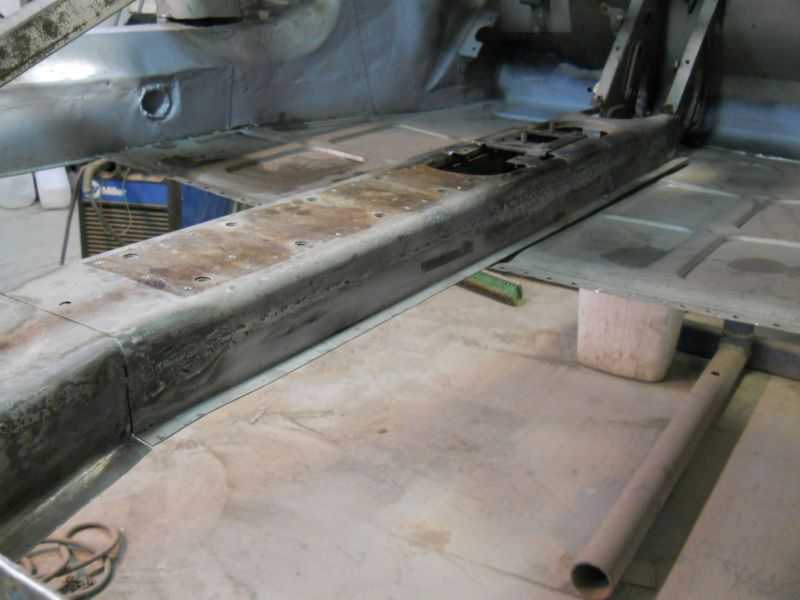

    Tunnel T1 conversion and seam welding continues.

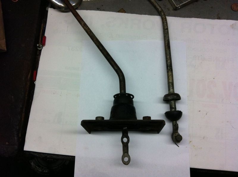

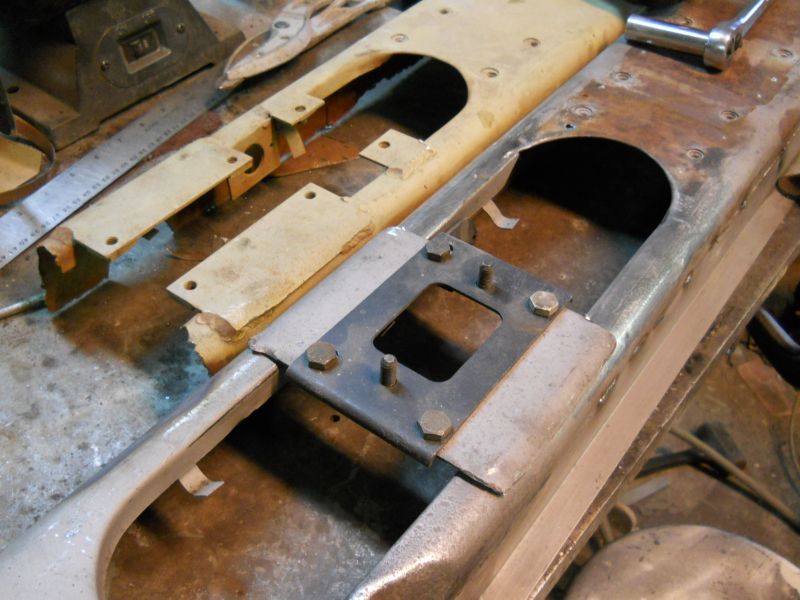

    As Jack mentioned earlier the T2 shifter and heat controller unit need be switched to be correct for T1. Ergonomically a mistake but its got to be right. Original mount tabs have been removed and am grinding and finishing the remains of the old welds.

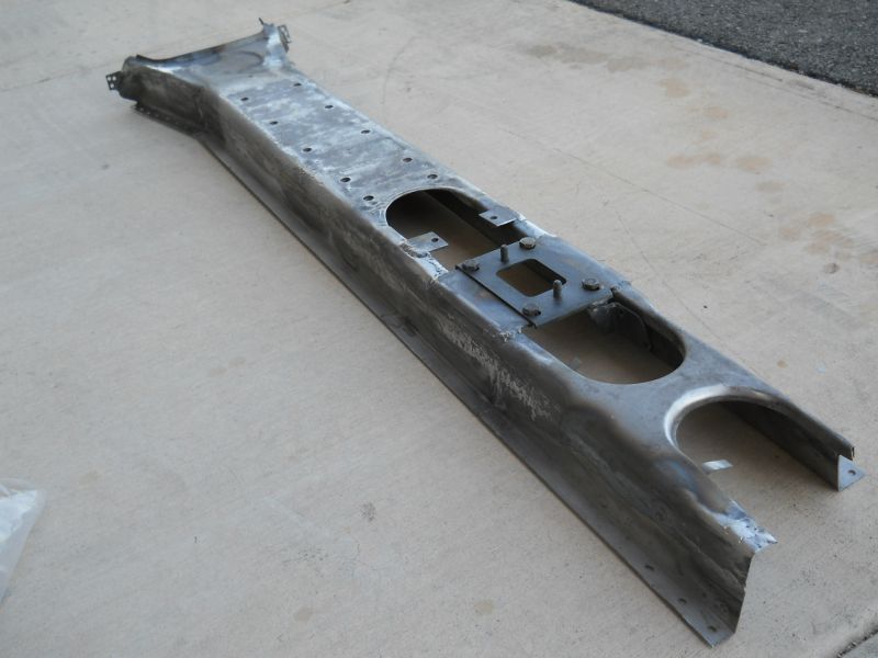

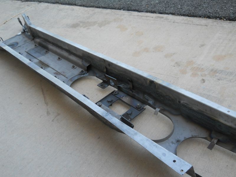

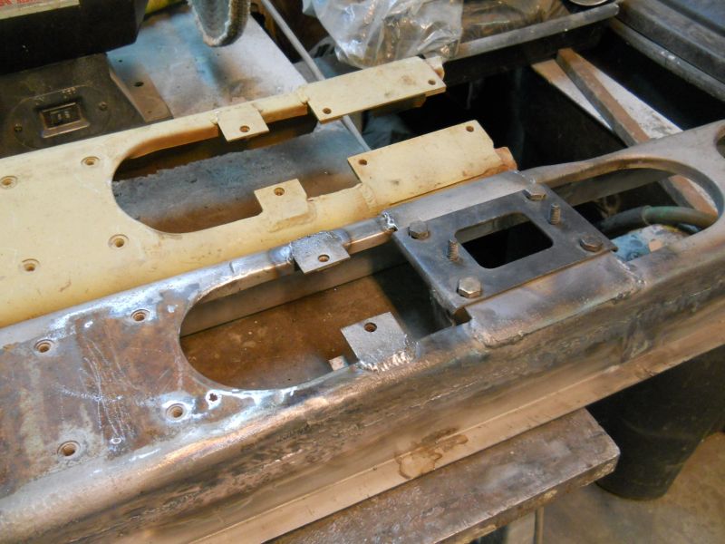

    Original T1 tunnel from a coupster provides the correct spacing and placement info I need. Bolted a Shifter base plate to the mount tabs to both locate and center each side.

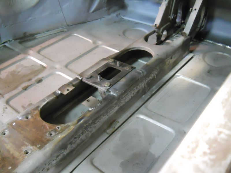

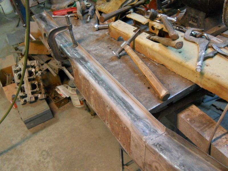

    While I was at it this afternoon I also finished up that Long seam weld on this right hand side. Still have most of the left side to go.

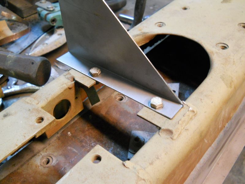

    Didn't want to dig out my heater control unit so I made a quick holding jig from piece of scrap.

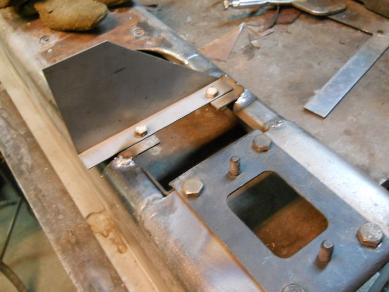

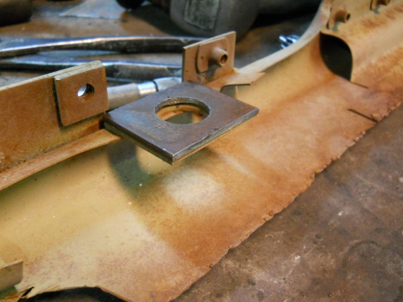

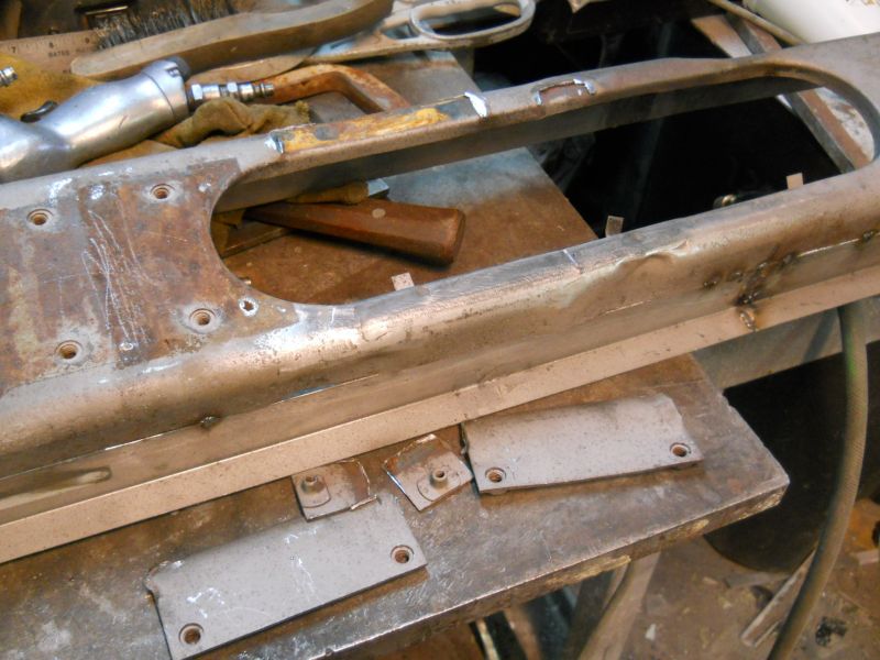

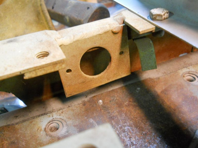

    Another T1 part I need to make is this mount plate for the reverse light switch.
    Jig with mount tabs welded in new position.

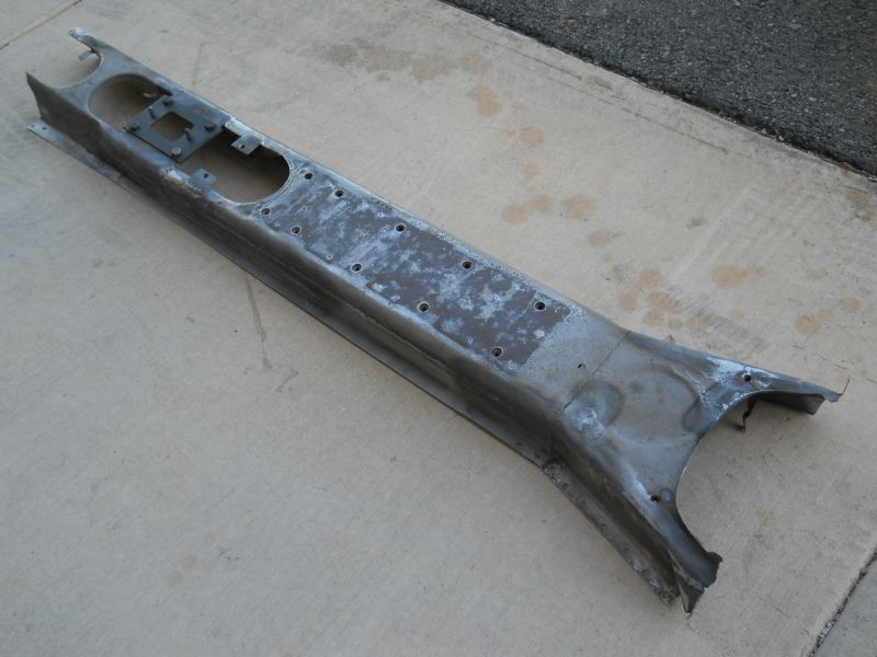

    A newly minted T1 tunnel housing.
    Another test fit to double check for heat distortion.

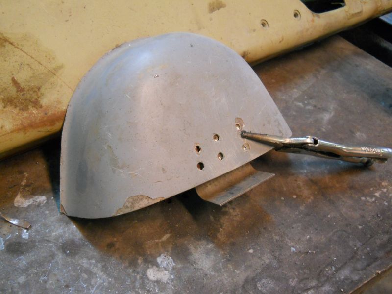

      T2 access covers went to this centralized base hook to secure the bottom of the cover to the tunnel. Early T1 covers are identical but had tabs on each side for a set screw.

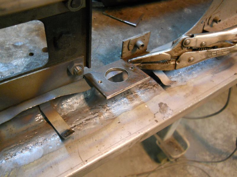

      Last detail is to fabricate a new T1 mount plate for the reverse light switch. Luckily I had the correct 4mm tap on hand to thread the holes.

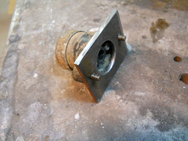

      This 2 inch strap section I had on hand was the perfect width and just needed to be cut to length. I really "eeked-by" today on tools and material.
      Basic part. Its a touch thicker than the original but I'd rather have it thicker than thinner. Its only welded at the top so there is a lot of leverage when the shifter works against it to depress the switch. Took a while to bore that large hole through there too.

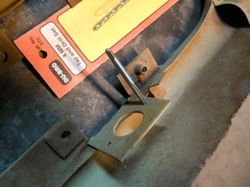

      Threading the holes.

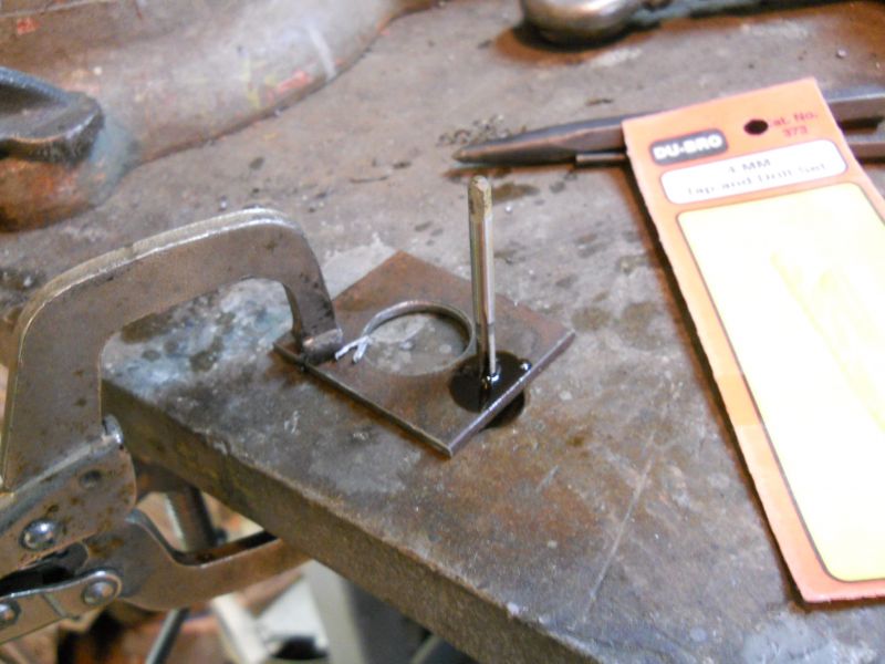

      All set. The hole lightens it but is also necessary for the wires to pass through.
      Ready to weld on tomorrow. T1 conversion chores complete. Thanks for looking! Justin

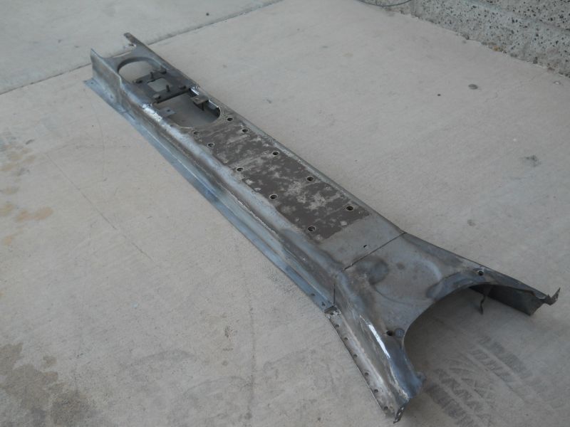

          Tunnel housing repair and conversion complete.

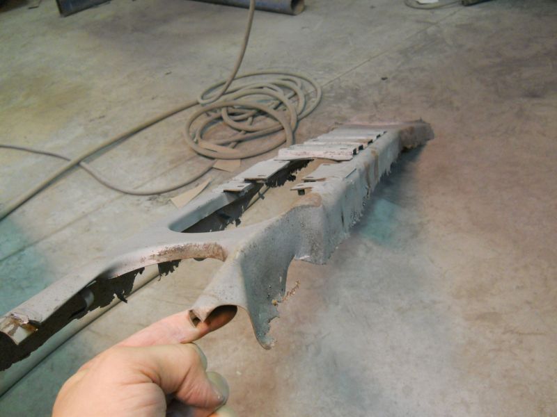

          What we began with.

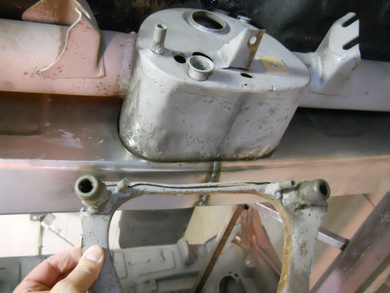

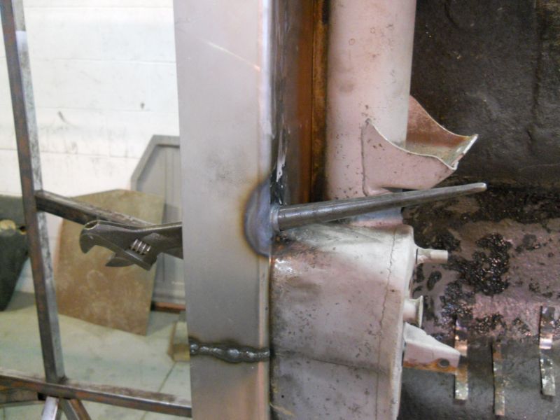

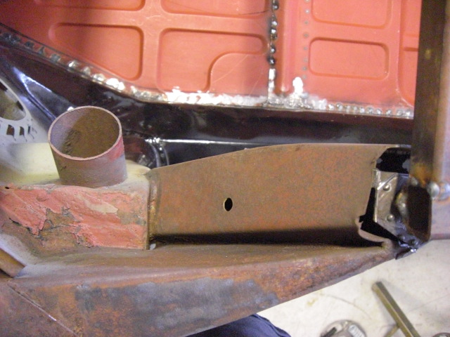

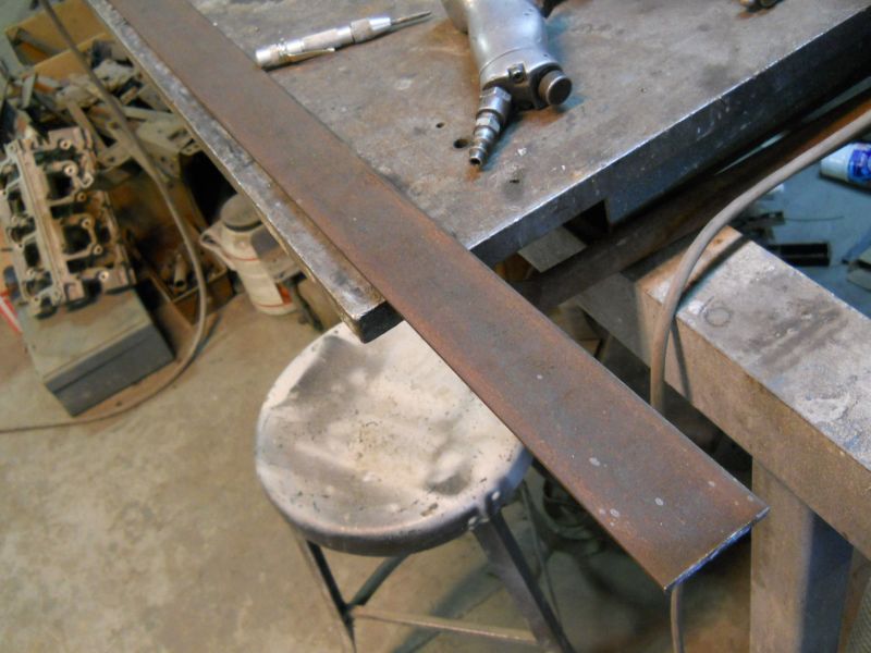

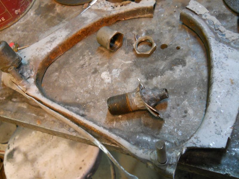

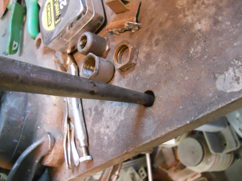

                Began the conduit repairs today by planning and harvesting the original E-brake fittings from the old wall section.
                First one free and now ready to grind down what's left of the old weld shoulder.
                Initial holes where drilled in the new wall then it was flared outward at an angle with some heat and my trusty cresent wrench. This tapered handle has come in handy for this sort of task more than a few times.

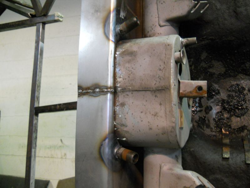

                Test fit. This side all but ready to be welded.
                Both sides all teed-up for final install and welding. These fittings will both need to be fully welded to the new conduits leads before they can be welded to the chassis. Working on that next. Thanks for looking! Justin

                              Thanks John! Those dies would be nice to have on hand but you could get by with a tapered shank like my wrench has or even a socket would suffice. Starting with a 3/8 hole to ensure a good shoulder would form once opened up to size I heated the metal up to a nice orange glow. It took me about 4-5 cycles of heat, hammering it in with a dead-blow hammer and twisting and working it. I probably could of got it in 2-3 cycles if I wasn't on my own but as you know you lose precious time and heat putting the torch down and taking up the wrench and hammer to strike it.
                              Most of my flares have been made with a "female" backing as pictured above. Didn't have that luxury on this last go round but it was so close to the bend and tunnel housing that there was plenty of support.
                              As for the part you have pictured I think you could easily find something with a close ID and one with a close OD to flange out those embossments once you remove the centers with a hole-saw.

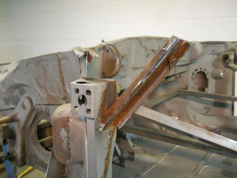

                              • 7/3/14

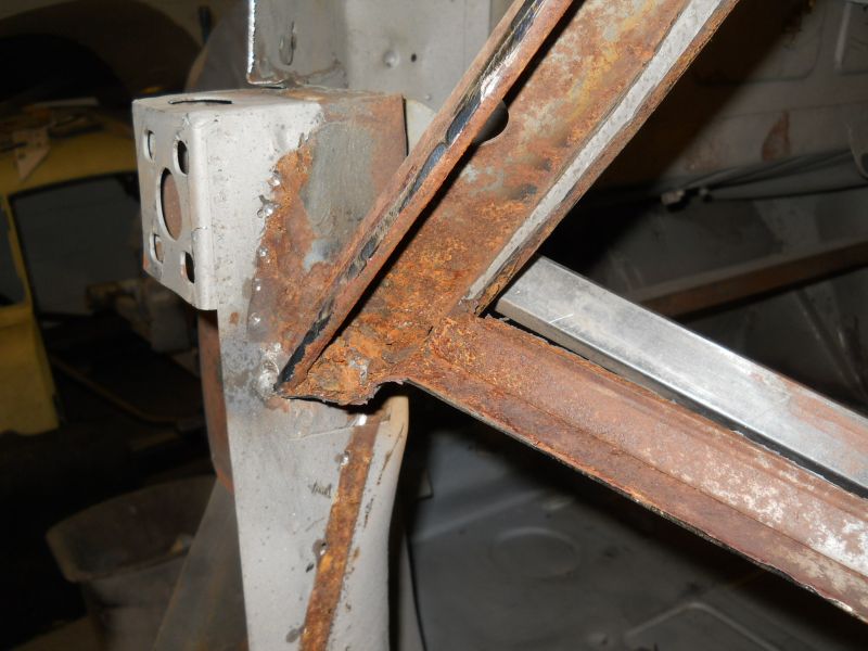

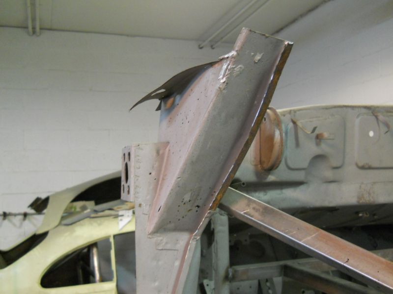

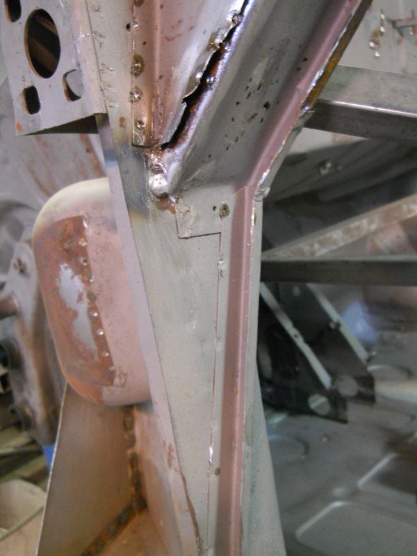

                                A-pillar prep for Speedster windshield post mounts.
                                Didn't make it by the supply house for the tunnel conduit tubing so I spent todays session prepping the left windshield post for the eventual speedster conversion.

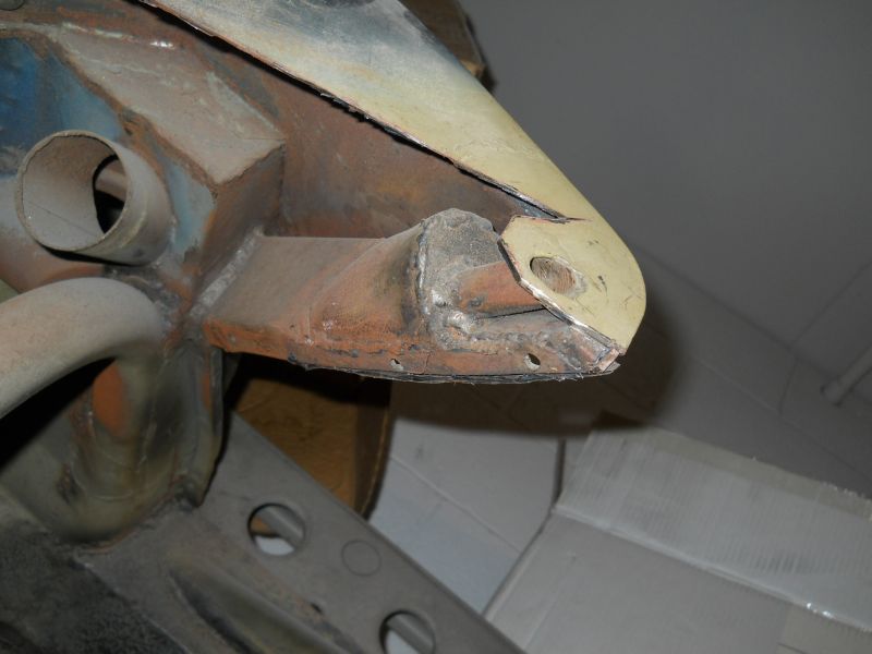

                                Had this area been solid and dry I would have spliced in the recess cup and Speedster post mount into the existing sheet metal. However, the rust holes toward the bottom of the mount are a very bad sign and its structural integrity is very questionable.

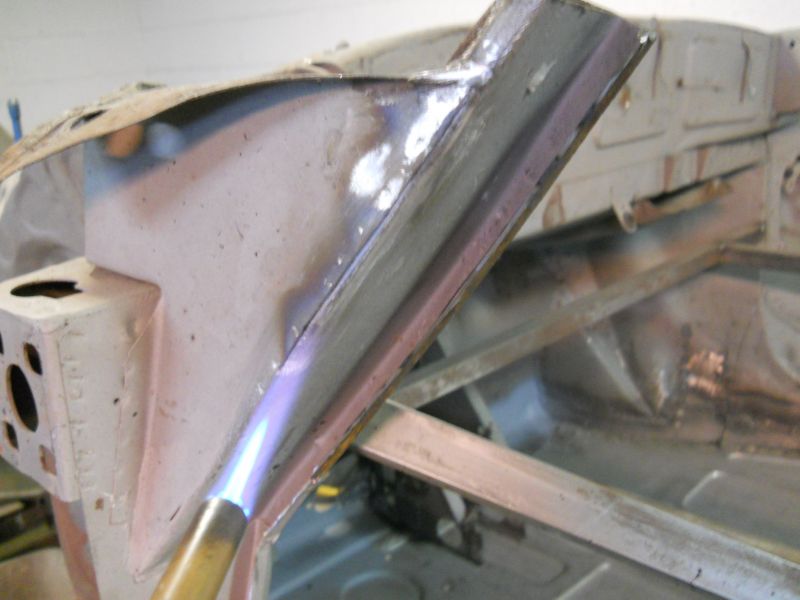

                                melting the remaining bit of solder off to expose the joint for the forward closing panel up and over the hinge mount. To get a clean shot to work on this I find it necessary to remove part of this panel just at the hinge where it bends around.

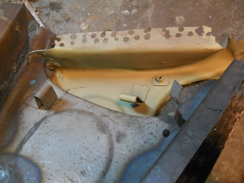

                                Upper closing wall now removed and exposing what I already assumed might be there considering what I've been through so far with this frame. Why change now..

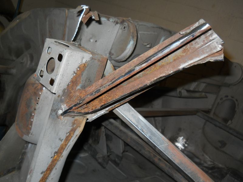

                                outer face plate with its internal reinforcement trough being peeled away here.

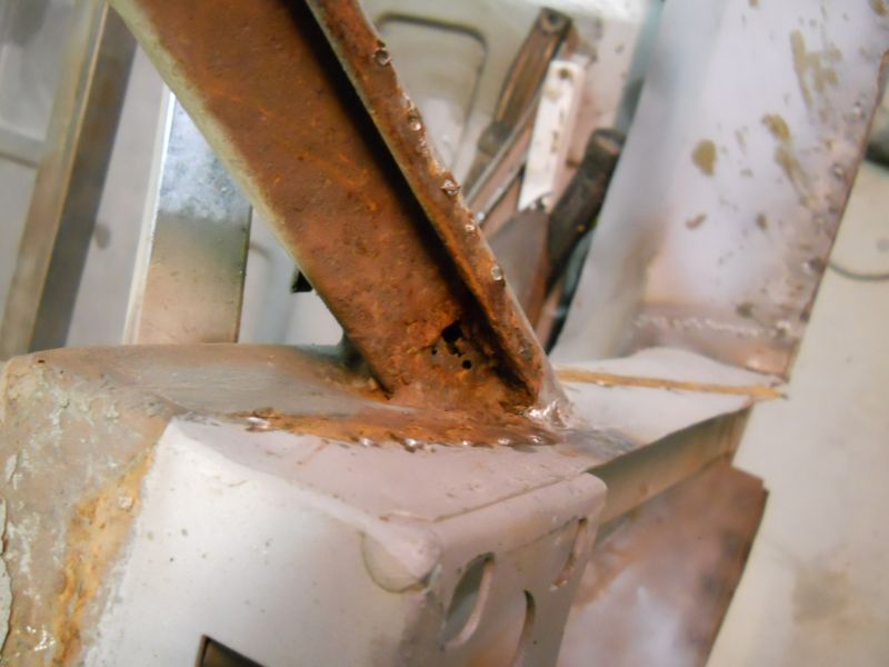

                                A nice thick cache of rust scale was of course at the bottom.
                                A few remnant strips of metal to go but its about down to bare bones.

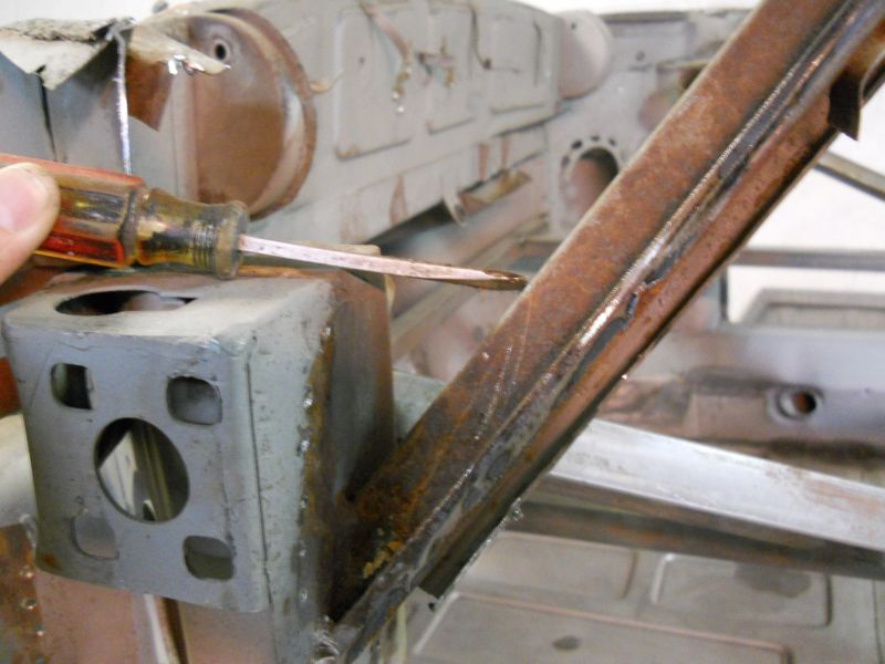

                                Another thought that came to mind today was adding in a gusset represented by the screw driver which would run from the hinge box to the eventual closing reinforcement panel. Not original but wont be seen and it will add more triangulated strength to the pillar/mount and in turn reduces the lever arm up at the top of this eventual post mount. Life's about the leverage, right. Thanks for reading this! Justin
