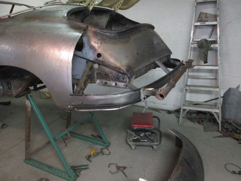

  • That bottom valance has to be set so well in the correct position. After looking at your efforts you know that. But..how do you know where exactly the bottom of that valance should be. So easy to be an inch out.
    Here's how:
    quote="Jack Staggs" Now is about the time you need to put that trans back in, and fit a mock up engine, with perimeter shrouds and muffler (I assume sport type with twin straight tips), to verify clearance of the tips to the lower edge of the apron, and also to assure proper fit of the engine surround sheet metal. We're getting ready to do this check on a '53 soon.
    I want to see 1/2" clearance to accommodate movement of the driveline on the mounts, and inevitable bottoming out of the tips, without striking the body work, another thing I HATE...

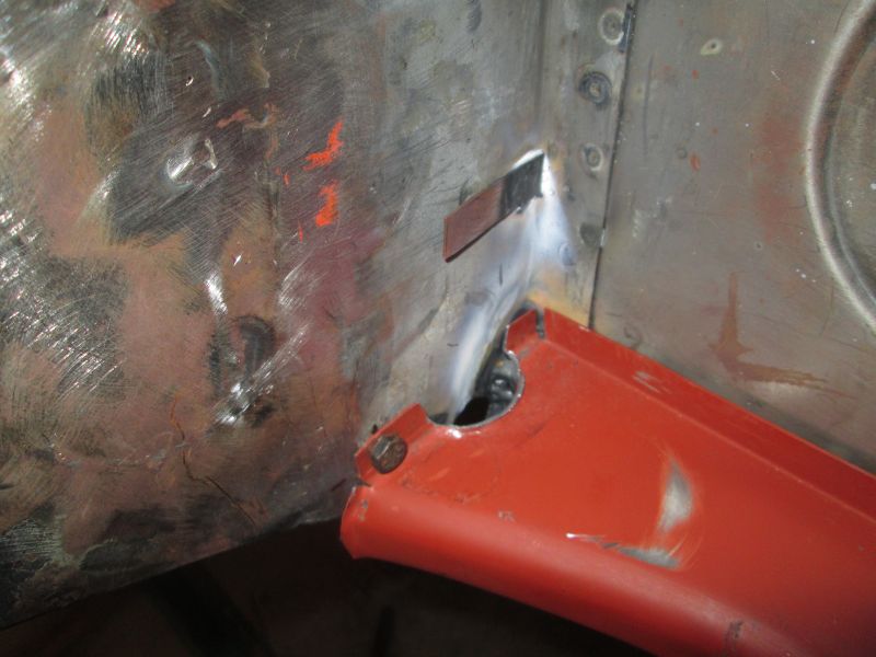

      These cars all varied here I'm certain but my coupe is showing the iron exiting on the high side of the hole. Skin and bumper mounts are all original to the car. The example iron is original but not to this car. I've got the coupster skin now spaced away from the irons but not quite this high. It will most certainly change a bit as she goes.

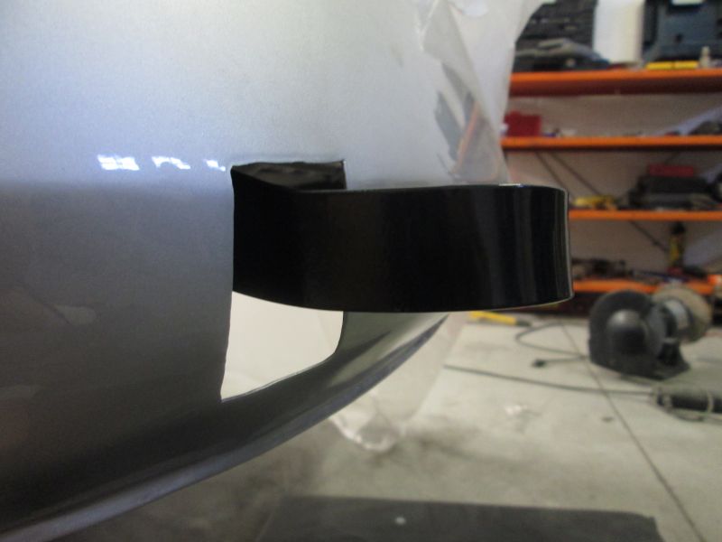

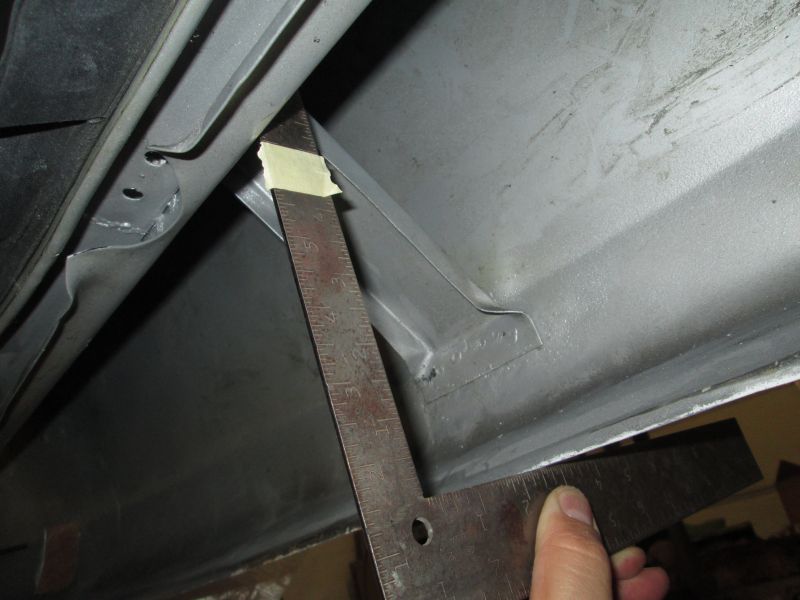

      I'm determining the apron's overhang with its relative distance to the leading edge of the cross member. Using my square mounted flush against the frame to do that. I'll post those findings shortly. Not completely scientific but it gives me a good ballpark. Then of course the final test is performing the mock up that Jack recommends.
      Thanks again! Justin

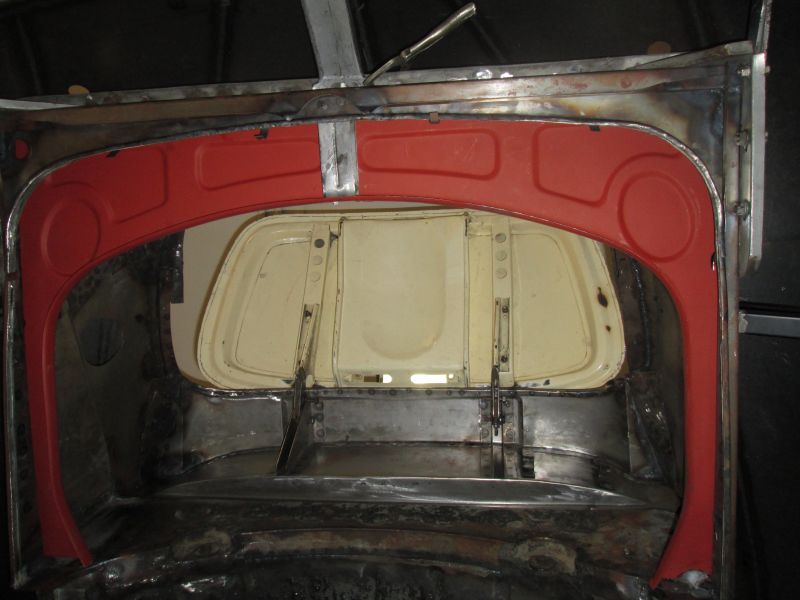

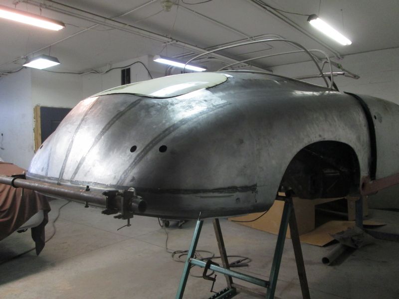

      • 7/10/16
        More tail work from last week.
        I started out with the skin resting directly on the irons so spacers (paint sticks) where added next for needed clearance.

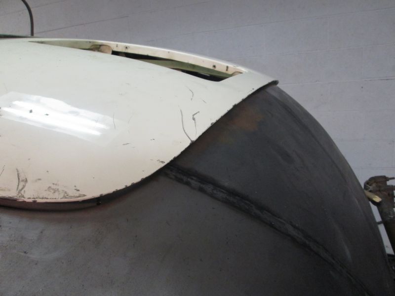

        This needed adjustment upward a little more still made the overbite at the deck lid of course a lot worse.

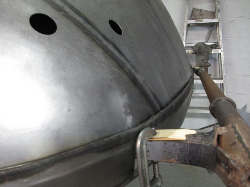

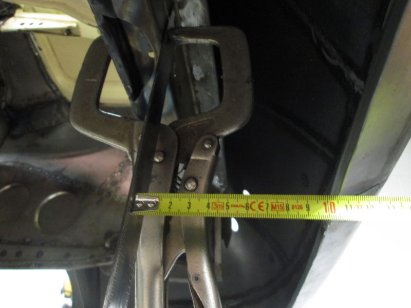

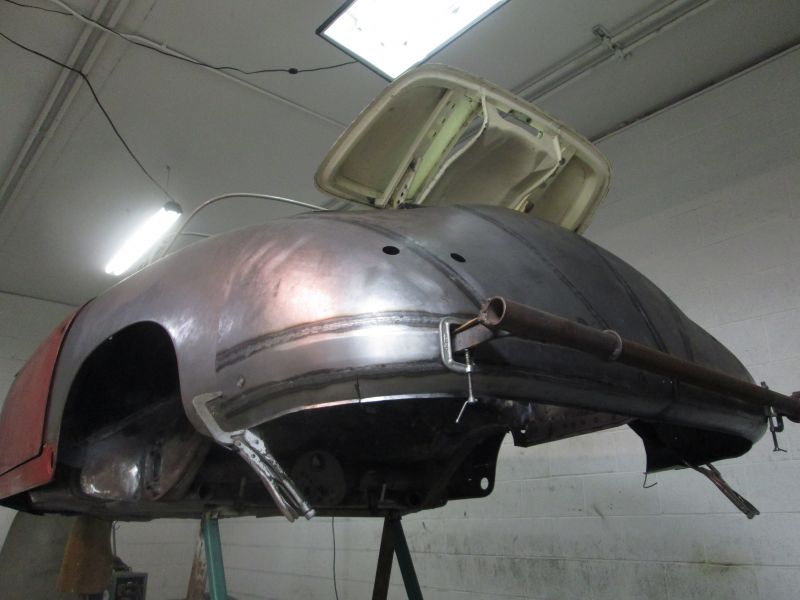

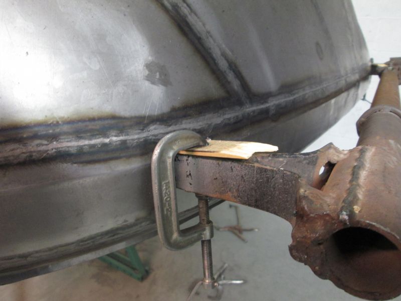

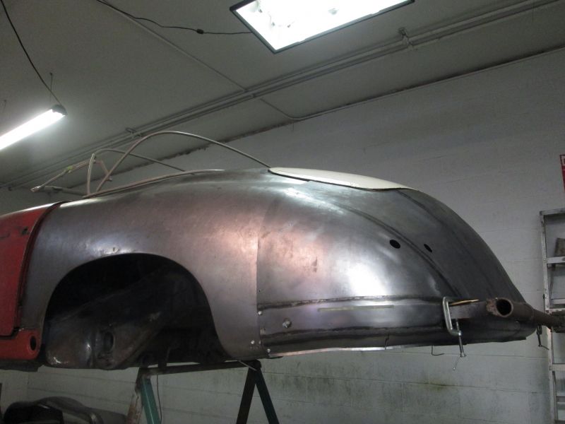

        Added the c-clamps to hold my spacer and to lock in that desired distance away from the frame. Like I said this shop is very high tech/ cutting edge.
        Lower apron dialed in for distance and height but all at the expense of the upper portion's fitment for now.

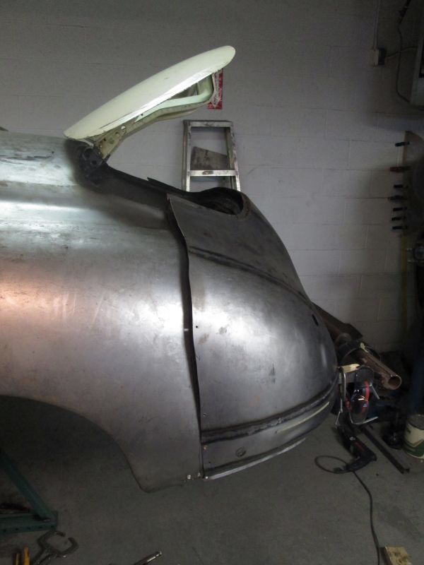

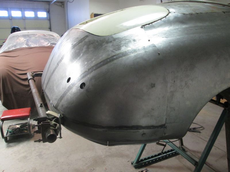

        My guiding rule of working outward from the closing panel didn't quite hold water here. Instead, I had to cut all that loose again and work backwards. No away around it I suppose I had to get it mounted first, then figure out "where" it was wrong. Another lesson learned.

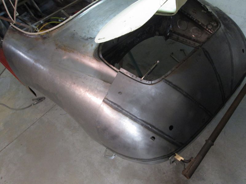

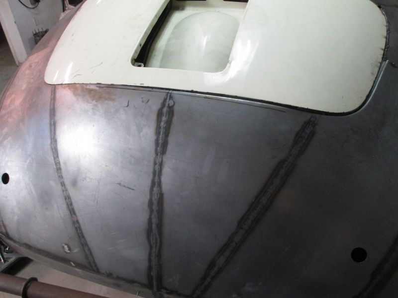

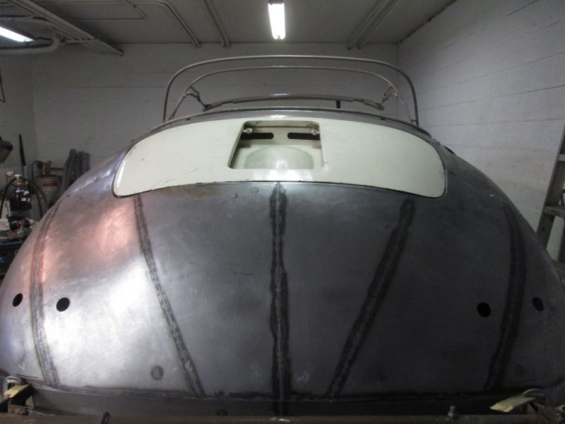

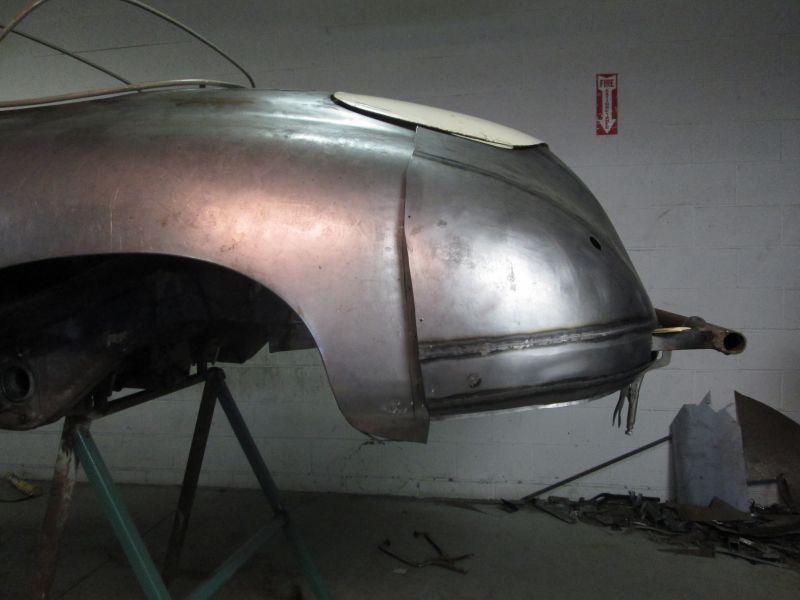

        As this photo highlights I have a lot more issues than just the loss of the lid gap. The entire upper tail profile stand up way too proud now.
        So I'll be cutting the tail along this weld joint to remove the excess metal. A big commitment and a little scary but the best option. The fine line tape section to the right highlights the bead roll. It has a definite angled approach so I took my digital protractor to my coupe to establish it. The apron is now secured to the fender to hold that attitude before cutting. This big alteration along with the complexity of it all was really weighing me down.

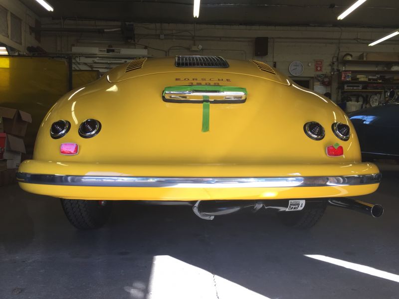

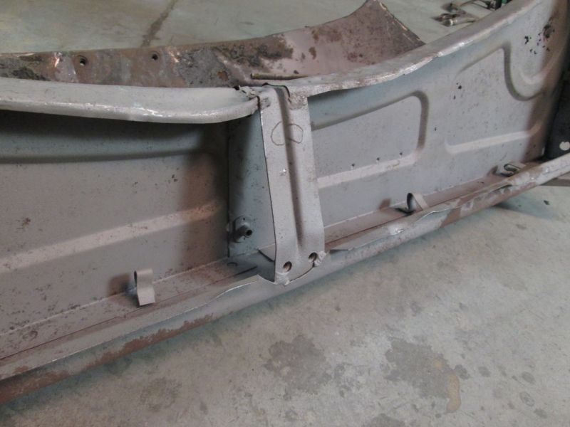

          • Justin, here are a few quick references for a rear valance. The yellow car here now belonging to John Kreuz is also scanned as what it looked like in 1967. A '56, it had already been converted to tear-drop lights.
            (The yellow Speedster is not lopsided, the floor is...going toward a drain, and it's the same Speedster.)
            The other pictures reference the two original taillights on a '56 Cab, same story, and even with all the prior butchery done, the center of the original hole is 198mm from the inner corner of the unequal bumper bracket holes, FWIW.
            John just told me that the above scanned picture was taken at an early PCA Parade that used the old Marlboro race track and that Bruce Jennings drove that car around with him as an instructor.

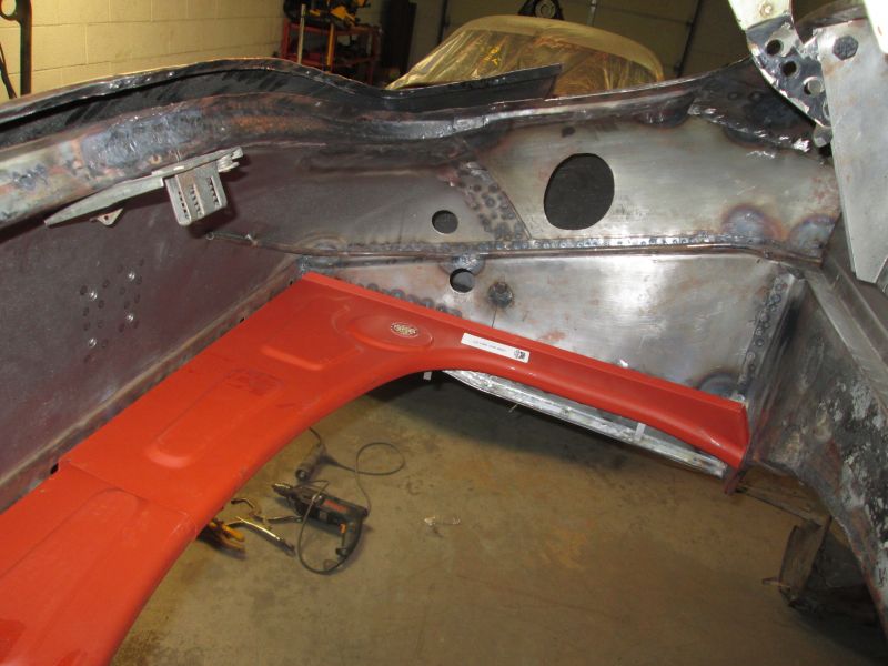

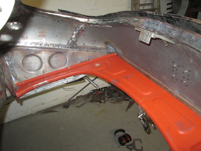

                7/11/16

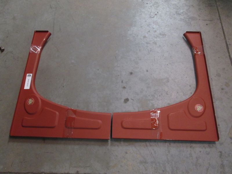

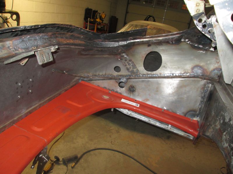

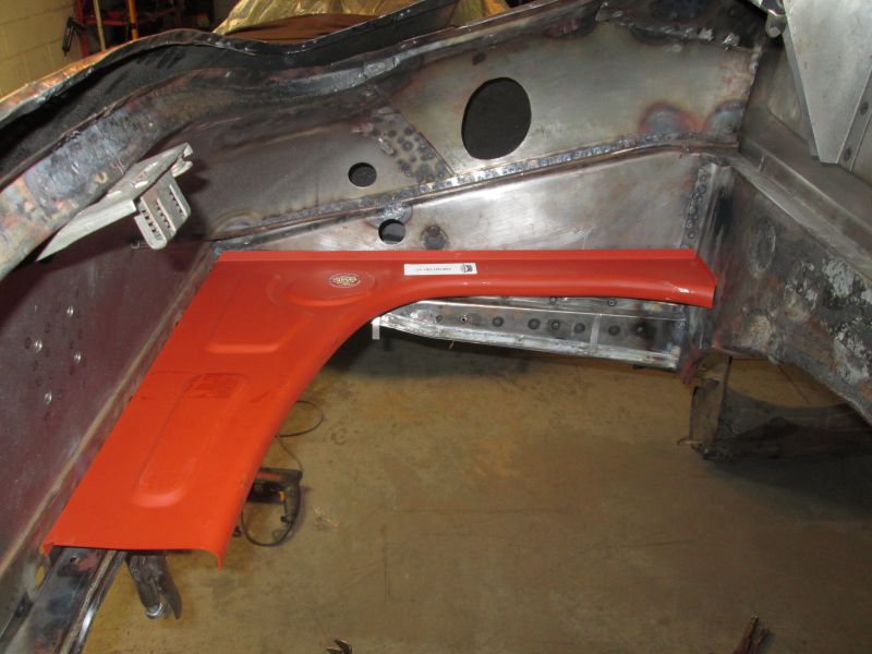

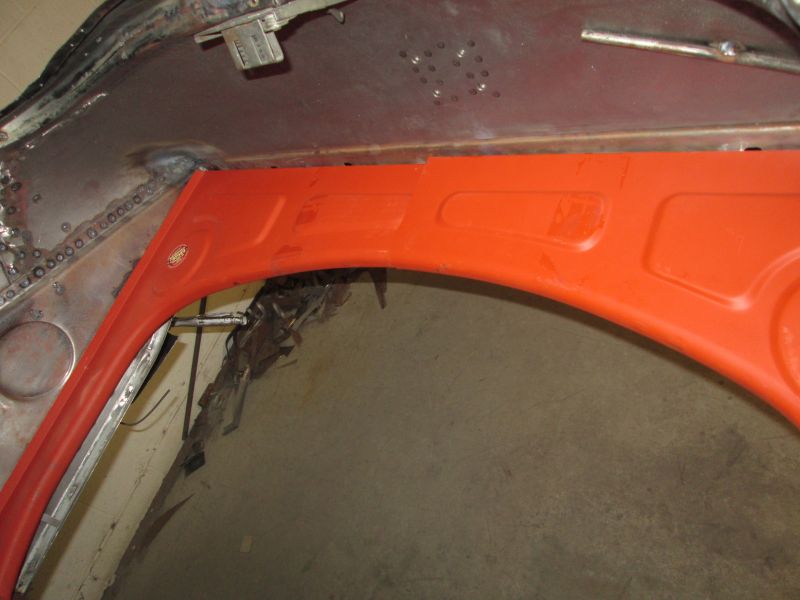

                Push-rod engine tray prep and install
                Just a touch too long on both sides but it nearly fit right out of the box.
                Both sides only needed about 2mm in length removed to fit. Forward flange was just flattened and rebent at the scribe line.
                It now cleared and seated right in.
                An equal amount was removed from this side as well. The best confirmation with all of this was that dimensionally they were all so close to fitting minimal modification required and also that this new engine compartment is actually still in square.
                I have some excess overlap to remove at the center but I won't trim that until I have the sides bolted and synched against the walls. This was so easy and straight forward for a change that it was actually an enjoyable session.

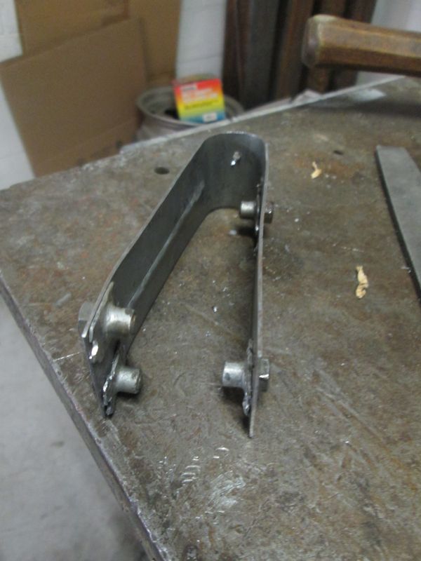

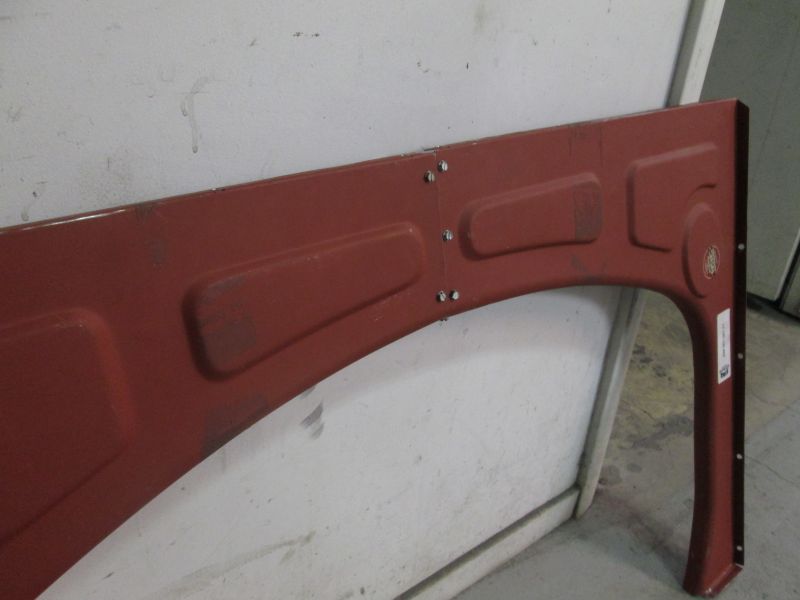

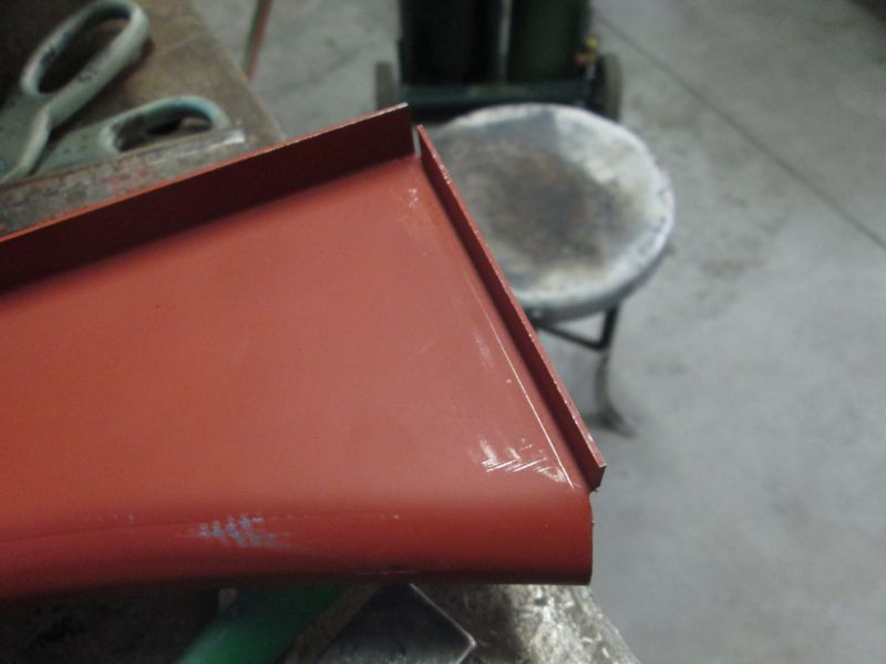

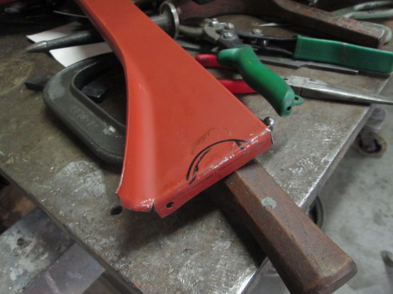

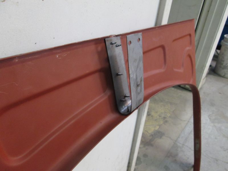

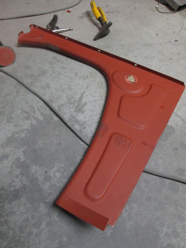

                Replicating this coupler bracket next. This is an original from a '59 and as you can see the factory went back to welding this shelf in by this time so what was once meant to be bolted in was simply gas welded on.
                Coupler in basic form and now set screwed joining both halves.
                Eventually the screws on the left half will be replaced with a plug weld and the right side will get two bolts.

                One new removable T1 style shelf mounted and finished.
                It was stress free and fun while it lasted. Now back to that tail.

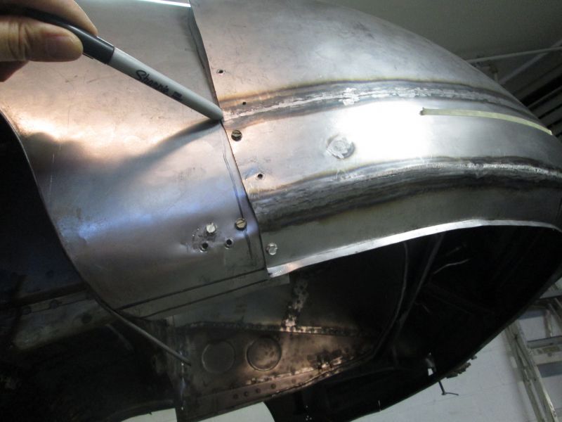

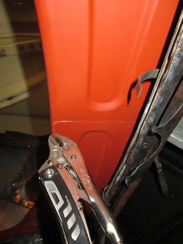

                      7/12/16
                      Back to work on the tail.

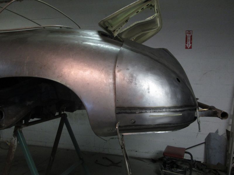

                      Had enough time to think about it so I was ready to take the plunge and start cutting.
                      Committed now... Apron remains locked into position so I can work back from it.
                      Initial fitment with the upper portion slipped in behind the apron.
                      The upper half was now resting on the bumper irons
                      That initial cut still wasn't enough as it laid still a bit too high and uneven.
                      I began cutting small strips away at the point of contact and after a few rounds of that it was able to seat where it had been. General alignment coming back.
                      Now secured and aligned with all the initial set holes before I started worrying about bumper bracket mounts and apron clearances.

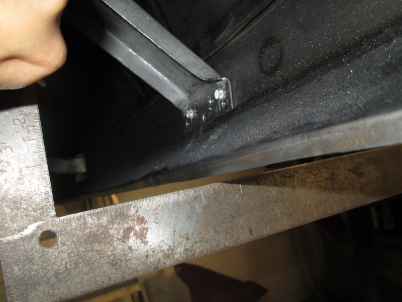

                      Going back to Roy's comment about apron clearance this again was the relative differential from the bottom of the apron to the leading edge of the cross member of my reference car.
                      In the same location I'm getting readings of about 2-3mm higher. Good news but again its just a ball park and it is strictly relative as everything back here on this car is just an interpretive copy including my placement of the parts. The true test will be an exhaust system mock up as Jack suggested earlier... BUT it seems to be close.
                      so relieved to have that fitment against the lid back

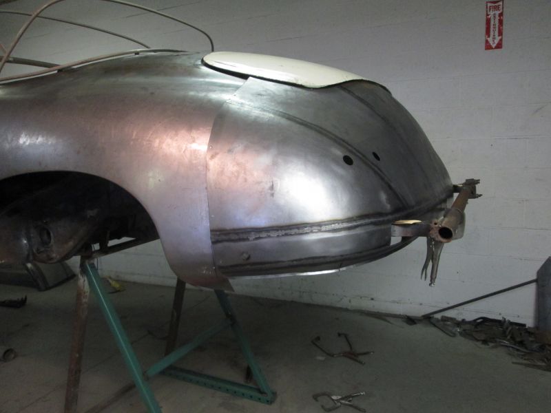

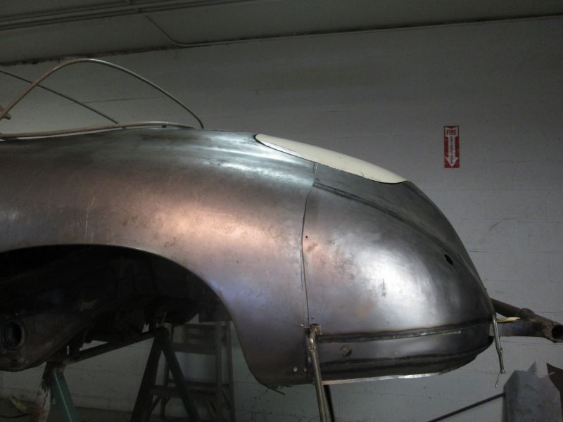

                      To get a Butt-joint here again I'll be removing a solid half inch strip of metal.
                      The tail lights still don't look hideously low to me but they'll be a lot closer to the bracket holes than Bruce's example car of 198mm. I'll take a measurement tomorrow. If necessary I could fudge the holes up a touch higher to compensate for that half inch its losing. To be determined.
