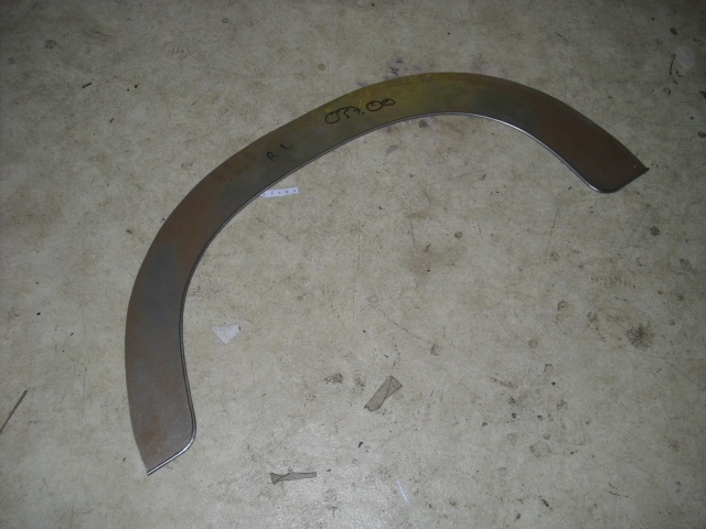

    These photos were taken for me a couple years back when I needed some arches but I needed a litle more than the 90 mm so I could not use Ritchies parts.
    It is worth sending a email to KK IF you looking for something special....they might have it or good leads on getting it somewhere around the globe.

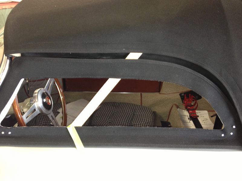

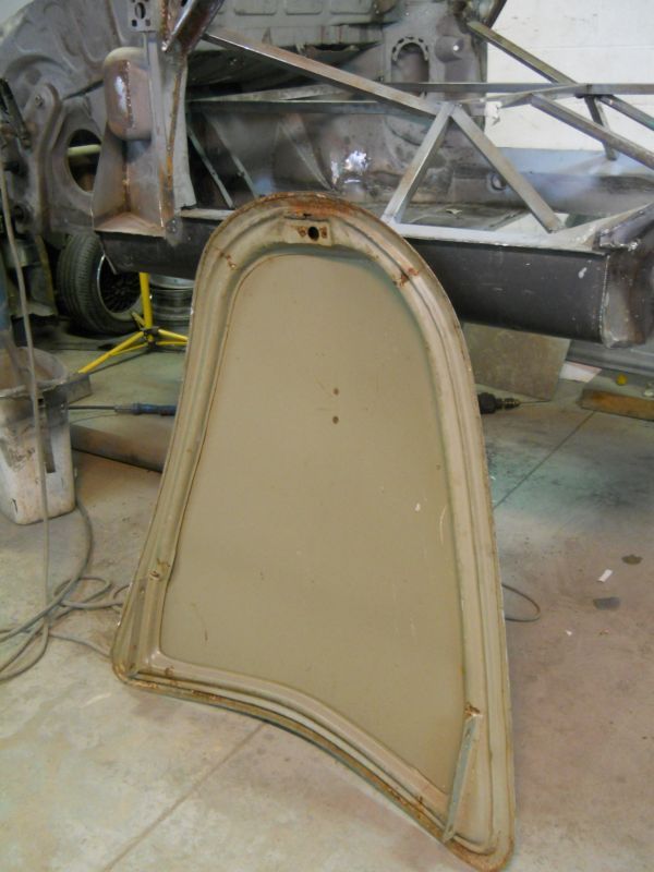

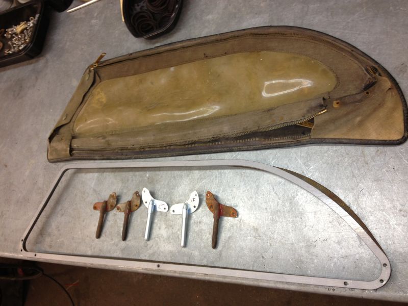

    • Speaking of curved parts, the side curtains for the new top on 84255 didn't fit well, too much gap at the rear arch where the low curve of the side curtain didn't meet the higher curve of the new high bow top.
      I called Autos and spoke with Agustin and asked if there were different side curtains for a low bow and a high bow, as I never noticed that between tops, but who the heck uses those awful things anyway? (I did, in the winter when a Speedster was my only car...and they sucked!) and the Factory books, the Brett Johnson books all are less than complete with photos or facts.
      Augustine said that he was unaware of a difference, so I took some of the A.I. versions apart and old originals apart to compare frames. Hah, there's what I need! Here we go again with 'custom' for something that sucks at best when new, trying to make that fit better even if they are never used.
      At least the owner of my old Speedster DOES drive the car regularly and in a 'spirited' manner.

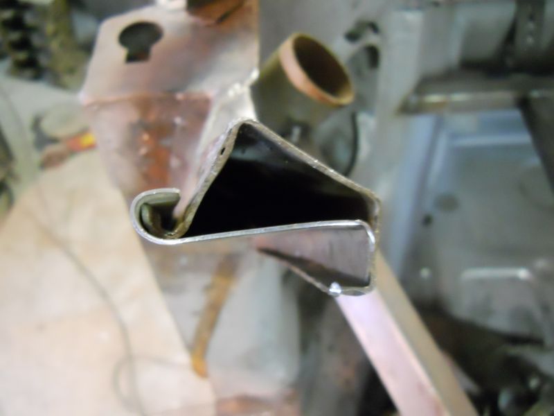

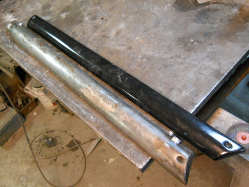

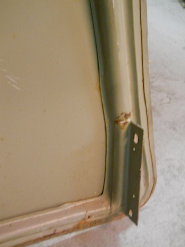

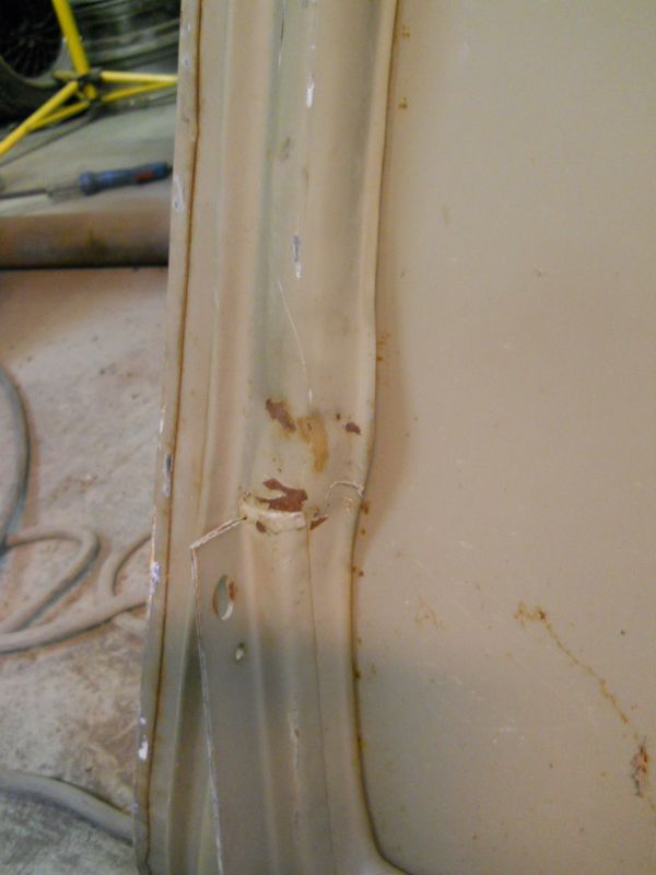

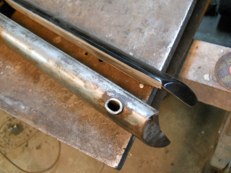

        While coupe and speedster door tops are similar in shape they really are different animals The speedster has much bigger radius profile.
        While you might be able to add metal to a coupe garnish rail it would be far easier to just begin with fresh piece of steel.
        Thanks for sharing your insight concerning the windshield frames Bruce!
        On those side curtains I think AI version frame was modeled after an early Low bow side curtain. It would make sense that the slope of the frame would cut a little quicker for the lower top profile.

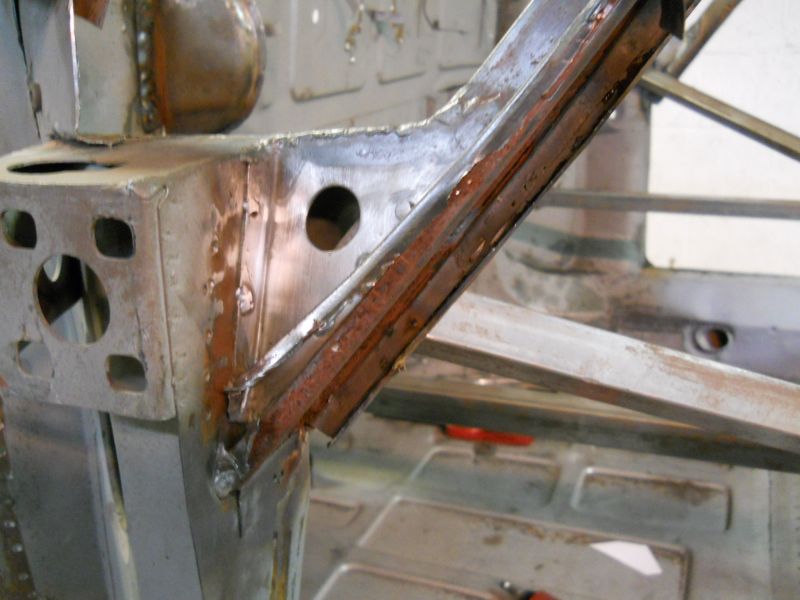

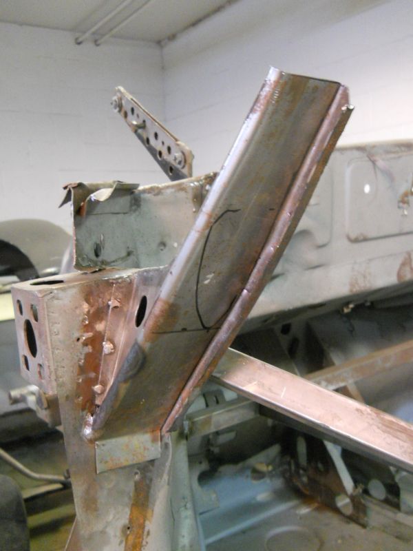

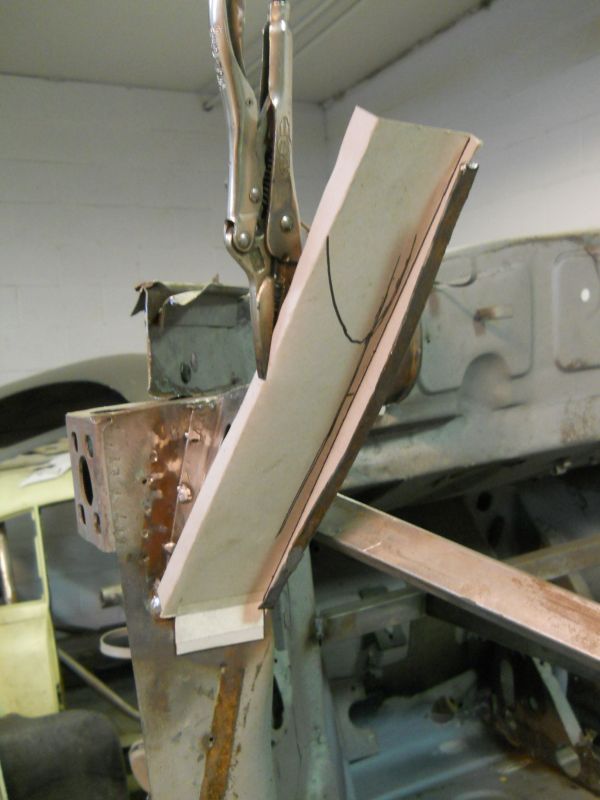

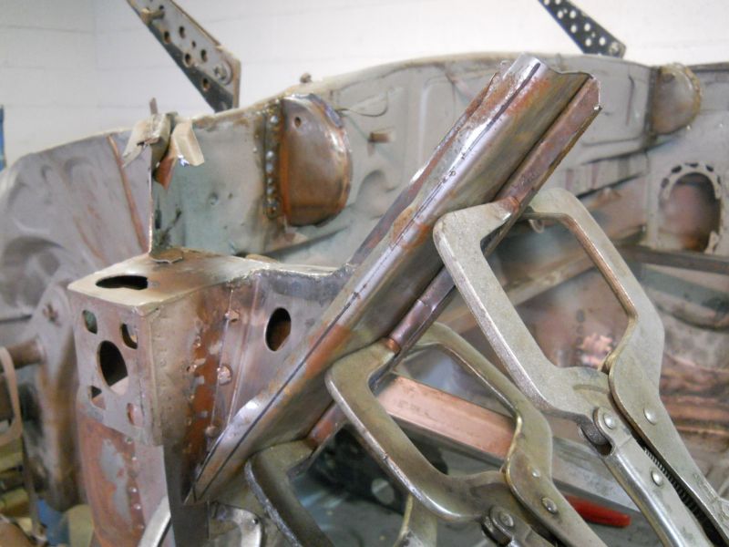

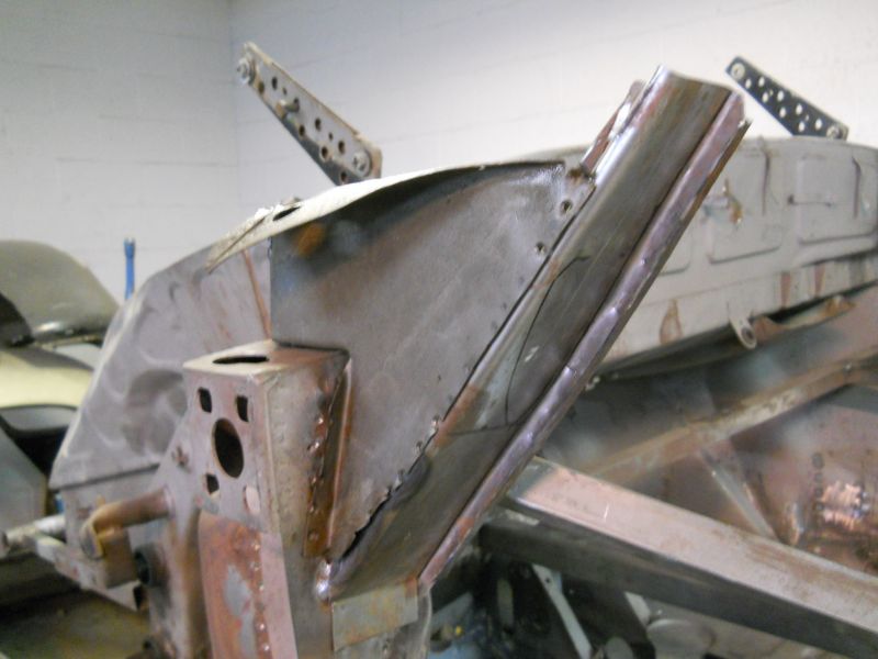

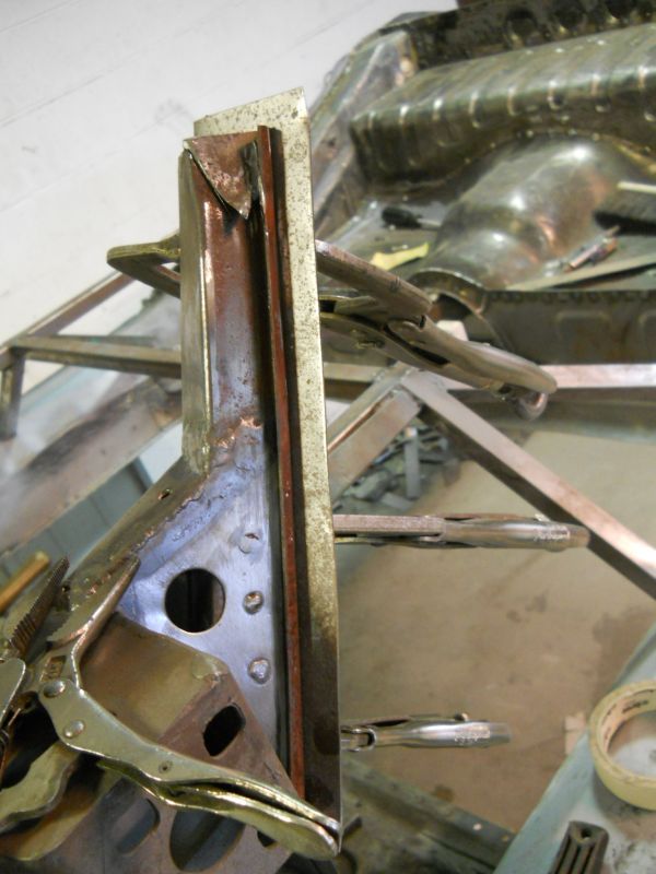

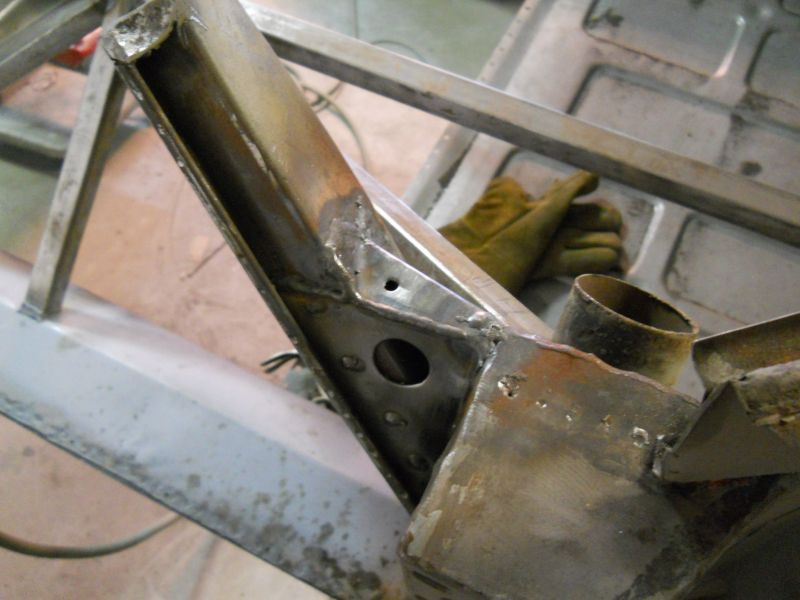

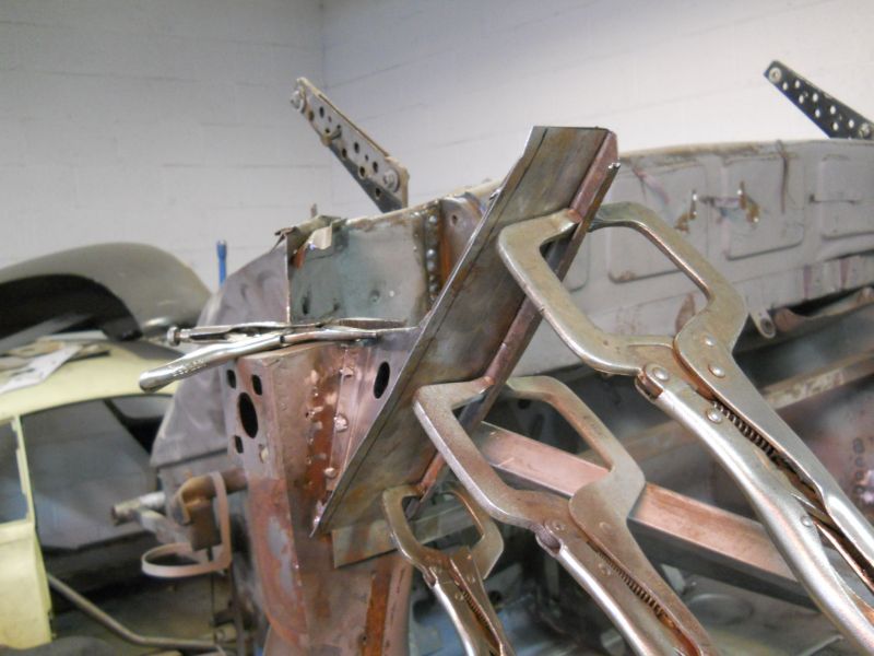

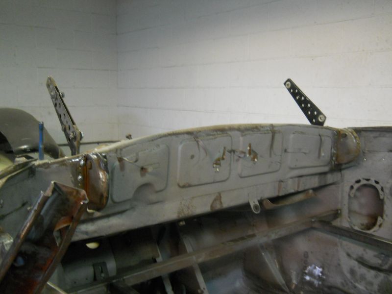

        Right A pillar gusset complete.

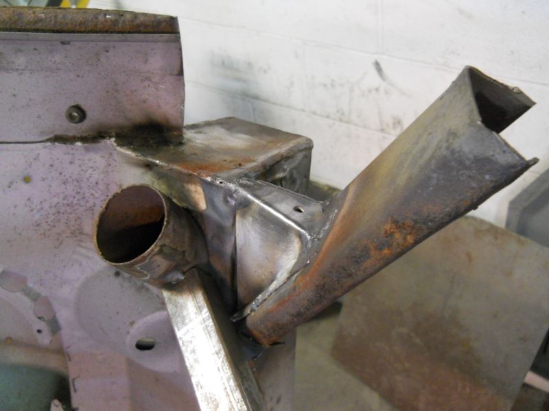

        Basic shapes cut out and fine trimming and fitment next.
        Welded and complete.
        Moving onto the hinge boss conversion next. Thanks for looking! Justin

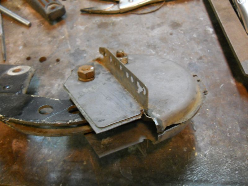

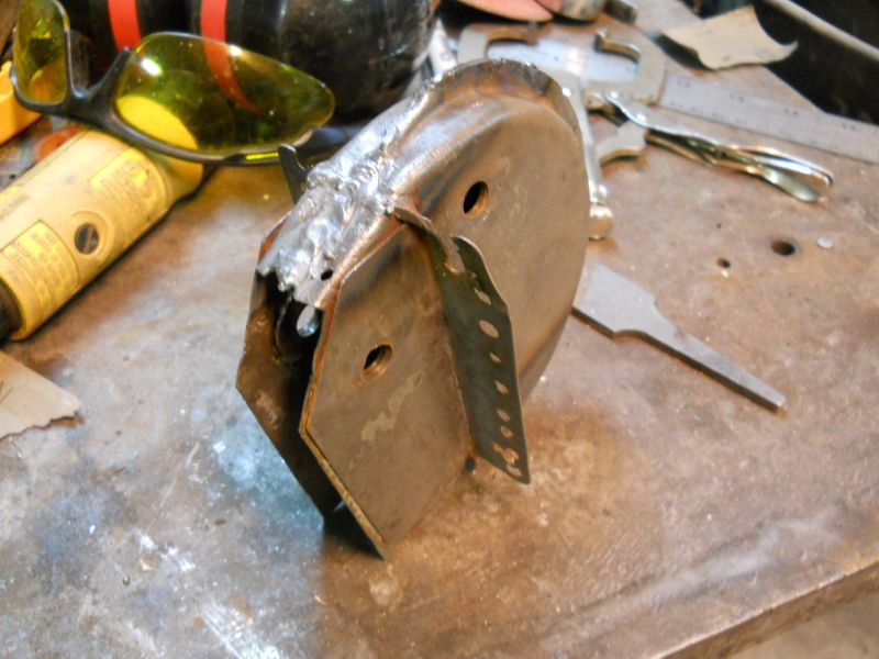

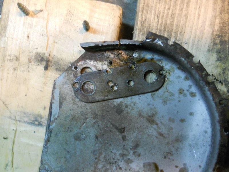

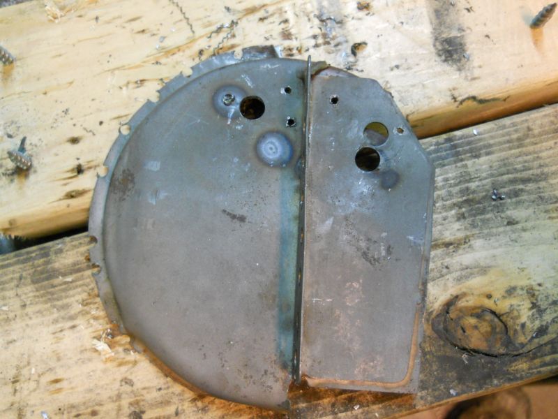

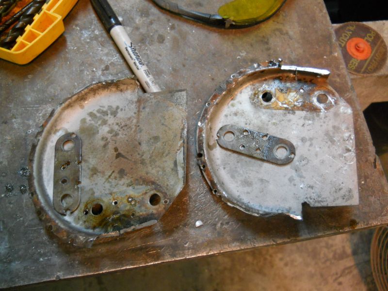

            Front hood hinge boss conversion
            As mentioned a little earlier a coupe/cabriolet hood rests a little higher than a speedster in its opened locked position. Mounting hole modification is required to replicate this detail.

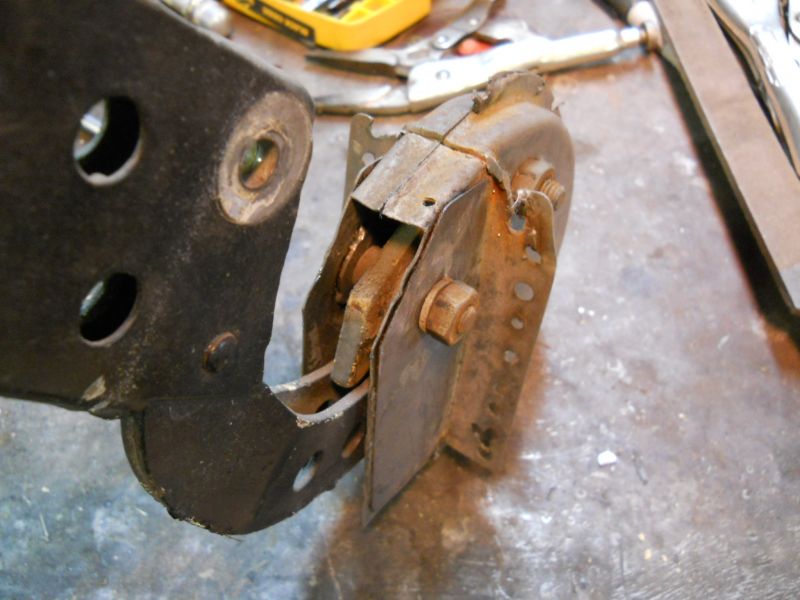

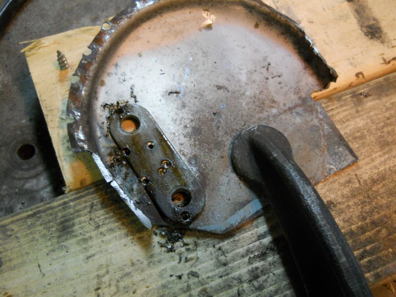

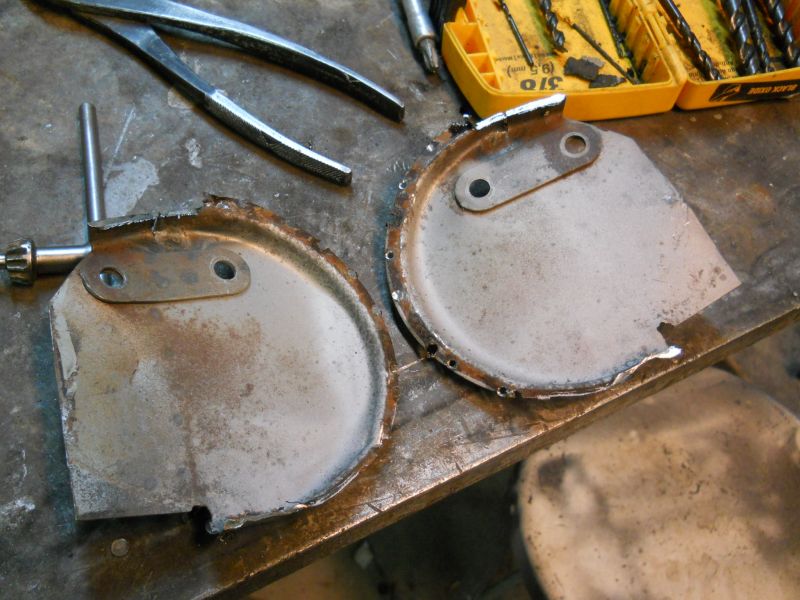

            left hinge boss split apart to get at those reinforcement tabs.
            Spot-weld drilling of course...

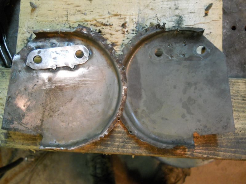

            First tab freed and mocked up in my anticipated position: Forward anchor moves downward its "hole width".

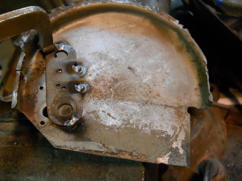

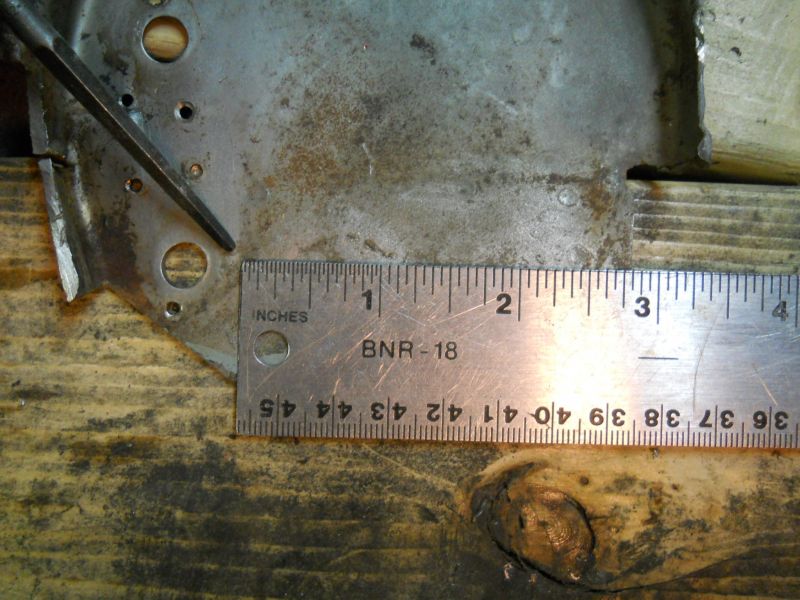

            Both halves teed up for the modification. Needed to measure my friends '57 speedster to confirm where the new hole should be first.
            Measured my buddies Speedster late this afternoon and the center of the forward spur hole was just better than 2 3/4 inches to the lower edge of the housing. Example measurement above on the old coupe housing puts this "speedster" specific detail almost exactly a hole width down. Close enough for gov't work!

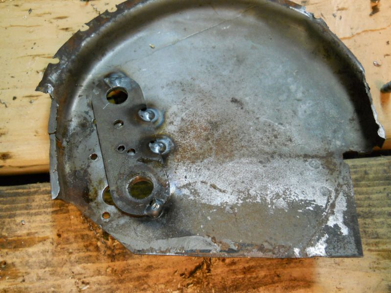

            old plate now tacked into its new "speedster" position. Rear hinge pivot hole of course stays the same.
            New hole now opened up just under the original coupe position.
            The reinforcement tab also double as a great locator for the new hole.
            First half dressed and complete.
            Will finish up the other side tomorrow and weld this shell back together. Thanks for stopping by! Justin
            • Originally posted by JTR70" post=20159
              .....Actually the price on his door tops is still not too out of line. Speedster door tops are among the hardest items to come by. A lot of them just rotted away. Even 14 years ago as I was trying to locate original parts, the door tops were the toughest to find; and so was the lower speedster windshield frame.

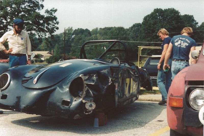

              I bought 84255 in the '80s with a very flattened left side from slamming a wall in a race in the '70s, so as I had sold a pair of NOS Spededster doors to Parker Tyler already and it was too much money to buy them back, I made the replacement door from a nice clean C door.
              Hey, it was only a race car! I then made the top garnish rail/curtain pin holder after I sold it and it was made more like it was when new, but at that time was never to get a top.
              Things change.

                To be clear; is this the same car right?

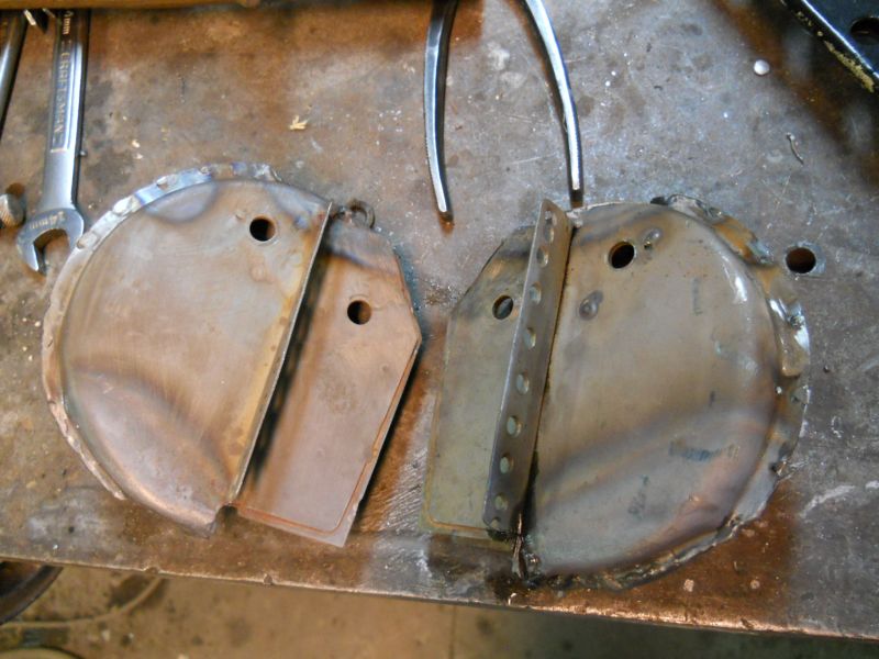

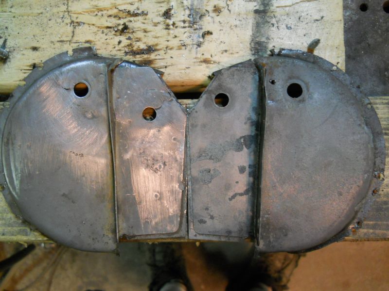

                To ensure there is no fitment issues after welding like alignment or clearance I thought it best to bolt up a hinge to act as a jig while I joined them back together.
                Side by side comparison with the stock coupe angle on the right and the new "speedster" configuration on the left.

                One Speedster versioned hinge boss ready to mount back in the chassis. Converting the right side boss tomorrow. Thanks for looking! Justin
                • Yes, Justin, that is the transmogrification of old 84255! It was rolled by owner #1 when just months old and silver, nose-overed a few years later by owner #2, left body-slammed into a solid concrete/steel wall by the owner #3 standing next to it when it was black and given a hard hip-check into the 'blue bushes' at Watkins Glen by owner #4, me, when the yellow version. It's back to silver.

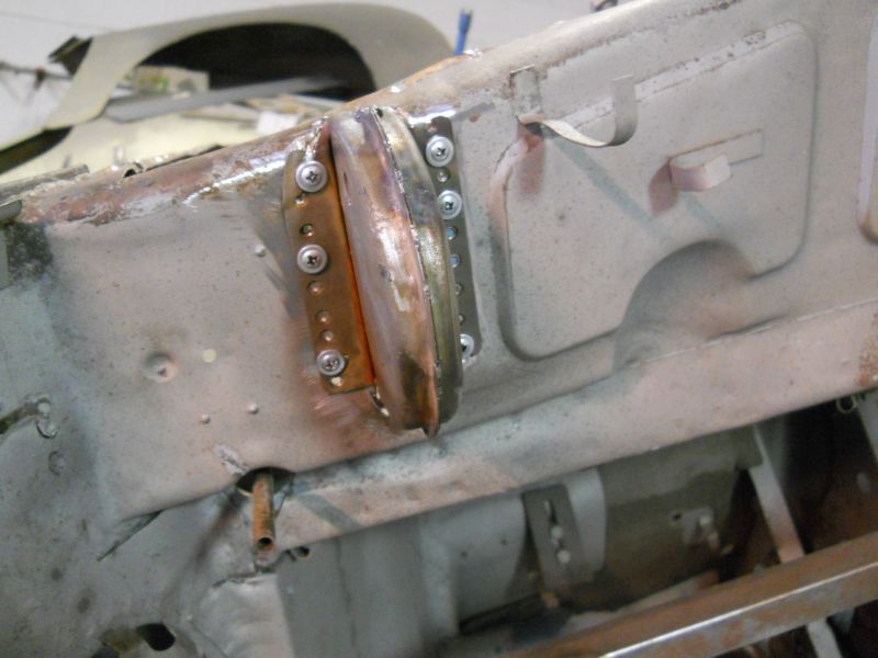

                    Some mild hammer and dolly work required to the closing wall before these could go in. Original spot-welds made for the perfect "locators" to get these positioned back in correctly. Screwed into position here and ready for a tack-weld.
                    Both sides initially mounted with hinges test fitted just to make sure.

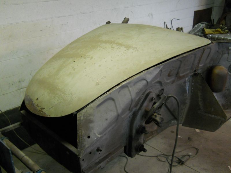

                    No better time then now to mount the hood for its very first initial test fit. This is the "new" donor hood that was purchased for this project. It has a few issues like rust at the nose and a kink on the right hand side.

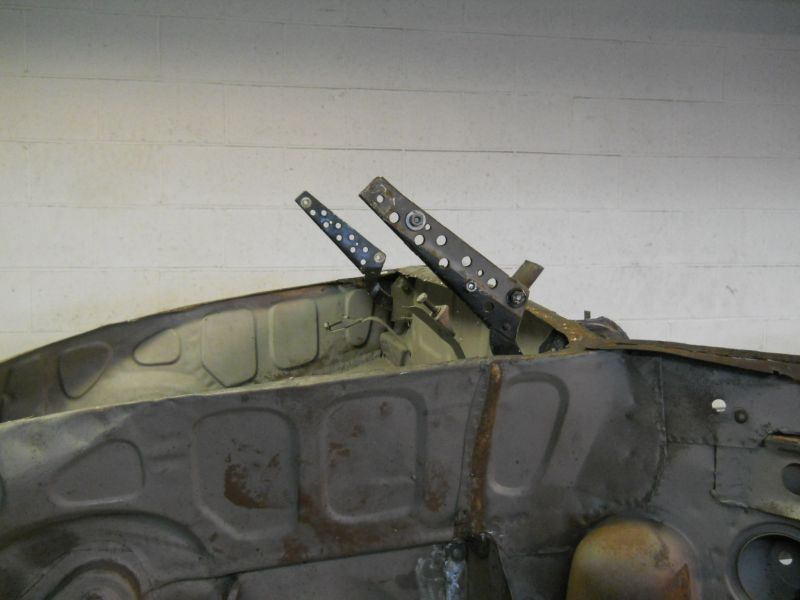

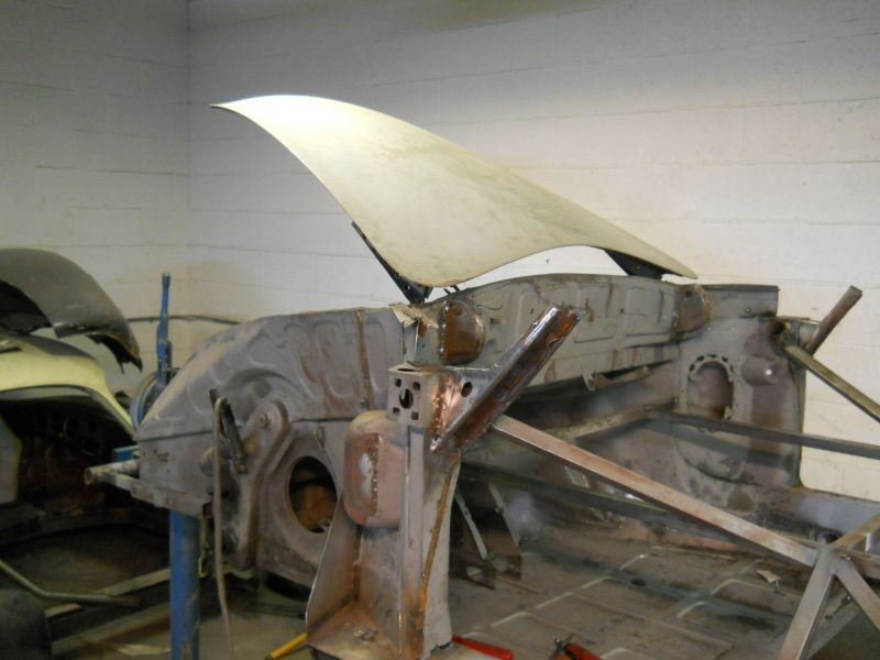

                    "new" hood hinged and mounted for the very first time. Many, many miles yet to come but its a beginning.
                    hood resting in its new open locked "speedster" position.

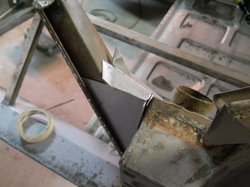

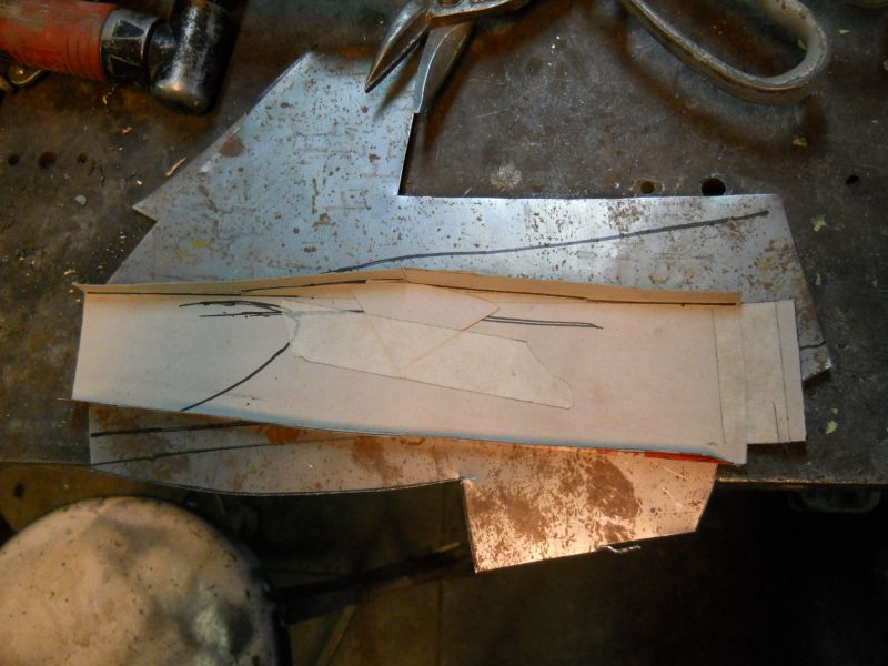

                            Left A pillar closing wall
                            Well, the view from my hood hinge "plateau" was nice but I had to descend down into the valley of the next repair.

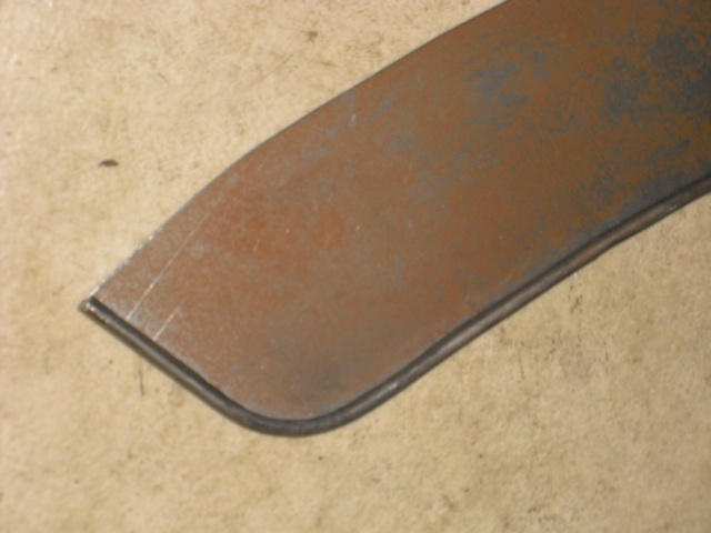

                            Paper template for the new pillar closing panel in process here. Rough drawn the eventual recess mount cup for the Speedster WS frame.
                            The original closing wall wrapped all the way around the edge of pillar frame runner which actually creates the gutter rail as it moves higher. Pealing away the remains of it here.
                            Template close enough and ready to move to steel. The inner flange has a bowed profile that had to be replicated so it will mount flush with the inner pillar shape.
                            New section in for its initial fitting.
                            Going to try an have the new section wrap around the outer pillar gutter flange as originally. Working on that next.

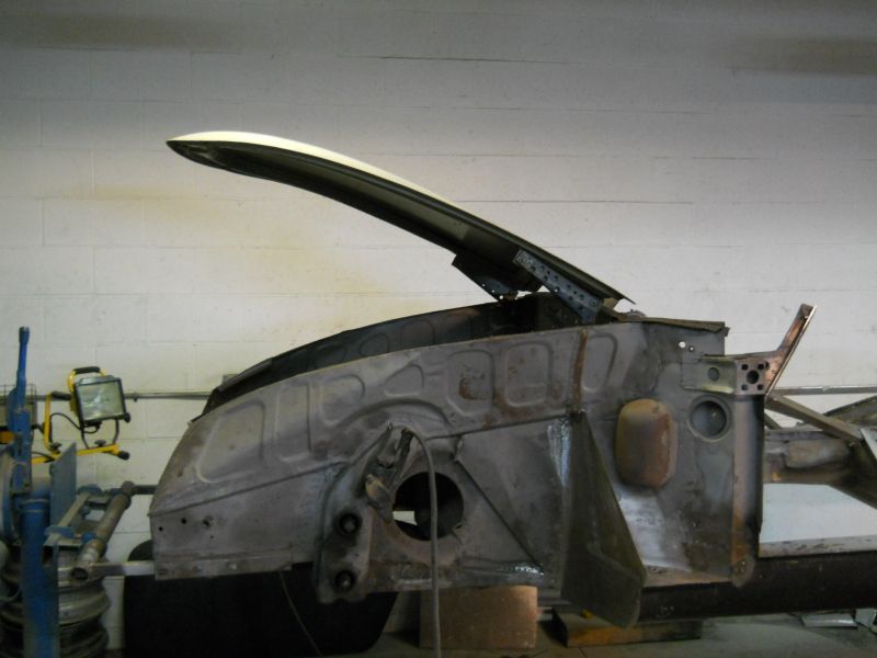

                            • 7/18/14
                              Left A-pillar closing wall continued.
                              A nice thing about the pillar runner being made from heavy gauge is that it doubled as my hammer form to heel this edge over.
                              As far as I can go for now. Will pinch it closed once this wall goes on for good. A lot of things yet to do before that can happen.
