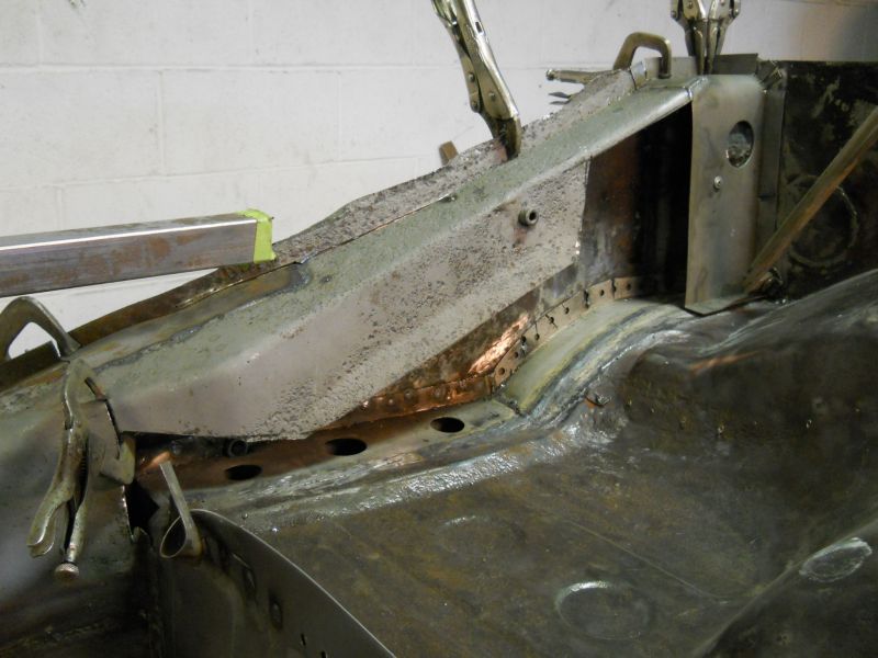

          Right side inner frame section repair begins
          I need to replace part of the top section right before this cut line but I needed to know if I had to go past it to remove more un-savable rot. Removal of the old mount flanges for the triangular reinforcements was next to determine how solid the rest of this was.

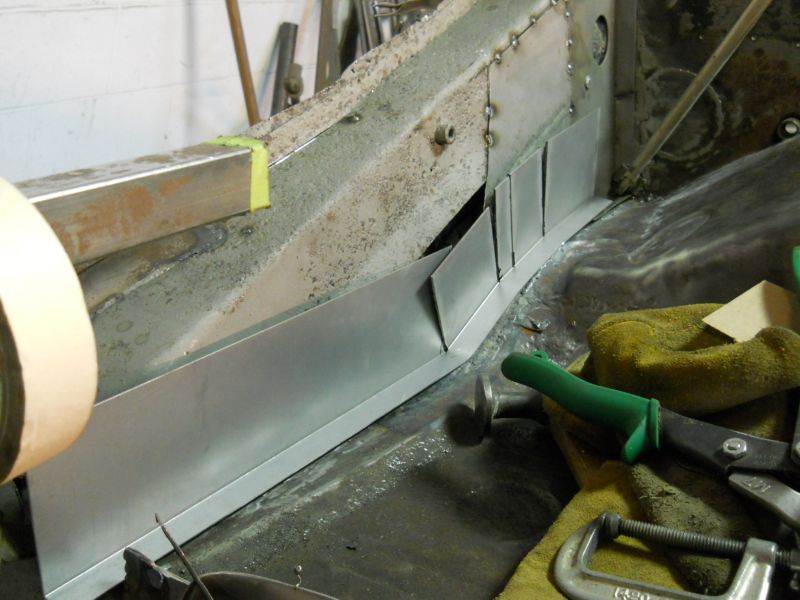

          Other than a few holes that need filing it was in surprisingly good shape so the patch will just need to go up to this cut line.

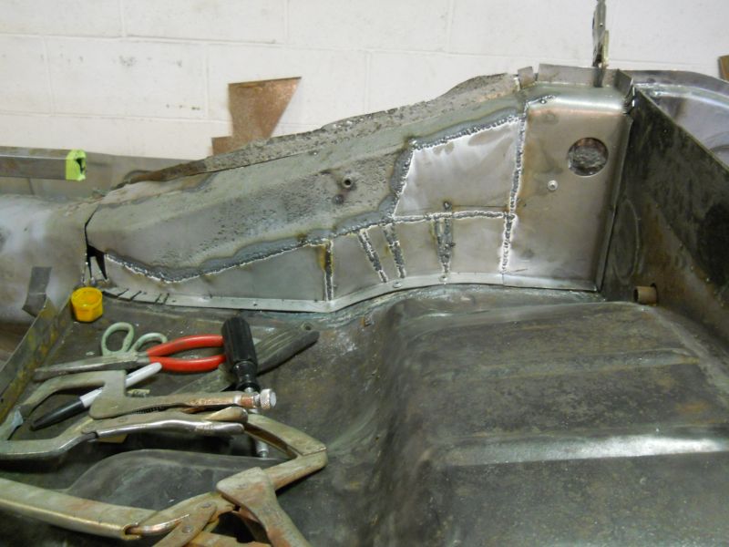

          New section welded on. Really won't be too much left of this side once I'm finished.

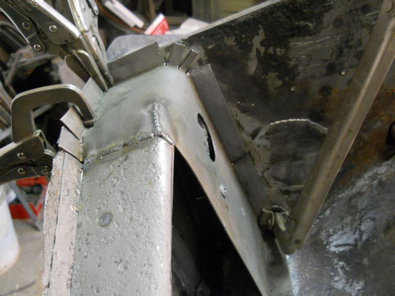

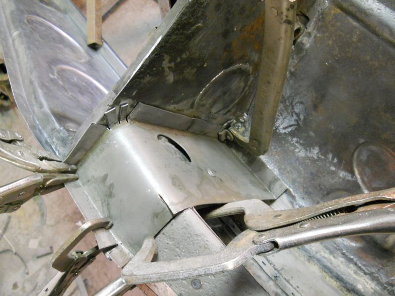

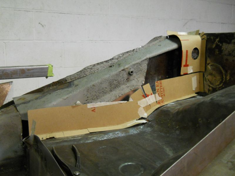

          Flipped my templates over from the other side for a good jumpstart on the new template. Continuing on tomorrow. Thannks for looking! Justin

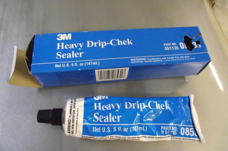

          • Always good to save the paper patterns . 3M heavy drip check? Is that basically a brushable seam sealer? Or are you using it out of caulk tube? Or both?

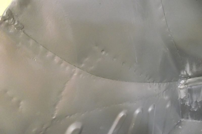

              • Mark, here is the 3M heavy drip check I use:
                Comes in a tube with a small applicator tip.
                This splash pan joint along with everywhere else under here has been sealed in it then painted over. This stuff shrinks up nicely into the joint once it cures. I don't like the brushable sealers for exactly the reason you spoke about earlier; it looks like your trying to camouflage sub-par metal work.

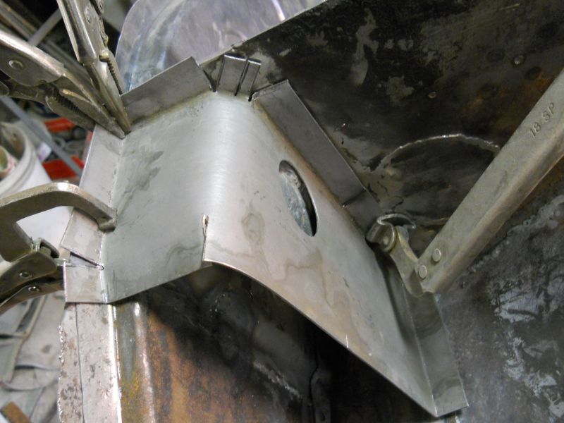

                      Right side closing section continued
                      New repair corner clamped flush with the rest of the relief cuts added to get the final shape and contour. Rear flange was also step relieved to make way for the anchor plate flange.

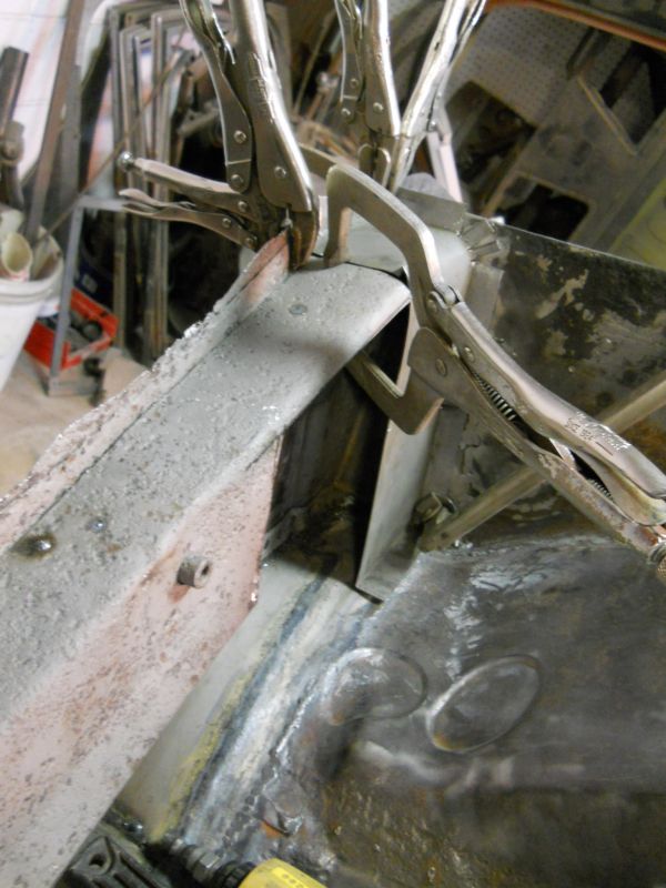

                      Before making the cut I used about every clamp I had. I wasn't taking any chance of poor alignment like I went through on the left side because I got lazy.

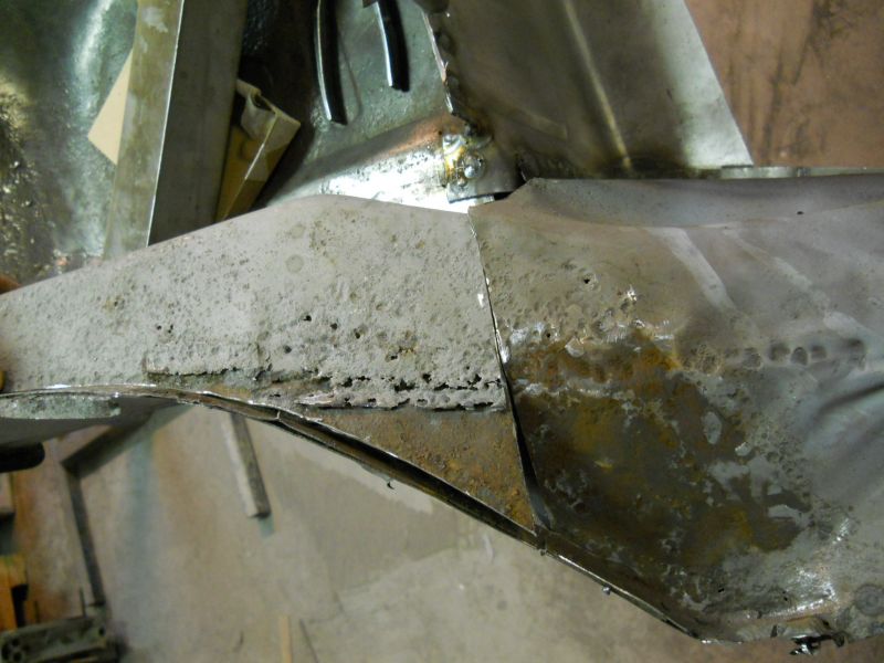

                      trimmed back the old section to get rid of as much pitted metal as possible.

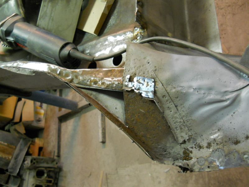

                      new and old joined with excess corner flap cut and welded like the left side earlier.

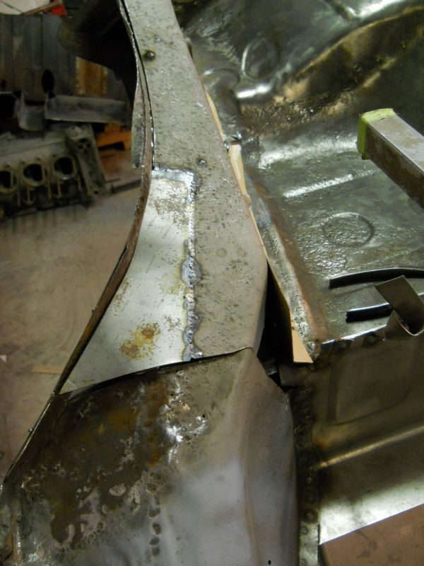

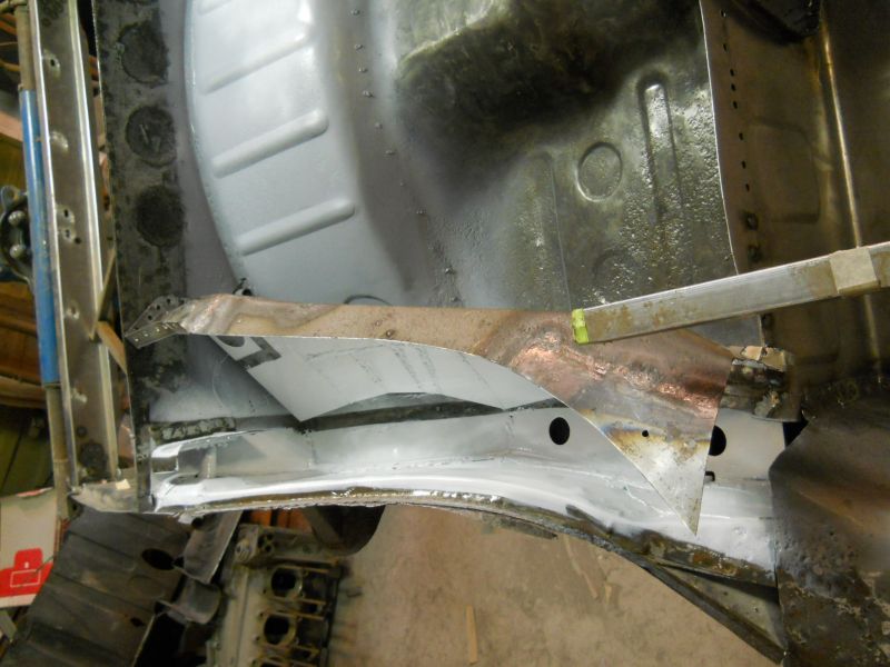

                      This nasty old part instantly became more "viable" once I hooked it onto that new rear corner.
                      New center patch tacked in and working on the lower flange section now. Thanks for looking!! Justin

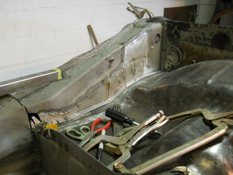

                        Right side repair sections almost complete.

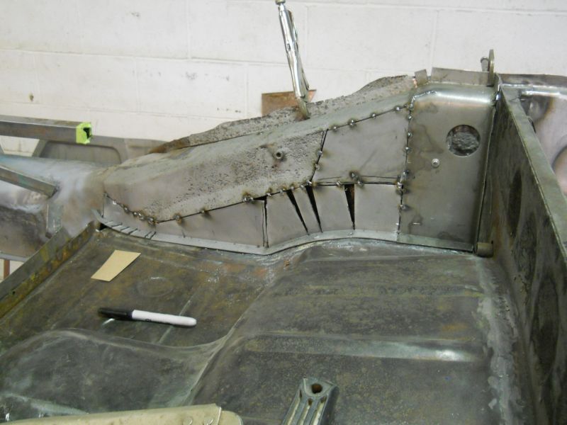

                        Final trim and all tacked together now. A lot of test fits and double checking to make sure I didn't come up short like on the left flange before I committed to these final cuts.
                        Spent a solid session spent stitching it all together and filling the pie cut gaps.
                        I test fitted throughout this process as well to make sure it didn't change shape too much. A bit more tweaking on the forward corner to get the correct contour but I'll have this piece in for good before the weekend is out. Thanks for stopping by! Justin

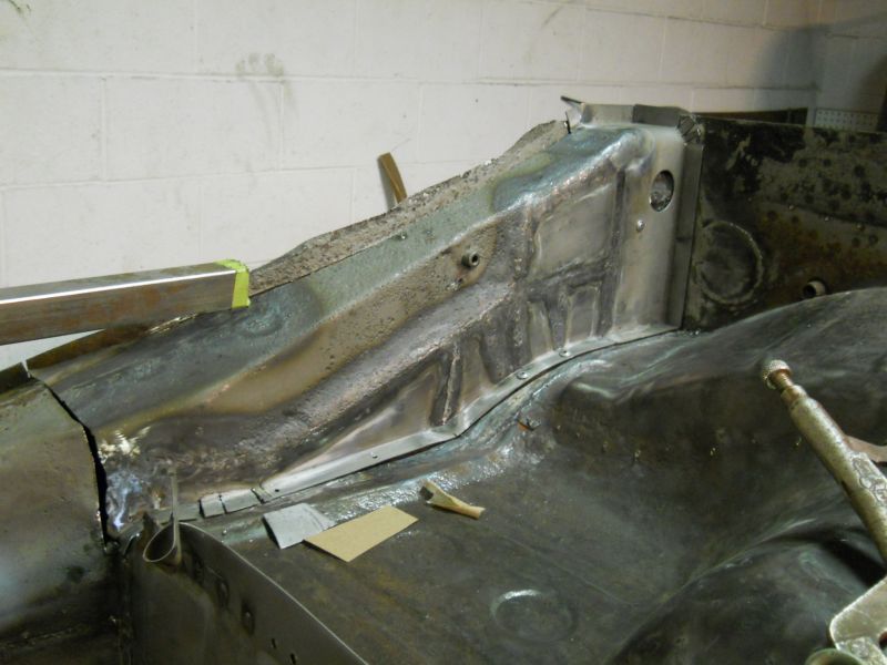

                            All the heavy repairs to this piece are finally complete. tomorrow will be spent prepping the cavity for paint and punching holes in the flanges for the plug welds. If I get lucky I may get it tacked in before the day is through. BTW with all the heat and hammer work that forward gap opened up on me; just when I thought I was going to avoid that problem on this side. At least its a short run so it won't be too much trouble to correct. Thanks for looking! Justin

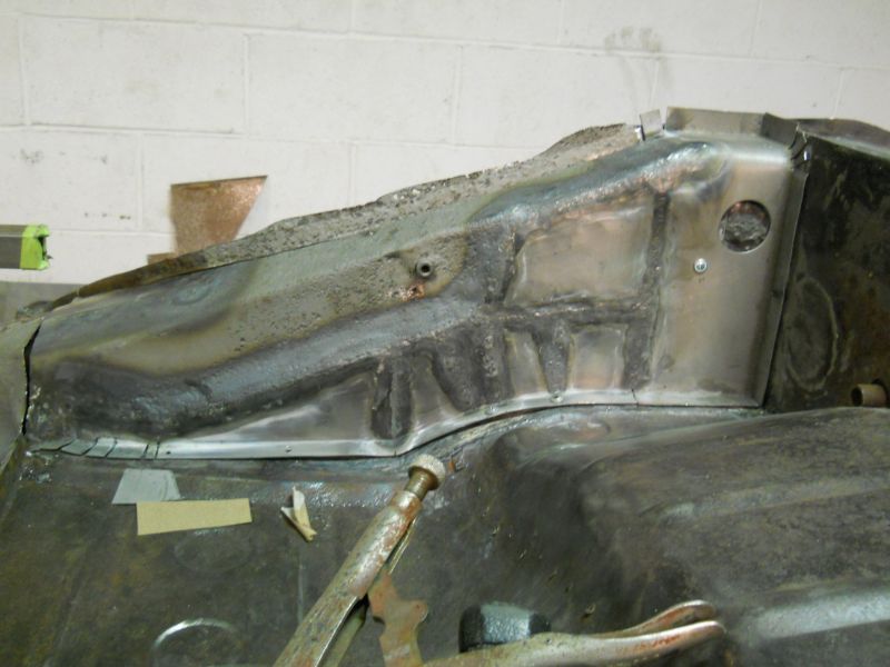

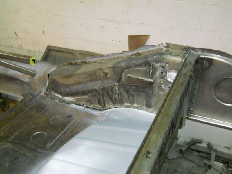

                              Right side closing panel in!
                              A lot of loose ends had to be tied up making for a very long day but before it was over the panel was in for good.

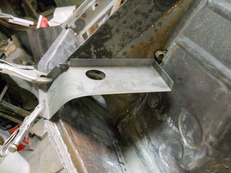

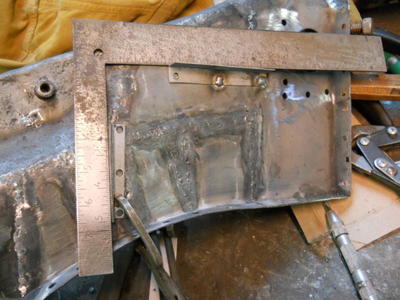

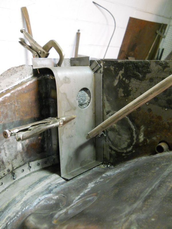

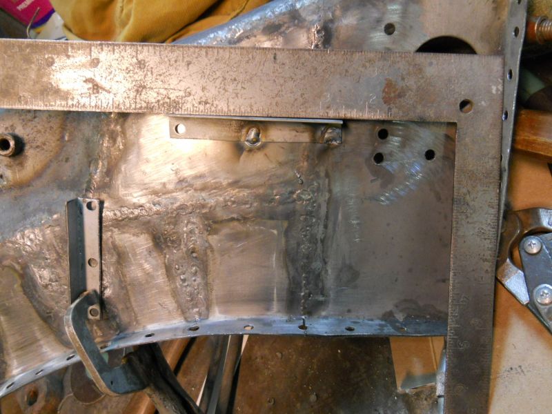

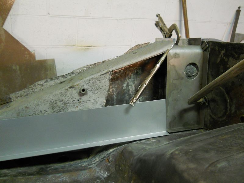

                              These mount brackets for the parcel shelf was one of them. Since this was rusted out past the old ones a had no reference like I did on the left side. After taking some measurements I was able to locate them correctly. Squaring the top bracket to the rear flange.
                              Then squaring the side to the top bracket.

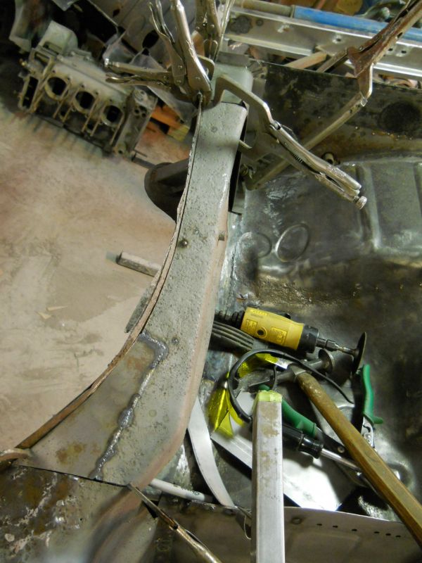

                              At days end I was finally able to begin clamping for its final fitment. Being that more of this side was replaced and heated it did fight me a bit more than the other side.

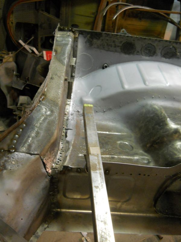

                              Working my way from the corner once again I began running screws into the flanges and slowly worked forward.
                              Once this is welded up I'll finish the leading seam on the forward vertical wall/seat pan and begin the parcel shelf. I'm almost done back here! What an involved project this was! Thanks for stopping by! Justin
