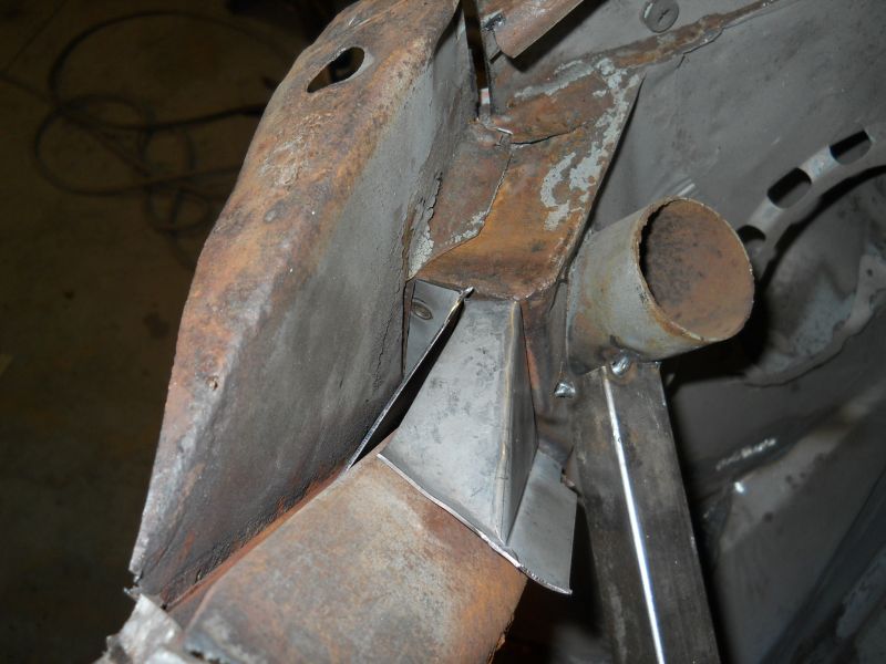

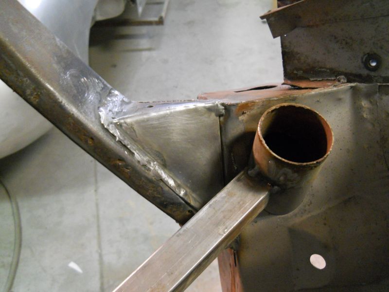

    I assume this is at least not a Michigan car. Imagine the extra rust beyond what you have if so. The gusset seems like a good idea. Keep thinking.
    • Ya, i agree, the gusset is a good idea.

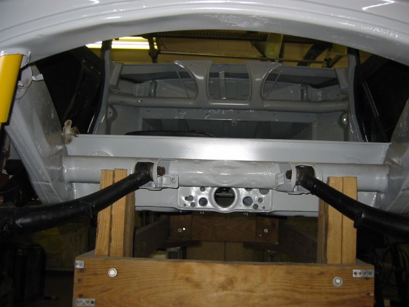

              I must get all the '52-to-rat-rod pictures organized. Maybe they could be of some help? We made the tunnel due to the weakness of the '52, which was bought after having been dipped. The donor car for the rear tube, etc, did give us the innards of tunnel and shifter, rear suspension and torsion tube. Glad to have the chassis jig and rotisserie, both of which got some adaptation modification from being for 'merely a 356.'

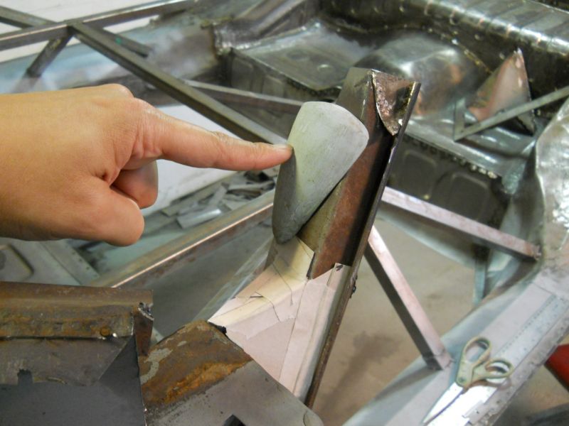

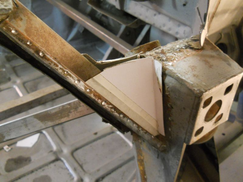

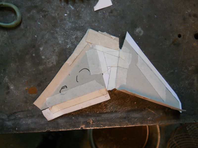

                  Paper template development begins.

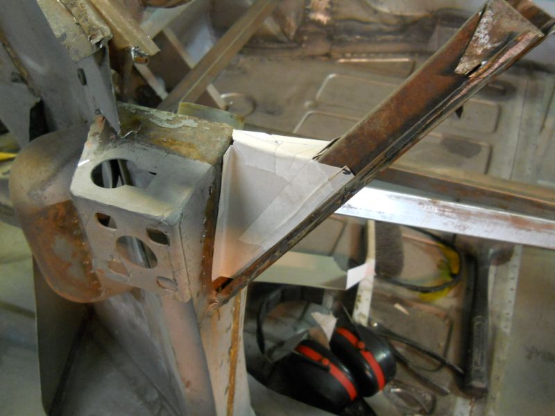

                  A very complex-compound angular shape so a lot of splicing and a lot of masking tape required.

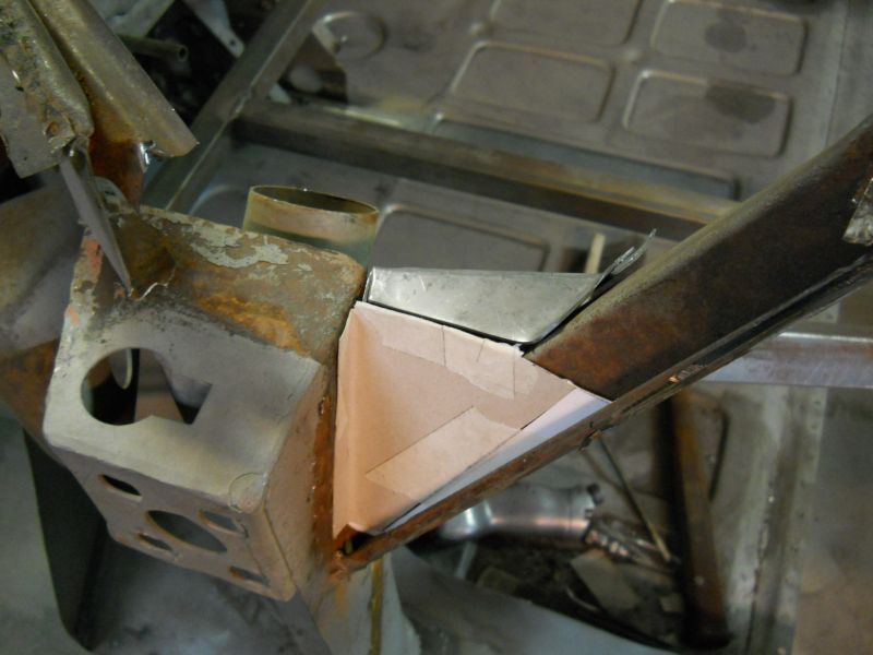

                  A very rough guestimation on the eventual relief cup position but it looks like the tip will just begin at the gusset.

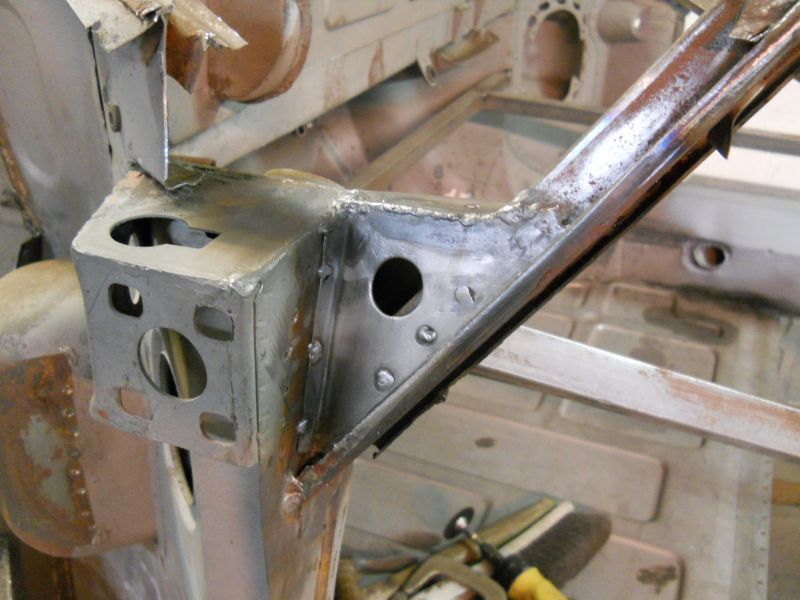

                  Basic shape here though some fine fitment still to come. Once the new dash is mounted and this area is in correct flat-black this addition will be hard to detect and most likely go unnoticed. I thought about punching some holes in to lighten it but that would only draw attention to it so I'll save that treatment for my coupster.

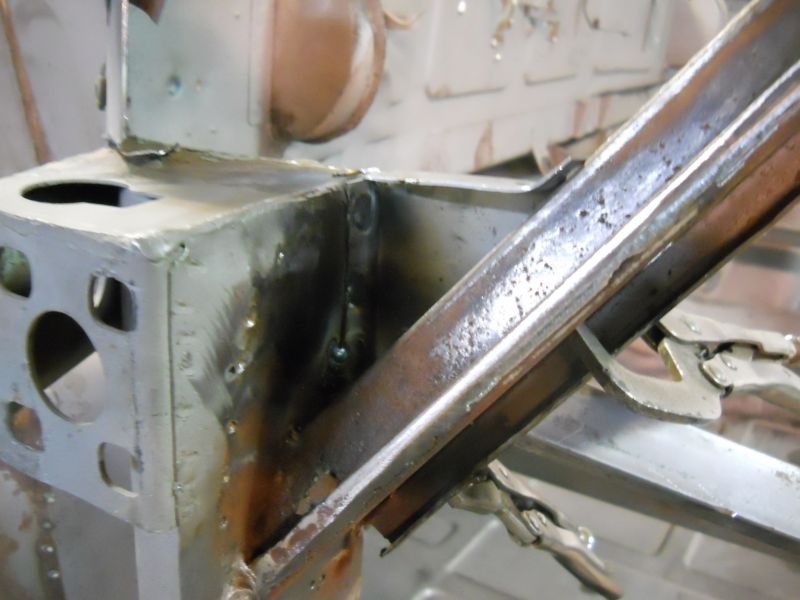

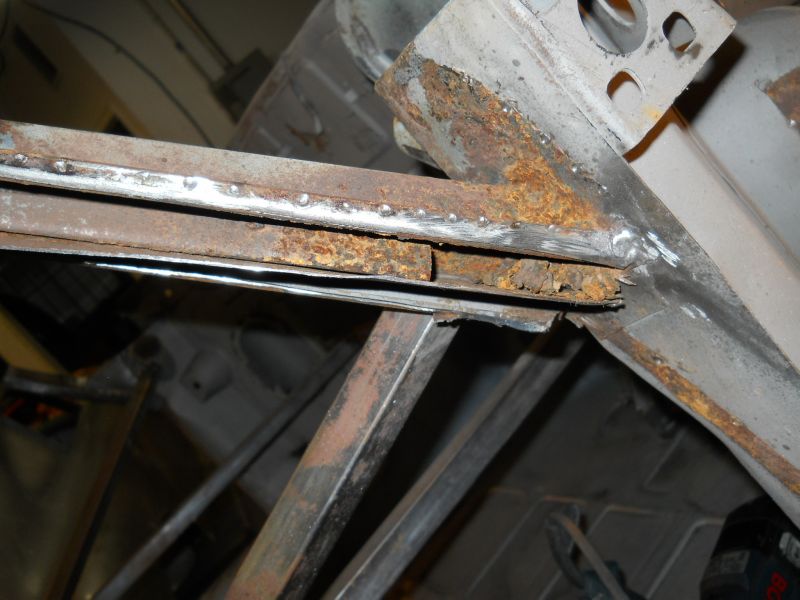

                  • 7/6/14
                    Left A-pillar gusset complete.
                    Began welding in the outer section first so I could get to the plug-welds on this inner flange before I boxed it up.
                    Plug and seam welded the outer flanges. A lot of extra time was taken to ensure the pillar did not move during this install phase.
                    Could not get a clean shot at the very bottom here due to the support Jig. It won't be a problem as it can be finished up at anytime down the road.

                    • Nice work Justin! That access/lightening hole looks factory.
                      • I cease to be amazed by your work Justin. Hope I'm still around when this is finished. Curious, is there any issues with Speedster windshield cracking due to flexing of the frame? My old 100-4 Healey sure had a problem with that with the "high speed position" feature.
                        • Thanks Don! I wanted to add a hole to the other side too but I don't want to draw any attention to this "unauthorized" gusset.

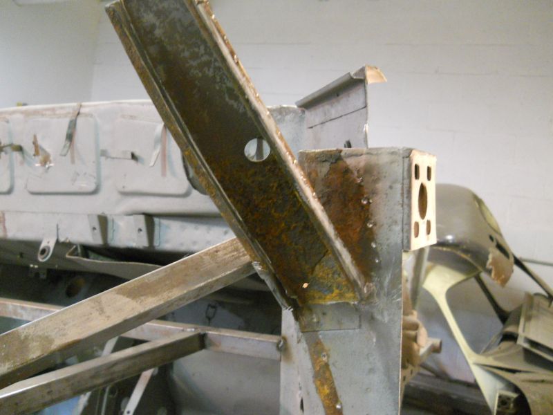

                          Right A-pillar prep.
                          All stripped down this afternoon.

                          Peeling off the outer face plate to reveal almost identical conditions.
                          Lots of water spent time in here to produce lots of scale.

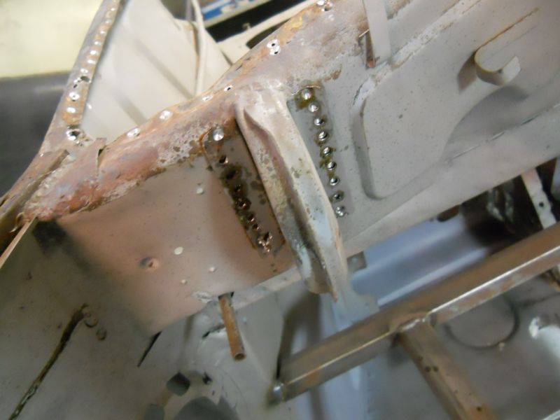

                          • 7/7/14
                            First official Speedster specific change over to this old coupe chassis.
                            A very Subtle detail difference between coupe and Speedster is the height at which the hoods rest in the open locked position. I was made aware of this difference several years ago by my good friend Ric Marcus.
                            This vintage assembly line photo courtesy of Bruce Baker clearly illustrates the difference between the two. I understand that this change was made to the speedster to remedy the back edge of the hood colliding with the windshield wipers to unlock the hinges. The hinges needed to disengage sooner so the locking spur mount hole was lowered and in turn lowered its open resting position.
                            To recreate this detail full removal of the hinge bosses was of course necessary.

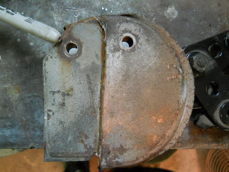

                            Spent the last part of today's session drilling out the 20+ spot-welds and the gas welds at the top and bottom.
                            With the housing free you can see the pen pointing to the locking mechanism hole that needs lowering.
                            It is this spur that bolts into this hole.
                            This conversion is of course not going to be as simple as redrilling the hole. As you can see above both sides have an inner reinforcement plate that needs to be cut free and repositioned.
                            To get at those plates requires that the hinge boss come apart. I suspect that this hole only needs to be moved its width downward. I'll get some measurements from my friends speedster before the week is out. Anyway it can't be much. This might be a silly detail to chase by some but I think if you're going to sacrifice a real 356 chassis these days you better go all the way! IMHO. No "skunkwagons"!
                            Thanks for looking! Justin
