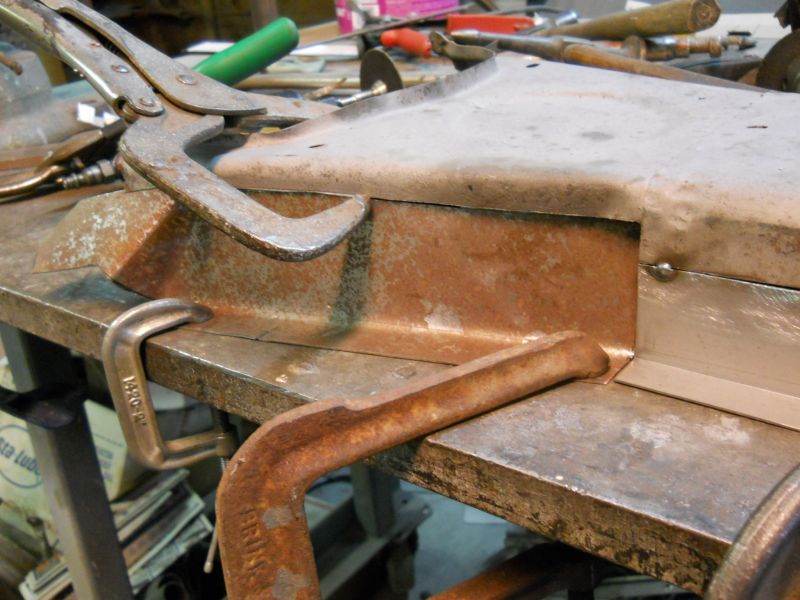

          First new section cut to final height, clamped and about ready for a tack weld.

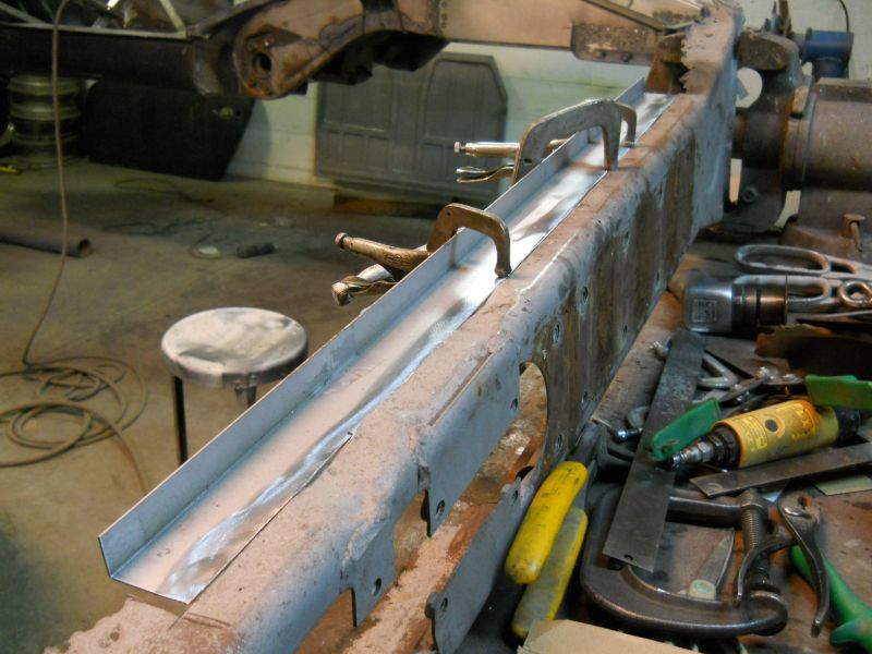

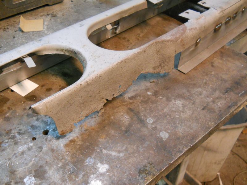

          Since the original lower flanges of that tunnel are completely gone I had to reference the one in my coupe. It was a bit tricky to finally establish the correct overall height for the rusty one. The measurements would vary ever so slightly across this run so I took the best average measurement and went with that.

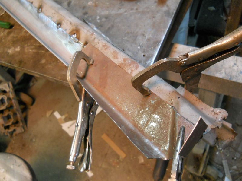

          New section tacked on here and of course all the original lap joints will be replicated.
          Very straight forward from here now that the replacement flange height has been established with this new piece. All I need to do now is keep the rest of the sections level and square with this one. This part looked like pure junk to me yesterday but an amazing transformation happened the second this new section was glued on; feeling much more hopeful about it now. More tomorrow. Thanks for stopping by! Justin

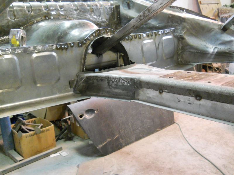

                  Piece tacked and the tunnel in for its first test fit.
                  So far so good...

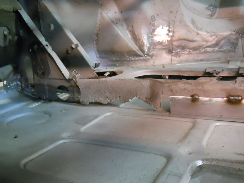

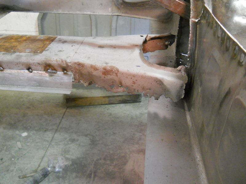

                  This left side forward section requires a bit more shaping work due to the gas pedal and foot recess for the driver. oh yea, got the main left side flange repair section tacked on too.
                  A quick look at my coupes original shows how it was done. (I would be sunk without this car for reference) Notice that the mounting flange is considerably wider along this recessed area; More support I assume. I'll go ahead and replicate this detail as well.

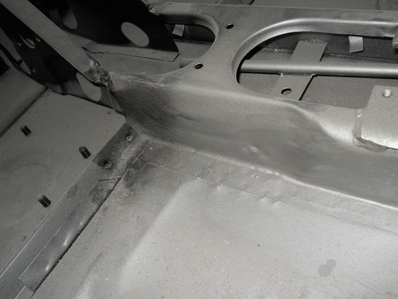

                    so nice to have this section all welded up an finished.
                    Finishing out the remaining flange repair sections tomorrow. Thanks for stopping by! Justin

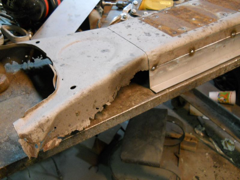

                        Rearward flange repair section.
                        Turns out I have a bit more shaping repair to do other than that last forward section I just finished.

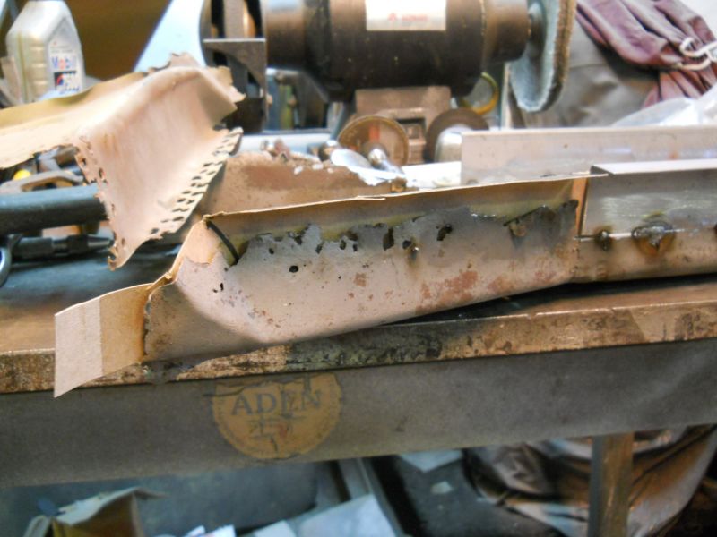

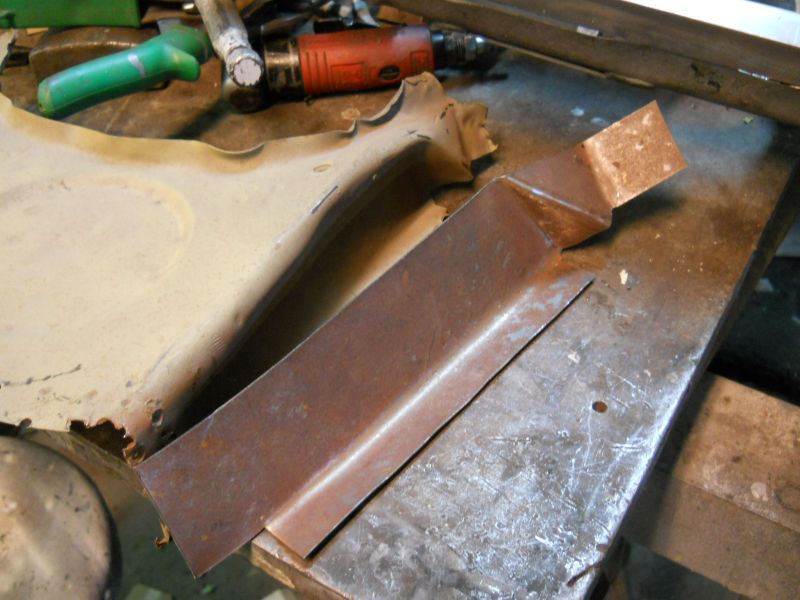

                        The triangulated bent tips at the end are another detail I'd have to copy. Thankfully I have this original out of my coupster project floating around loose.
                        Cardboard template in for a final fit before moving onto metal.

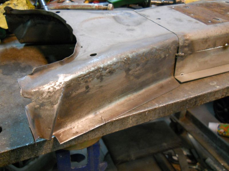

                        In metal. For this section I went with 20 gauge as the original is closer to this thickness and its a lot easier to shape. You'll notice the bend for the mount flange is much less sharp than the forward sections.
                        Test fitment before final trimming.

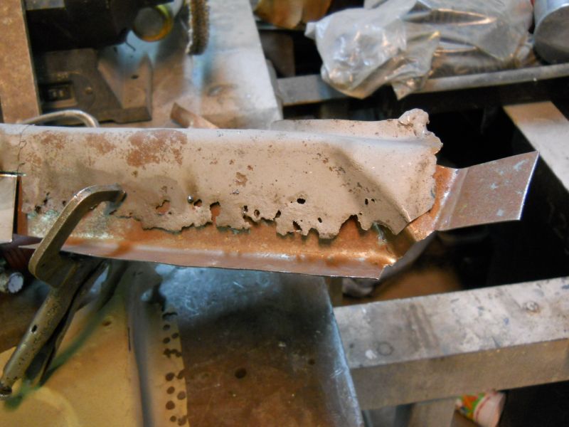

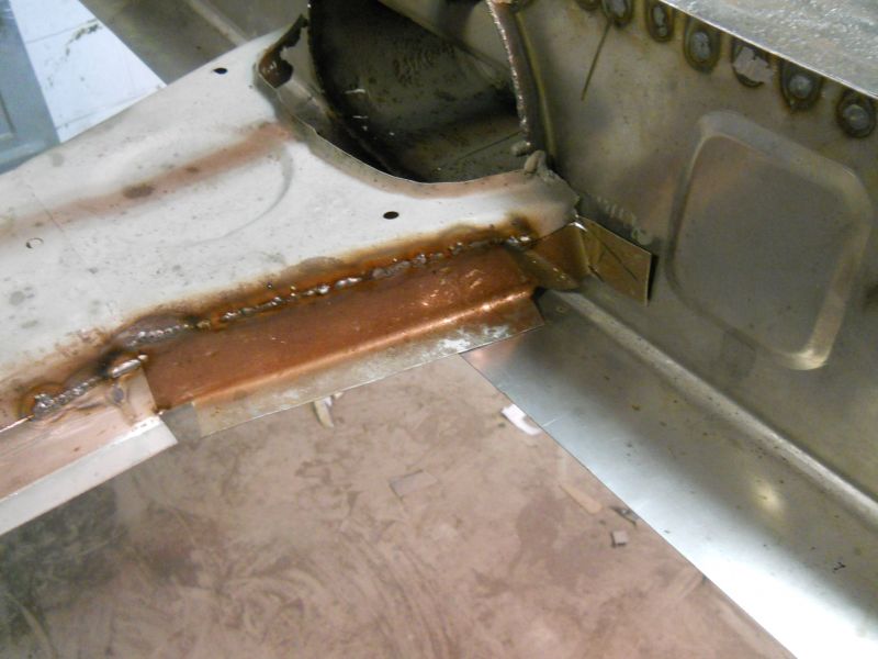

                        New section trimmed and am now establishing the cut line on the tunnel.
                        Welding almost complete but in for a mock up. I cut the bottom flange a bit short but will correct it before its over. Moving on to make the right side tomorrow. Thanks for looking! Justin

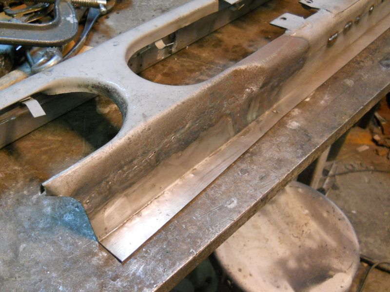

                            Fully welded and finished section
                            In for another test fit.

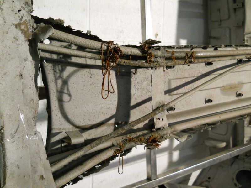

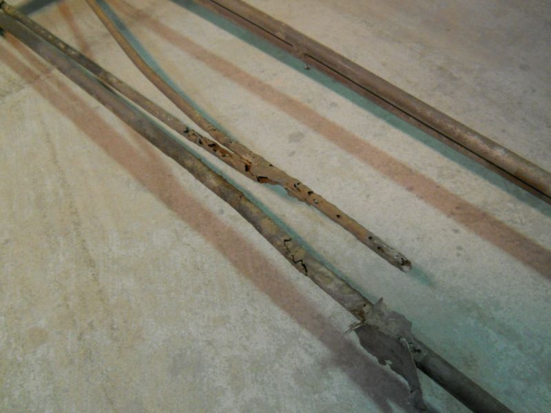

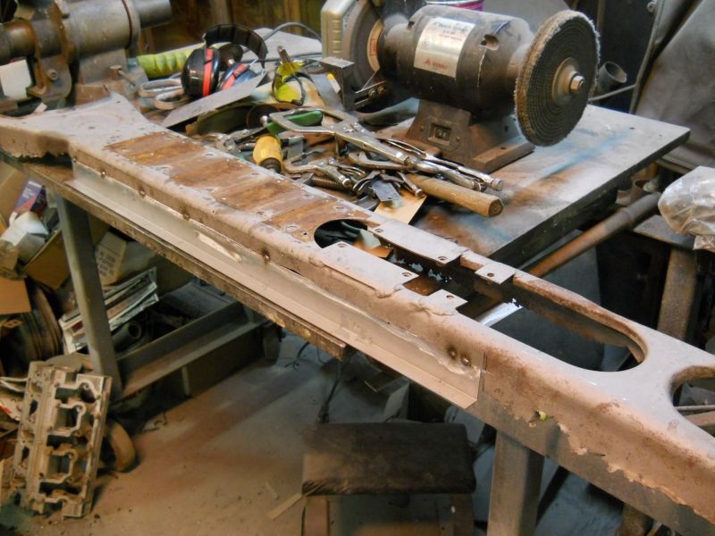

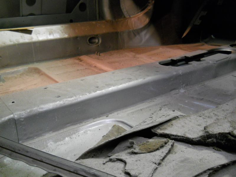

                            Up next will be to fabricate new tunnel conduits for the clutch, heater and Parking brake cables.
                            As you can see these are shot as well.
                            When I slid the cables out these worms of grease exposed breaches everywhere. Thanks for looking! Justin
