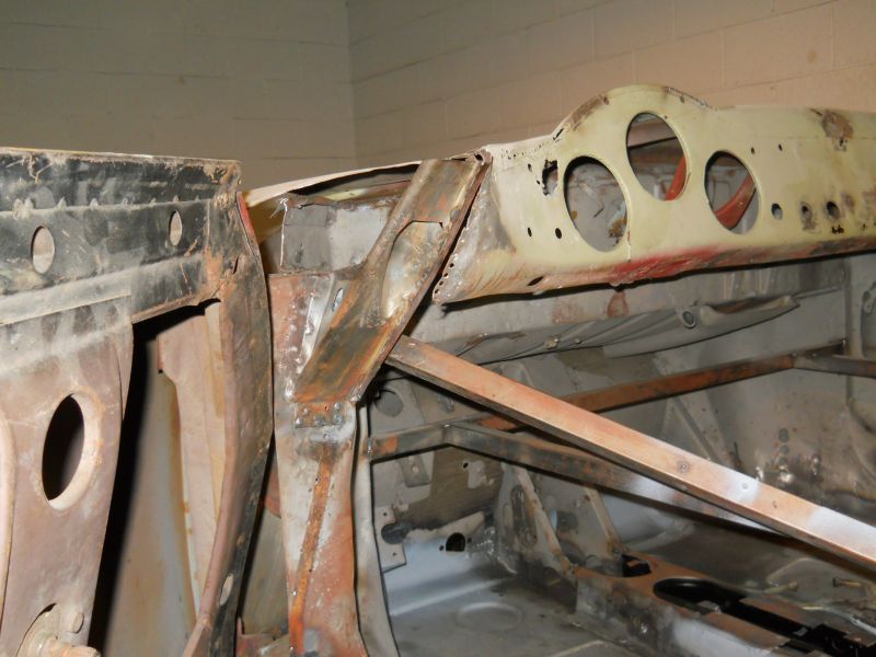

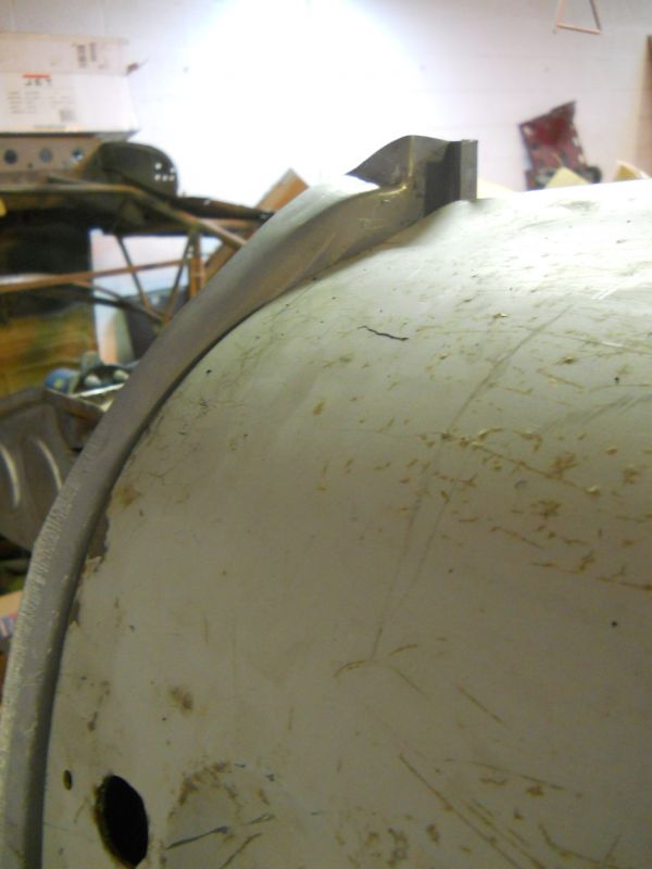

            Left striker post conversion
            Spent most of today's session on the learning curve. The right side will of course go quicker and cleaner but I had to start somewhere.

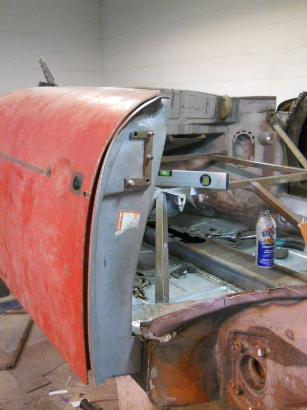

            Time was needed to figure when and where to cut and bend.

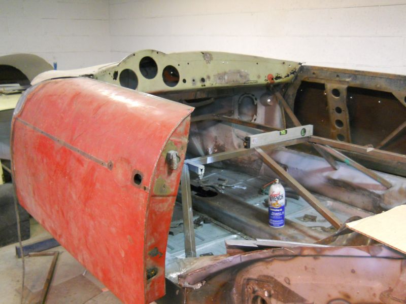

            Initial cutting and contouring where very promising in relation to the doors profile.

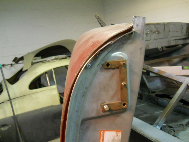

            as the repeated test fits went there was a bit of slippage discrepancy and it finally occurred to me to drill and mount the striker plate and plug it into the door's latch for an accurate fit. Again this was part of the learning curve today.

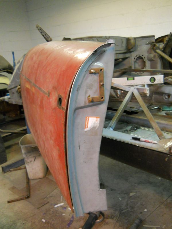

            Aside form the getting the outer door profile to match it was equally important to make sure the seal channel profile was running consistent along the backside as well.
            Getting better but more shaping was still ahead.
            Just about there and almost ready to reinstall the flange section I cut away earlier.

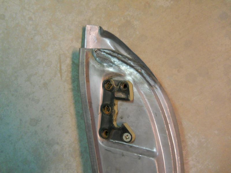

            Shaped and welded.

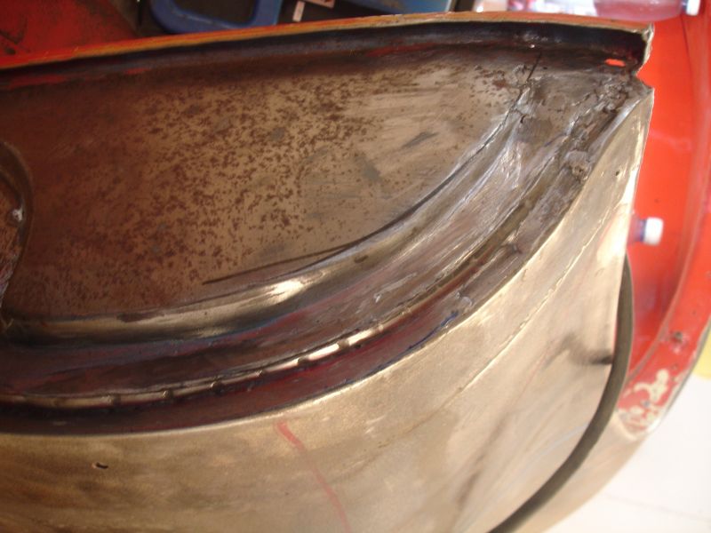

            Fine finishing yet to do and I'm guessing it may need more contouring once I begin fitting the quarter panel but will cross that bridge when I get to it.
            It now runs to the inside of the door's edge allowing for height adjustment for the eventual body skin.

            • Justin, that was good of you to use the door as a "die" for getting your lockposts right.
              But the again you dont have any original lines to use as a guide when doing your "new" porsche

              • Difficult job Justin. I would think you feel much safer with that alignment frame securely in place like you show. Those who go this far into things could well come a cropper without one. Nice photo's. Aside from this, in the mid 70's my brother was still driving his 51 with RHD conversion. The dash panel was LHD. He went to AFN the main Porsche agent where he used to work and would you believe bought the last dashboard a pre-A version RHD ! A few ago we tried to evaluate how Porsche produced a RHD version dashboard considering the low volume and tooling costs. I used to be involved in press toolmaking so asked some questions. Apparently they cut and welded somehow the LHD version some guys even found the weld runs. He bought that item for peanuts and further more they were clearing their stock of panels at the same time to make space!!

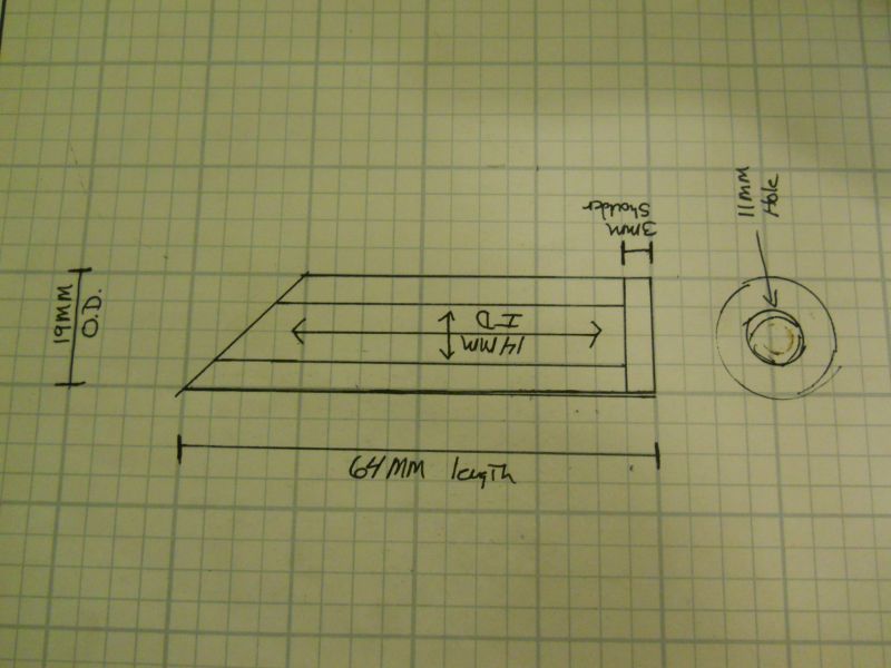

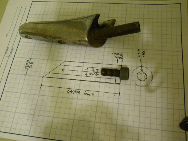

                        Ordering the Speedster windshield post mounts tomorrow.
                        Finished the basic dimension plans for the shank mounts and will drop it by my friend Bill's (machinist) to get these rolling.

                        Not exactly like the original but I want a 3mm shouldered at the base for the bolt to work up against.
                        I'll leave Bill with both parts to ensure it all fits nicely. Especially the top angle cut and the inner dimension for the shank; don't want too snug or too loose. He'll know what I need.
                        Thanks for looking! Justin
                        • Look very closely at the new mount posts and compare to known originals. Last year I had a pair that the post came out of the housing at the wrong angle.

                            • Thanks for the reminder Jack! I have heard about the legendary Stoddard repro WS post's from the 1990's which were built with the wrong post angle and would lay the windshield frame back too far.
                              That's a good question Drew. I haven't thought that far ahead to be honest. Since there is very little to no chance of running across an original frame these days I suppose we'll more than likely be buying the same repro frame that you're thinking about getting. Its not like it was 10 years ago when original frames and or parts of it would be offered up for sale on Ebay or the classifieds on a somewhat regular occasion. Man, there was a time a few years back when I had two complete original speedster windshield frames and one upper frame with its posts. Now I'm down to just the one for my project; which is also the frame I'll be building this car to accept. Projects like ours and the rebirth of a lot of long dead Speedster's has all but dried up the Original parts availability now. If a nice complete original frame were to come up for sale today I could see it commanding a price in the 10-15K range...

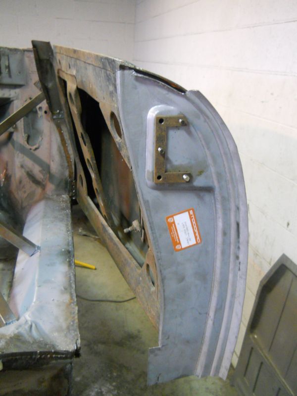

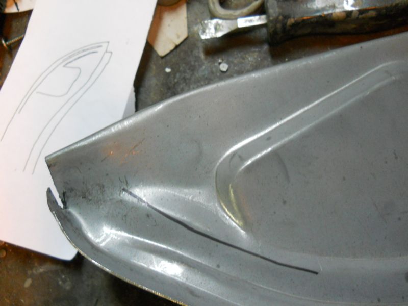

                              Shortly after making that last cut a buddy of mine sent me these photos of a raw NOS speedster lock post. The top outer profile where the skin will attach is much broader than mine at the top.
                              With this new perspective I realized that I had jumped the gun on a committed final shape to the drivers side. It's best for me to stop where I am at now with these and wait until I am actually fitting the quarter panel skins on then I can build that corner radius to suit. That's what I learned today... Justin

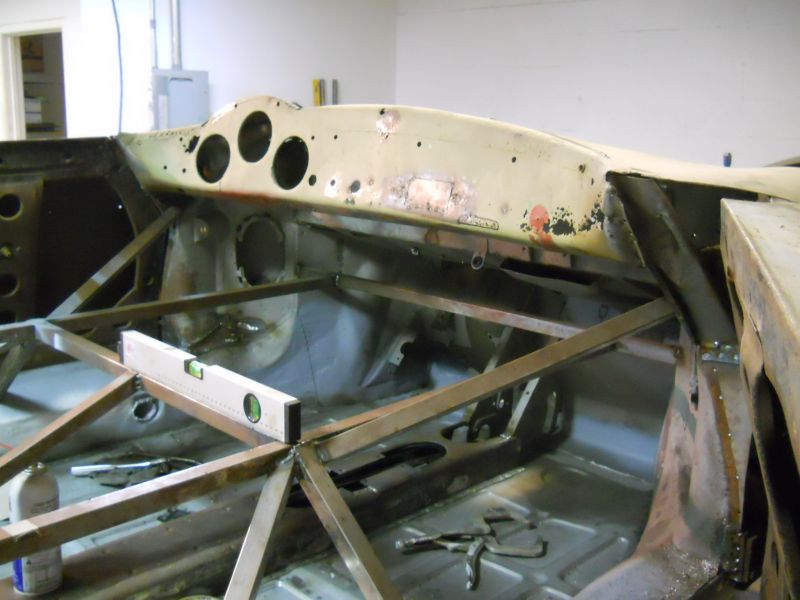

                              • 9/18/14

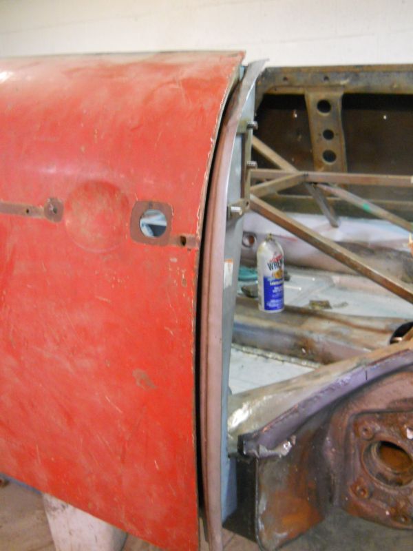

                                Waiting for a shipment of parts so I've been stuck grinding weld heads and other small unpleasantries until they show up. Hopefully tomorrow. I did want to see how the mounted doors were shaping up against an eventual front cowl and dash so I mocked up the original dash I have for my project.
                                More trimming of the A-pillars is required but it seated in about 90%.
                                Liked the line it was taking with the doors so that was at least promising.
