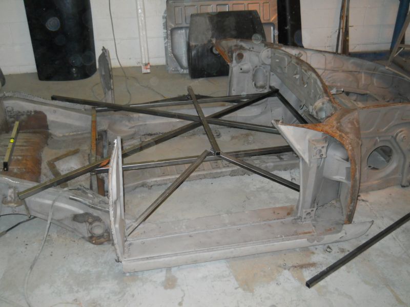

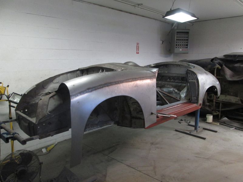

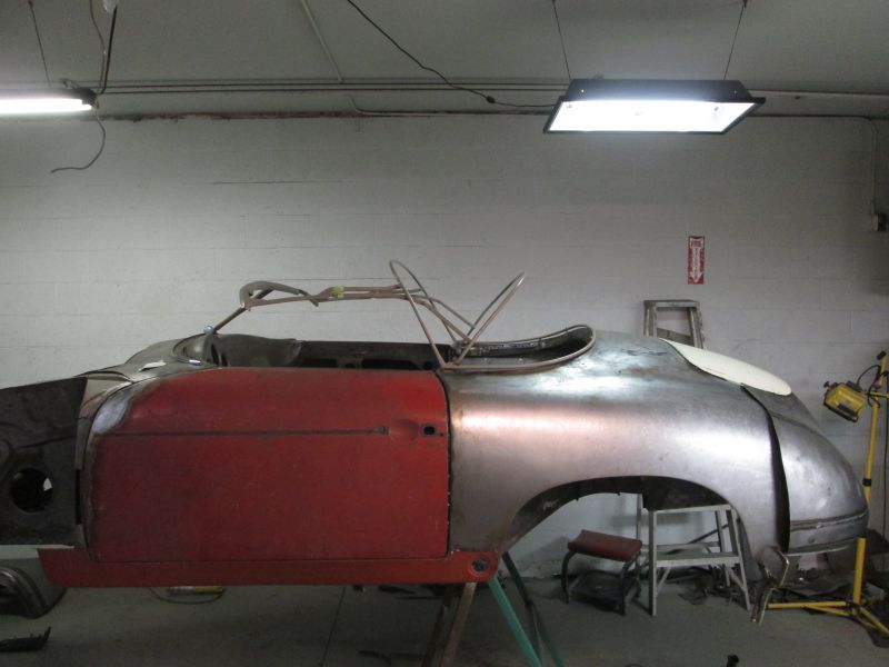

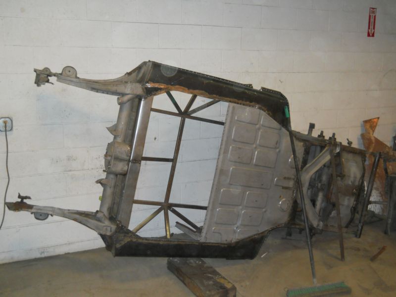

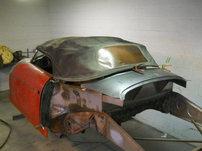

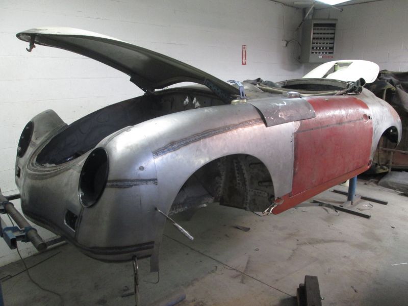

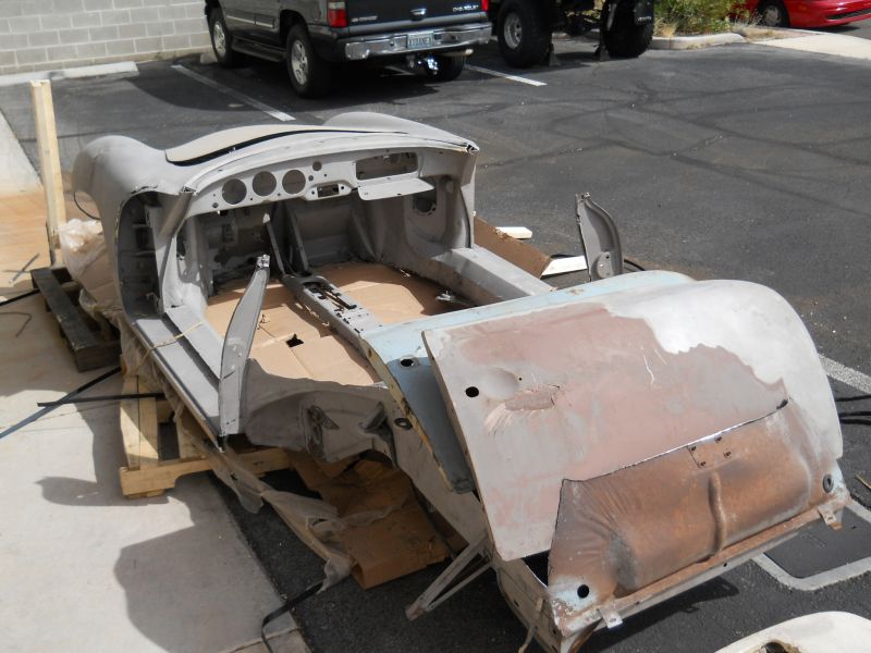

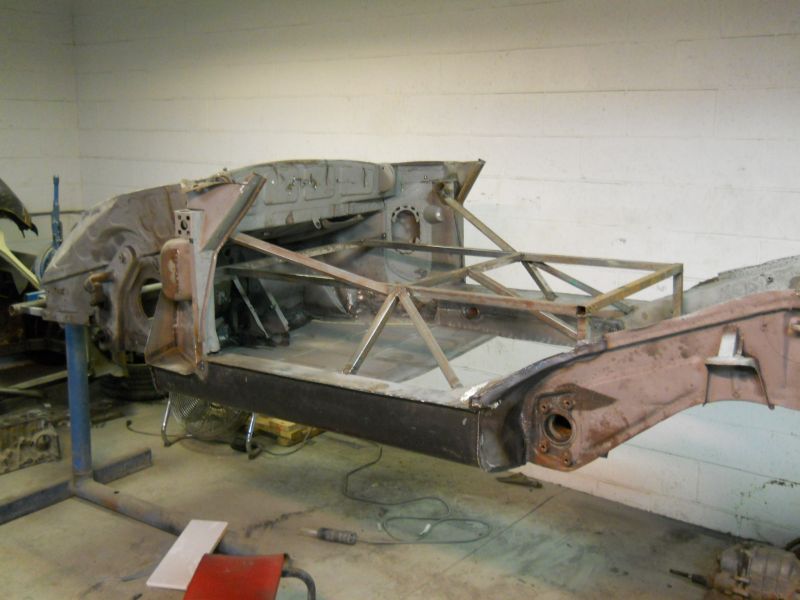

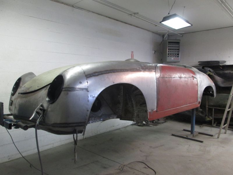

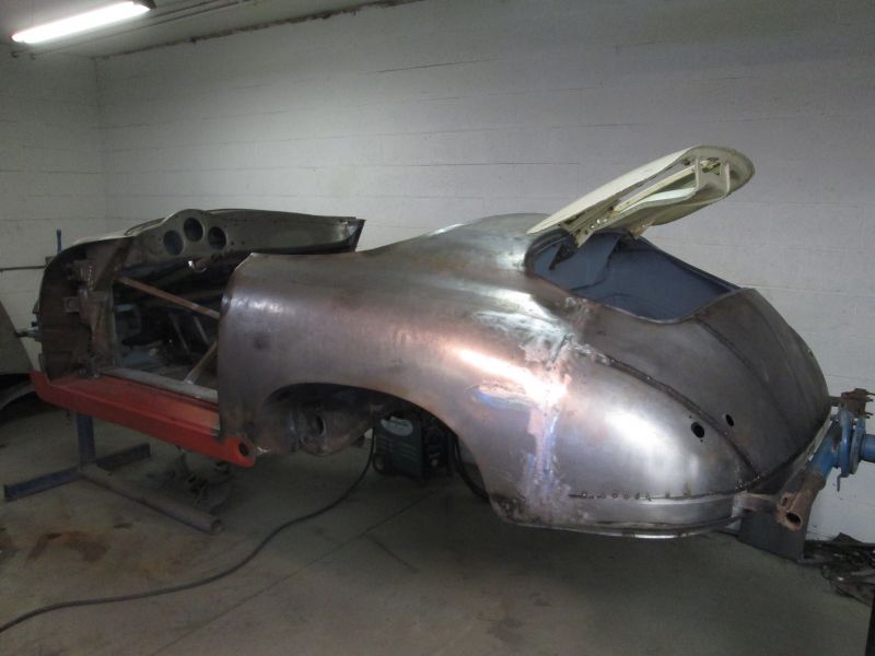

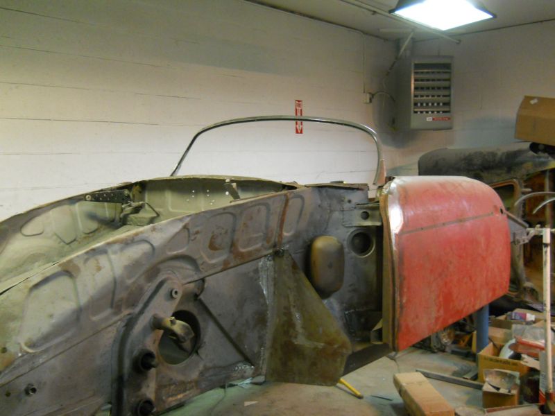

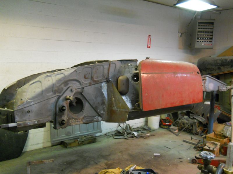

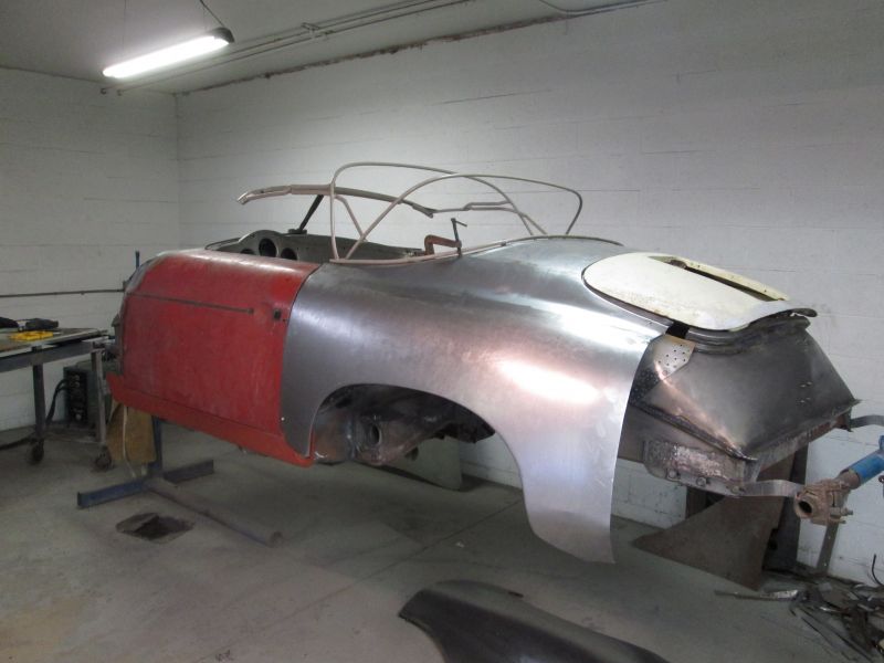

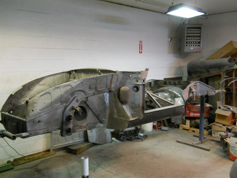

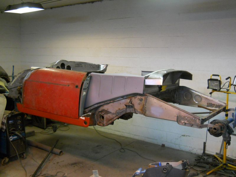

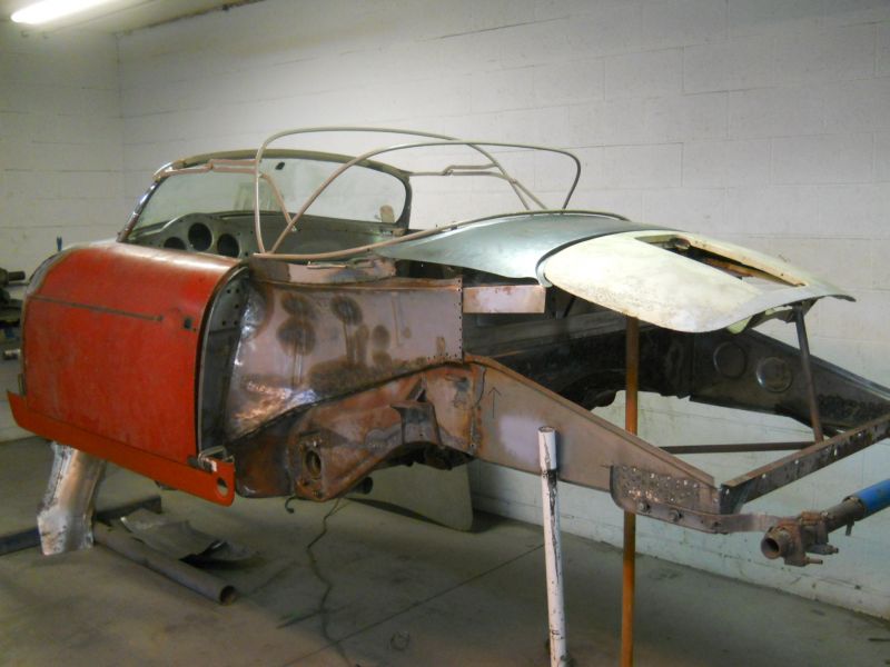

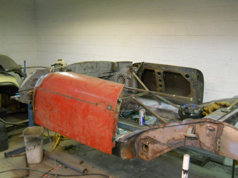

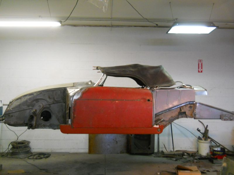

              Easy to forget(or Repress) just how long and rough the journey was so I decided on a condensed "readers digest" photo series since most who visit here are not going to want to pick through all 250 pages of this saga. So below are the highlights or low lights as the case might be. All the work and heartache that went on in between each photo does make my head swim.

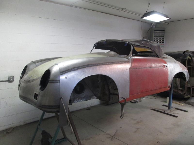

              Really thought I was looking at a Speedster the night I got this door hinged on there. Dreaming for sure...

              Just under 2,200 hours later we had a solid basic Speedster body.
              Thanks again for all the nice words of support you guys!

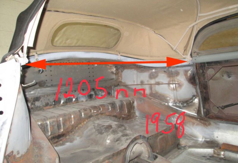

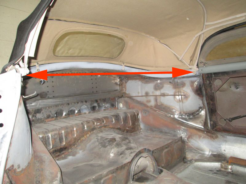

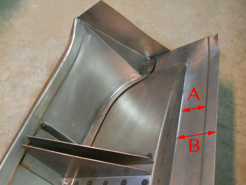

                    If I'm not too late and the coupster is still in your possession, could you take a quick measurement for me.
                    I need to know the distance between the welded plates that have the hood attachment pins in them, as I think it is different to the convertible D dimension.
                    Cheers
                    Drew
                    • Drew,
                      I got 1205 mm between the welded plates.
                      If you need more give me a hint. The 1958 is still sitting in a corner waiting for more TLC

                      • Thank you Per
                        There are a couple more dimensions I need.
                        Cheers
                        Drew
                        • Drew,
                          I got the loong distance B to 70 mm
                          The short A to about 46-47mm
                          I hope it helps you out

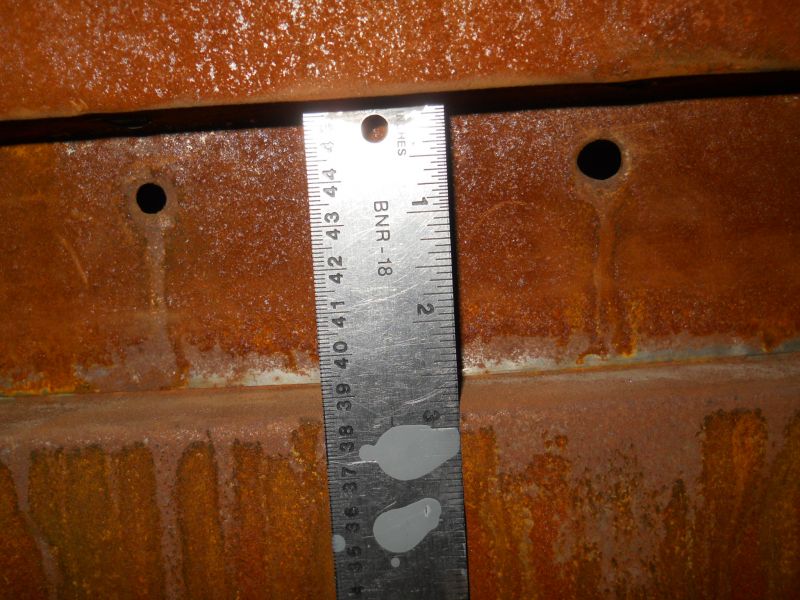

                          • Drew, The car has been gone for well over a week now and sorry for the late response but Here's that distance on the Original Speedster referrence car. Sorry its in inches
