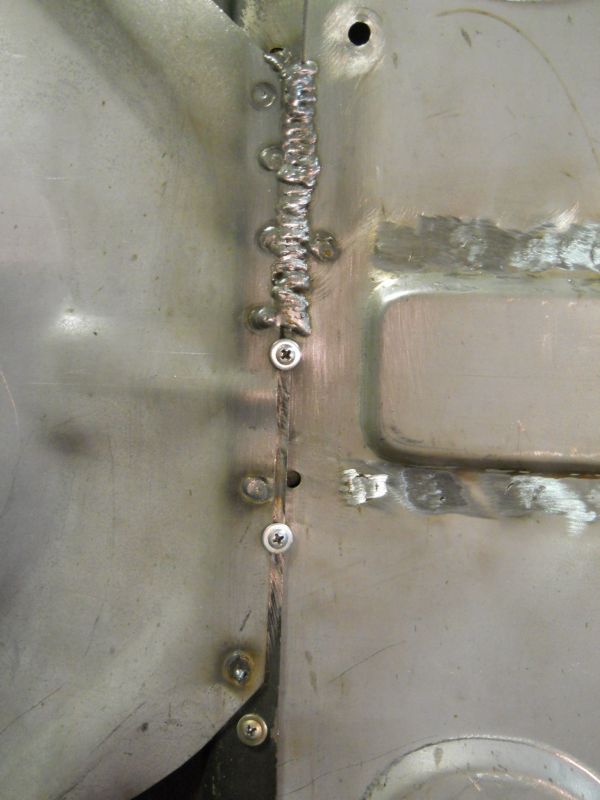

        A very abbreviated session this afternoon and mainly formed a plan of attack as far as welding sequence.

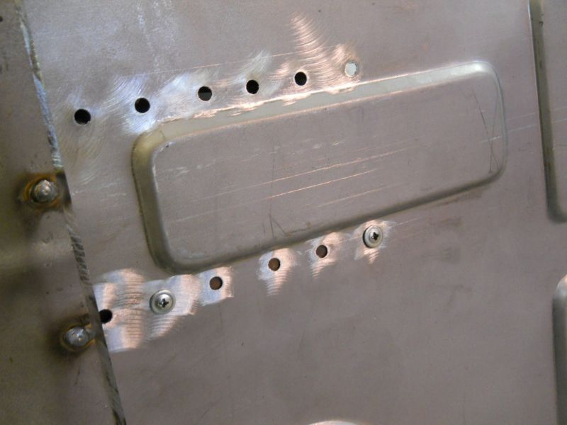

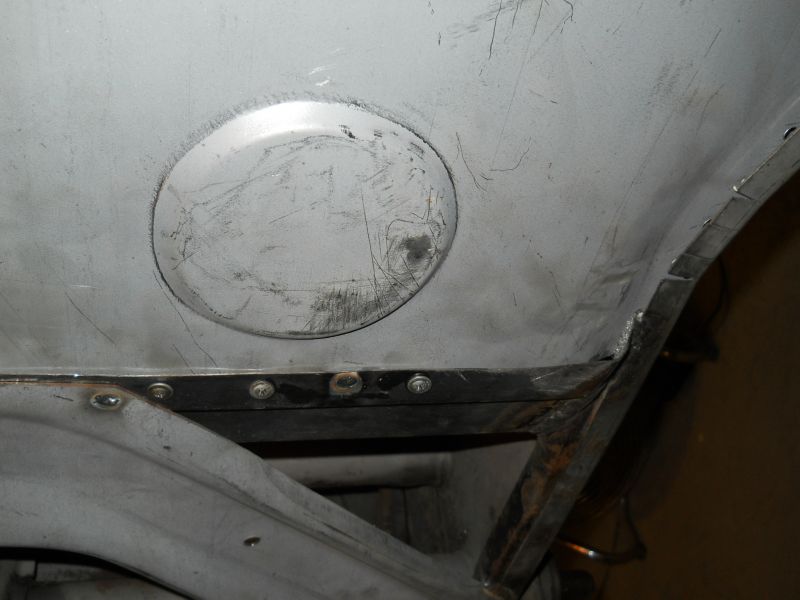

        Decided to begin from the forward center then out to the edges. Drilled and installed a few self-tapping screws to draw these two pieces together tightly before welding. I have cleco pins but found out several years ago while repairing the battery box on my coupe that screws provide much tighter clamping force.
        Another reason I have decided to leave the sides loose for now is this gap found on both corners. I'll need to torch-heat the floor here to be able to draw it down tight and contour it to this lip. The sides need to be loose to allow the amount of stretch and movement I need. Working on that tomorrow. Thanks for watching this! Justin

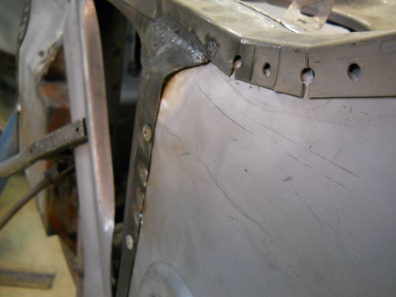

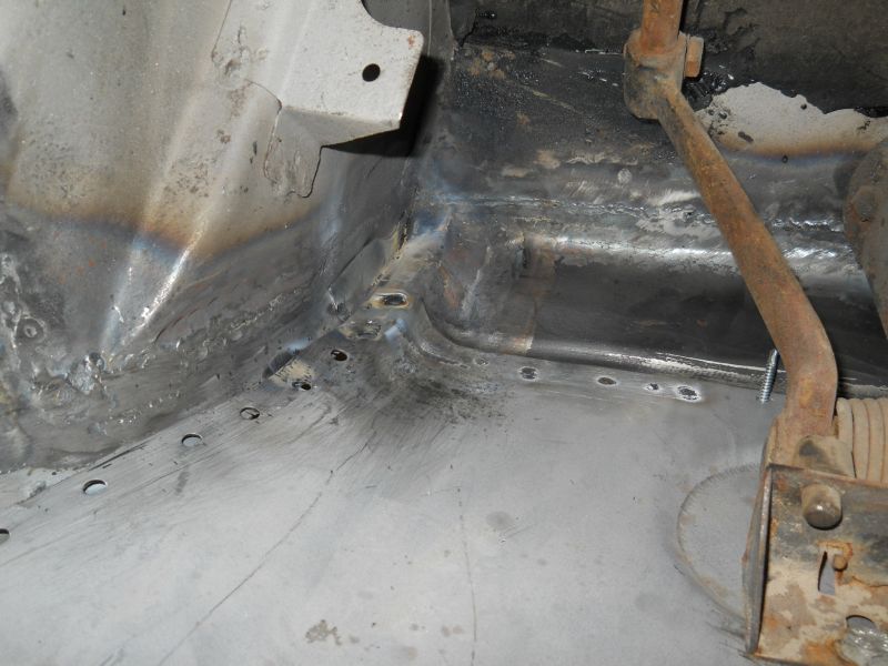

              Drawing up the corners and leading edge of new pan.
              Began torch heat and hammer work to the inside floor corner to get it to stretch and contour to this flange. This is after a couple of rounds.
              It wasn't all just floor stretch. I also heated and shrunk this outer flange to meet the new panel the rest of the way.

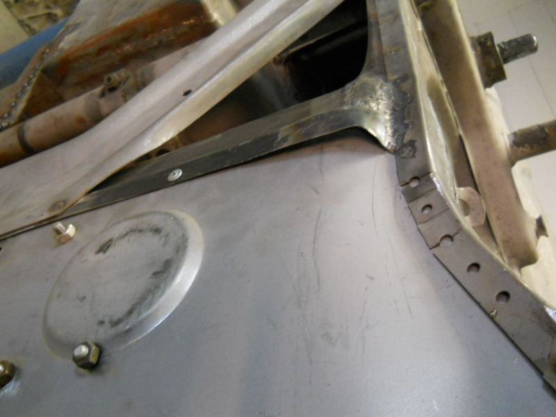

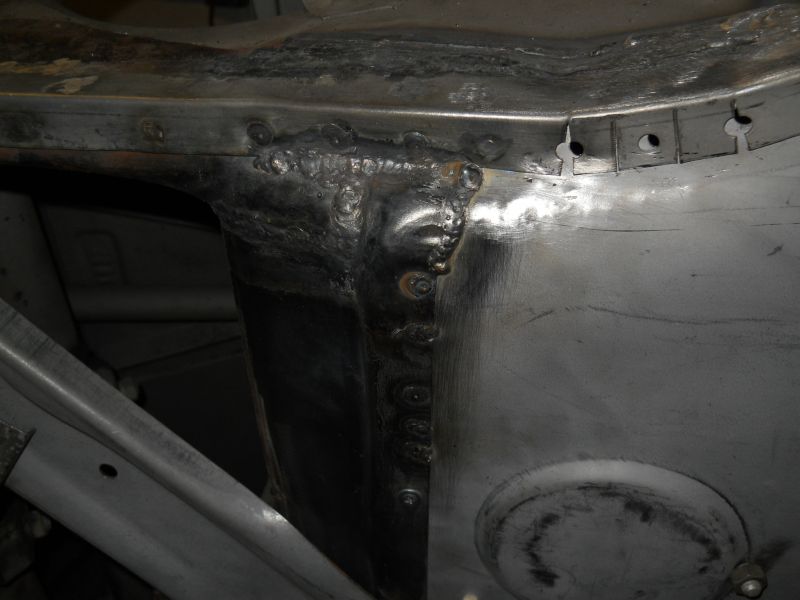

              With this corner shaped I could begin plug-welding the sides down to the flange.

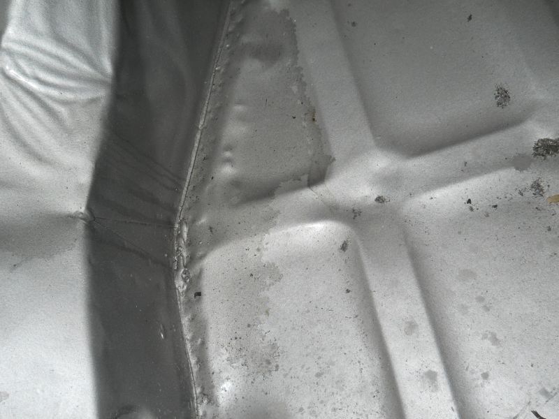

              referring back to the original floor on my coupe the factory seam welded this corner just past the shoulder. weld replicated here.

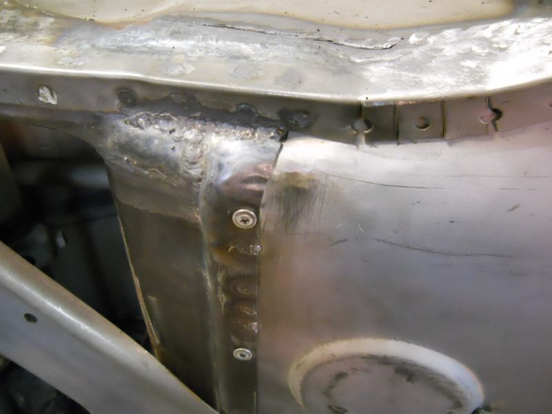

              Onto the right side and Leap frogging my screws and gradually replacing them with a plug-weld as I draw this side as close as I can before applying the heat. Repeat tomorrow; so far so good. Thanks for stopping by! Justin
              • Looking good Justin. Nice work on fitting that corner and replicating the factory welds. Surprised to see you use Phillips heads screws. I use the TEC screws based on a recommendation years ago from Bruce. Hex head, which imo is much easier to install and remove, plus self drilling and tapping. You can see one in this pic where I used 3 along the top of the flange to hold the new rocker in place.

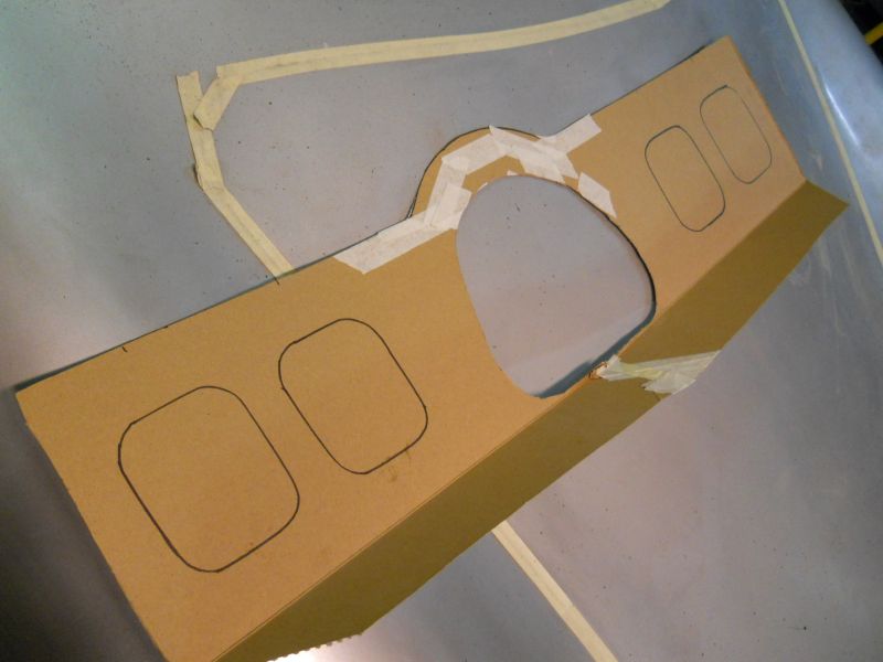

                      • 1/17/14
                        Paper template complete as Steve Hogue requested.
                        Wrapped this little chore up over last weekend and sent it off.

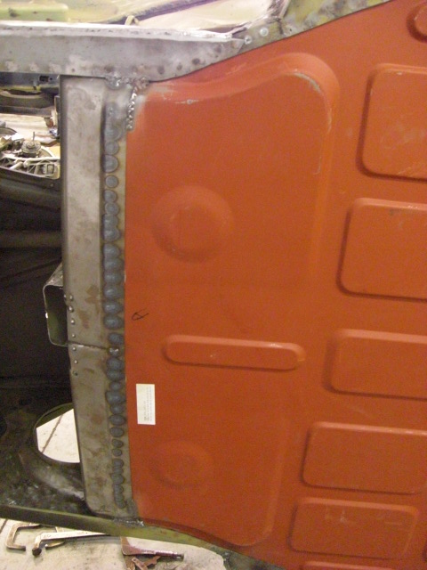

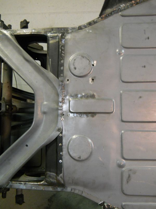

                        In the mean time I'm continuing on welding up the perimeter of this new forward pan.

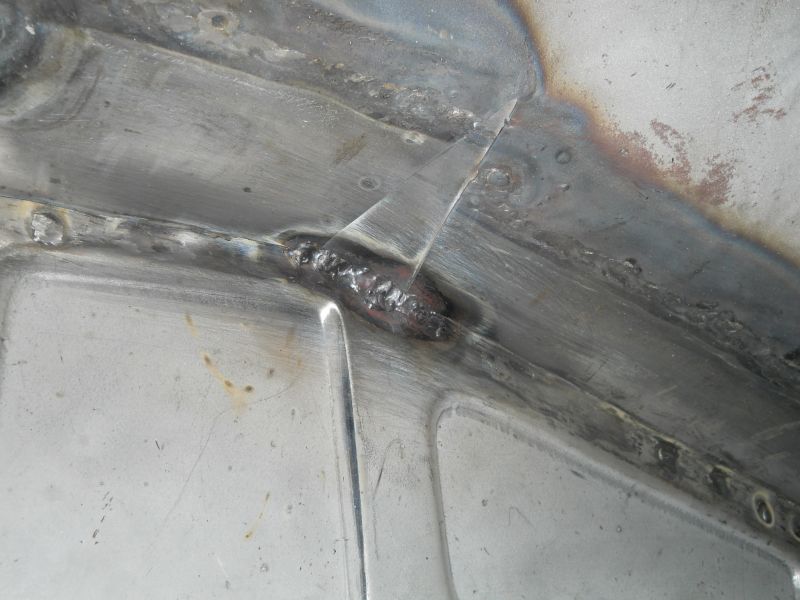

                        My original floor and cross member on my coupe has this leading edge seam welded across however they stopped at the pan. I decided to take it just a few MM's further and include the pan for more tie in strength. Basically still correct and most would never know the difference.
                        Plug-welding down the sides as well and am also replicating seam welds were originally done. The factory ran a seam across that "V" junction on the floor as well as a few other places I'll show when I get there.

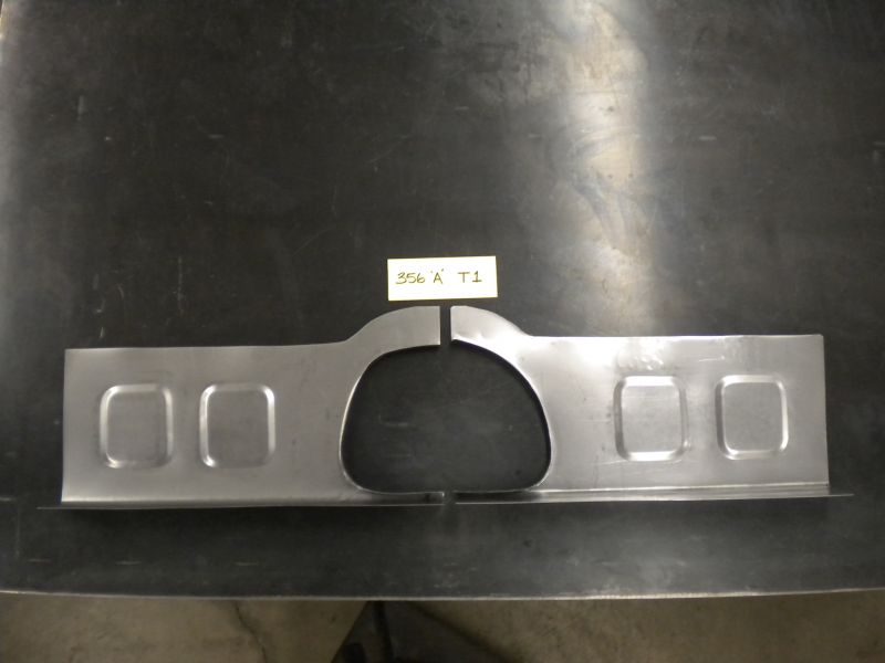

                        • 1/28/14

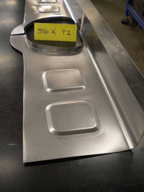

                          New chassis parts:
                          Steve Hogue came through on that rear vertical closing wall and I should have it in my hands next week.
                          Embossments and details look good! Trimming and fitting of course but what a nice looking start.

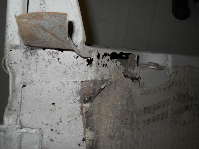

                          Excellent, solid, rust-free original chassis parts. Only draw-back is they were cut short ahead of the mount flanges so I'll be fabricating those simple repairs.

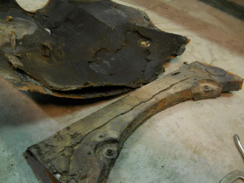

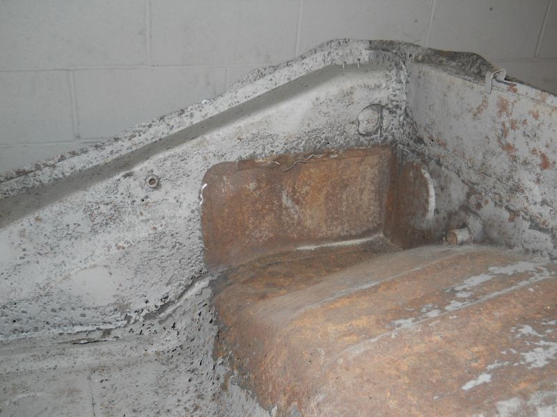

                          Original seat pan and cross-member is of course severely rusted out and heavily pitted.

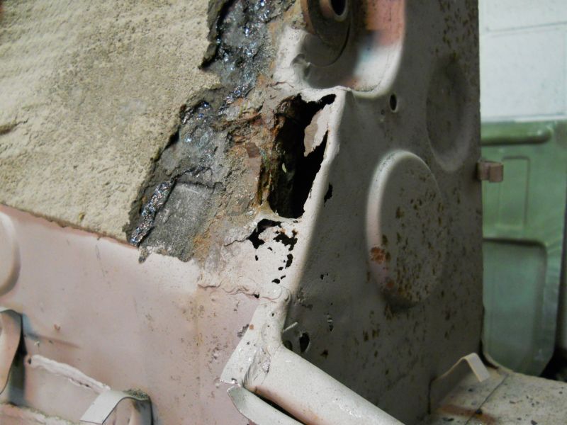

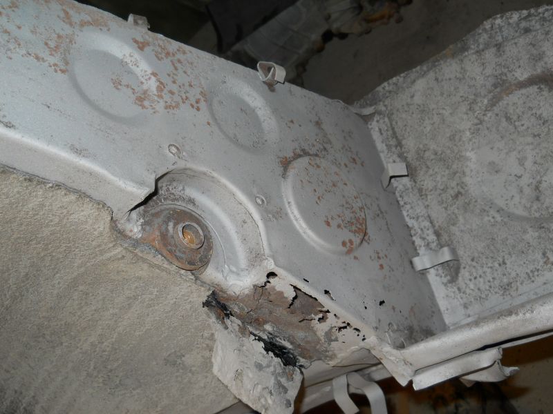

                          Both lower corners are gone and repair patches were considered but on close examination the rust is very advanced throughout the cross-member.

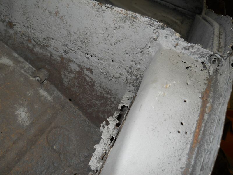

                          Other side

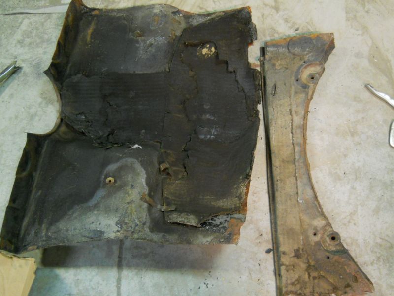

                          The cancer is not localized to the corners; heavy pitting and rust damage runs all the way up its walls.
                          A cosmetic cap is not going to cut it; the rust runs too deep.
                          This is the business end of this chassis. The weight of the drivetrain and the torsional force of its operation runs through this cross member. I wouldn't want that thin rusted out old anchor-point in my car. This replacement is a must as far as I'm concerned. Prepping this area until my wall arrives from Steve. Thanks for stopping by! Justin
