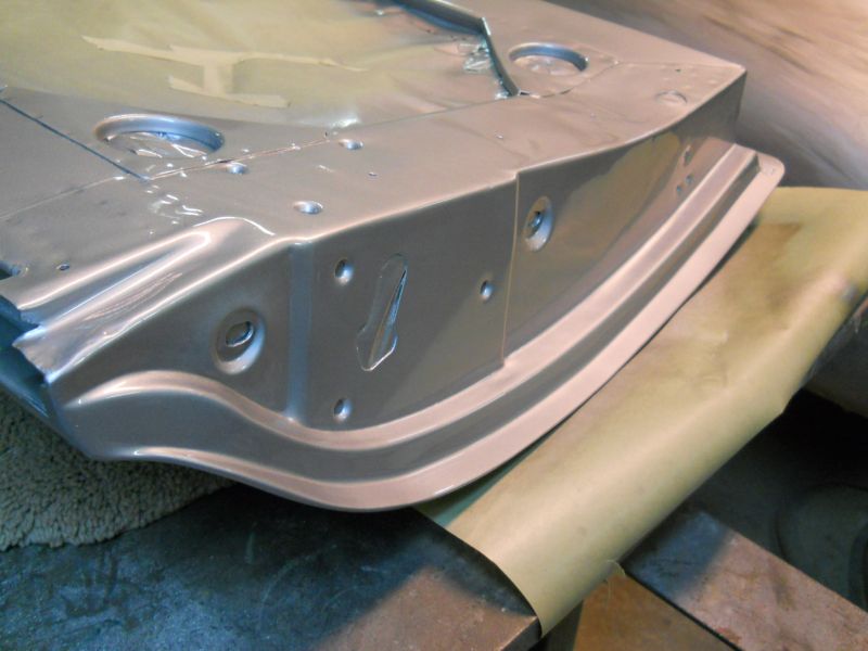

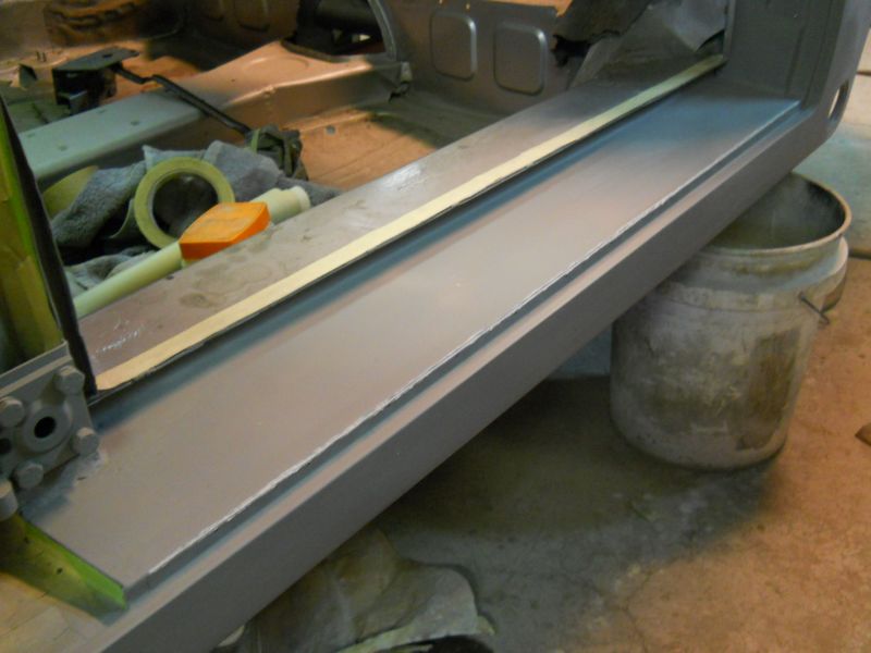

          Door prep continued:
          re-heavy drip checking the joints that open upward including around the hinges and the entire lower pinch seam.
          Puttying up the divots and cleaning up the faces that will be seen once finished.

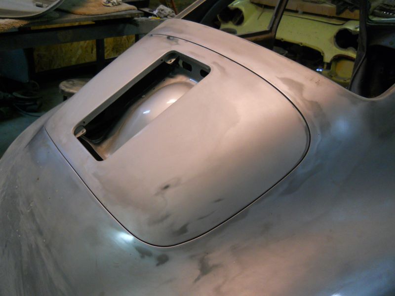

            Deck lid gaps, jambs and edges done.
            The final bodywork phase for this car again are the edges, jambs and gaps on all the closing panels and openings.

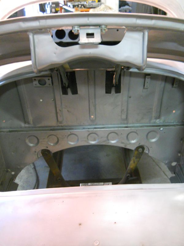

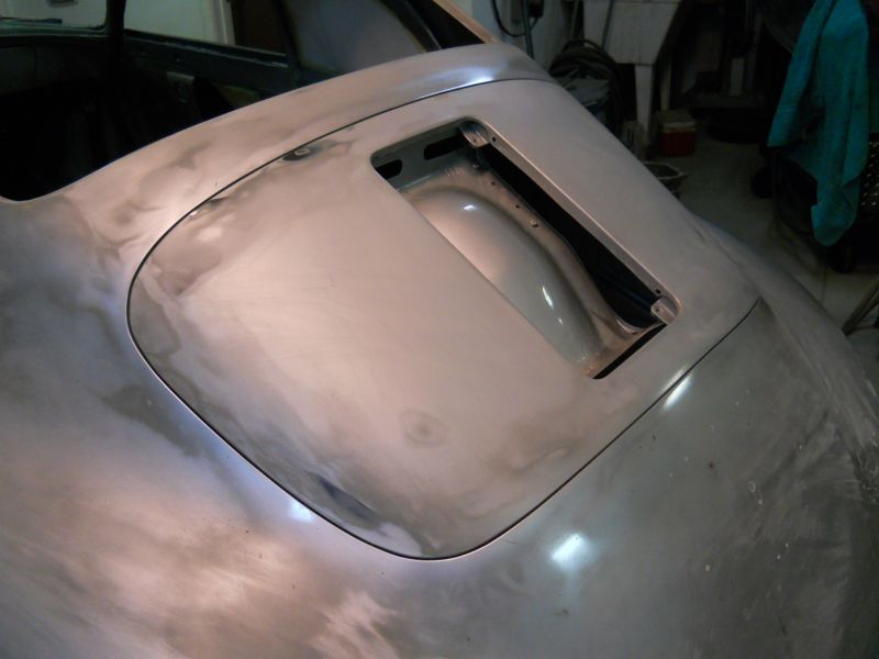

            As of this afternoon the rear lid is officially ready for final paint with no more blocking or shaping needed. I've Chased it as far as I'm gonna..

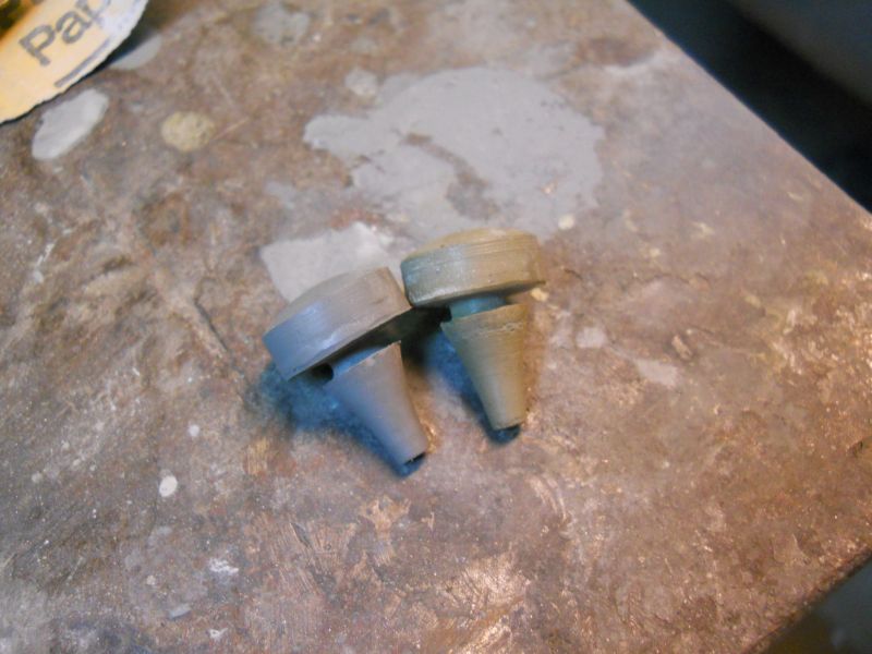

            As the final shaping of the opening progressed I was having a bit of trouble recreating the agreed upon gap from side to side as tracer coats and test fits proceeded. It was driving me nuts! Unfortunately the latch and hinge design allows for a lot of flex from side to side.
            It quickly became apparent that the rubber buffers at each corner play a very important part with the lids latched position on the car. I have here new and original buffers (original on the right) The new ones are much softer and forgiving so I installed one on the high side corner with wider gap. The originals are a touch thicker and stiffer so those were used on the low side with a tight gap.
            After dialing those in the lid now seated on the car exactly how I had intended. I can't tell you what a relief that was, I though I was going to have to go back to shaping the jamb again. Anyway at this point the secret is in the rubber buffers to either load or unload where necessary. Will shoot some silver over the dark spots but its now done otherwise. Back to the drivers door. Thanks for looking! Justin

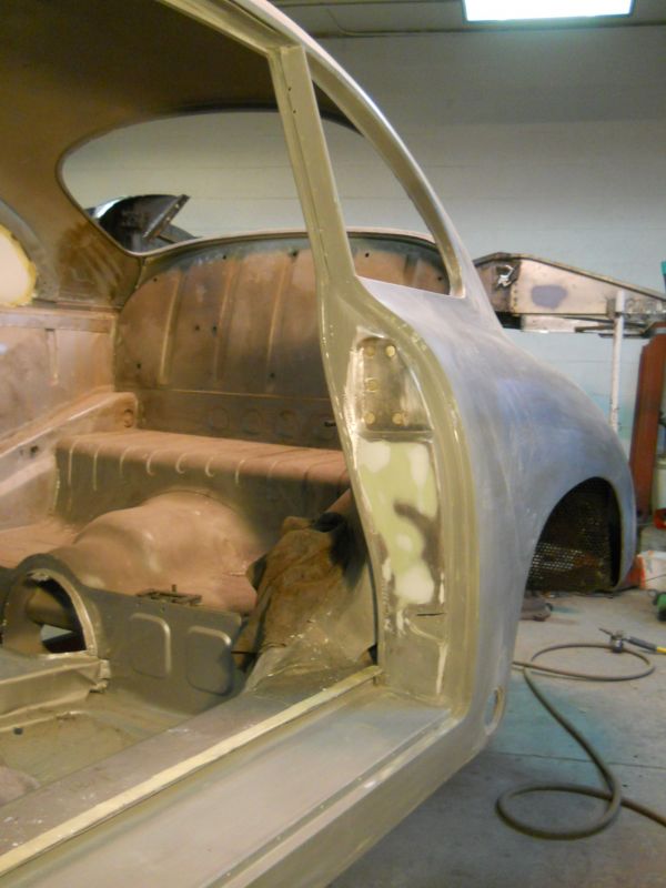

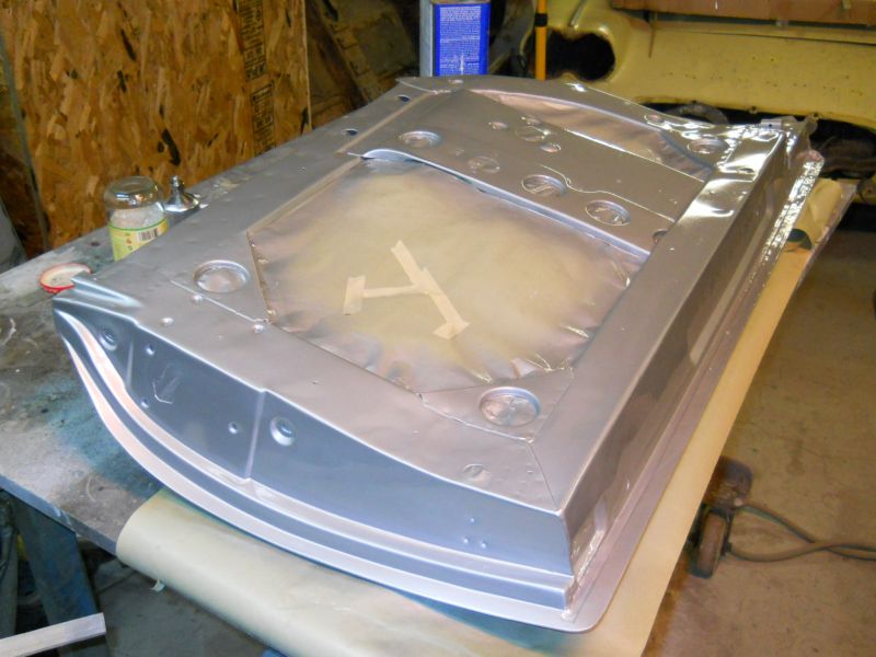

              Finishing up the left inner door structure and jamb.
              Substructure and jambs now in final paint.
              Did my shaping and smoothing to the surfaces that would show most like the rear face but I left the rest in one coat of primer and then just 2 good coats of silver to finish it off. It shows every imperfection but that's what I was shooting for. I am trying to avoid the look and feel of a car that's just buried under mounds of paint. Except where I need it.
              Again took a lot more care here to smooth and shape all of the facets since it shows every time the door is opened.
              Now that the door is out of the way I am focusing on smoothing out the surfaces that will be most obvious.
              The spot on the lock post where I found that patch of original putty needed a replacement swatch after all.
              Also running another run of drip-check along the mount flange. I know there is old rust in this pinch seam so I have to do everything I can to keep it dry. Lock post and A-pillar are now primered and will shoot a test coat on tomorrow. Thanks for looking! Justin
