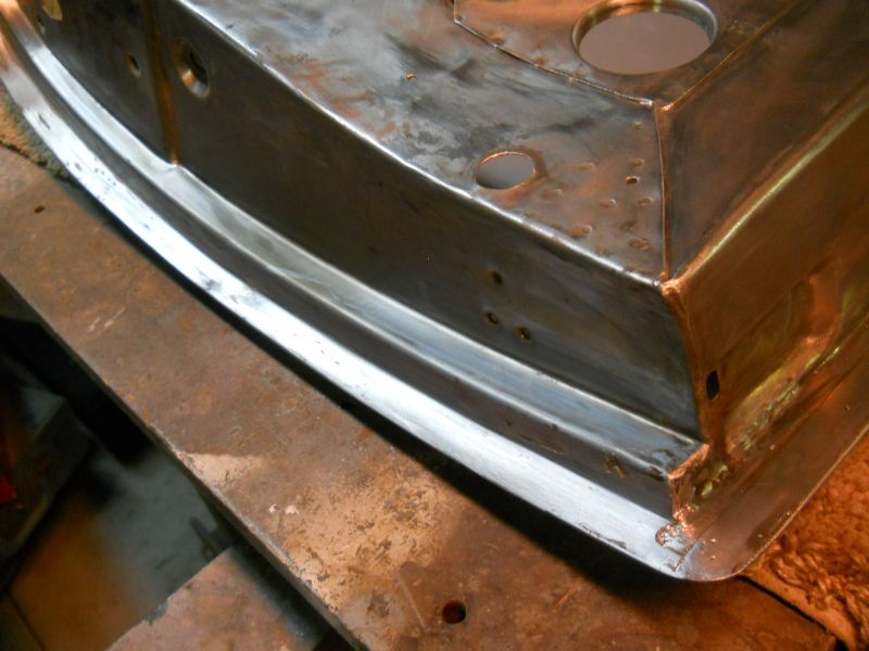

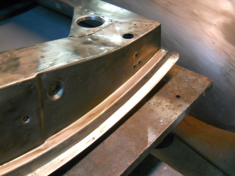

                        Beginning the last of the re-dos (I hope) before it goes for its final color. The substructer's on both doors and threshold areas were also coated many years ago in that cheap epoxy primer. With the outer skin of this car finally done I am painstakingly stripping these areas back down to metal.

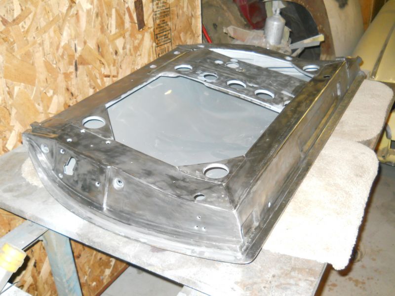

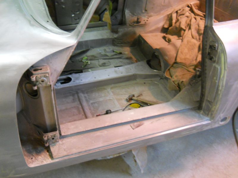

                        Door removed and will begin stripping the door well and threshold areas. All the while being very carful not to get any paint remover on the outer base coats.

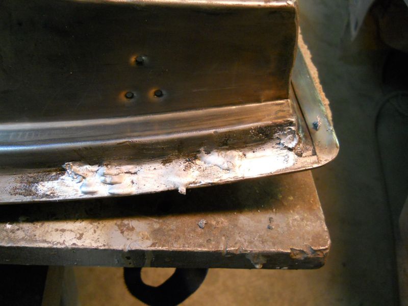

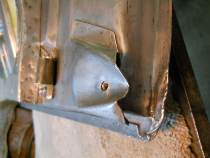

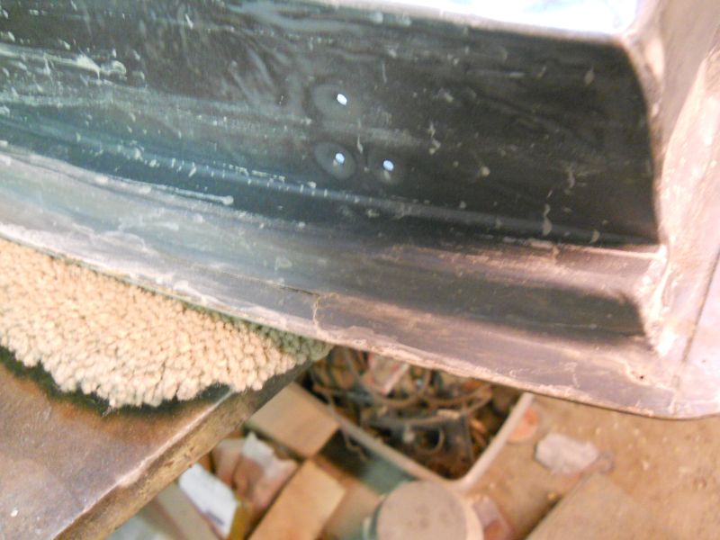

                        Another redo to address is the mid-lower corner of the door. As I struck it with a hammer to get the proper elevation with the body I cracked both the lead and an old patch joint on the leading edge. This fix has been too depressing to think about for some reason.

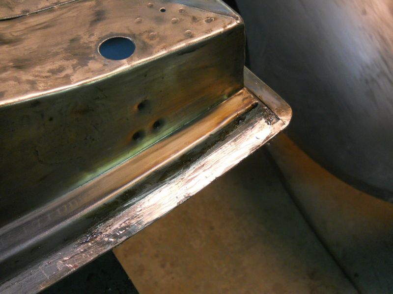

                        Interesting detail here, seems the factory was beginning to play with plastic filler even way back in late 1956. Here is a very small remnant of it.

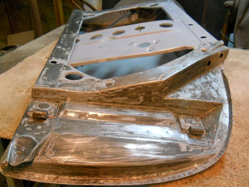

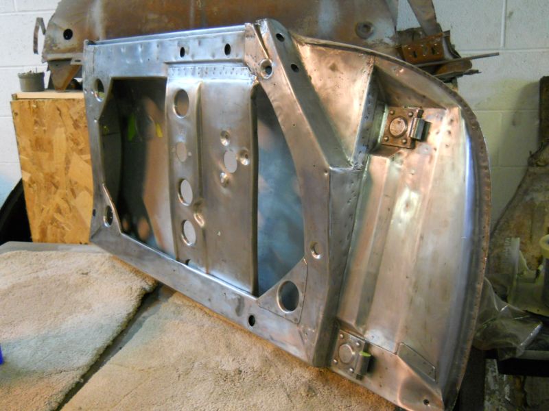

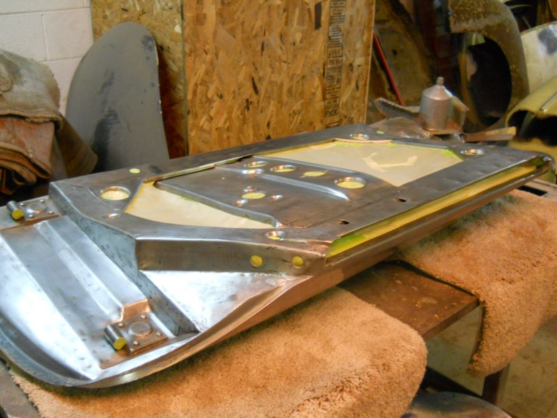

                        Now for the very time consuming chore of stripping clean all the crevices and facets of this inner structure.
                        Slowly getting there but as you can see still had the turned edges and flanges to go. I also had to take care as not to damage the paint job to the inner face of the door skin and chassis. I do want to reshoot those areas again.

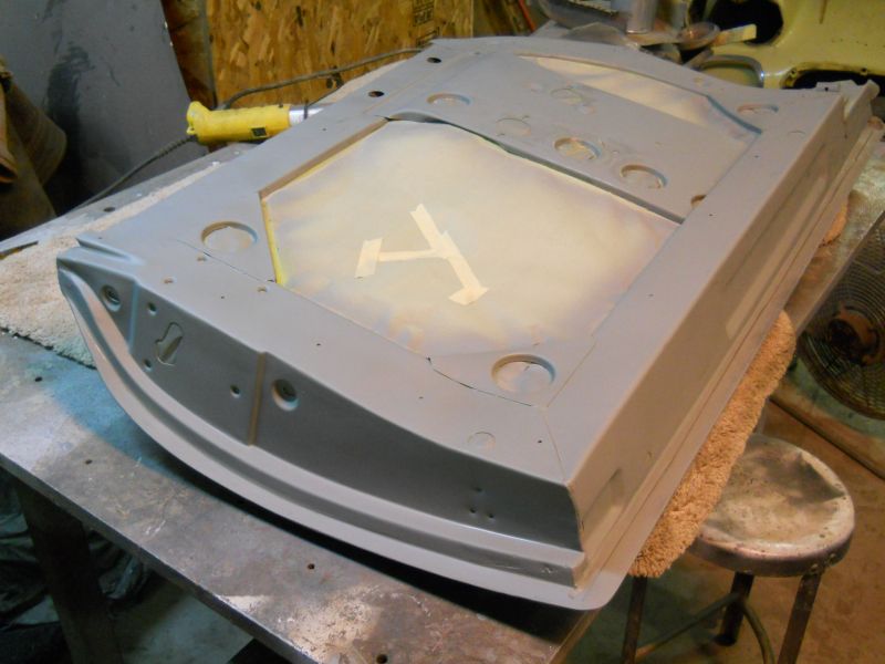

                        Took a few sessions of careful stripping but I its finally all clean and ready for some DP40.

                            Also, is the door stop shape "correct"? On T6B the top(horizontal on car) is flat. Yours is depressed where the rubber bump stop is. Another little difference between models?

                                I hope they help Phil. Tom is getting ready to solder his car so there will be additional reference here shortly.
                                No, there is no difference in the snubber mount between model years. These started out flat like all the rest but have bent from the doors being flung open by the previous owners. I made no attempt to fix them because both doors are equally deformed and frankly I think they are better this way. They are completely bottomed out so they are not going to bend further. They still do their job as door does not collide with the body when opened fully. Hell the doors don't hit now even with the rubber snubbers out. Leaving them alone also allows the door to swing open a bit wider when the rubber goes back on and gives me a little more room to get my behind in and out of the car. I'd be a fool to "fix" them.

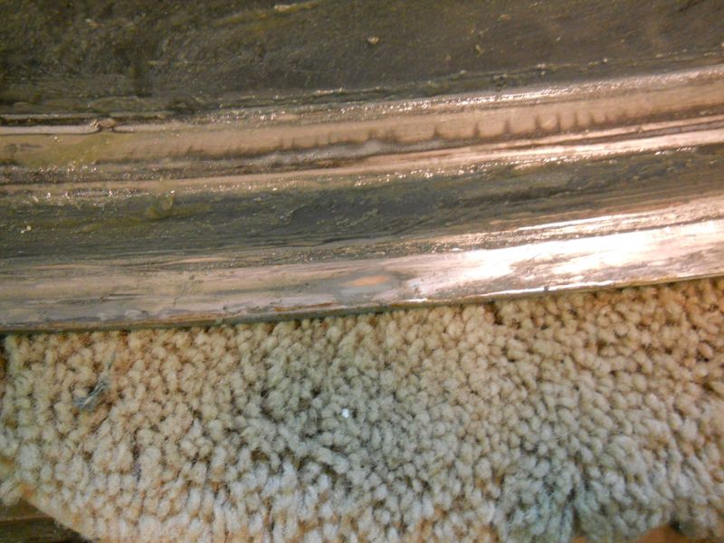

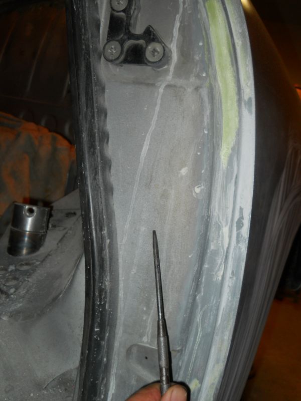

                                Spent the afternoon carefully taping up the door. Also went ahead and stripped out the door glass opening and taped it off. While it won't be seen it would bug me if I left it scaly and nasty down in those flanged areas.
                                In DP40 this evening. Just have putty up a few divots and imperfections then run some more heavy drip check on a few seams but after that it will finally be ready.
