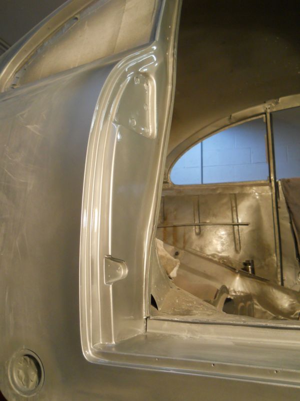

            doorjamb fine finishing con't

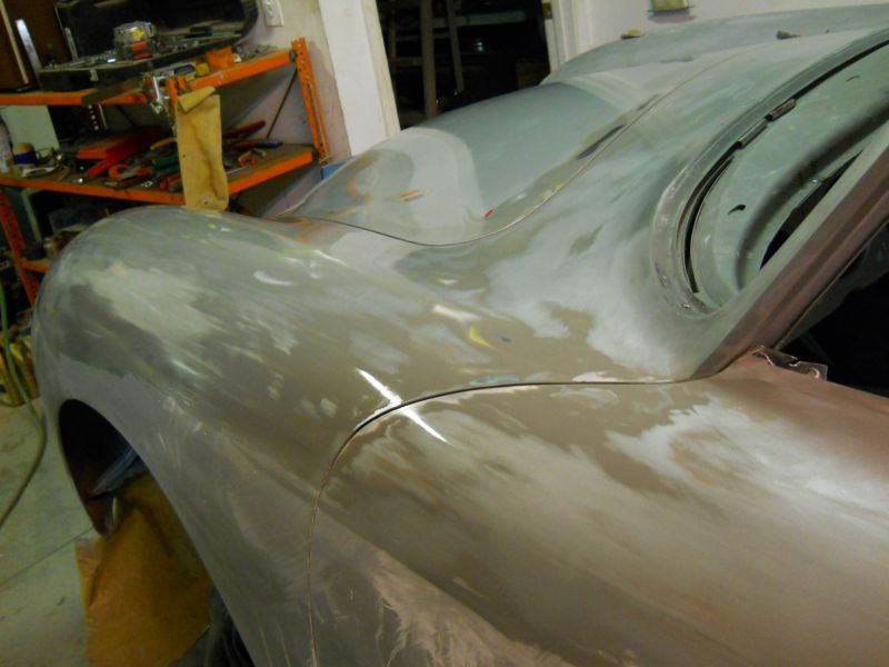

            Quick tracer coat and its getting oh-so close!

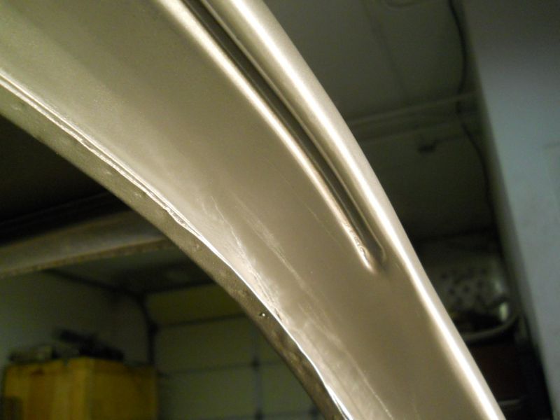

            I'm down to scratches and nuggies like the ones in and to the side of this bead roll. Stuff most would never notice or give a second thought to but being so close I just can't bring myself to leave it.
            As soon as this hardens up enough I'll block it all down with 400 but I think its ready...I think.

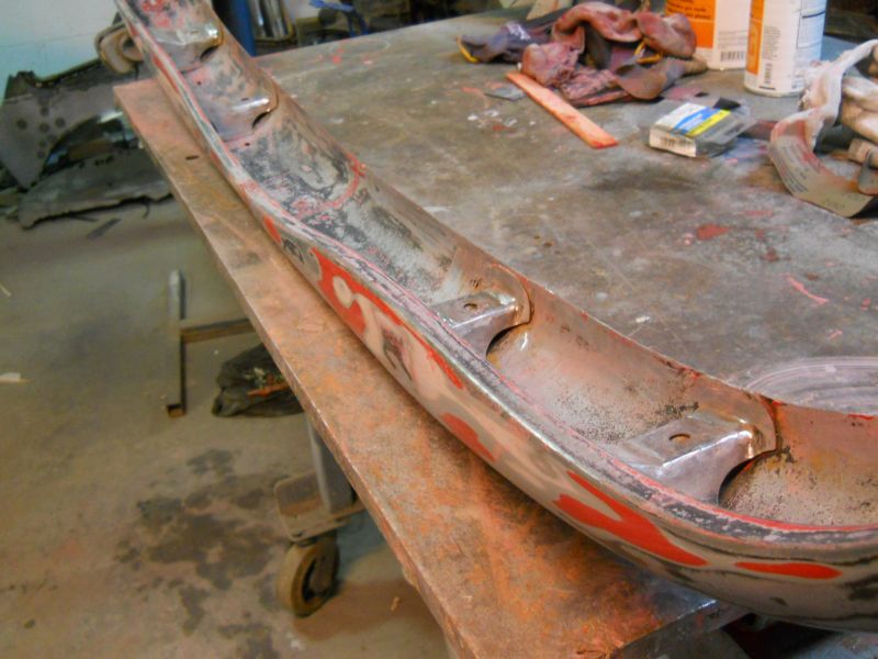

              My initial thought was to get the exterior in a solid guide coat of silver then apply the final finish. Rick highly recommended using a sealer over the bodywork instead. I told him of all my concerns over proper adhesion and the problems I'd had recently; he assured me that would not be a problem with the system he wants to use. Since he's in the business of automotive refinishing and is up on all the latest stuff I wasn't going to argue. We'd do it his way.. I began sanding back the bumpers as far as I could to both shape finish them and get the material thickness back down in prep for the sealer.
              Made the extra effort to strip down the backsides as well to hold down the paint build-up.

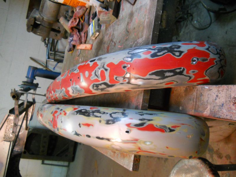

              Rear bumper hung and ready for the final sealer.

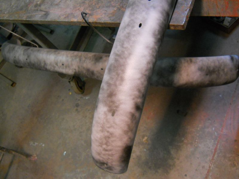

              Both sealed and fogged with a guide coat here. Final sanding prep tomorrow before final paint!

              Very carefully blocking down the guide coat as far as I can with 400 to make way for the sealer.

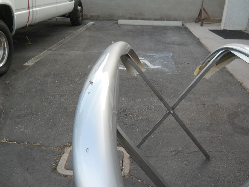

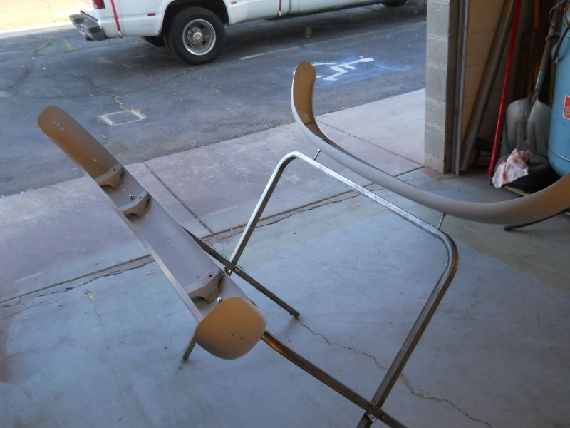

                              After a few rounds of sealer and block sanding the bumpers are finally ready to go. Fabbed up this little stand during the process to make spraying these odd shaped parts much easier. The final application will have a much better chance of turning out blemish free versus just hanging from wire like they were when the sealer was applied.
                              They are wiped down with solvent here and will be shot tomorrow morning. Rick wants to finish the inside first, back tape it then flip them over and do the outer surface. Provided we don't have any "fisheyeing" or lifting problems the final coat of color goes on tomorrow.

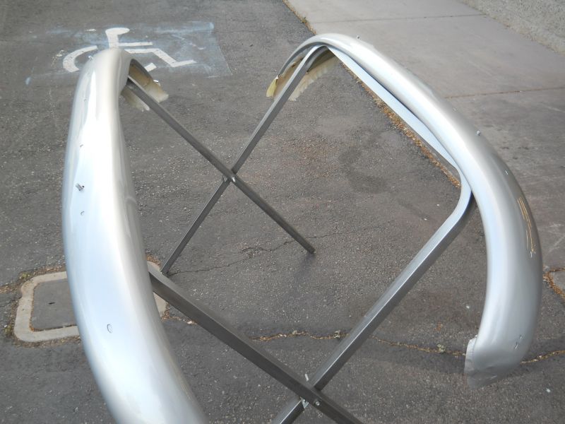

                                Rick getting ready to shoot the final coat to the outside. He had painted up the inner surfaces a few days ago and they are back-taped here.
                                Painted and they turned out beautiful!! He laid the silver base down with a really nice sheen with no "tiger stripes" or pattern inconsistencies.
                                The clear went on just as well. My joy soon turned to sadness as I found a light spot at the very tip of both bumpers at the same end
                                We just didn't get enough silver base on those tips as they turn in slightly on this one side. Too late to chase it as the clear was already over the base so the easiest thing to do is to let them cure sand lightly and shoot them again. par for the course and have been down this road many a time but it just sickens me because the rest of it was/is so beautiful. Oh well, I at least found out this afternoon that I'm going to love the color and I have a guy who's competent at shooting metallic paint. Thanks for looking! Justin
