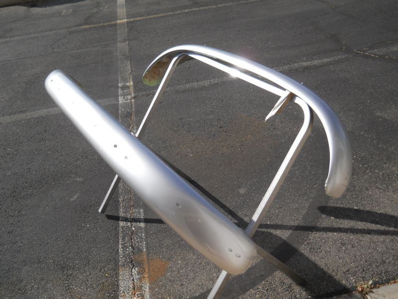

    Bumpers in final paint.

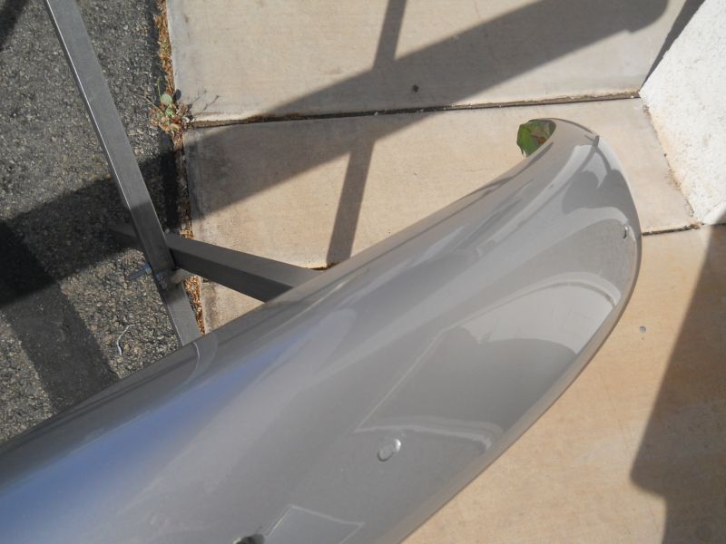

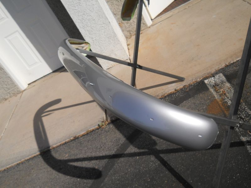

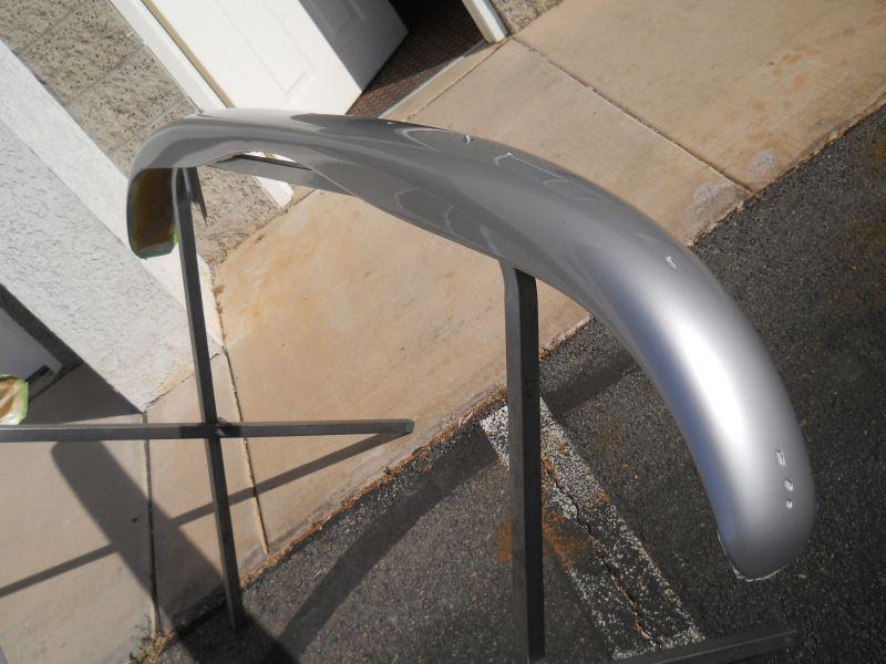

    Got the bumpers reshot yesterday evening and pulled them out into the sunlight this morning. Rick was able to repeat the silver effect beautifully!
    The clear settled out with almost no orange peel. If not for the specs of lint and a bug that decided to land on one of the bumpers just after the final coat I'd have almost no reason to cut and buff these.

    The photos don't quite capture the glow these give off in the direct sun; I could not be happier with the color and the tone of this particular silver. I'm really getting excited about getting the rest of the car finished out. Will get the dash face painted next so we can seal the interior off in prep for the rest of the body. Working on that now. Thanks for looking! Justin

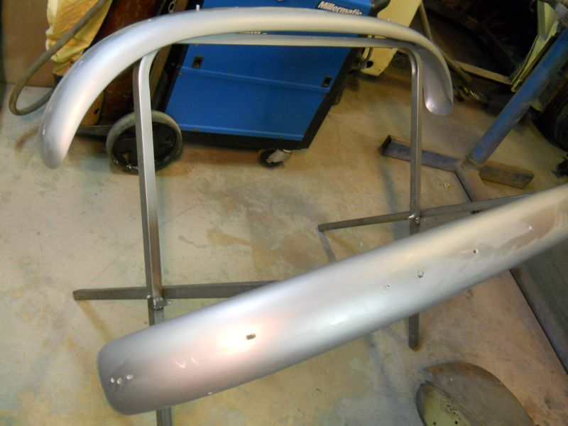

        I spent some time yesterday giving them their initial cut with 1500 to open them up for a thorough curing.
        I'll leave them as is for the next several weeks to harden up for the final blocking and polish.

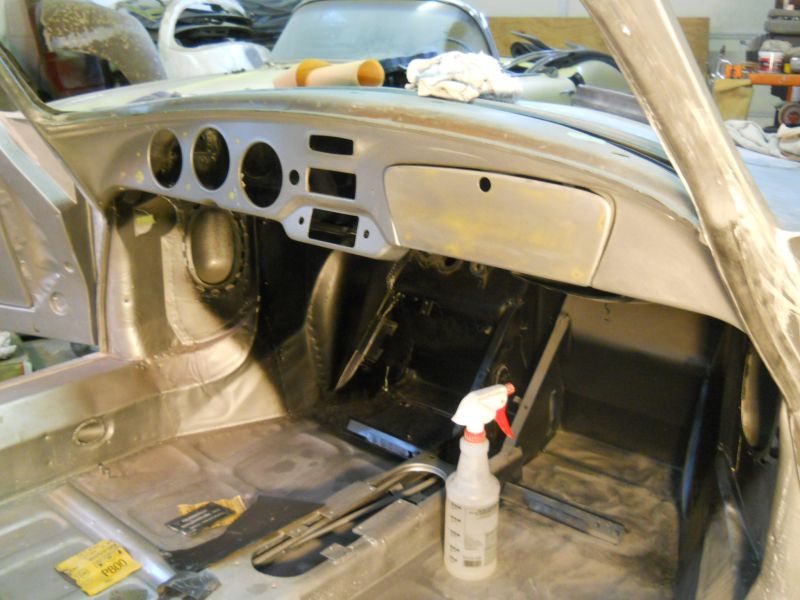

        Begin block sanding the dash for final paint.
        Almost blocked and after that a careful masking to seal off the underside of the dash. Thanks for looking! Justin

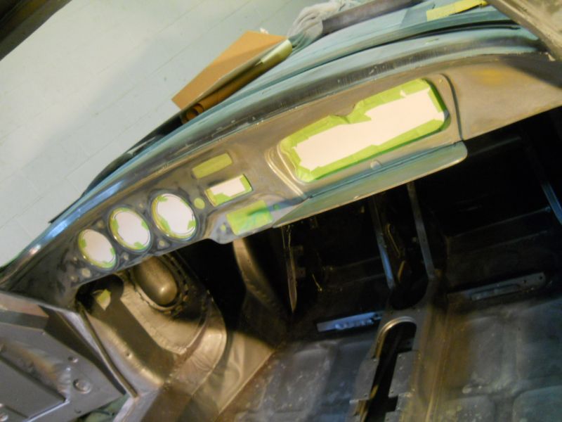

                                Dash prepped for sealer then final color.
                                Took several sessions to carefully sand and prep all those nooks and crannies. Then a solid session more to carefully tape it off.
                                Glad to be almost done with this area. That floor and tunnel are not the most comfortable place to sit and lay on while you're sanding or taping.
