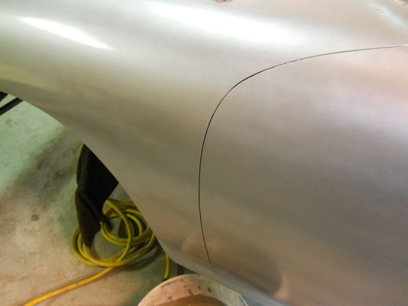

      block sanding begins anew.

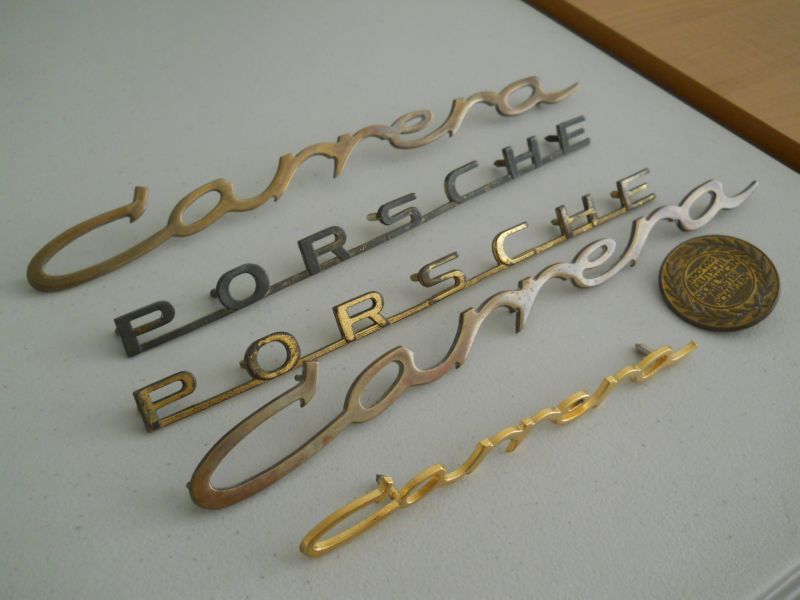

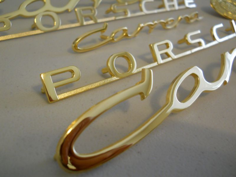

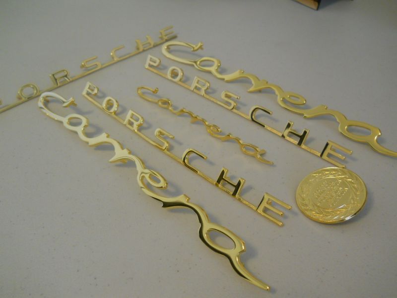

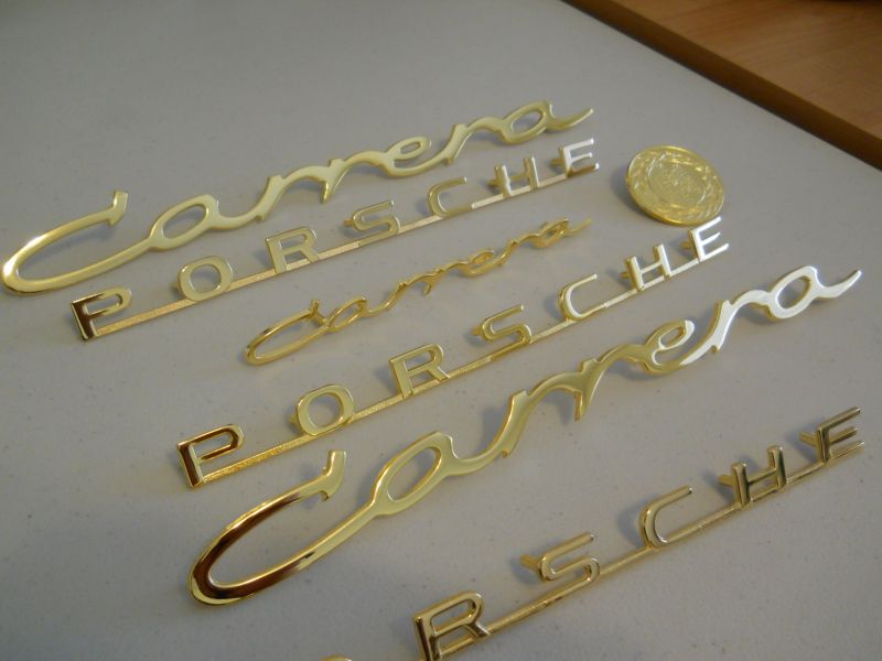

          Just received the "jewelry" back from Victor Miles this week and of course he did not disappoint!
          From this...
          to this! Absolutely Beautiful!
          All the detail stuff left intact like the pebble finish on the connection bars between the letters.
          all the original details on the dash medallion left alone as well.
          While we were at it I sent along an extra Porsche script for my coupster project. Even more motivated to get that body painted! Thanks for looking! Justin

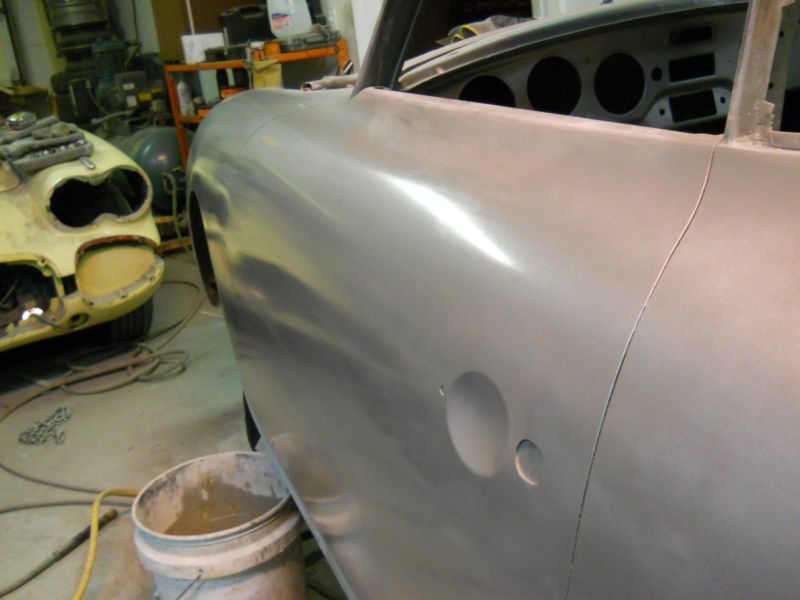

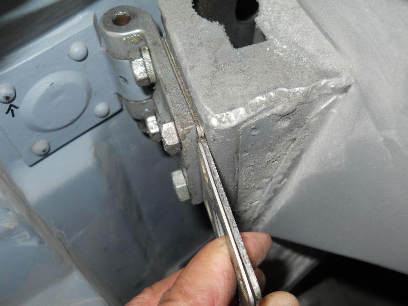

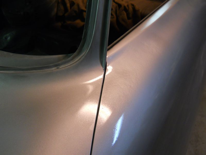

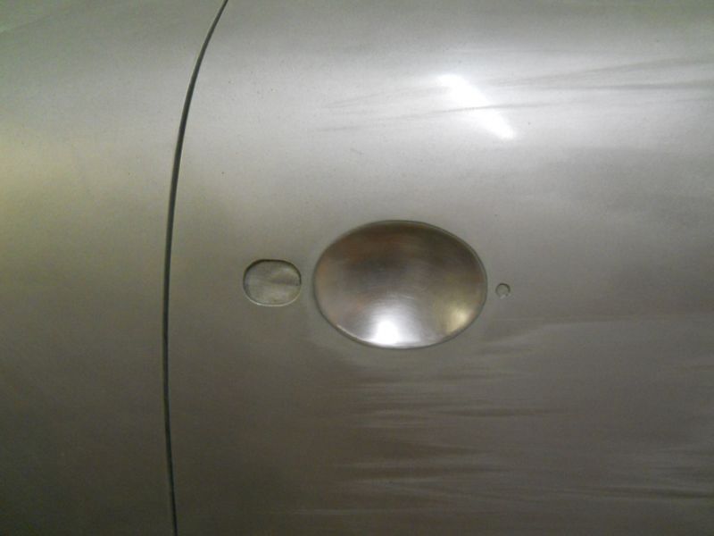

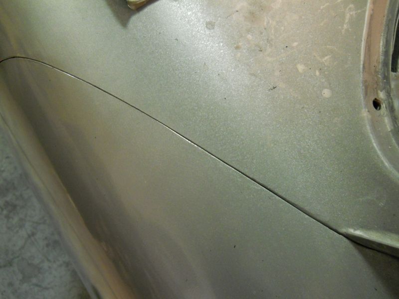

              One last final hair to split on this troublesome drivers side door.
              More than once I foolishly and prematurely claimed that I was finally done with this left door but now I can truly say I am finished. This is part of the reason its taken me more than a month to update this post, I wanted to be absolutely sure this time as I was as tired of talking about this area as you probably are about reading it.
              While I was happy with the reflection consistency across the front fender onto the door after the removal of that shim a new problem arose afterward which didn't think was all that serious at the time.
              Now with the door fully latched the back edge was sticking up a few mm's from the rear quarter panel. I thought no big deal I'll adjust it inward a bit. After a couple of weeks I turned my full attention to getting the latched door back down flush again. After moving the striker inward a touch the problem persisted and after removal of the striker plate the real problem came into focus. That shims removal created clearance issues with the lower a pillar section. As I pressed the door into position I could hear and feel it collide with the door jamb. This crowding was the cause of the rear edge alignment issue.
              I filled away some of the lead to create space and it helped but wasn't enough.

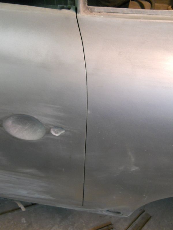

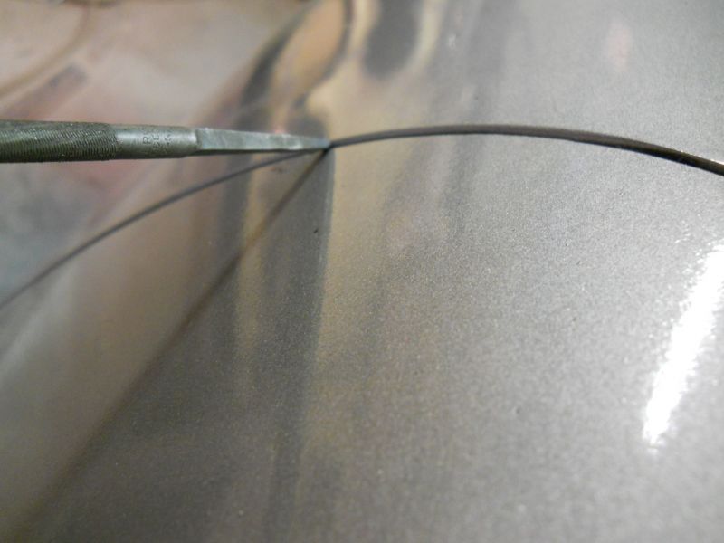

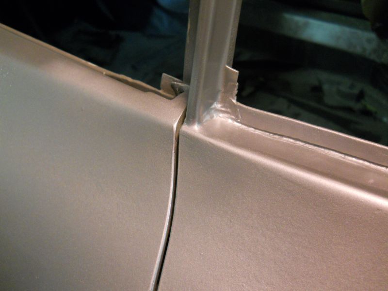

              Now after pushing the back of the door into level position this forward line just completely closed up. How's that for a door gap Roy?
              I quickly realized that this change created to many general fitment problems to try and just force though. I needed to preserve that body line but the door had to come back out a touch. 2 shims were too thin and 3 was too thick so I had to create something in the middle. I found that one thick and one thin shim with some mild prep would yield me the distance I needed.

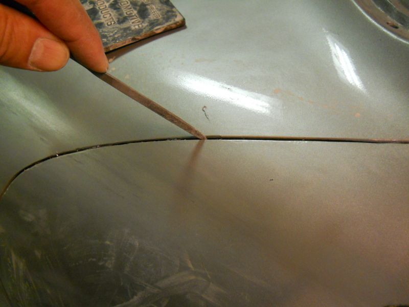

              Another confirmation that the door could come out a hair was this elevation deficit depicted with my file.
              If I over shot it just a touch I knew this swatch of filler I laid down after the 2 shim change would buy me the time I needed to relevel the panels. (and as I block sanded afterward it did just that)

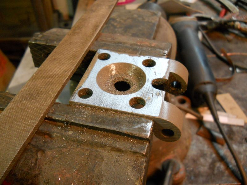

              one thick shim about equals two thins so get me down somewhere in between I stripped it of all paint and finish sanded it faces.
              I also surfaced filed the hinge face to help achieve that middle distance I needed. Reassembly with striker plate and block sands followed.
              Fast forward to the first work coat and I finally had everything I was after; rear door edge latched flush again with proper clearance from the jamb; and most important cosmetically speaking the reflection across the panel remained at a level of consistency I can live with.
              Have a bit more opening to do here but at least my gap came back after this final adjustment.
              Again its still not absolutely perfect but its as far as I'm going to chase it. Besides Most people who will see this car will have no idea what my problem was/is...
              Okay, Now I am officially done with this side!!!! Thanks for reading all of this trial and tribulation. Onto final finishing before paint. Justin

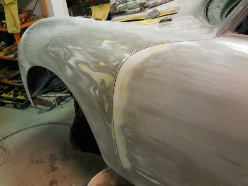

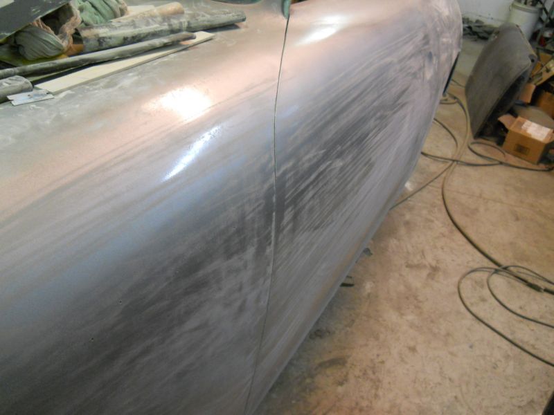

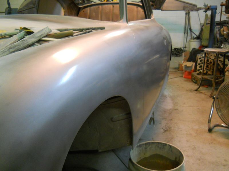

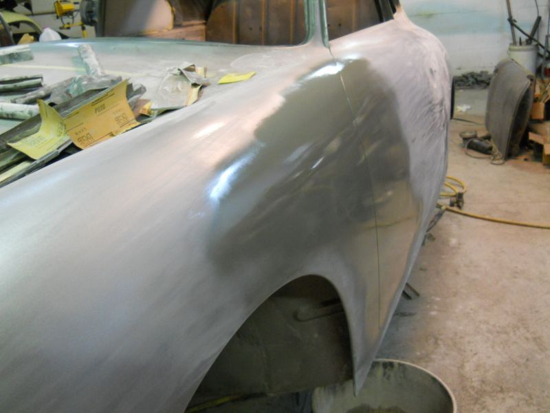

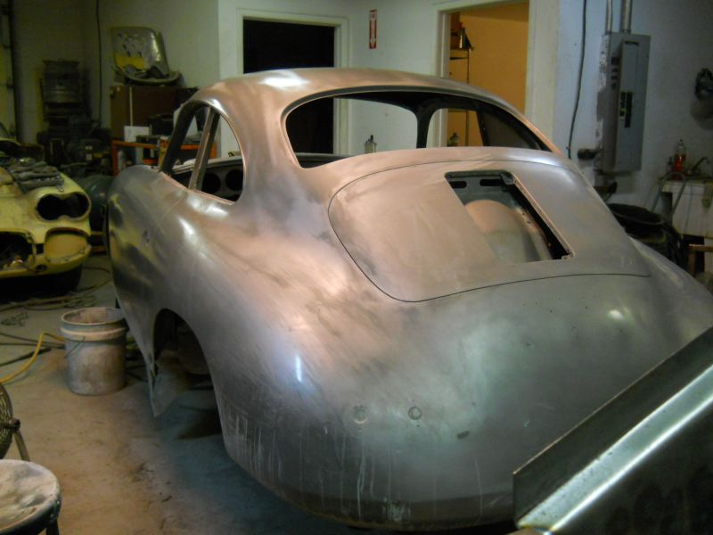

                        Pre-paint finishing phase: Now that I've got the bodywork to an acceptable level my next goal is to thin out its coverage as much as possible without ruining the shape I work so hard to get.
                        now blocking down the body as a whole as far as I can. A real balancing act of taking it down enough all the while resisting the urge to go too far and destroy the surface. (as you can probably gather I've done that to myself many times before ) I have to be careful not sand past too many different levels at a pass; what I have learned the hard way is that even though I was using a sanding block the various levels of paint, primer and filler are of different hardness and will wear away at different rates all which will create an uneven wavy surface requiring another coat of primer and block sand to get back what I had before.

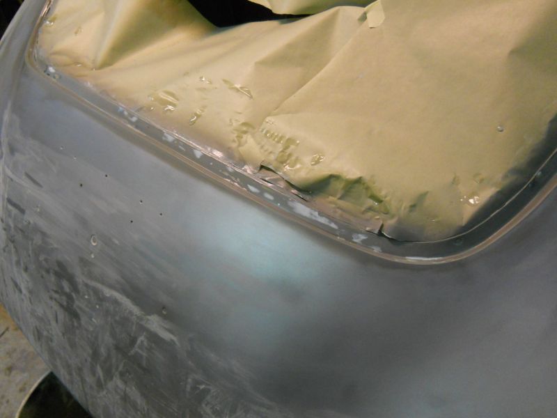

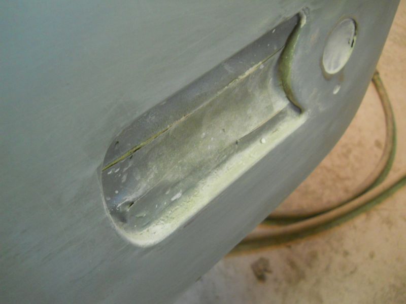

                        No secrete that this car required many phases of primer and test coats. The flat surfaces have been thinned as it went but areas like this handle recess where not touched and paint thickness has built up.
                        Again reducing excess paint thickness wherever and when possible.

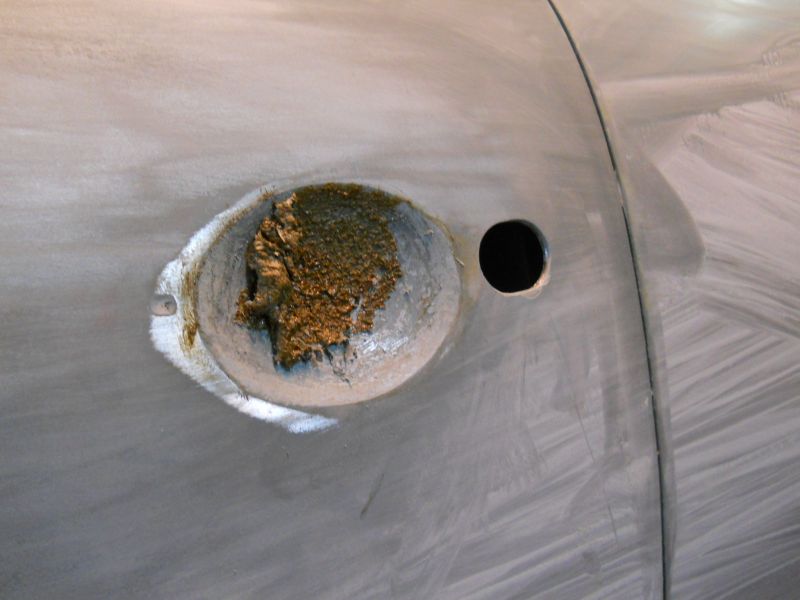

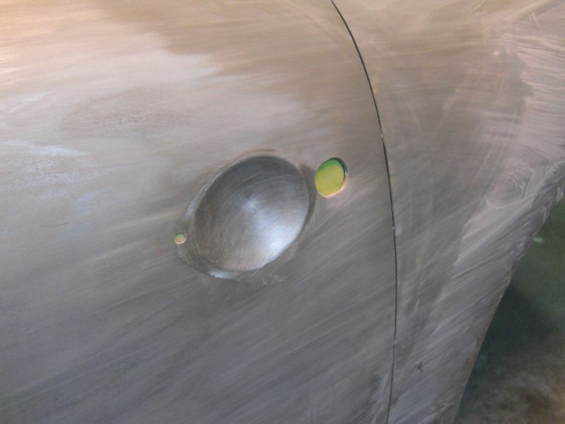

                        Right side pocket reduced metal and will get a coat of primer and one color coat before the final paint job is applied.

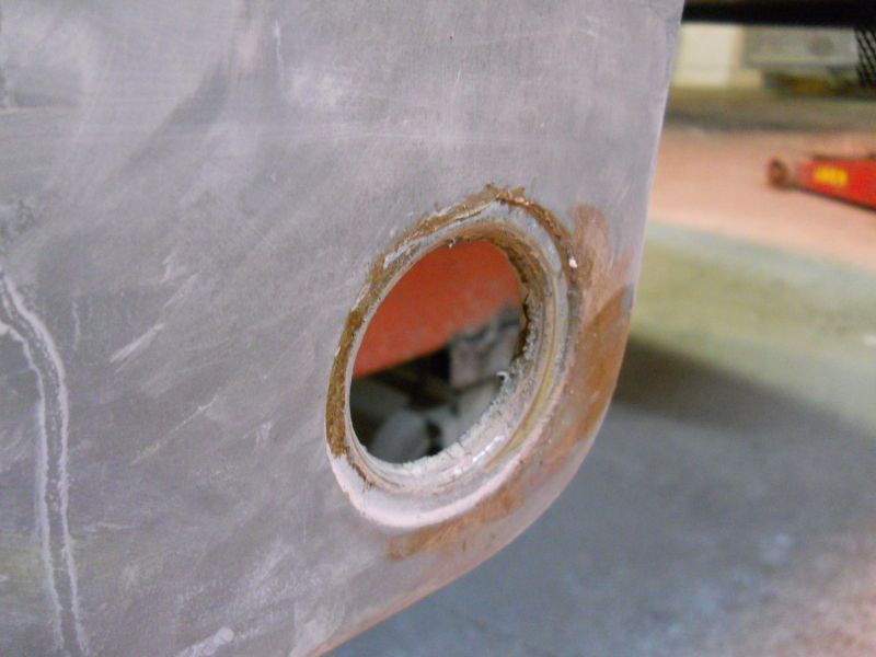

                        Other areas easily overlooked are the body-plug flanges
                        and the horn grill flanges. What I am trying to eliminate is that heavy viscous repainted look that some restored cars have. You just look at the various edges and details and the lines are just thick, fat and rounded with paint and material. My neighbor Rick who is professional painter by trade (and who will be shooting the final color on for me) introduced me to the term surface "modeling" which refers to that thick and heavy covered look. Anyway shooting to eliminate that effect even in the most devilish of detailed areas. More sanding tomorrow. Thanks for looking! Justin

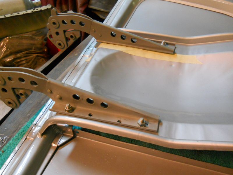

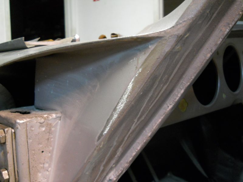

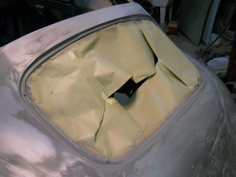

                          Fine finishing the deck lid jamb now that the bodywork to the exterior is all but complete.
                          Tying up more "redo" loose ends like the deck lid hinges. Stripped clean and ready for primer here.
                          Without the pressure of striving for a consistent reflection as I was on the exterior I am finding this jamb work almost relaxing and enjoyable. Never thought I'd say that about inner panels and jambs. Only concern here is not to sand too much and change the contour of the edge which would ruin my gaps. I'll be reinstalling the deck lid before final paint just to make sure. Thanks for looking! Justin

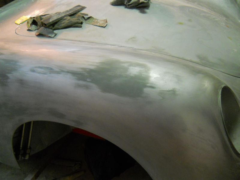

                            Blocking continues with the rest of the body though now I am down to 400 grit paper.
                            It is at such a fine stage now that if I find a stubborn low spot I'll shoot a few coats of primer to chase it out. It makes no sense now to "break the skin" and block through the various layers as that will only create more problems with the surface uniformity. More of the same tomorrow... Thanks for looking! Justin
