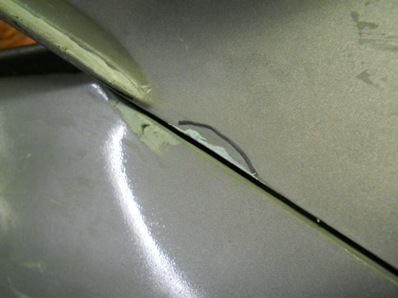

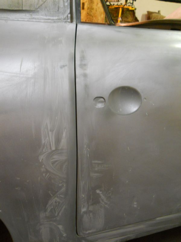

    Right jamb and threshold area now down to small nicks and the like. All highlighted with marker here. Click image for larger version

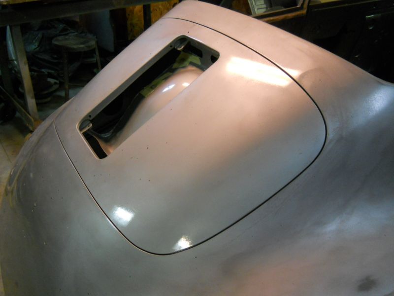

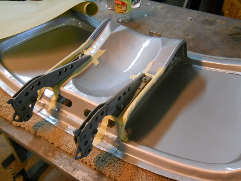

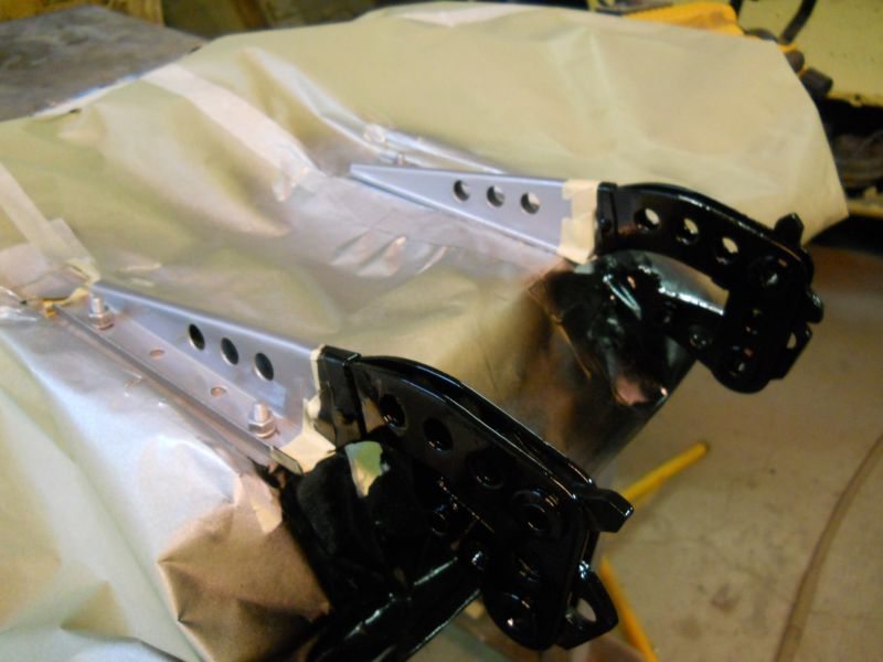

    Prepping hinges on the decklid for final paint.
    Hinges in paint and back masked here for the black.

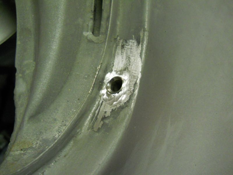

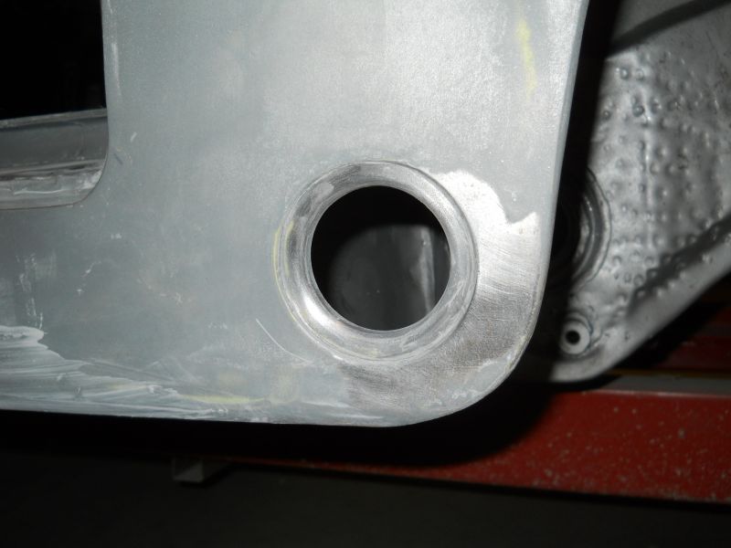

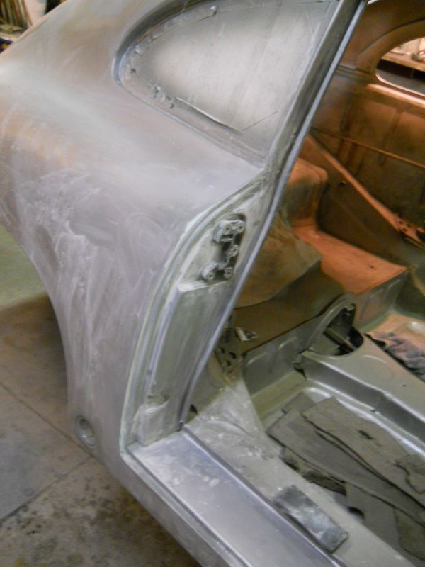

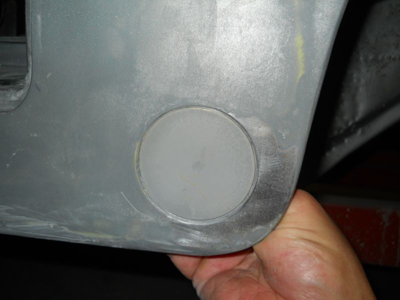

    Shaping and cleaning the shoulder of the body plug holes.

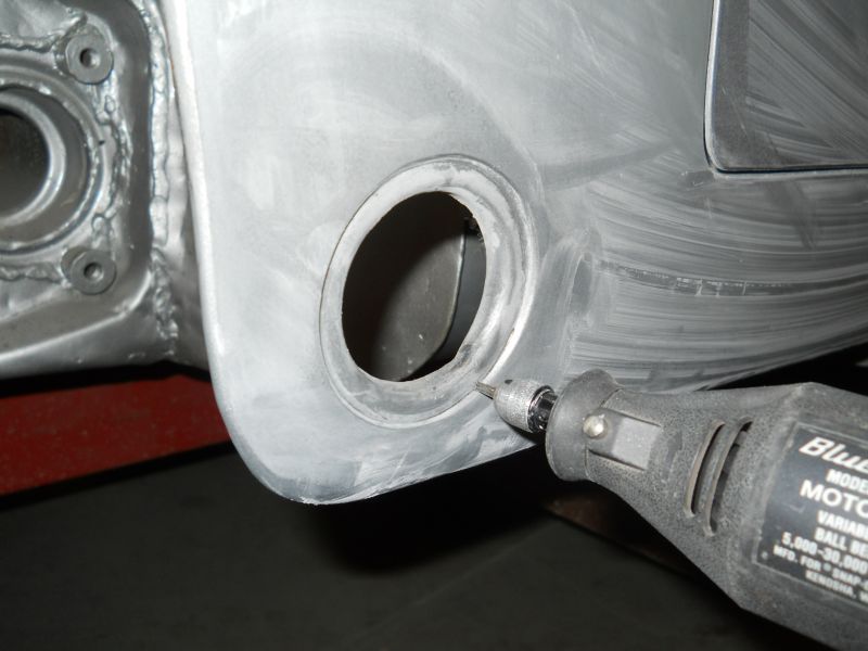

    Dremmeled out lead, putty and excess paint

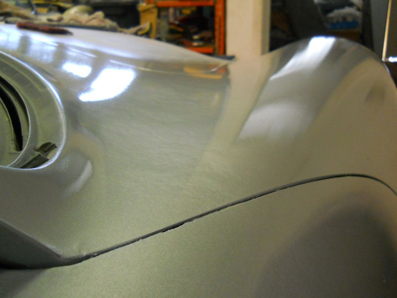

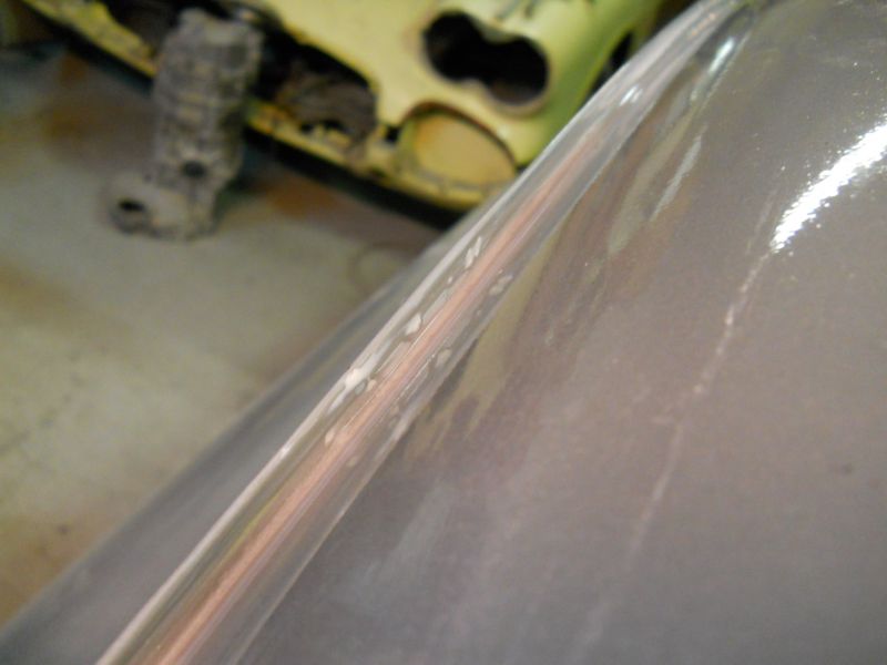

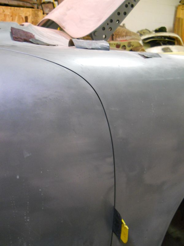

    Another detail of concern is that this "break-line"/ rolled shoulder detail around all four wheel arches is shaped and runs consistent through out.

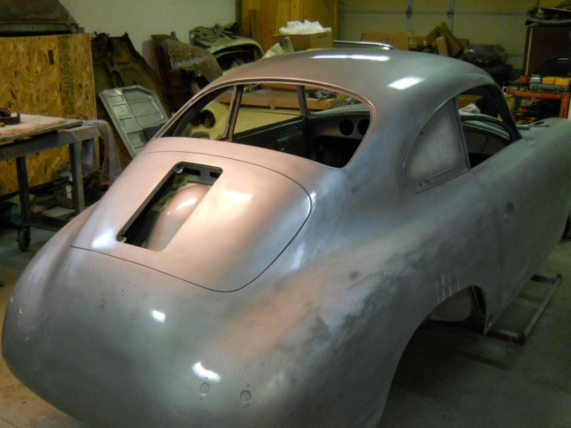

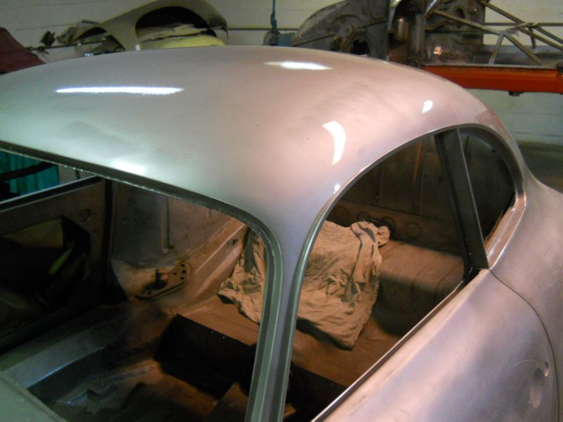

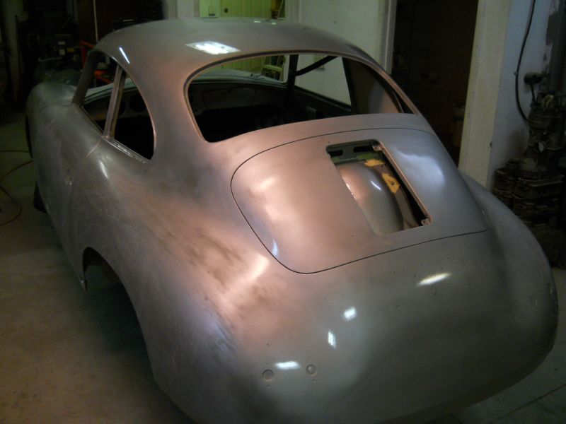

    Roof is in its final work coat here.

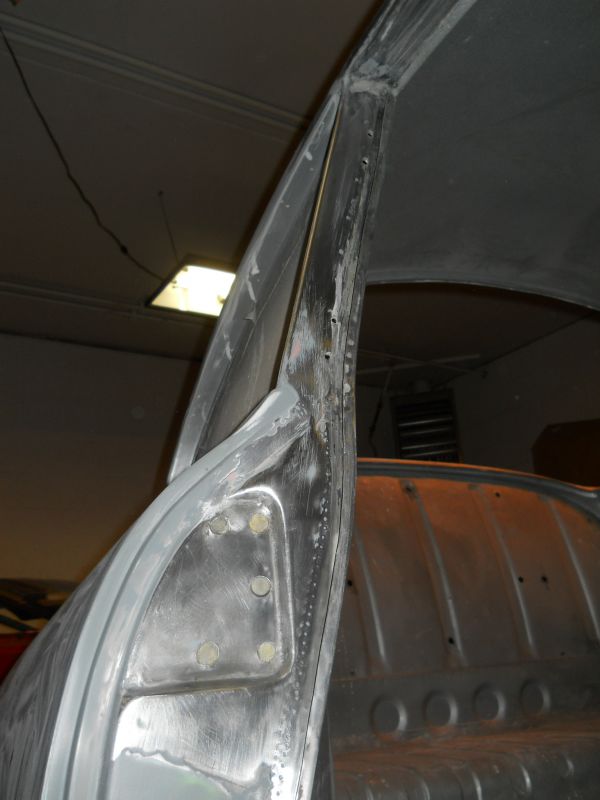

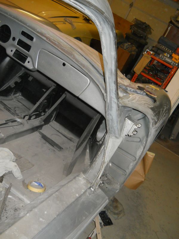

    A great deal of time spent filling, sanding and shaping all the facets in and around the gutter and window openings.

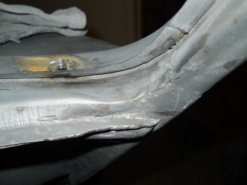

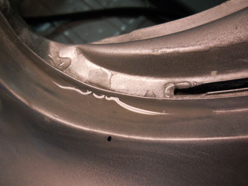

    After this final coat I still managed to overlook a few small nicks to the inner face of the gutter.

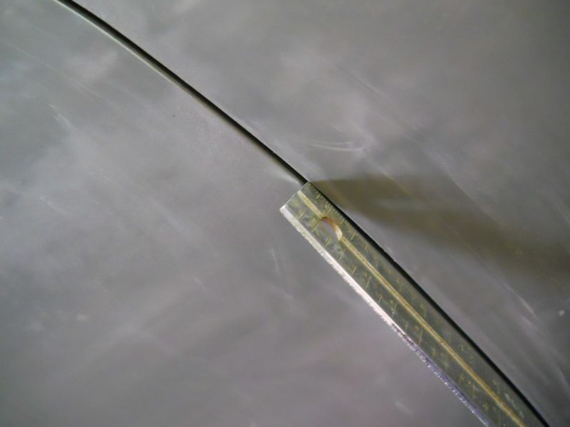

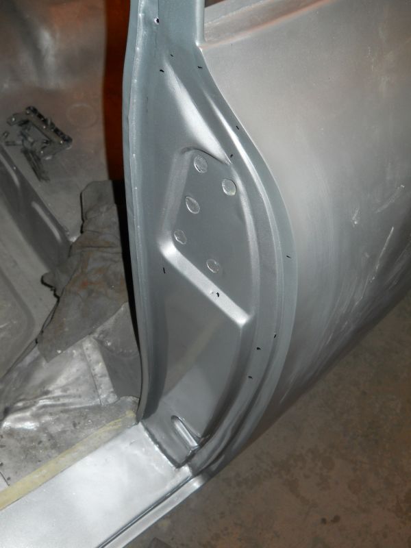

    as much as it pains me I'm slowly widening the forward door gaps to account for final paint thickness. This steel ruler is just the right thickness and is my guide.

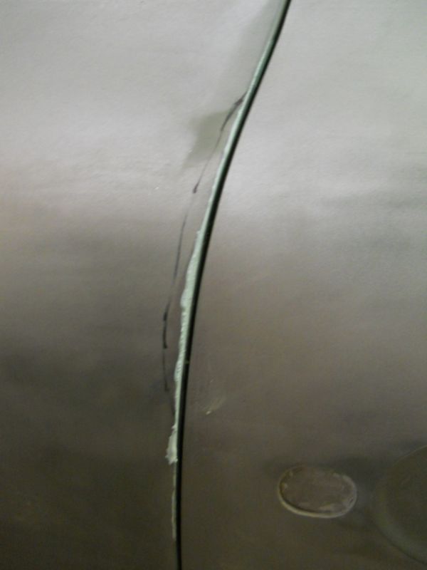

    Back filling shaping mistakes; rounded the shoulder a bit too much here.

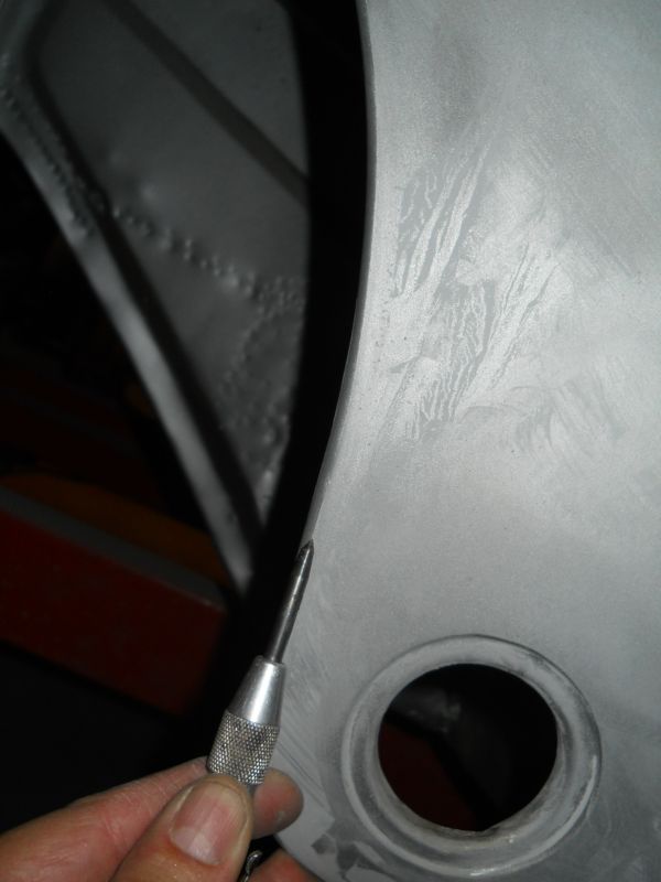

    Same story here so a bit of redo as its going. You can also see the swatch of filler along the inner surface of the gutter trying to eliminate more irregularities in the old lead.

    Getting areas like deck lid and its jamb opening in a fully completed stage helps to keep it going.

                    removed the door to finish out the striker post and jambs as I did earlier on the left side. I'm really motivated for two reasons now, I've got the paint and I suspect Tom's car is at the body shop now.

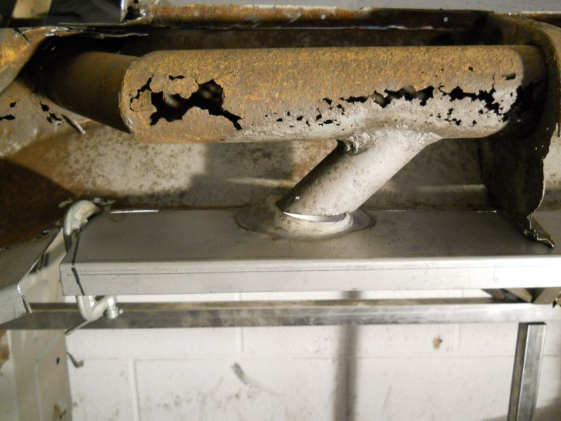

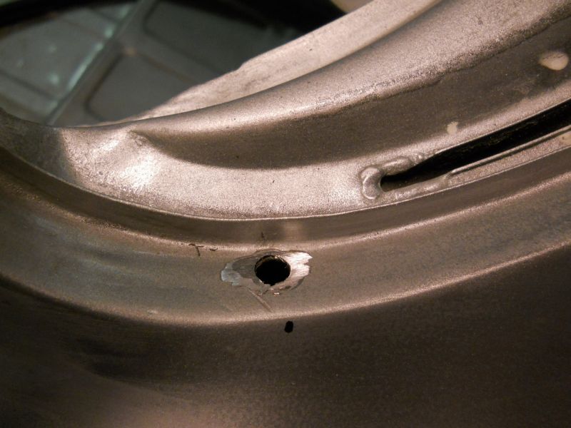

                              Water accumulation in these lower corners is another major contributing factor to the demise of the original longitudinal and related areas. As you can see Once the water level seeps or leaches over that vertical lip caused by old or poorly fitting front seals its all unfortunately downhill from there. If it wasn't soaked up by the dash padding first it easily found its way right into the defroster vents. As you can see the outer leading edge is higher than the vertical flange so any residual water is encouraged to go in, not out.

                              Here is a direct result found on the current "coupster" project from years of corner water seepage. Pooling water rusted out the bottom of the heater tube and the upper closing wall or bulk-head at the neck.

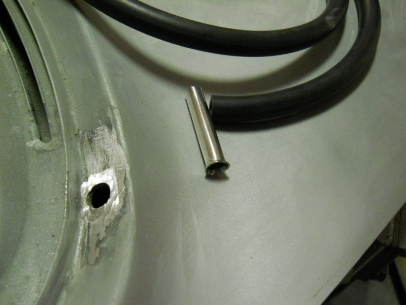

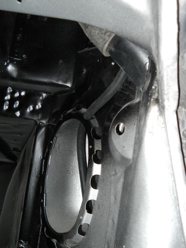

                              Drain tubes are my solution to give any water that will eventually find its way behind the front seal. Initial hole drilled here using water in my first photo to find the lowest settling point. Might be overkill as this car will never be exposed to moisture as in years past but its good insurance. There is still sleeping rust down in the bowels of this old heat system and I have a cherry original replacement dash top I don't want to see get ruined. Besides they are installed with the most minimal of modification (2 small holes) and will be all but undetectable once the car is fully reassembled. I did the same thing to the rear window frame a while back. You can see it here: http://www.abcgt.com/forum/14-356-Restoration-Projects/34-58367-The-75-Junkyard-Carrera-coupe-restoration.html?limit=6&start=54
                              Stainless sleeve insert and basic vacuum tubing ready to go.

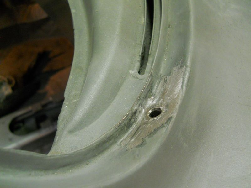

                              Flared and ready to weld.
                              welded and dressed
                              lead inserted into the tubing. After much thought about the least invasive and stealthiest exit I settled on a small hole at the base of the speaker housing.
                              Once the carpet is installed this tube will be nearly undetectable. The housing perimeter hole(s) also doubled as a great clamp to secure the tube flush against the wall.
                              Once it exits the housing it snaked around nicely in behind the hinge gusset for a secure wedge fit then finally dumps out of the existing hinge pin hole which means no more modifications to the car. Again once the door is installed you might catch a glimpse of the tubing if you really try. Finishing up the left side next. Thanks for looking! Justin
