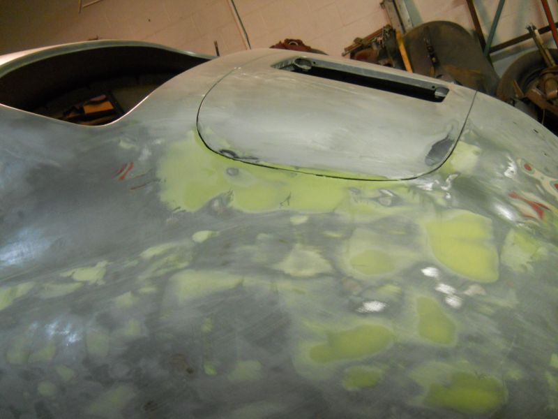

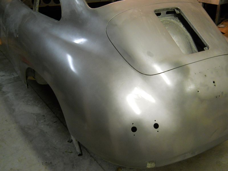

    More blocking and swatching required but its almost there. I began addressing the left vertical run of deck lid gap as well today.

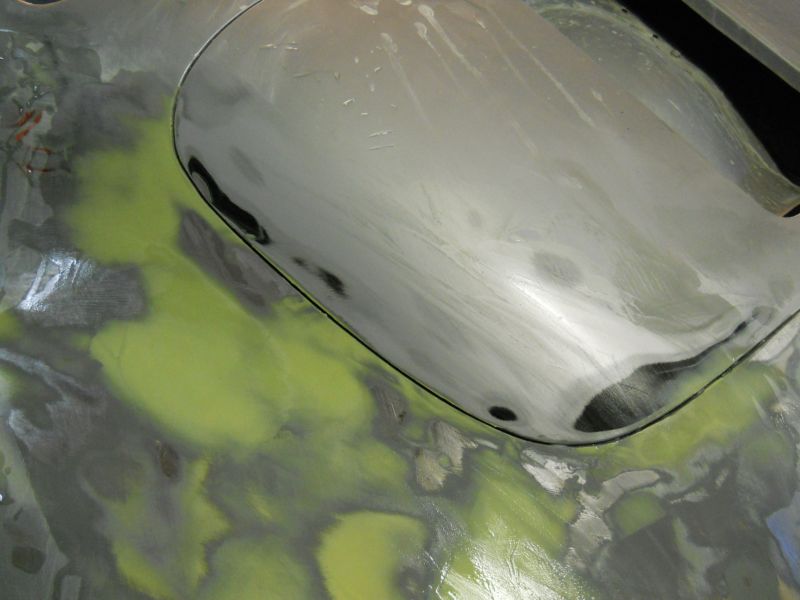

    Began to concentrate on smoothing the transition form decklid to quarter panel.
    A layer of filler was left behind on the edge of the decklid so some tweaking to that edge was required.

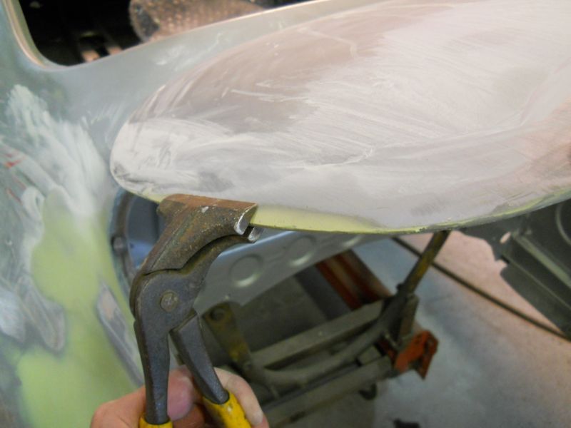

    Took my hand-brakes and began gradually prying the edge upward.
    After several tries the edge was lifted and the filler went away with the follow up block sands.
    I'm happy with the transition and the gap is just about there as well. Another primer and tracer coat coming up next. Thanks for reading this!

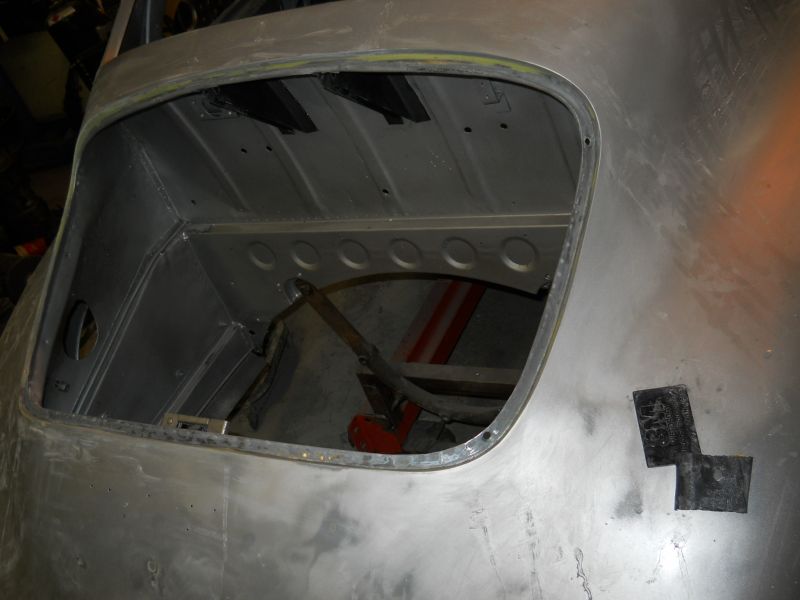

            • 11/10/13

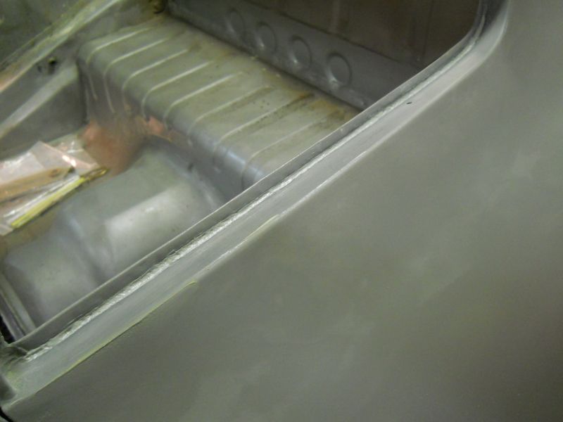

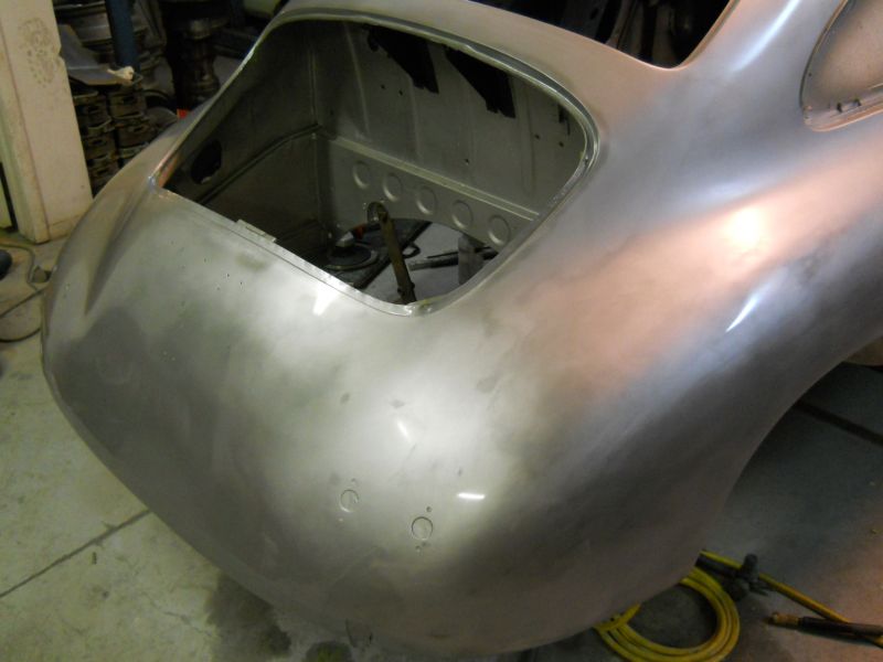

              Down to fine details at the tail end. Deck lid gaps are 99% there so with that I removed the lid (again) to address the entire jamb.
              Like the trunk area before, fine detail sanding and perfecting of these jambs is just as critical to me as the outside skin. It has to slick here when the lid goes up; Nothing worse than a shiny car with scaly or rough jambs.
              Epoxy primed and ready for the next test coat.

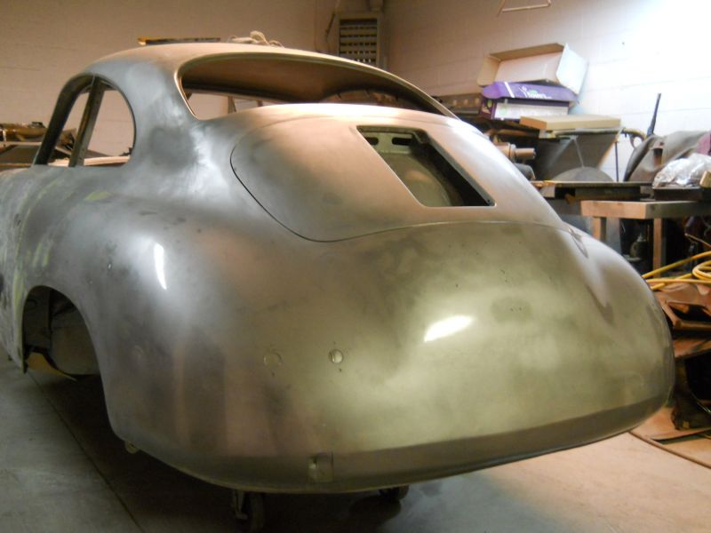

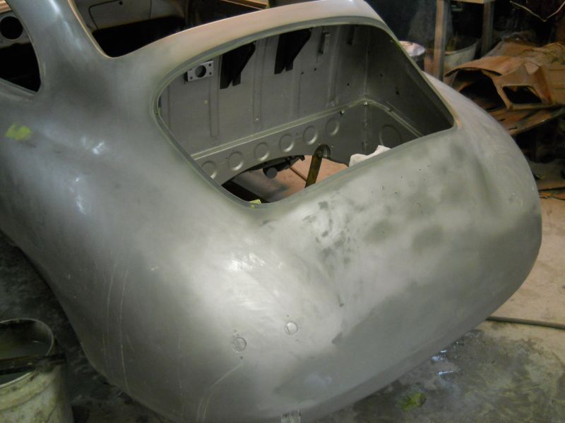

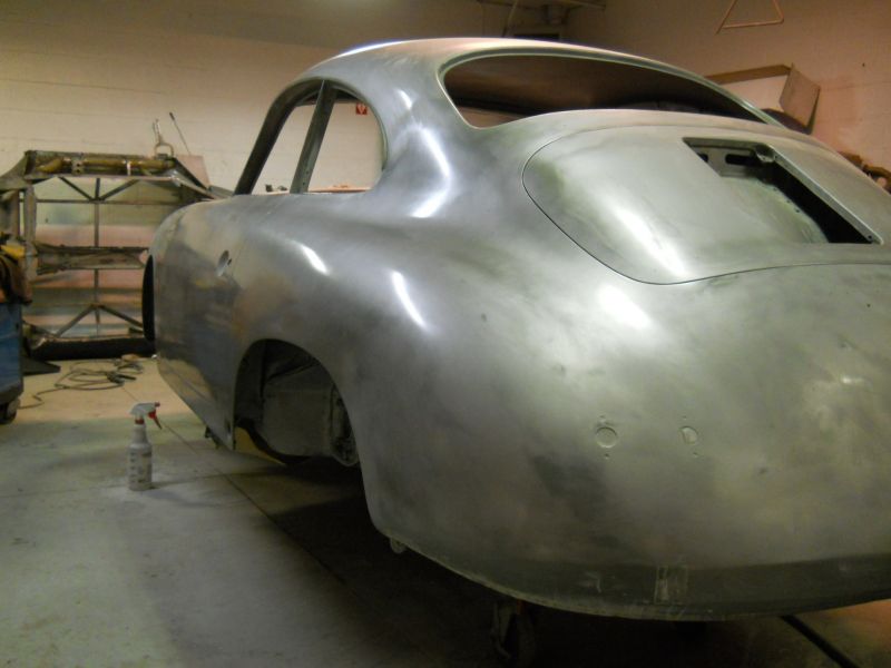

              Tracer coat applied. The tail skin is all but complete. There are few little imperfection I need to chase but they are small.
              Lid reinstalled. Not only is the tail skin about there but most of this left fender is all but finished as well. Once again I apologize if this is too in depth but I want to show those of you who may not do bodywork exactly what it takes to get a rough old turd like this car was into show quality condition. These small detail areas just don't take care of themselves and a concentrated effort must be made if you want it clean throughout. Also too; when your body shop hits you at 20K for a paint job you'll have more perspective on what it takes to bring it to a certain level. Just about ready to move onto the left door and quarter panel transition coming up next.

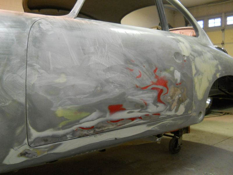

                      • 11/25/13

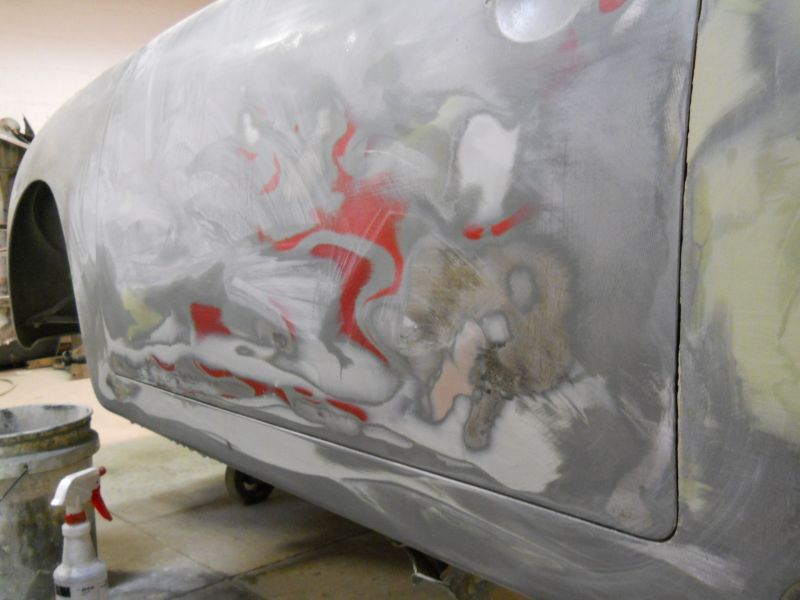

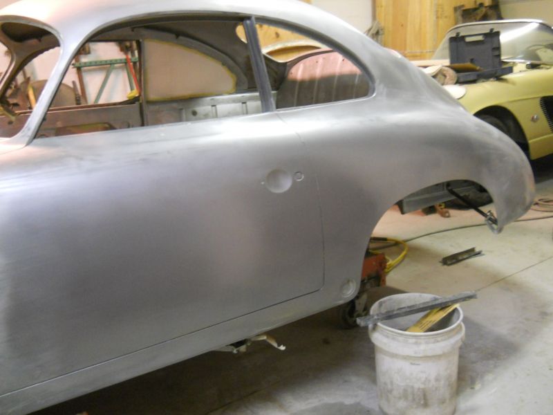

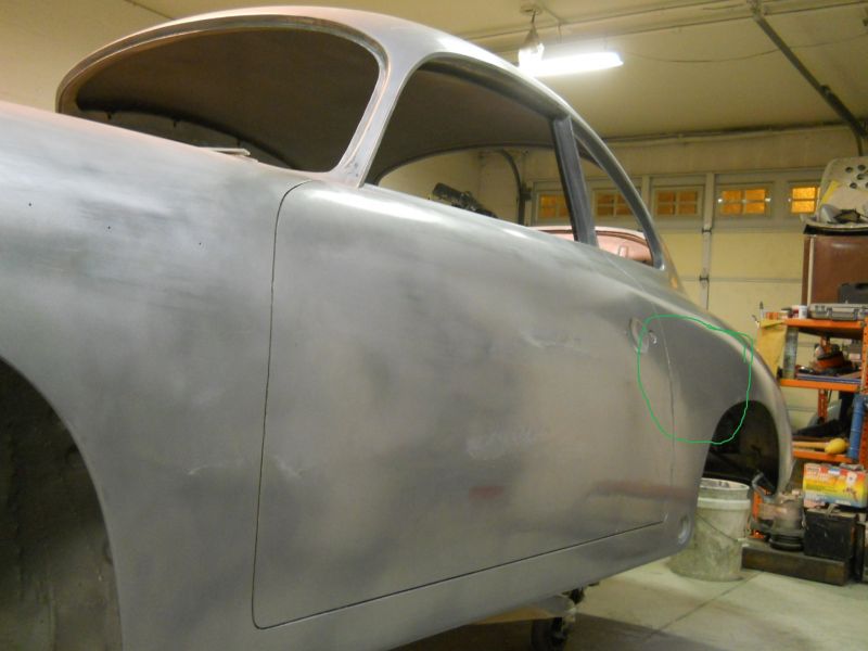

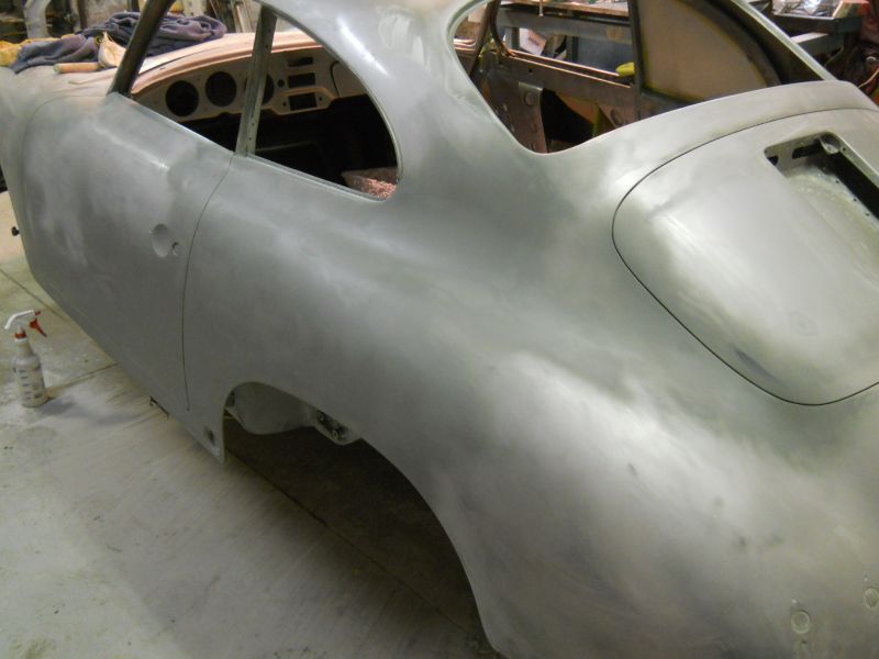

                        left side door to quarter panel contour and transition.
                        Now that the rear and back half of the fender is all but finished it was time to address this last section.

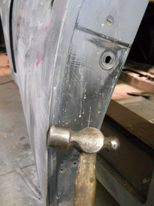

                        As with all the rest of the panels, the edges of this door had to be tapped up a bit.

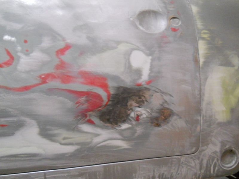

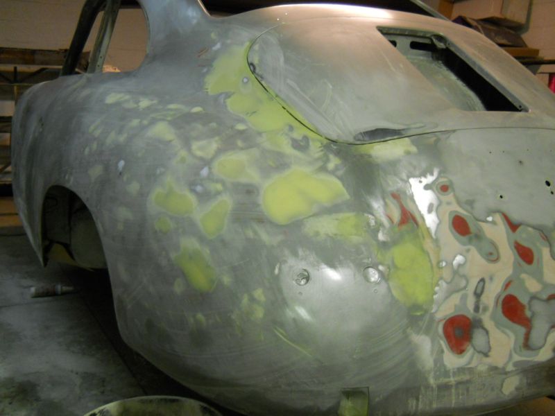

                        A definite high crowned area here which was really throwing the lines of the body off. This was due to heat distortion from a small repair patch Dad and I did to the tip of the lower rear corner back in '87.
                        After several disc passes and quenching the bulge slowly started coming down which immediately improved the overall shape of this area.

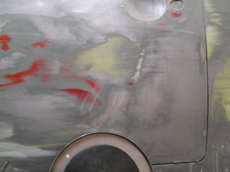

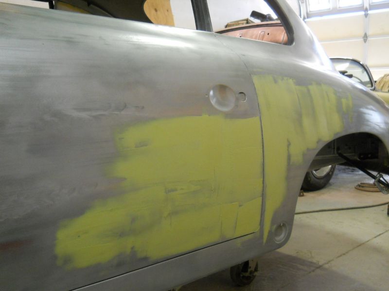

                        Another trouble spot with this door was a crowned ridge just above the lower edge. This is 100% factory, the door has never been hit and this lower run did not need rust repair save for that small one on the very back corner. Being factory I never questioned its shape and mindlessly began filling the surrounding areas to correct and compensate for it.
                        You can see here how much area that initial hump occupied once I was done chasing it.
                        After several disc passes and block sands this area too began improving.
                        Panel is fitting better with its surrounding and the filler is getting thinner; what more could a guy ask for?

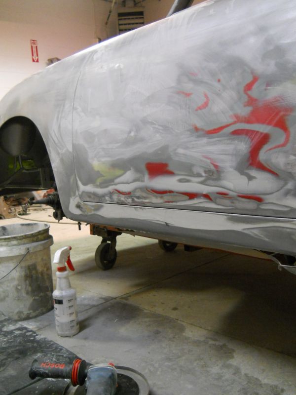

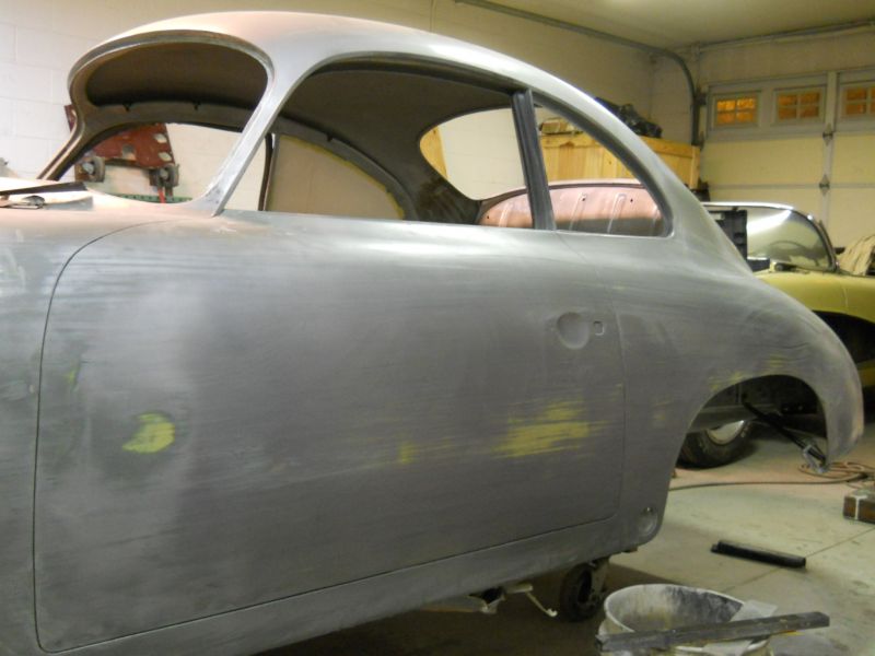

                        After almost 4 sessions I had the shape and general transition contour I wanted which now matched the right side much better. I put another coat of primer over it and prepped for another test coat to see where I was at with it.
                        As with the right side I laid down a bead of drip-check on that lower quarter window pinch seam.
                        Getting the area behind a uniform color helped even more. Even after all that I have been through with this body I was still a bit hesitant and intimidated to disturb things for fear of making it worse but I had no choice if I want this thing in final paint after the first of next year.
                        This next test coat was applied the following day.

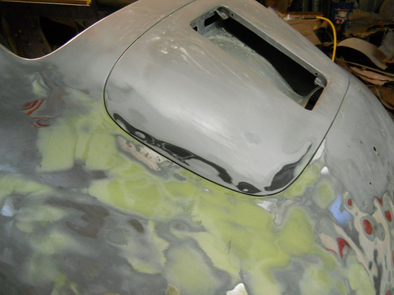

                        I now had the body contour and panel fitment I wanted.

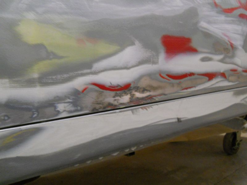

                        Subtle waves and irregularities remained and were of course expect as the refection moved down the body but all were extremely faint and can be perfected with one more thin swatch of filler. The heavy lifting is done. Thanks for stopping by! Justin

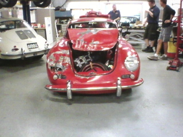

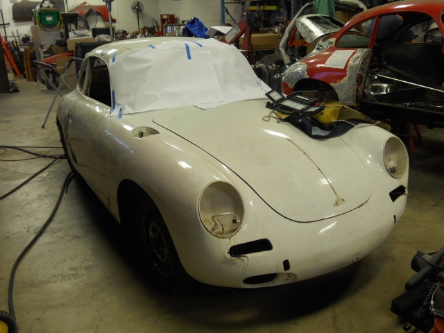

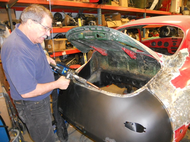

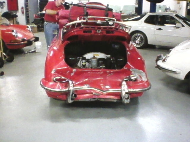

                          • Justin,
                            REALLY nice work.
                            Down at the Lufteknic shop here in RIC last week I have been 'assisting' Chris on a pair of doors for a T6 coupe that got hit by a pickup, sat in another shop for 5 years or so and it will be nice again.
                            I have sent Chris the link of your work since he will know what you are doing.
                            Last week he was grinding the weldment on the inside of the door, where the lower door skin was mated, to smooth it.
                            I said, "Chris that is what sets you apart from other restoation shops, the detail work!"

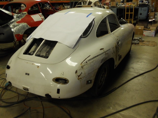

                            I don't have any pics of the doors in work, but here is the car.
                            The red T6 coupe behind the white one looked like this when it came to the shop after being 'crunched' between two SUVs.
                            and
                            It is coming along!
                            New rear sheet metal from Trevors.

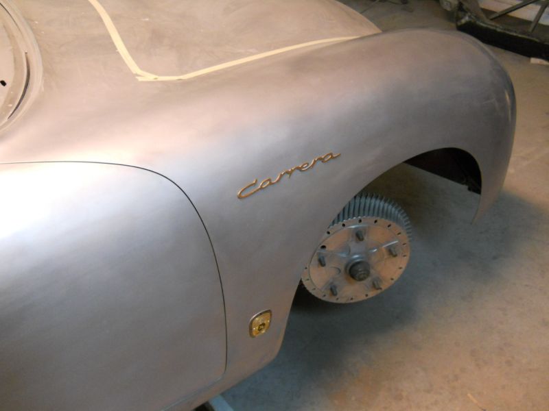

                              Just a mock-up shot I took for fun a few weeks back. Trying to decide weather to have Victor Miles re-gold plate these emblems or just leave them raw? Still shy about running that cherry original Reutter badge; I think its worth more than car at this point.
                              Thanks for looking! Justin

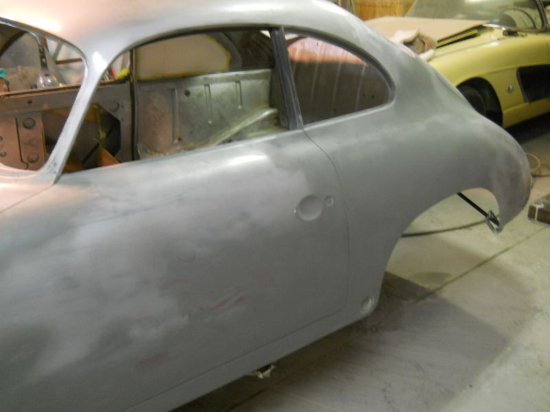

                              • 11/30/13

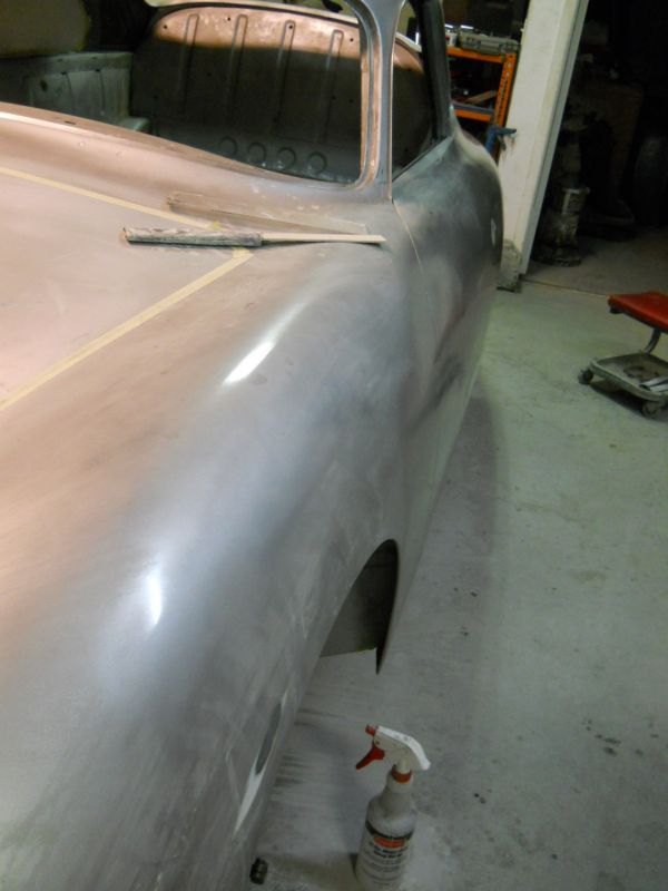

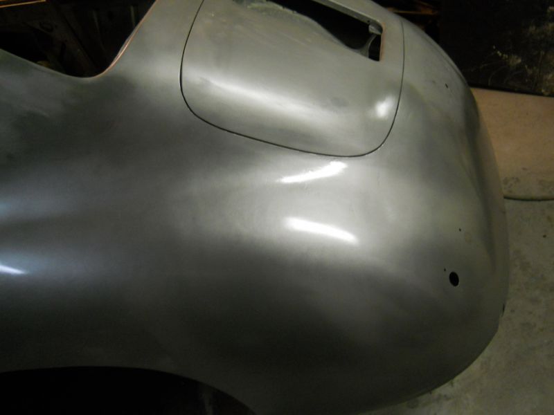

                                Getting the last of those pesky waves and "rolling" reflections out.
                                The irregularities That remain across this side are now so gently rolling and faint that they are nearly undetectable by feel. To get these to even out,a long section of hard metal bar stock is my sanding block of choice.

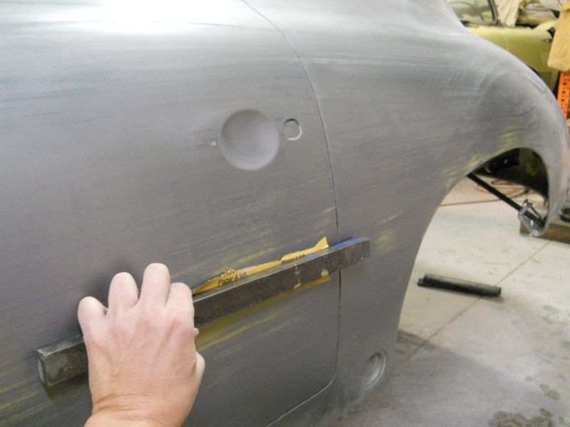

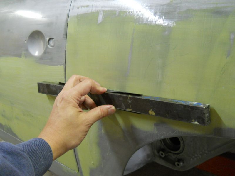

                                To get this long surface reflection uniform requires long even strokes across the entire run. Each pass here began about mid-door all the way to the apex of the rear wheel arch.(glad my work seat has castor wheels) As you can see all the slight highs and lows that are bending the reflection are showing with that hard unyielding metal bar.

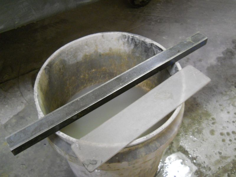

                                For this stage here is my tool of choice as a sanding block. Its square and most importantly unyielding. Even my plastic block pictured next to it which I am so fond of would slightly flex and fall into those long rolling waves. The block has to be hard to ensure your only hitting the high spots.
                                This last swatch of filler will take it the rest of the way in.
                                Again long even strokes with my bar stock.

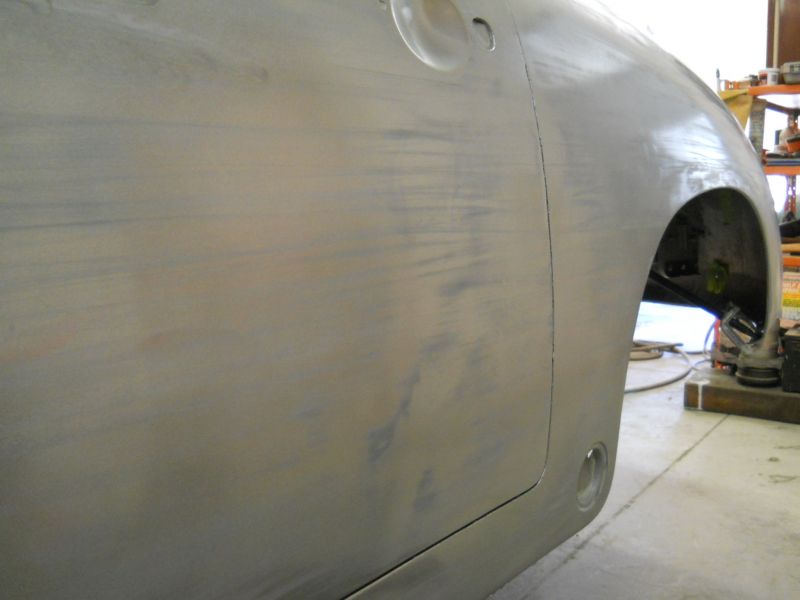

                                Repeat next day: long even strokes across the surface
                                Its so close... but I'm not done yet. I am officially past the use of plastic filler though. The irregularities that remain are so slight that applying even the thinnest of swatches would be counter productive. I'd end up creating new low spots on either side of the swatch as I sanded it and in a sense would be chasing my tail. To finish this now will require only blocking and chasing it with primer and paint coats. two maybe three more rounds should do it but we'll see; Repeat tomorrow. Thanks for stopping by! Justin
