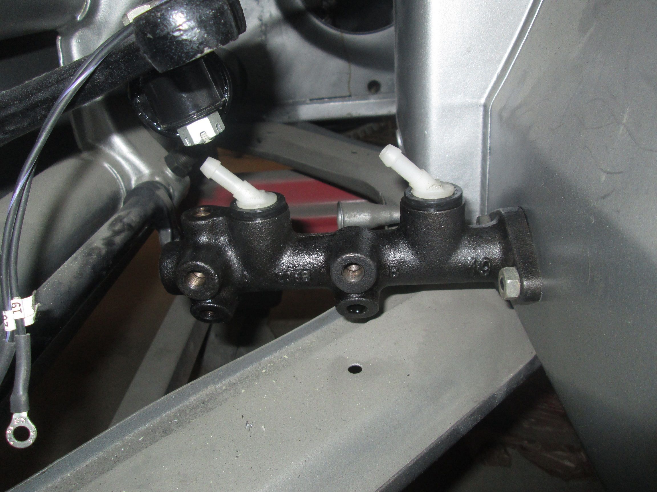

  • Dual circuit master cylinder:

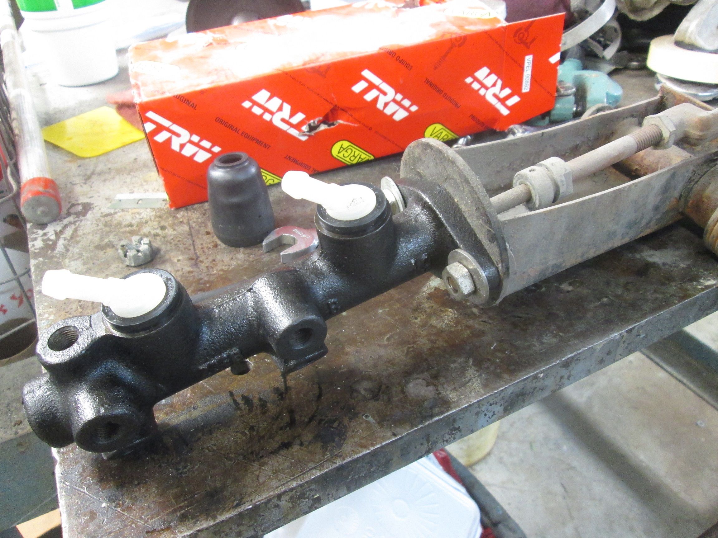

    Click image for larger version  Name:	IMG_8582.jpg Views:	0 Size:	632.2 KB ID:	112857 Making the additional upgrade and safety of a twin circuit master cylinder. I didn't buy the conversion kit but opted for this new 19mm VW bus unit by itself for 25 bucks. I'll fabricate my own hardlines as it goes. I pulled it apart and seasoned the outer surface with oil and heat to keep any flash rusting at bay. Same treatment I give all of the original bolts elsewhere that aren't zinc plated. Reassembled and mounted on a 356 pedal cluster. The mount flange comes threaded for a bus application but quick ream with a drill makes it ready to accept the studs on a 356 unit.
    Click image for larger version  Name:	IMG_8583.jpg Views:	0 Size:	542.2 KB ID:	112858 Mocked up in the car for the first time. A little longer than the original unit but no foreseeable clearance issues. It requires a remote reservoir will be much more convenient later on. Click image for larger version  Name:	image_65443.jpg Views:	3 Size:	500.9 KB ID:	112859 Ashley Page was kind enough to send me this really nice remote tank and elbow fitting some time back. It went back into the box for a while as let my mind work on a mount that would not require any modifications to the original GT tank access cover.

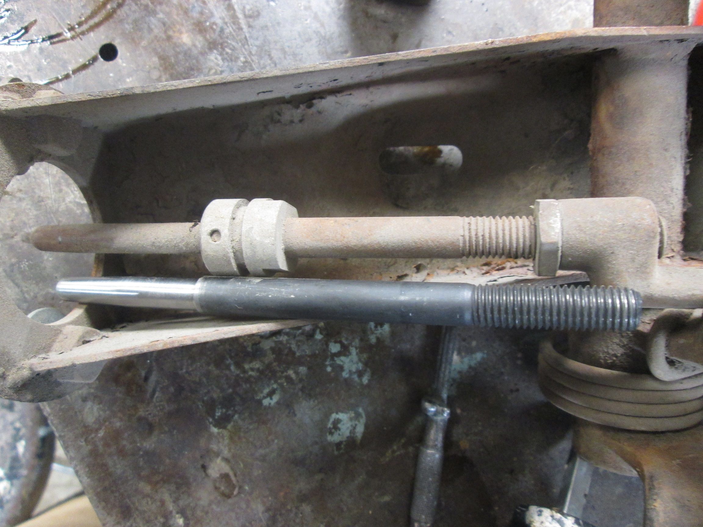

    Click image for larger version  Name:	image_65444.jpg Views:	3 Size:	570.3 KB ID:	112860 Ashley also said that the original plunger shaft would be a little short for this application so he also included this custom made plunger when he sent me the tank. Looks to almost identical to an original but I'll know for sure as this conversion goes. Thanks again for everything Ashley!

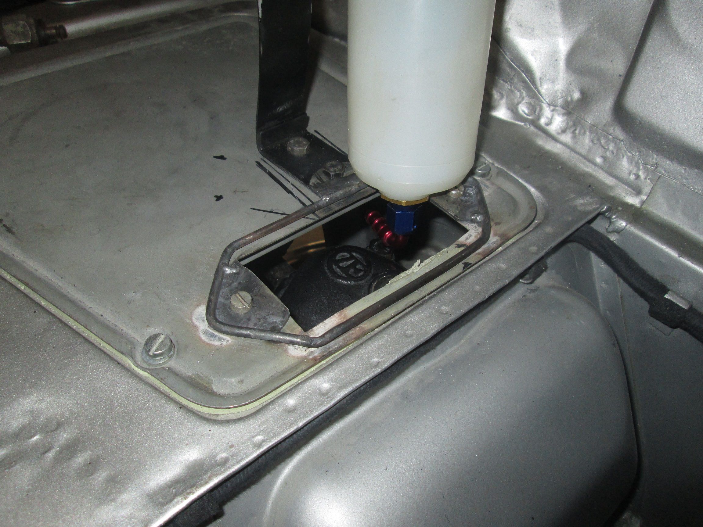

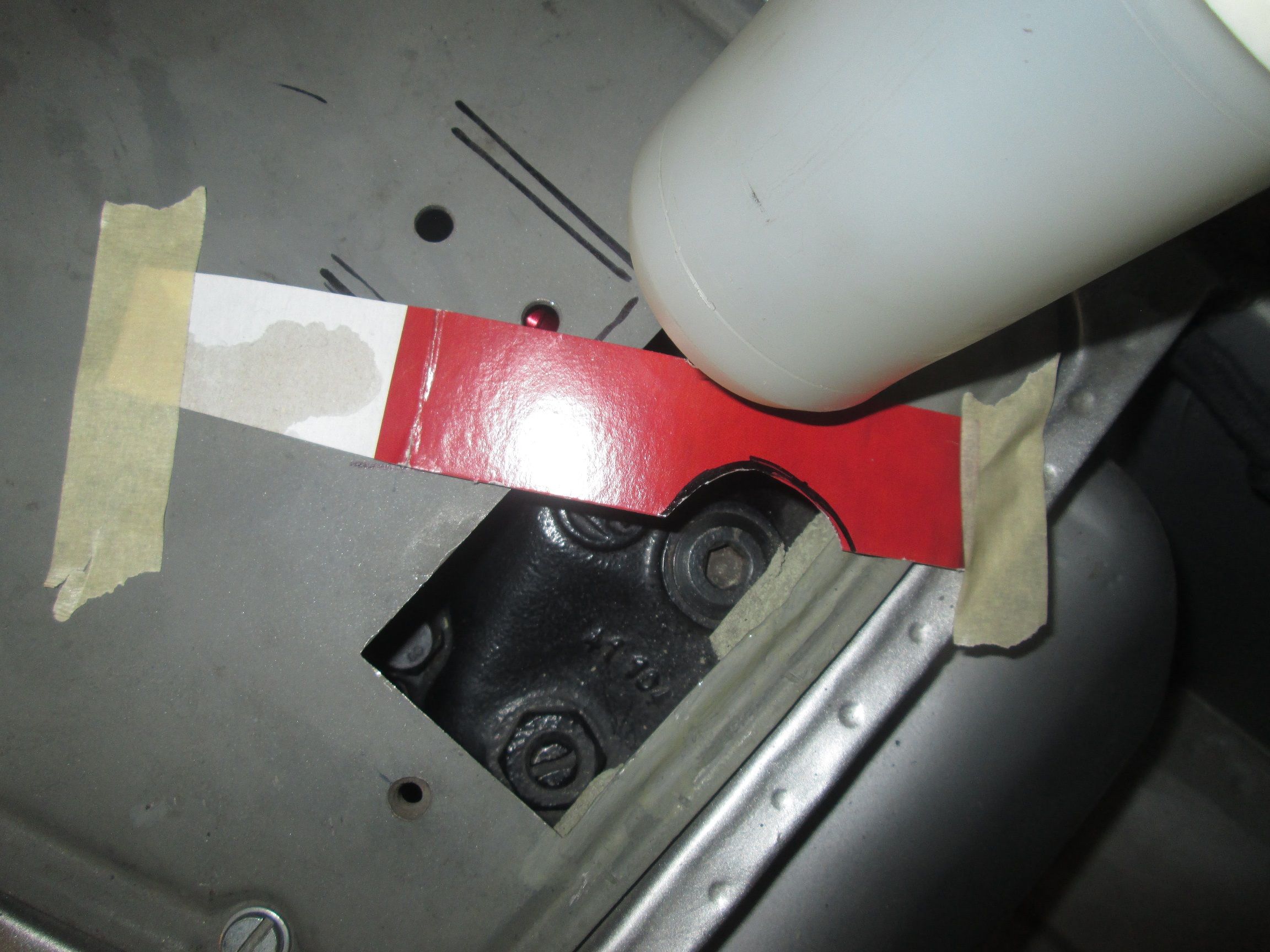

    Click image for larger version  Name:	image_65445.jpg Views:	3 Size:	423.6 KB ID:	112861 The initial parameters of this new mount was to have it up and out of the way as far as possible while still leaving me access to the steering box adjustment and fill cap; and again with no modifications to this access cover/gas tank mount.

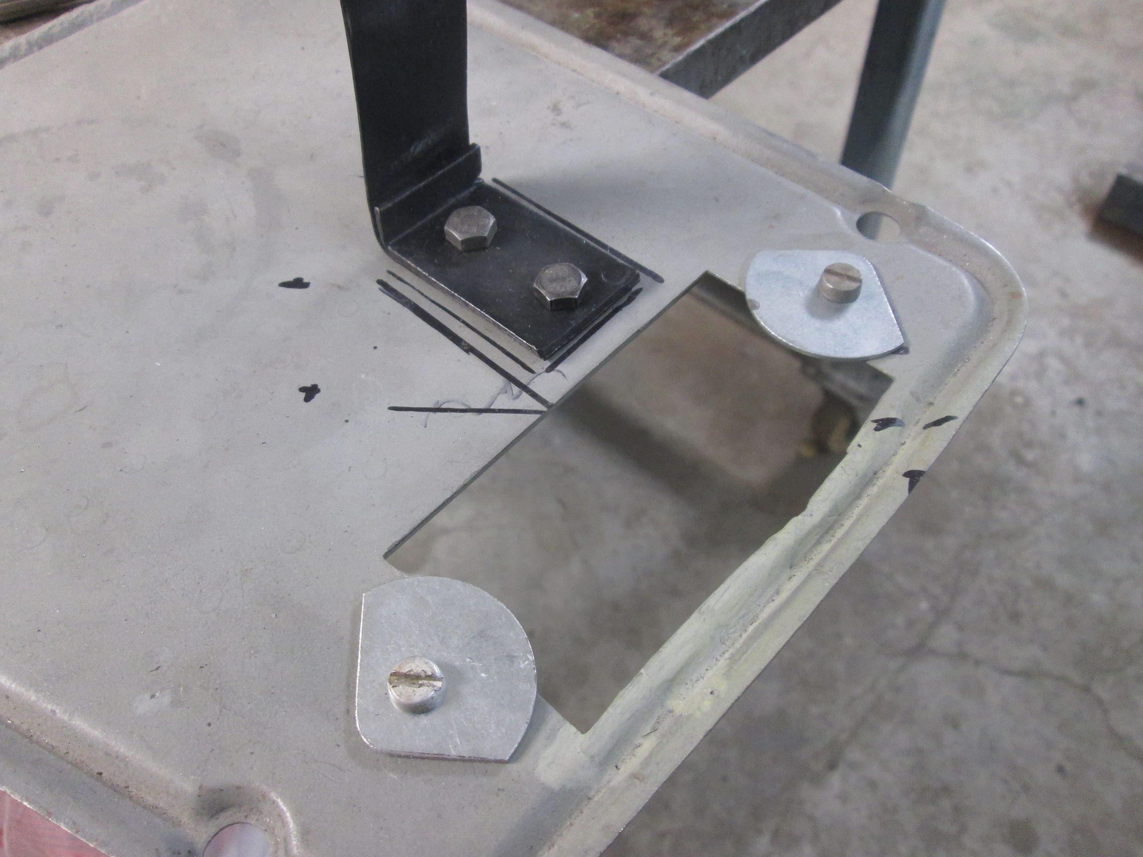

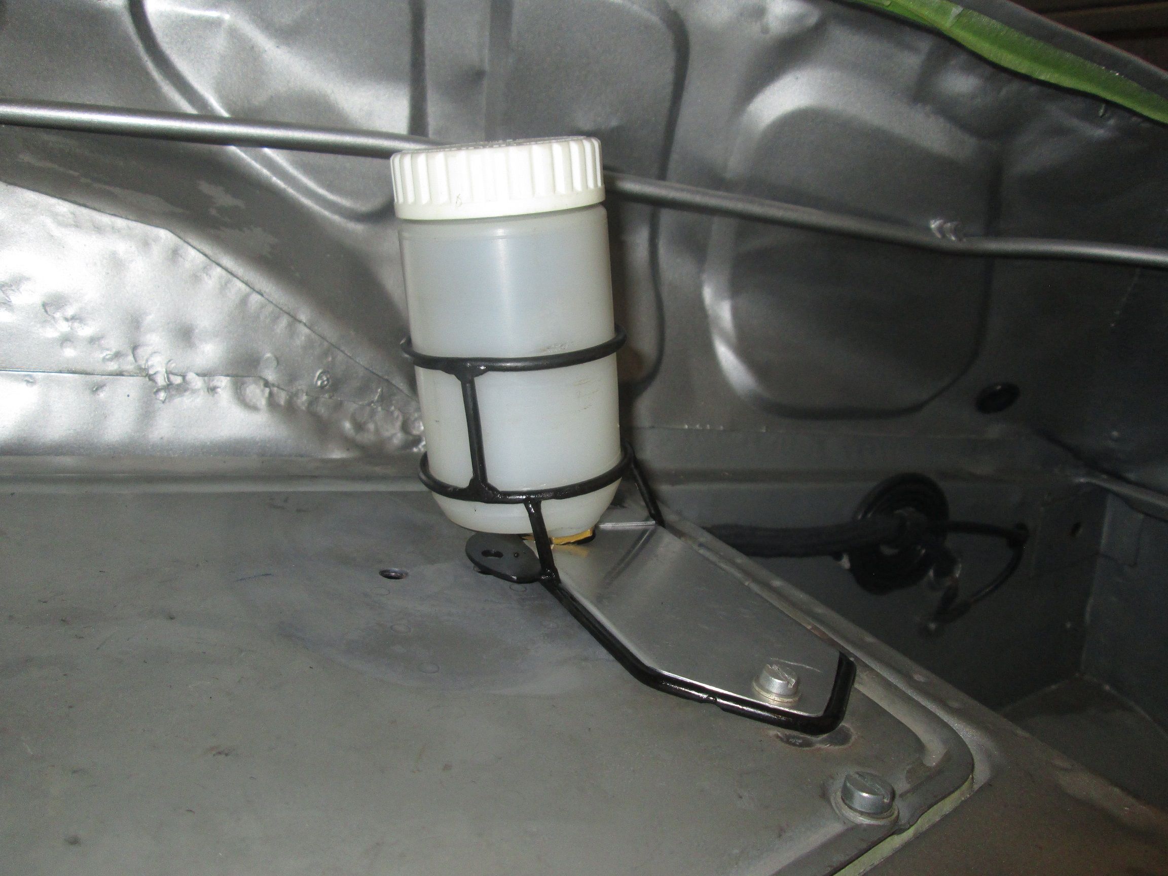

    • Removable wire base frame.
      Click image for larger version  Name:	IMG_8599.jpg Views:	0 Size:	489.7 KB ID:	112863 Decided on a small gauge wire frame that would work off of the existing access cover holes. Base plates from a couple of large washer cut to initial shape here.
      Click image for larger version  Name:	IMG_8600.jpg Views:	0 Size:	488.3 KB ID:	112864 Begin wrapping the wire base around the contoured shoulders. The final mount frame will have the same foot print of the original cover.
      Click image for larger version  Name:	IMG_8601.jpg Views:	0 Size:	632.1 KB ID:	112865 The basic frame completed with an additional tie in at the forward tank strap bolt for a third attachment point.

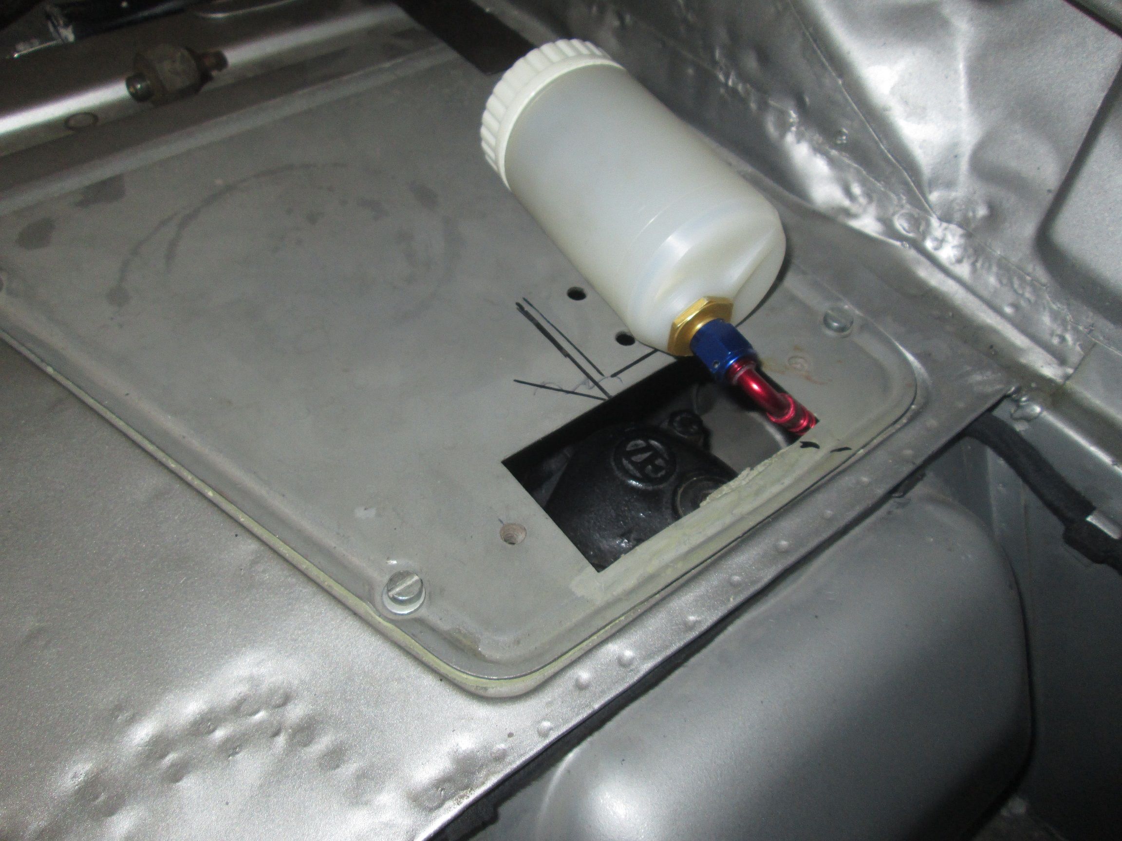

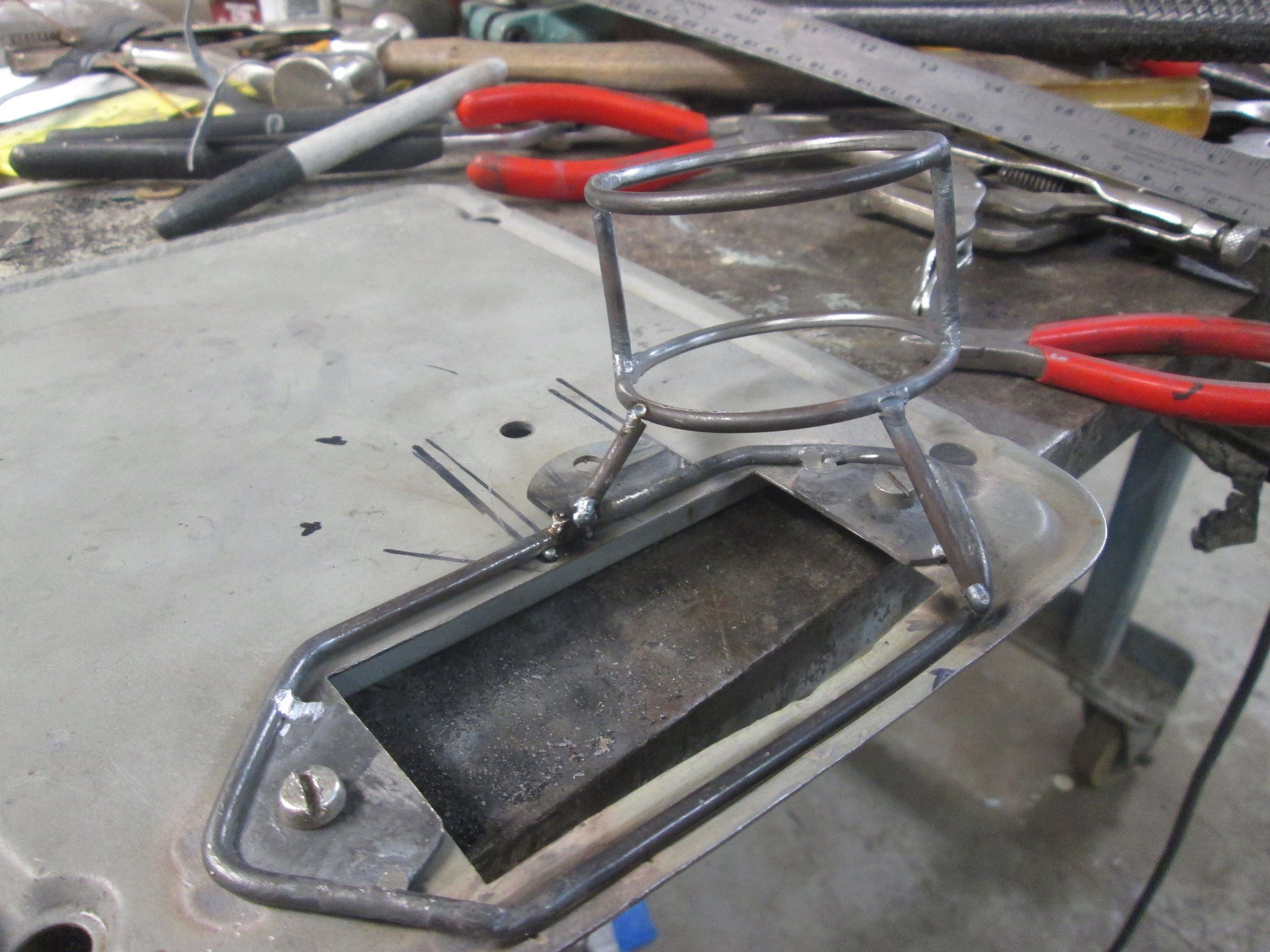

      Click image for larger version  Name:	image_65449.jpg Views:	3 Size:	611.9 KB ID:	112866 The tank will sit back and over as far as the fitting elbow will allow. Next step was making the cup holder frame.
      Click image for larger version  Name:	image_65450.jpg Views:	3 Size:	588.6 KB ID:	112867 Settled on a twin ring version for added rigidity and support. Next was adding on some legs to both locate and attach it to the base frame. More on this later.
      Thanks for looking.

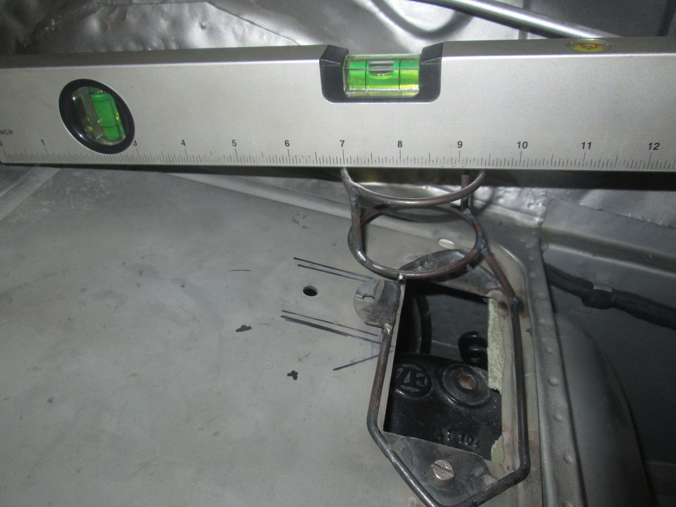

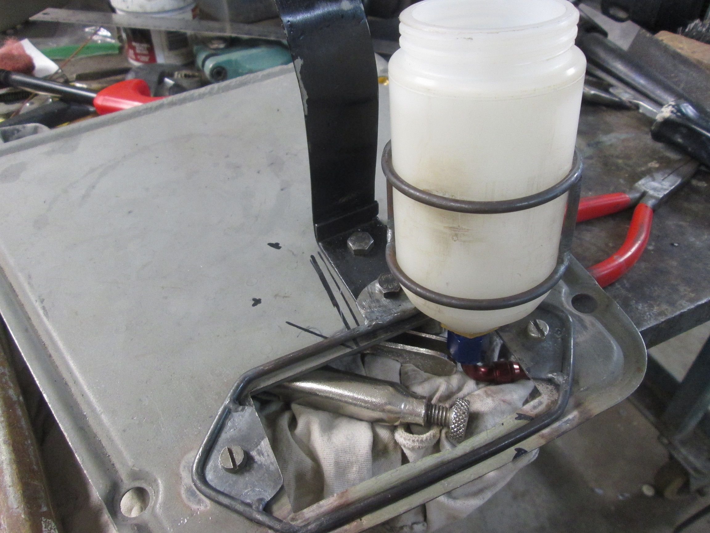

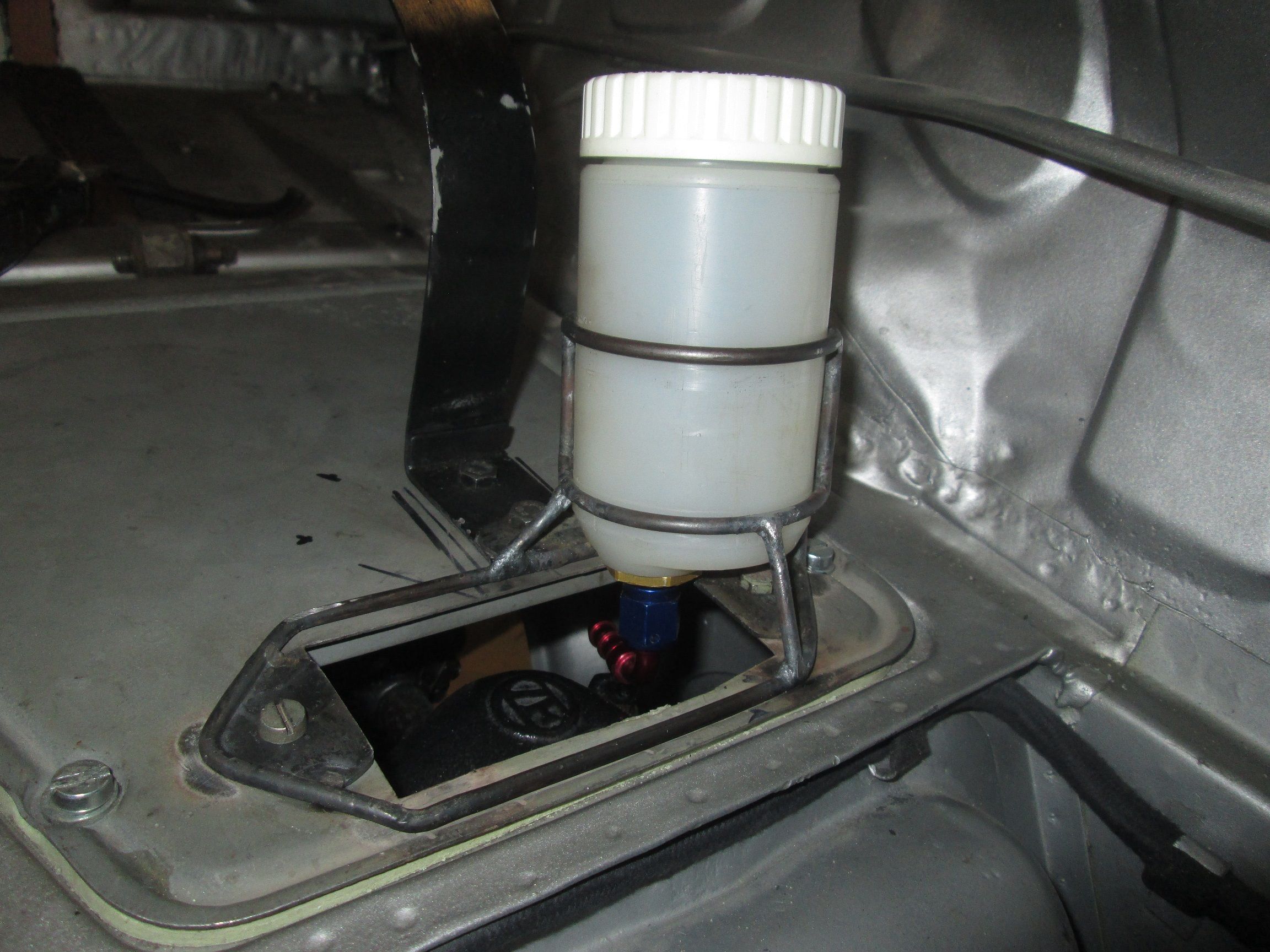

      • remote reservoir mount and access cover complete.
        Click image for larger version  Name:	IMG_8604.jpg Views:	0 Size:	562.7 KB ID:	112911 It took some adjustment and fine filing but a firm friction fit for the cup was achieved. It takes a good bit of twisting and pulling to get it out of there so its very secure.

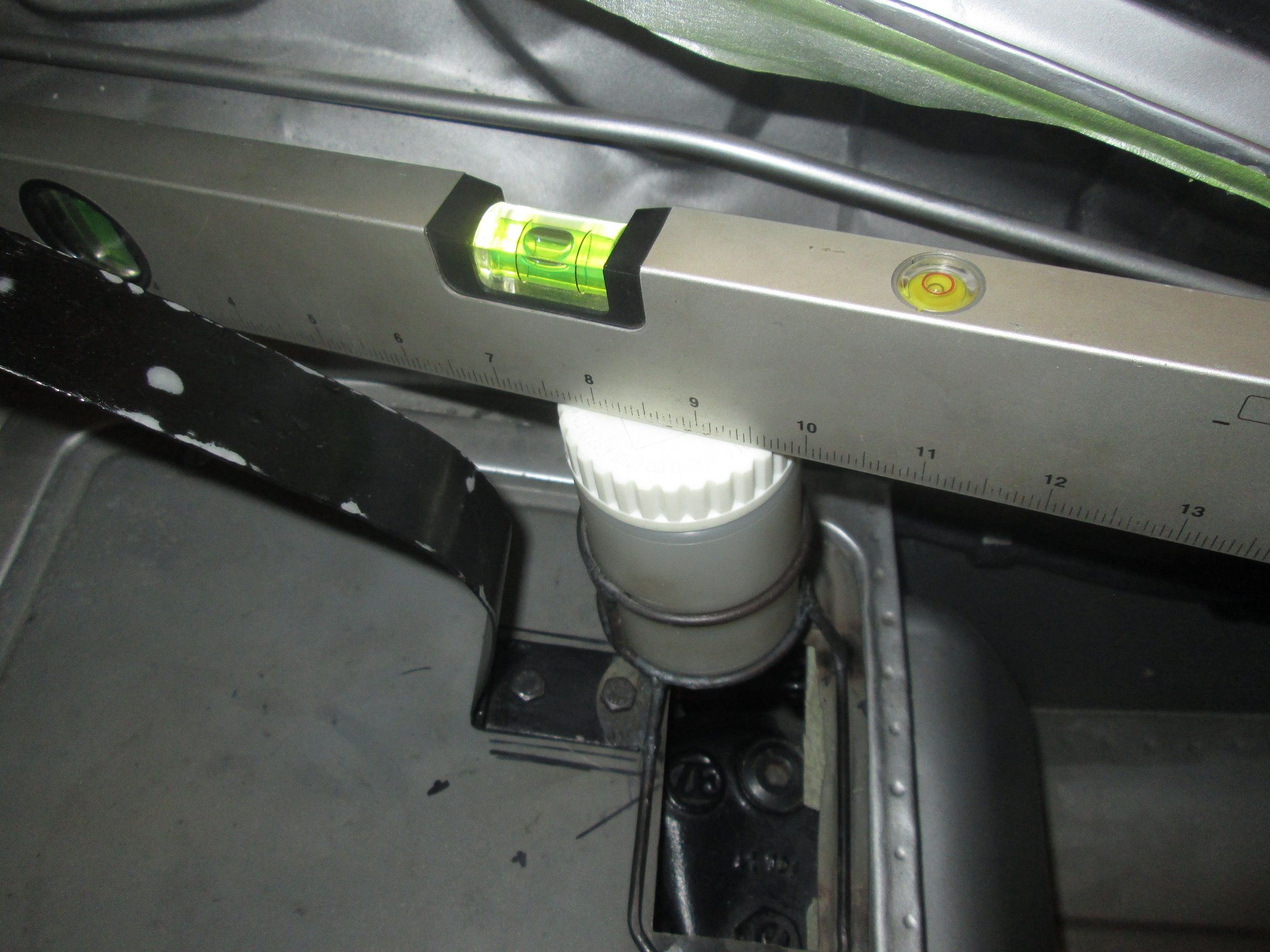

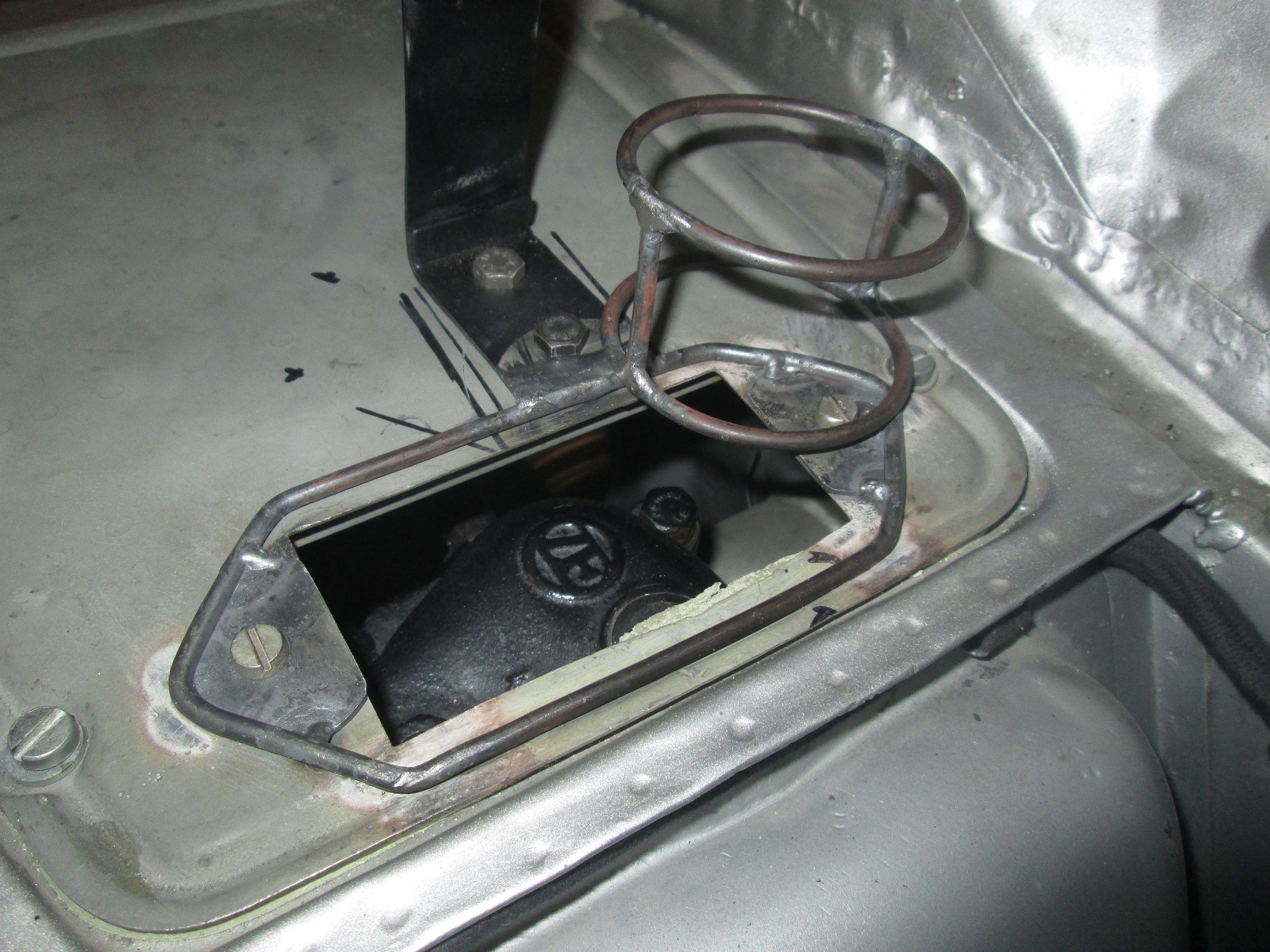

        Click image for larger version  Name:	IMG_8619.jpg Views:	0 Size:	478.5 KB ID:	112912 One leg tacked in and now dialing in level for the next leg to lock this angle in.
        Click image for larger version  Name:	IMG_8620.jpg Views:	0 Size:	576.1 KB ID:	112913 That position now set with a second leg with one more to add to finish this mount.

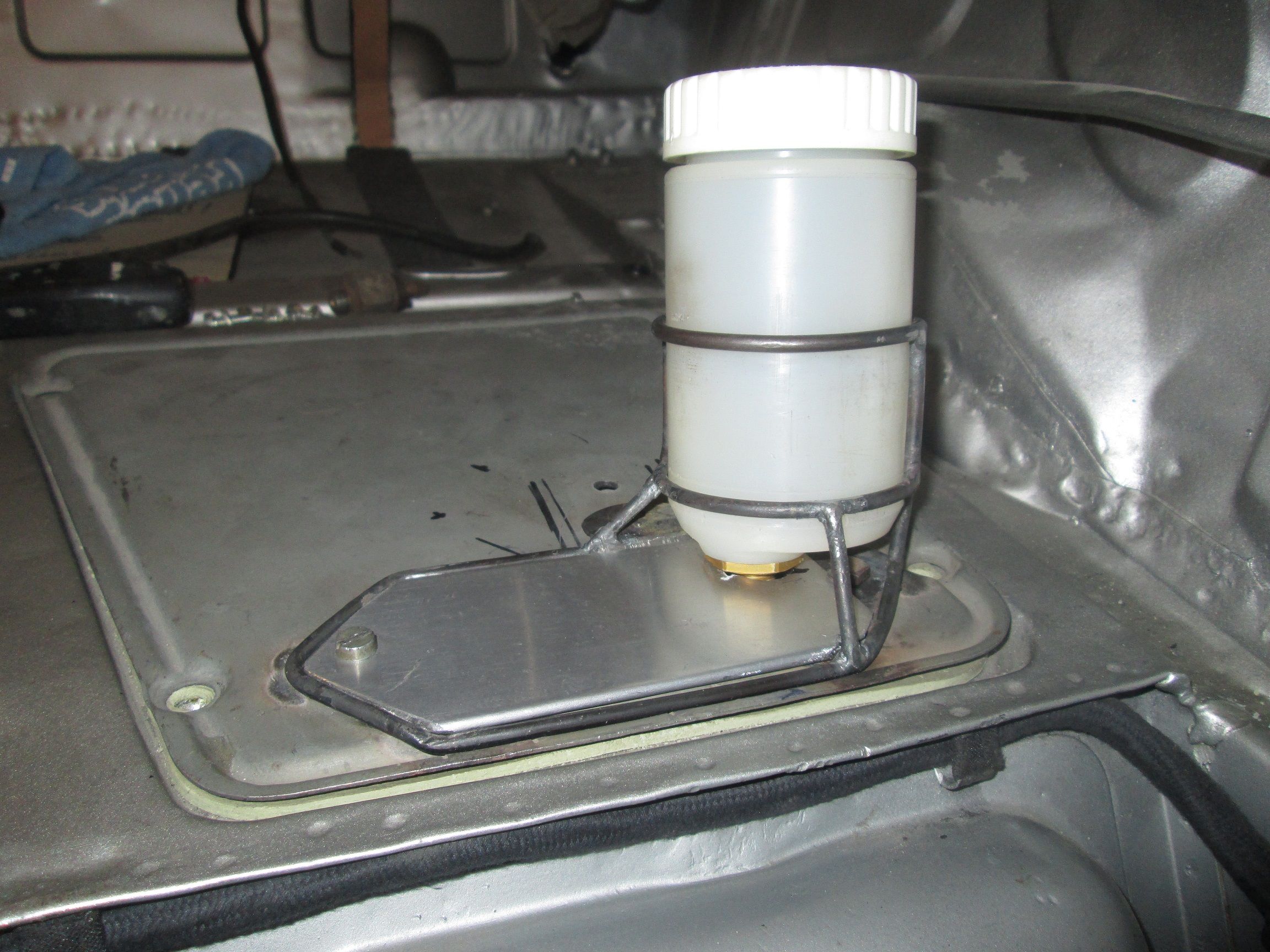

ID:	112914 Mount now completed with a reservoir mock up.
ID:	112915 One more confirmation to ensure level was maintained. All set, now onto the final access cover plate.

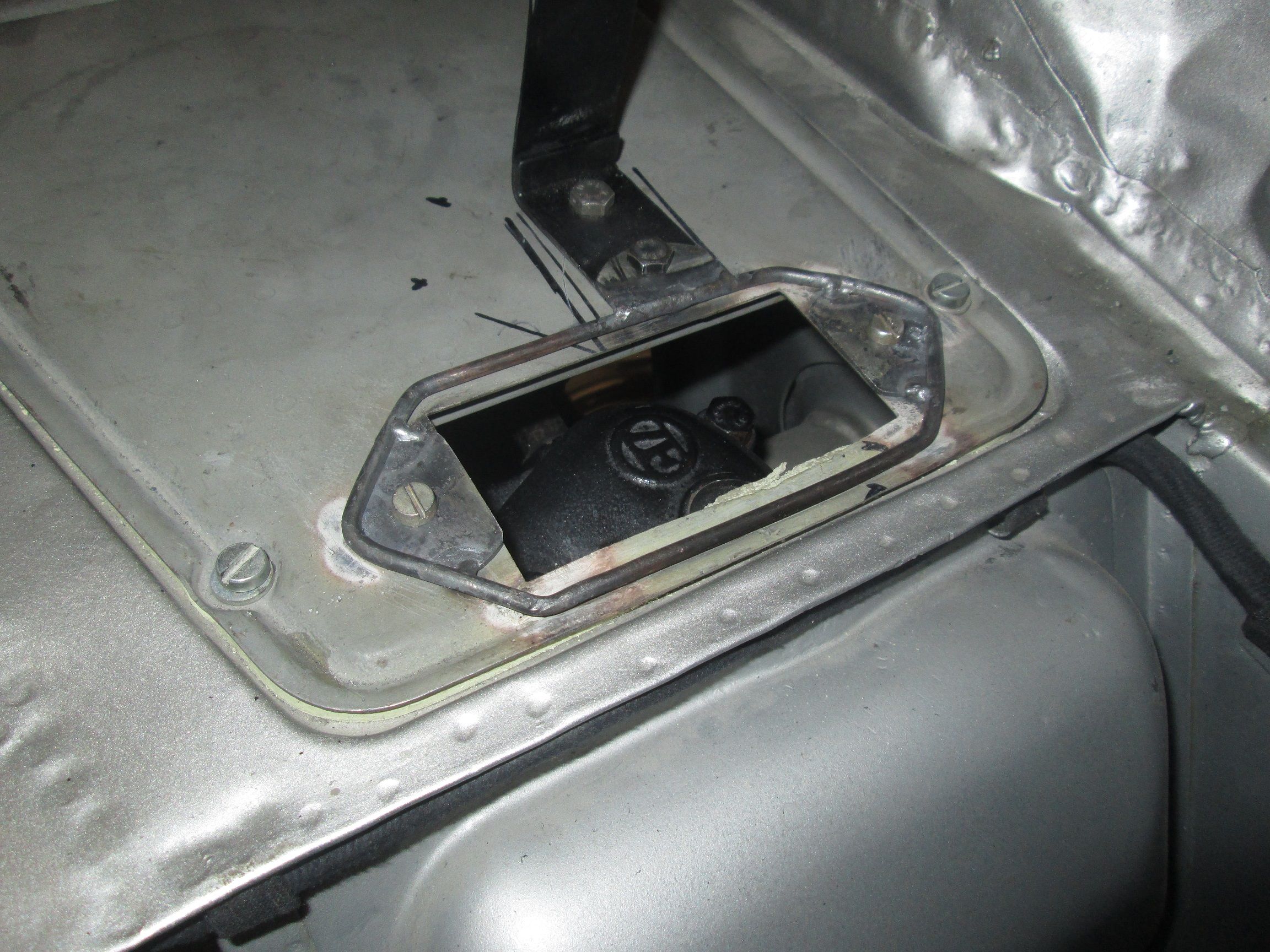

        • Click image for larger version  Name:	IMG_8627.jpg Views:	0 Size:	525.1 KB ID:	112917 Final cover would be an aluminum insert. This developed as it went along as there is very limited access to the screw under the tank. I want to be able to remove this cover without disturbing it right off the bat so the plan was to make it in two pieces with the leading edge of the smaller section pinning the removable side.
          Click image for larger version  Name:	IMG_8643.jpg Views:	0 Size:	551.0 KB ID:	112918 Mounting frame and alloy cover complete.
          Click image for larger version  Name:	IMG_8644.jpg Views:	0 Size:	502.5 KB ID:	112919 Rounded up a hex head screw to loosen or tighten with the tank installed. Stepped leading edge secures the "removable" portion under here.

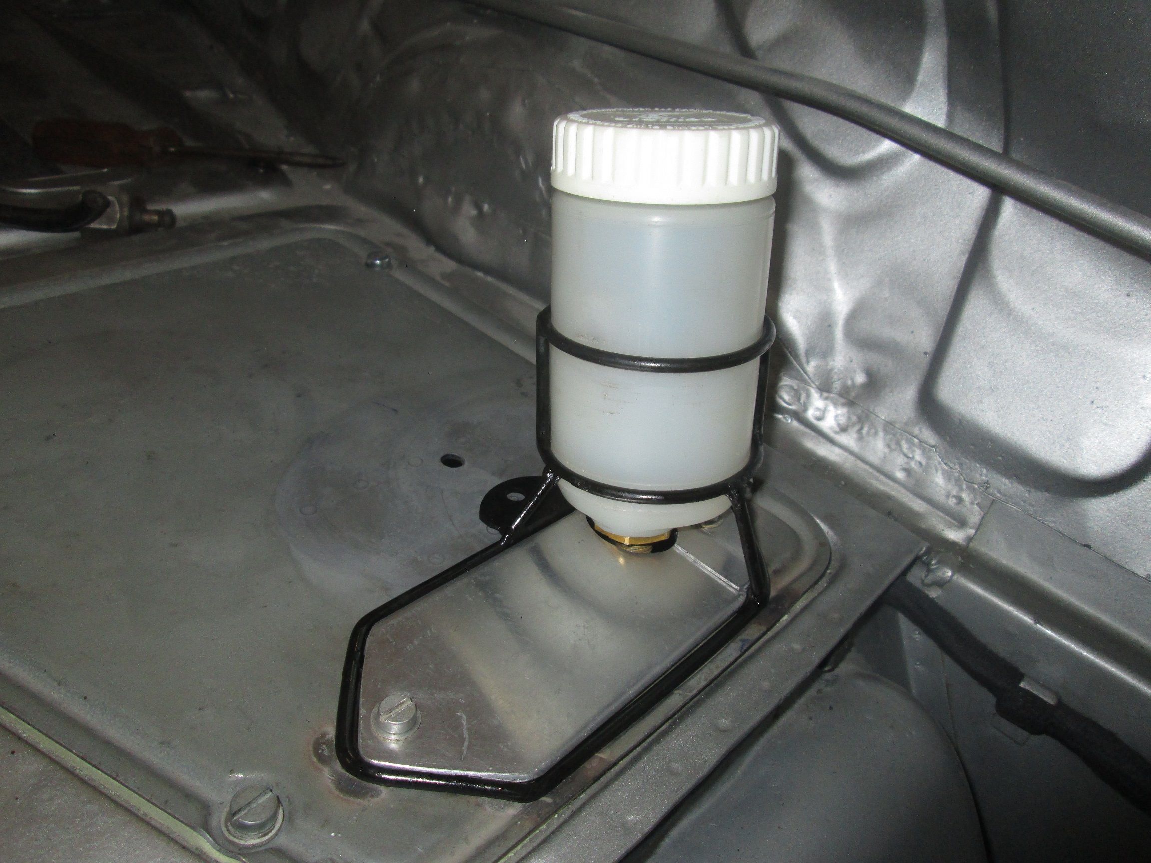

ID:	112920 Back and over as far as I could mount it without modification to the car or an original part.

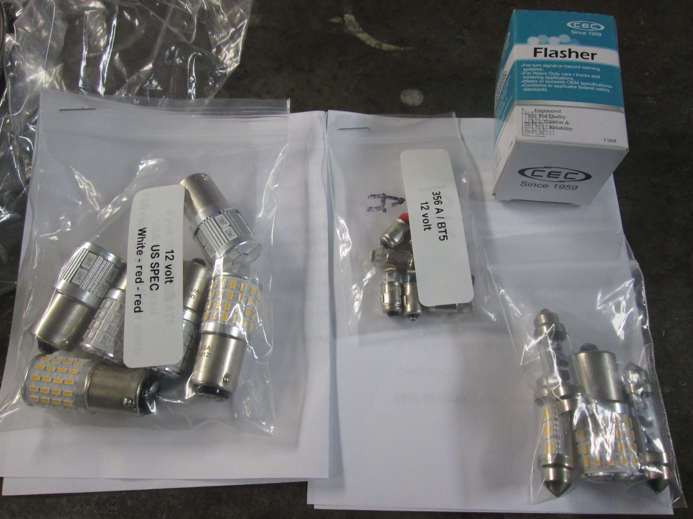

            I'd always planned on running at least a partial LED system to preserve more amps for the eventual EFI and electronic ignition going on the motor. I contacted Jules Dielen about his 356 LED light package.

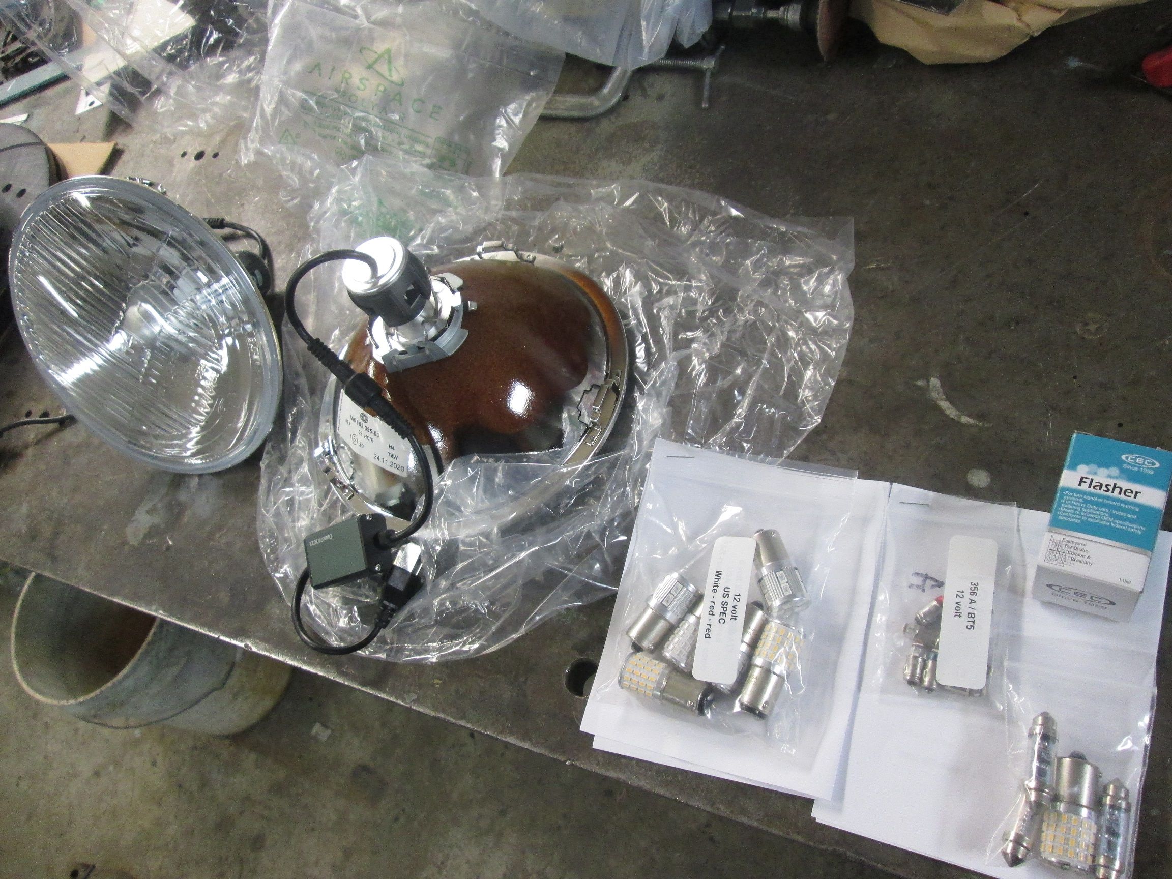

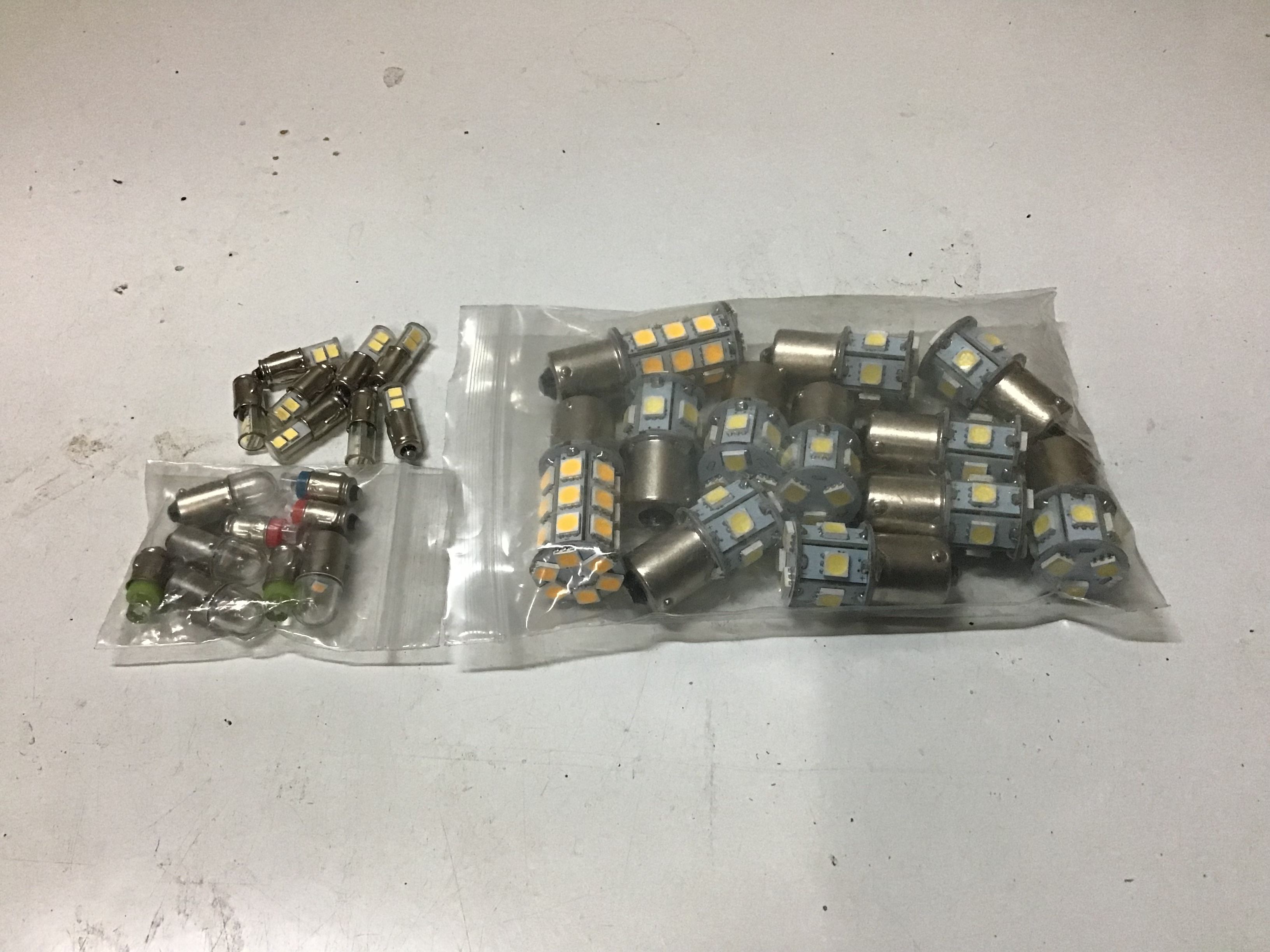

            Click image for larger version  Name:	IMG_8938.jpg Views:	0 Size:	660.5 KB ID:	113141 I went ahead and took delivery of the entire LED kit that he offers for 356. All 12volt of course.
            Click image for larger version  Name:	IMG_8937.jpg Views:	0 Size:	522.1 KB ID:	113142 All marker and dash related lights including an electronic flasher unit.

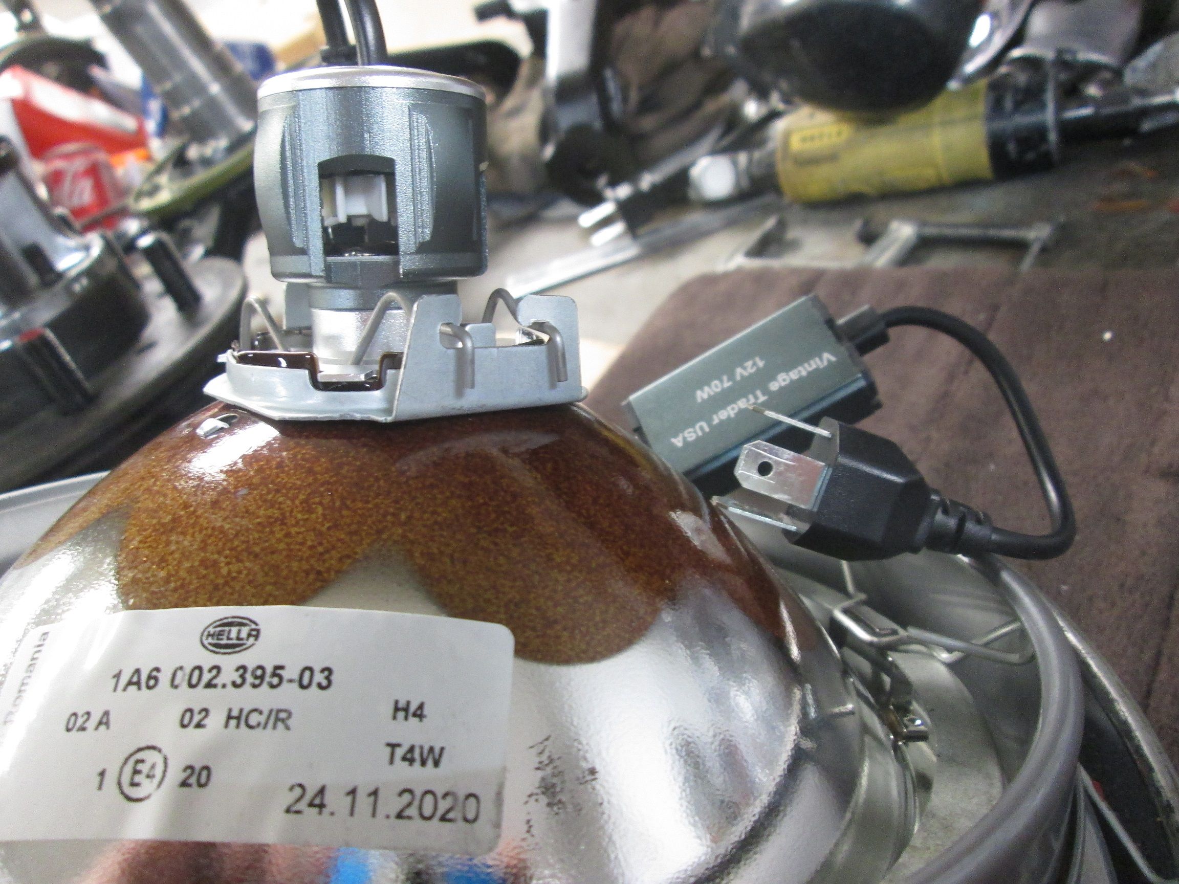

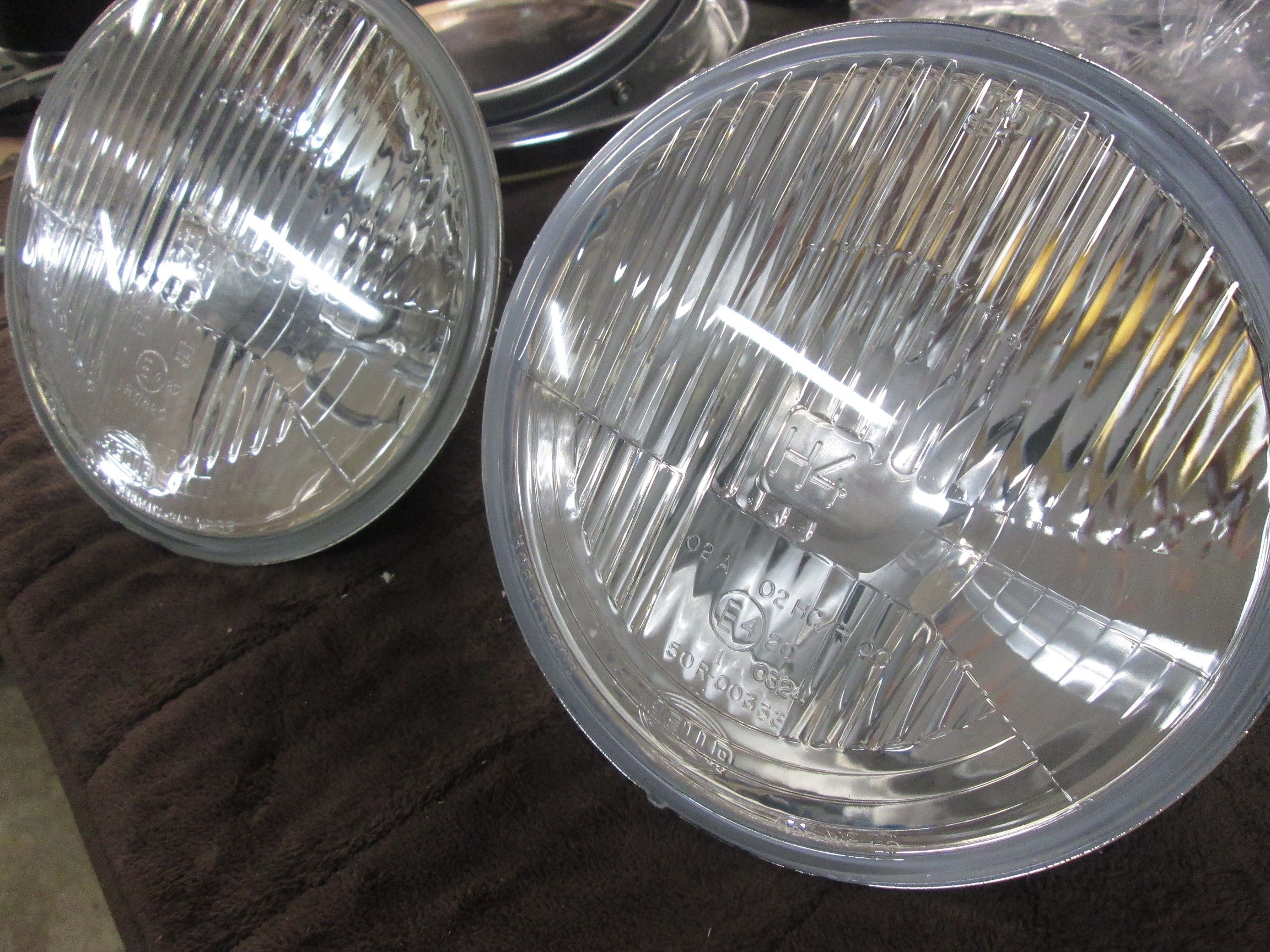

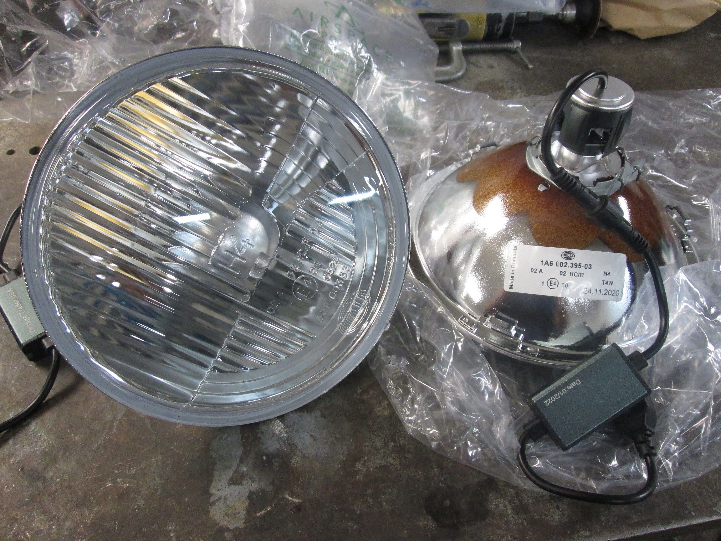

            Click image for larger version  Name:	IMG_8936.jpg Views:	0 Size:	777.6 KB ID:	113143 Headlamp units are new Hella H4 housings with their LED light units.
            Click image for larger version  Name:	image_65637.jpg Views:	3 Size:	575.5 KB ID:	113144 Really impressed with the quality. All metal jacket housings with a high quality quick disconnect lead and plug. Note the impeller fan at the top, really cool.
            Click image for larger version  Name:	image_65638.jpg Views:	3 Size:	582.4 KB ID:	113145 As advertised, the light units plugged directly into my original shine down light base.

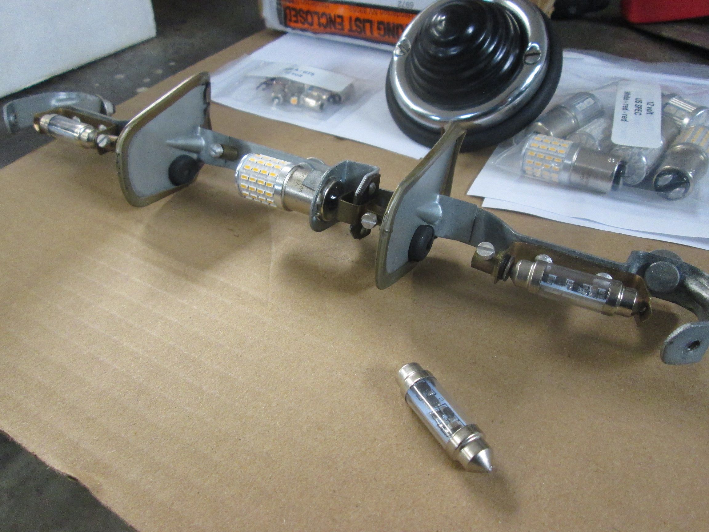

            • Click image for larger version  Name:	IMG_8940.jpg Views:	0 Size:	516.6 KB ID:	113147 White LED reverse light unit

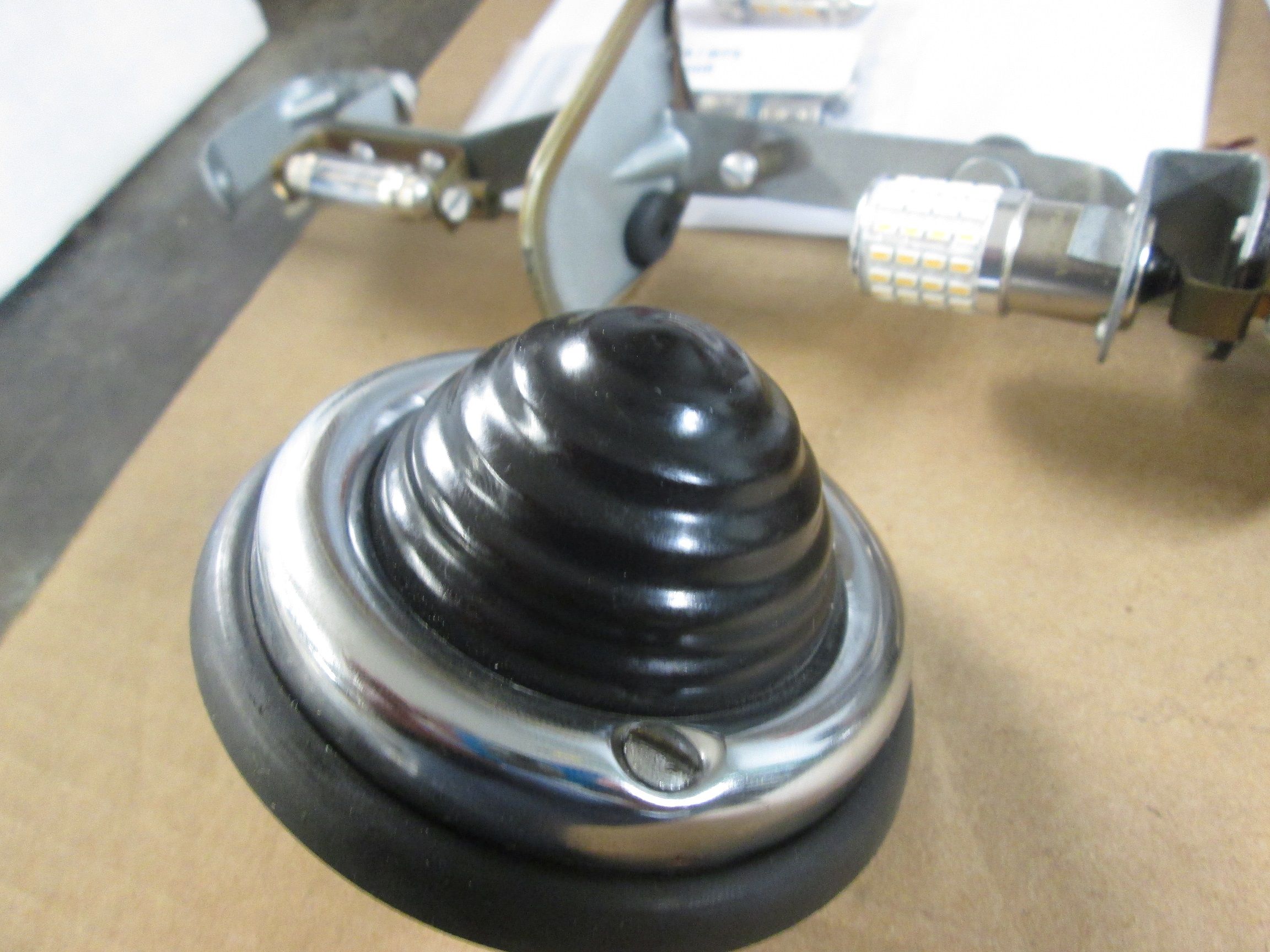

              Click image for larger version  Name:	IMG_8941.jpg Views:	0 Size:	567.3 KB ID:	113148 The tall beehive lenses look terrible (IMHO) so one of my main concerns before buying the entire kit was that the marker light unit's ability to fit under the short version lenses.
              Click image for larger version  Name:	IMG_8943.jpg Views:	0 Size:	454.0 KB ID:	113149 Jules said they would and they do. The plan was to always go to a 12V system and I remember the danger for the guys back in the day of melting their OG lenses with the heat of an incandescent 12bulb. Have it all covered here; more brightness without the amperage draw and the heat that goes with it. Definitely the way to go.

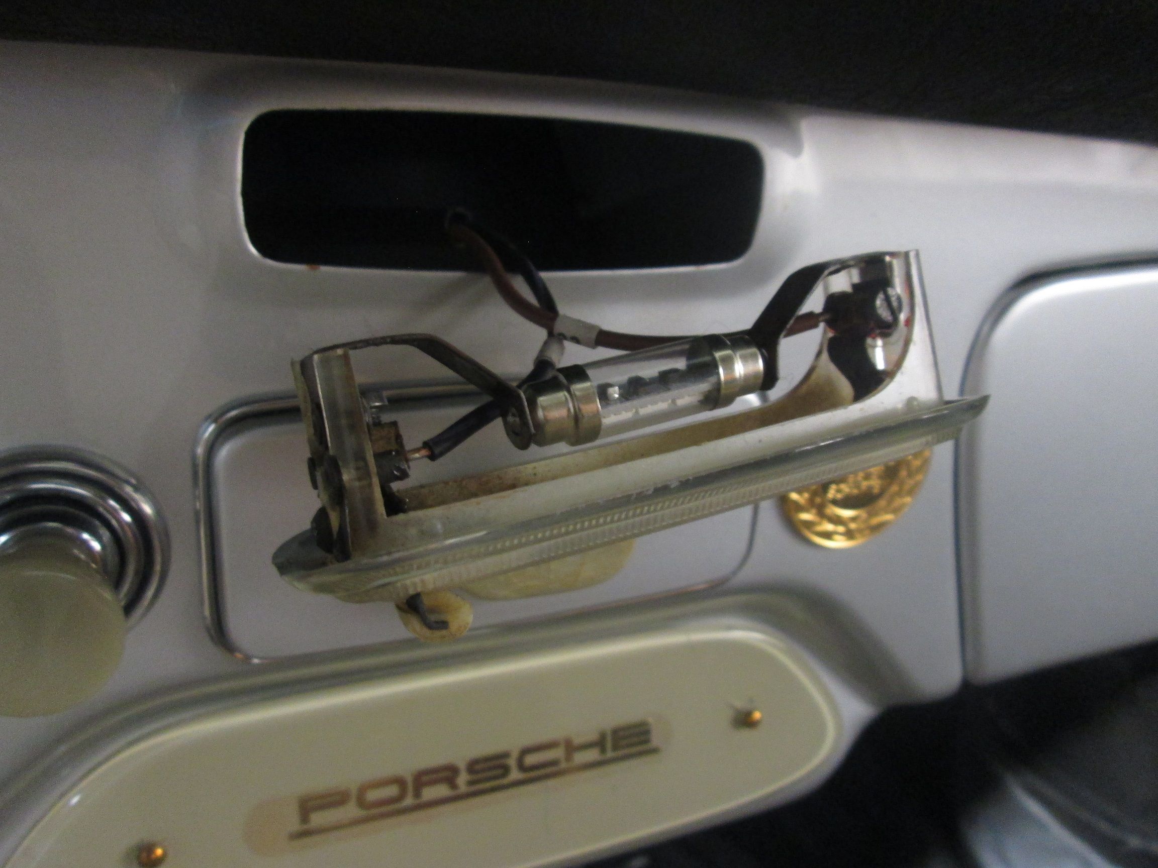

              Click image for larger version  Name:	IMG_8971.jpg Views:	0 Size:	444.9 KB ID:	113150 Same "bean" shaped unit that powers the license lights also goes into the courtesy light.
              Click image for larger version  Name:	IMG_8968.jpg Views:	0 Size:	535.4 KB ID:	113151 Switching out the gauge lights was of course just as straight forward.

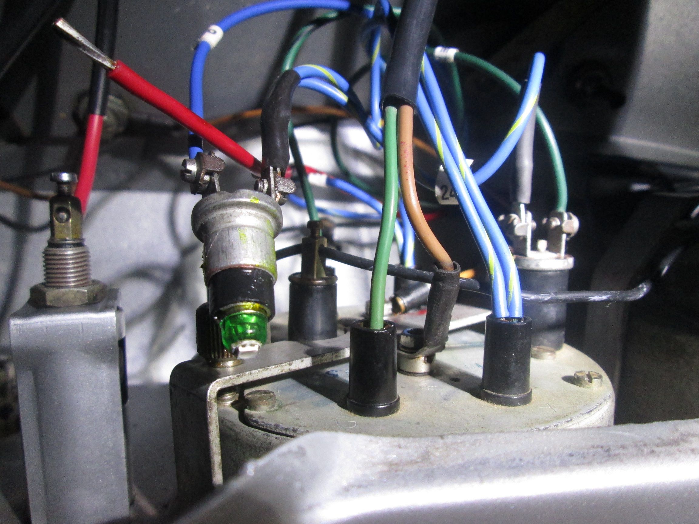

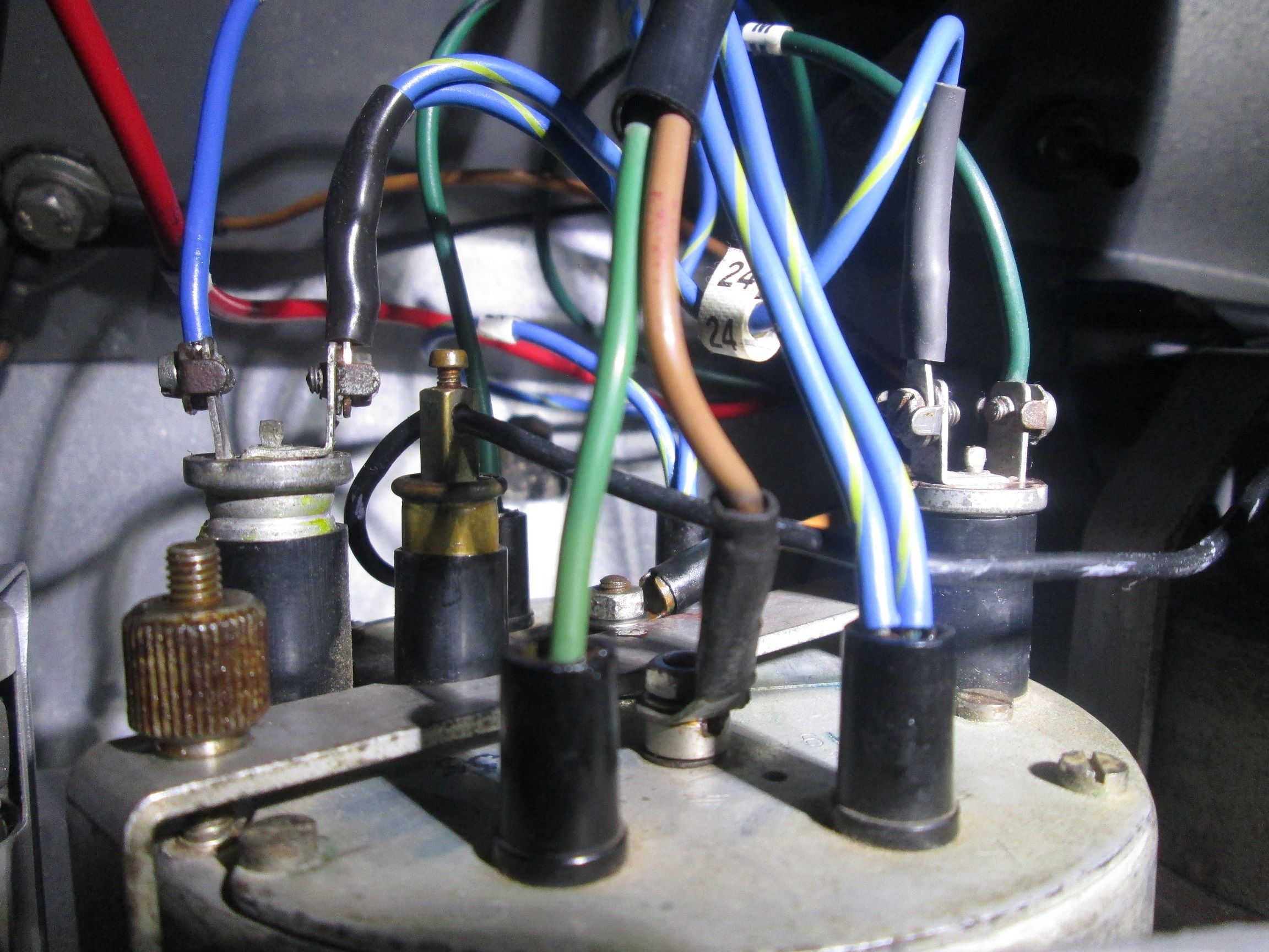

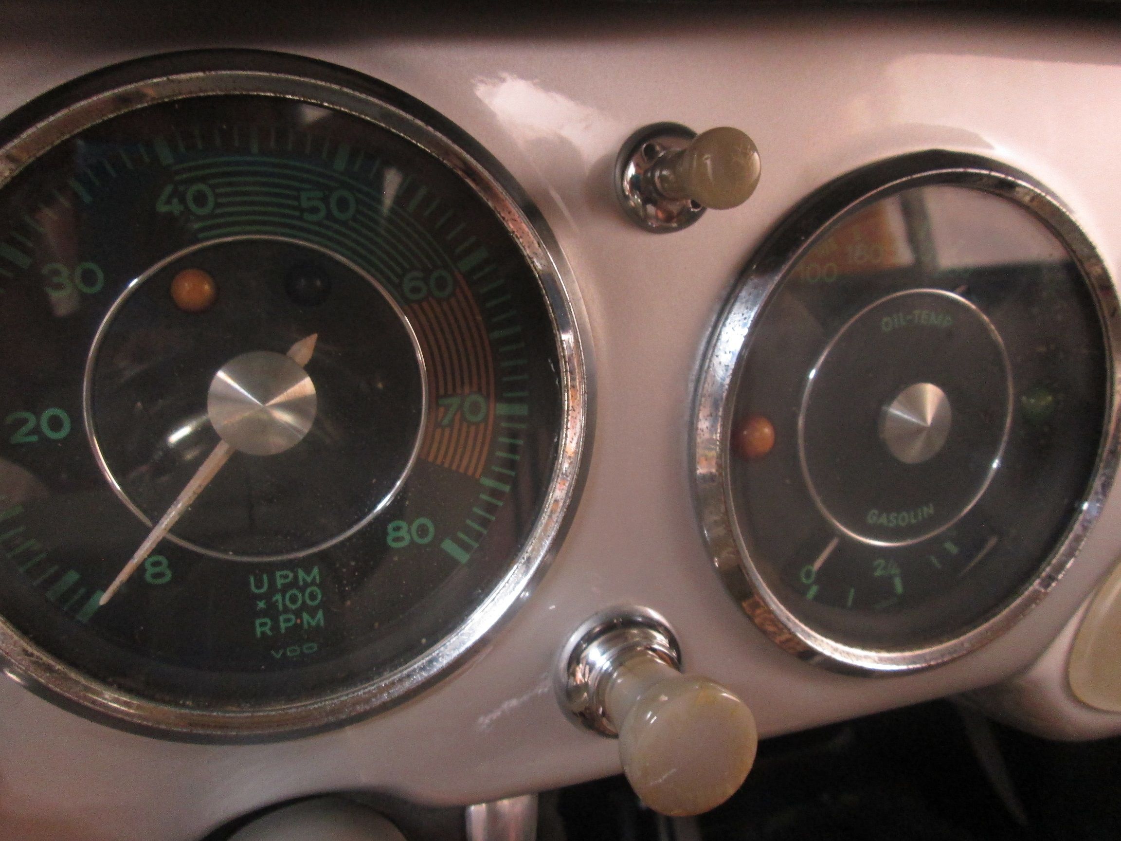

              • Click image for larger version  Name:	IMG_8969.jpg Views:	0 Size:	551.6 KB ID:	113153 As advised in the directions the new bulbs were only inserted half way for the combination gauge. This gauge's housing isn't as thick or deep as the other two so inserting them only partially here is supposed to help with illumination dispersion. We'll see how that looks when I finally get a battery in this car.
                Click image for larger version  Name:	IMG_8970.jpg Views:	0 Size:	459.9 KB ID:	113154 The colored LED's will be another plus for my purposes in that my gauges won't be restored and the half-century plus of UV light has faded the die in these old lenses terribly. So they should be looking pretty nice again once backlit with new bulbs.

ID:	113155 Head light switching was of course just as easy. Switching out my vintage H4's from the 80's.
ID:	113156 Same exact Hella housing though the logos and inscriptions are a little different being 40 years or so apart.

                • Pleased you have the original instruments untouched Justin. They are the best items to keep as original as everyone from when the car was new, has looked at them ! Daft really but that's how I am.
                  Also daft really, that I still run 6v and have lights like candles so generally given up driving it at night as lights on modern cars are so bright ! Your lights are going to be perfect Justin.
                    Thanks Roy, That's an interesting way of looking at the gauges, I like it. I was going to have them restored years ago but I am so glad I didn't. They do show their age but I find the patina affirms their authenticity as restored gauges can be customized to be any version you like. Did you upgrade your car to LED's and 12V?
