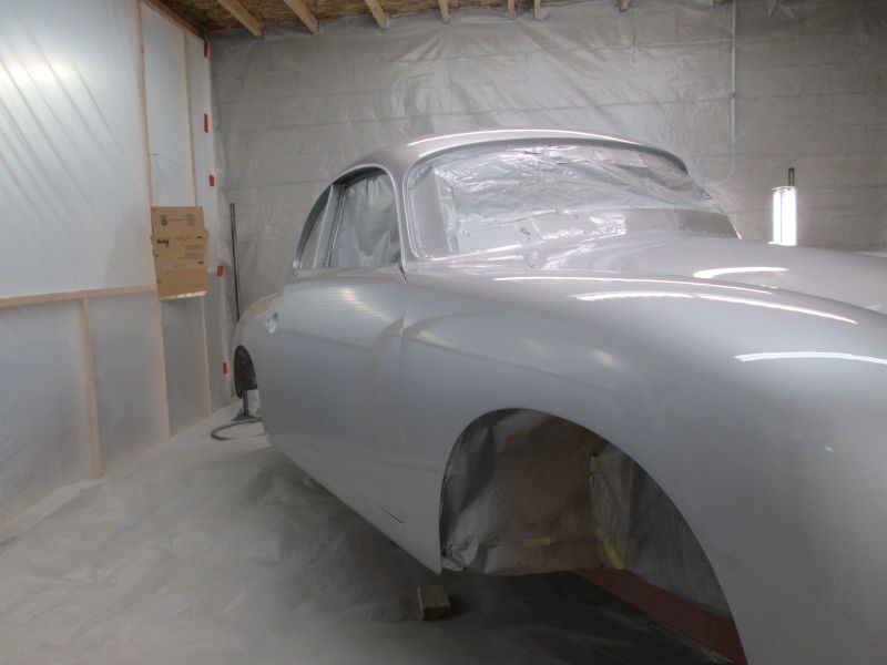

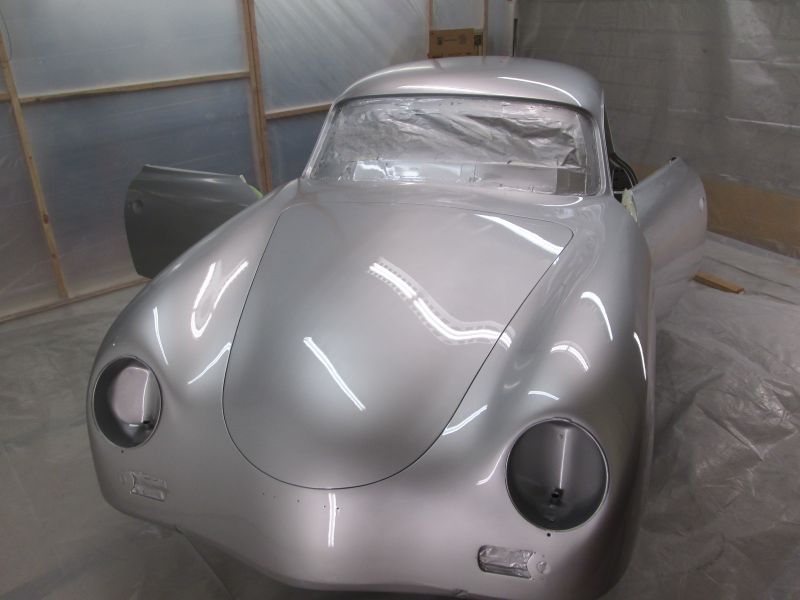

          • Thanks so much for all the input guys! I'll do a proper response post after I recover. I've been slamming on it all week in preparation for today. I got started at 1:00 this afternoon and just got home at mid-night. A full day to say the least but.....Its painted!
            Here's a quick shot. Hitting the showers and off to bed to recover. More later. Justin

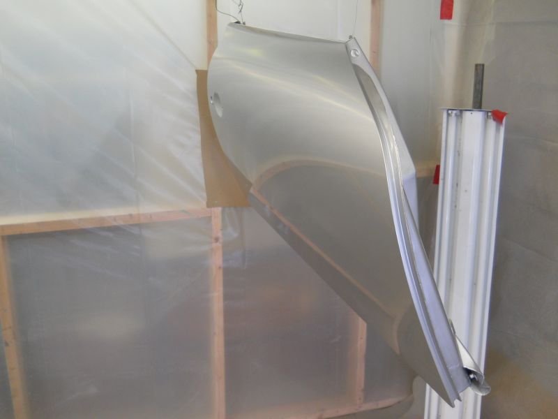

                          • First attempt on Saturday Oct. 10
                            Contamination not flake pattern would be the downfall of this go round.

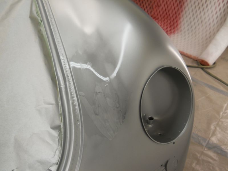

                            I had localized contamination to the inner left front fender(highlighted in green) in the form of one good sized "fish-eye" (that simply refused to die)with three smaller satellite dimples. The left door had about a 3 inch scratch that was reacting much the same way as the fisheyes also in green. It had contaminants in it that the paint just didn't want to touch. BTW: this was also after adding a cap full of Fish-eye preventer to the base as insurance.
                            What normally causes this is either oil or silicone. Before I sent the car over to Ricks I did a full and careful preliminary wipe down with wax and grease remover solvent. Then after the car was in and settled it was wiped completely again. I never figured out where the hell this contamination came from but at the very least it was localized to just those two areas.

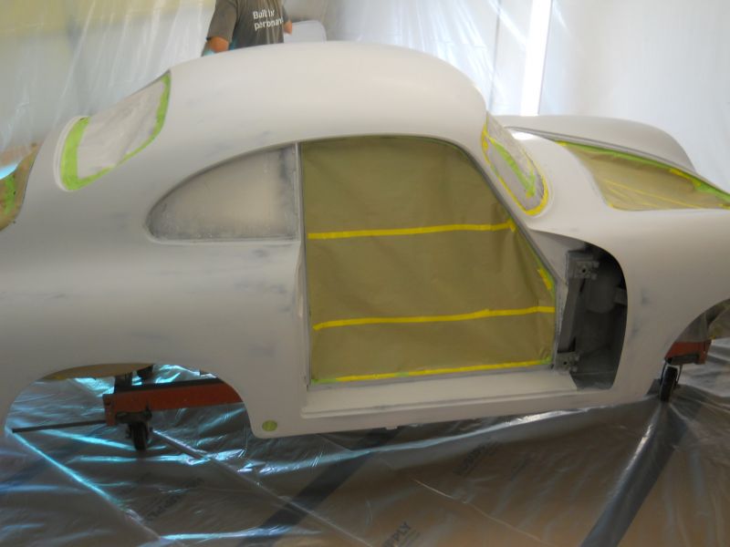

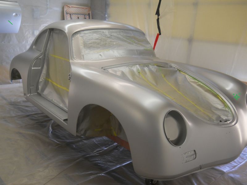

                            What made it all the more frustratingly sad as the day wore on was that the rest of the body and the closing panels could not turned out better; they were ready for clear coat and call it a day. Rick shot the first coats around 11AM then it was a cycle of letting those troubled areas cure for about 45 minutes then carefully sanding them back in anticipation of another coat of base to try and bury these flaws. By the second try the door was fixed BUT I ended up wiping it down clean again with laquer thinner as it was much quicker than waiting for it to dry. (what a mess that was) By the fourth attempt all the smaller fish-eyes were gone on the fender but the large one while smaller was still reappearing. It was getting into late afternoon/early evening by this time and patience was wearing very thin with all of us as the risk of losing the rest of the body as the clock as ticking to apply the clear to the curing base.
                            The fifth try was very promising but as it settled in the divot started to form as I said earlier we were all getting pissed. Rick tried to flood coat it but to no good end. I finally took my finger and just smeared it out! Felt good to do it but that was it, we were out of road for the day and it would have to wait until morning. Leaving this mess pictured above to set overnight would open a brand new can of worms for me on Sunday morning. We should have wiped it off. We don't have a "crying" emotocon but I sure could use one here.

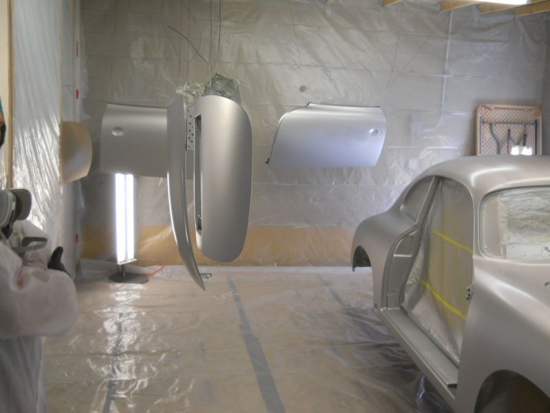

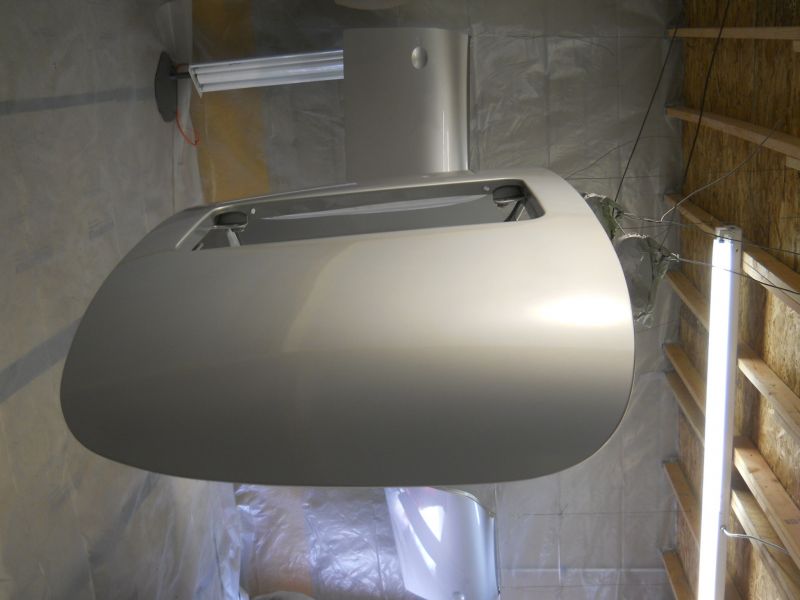

                            Before we called it quits Rick wanted to at least get the closing panels finished in clear so we'd only have the body to deal with on Sunday.
                            My "police car" doors looked so pretty, which also made it all the more sad.

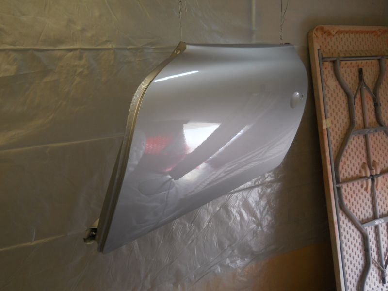

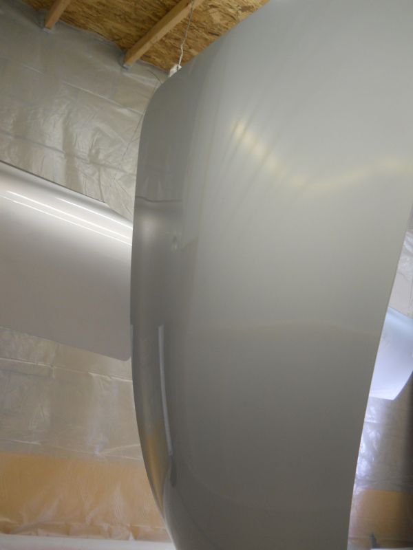

                            The troublesome left door looked fine as well but on Sunday I'd find wisps of sanding scuffs in the flake around that same trouble area that I just could leave after all that I'd been through so far. I'd try to talk myself into thinking that they weren't so bad but I just couldn't let it go. By this time it was past 10PM and it was a very stressful and largely unsuccessful day. We were all beat up, hungry and tired with another trying day directly ahead of us to get this thing finished;which we would not. Sunday bloody Sunday next.
