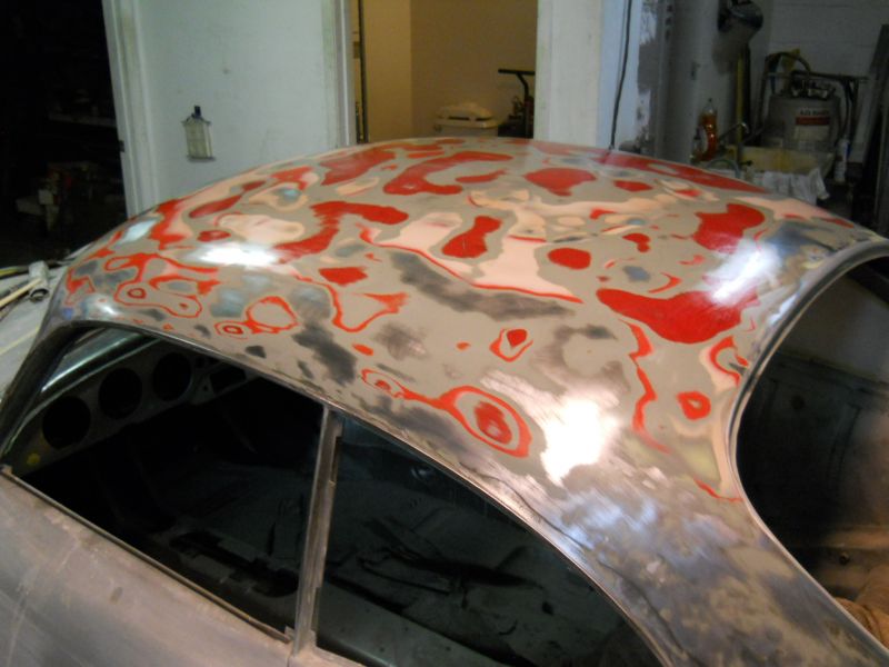

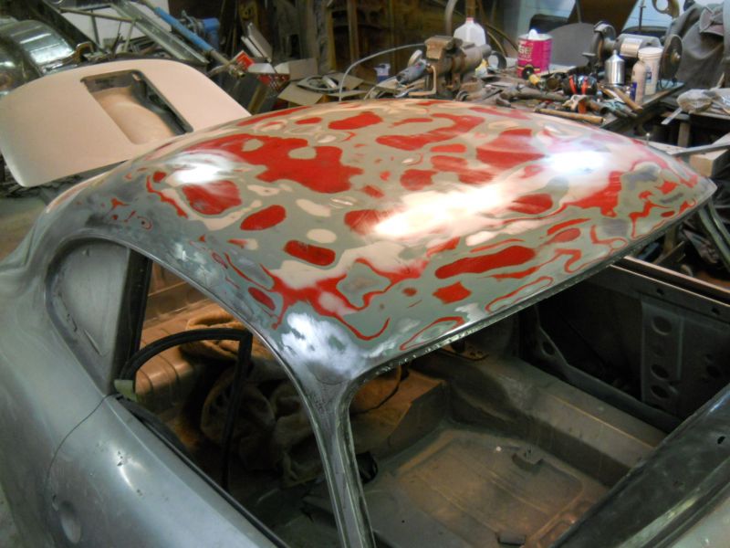

        My problem spreads to the roof. As of this entry I have practically cleaned off all of the prep repaint that was done in '99. A good thing considering what I've realized about that mystery epoxy primer I used.
        As I followed the white paint up the left A-pillar it quickly became apparent that I had forgotten that I sprayed the entire roof in that epoxy and white paint.
        Unlike the left fender I wire wheeled earlier I did not want to lose the body work we had done in the late 80's which meant hand sanding it back down to my bedrock-bodywork. Several hours and a lot of swearing and frustration spent getting to this stage.

        This side was even more aggravating as I had already spent time smoothing and shaping the areas by the gutter; all of which had to go as the unstable coats were underneath. A while back I told my father that I had gone back to DP40 because of adhesion issues and he shook his head in disbelief when I said it was 500 bucks a gallon now. I'll have to show him this entry and ask him where is the value or savings of using cheap-off brand epoxy?? All of this wasted time, energy, material and utter frustration it has caused has clearly demonstrated that there is no advantage, even if it was free!

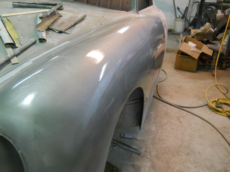

        My only saving grace from a total melt-down this week is that I now have this sides profiled reflection at a level I can live with! I am now down to micro-finishing this area.

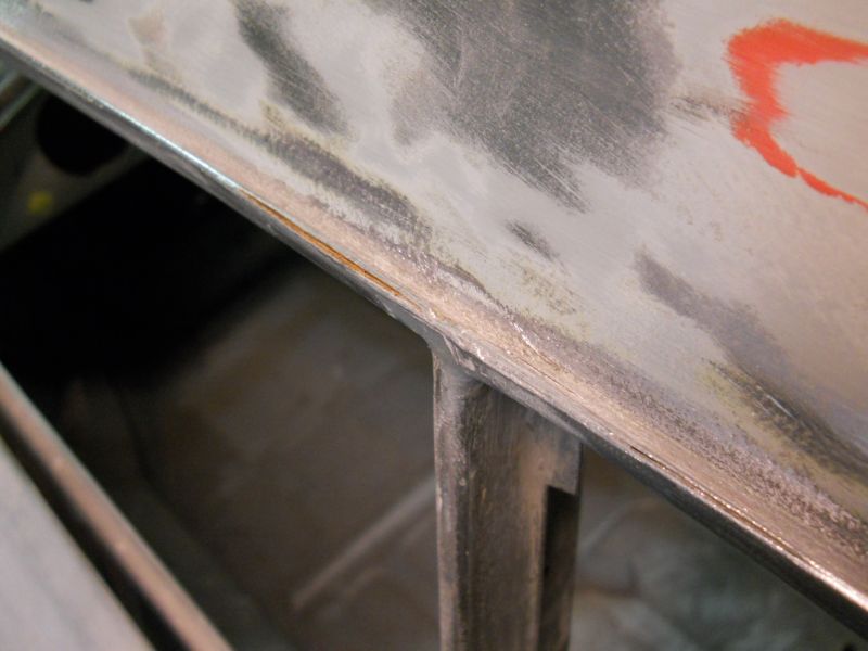

        While cleaning the roof I discovered where the factory guys had buzzed through the leading edge of the gutter in two places and just leaded over it. I'll of course have to run a stitch of weld here. I tell you one of these days I am actually going to run out of things to redo or fix on this damn car!!

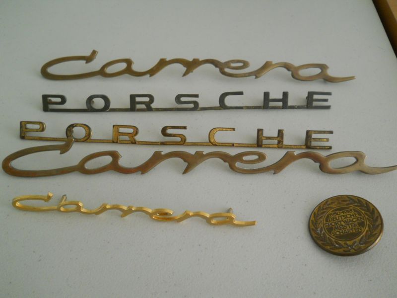

                Just sent the emblems off to Victor Miles to be replated in gold. Wont' be cheap but he's about the only guy I'd entrust with these! Only the Large Carrera Fender emblems and the dash medallion are original to this car. The original "Porsche" scripts were far too mangled to keep and the small Carrera emblem for the back has always been missing. Fortunately during my years of parts scavenging I found these originals to complete the set. looking forward to getting these back.

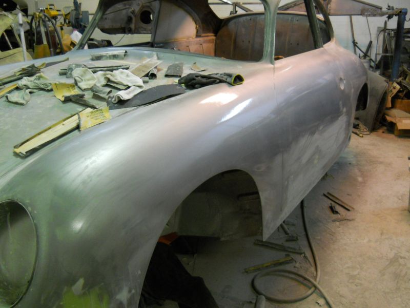

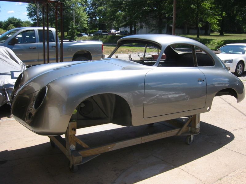

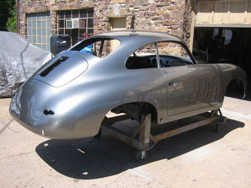

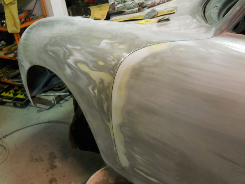

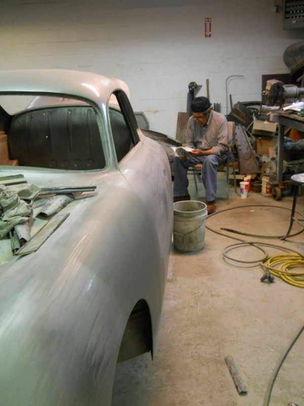

                Still obsessing over the profile reflection across the forward gap but my father was just in for a visit and helped to relieve a lot of pressure I was putting on myself. He saw the slight irregularities I was talking about but said it was about close enough and I was really just chasing ghosts at this point. His approval on this car is of course very important to me so this confirmation helped alot.
                Okay, just one more try to get it a little bit better then I'll hang it up...

                  Justin, I have limits in time=money and talent. You are limited only by that which makes you satisfied....a very enviable position to be in.
                  Now...just get it done already!
                  BTW, FWIW, I have had good gold plating done on emblems by Craig Bierman in Texas, speedsportchrome.com
                  Victor is great, but like with other specialties, having more than one source can be educational, if nothing else.
                  What a difference in 'look' over repro!
                  Not cheap, but when the rest of the 356 is done well, that finishing touch is a really obvious 'plus'.

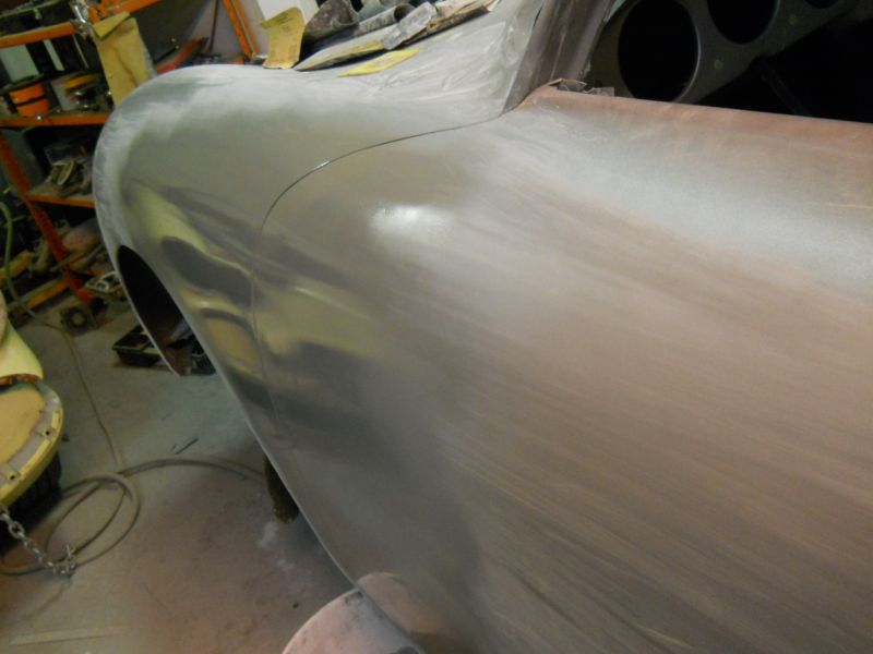

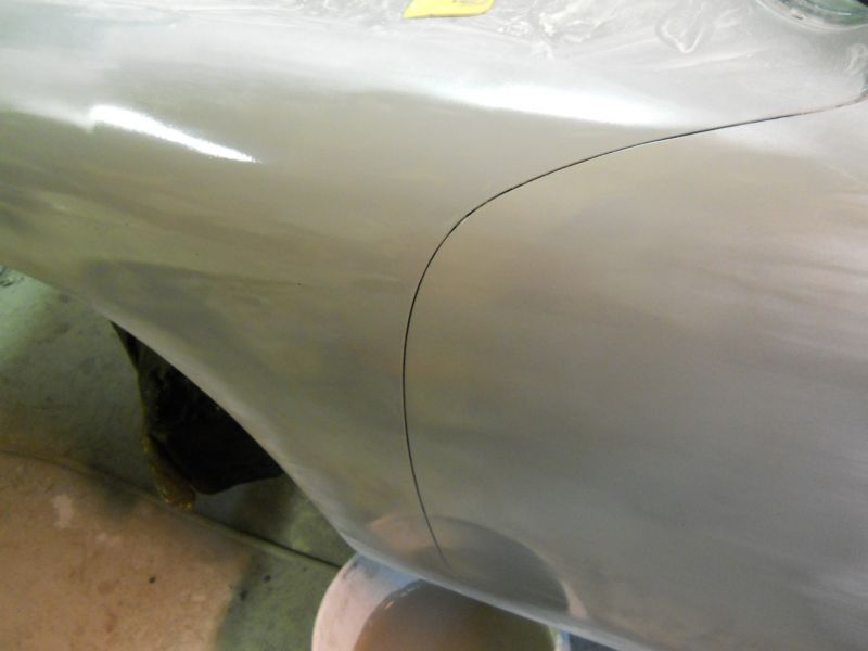

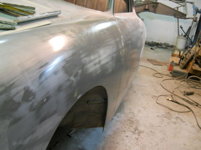

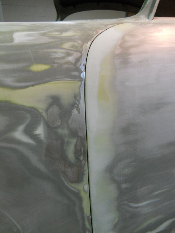

                      • 6/25/14

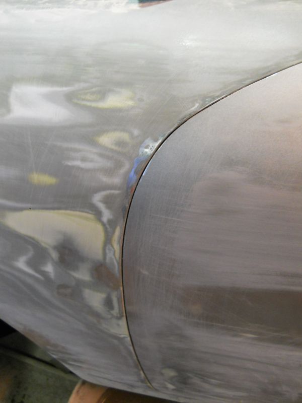

                        Finally turned the corner on this damn left fender to door transition that has been plaguing me for the last few weeks. I tried to let it go and listen to both my father and Bruce's advice but with each tracer coat I just could not convince myself that it was fine; quite frankly it still sucked! The reflection continued to jumped and meander on either side forward gap. Very subtly and appeared worse viewing it from front to back versus back to front. My father said I was just chasing ghosts at this point but I knew I had to exercise this spirit out before I'd ever have peace with it.
                        My mistake was I had built up both sides of the gap to try and smooth and "ramp" the reflection across the this transition. Because I was hitting a lot of metal both on the leading edge of the door and the fender I thought it was my only option. In doing so I had created a wave or step at the apex of the front fender well and just ahead of the middle of the door. I was at the end of my rope trying to perfect it and the more I did the worse it seemed to get. This is when it finally hit me that I was on the wrong path and needed to change the approach.

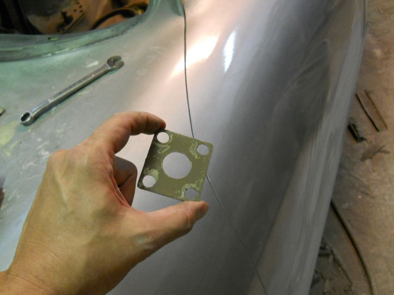

                        Because the door always fit so uniform,smooth and even with the fender it never occurred to me to try and pull another shim out. However by this time I was desperate and all out of other options.
                        Not much in the way of adjustment with only three thin shims up here but it was now time to try two shims.

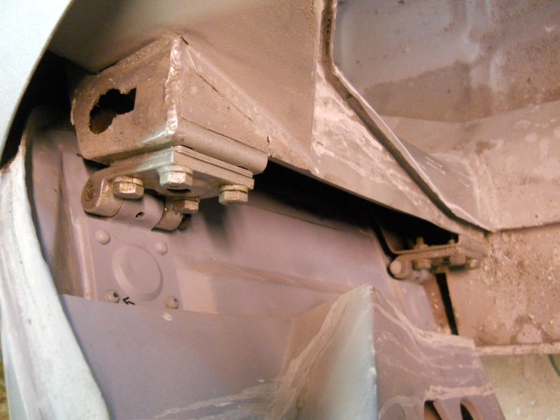

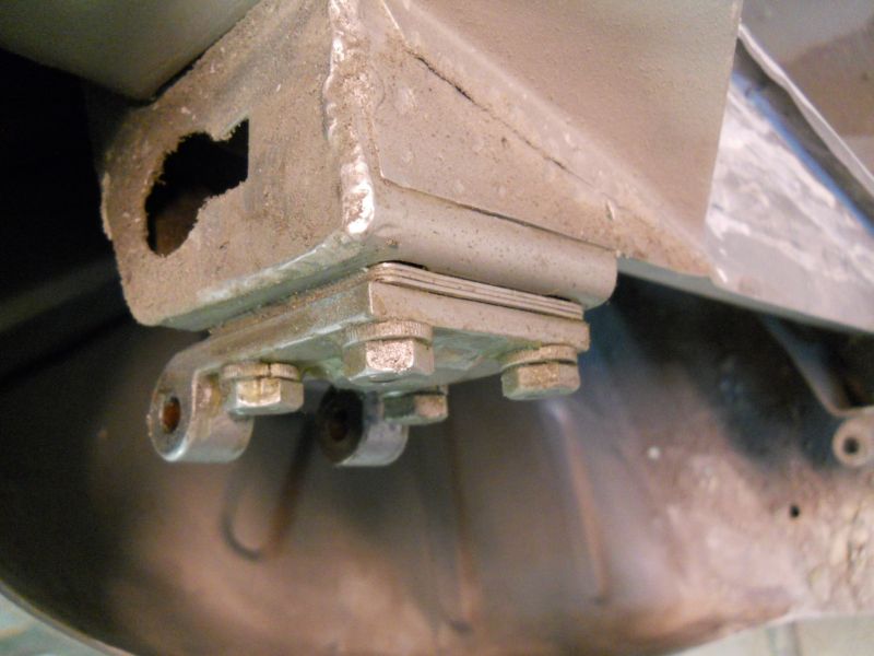

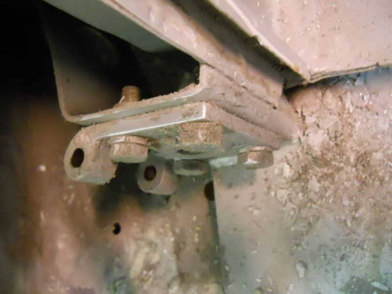

                        Fortunately the lower part of the door's reflection has not been an issue. No shims to take out here. Somehow when I reinstalled this bracket after rust repairs I got it in just the right spot as not to require any. If the lower door did need to come in I was fully prepared to file and surface the hinge as necessary. Thank god I don't have to.
                        This single shim was the key!!!!!!! The attitude of the engaged door was night and day,relatively speaking. Even though I had lots of build up to block down I could tell immediately that this was finally going to give me the result that I was after.
                        As blocking progressed the fender was getting straighter and only about first couple of inches of the door were low and not in contact. The leading edge of the fender went quickly down to metal and required some inward pecking to get it level with the door. As I tapped a section down another would spring up. I was crowding it and more room had to be found to allow these high spots to come down.

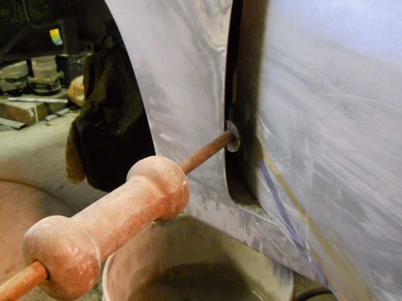

                        I found that the lower half of the edge could come up a bit to make way. I got out my slide hammer with a big washer to hook the edge and slow began working the edge out higher to make room.
                        Messaged down the leading edge about as far as I could take it. I thought about filing it bit but that edge is original and I know there is sleeping rust in that pinch seam so I could not afford to thin this metal out any further. To get that last thousands of an inch from fender to door I had to swatch the leading edge. Its thin but required just the same.
                        Two great things happening;filler getting thinner and car getting straighter. This area was now blocked down about as far as I could take it. I was more than pleased with its wet reflection. Ready for a coat of primer.
                        First coat of primer. Some slight irregularities of course remained but those will come out with further block sanding.
