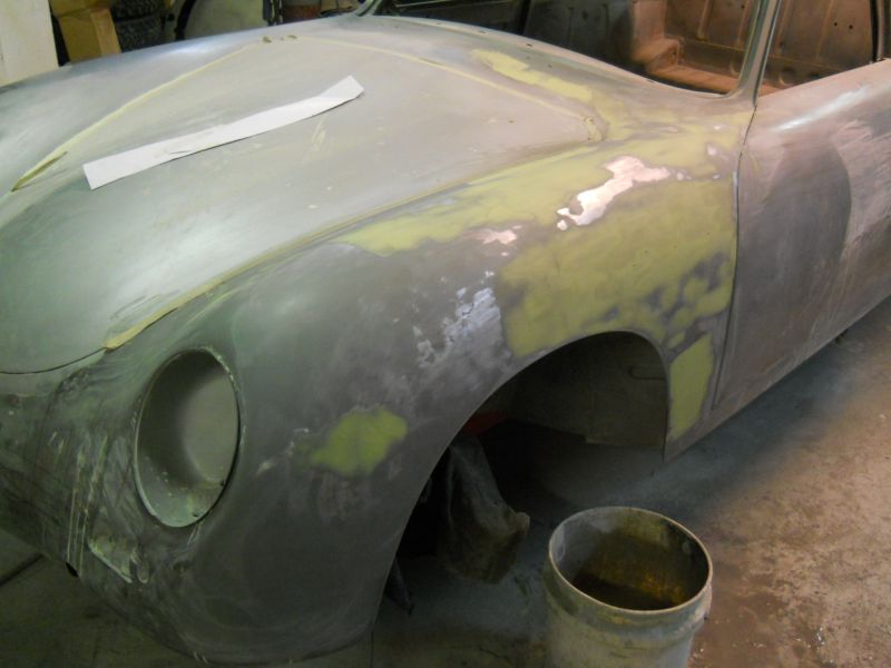

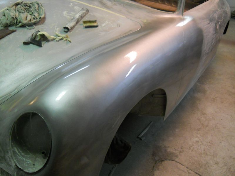

          • WOW! Thank you very much for all the great comments of understanding and support you guys! Your stories of similar trials and tribulations really helped to ease the sense of frustration and doubt. Its nice to know that its not just me! Thanks once again to you all; it is very much appreciated! Justin

            Once it was primered I began skim coating the obvious waves and irregularities I was wrestling with before all of this.

            This where it is as of this evening. The putty stage is finished and am now back to primer, long-boarding and test coats.

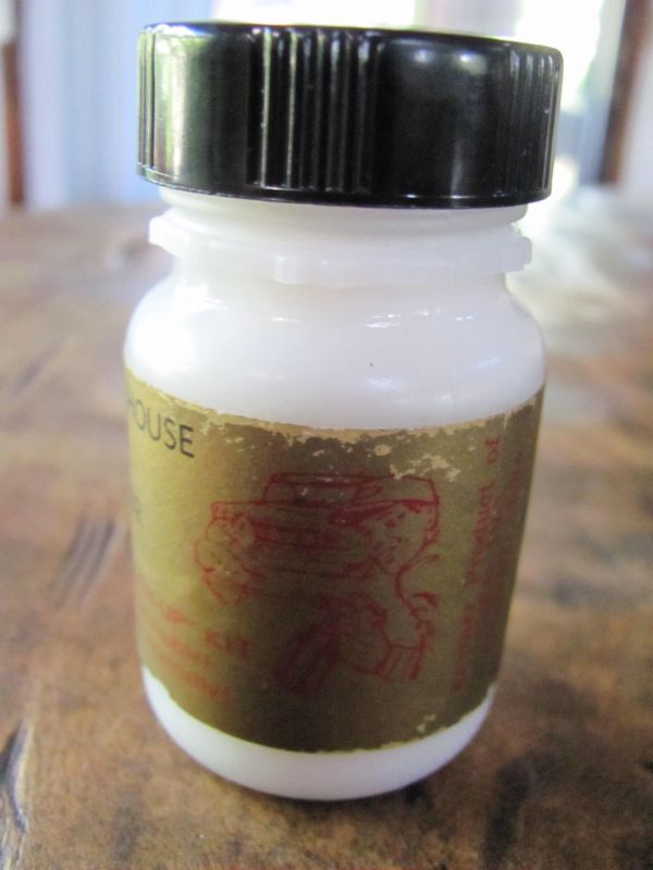

                • Speaking of Junior, here's one for ya. Smothers Brother Dick brought his 62 S Coupe to Junior to have it repainted after being keyed in the mid. Sixties. Those boys kicked up some dust in the 60's.Here some pics of the car several years ago, 62k orig. Miles. It is a S/R with all the options, rallye headlight grills, Speedster side spears, headrests, S engine, 62 date stamped Nardi .Found the paint sample from Juniors in the glove box.
                  Called Junior and he told me the story of why the repaint of such a new car., still looked good after 40 years.

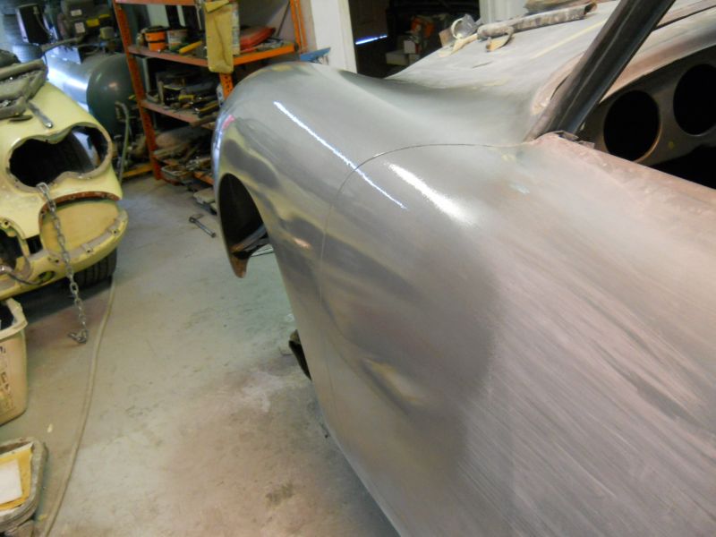

                        first test coat after redo.
                        Much to my relief its actually getting really close.

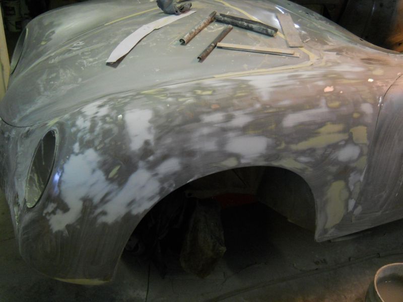

                        Still having a slight issue in the reflection at the mid-upper door gap transition but its closer than it was before I had to strip it. I don't know why that is but this area is straightening quicker than before I took it down to metal?? I'm sure its all in my head, anyway its getting to a level that I can live with. Thanks again you guys! Justin

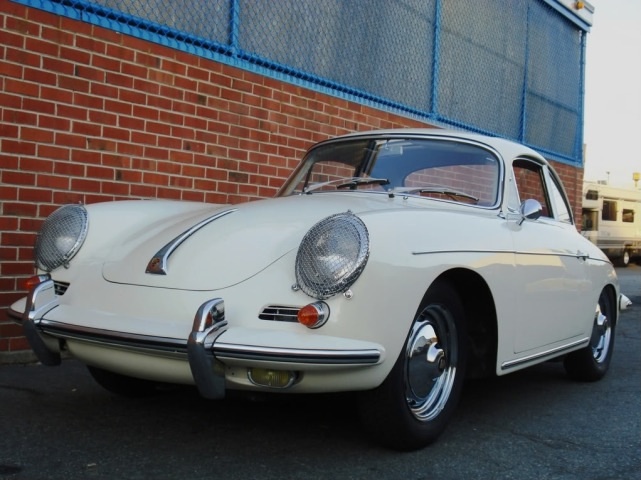

                            • No Justin, it was a short love affair, had to sell It to move on to the next adventure. The chapter of buying and selling to enjoy yet another one of Dr. Porsches creations is coming to an end.

                              All around it's not an easy process anymore.
                              My current car a 59 Ivory Cabriolet is undergoing a sympathetic restoration . It's another great car and a year & model I've never owned. I think I'm through now , this one should be with me for some time.
