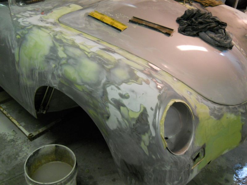

      Nothing huge to report over the last several days. Just the continuation of more block sanding to the right fender and trunk gap areas. Trying to keep it edited here so its not so boring which it really is but I'm sure you don't want to read about. Here are few more pics and details. Thanks for stopping by! Justin

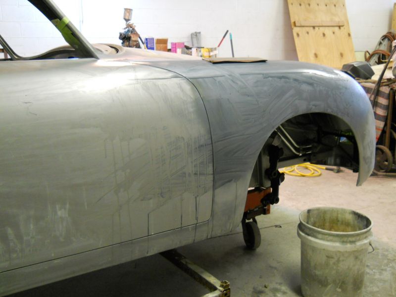

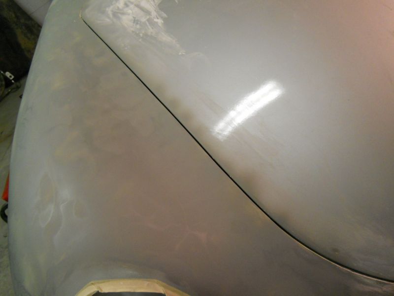

      Entire fender up to the trunk lid fully blocked and ready for primer and another tracer coat. Was able to shape and thin the first application (the white stuff) a little further.
      Another coat of primer and now ready for the tracer paint. All the heavy shaping is done! I am now down to just ultra-fine detail sanding here. Always a huge sense of accomplishment.

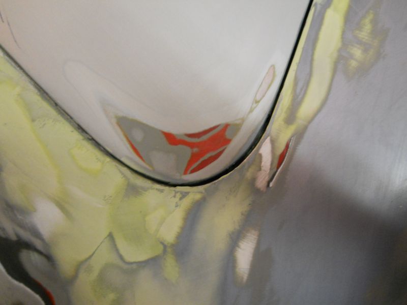

      Tracer coat being block sanded here. Working it with the door for an undisturbed reflection over that gap. Down to 400 gritt sandpaper here. This block sanding phase was actually almost fun and very rewarding to see the end of this so close in sight. This is my life now, more of the same tomorrow. Thanks again for reading this! Justin

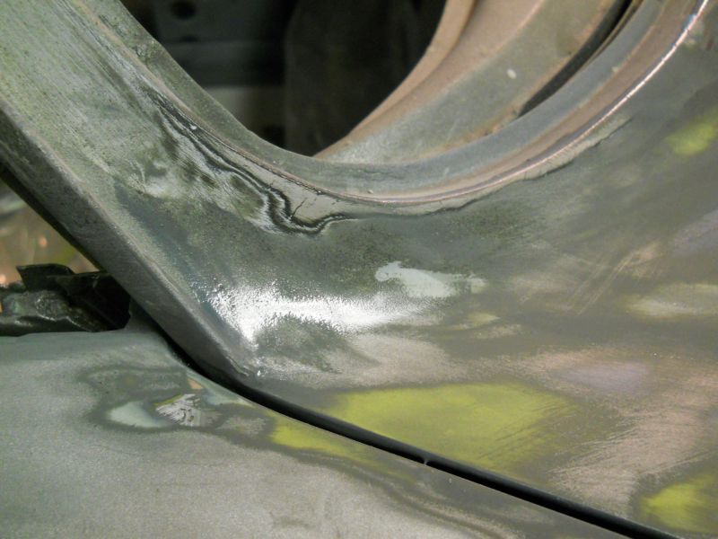

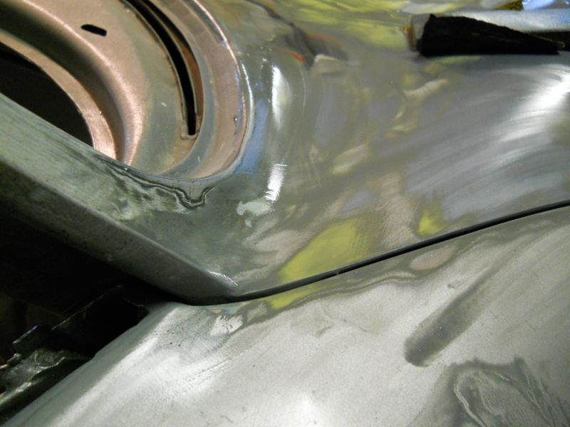

                Shaping small areas where several shapes converge sure can eat up the time quick. Spent a good hour just fine leveling and contouring the gap up at the A pillar transition and along the lower windshield frame.
                I wanted to make sure the door and the edge of the fender were dead even right up to the gutter transition. This left a lump right behind this gutter on the edge of the door. Had to soften it next and blend it in with the rest of the new profile. Note the tiny fractures in the original lead around the W/S frame. They are through out the roof and have been there since I started in '87. They have never caused trouble or become visible in my finishes so I am going to continue to let them sleep.

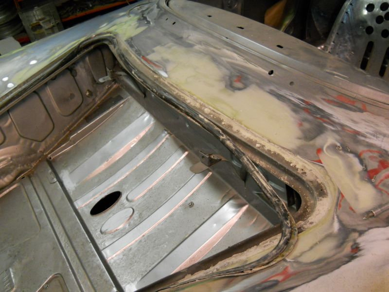

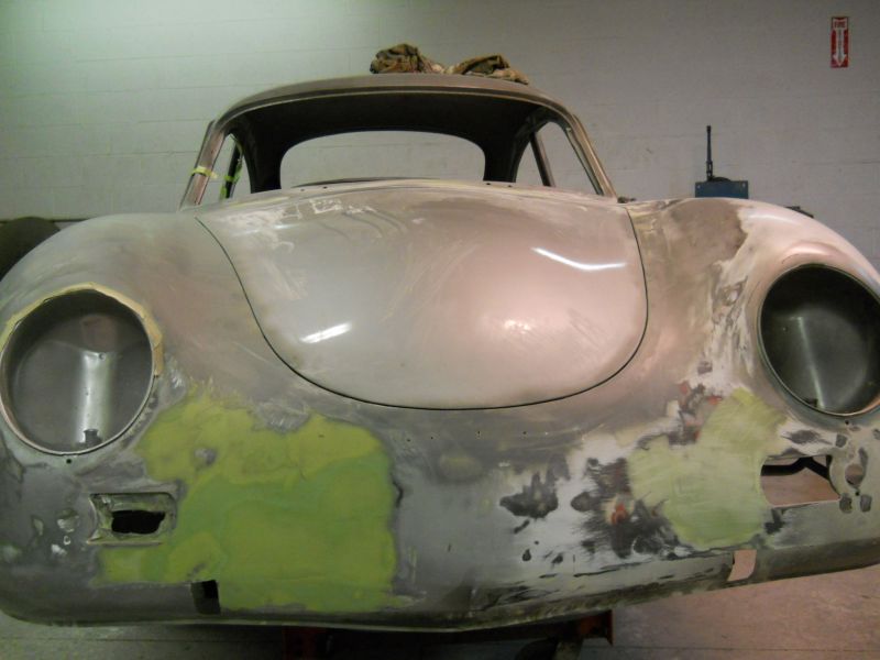

                • Now That I have the trunk's front and side gaps dialed in I focused on the rear corners and cowl. After some opening and closing clearance evaluation I now know that I can tighten up the corners and the cowl just a bit more to match the rest of the trunk. Here is whare I maybe guilty of overrestoration Mark; I'm tightening up an undisturbed factory set gap and fitment. I can't help it! It all has to match now.
                  This corner definitely has to be built up so the gap is smaller. While it was so tempting just to fill it with bondo I'm going the extra mile again and creating this new line with lead solder.

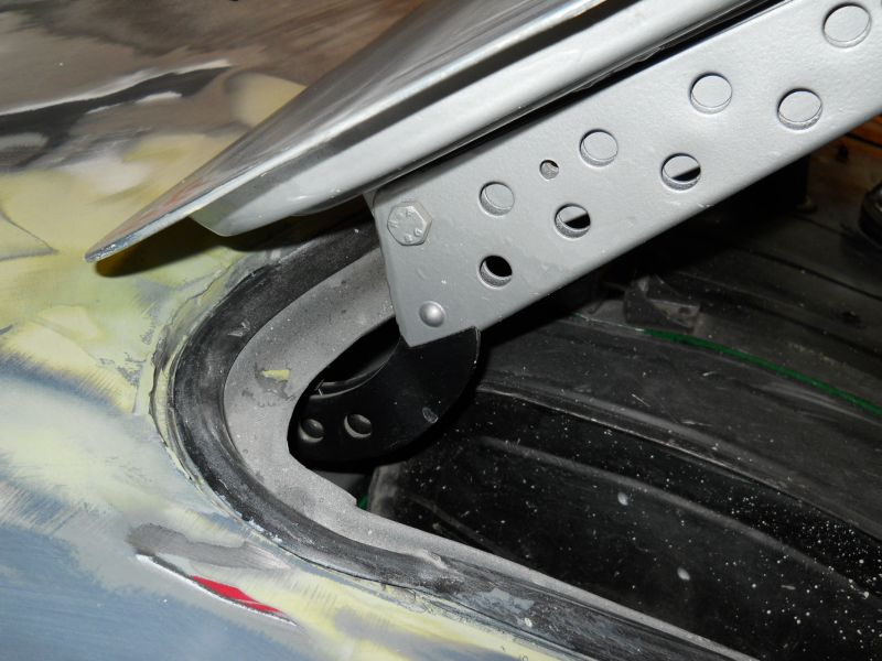

                  So to clean and prep it correctly the hood and rubber seal will have to come back off. More time and of course more work.

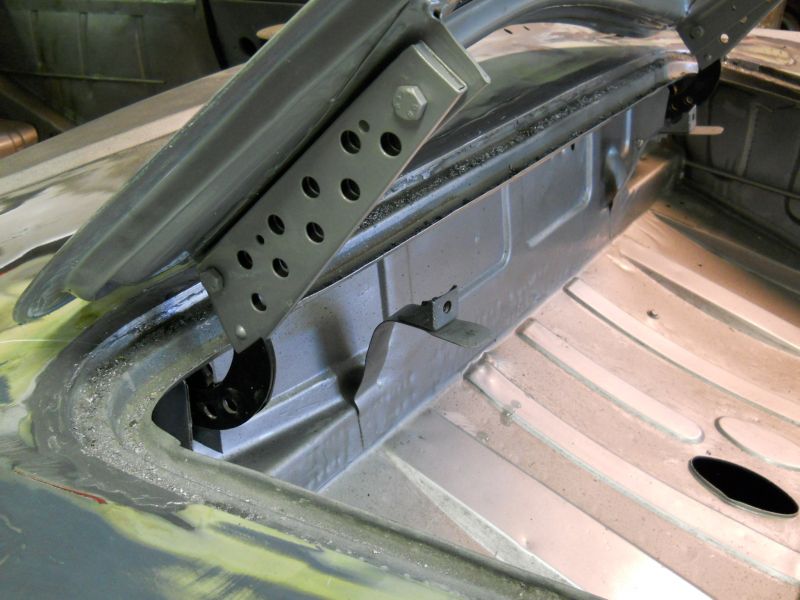

                  Hood, gas tank and rubber seal now off. Taking this hood off alone is so much more trouble and scary then when I worked with the doors. Don't want to have to repeat this any more than I have to.

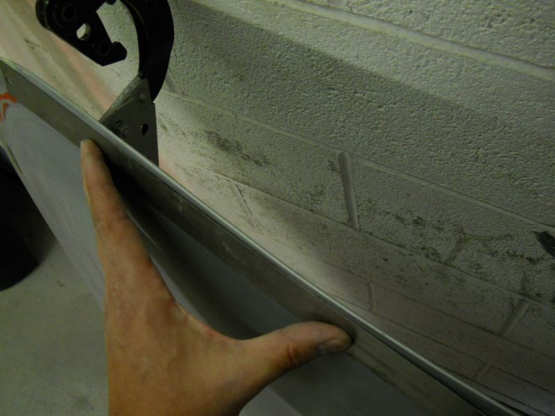

                  With the hood off I can address this low edge. My ruler highlights the low spot clearly. A few slaps with my dead blow hammer should bring it up quickly.

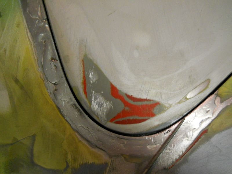

                    Plate pulled out and a quick filing down to see what I ended up with.
                    Left corner was up next. I then worked toward the center to finish the job. Leading phase is now complete.

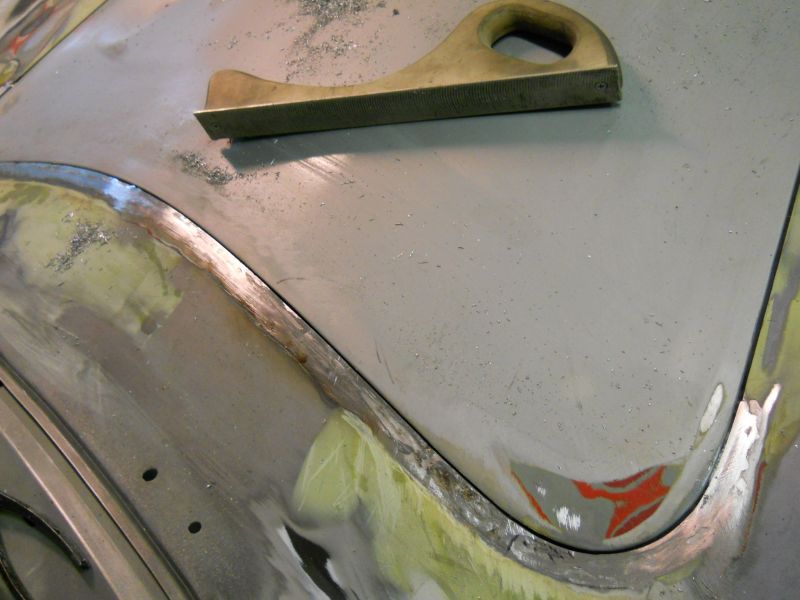

                            • 1/23/13

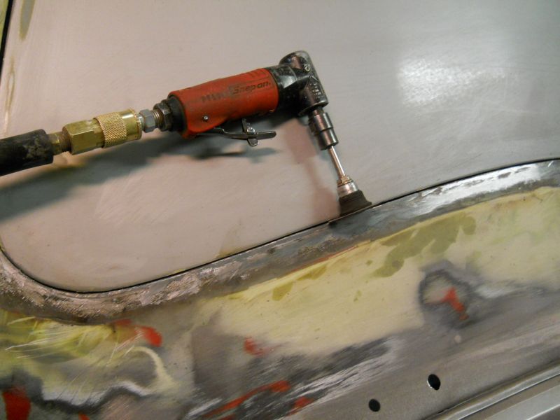

                              Shaping this rear gap and corners has proven to be an extra teadious and time consuming project. I have spent 3 solid sessions just ever so slowly widening and shaping this gap up; mostly by hand. Tons of repitious strokes with a file and or sanding block to get it right and also just to be able to get the hood open again.
                              I used the die grinder to get it close but it was only good for the longer straighter sections. I could not use it as I approached the corners and had no choice but to shape them slowly by hand.

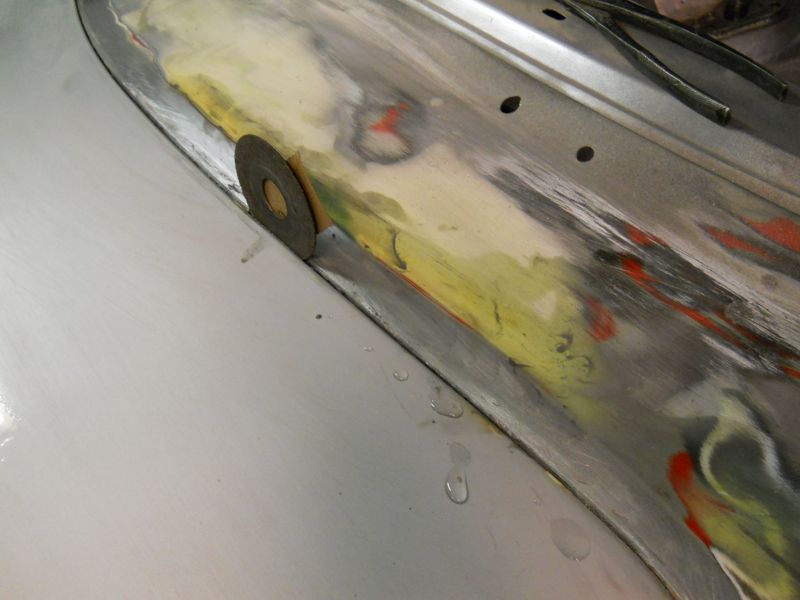

                              Went back and fourth many, many times between this disc & sandpaper or my tiny Rat tail file.
                              Slowly widening and taking shape here. Gap is still too tight up by the file. Needs more.... I tell you repetitive and boring! This has been my life for the past couple of days.

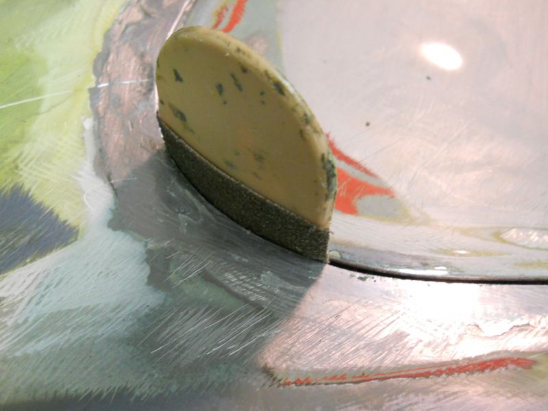

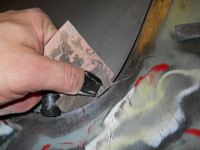

                              The corners were the most difficult to file, sand and shape. Coming up with new ideas as you go; I realized that this putty spreader with emory paper worked the best for shaping these corners. Wished I'd have figured this one out a little earlier.
                              I am almost done, One more session should finish it. As you can see my skin and my patients is wearing really thin with all this. Had to resort to wrapping my tips with duct tape just so I could keep going this afternoon. Its Almost done though, I see my light at the end of this tunnel. Thanks for reading this! Justin
