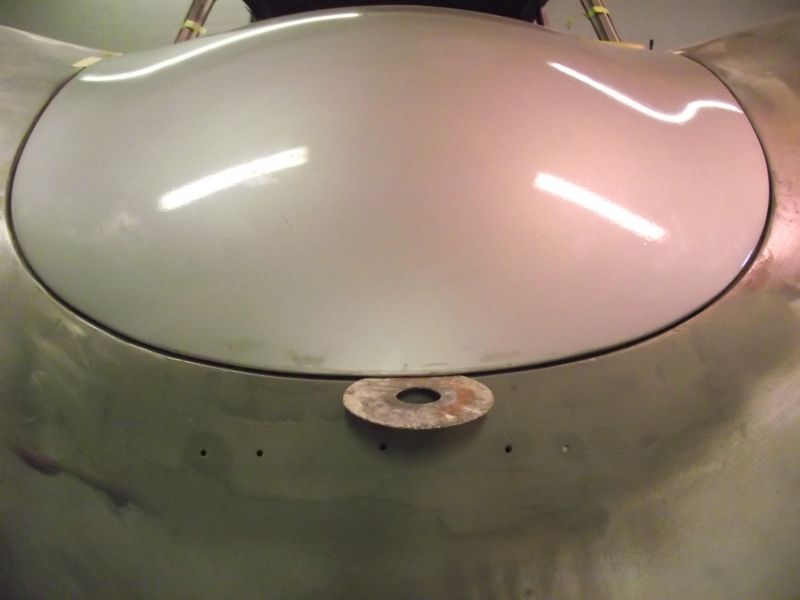

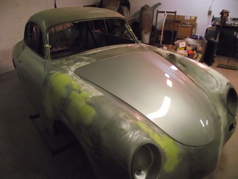

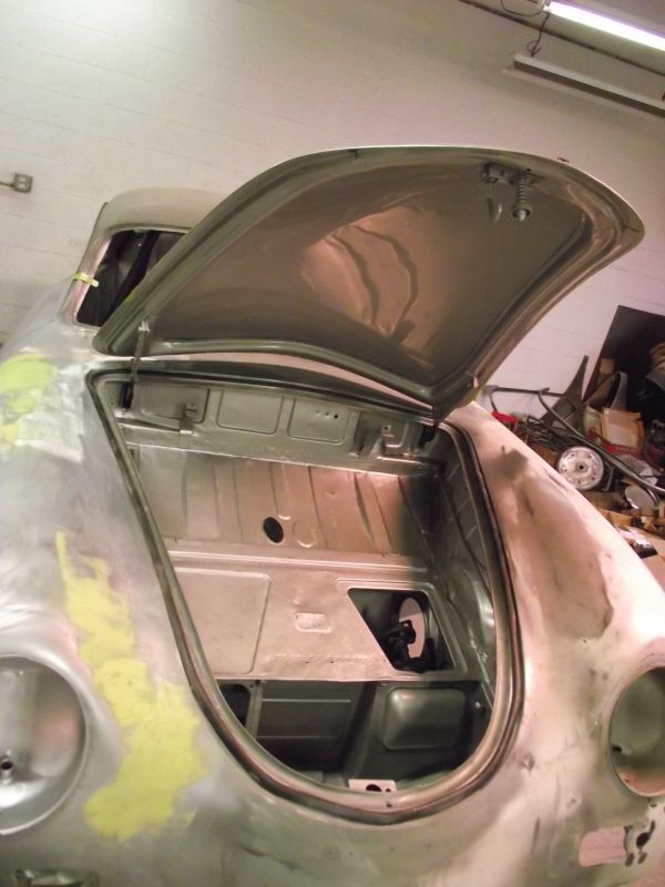

              Trunk gaps
              Now that the car is lower to the ground and the front of the hoist is out of my way I can now really asses my gaps and hood fitment.
              Spent this afternoon reinstalling the hood seal and then finally the hood itself. I ran out of time before I could mount the latch base in its final adjusted position.
              So far the gaps are just okay with some slight uneveness between each side. I might be forced to lead these gaps like the doors before but I'll wait until its fully latched and adjusted before I make that decision. Shit! remember when I said I'm only a paint job away and no more heat or welding required! Just when I think I'm done. Oh well I'll see tomorrow after I get it locked down into poition. Thanks for stopping by. Justin

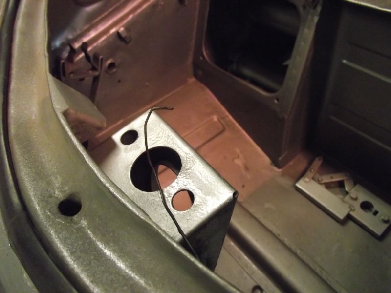

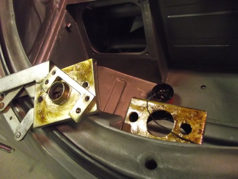

              • Bottom latch install and final hood gaps
                Installed the bottom latch reciever for the final time. Cleaned the release wire and black oxided it. This was one of those fun and rewarding jobs that gave me a small taste of how great life will be after final paint.

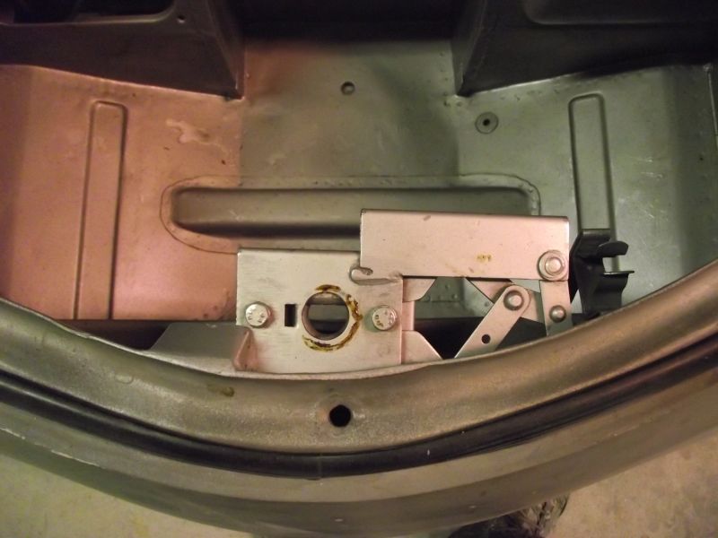

                At long last, mechanism mounted and hooked up for good. The old bends in the wire where a great guide on how it was originally secured. I double checked my workshop manual however.
                As a guide I put some grease on the cover shield of the upper catch to determine the most centered and neutral position.
                It all lined up and opperated better than I could have imagined.This isn't supposed to happen. Once the hood was slowly lowered past the secondary catch some mild finger tip pressure was all that was required as the latch went "click" making the hood fully engaged. I have witnessed a few resto's where the hood had to dropped almost a foot high to get it to latch. I wanted to make sure this was not the case here before final paint.

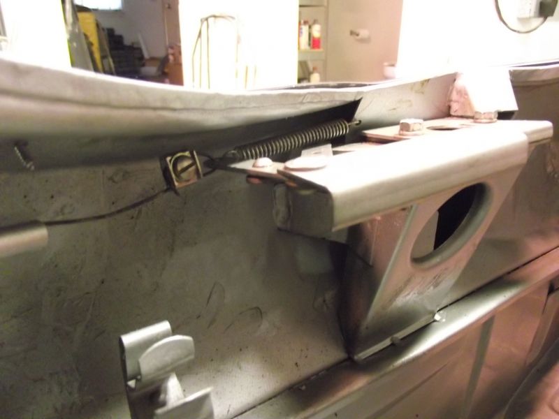

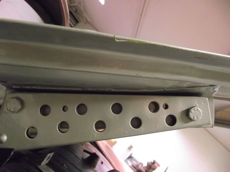

                    The hood is in its best adjusted and original position. Latches and hinges are 100% set.
                    The two smaller holes on this hinge were locating holes put there at the factory once the final adjustments were set. As you can see the holes in the hinge and the mount flange line up perfectly meaning this hood is now set in the exact same position as it came new from the factory.

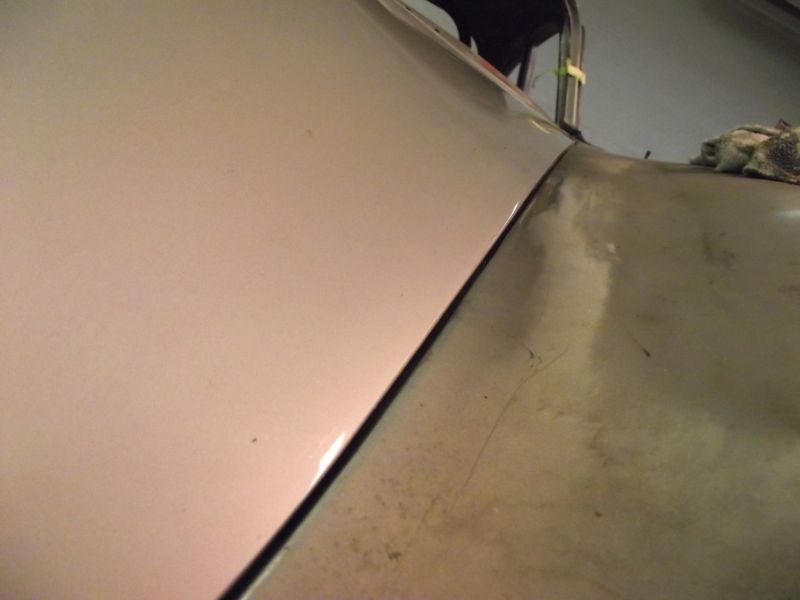

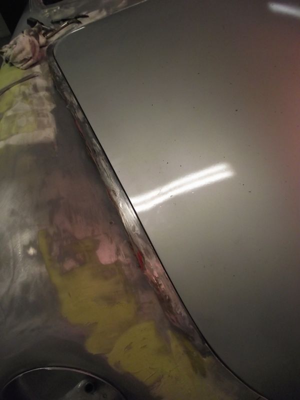

                    Still happy with the front gap which I leaded back on page 22. The left side is just okay but...
                    This right side gap is much wider and way too large to leave alone. Nothing has been disturbed or changed so it must have come from the factory with wide but I need to match the other side better and my new door gaps more closely. Gonna have to lead it.

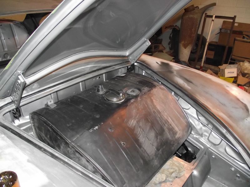

                    Since I am not punching in the access hole in the hood I wanted to make sure the fin on this gas cap was going to clear. I put some grease on the handle ridge and closed the hood. No transfer! Doesn't touch but its gotta be close! Prepping the right fender for lead now. Thanks for stopping by! Justin

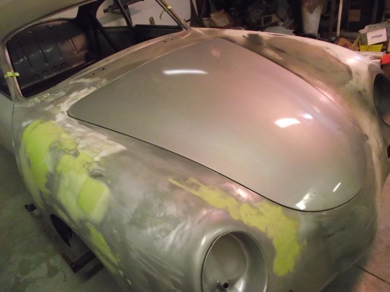

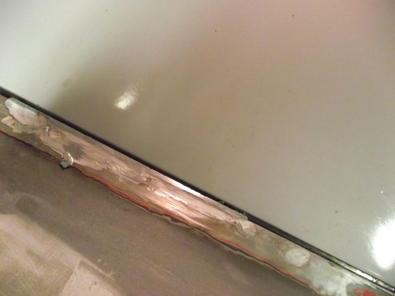

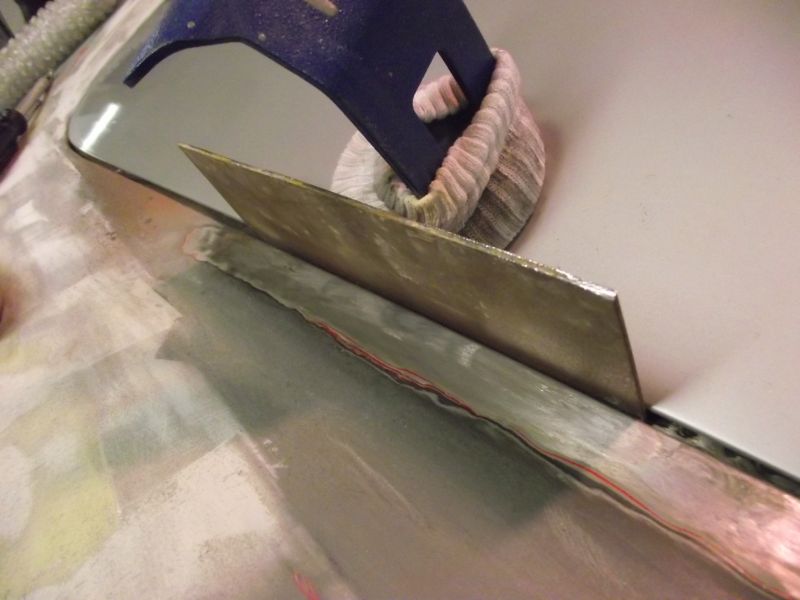

                    • Trunk gap leadwork 12/18/12
                      First test section cleaned and ready for tinning acid.
                      Prepped and wiped with the acid/flux
                      Back to the old plate barrier again. using this magnetized base to hold the plate in position.

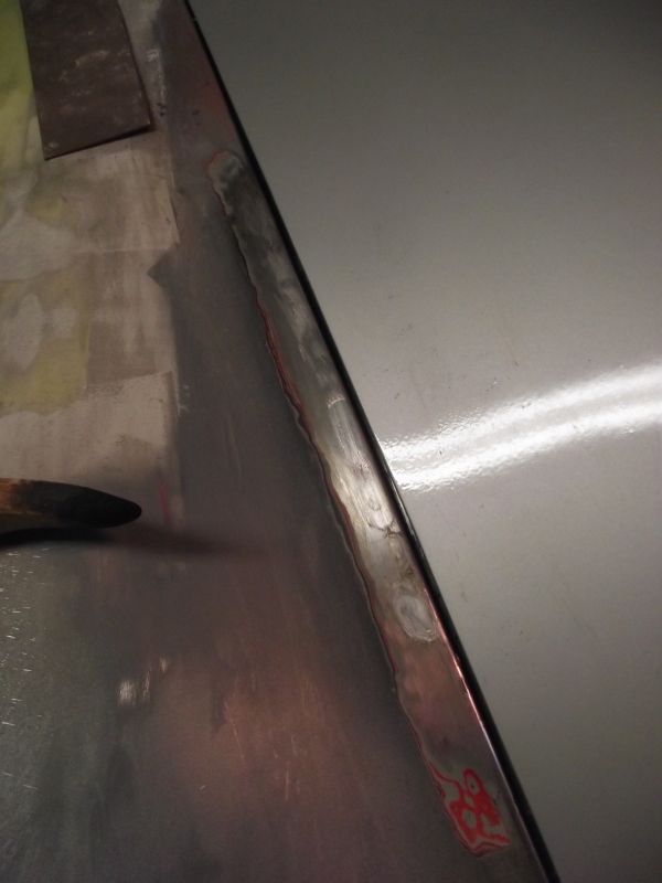

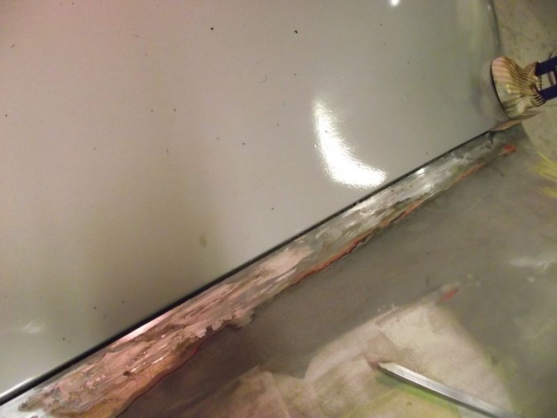

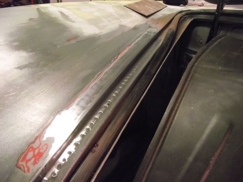

                      First section now leaded and initially filed. You can really see how wide the gap was to start with.
                      The rest of the right side run now cleaned and prepped.

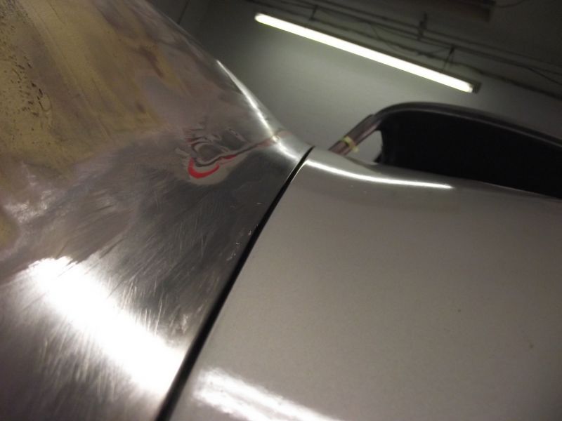

                      Entire right side gap now leaded. It matches the left side so much better now.
                      Many more hours of filling and shaping before I'm done but it was a good start today. Thanks for stopping by! Justin

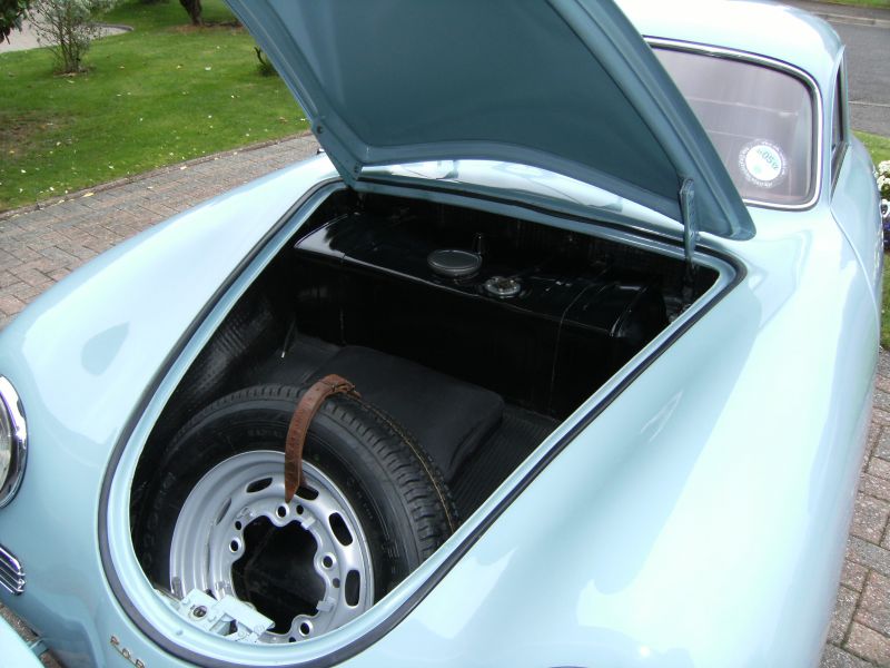

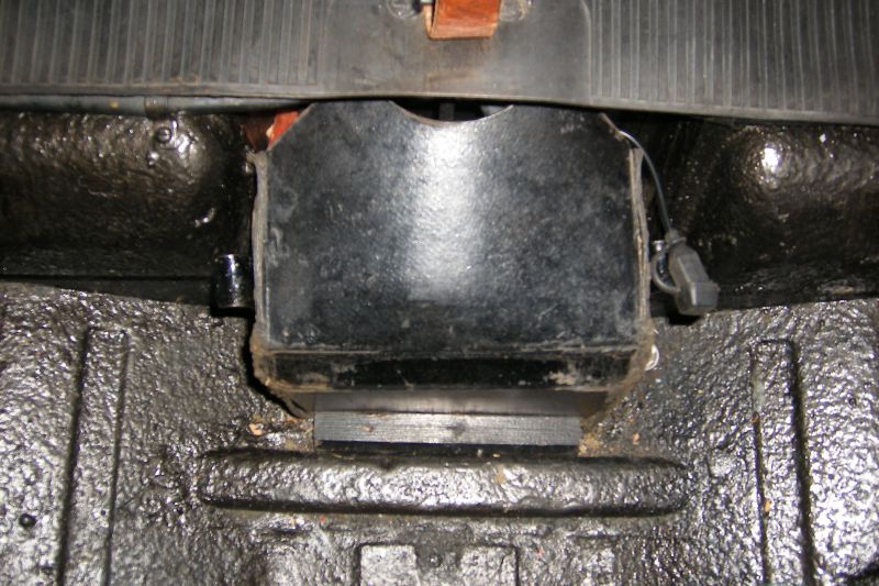

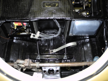

                        By the way the battery box area looks very nice painted. Mine is still original but coated in the black stuff. Are you keeping yours plain which looks so nice? If you do, then of course you have to sort the insulation panels on the interior sides of the hood area which are normally black.
                        Some pics of my battery box area and the sides. I painted the sides of the insulation some years ago but actually should have used a satin type black instead of gloss.

                          Thank you! Didn't want to add the lead but I had no choice. I am using sort of a new-old seal. its one I bought new 20 years ago from Stoddard but has been in a box for most of its life. It appears to be one of the thinner ones. It has some tears in it so I'll be putting another new one in. I'll be sure I get a thin one. I have heard all the horror stories of the thicker seals. Yes, just like with your installation eventually after some time and pressure the seal gives up and conforms. Yes, the trunk area is in its final finish. The interior detail shots of your car really drive home the point of how nice it is! Its alright if the black is a little shinnier than it should be your car is beautiful. Cute shot of your grandson, I'll bet he just loves grandpa's old Porsche. Thanks again! Justin

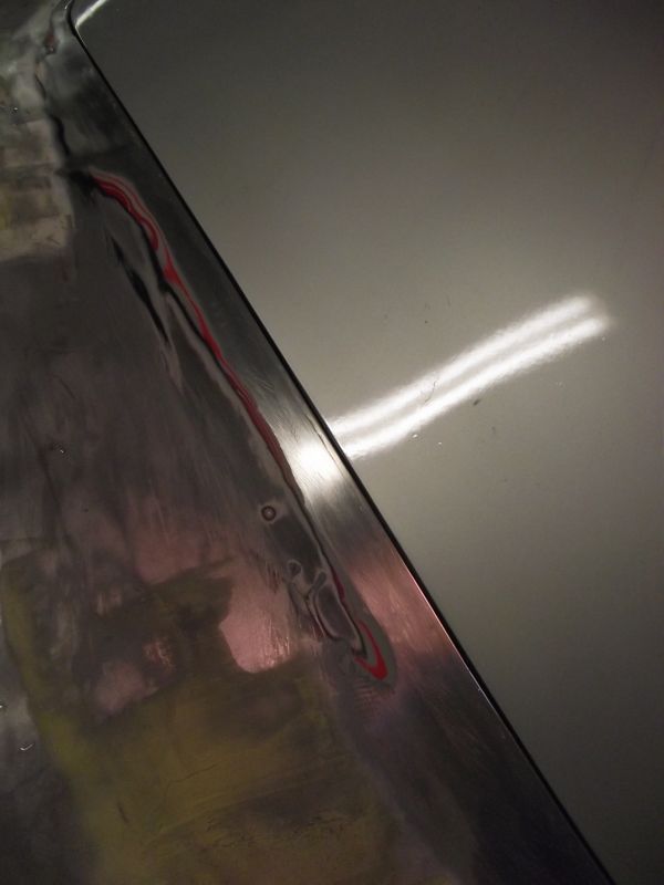

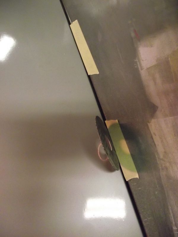

                          12/19/12
                          newly leaded gap now fine finished.
                          Filed and wet sanded the lead back where I needed. I used alot of soapy water to also ensure I get all the tinning acids off before the top coats are added.
                          All basic building done in lead as before and all final perfection filling will be done with putty and primer. Elevation are good all around. Thankfully no trouble there.
                          Matches up very well with the left side pictured here. Again will do all the perfecting in thin veniers of plastic filler. Won't take much.
