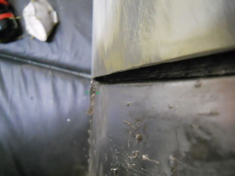

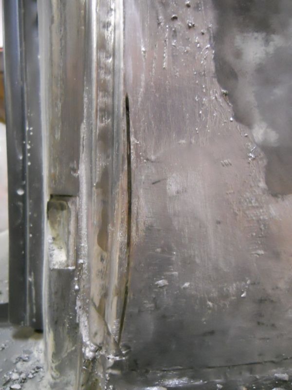

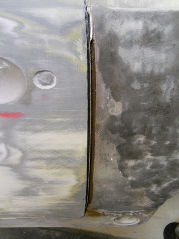

        with the door closed and the factory lead gone I was shocked at how poorly this cars panels were fitted! This body must have been built on a Friday afternoon just before holiday break.
        Big gaps are of course expected but the horrible approach elevation at the fender is what bothered me.

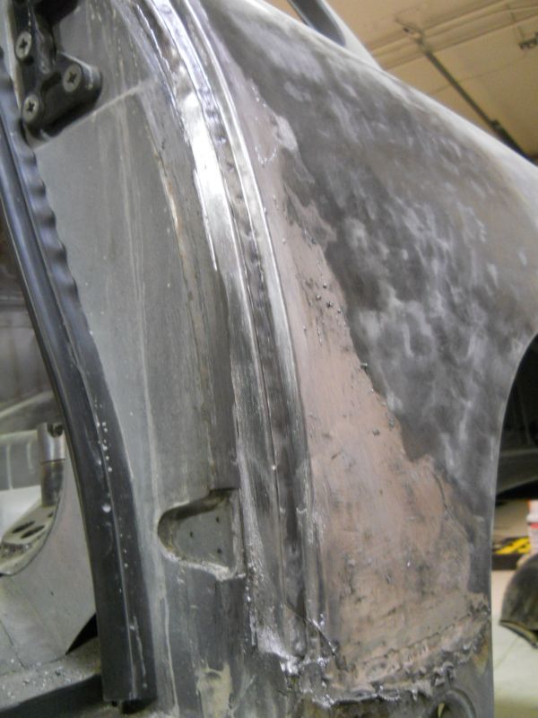

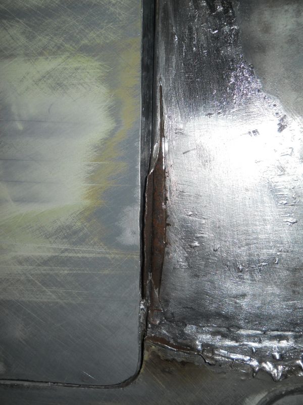

        Here is the lower section peeled forward with the old corner bend relaxed. The "new" gap will require far less lead filler this time around. I was liking this so much better!! A you can see just like ANY 356 on the planet (no matter how "rust free") there is rust in the pinch seams; very mild though but still present. Getting late.. will continue my "detour" story tomorrow. Thanks for reading this! Justin

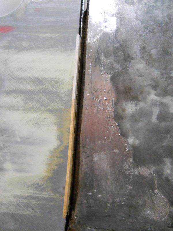

            New basic gap now established. The very top gives an idea of where it started. Obviously a filler strip of metal will be needed on the edge of the skin.

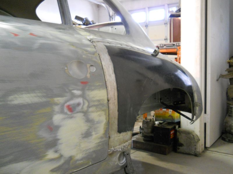

            With the gap set my next "filler" reducing chore was the level of this skin at edge. Before I could do this I had to decide weather I was going save this original fender or just replace it.

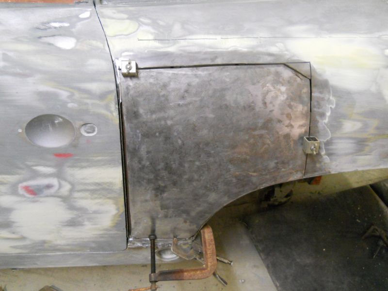

            After several hours of debate I decided to stay conservative by attempting to save the original fender skin. Besides the back portion actually turned out good and I did not want to throw away any more time that I had already spent on it. I had destroyed enough already. I cut this badly worked section free at the rocker joint and just at the wired lip to preserve it. If it works out the only weld lines visible will be the upper length and rear vertical runs. I also was looking for more shouldered weld joint to reduce heat distortion.

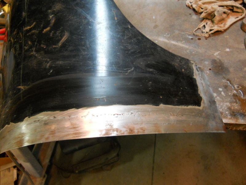

            My next decision was to either iron out this original piece or replace it with a fresh section of 20 gauge.

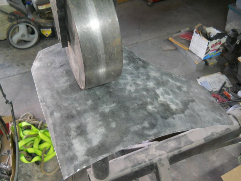

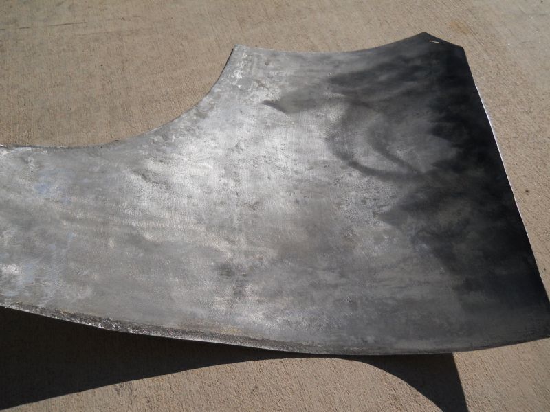

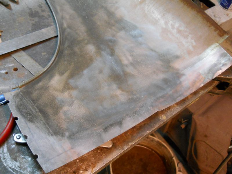

            Either choice would require a run through an English wheel so I decided on saving this old portion again.
            I made a trip over to my buddies shop to borrow his wheel. (another tool I need on hand!) Its chalked up here. I spent several hours carefully and slowly rolling this piece. I had to take care not to change its basic shape but to only level and realign its surface. I really need my car to be in the same room so I could check the progress as it went but his speedster body made for a good surrogate. Again doing my best with what's available to me...

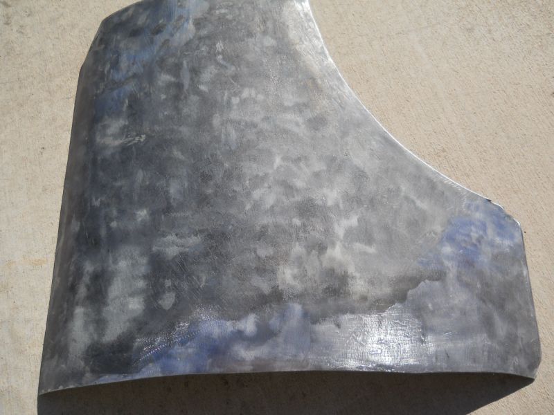

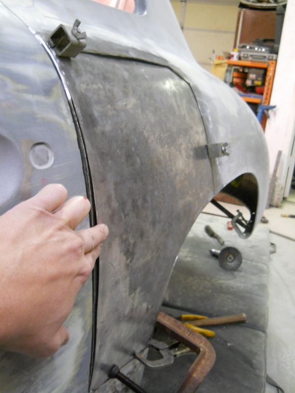

            First fit after getting it back home. I was unexpectedly surprised how good it fit. My biggest fear was twisting it out of shape with the wheeling.
            Basic contour and shape are good.

            Besides smoothing the surface another benefit of the wheeling is that it hardens the metal. This panel feels very resistant to "oil canning" now as it was doing before. That could certainly change after welding but for now its good!

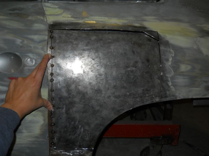

            The required skin filler strip was next. New piece cut with a good tight gap and ready for its first tack weld here.

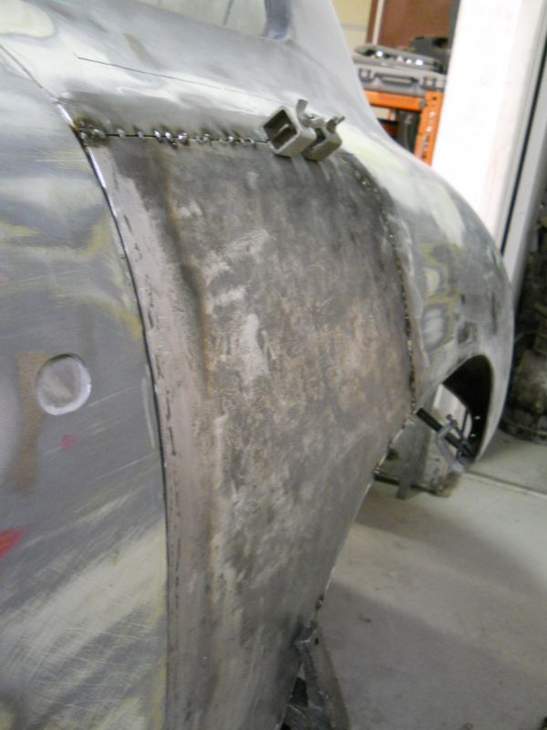

            New piece fully tacked and in for a test fit. I ground these heads smooth and gas welded this portion on the rest of the way by melting the two ends together with no additional material introduced. It was nice not have to grind down a weld.
            Old panel section tacked into final position and fine trimming the excess off to the newly positioned flange.

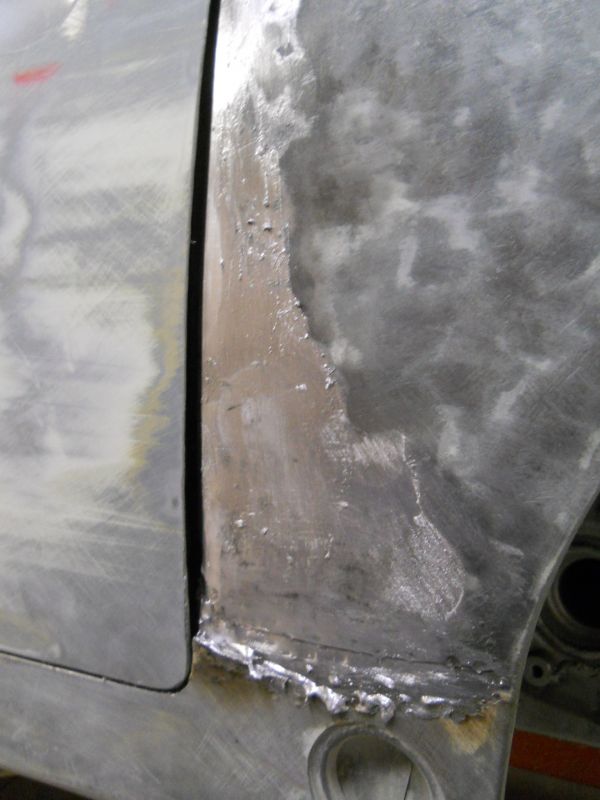

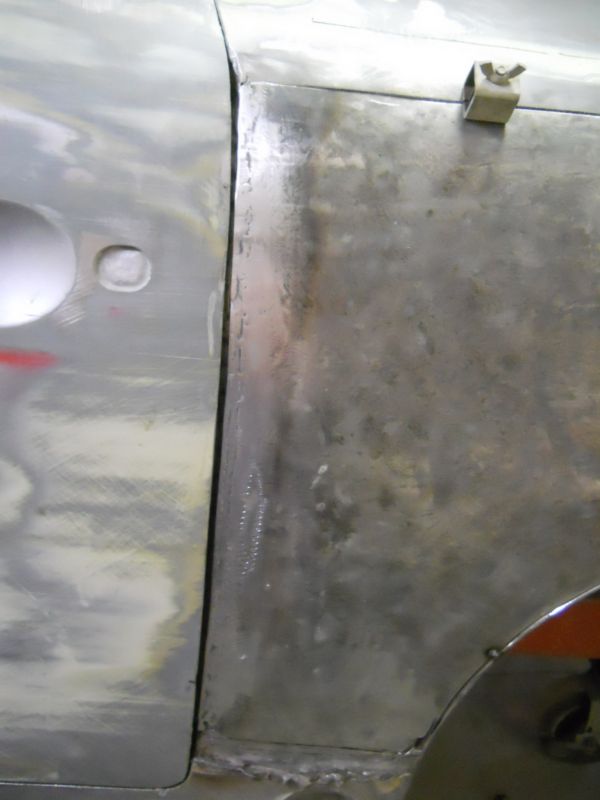

            My new base line gap and skin elevation. Gap is still wide and slightly irregular but will require far less filler than originally to be perfect. That's all I was after, not trying to reinvent the wheel just wanted to feel better about this junction.

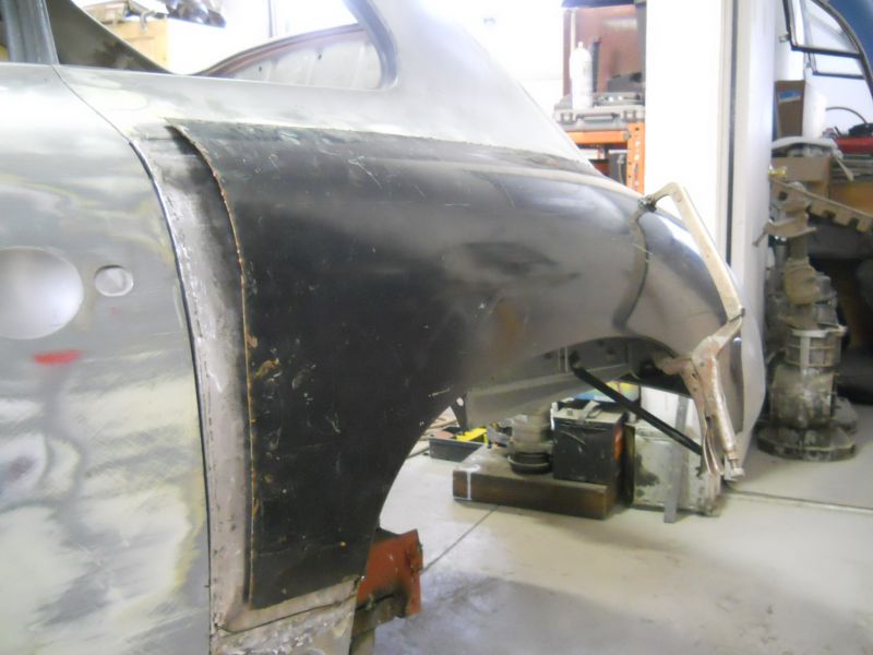

            Here is where I am as of this entry. The slow and tedious process of tacking and welding this old piece back in.
            Taking extra time to ensure both sides a aligned to avoid creating a tension or trigger point in the surface. Not out of the woods yet! Only after its welded will I know if this was successful or not.

                    I cut the skin at the wired edge and left it with the car. One of my goals was to not cut that wire and besides it had to be out of the way to wheel the entire section. I would really like to see your old slides from back in the day when you tackled your car! Looking forward to it and hope you'll find some time to locate them. Thanks again Roy I really appreciate your support through this mess! Justin

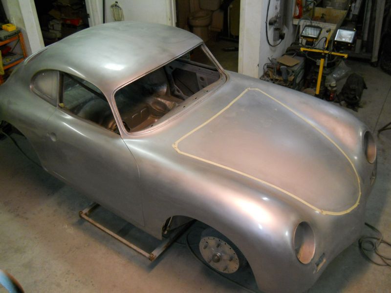

                        1/8/14
                        Rear fender repair failure

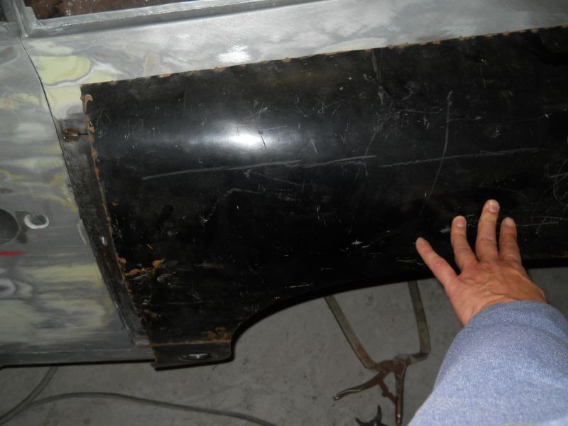

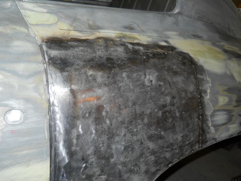

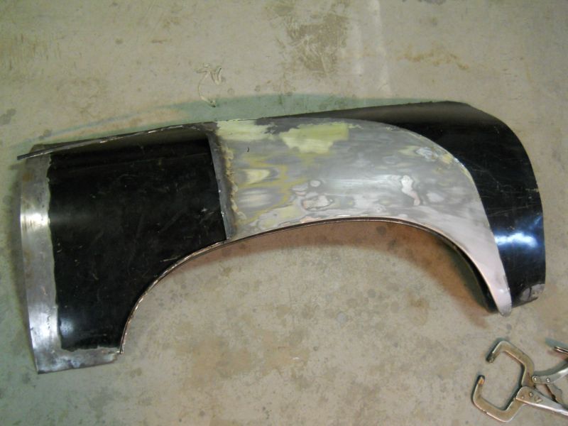

                        I was so close! I had most this panel stitched back in with very little distortion. However, Once I made the turn down the vertical seam this whole repair went sideways in a hurry! The wheeled patch was of course now harder so once I joined it to the softer vertical and flatter section it began contorting the profile. The middle was now a bit low so I began bumping it up a little, then it was too high then I decide to put a little torch heat to it and shrink it ... it was like pouring gasoline on the problem and its shape got worse... all that ran through my mind was why did you FUCK with this; now its going to need as much filler as before to be correct by the time I get stabilized again!?!?! I kept messing with it for a bit longer and as I continued a portion of that patch began oil canning again. I completely lost it and punched it square in the middle of that panel. It was a done deal then. I had created such a mess of it that I was simply in over my head at this point.

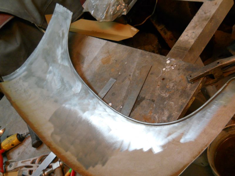

                        New fender replacement section.
                        This original fender section from my '56 coupster project is actually in really nice condition. there is no filler on it (yet)and has only some mild waves across the reflection.
                        However I had cut it short years ago so I had a bit of preparation to do before I could mount it. I can only spend an hour a day working on this car so it has taken me these past few weeks to finally get this panel to the point where I could tack it on the car.
                        First order of business was to add a new length section. I took extra time and care during this process. I'm on my last chance; if I burn this one I'll have to buy a new fender.

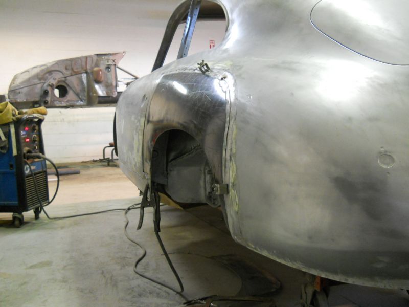

                        • New section tacked in as of this afternoon. 1/8/14

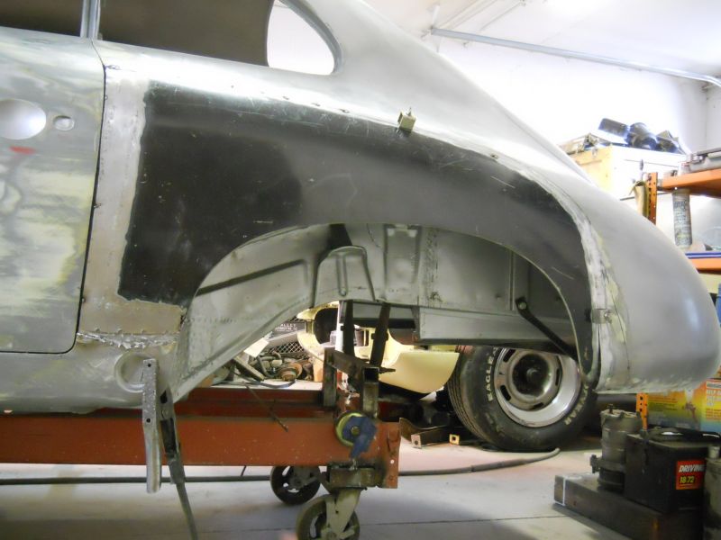

                          I had finally climbed out of the hole I made for myself enough to update this thread once this was at least partially in.
                          Several adjustments to do as it goes but it at least is heading in the right direction.

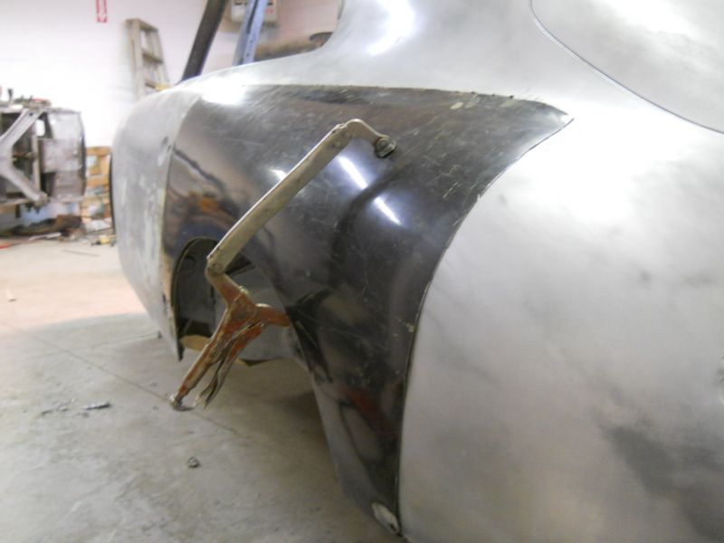

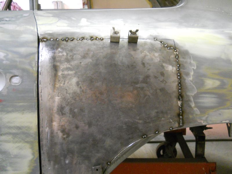

                          Ever so slowly stitching this in. Continuing on tomorrow. Thanks for listening! Justin
