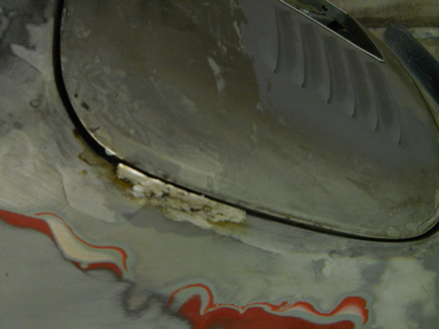

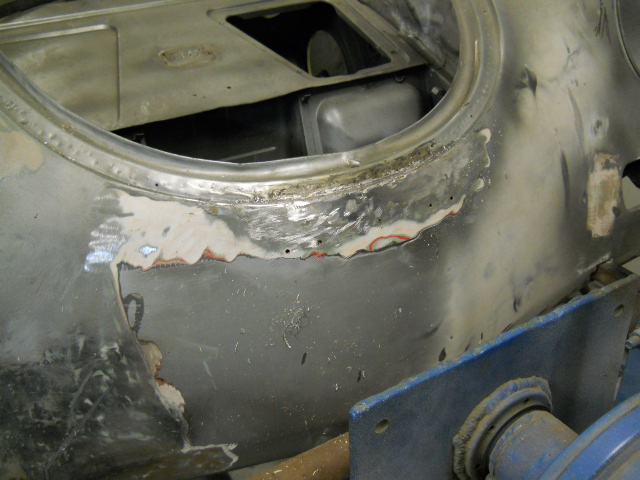

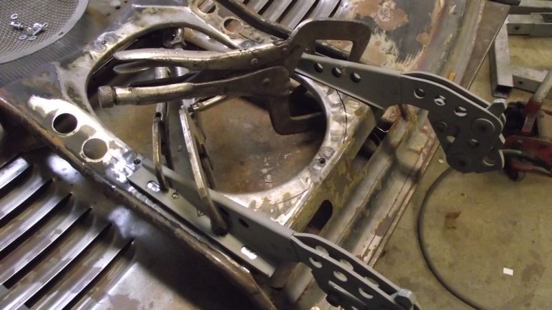

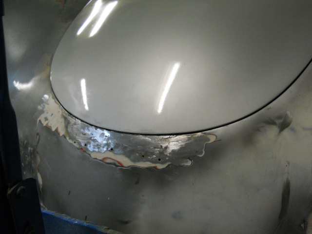

      Some very old damage which was also done in bondo up at the trunk lip needed to be redone in solder. Cleaned the area back down to metal so I could lead it and correct the trunk gap.
      Area now cleaned of all filler and paint. ready to be soldered.

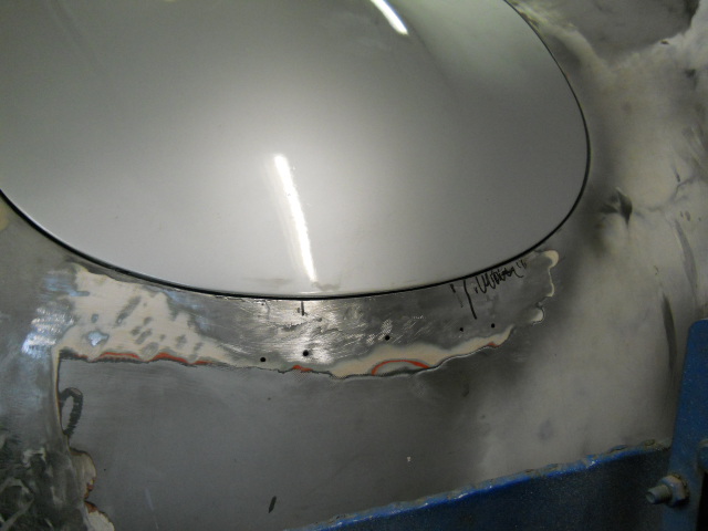

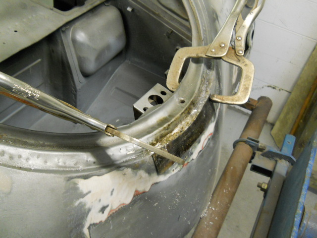

      Could not build up the leading edge without losing some of it to gravity. Had to go back to the old trough trick.

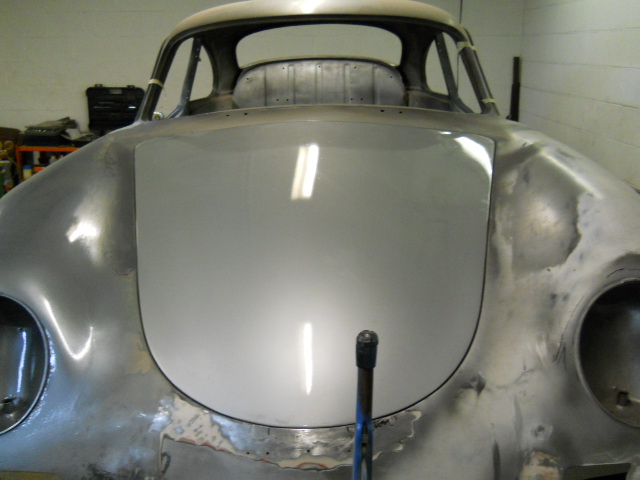

      initial fitting with hood. Lots of filing and shaping to do.
      More gap work to correct further up line but will get it.

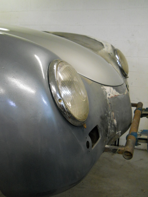

      as you can see I decided a while back to shave the hood handle. The handle is okay but I think its so much sleeker without it. Besides its just hole drilling to bring it back.
      Profile shot. The hood to nose profile is taking a nice contoured line. Very happy with that.

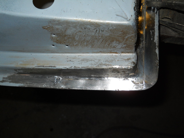

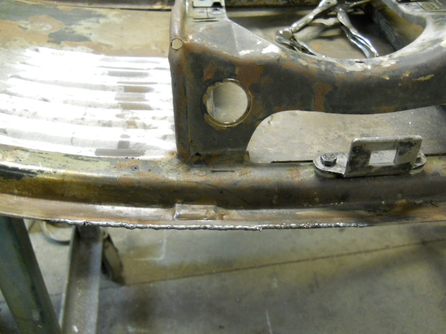

                    • Finishing touches to the left inner door flange where our old repair was on the corner from the 80's. This part of the patch was poorly done and I wanted to go back and make it correct.

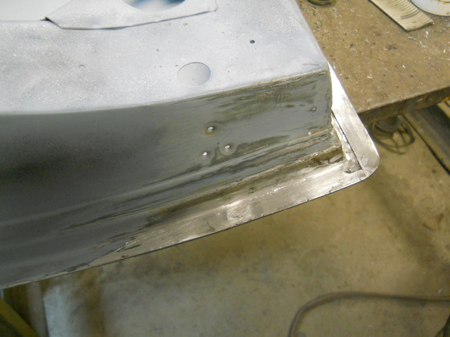

                      Here is the flange. The bottom 4 inches and the verticle 3 inches were redone to look factory. The original lead in this area of course was lost.
                      resoldered like it was and now ready for primer. This would have been finished in Putty a couple of months ago. So glad its done correctly.

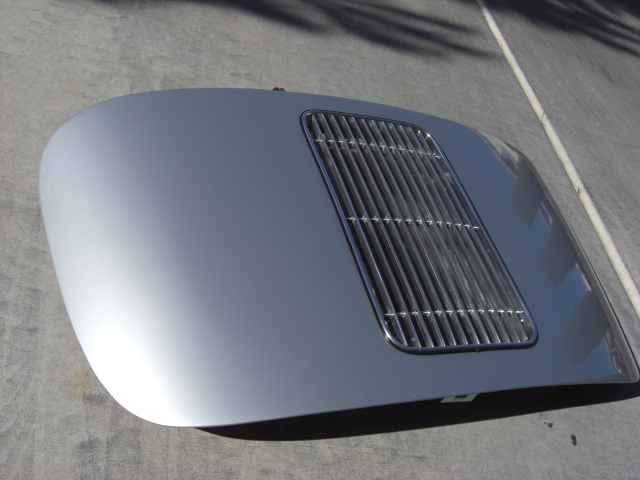

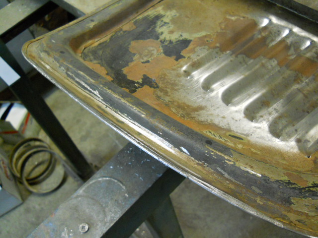

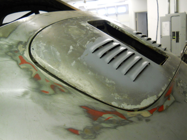

                      This is the original numbers matching lid(367) to this car. I for some foolish reason had restored completely by itself. Waste of time since it will have to blocked in with the body. The gaps are alright but they could be a little better.

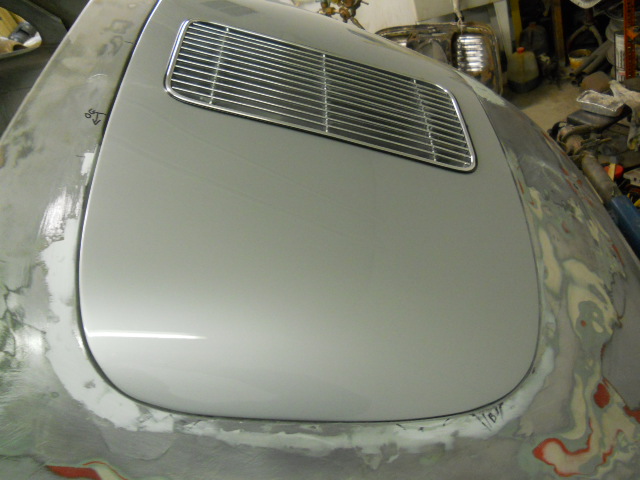

                      As you can see in its best adjusted full latched position with the rubber grommets; the Right side gap is pretty good.

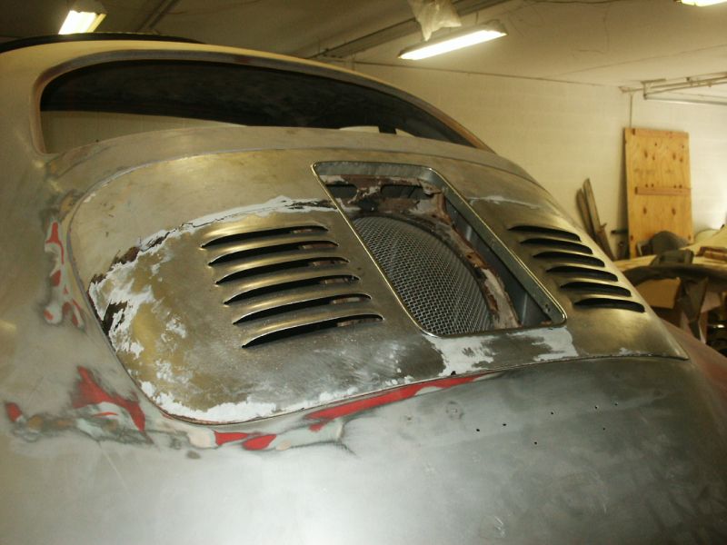

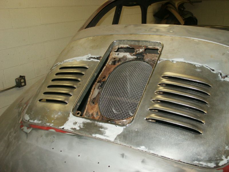

                      As I mentioned earlier I am restoring this car as a GT light weight clone. Always loved the look of the louvered decklids so I sent this spare one I had out to GT werk. It came back beautiful! I could not be happier with the conversion.
                      Louvers have the correct width and cues making them appear to be spot on. I have seen a few lids with domestic hotrod style louvers and it just doesn't cut it for me. The factory style vents look the best hands down! I also had the rain tray punched and screened.

                      As I mentioned above this is the original numbers matching lid to this car. Though I want a GT look altering this panel by punching louvers in it was not even a consideration. It was a spare lid or nothing.

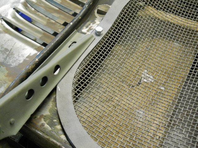

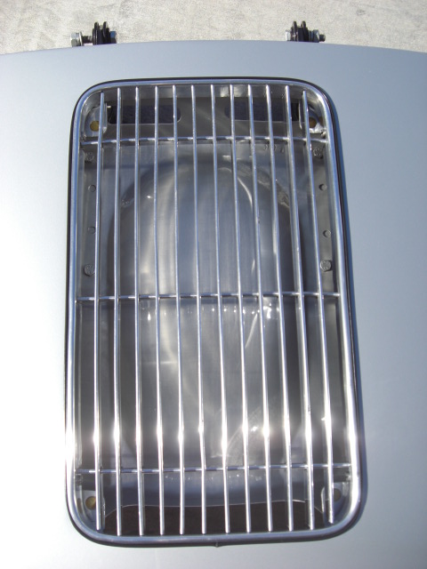

                      I have more hours than I care to think about in hand polishing the original grille. It came completely apart to be restored. Note the original plastic plugs for the luggage rack mounts.
                      Original hinges were fully adjusted and set for gaps before final paint. Gotta keep the paint on those bolts virgin! Its install ready but is now mothballed away with my standard gas tank, standard brakes&wheels, fatback seats, overrider tubes and all the other original parts to bring it back to stock GS specs.

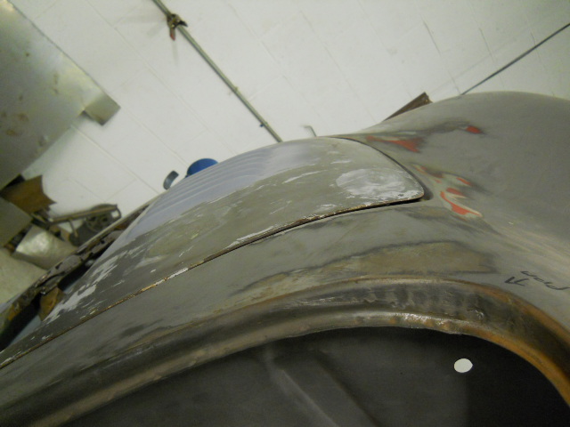

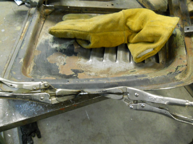

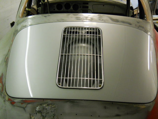

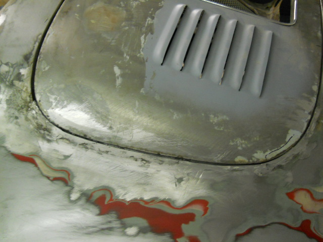

                            • Before I began leading the decklid gaps I had to mount the hinges and establish my best adjusted position on the GT lid. It wasn't very good as you will see. The fitment was horrible to say the least.

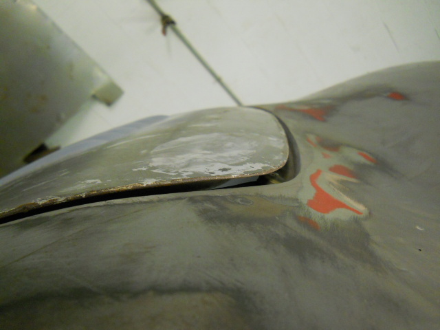

                              Same story with this lid. the right side fit better than the left though that was not saying much.

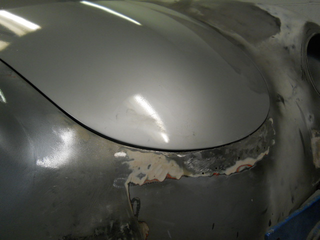

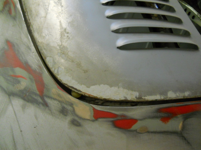

                              Huge gaps especially at the corners!

                              Would take alot of messaging to get this lid to fit right.

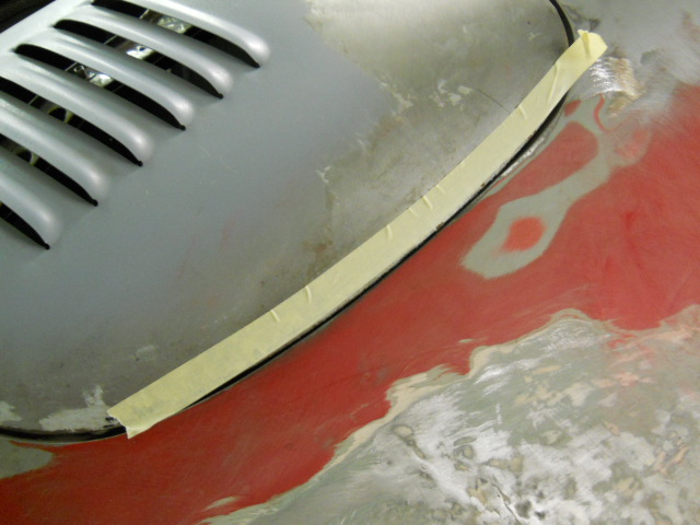

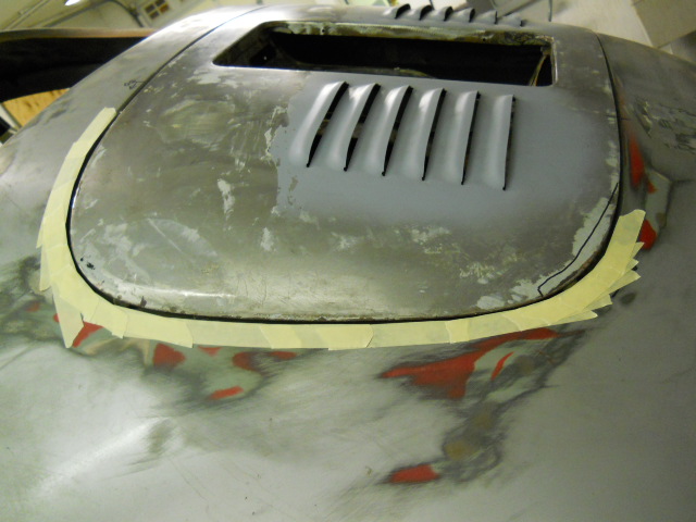

                              Before removing the original lid I put down some masking tape to simulate a nice gap with it. I removed it and put the GT lid back on, It fits almost perfectly. There is some slight differences in the arc at the corners but I'll add a little steel in to correct this. So its been determined that the fix is almost identicle for both decklids. This at least makes it a little simpler.
                              The right side lateral edge was a bit tight in the center. I Laid down some masking tape to sight a good line that matched the upper and lower corners as well as the opening contour. The leading edge also turns a little too tight. I'll have to relax it a bit to line up with the body.
                              Trimmed a few MM's off using that masking tape as the guide. it opened up the gap just about right where I wanted.

                                Right side fitment complete. Good even gap all way around. Relaxed the leading edge for a smooth transition from body to decklid. Some minor shaping still to do but Its getting there!

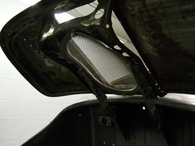

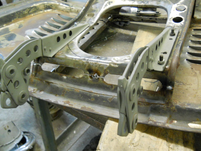

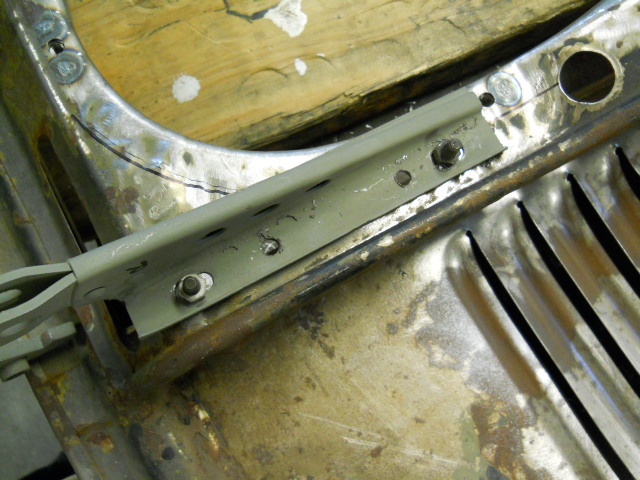

                                Here is a perfect example of the extra work you make for yourself once begin modifying components. The GT screen I had installed now interefers with mounting of the deckid hinges.

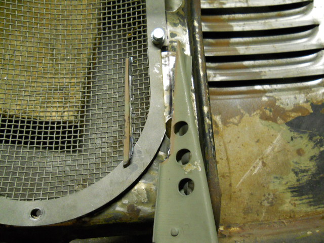

                                Had to trim away a little of both to get the hinge to seat properly. here is a shot of the initial cut to both.
                                I rewelded the flange I had cut off earlier to clear the screen. I stepped this section higher to now fit and dressed the welds.

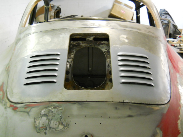

                                All modifications needed to make this all work together now complete. It even fits the car exactly the same as before I messed with it. I catch small breaks every once in a while.

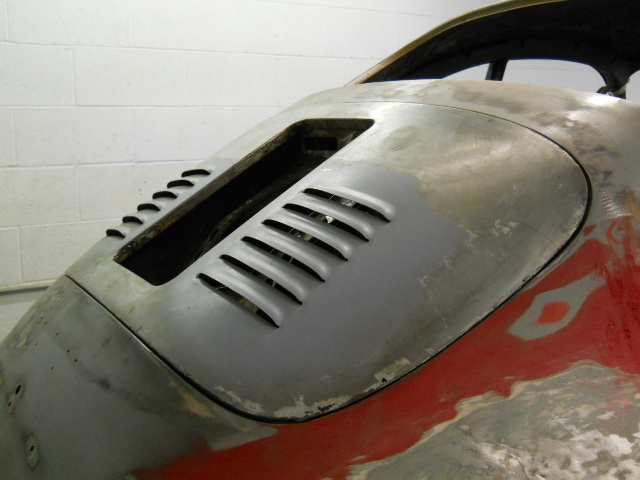

                                With both lids now basically fitted I could now move onto the leadwork. Intial fill of solder pictured here.

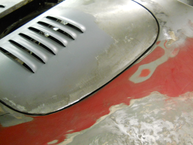

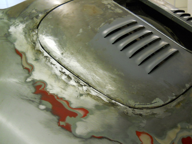

                                Entire left side run now closed tight with solder. Die grinder next to begin opening it back up to match the right side.
                                Gap is now opened up to match the right side. Corners are still tight and more solder needed up top.

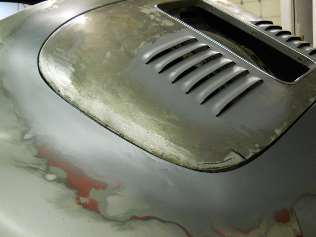

                                Got a little ahead of myself shaping the left side gap to the GT Lid. I went back and reinstalled the original #'s matching lid to see where it was at. It was too thin. I had to refill a section of it then shape it to the original lid. But I am done in lead here now. All the gaps are set and I'm happy with them. I've reinstalled the GT lid to begin shaping it to the body contour.

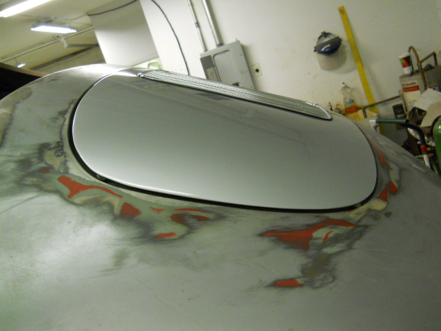

                                left gap and contour matches real well now. I can live with it. I have a ton of time here filing and sanding it to shape. I must have opened and latched that decklid 50 times during this process. laid a little filler in the lead to catch the big divots before primer and paint.

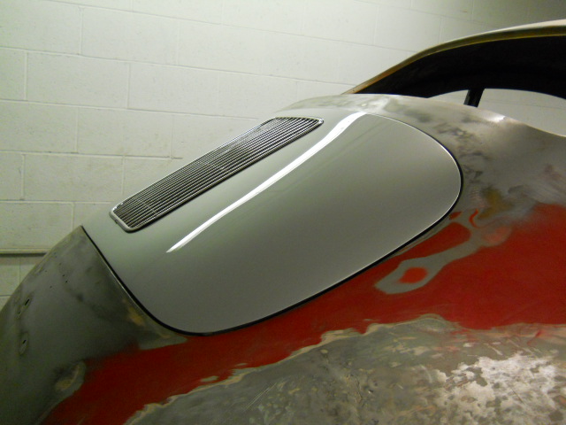

                                With the body line set to the original lid and the lead behind a coat of primer and paint I've now reinstalled the GT lid for final fitment. Top corner is nice. Side is too tight and will have to be trimmed and welded (like before). Lower corner is short and will have to add some steel there. Final fitment of this GT lid coming up next. Thanks for stopping by! Justin
