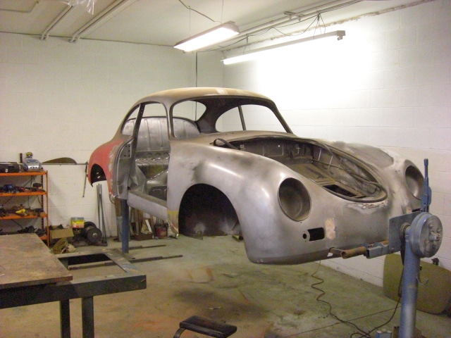

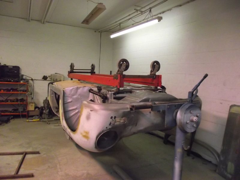

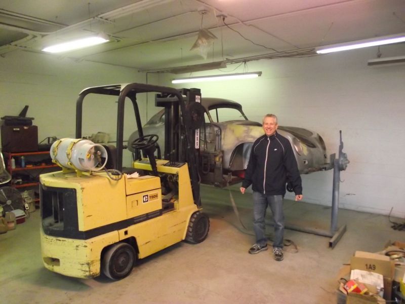

          After 2 years 6 months on this hoist (car pictured above the day it was remounted) All of the metal work and fabrication requiring the use of a rotisserie is now finally complete. God it sure felt good to type that just now. My Buddy is hopefully going to swing by the shop tomorrow with his forklift so we can finally dismount this shell!

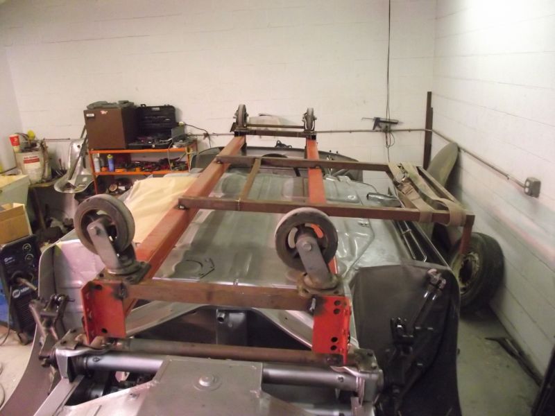

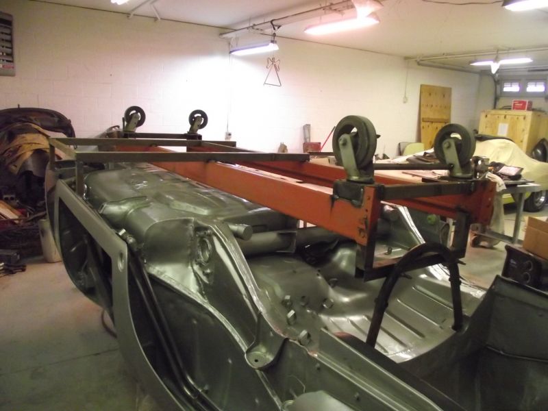

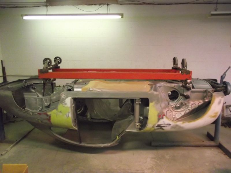

          Spent this afternoon prepping and remounting this frame dolley I built several months ago.
          Remounting this car was less stressful then because it had no rockers installed. A lot more care must now be taken to ensure they do not get crunched during the dismount.

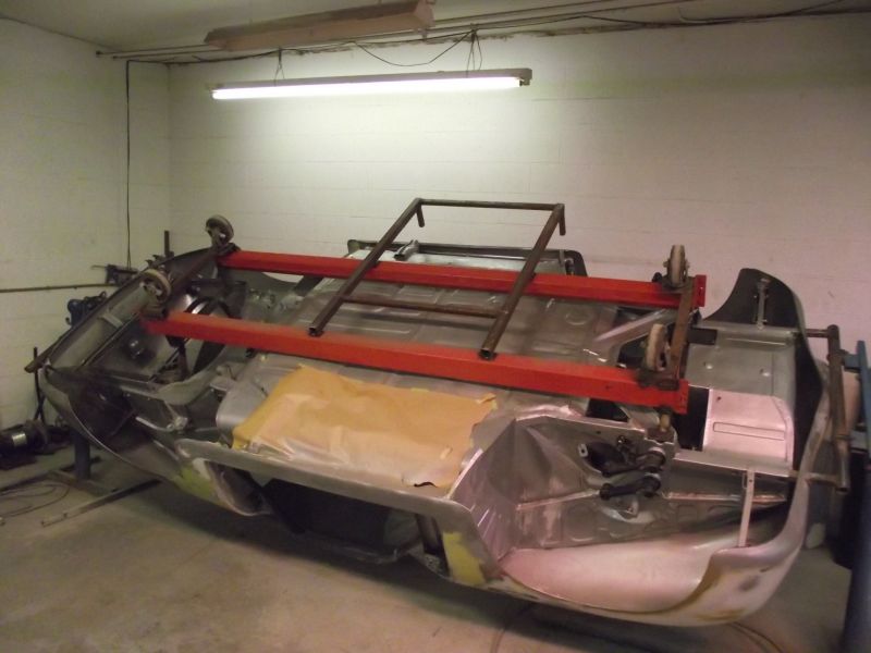

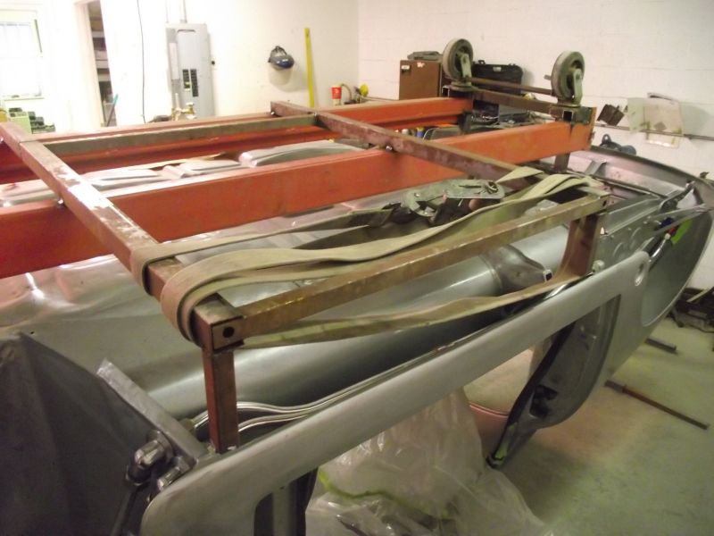

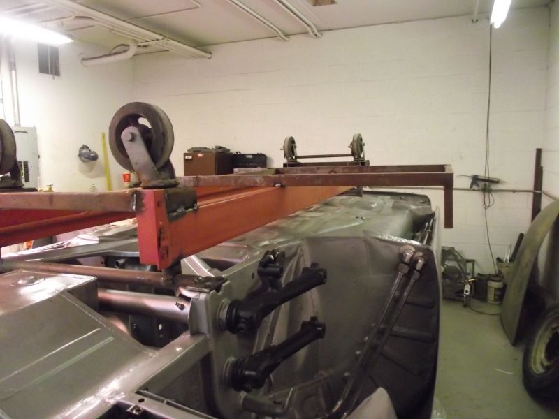

          I welded this sub-frame on which will act as direct contact for the forks and a barrier to keep the rockers clear of the lift.
          As you can see the end of the frame sticks out just past the body and will act as the buffer.

          once in position this frame will be strapped to the forks before the "big lift" to ensure no movement or slippage.

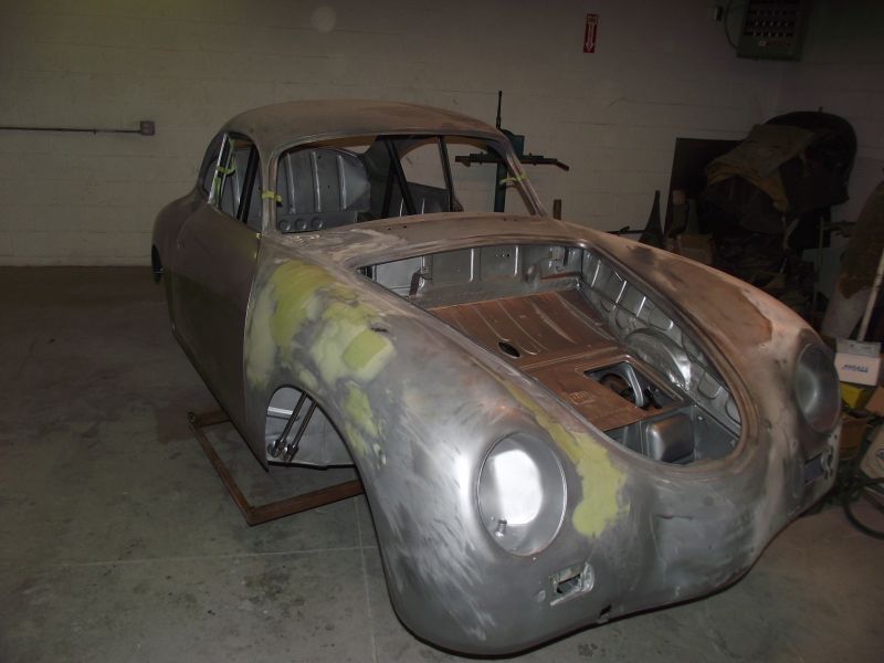

          • Car safely back on the ground and a new chapter begins!

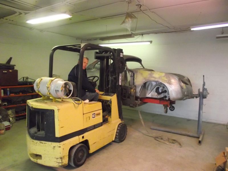

            My buddy Mark made it over to the shop late this afternoon. Just about ready to go here.
            Forks have now been securely strapped my little subframe and we're all ready to go. DRUM ROLL PLEASE!

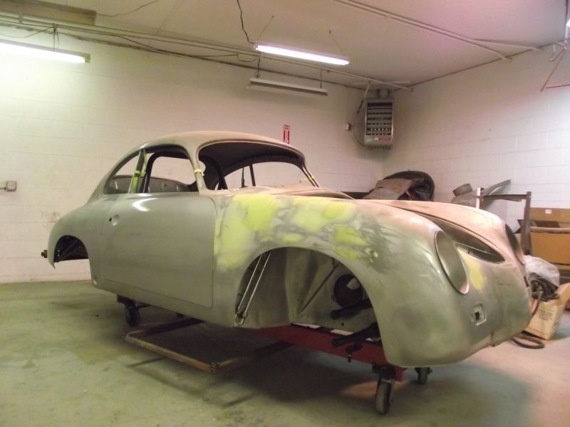

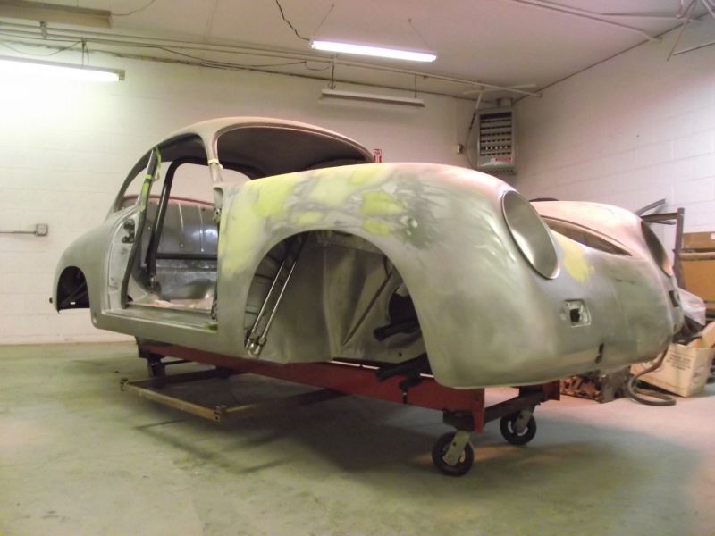

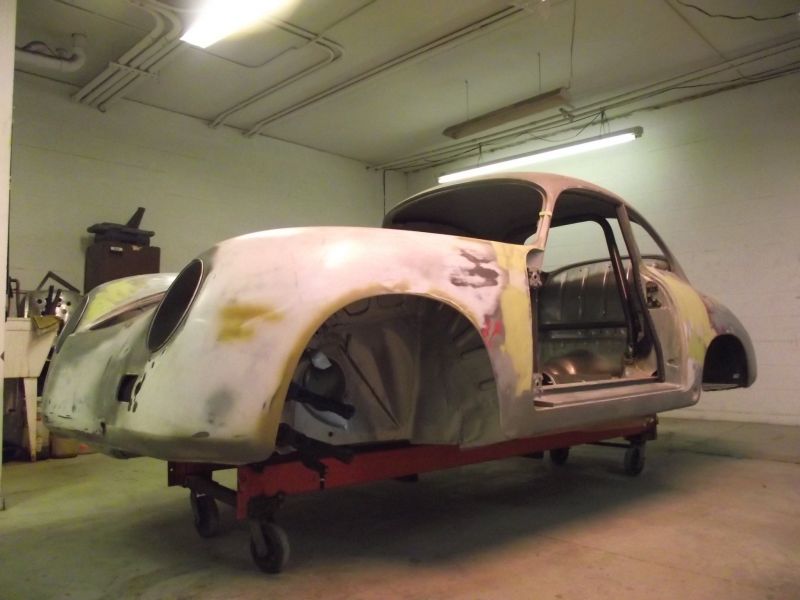

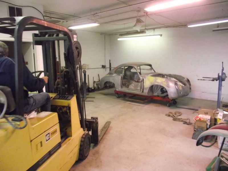

            Safely on the ground with no issues.
            It was very strange after all this time to see the body so low to the ground. I'm used to the rockers being waist high.

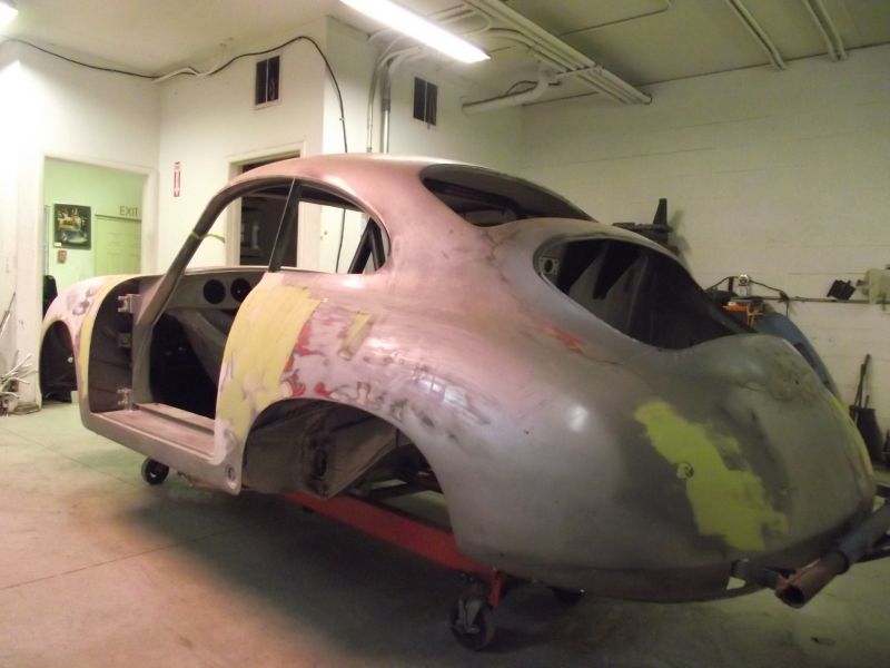

            Could not wait; I wanted to see how the roll bar looked at more realistic height/vantage point.
            I'm happy so far.

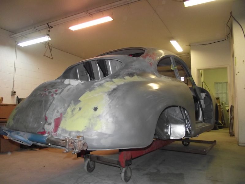

            The little subframe worked perfectly. It kept the body clear of the forks and made a great tie-off point.
            Only a paint job away from reassembly! Such a sweet spot to be in after all these years and effort. No more torch heating, welding or fabrication to this body! Just straight forward blocksanding which I can practically do on autopilot. Got my weekend planned now. Thanks for stopping by! Justin
