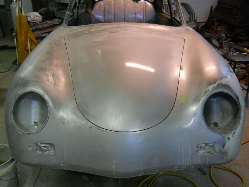

          Front end of the car just about ready for final paint.
          Since starting the Speedster conversion I have neglected to get anything done here for the last couple of weeks. It was really beginning to upset me that all these days were rolling by and not a thing was moving forward with this car. I made a decision about a week ago to commit an hour (and only one hour)each day. I bring my stopwatch and when my hour is up I move right on the other project. Much to my suprise and relief it is amazing what can be accomplished. I just had to set the time aside and be consistent; just like going to the Gym.

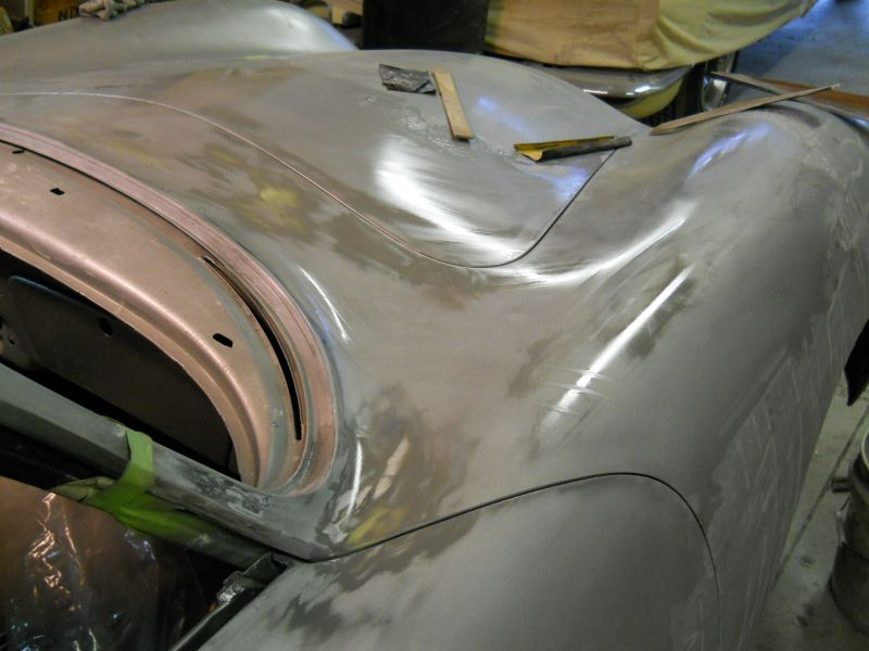

          Most of what I had to remove were deep scratches and "saw marks" up by the windshield sweep from my earlier aggressive block sanding and lead filing stage.

          Much time spent carefully sanding/shaping this A pillar transition.

          tricky areas here,lots of slow careful shaping around the gutter and the spill-way at the fender to cowl transition. Easy to wear a groove on an opposing face if your not watching it.

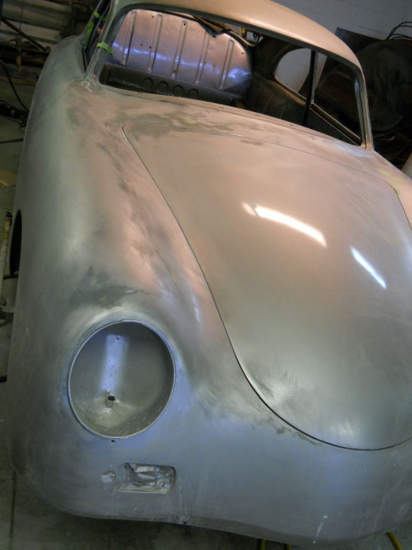

          Hood gaps are finally all set. Just had to fine shape the shoulders for consistency throughout.

          During the unproductive phase I really dreaded looking at the front nose area and all that still had to be done. An hour a day eventually got it finished.

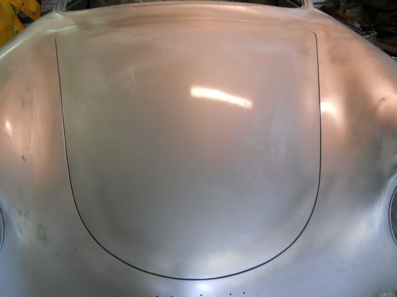

                        The one hour a day ritual is slowly but surely paying off! The hood,gap and nose are finally complete and now ready for final color.

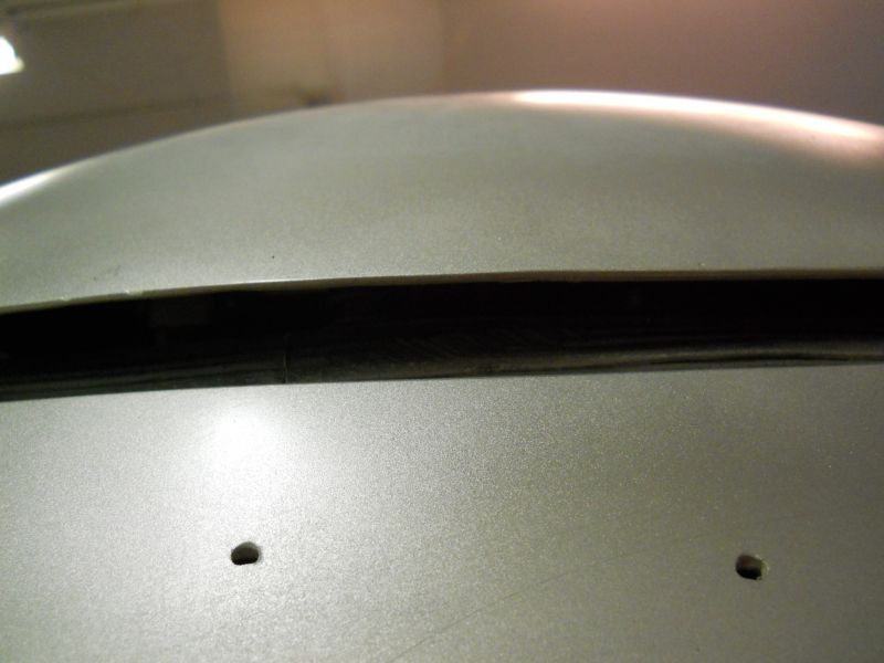

                        Primered yesterday and today shot the final work coat on this gap area and am now offically done shaping.
                        I can still see areas or angle were I could maybe get it a little better still but I can live with it and have chased it as far as I want to go at this point.
                        The hood gap is at least even and consistent throughout which was a real time investment.

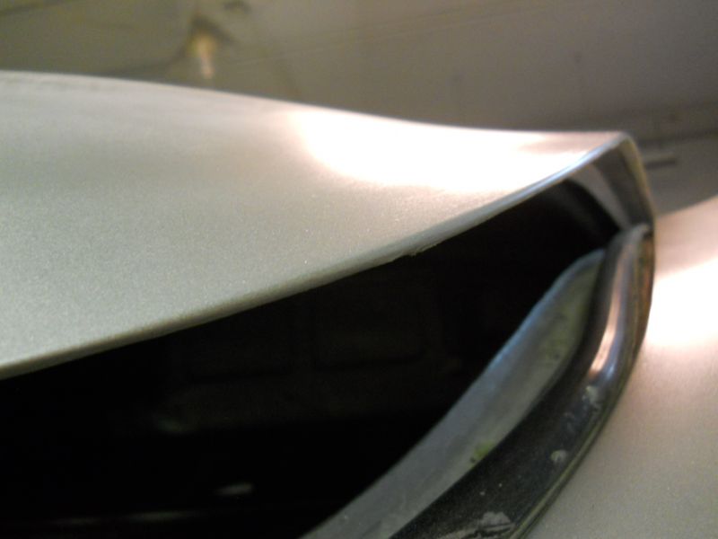

                        • Same rule applies to the hood as it did while I was working the right side door in; the make or break detail which cannot be hidden under paint and primer is the leading edge thickness of the panel once its opened or ajar.
                          I went the extra mile to make sure all the edges of this hood were a believable thickness.

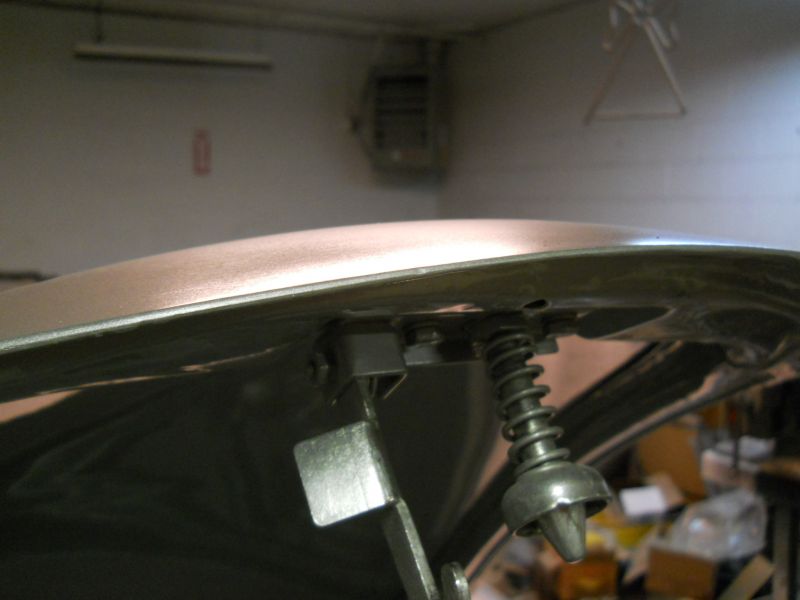

                          This required several removals, love tapping then re-installation.

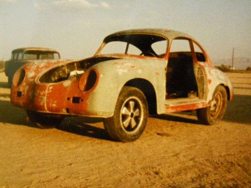

                                I hope you've had some luck repairing your garage door by now. Yes, it would be suicide to try and get that hood leveled and worked in with out the seal being in there. My new concern will be how much if any will the final new seal make once its mounted. Will know soon. Glad you liked that bit of trivia on those old marker circles I ran across. Here are few photo's I digitized from that time:
                                These pics are dated 8/88 on the back but I recall spending a year learning and trying to get this body straight. Most importantly I was learned how to "read" the topography of the surface and what the succession of paint layers was telling me as I block it down. This is how I spent my summer vacation from school; waking up just after dawn to beat the mid-day heat wet sanding and slinging bondo.
