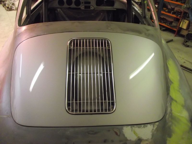

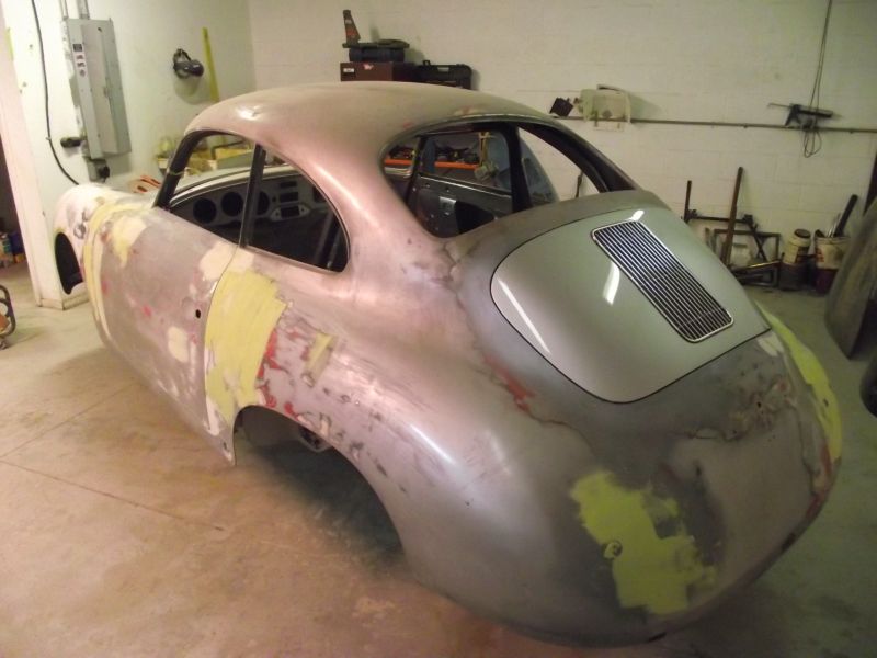

        I remounted the #'s matching decklid just to make sure I was still in love with the final gaps here. Gaps are okay but the lid will have to blocked like the hood is.
        I really jumped the gun here by thinking this was in final paint before fitting and blocking it in first with the body. I did this 3 years ago before I really got back on this car thinking I was making headway by completing individual parts at time. A rookie mistake! You can't do that with the body panels if want it to look right. I at least have learned this lesson now. You know its literally been 30 years+ since all of the original #'s panels have been fitted and installed on this car at once. Hurray for small miracles! Back to more of the same tomorrow. Thanks for stopping by! Justin

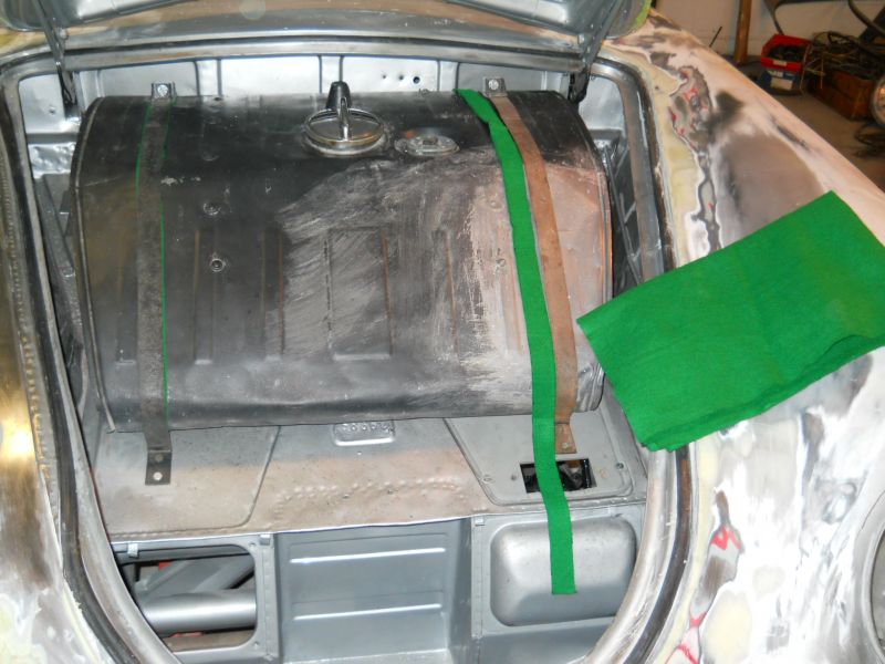

              • More trunk details:

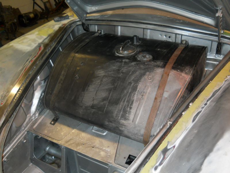

                Now that the hood is fully mounted and adjusted Joris Koning Had brought it to my attention that I may want to double check the fitment of a fully mounted gas tank in relation to the hood. While I have prided myself on test fitting just about everything before final paint I had overlooked fully strapping the tank and checking for hood clearance. I sort of assumed while initially fitting this tank to the car that it was all going to workout. Tank fitment here:
                http://porsche356abcgt.com/forum/14-356-Restoration-Projects/34-58367-The-75-Junkyard-Carrera-coupe-restoration.html?limit=6&start=162

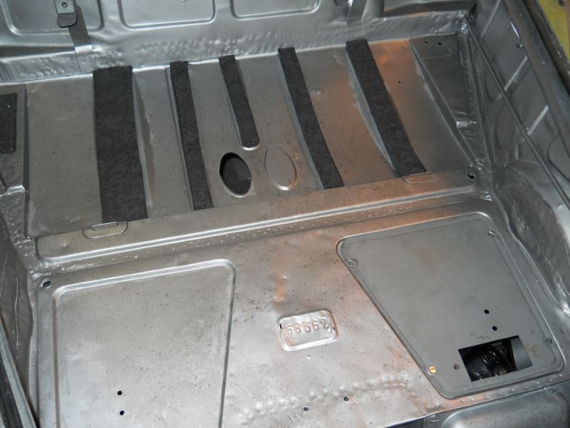

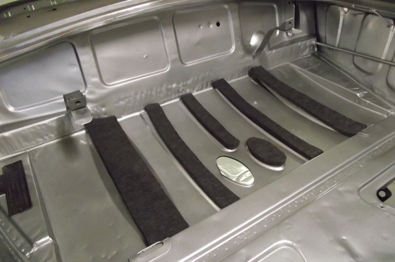

                A fully mounted tank means test fitting it under the added pressure of padding. I had cut some new floor insulator pads from some comparable wool type stock several months ago. They have been bagged and ready for quite some time now. Porbably don't need the oval knockout pad but made one anyway.
                Access cover fully mounted for the first time. Pads in and ready for the tank.

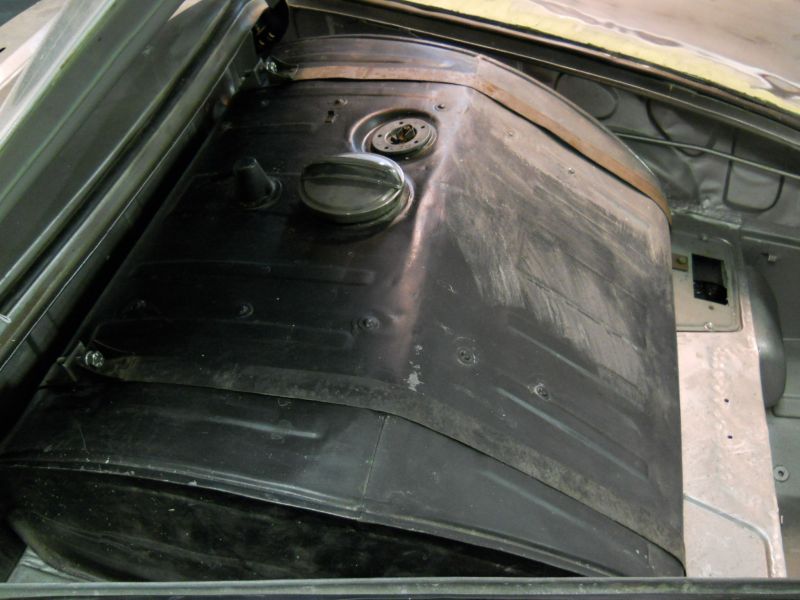

                Because everything was pretty much ready to go it literally only took about 10 minutes to get it strapped down. The hood closed shut with no clearance issues! Another potential problem solved.
                At the time I did not have the felt strips for the tank straps but they are thin so it won't change anything really.
                A few days later I got my hands on some felt and cut out a pair of strips. Everything still fit and cleared just fine. I may bleach them to tone down the green before final assembly.

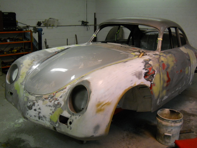

                • Trunk gaps and skim coats continued. 1/1/13

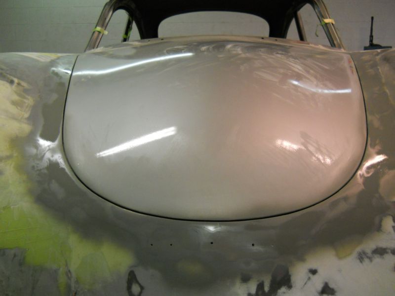

                  Intial coat of primer to see what the gap looked like with a uniform covering. Tons of fine details to do yet but the basic fitment and shape is there.

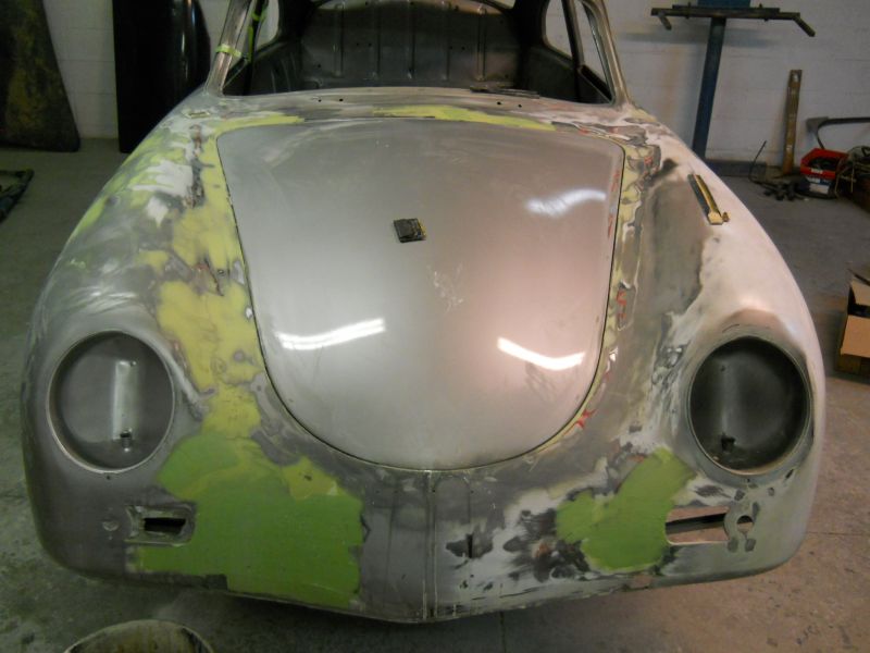

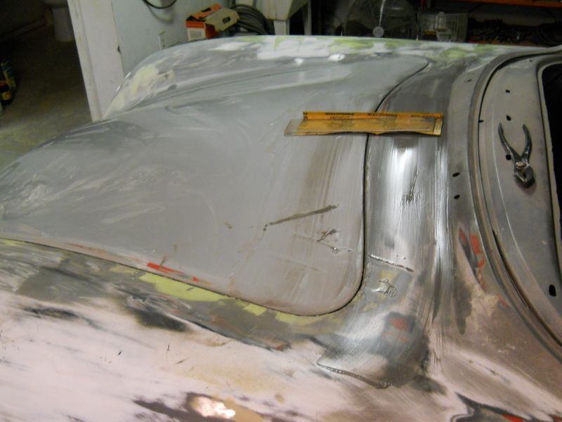

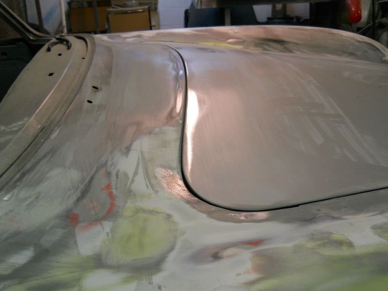

                  Began block sanding and working the cowl and hood transition. Another critical detail I completely over looked the first time around as a much younger bodyman. Like the doors you have toblocksand and work everything together. A lesson learned; finally.

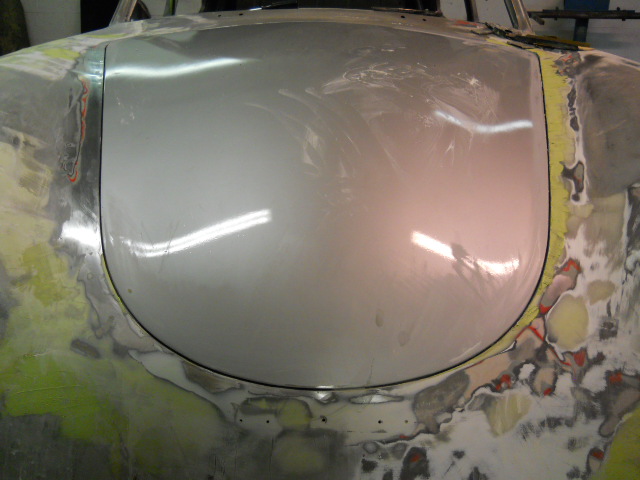

                  Here is a spot easily overlooked. You can see the shiney edge of the hood here where its low and untouched by the sand paper. As I rubbed my hand over it I could feel it was slightly bent and low. The hood by itself seemed fine but once you work it as a whole things start popping up. I have to pull the hood off and spank this edge up a bit.

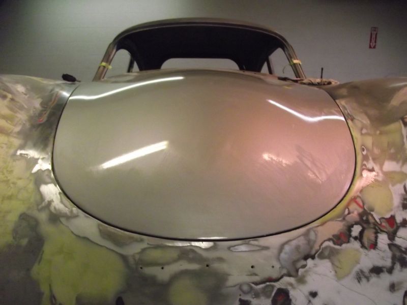

                  This rightside fender is finally done! No more skim coats! Just primer and a few blocksands to go!
                  With the hood gaps getting close I am making my way to the nose of the car. Began skimming the sides here. Thanks for stopping by and Happy New Year! Justin
                  • Tank and gaps look great. I have been looking at your gaps and comparing them to those on my car. I have to say I really lucked out with my car, the gaps are almost perfect except for where some PO fixed (if you can call it fixed) the front fender rust at lower corners.
                    A trick I saw, which you may know about, for checking how close your gas cap is to the bottom of hood, is to take modeling clay and stick it to the cap. Slowly close hood, raise it and then see how much height is left on the clay.
                    Keep on posting for all our entertainment. Happy New Year everyone.
                    • Hey Mark,
                      I am glad to hear that your gaps are close! You really did find a nice car. Yeah, the clay is a really good idea I should buy some. All I had on hand was some grease which I swiped the handle ridge with it and there was no transfer to the hood. I don't know how close it is (the clay could certainly tell me that) but it does not touch. Thanks, I'll keep slinging bondo! Happy New year to you!
