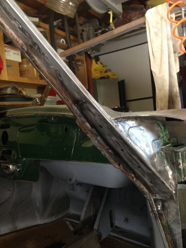

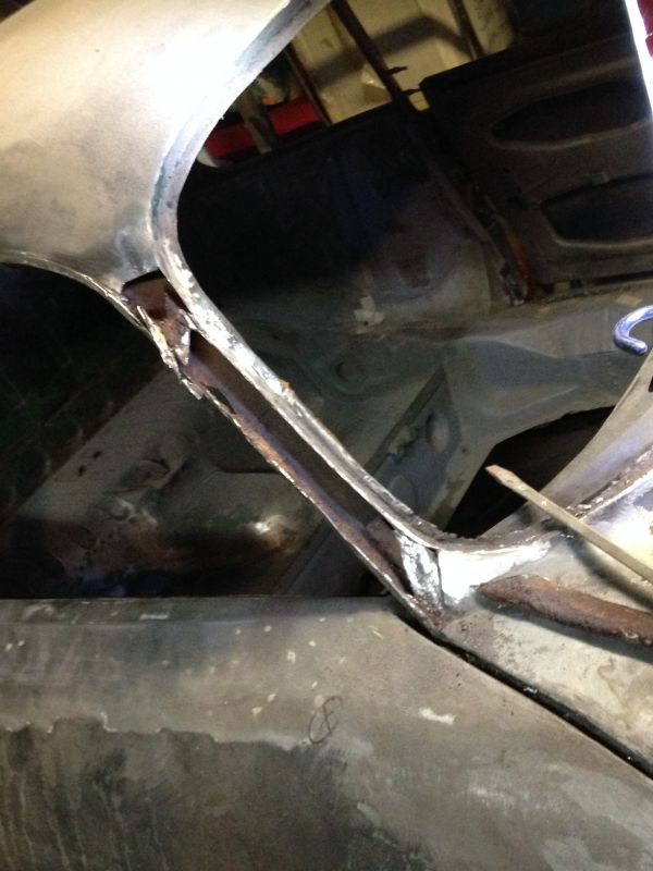

  • In preparation for future lead work I decided that I better check under some existing lead in the A pillar.
    It was suspect because I think I saw bulge that didn't belong. Well, its a good thing I checked because there was lots of rust underneath. And thought I was done with rust repair, but now I'm knee deep in it again.
    Probably several days needed to fix this one.

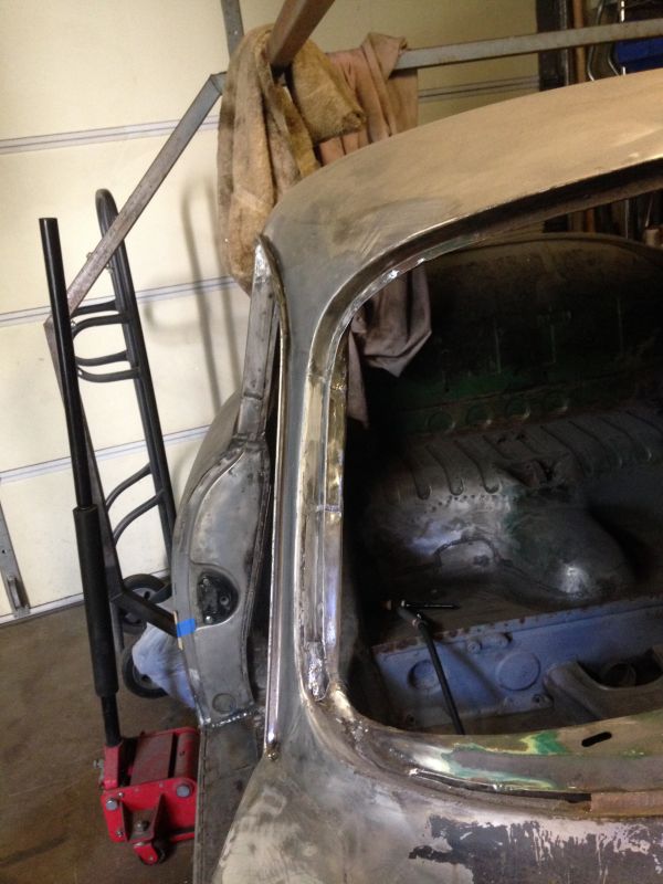

          • Further destruction shot below. I may have cut more than I needed to , but I needed to look given how bad the other side was. The drivers side had the entire pillar replaced.
            Already started putting new metal back in.
            Thanks,

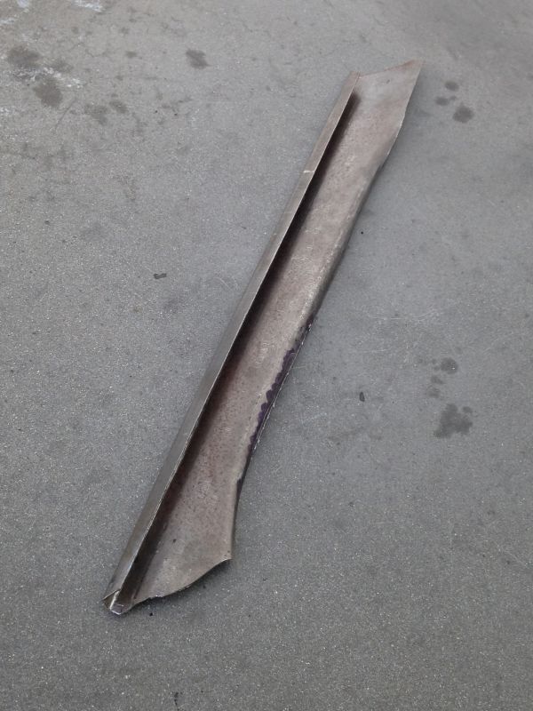

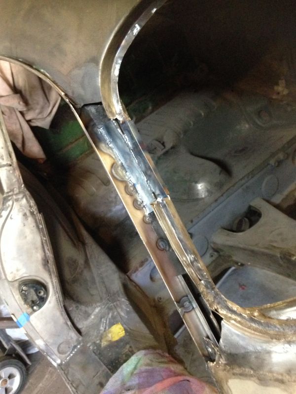

                • Ok, finally finished the ugly repair to the windshield post.
                  The factory included a strengthening U channel to the flat portion that faces the door opening. See twisted part damaged during removal pictured next to new ones.

                  I reproduced mine to be longer so that it extended further up into the pillar for extra strength
                  Another triangular box section was added to the upper half to further increase strength. Just for good measure

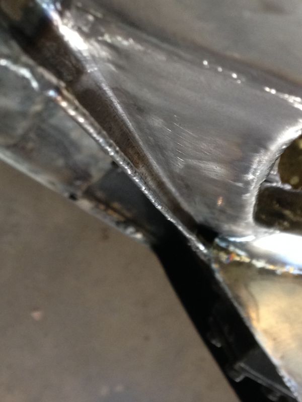

                  Instead of crimping the gutter, I just edge welded the sandwiched pieces together.

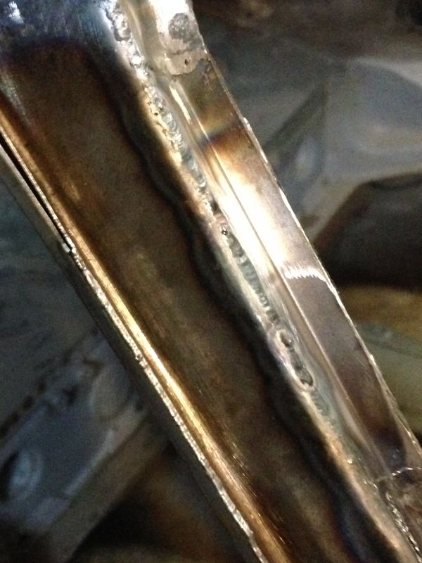

                  Tiny welds for you Justin! This pic is looking down the gutter channel. Some easy straightening to do after the heat input.

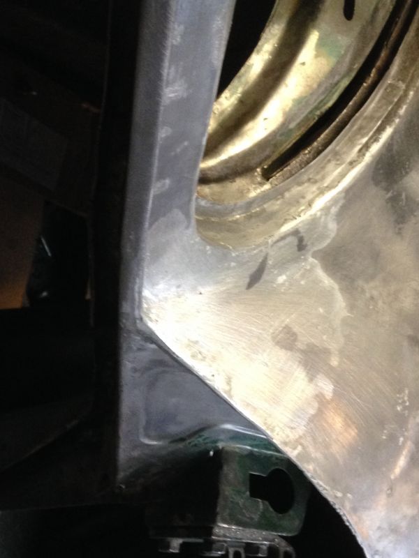

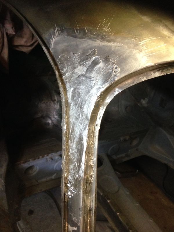

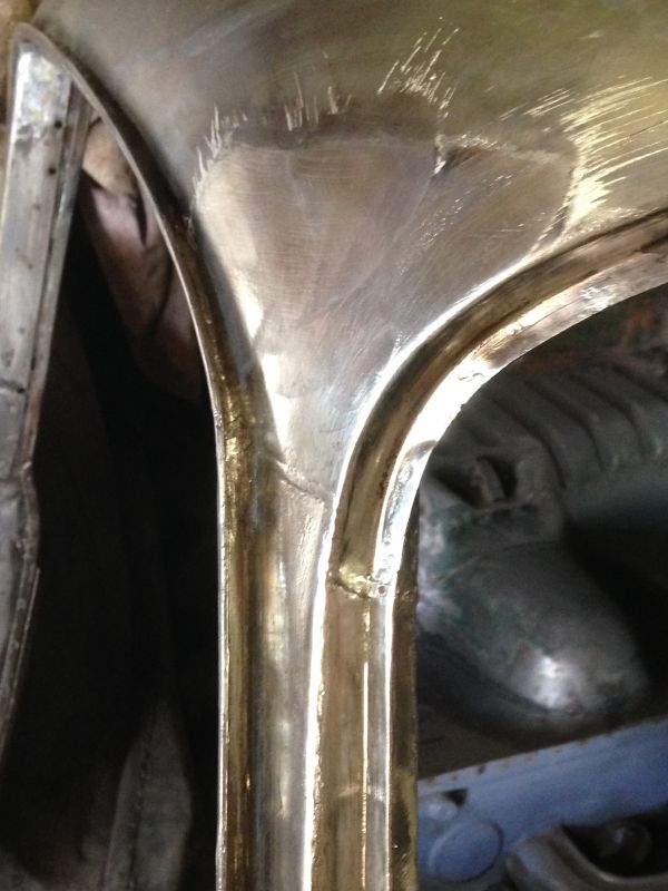

                      • Got started with the lead filler. It took awhile for me to get the tinning method down, but I think I'm good to go. I tested the adhesion and it seems okay. The adhesion is really sensitive to how clean the metal is, so every weld and nook and cranny had to be really clean. Here is a shot of the pillar tinned.
                        This was after I washed it with baking soda which took some of the shine away.

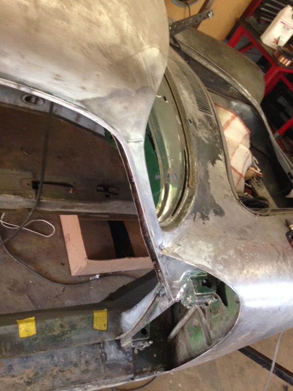

                        Globing it on isn't very precise, but not as hard as I expected.

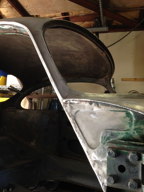

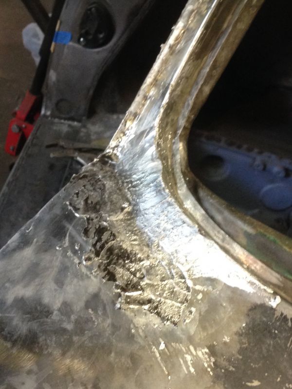

                        Filed and quick sand.
                        I left the edge where it meets up to the door a little high, so I have room to remove more to fit the door best.
                        All in all I hope everything is right, I will be monitoring this area for lifting or anything else strange that might happen. Please let me know if anyone wants more detail.

                        • Tom
                          Great job for you first attempt. Looks like it came out pretty slick. Thanks for posting.
                          • You're a natural at it Tom! Nicely done!
                            • Tom,
                              Are you using real lead or the pseudo-lead that's Eastwood sells? Either way it looks good. What files are using to get into the narrow areas?
                              • Thanks guys! I'm using lead-free solder from Johnson, ha ha lead-free lead is like ordering a cheese burger without the cheese.
                                The material is fairly soft, so I used a few different sizes of tapered and round files. In the nook area, I used a rotary teardrop file on my dremel.
                                I will get lots more practice soldering around doors and hood. Stay tuned.
