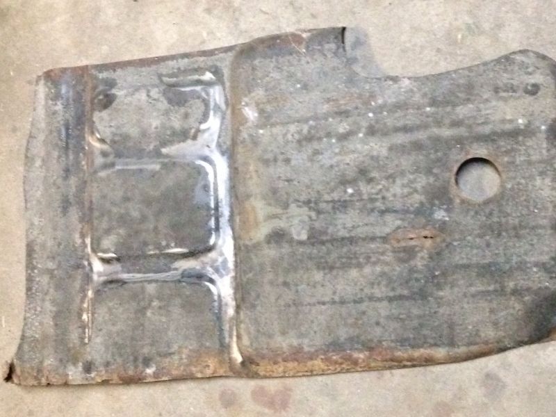

      Here's a picture of the original floor drain holes at the rear of the tunnel. Seems like a good idea, but certainly didn't save my floor from rusting.

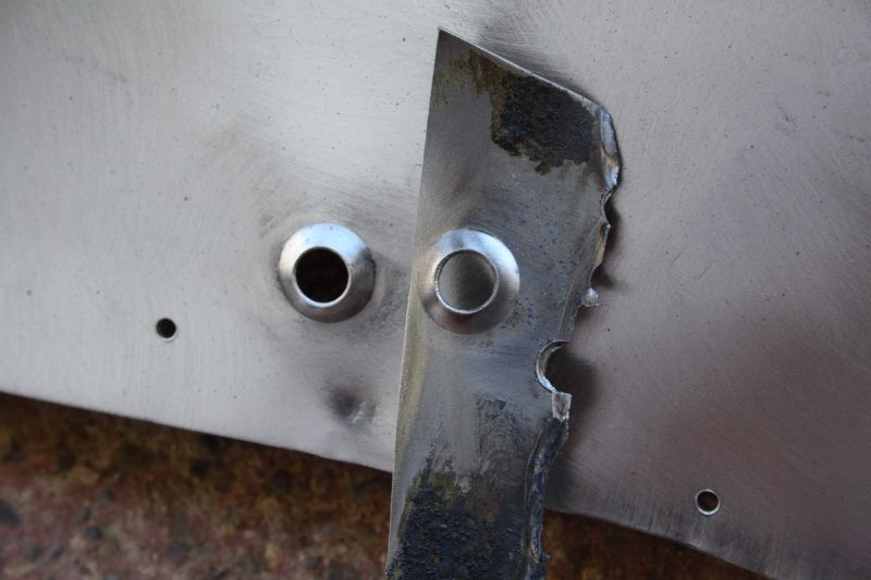

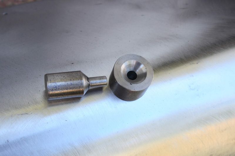

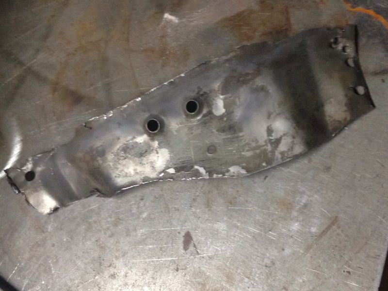

      This is the tool I made when punching holes in the longs.
      Result:

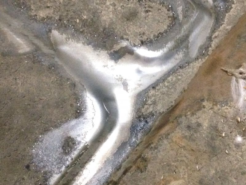

      Here's how the newly radiused rear impressions turned out.

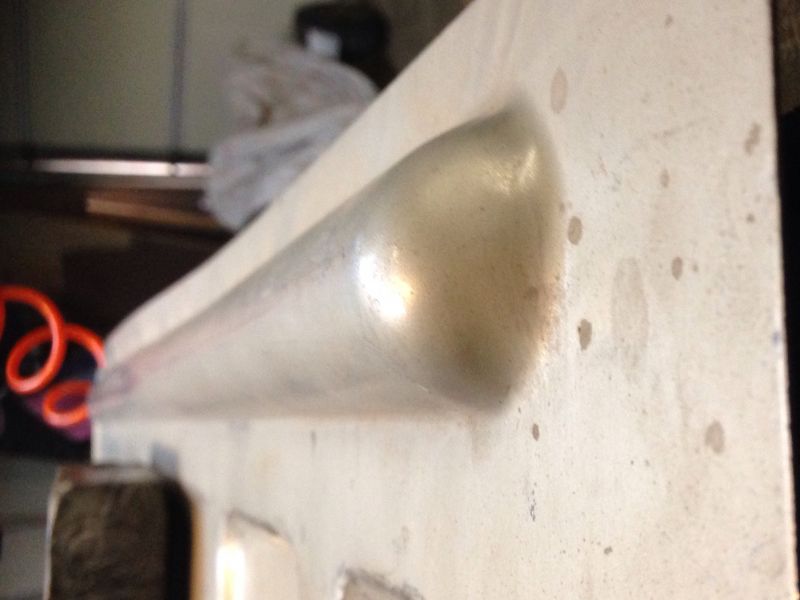

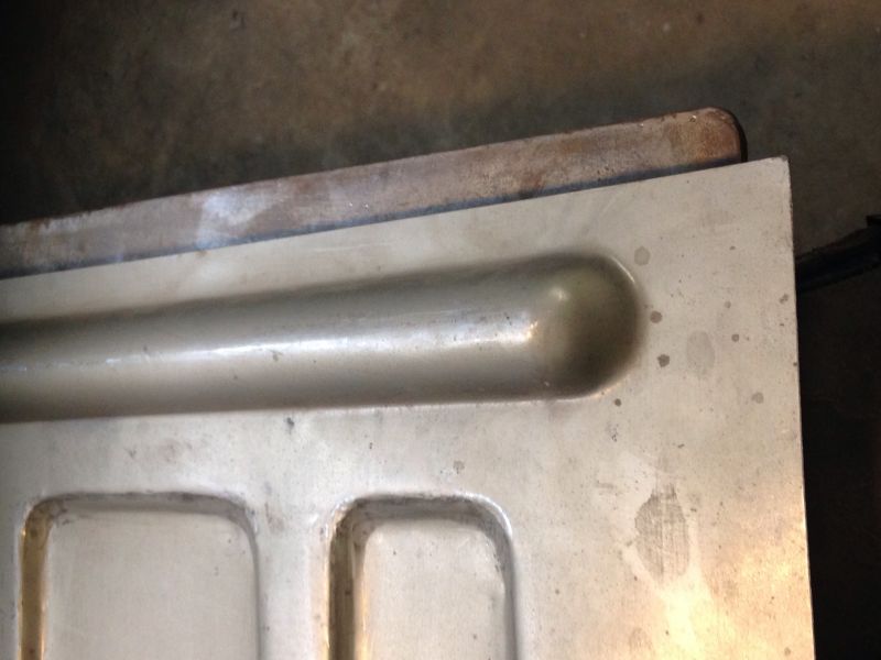

      Also check out that huge hot dog shape for the transverse tube.
      That was a lot of fun to hammer down according to the original shape. I took this down to the beach and whacked it in the sand for a while with various dollies.
      I also softened the front impressions some. The result is kind of a middle of the road effort compared to the original. My original front floors had very washed out impressions. If I can, I'll take some more pictures of my original floors too so Bruce and I can compare notes. I ended up with fairly strong impressions, that kind of match the rear......At least I made an effort.

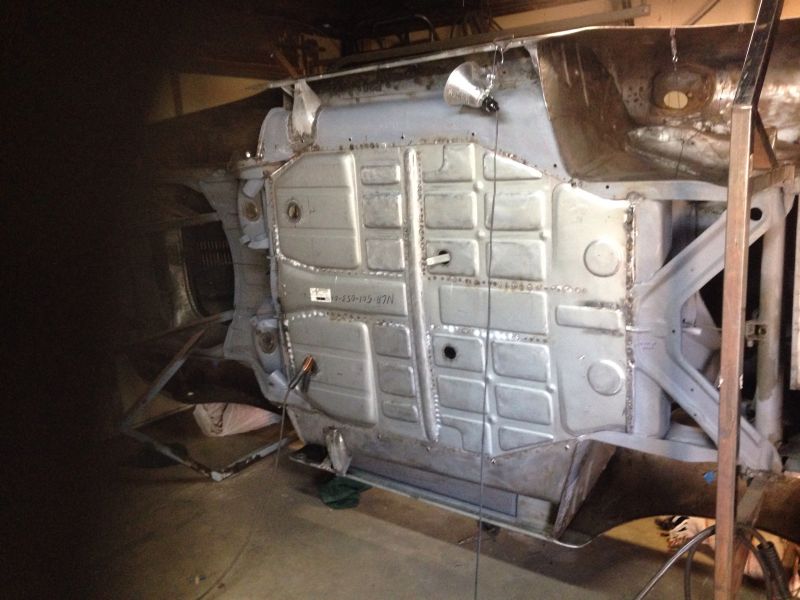

      I wish I had more pictures, but I don't. Here's a shot after the floors were installed.

      Those front triangle impressions were completely re shaped to match the angle of the inner longitudinal and to avoid intereference.
      I did get lucky on the pedal mounting bracket. It lined up right on the embossed circle. Thank you Jack for recommending trial fitting the toe boards! I don't have my original floor matts or a repro yet though, so I will have to pray it fits.

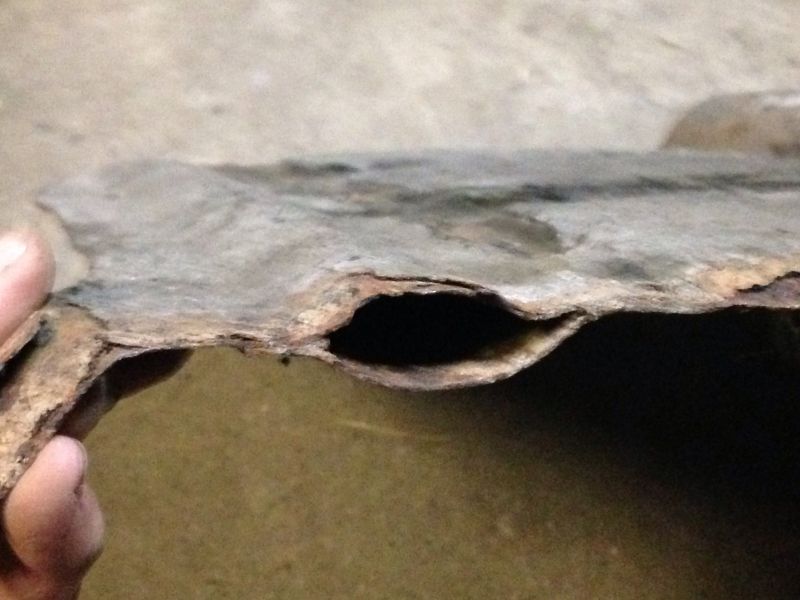

        • Floor tunnel (boat) drains? Lowest part of 356 due to angle down from longitudinals. Window left down in a rain or plastic plugs in Karmann lower front and rear window openings leaking? Oil from nasty trans neck leak getting up there (seen all that happen) or just a nice idea from Karmann to help with 356 longevity.....diss'd by the accountants at Porsche.
          Let's not forget the discs in the squab seat lowest parts of THAT pan.

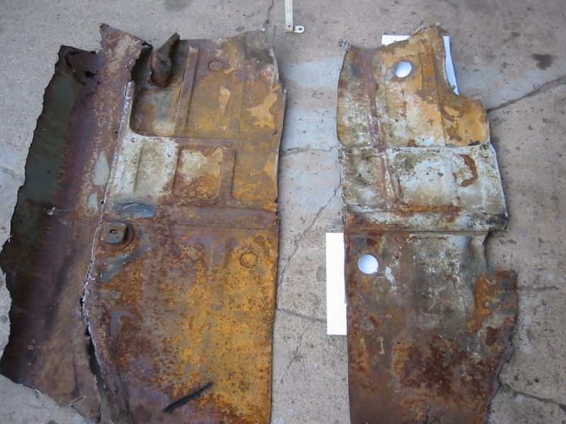

          Here's a picture of an original floor pan with some of the remaining longitudinal on one side, showing the 'special' details particular to Karmann bodies. I'm surprised that (Alex, if you are still lurking) a company making the floors doesn't offer a Karmann floor option for an added two or three hundred dollars (or whatever) for the additional details installed prior to shipping...same for the rear seat bottoms. (That's approximately what my shop will bill if it is a customer's request.)

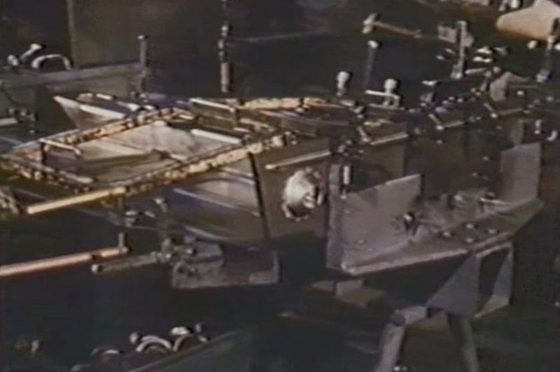

              • Don,
                If you look in the picture then there is the frame Porsche uses to get the seat mounts in correct position plus they have just done some spot welds to the mount with their giant spotwelder.
                I hope this helps you out
                / Per

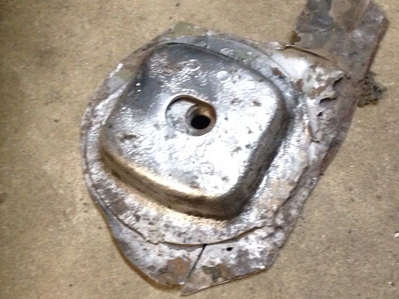

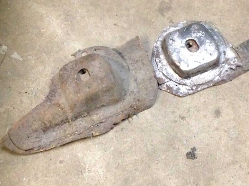

                • Originally posted by Don C" post=24526
                  Question: Were the seat mounts in a "C" spot welded to the floor or was there a more substantial weld used?
                  Mine were replaced,along with the floor,in the 80's and the heights vary over 1/4" making the seat rails not in the same plane.
                  Got new ones on order and was wondering how to attach them, thanks!
                  DC
                  Hi Don,
                  Here's some pics of my cars original seat mounts still attached to its floor. No special welds except maybe a gas weld tying the floor to the longitudinal sandwich.

                  Thanks Per for that picture of the cool factory jig. That's a time saver for sure!

                  • Here's some pics of my original floors to back up Bruce's great photos.
                    Fairly "soft" impressions if you ask me. The front was really battered so I can't vouch for how original it is.
                    Hopefully pictures like this will be around a while for those who don't have originals to compare with .
