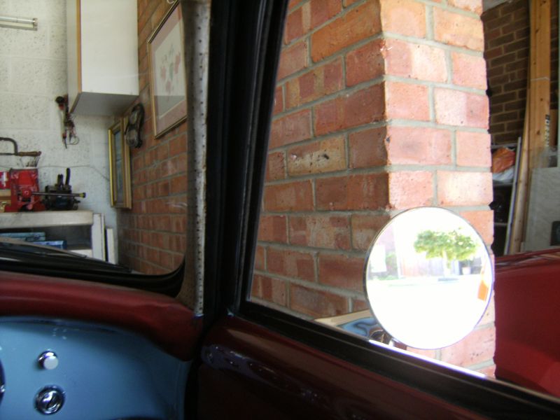

        The posts about your door mirror were interesting. I had no door mirror fitted to my car when I bought it in the 60's. AFN the Porsche agent still had some brand new Durant door mirrors so I bought one.
        I remember two things about fitting it. The first one was movement so correctly mentioned by Bruce. I tried swivelling it before fitting and it seemed to have a positive 'stop' but actually it was a limited movement to what I imagined it should be. It therefore took me much time to drill the fixing holes. I had help whilst I sat in the car and someone held the mirror. I was around 5 foot eleven inches and the seat position was important to get right.
        Some 12 years or so later I happened to knock hard the mirror with my arm. Would you believe the movement of arc then was almost double!! It swivelled so much more, important for you to check that!! I do not know why it increased.

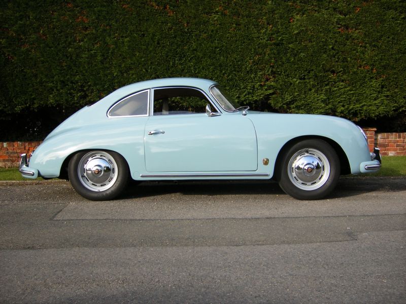

        The 2 holes you welded up were obviously not for a Durant but the photos I have for the other 356 mirror the Aero do look more likely. But they fitted 356A / early B only???
        The distance from the edge of the rubber seal to the beginning of the door gap is 5 inches on my mirror and one and a half inches from the seal edge to the window chrome trim.
        I attach a photo of the aero and one of my Durant.

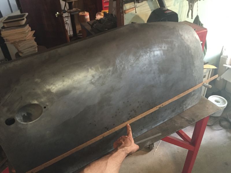

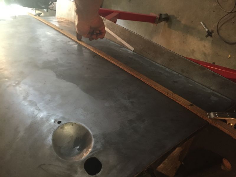

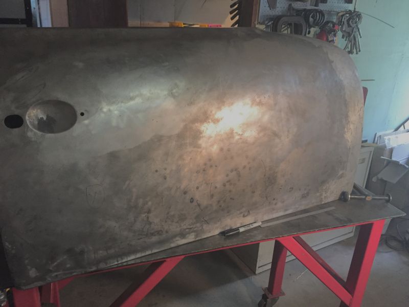

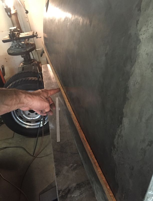

            The passenger door lower skin and door bottom was replaced by me along time ago. Actually it was one of the first things I did because I couldn't stomach the bubbles anymore. The repair looks ok, but the door has an oil can to it. In other words if I push on it hard enough I make a dent that won't pop back on its own. Chris pointed this out to me and said it needs to be fixed.
            I now know that I must have over hammered it way back when I was early on the learning curve. I'm still learning obviously. Worst case is to weld in a new lower section but I tried shrinking the skin with my TIG torch.
            This is hard to take pictures of what is really going on because it's a touch and feel thing. Luckily I was able to make the skin tight as it should be. I did need to hammer some shrink distortions out but this time I was careful and more strategic with my hammer blows.
            Here's some pictures showing the shrink marks and a long stick to check overall curvature and high and low spots.

            It doesn't look any better but all the squishyness is gone and I'm much relieved.

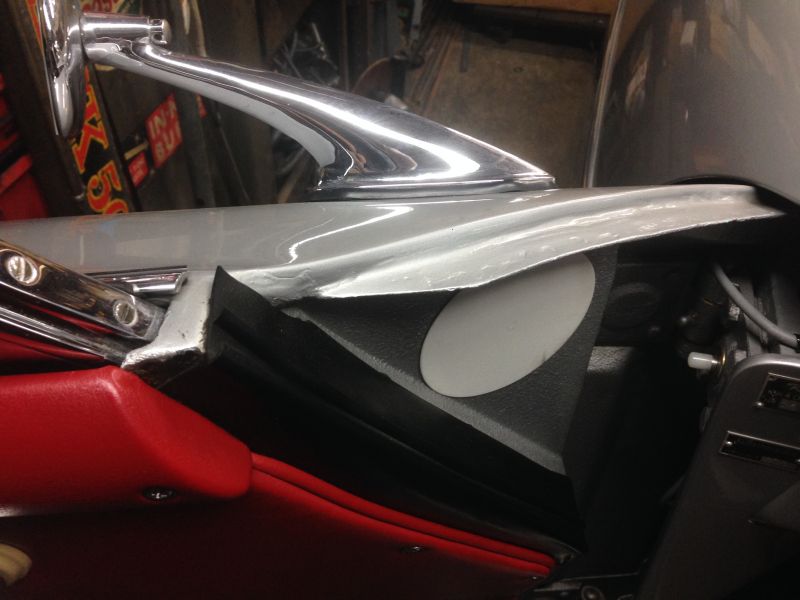

                • Here are a couple of pics that demonstrate the wrong positioning of the mirror.

                    Ya know Tom, I've been staring at the previously welded holes on your door pix, and they actually look pretty darn good on close review. Do they line up well with the access hole?
                    • My welded holes seem a little too far toward the rear.

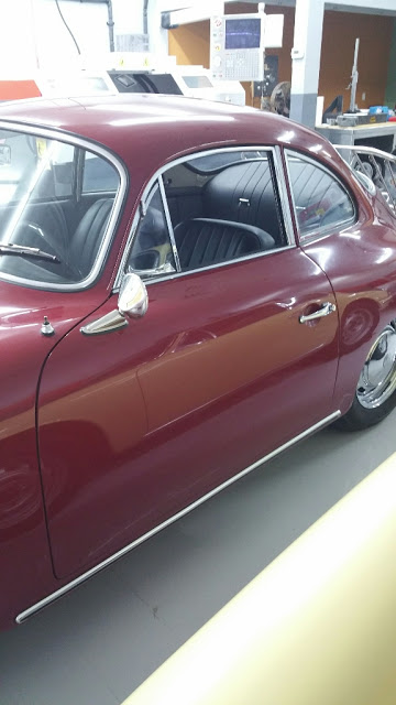

                      What do you think about this mirror pictured below? The mirror location seems to agree with the brown car that Jack sent the link to.

                      • Seems those mirrors where placed all over that upper quadrant. If it was my project I'd take Bruce's earlier advice and position that mirror so it "works" for me sitting in the drivers seat. Better still an even split of utility and aesthetics; leaning toward the utility side.
                        • +1 what Justin said. Why mount them if they don't work? I'm 5'7" and the location I posted earlier work for me.

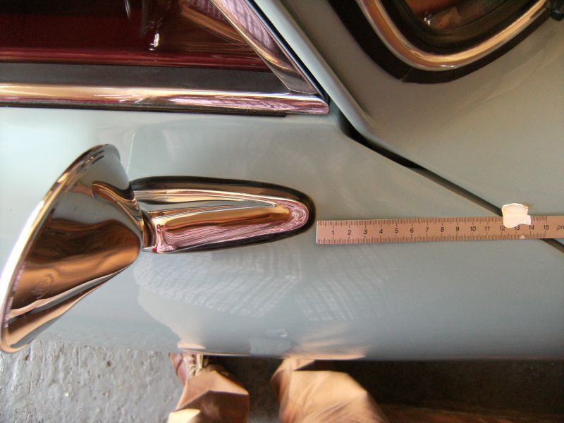

                          • Tom,

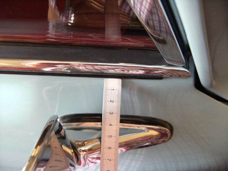

                            I know my 356 is an 'a' might make a difference to your SC but Justin is correct sit in and get someone to move it to the correct place. But I would place the swivel in the mid position to allow for correction.
                            I took a few photos of mine today with a ruler in mm. Try that first before drilling anything.

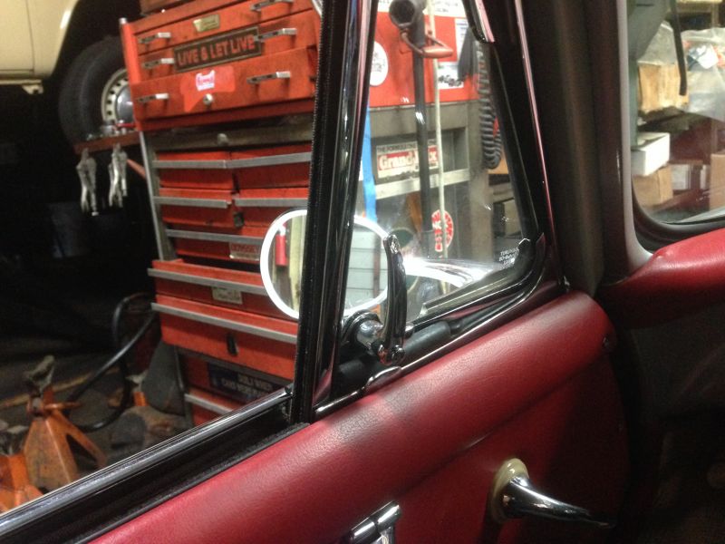

                                Since I'm average height, 5'11", I'd like the mirror to be in a well accepted position asthetically. I do understand that there is a lot of variability, but my plan is start with the universally accepted position and adjust from there with the seat/pedals in the car. From what I've seen so far most of the variability is in the front to rear direction. I usually drive with the seat almost all the way back, but I will put the pedals and seat back in and report my findings when I get some more garage time. I probably need to put the wind wing back in to huh. (Funny picture by Trevor). This summer has been full of fun activities but I'm dying to finish my pre-paint to do list.
