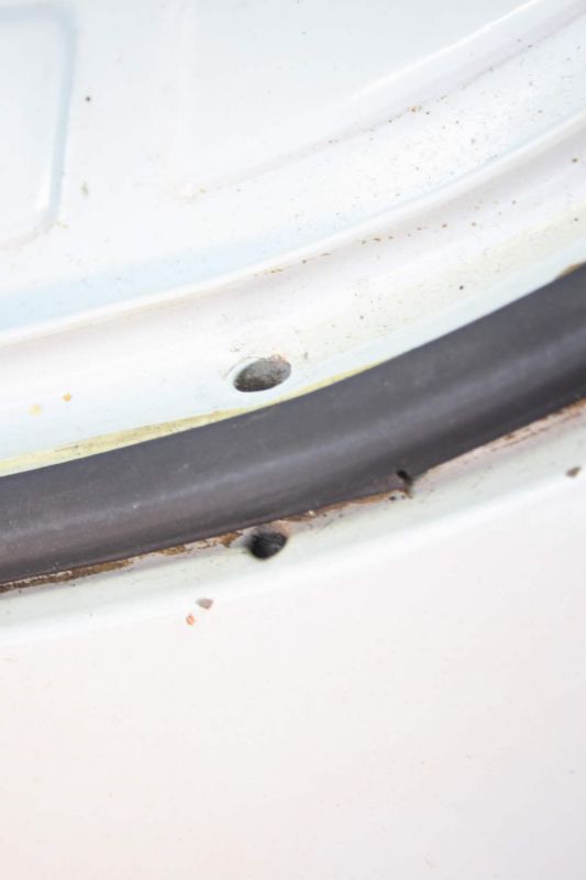

          I saw your question about the drain holes too. Here's a picture of an unrestored and unpainted 65C with the holes you found.
          This car is a cabriolet and made by Reutter. My car didn't seem to have these holes, so its either a Reutter or Cabriolet thing. And I thought Karmann were the ones with all the extra drain holes.

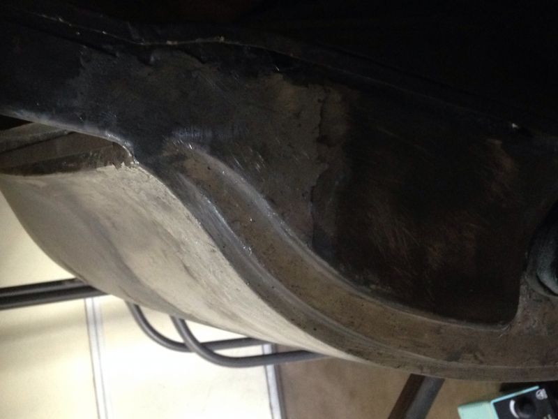

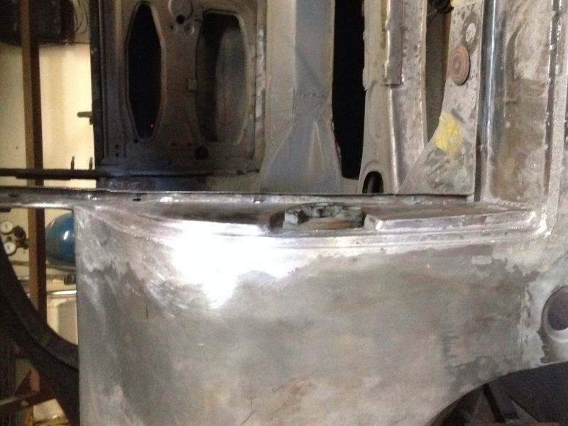

                • Hi Phil, I have even more respect for the factory workers after trying the lead work on the door pillar.
                  It requires so much patience, that I just had to walk away several times, take a break and try again several days later. At one point I had to start over.
                  Anyway this is what I ended up with. It's hard to get a good picture of shiny solder!

                  Sorry for the sideways pictures. Maybe I can fix it later tonight. The gap is currently 2.5mm except for the very top. I will need to add solder to the door to bring this closer. There is factory evidence of lead there BTW.
                  Now I'm moving on to the forward gap which is another major headache for me. I ended up cutting the door skin away from the frame to reduce the amount of lead up there. More posts to come on that soon I hope.
                  Thanks

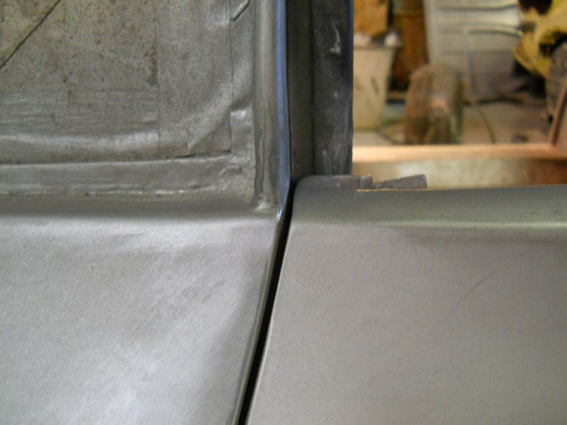

                      • Looking good Tom! Yes, the guys who performed this work at the factory were true artists and it is a skill that is only developed through constant practice. Like I said before the easiest application is the first one then adding more solder where it needs it without melting or ruining what you previously created is the real tricky aspect of it all.
                        I can confirm too that the upper corner of the door was shaped in solder to tighten up the lines. Keep up the great work! Justin

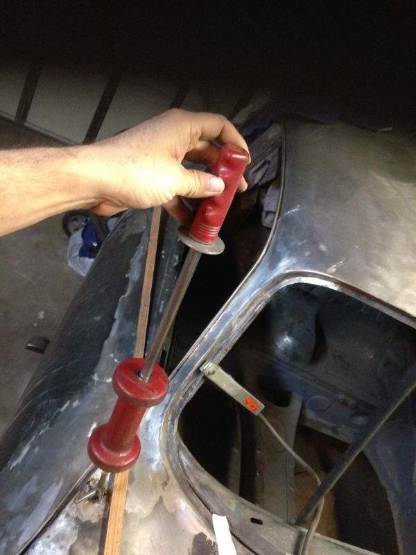

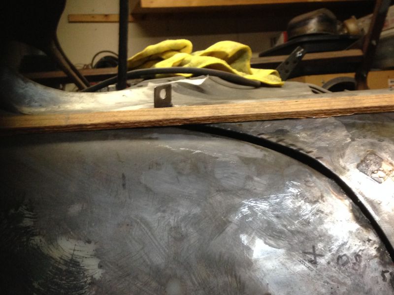

                            • Some of you may find this technique interesting....
                              Before I set the forward door gap with solder in the way the factory did, I want to make sure there are no valleys in the gap too. In my opinion both the gap and the shape across the gap are equally important.
                              Some time ago, I replaced the trailing edge of the front fender and it looks good until I put a long arching wood strip over the gap. Sure enough the body work dips down near the gap which I was apparently ok with then, but now my standards are creeping up.

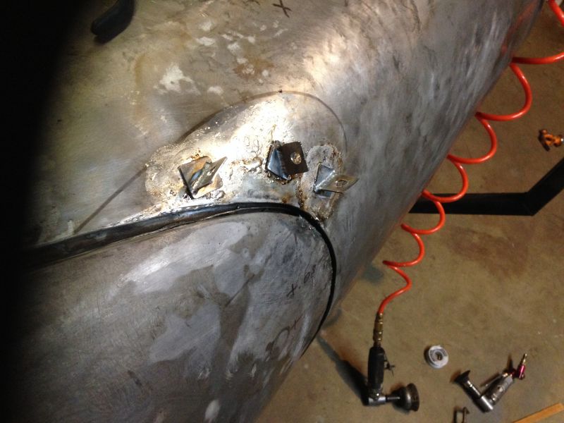

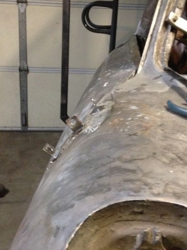

                              The access behind the trailing section of the front fender isn't very good, so I decided that I would try to pull the metal up using my slide hammer. I don't own a stud gun because I don't like the pimply shape the metal ends up with.
                              While time consuming, I fabbed these little pull tabs and soldered them to the sheet metal.
                              A slide hammer slides in the hole and then, WHAM! a large section of the metal rises up.
                              It actually pretty amazing how much force the solder will take and I used a 60/40 lead from radio shack because it melts at a very low temperature to avoid heat distortion.

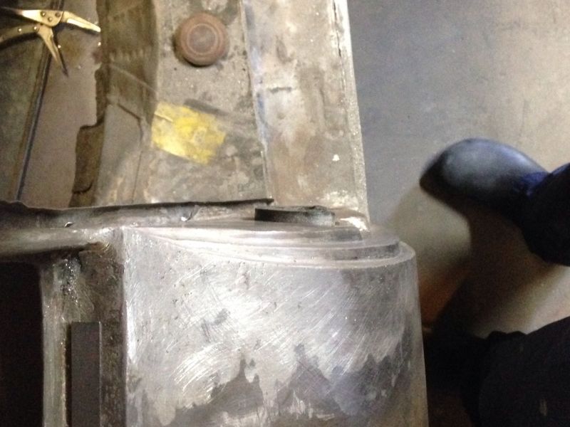

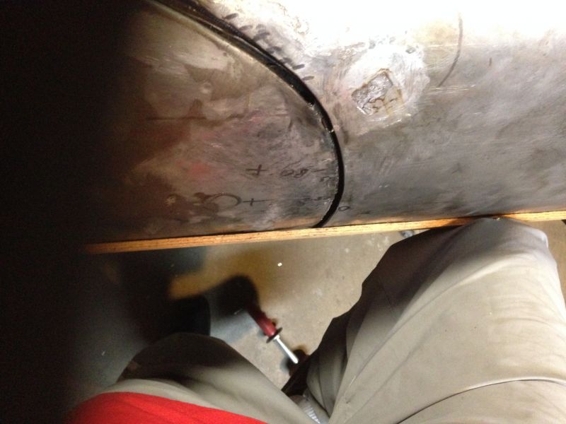

                              Then I constantly check the valley depth until its zero using a long flexible stick.

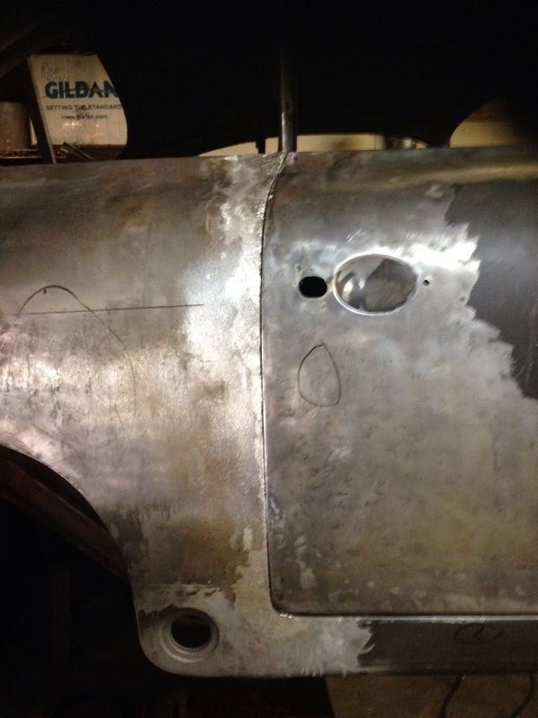

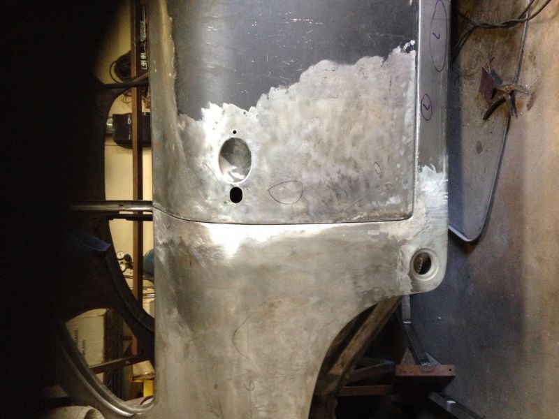

                              Same stick used down low too. Actually I have a 9 footer that goes the whole length of the car almost. Its taken a lot of work, but I want one continuous arc from fender to door to rear fender.

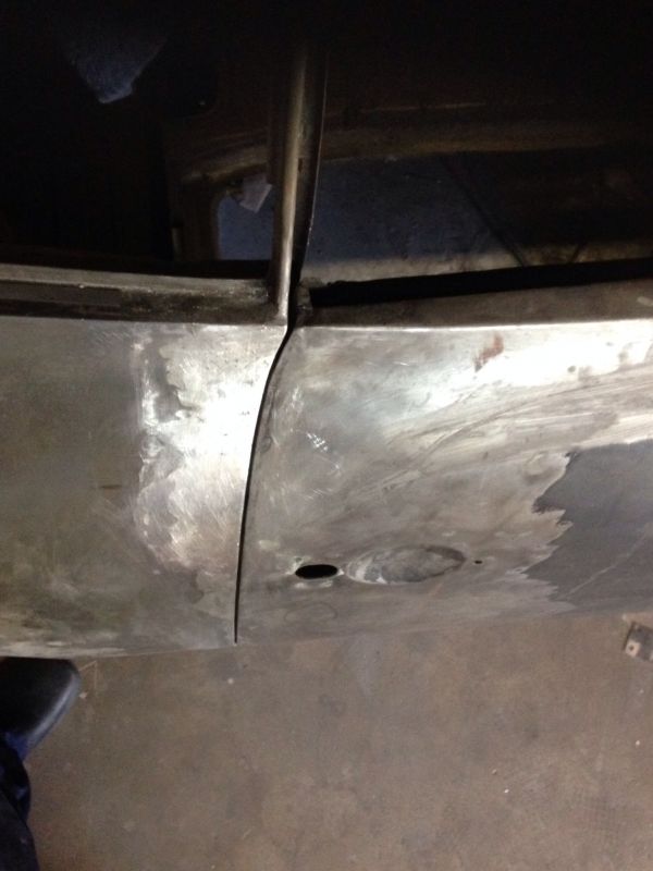

                              This shot shows a valley only on the door side which will get filled with solder once I'm happy with the fender position relative to the door.
                              This method is time consuming, but when there is a will there is a way. I did move the pull tabs around a few times to avoid creating rolling waves as I pulled.
