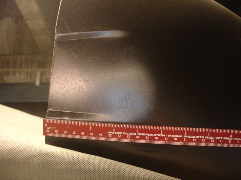

  • Here is a NOS rear end with the measurements from seam.
    So this must be one of the latest batches maybe....
    / Per
    • Wow, Thanks Per for the NOS shot. When I measured the relief distance I started at the rounded nose of the feature, so I got about what you show in the above picture. Thanks for the good reference, those bends are nice and crisp. Mine not so much!
      No worries Phil on the measurements. I owe you several by now.

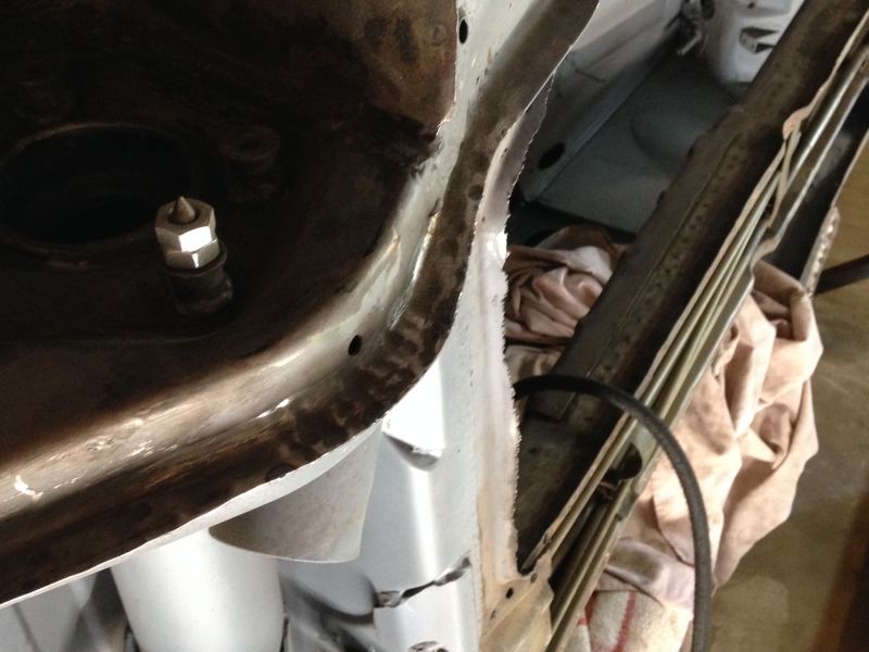

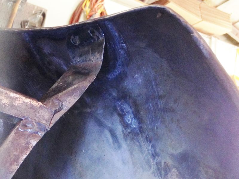

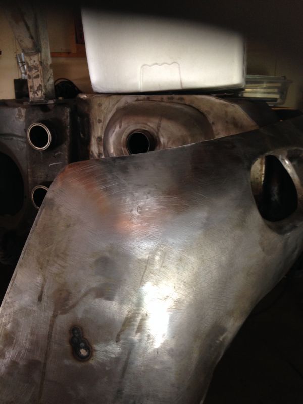

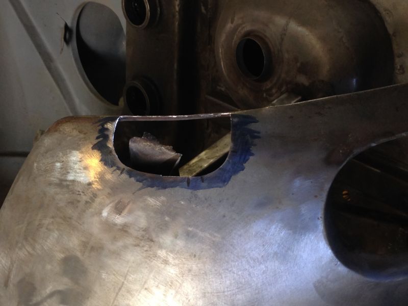

      Today, I tried to attach my front fender brace to the original nose. Of course it snowballed into a bigger project. Both the brace and the nose were rusted thin so I started cutting because I don't want any defects to show up later on. This brace to fender junction will probably have some vibration and stress, so I wanted good metal here.
      Brace extended
      What's yet another patch...
      Disappeared
      Still need to plug weld from the inside, but I was too lazy to roll the MIG out. Thanks for following along. Lots of small repairs like this left unfortunately. I also finished the fender brace connection to the battery box wall too. Will post pics of those tonight hopefully.

      • Nicely done Tom. Will reference these pics when I put the nos right nose piece on Foam Car.
        • I hear you Tom; you must take two or three steps back so you can go forward again. Nice work on that lower patch!

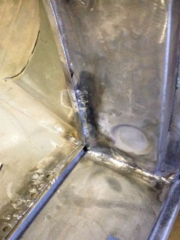

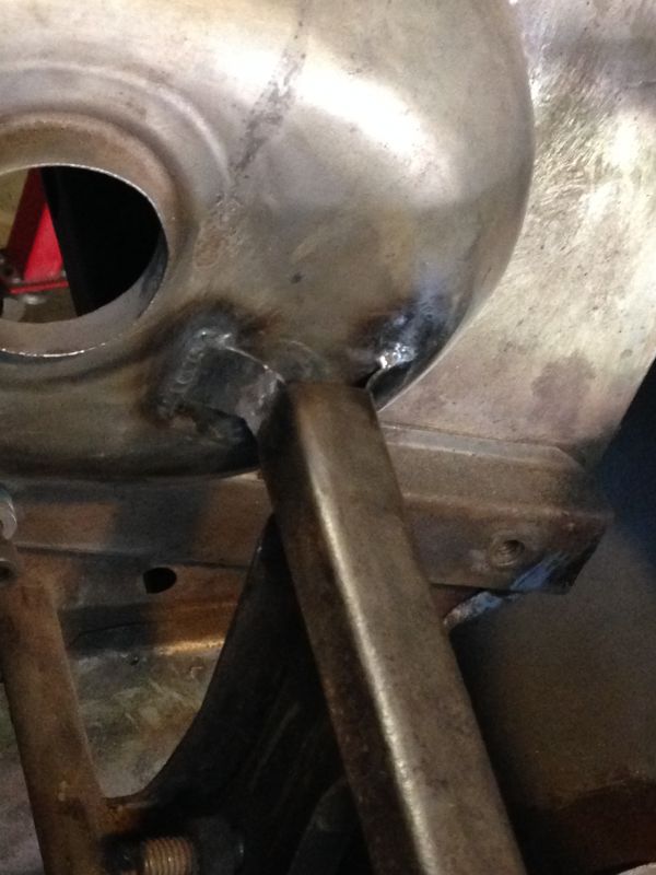

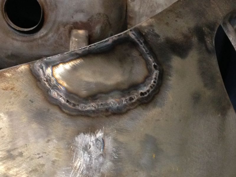

            Along time ago I fixed the bowl that protrudes from the T6 battery box. It was rusted. So now, the mounting tabs need to be added and welded to the repaired bowl.
            Here's what I did.
            Things are shaping up and the punch list is getting shorter.

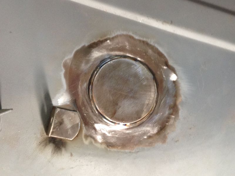

            • Well I'm bouncing around a bit. Today I installed the floor plugs that I made back on page 48. These are more accurate than the simple indent that came with my Trevor Marshall seat pans.
              Looks like I forgot to take a picture from the inside, oops.
              It would be hard for anyone to tell that these seat pans were replaced. Shhhh, don't tell anyone, ha ha.

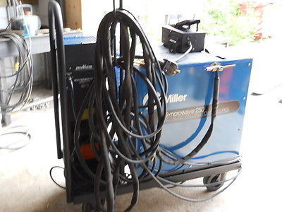

                • Your progress photo from last nights post was all that I could stand Tom! Seeing those really nice, tiny and controlled welds finally pushed me to commit to buying a TIG welder today. Here's a couple shots I snagged from the auction:

                  Needs a tank and the gauge assembly but complete otherwise. As well as its condition, the pump and water cooled trigger sold it for me. I don't expect to be at your level right out of the box but I at least will have the right machine now. Thanks for the inspiration! As usual great work!!!!
                  • Justin - Funny, you should post about getting a TIG welder. I used a friend's MIG welder today - first time ever using a MIG. Totally hated it! Sparks flying, trying to dial in the wire speed, grind the hard as hell welds... no fun! F*** that!
                    You're going to love the TIG! My #1 suggestion, ask Steve Hogue when his next class is. Attend, take notes, ask lots of questions, he won't shoot you down... you can ask as many questions as you want. Then... practice, practice and practice some more. It will be worth it!
                    • Yay Justin! That is one hell of a machine...and water cooled.
                      You will pick this up quickly I'm sure. Steve's class is great and really shortens the learning curve like Trevor said. Steve is not exactly close to you, but worth the drive in my opinion. Let me know if you want any tips to get started. I think you will be impressed with the versatility of TIG.

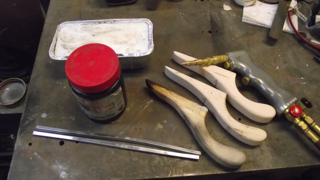

                      Justin, I need your help on body solder supplies. I took some notes from one of your posts a while back.
                      "Here are all the basic tools & supplies that Jason told me to buy.
                      The Dillon/Henrob Torch(now A.K.A. the Cobra torch) I bought as a kit on Ebay. (kit runs 300-400$)
                      Solder paste (Jason) The rest is Eastwood: wooden paddle spreader set (16.00) Solder Tallow,
                      the white stuff in the alloy tray. You warm this and coat the wooden spreader with it.(15.00)
                      Body solder sticks 10pc. 1 LBS. (40.00) These sticks go quick! Pictured are my last two!
                      This is the flux that Jason likes. Its an Australian product so I don't know if its available elsewhere.
                      Whats nice about this paste is that it has solder mixed into it.
                      So you apply it, heat it then wipe it with a rag leaving a nice primer surface of solder.
                      The molten fill just loves it!
                      Name of flux is Kemtex B Solder Paste."
                      So my questions are: Has any thing changed since? Any comment on neutralizers to kill acid flux during clean up. Any torch setting that you can recommend.
                      I'm totally new to this, but willing to try. Thanks for your help.

                        As for tinning, no not much has changed for me in that regard. I will say I'm not using the henrob torch though, I found that the standard torch head works just fine. As for setting I like a nice turquoise flame tip. Not an angry flame (as Jason Bobruk would say)or jet engine sounding flame but a quiet sharp turquoise flame.
                        As for neutralizing the tinning acid a thorough scrub with soapy water and brillow pad worked for me. Depending on my level of paranoia with an area I might have gone over it a second or even a third time before primer. So far so good because all of my top coats have been on there for a least one year and other areas up to 2 years+. I have yet to find a single bubble of lead contamination in my paint.

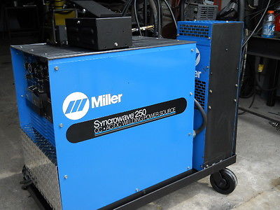

                        • First, yesterday I had a business neighbor invite me to try a new welding system in his shop for a demo. Two welders awaited, and a sophisticated pair they were! The $26,000 spot welder was water-cooled and had a plethora (I like that word!) of tips, arms and adjustable widgets and was computerized in all aspects. I was given samples of boron steel, regular mild steel and a few other types and told to just press a button when I was ready, no matter how many layers of which kinds of steel I wanted to join.
                          The head hesitates after clamping the steel in the tips, assessing the metal and it's type and thickness, then zaps a beautiful, even depression that will NOT come apart. I'd love to have a unit like this, but I have never spent $26,000 on even a Porsche!
                          The other machine was a MIG, with two guns. One was for aluminum, one was for a phosphor-bronze wire that melts at a lower temp than steel and doesn't distort the new steels used with new cars. Both machines were meant for production use on repair of new cars in a big shop. The MIG used 100% Argon, both guns were held 90* from the surface about 5/8" up and the trigger had the ability to make fine adjustments if needed, but the computerized unit figured the basics on it's own to get you started. They were a 'push' weld and after some trial attempts, I was able to make perhaps the nicest aluminum bead I've ever done with a MIG. (Which is why I have an old Miller 180 TIG!)

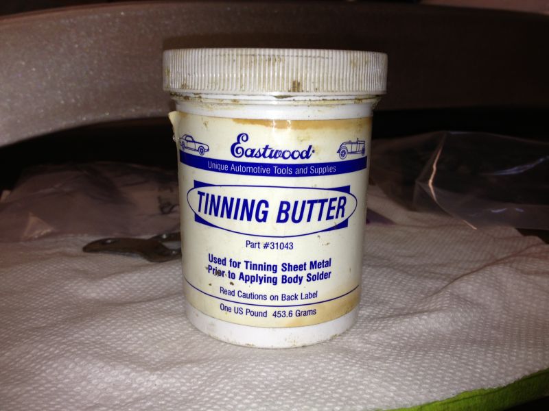

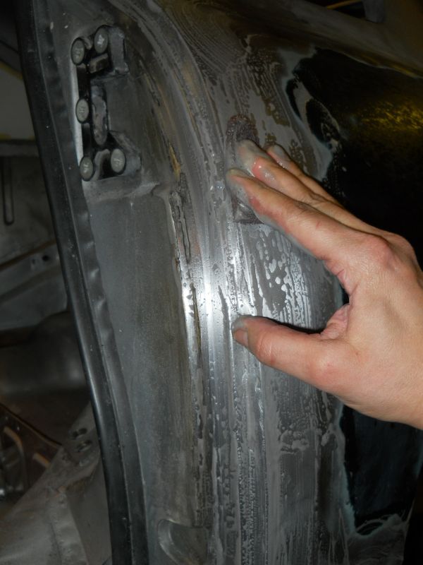

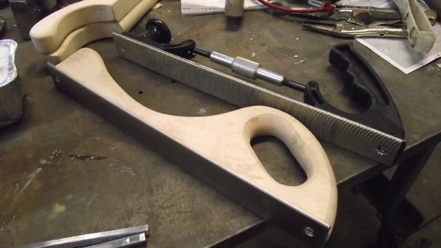

                          Second, since the fluxes we used directly with lead from the filler sticks we 'wiped' on decades ago are difficult to find for the usual save-us-from-our-(certain stupid)-selves reasons, here is what I have been using:
                          After tinning and complete wiping, I wash the surface as Justin does, but wipe it afterward with thinner and another clean rag after paddling to begin to rid the surface of the tallow, beeswax OR, as the 'ol' boys' used...motor oil. Theoretically, all contaminants rise to the surface while heating and maintaining 'plasicity' of the filling lead (I use a 'plumber's torch with a smaller 'B' cylinder of acetylene.)

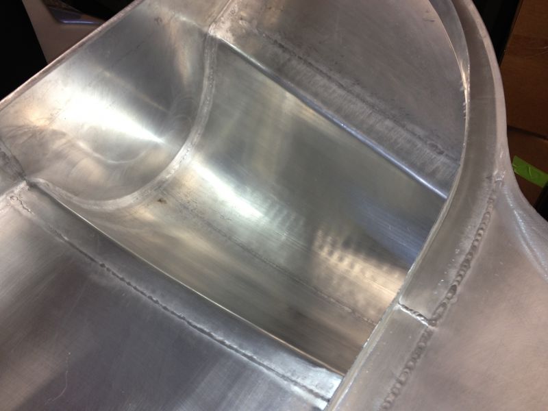

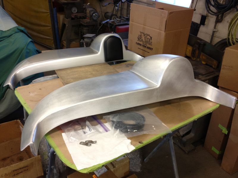

                          Third, here is fabrication and welding I admire. Done for Bob Kann (GT Werks) by a Swiss gentleman, the aluminum hard tonneau for 84255 is copied from my fiberglass racing version. The new owner wanted 'period correct' material despite my comment that a magnet wouldn't show a difference when both were painted. The real difference is in durability. My tonneau bore footprints from a worker who was helping lift me from the car when I was unconscious from a crash. I doubt the aluminum, while a pound or two lighter, would support any weight! Still beautiful work!
                          • Wow, all cool stuff. Bruce, would I ever like to see that spot welder. Oh man that sounds good!

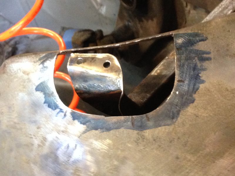

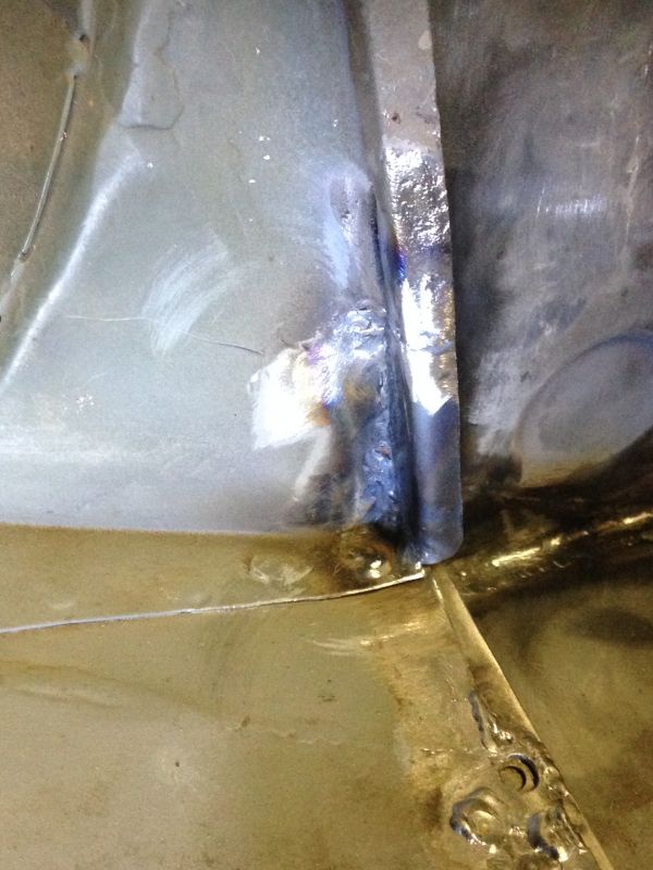

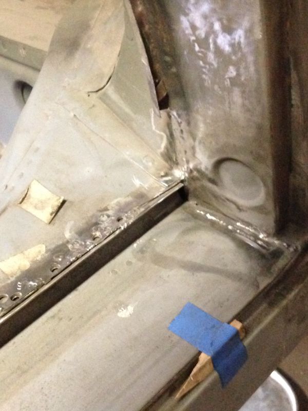

                              Each day, I'm trying to tackle small nagging repairs. Here's a weather seal channel fix.
                              Thanks everyone for the tips on lead work. I'm excited to start setting my door and hood gaps.
