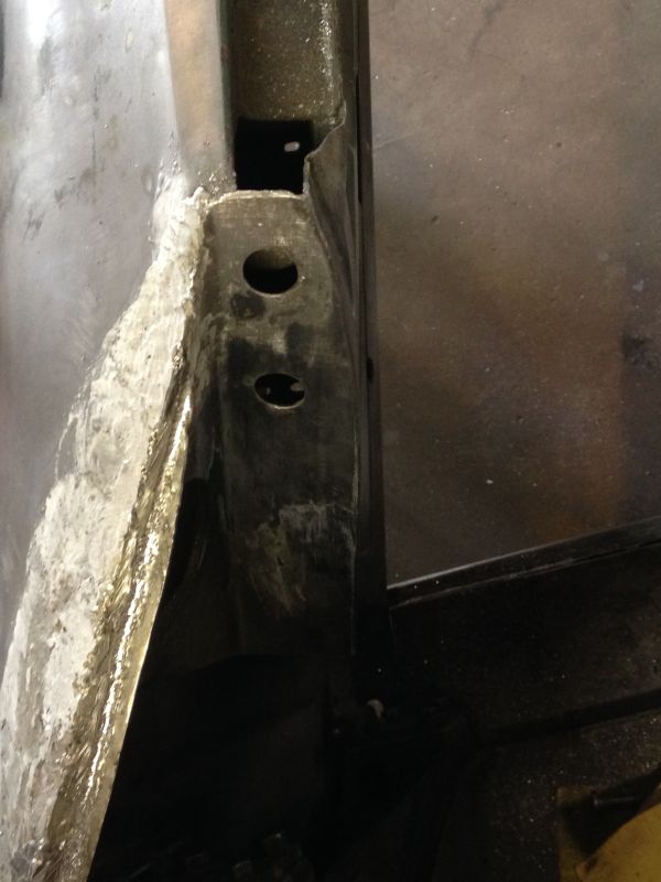

    • Hi guys,

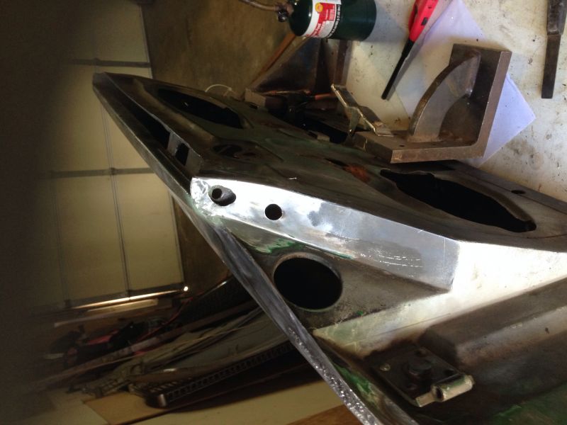

      As I was about to solder the door I noticed the large elongated hole at the top. It's very ragged and doesn't look factory. My other door has two equal round holes which seems correct, but I'm not sure because I repaired this area some time ago.
      Can someone tell me if these two holes should be equal? My car is a Karmann T6C.
      Thanks,
      • I often see irregular holes in this area on factory cars, probably due to mis-alignment to the inner holes for the window frame hardware making it impossible to put a socket on the nut. Almost always on the upper hole. Generally the rubber piece that glues to the door covers it.
        BTW, our 356 day party will be Dec 20 this year.
        • As Jack said, its definitely been hogged out for socket clearance. I'd punch a new hole in a repair patch and use a socket as your locating jig when you get ready to tack it in.
          I'll put that on my calendar Jack!
          • Thank you Justin and Jack for your help on my door hole dilemma. I hope to see you both again at Jack's party...its on my calendar too.
            It's been so long I forgot that this is covered by rubber, but I welded in another patch anyway making sure a socket can reach in there.

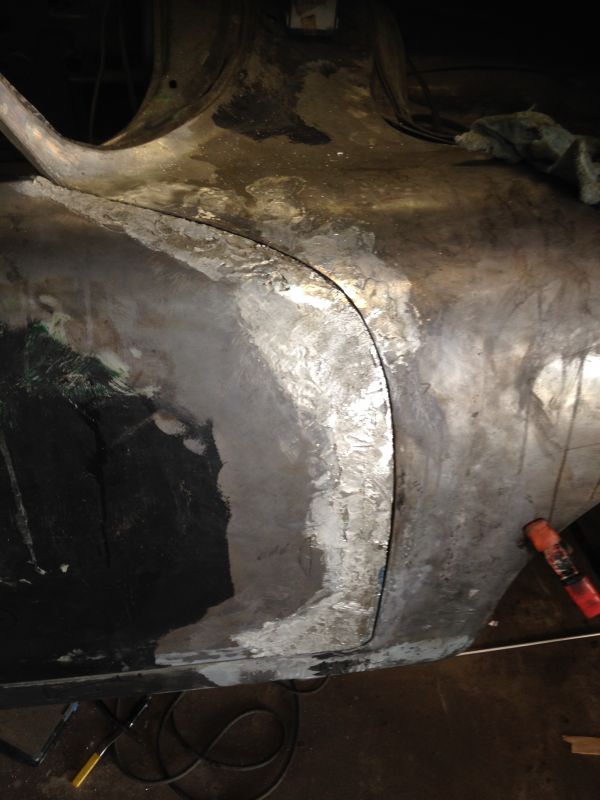

            Only the finished product shot here with a bit of solder over it like the factory did. The top had some factory gas welds that were originally smoothed with lead.
            Also in this picture you can see the solder that I added to the door to control the door gap.

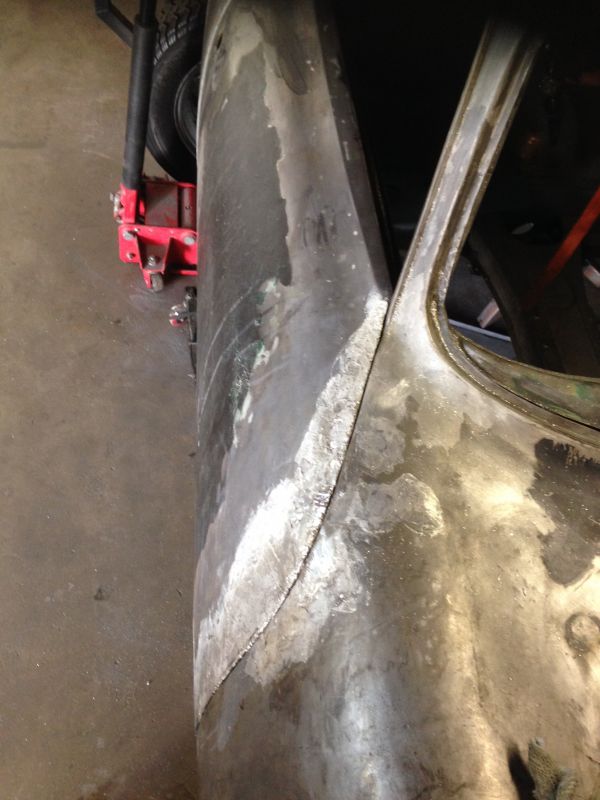

            Here are some progress pictures.
            This is more solder than I need, but its much easier to have too much than try to add more later. Believe it or not the door opens and closes just fine with the small gap pictured. I did knock down some high spots and interferences with my die grinder.
            My body files were crap, so I sent everything out to be sharpened, so I'm waiting for them before I level everything out.

            • Looking good Tom! You have more self control than I did; once it was applied I immediately had to file it down to see what was going on. Gaps and lines are shaping up nicely!

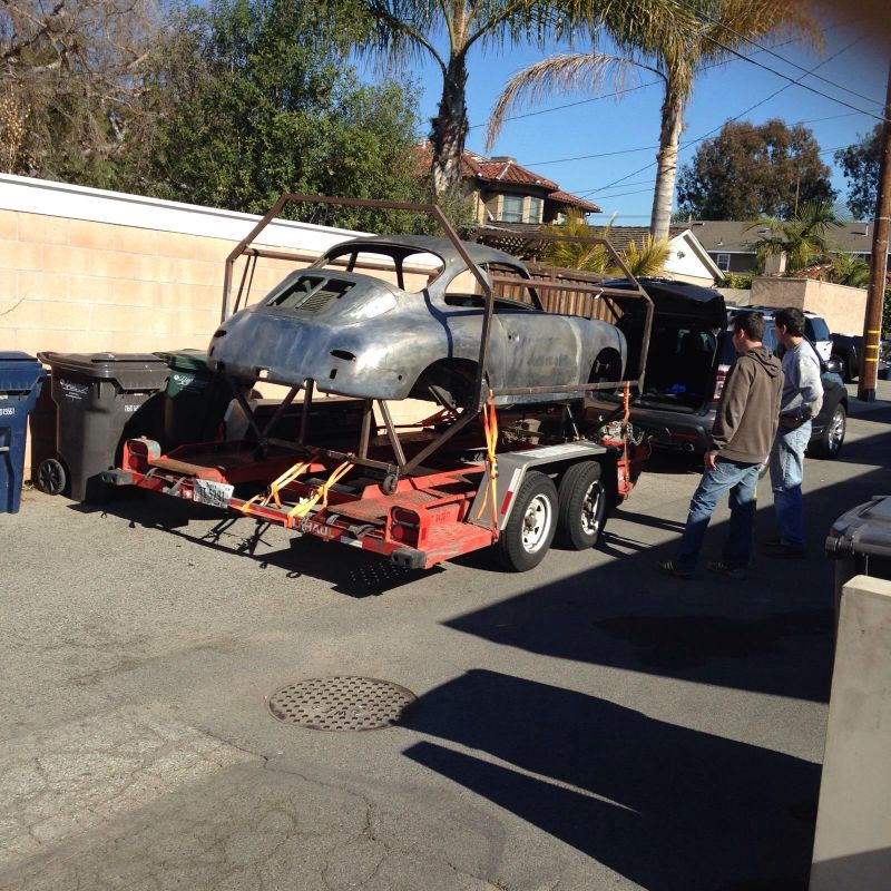

                • I hunkered down and took this rust bucket as far as I could. Well I could have tinkered with it for longer, but I'm so far behind schedule and exhausted I took it to my potential painter/body man.

                  Sigh of relief, but it's about to get expensive! I'm actually ok with it knowing how much work it is.
                  • UH-OH!!?!! You're now ready to move onto the paint and body work stage Tom?? I better get my coupe into final paint this spring before I really get embarrassed for myself here shortly!
                    Seriously, that is fantastic news! Congratulations on officially getting past the steel work stage. It looks really nice sitting on that trailer. You're right, you could continue to tinker and chase it for a lifetime but you just have to draw the line somewhere and say that "its close enough, time to move on". You said "potential bodyman", so you're still shopping; Who are you considering to do the work?
                    Expensive yes, but you have saved yourself a boat-load already so you're still way ahead of the game. I sort of envy your position though, how nice would it be to have someone else doing all the donkey-work while I wait for my beautifully painted shell to arrive back at my door. Very cool! Congrats again on getting to the next phase!
                    • Congratulations Tom. I dream about that day. Lots of sweat in that 356. Keep us posted on your last few weeks and the upcoming paint story.

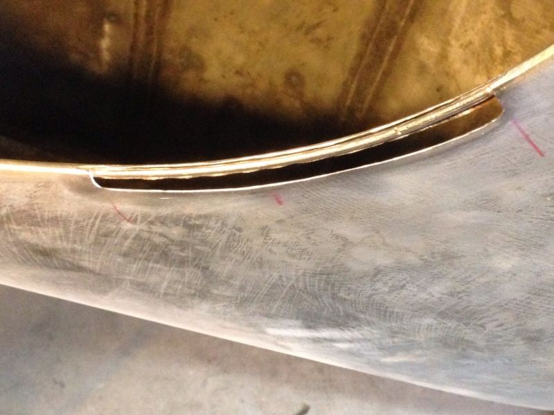

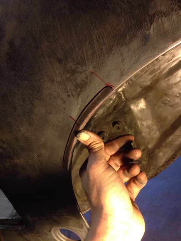

                          Here's a quick repair on the rear fender arch as I remember one of your cars had the same issue as mine. Basically the metal was sanded down too thin.
                          Here's the crack.

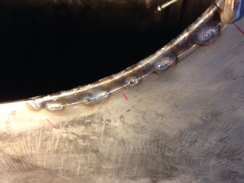

                          Repair piece formed with pliers and a hammer. I just got a bead roller, but it's not fully set up yet so I did this quick and dirty.
                          Here's what I cut out and cleaned. Yes it was rusty inside! Car was flipped upside down to make the welding easy.
                          Partially welded in.

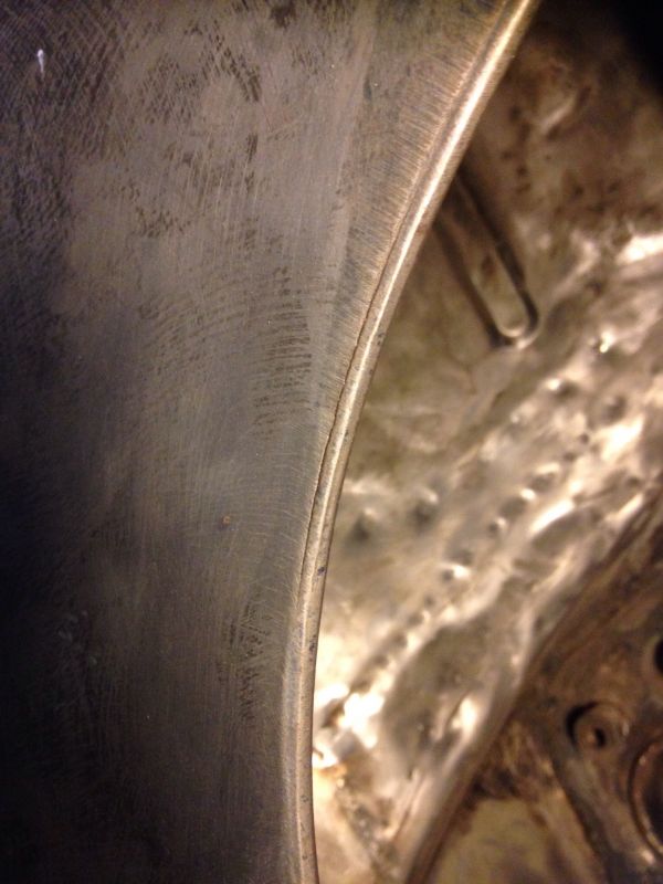

                          I don't have a picture of the finished repair, but you get the idea. If I did it again I would have made the patch slightly bigger because I ended up with a slight dish where I couldn't planish behind the wire rolled seam.
                          Thanks again to everyone for all the encouragement to keep me going.

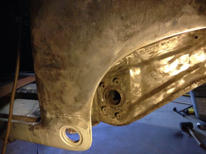

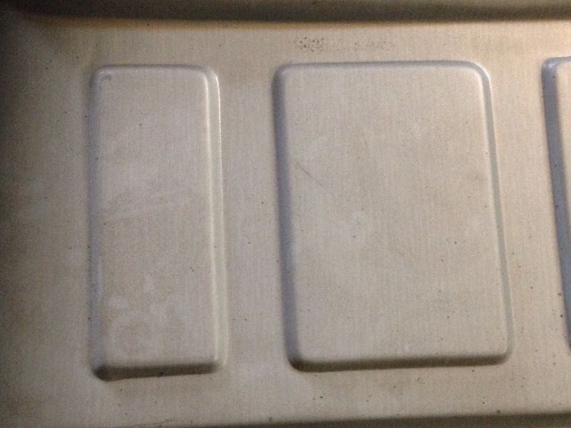

                              So the last major update to my car was the floors. I've been hoarding these for several years and I think they are from Stoddards. They certainly aren't the best.
                              I don't have a lot of pictures, so I'll try to describe the improvements I made.
                              Shortcomings:
                              Rear bulkhead lip too short
                              Rear depressions radii too sharp
                              Transverse tube too round. Not elliptical like the original.
                              Missing Karmann drain holes at rear and floor plugs
                              Front triangle depression interfered with longitudinal flange. (3/4" all around)
                              Front bulkhead shape was barely formed at all with no crispness
                              The opposite was true with front depressions were too crisp.
                              I know it sounds like I'm complaining , but I'm not. I'm just comparing to my original floors and striving to make the new floors look as original as possible.
                              Rear indent radius too small

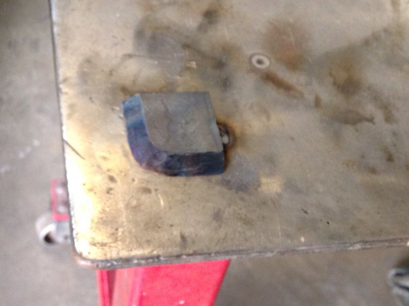

                              Handmade form tool to correct said radius
                              Gotta update the rest in a part 2.

                                On floor stampings: that has been batted around for many decades and there is still no exact replication I have found or of which I have heard. For a very long time, the "Zim's floors" were the best, with restoration design being a close second. The proprietary Stoddard floors are from steel dies but primarily and most noticeably compromised by the exaggerated transverse 'hump.' I have had to cut short the rubber mats to allow seat adjustment when I tried to use those when first out, as a mat over that hump won't allow clearance for the seat pan. (I was bailed out by shim strips under the seat rails, but that may be unacceptable for a tall driver/passenger) On the underside, anyone can look and immediately note the exaggerated transverse hump and after that, not bother to notice any other discrepancies of details. "Ah-h-h, it's a repro..."
                                As for the Karmann details, I made a die that is very close to the original metric hole but actually makes the plugs fit a common US hole saw or 'knock-out' punch size. The circumferential depression is easy. When someone sees those on a Karmann chassis, the visual effect of that detail is huge and that the floor stamping is a flawed repro is lessened. It's worth the extra time and effort if the chassis number begins with a '2.'
