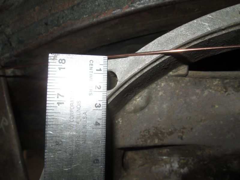

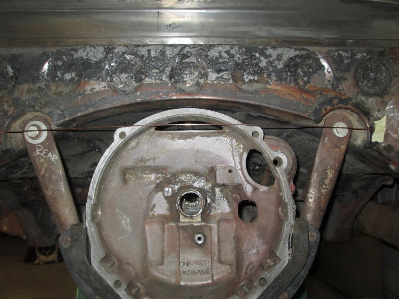

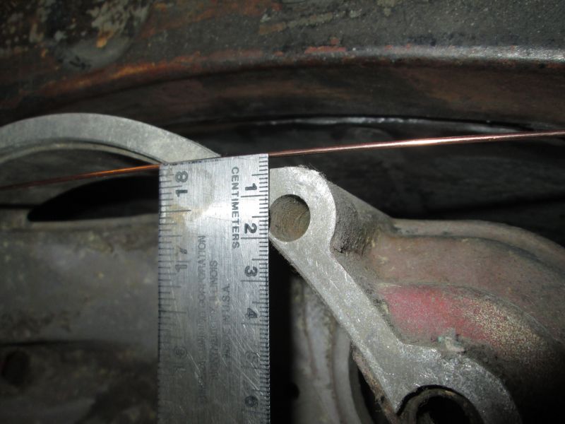

    • Hi Justin could you please take a measurement on the cradle to body mounts (i refer to pic 5447)
      I need the distance between a line drawn through the cradle mounting bolts and another line drawn through the top engine mount bolt holes on the gearbox. From the picture it looks to be less than 30mm
      I need this to verify a distance on my chassis
      thanks Armand

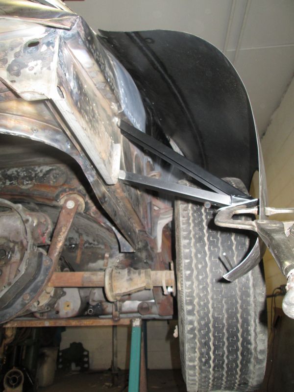

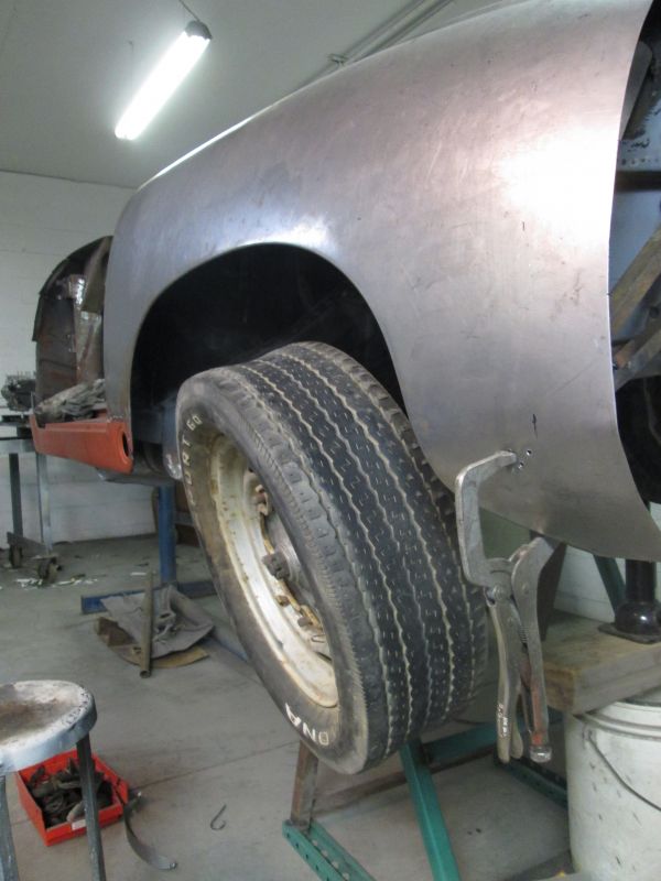

      • Justin, let those axles hang down a few more inches, then check clearances. They will get quite a bit tighter.
        • Hey Per, I've heard claims of 7 inch wide rims fitting in the back if the backspacing is dialed in though I cannot confirm that personally.( Not Pre-A's though) Yes, it would be foolishly arrogant of me not to take the advice of these guys. I would only be rediscovering the pit falls they figured out decades before I was even involved with these cars.
          Hi Armand if I understood your request correctly this is the distance you needed confirmed?
          Coming in right at about 15mm.
          Please keep in mind that the mounts are brand new and the gearbox is completely empty so old mounts with a loaded box will certainly create more distance. I hope this was of some use.

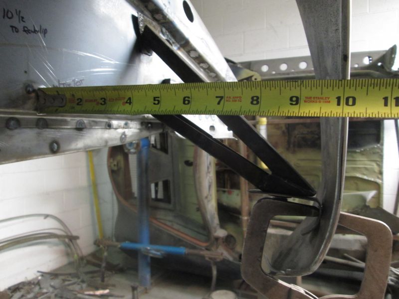

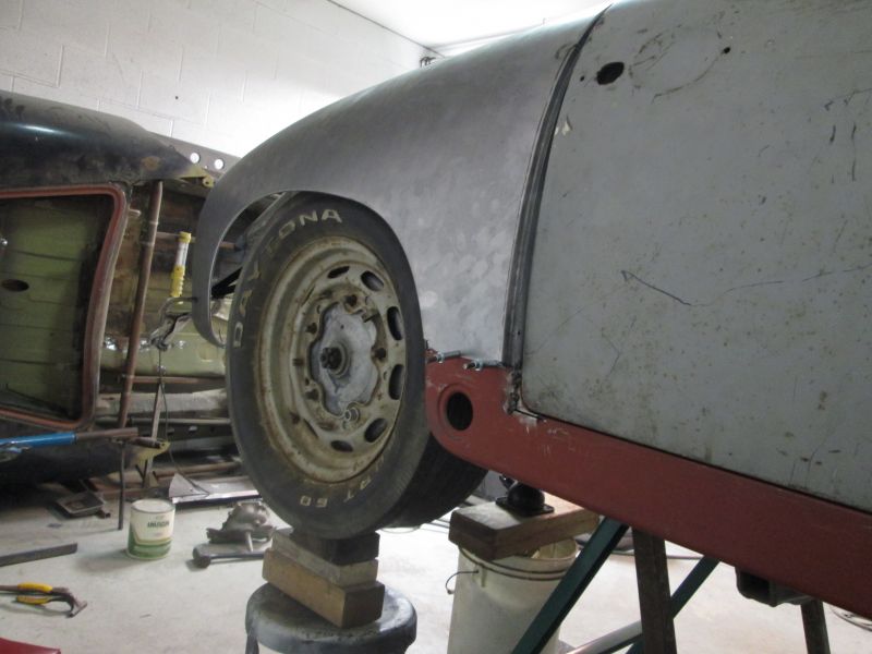

          Jack, as I cycled the suspension through on the first mock up I didn't note any clearance issues but I didn't get any shots of the edge of the tire at the apex of the suspension swing either so I set it up once more.
          Here it is set at its farthest sweep before the edge of the tire begins tucking inward.

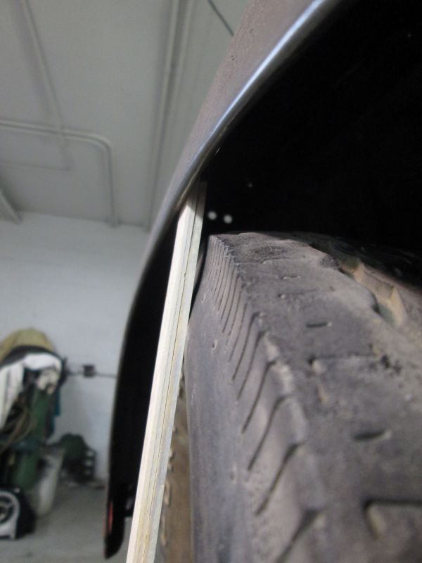

          I can comfortably get the thickness of two paint sticks in there.
          By the "writing on the wall" this lip began at 10 1/2 from the frame. With the current clearance displayed its back to 10 even. I don't want the fender to overpower a more stock tire size so I'm thinking I'll try and dial it back to 9 1/2- 9 3/4. However it all depends on what the tail skin is going to allow. I at least now know for sure that there is clearance and a target to come back 1/4 to a 1/2 inch safely.
          Jack, thanks again for the suggestion because I would not have done it otherwise. Its answered a lot of questions.
          • Armand,
            That nicely milimeter distance Justin gave you will diff a couple of mm
            Depending on brand of gearbox rubber/ renovation.
            Also old oilsoaked will get you down a bit.
            Plus you need to strap your engine in as well
            Atleast you have something to work with.
            /JOP
            Oups, I wrote this before our "Ruler" made changes to his answer of having new mounts
            • Thanks this is just what I needed
              Armand

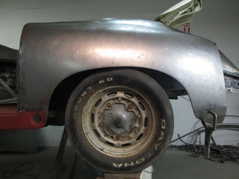

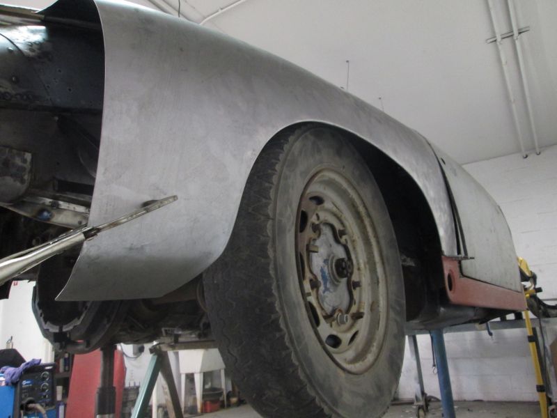

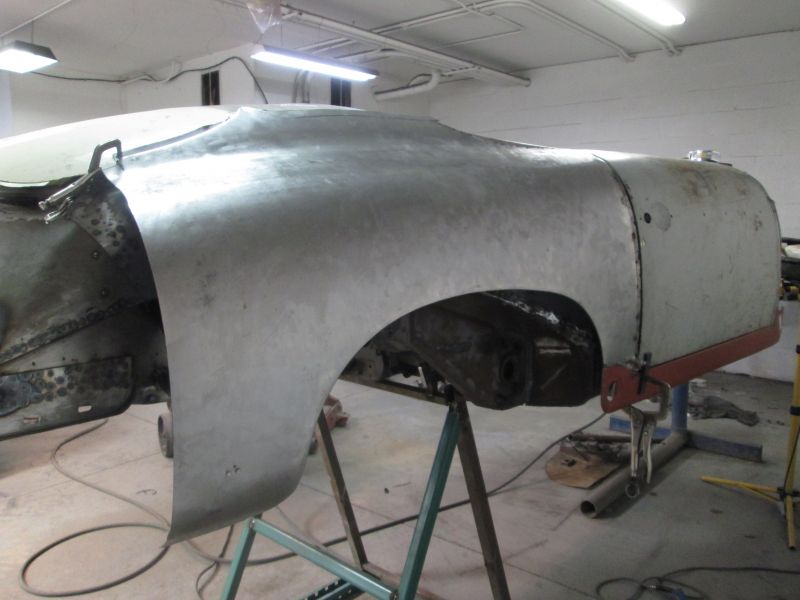

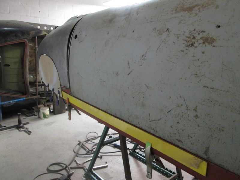

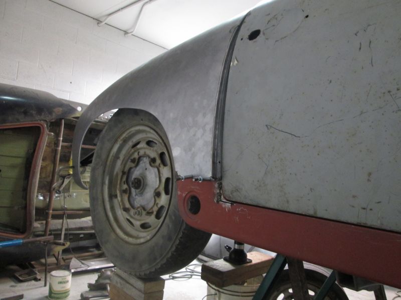

                  5/31/16
                  Right side fender clearance with wheels.
                  I'm opposite the factory findings; the right side is way wider than the left.
                  Based on my initial measurements I knew it was wide but I didn't think it was this far.
                  Even swung way clear of the fat boy.
                  Initially I was shooting for the fender braces to match in length but I'll have to shorten this one a few MM's more to allow the fender to move in where it needs to be.
                  This now explains why I was getting such a good fit with the tail last week. It also sends a chill as once the fender is back in closer where it belongs this joint is going to be as bad as the left side was. I'm thinking all three panels will have to be altered where they meet. I'll know once I get the right fender set.
                  After that I was very curious as to overall width of the tail. With it on the ground now was a perfect time to get a good look at it with an original bumper as Tom mentioned earlier.
                  Much to my disappointment it seems to fit against the bumper pretty well. I was disappointed in that the answer isn't jumping out at me at the moment.
                  Pretty nice on this side as well.
                  It looks pretty good. tail light hole sighting about equal to the bumperets. Cutting it in half and narrowing it is not going to be the answer. Besides I didn't want to get into the decklid opening anyway.
                  May cut here and tighten it.
                  May cut it here and relax it.
                  Should become clearer once I get that right fender set.

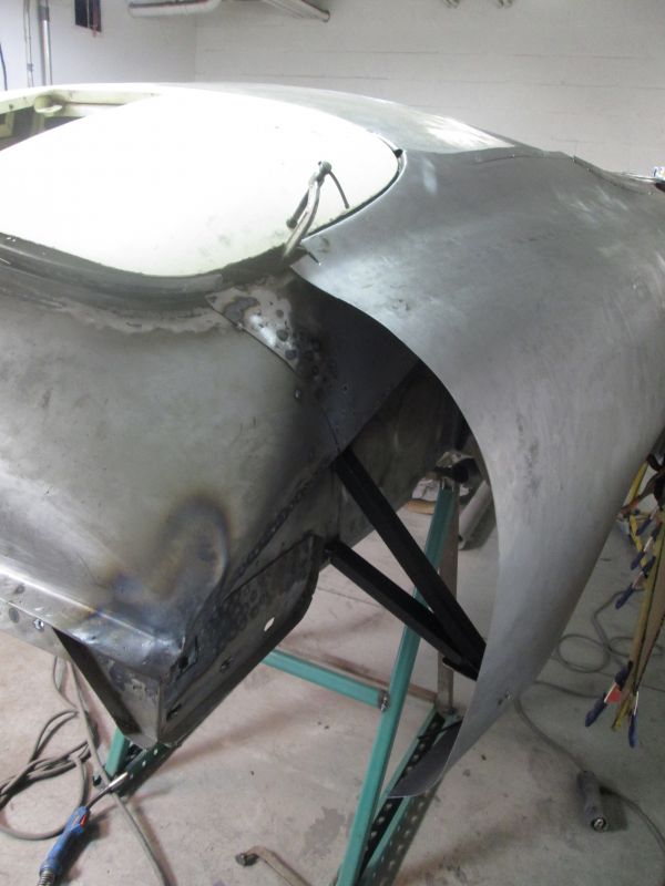

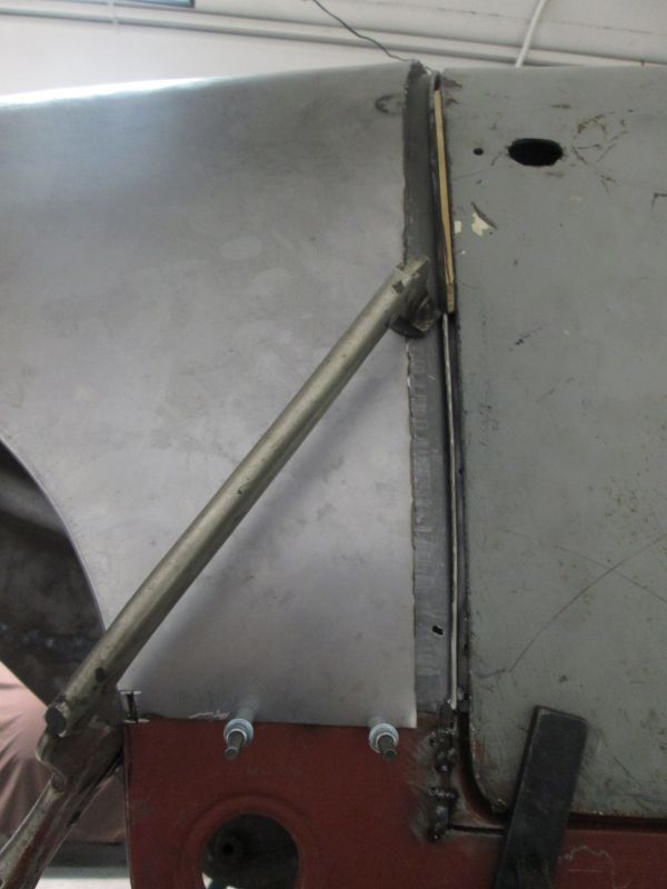

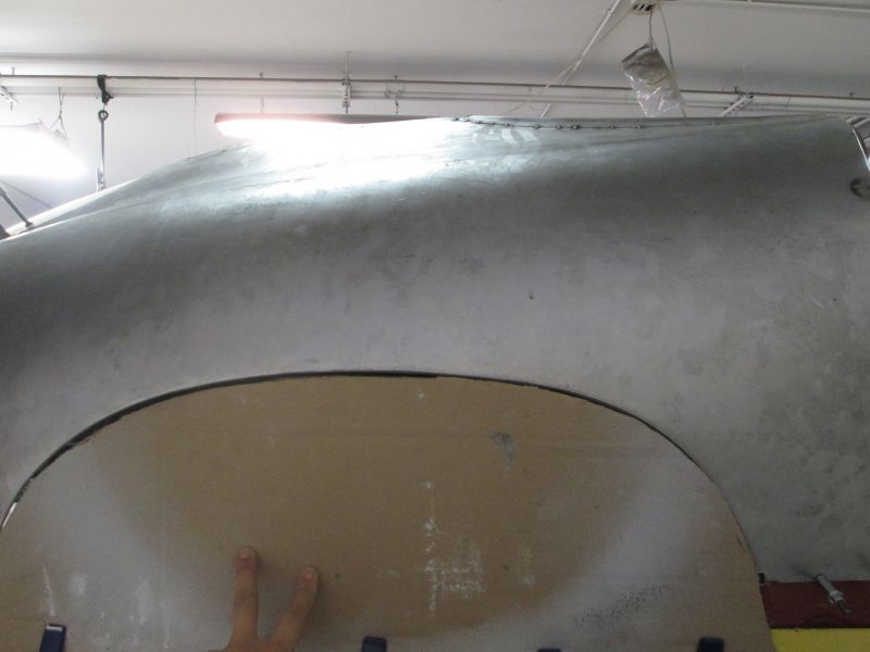

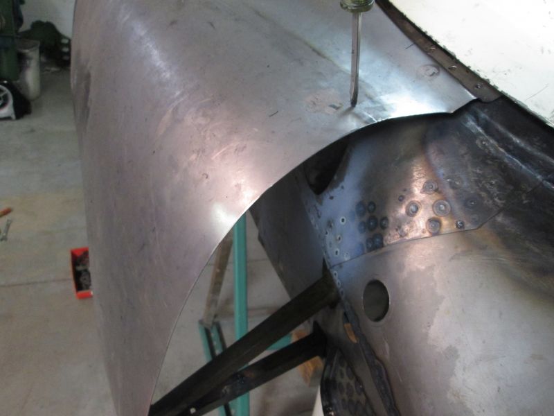

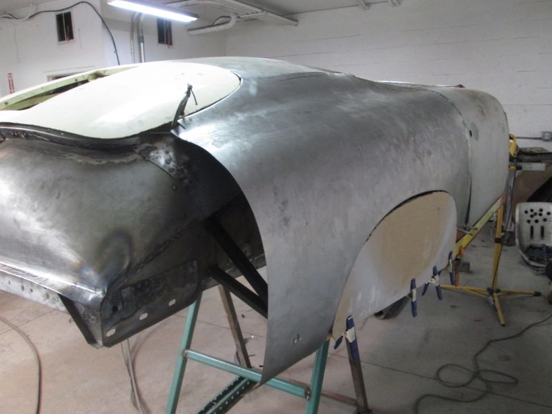

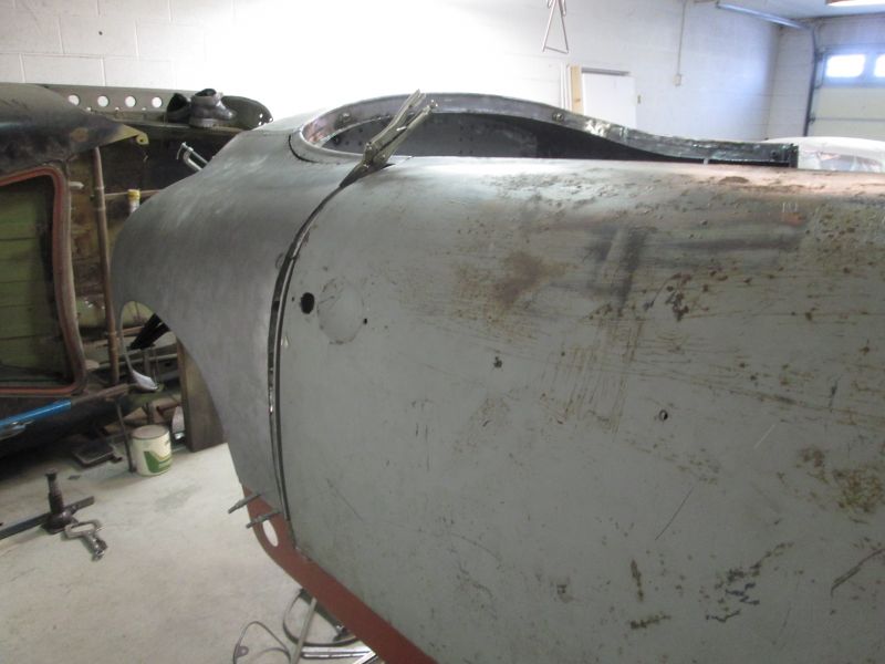

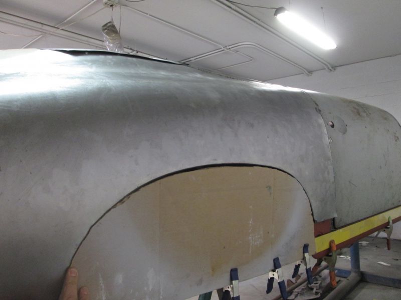

                    • 6/4/16
                      Right fender fitment rethink.
                      Had to reduce the width at the back corner and relax some crown in the fender profile but of course it fought.
                      The brace was shortened a few mm's now bringing the corner even with the other side. One problem solved.

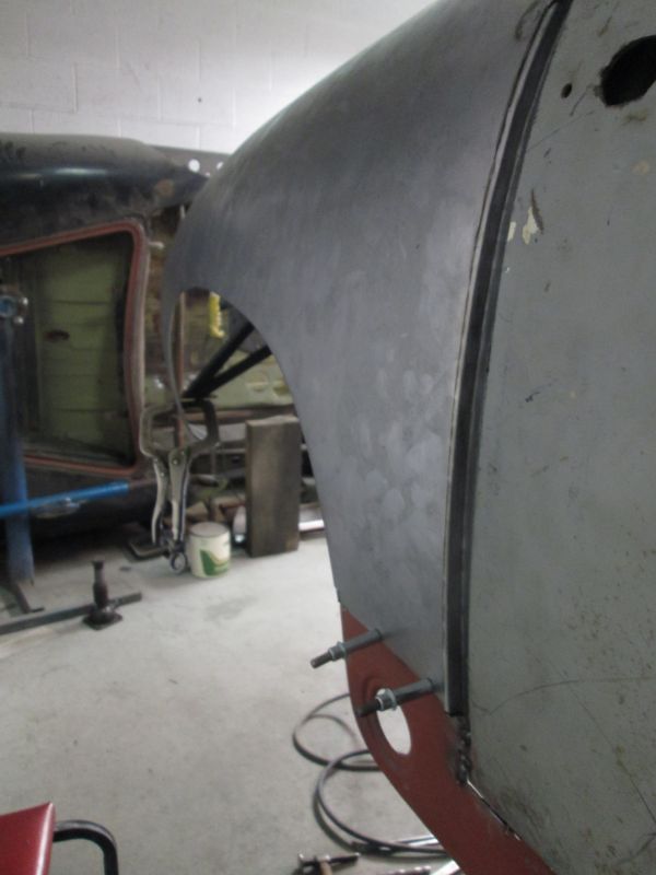

                      To relax the crown the fender was pushed in some to match the left this in turn made it longer throwing off my wired edge alignment.
                      It was time to change the approach. I initially concerned myself with establishing the upper edge first but this fitment was throwing off the rest of the fender and inhibiting the changes I was now trying to make. I unhooked it here and left it loose to allow the needed changes.
                      My prime objective now was to get the width and contour to match the left as closely as possible and to also get the fender openings to match. I'd worry about the edges of the fender after the fact.
                      Before the session was over I really had the opening dialed in to my liking.
                      Within 5mm difference at its very worst.
                      Initially it was concerning as to how I was going to get this side to lay down and match the left but once I backed it up and loosened all that I had done previously the path forward soon revealed itself. What I like most now is that the fender wells are almost an exact match. I thought as long as I have this I'll deal with whatever adjustments I have to make at the edges of the fender. Adjustments at the fenders edge next.

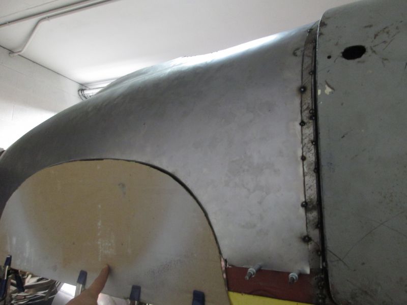

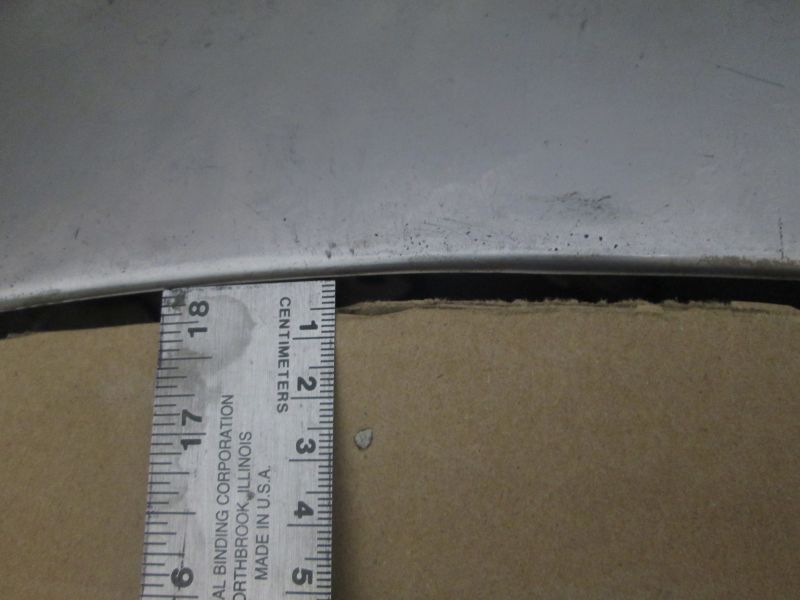

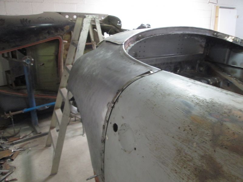

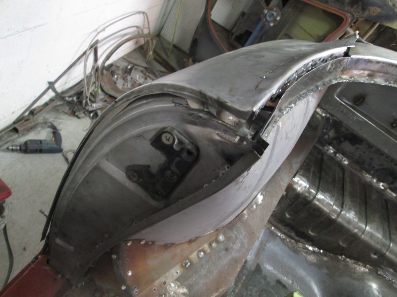

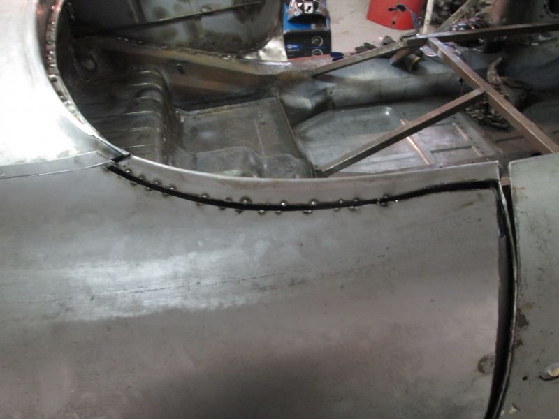

                      • 6/5/16
                        required changes at the edges of the fender.
                        With the fender in its basic and final position my flanged leading edge fitment with the striker became a whole lot worse.
                        A pie cut extension as originally thought was no longer going to do it. It now required a full filler strip top to bottom. Took the plunge and cut the entire run free.
                        Going to need about a 1/4 inch filler section to get the flange to seat over the striker post. That's also taking into account the paint stick thickness+ I need for a door gap.
                        I needed the very cap to stay where it was so I cut the tacks free allowing it to shift.
                        shifted a quarter inch corresponding with the rest of the changes in this area.
                        Scary and a PIA but no way around it. Once the wheel opening was dialed in it was just short up front. It was showing me that at the very beginning anyway.
                        Filler strip and reattachment of this forward upper corner next.

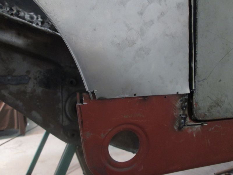

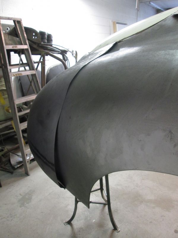

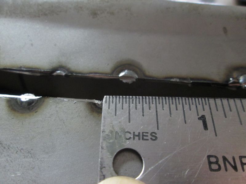

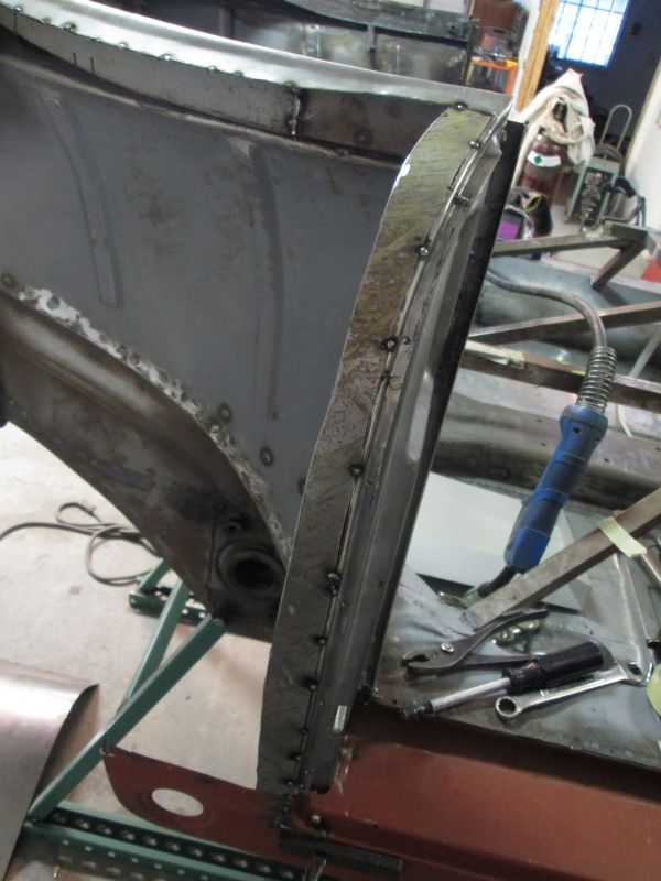

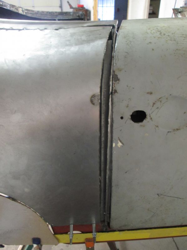

                            6/6/16
                            Fender Filler...
                            Filler strip tacked to flange.

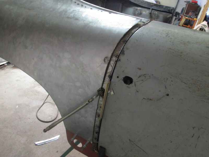

                            Fender remounted(again) with door gap established so I can scribe in the final cut line.
                            excess removed and final strip thickness making up about a 17mm shortfall.

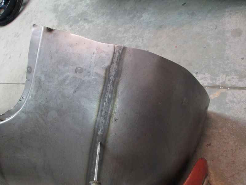

                            Tacked to fender and working my way upward. Hardest part was getting it flush to lay down a tack-weld. triple checking with the template again.

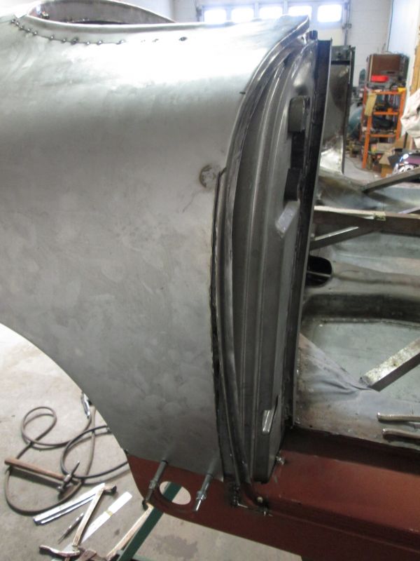

                            As I make my way up a decision had to made as to how much I was going to swing the fender out for stock width and a general contoured shape that "looked right" and closely matched the other side. It of course was a bit of give and take. I'll get into that on the next one.
                            Closer...ever so slowly.
                            Thanks for stopping by!
