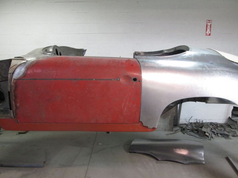

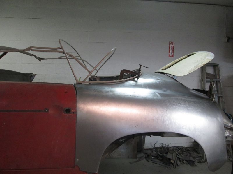

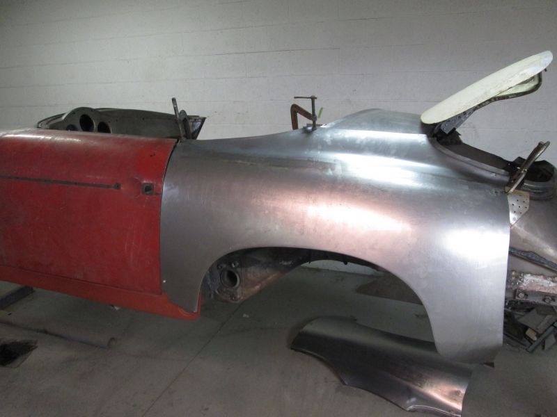

      Left quarter panel fitment.(a few days ago)

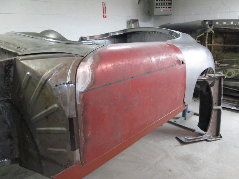

      After some time spent getting my head around the best way to approach mounting this fender it became clear to treat it like all the panels before. Position it so it continues the body line and shape off the end of the door. Once the gap and profile shape are established I'll chase the rest of fender toward the back of the car.

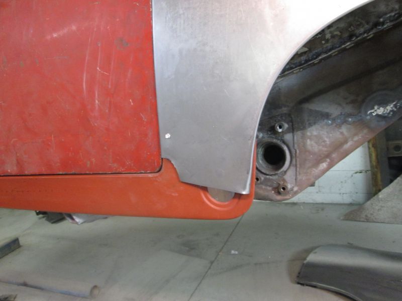

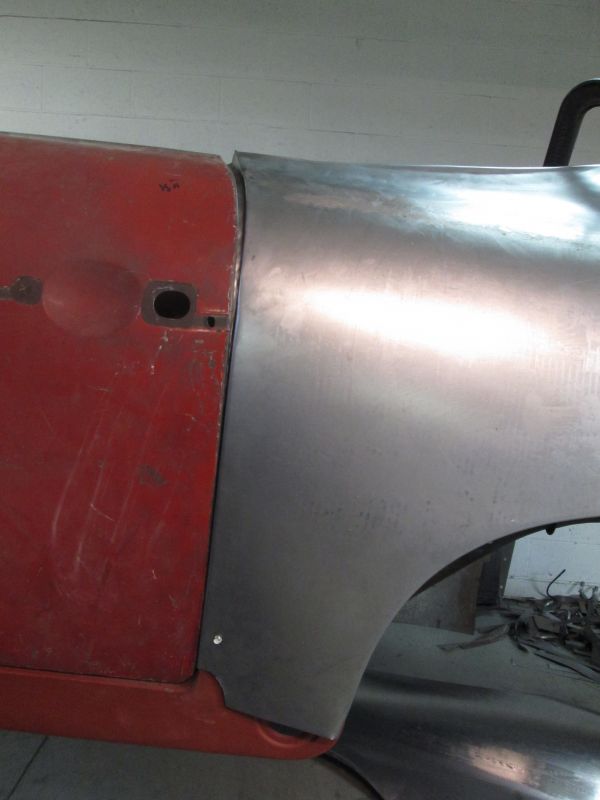

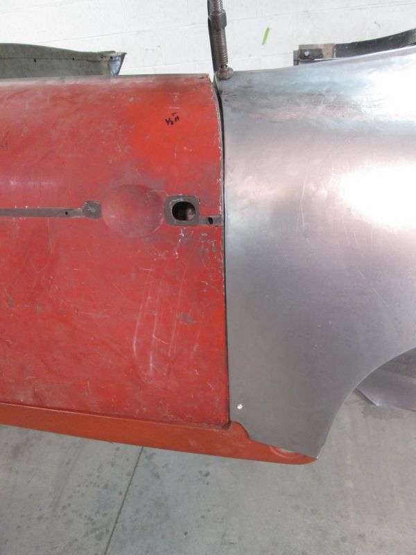

      perfect example at the door handle where the vertical profile of the fender needs to be matched to the profile of the door.
      Height issue at the upper corner of the door here and the list goes on...
      I mentioned to Trevor on the initial order not to bother mounting the inner rail run but he must have forgotten. You can see here that I've already removed it by drilling out the spot welds. Not because I already used mine but for the freedom of adjustment specific to this car. I need to be able to slip the fenders edge up or down to match the door without disturbing the set position of the rail to the inner wheel house.
      I need the ability to push this corner down level with door and having that inner channel free makes it a lot easier.
      The lower gap is tight and too wide at the top but its good average overall fit for now so I added a screw to help hold it. Its just some place to begin.

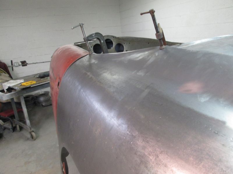

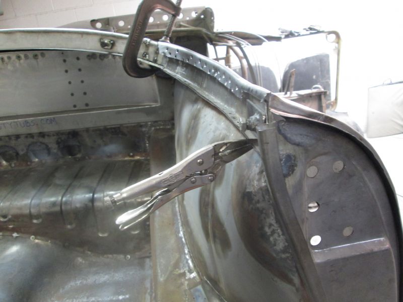

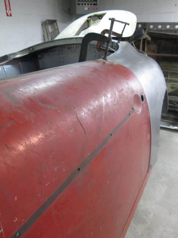

      Started adding clamps at the top to begin squeezing it down into alignment. Again this is where having it free from that inner channel really helps. It was also nice too see this whole sticker/fender area taking a finished shape.
      Second clamp added to drive that corner down level with the door. Still a long ways off but headed in the right direction. Fender is under a bit of pressure here BTW as its of course is fighting me but It will eventually submit.

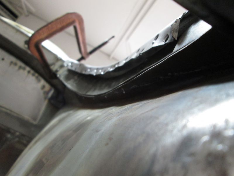

      Upper gap getting better. While I like that tighter gap the rest of the way down its too tight for the chassis flex of an open car so it will need to come back a few mm's.

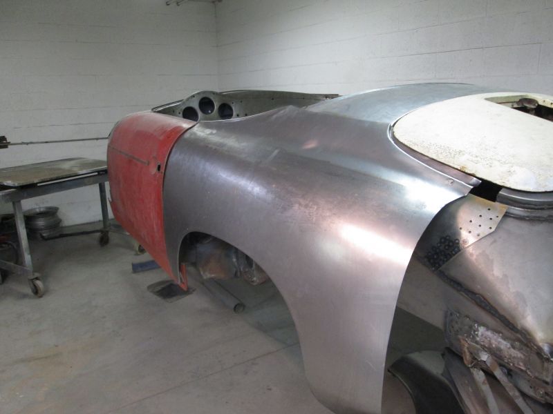

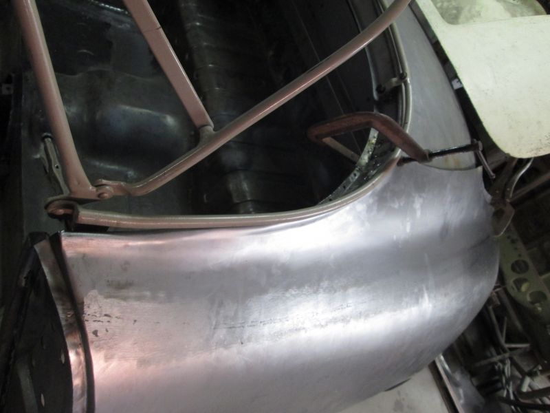

      Wheel arch is also lining up pretty good.

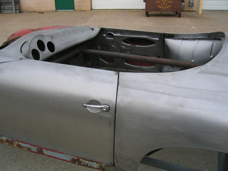

      Body lines are getting better from the door handle upward. I sure like added muscle of that crowned fender opening profile but to be correct it will have to be chased out flatter.
      More gradual fitting next. Thanks for looking!

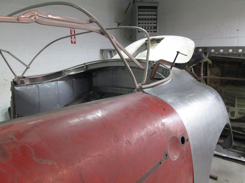

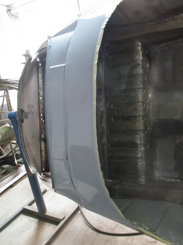

            1/7/16

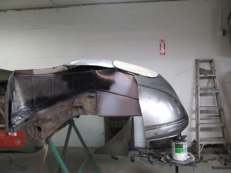

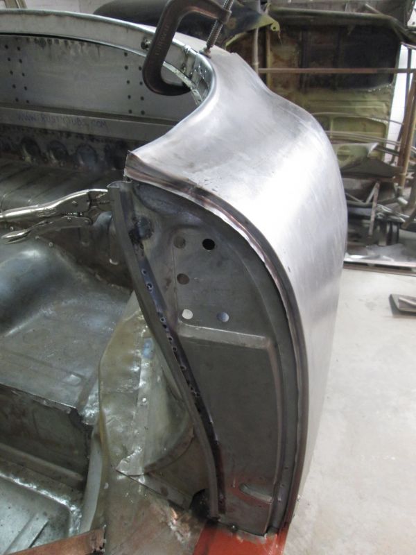

            Prepping chassis for rear cowl permanent install.

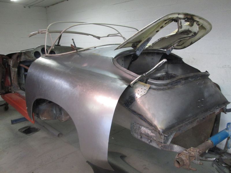

            With the fender in pretty good alignment there is quite the gap to close between the lip and the lower channel. Had to determine which side needs to move most so they'll seat tight.
            To help determine this I installed the top frame to see how the shouldered opening matched the base bow.
            Pretty damn close so the rail will have to be adjusted to suit.
            I tell you, a lot of "planets" all have to line up before you can really commit to anything.
            To my relief the lid opening is lining up pretty well at the corner.

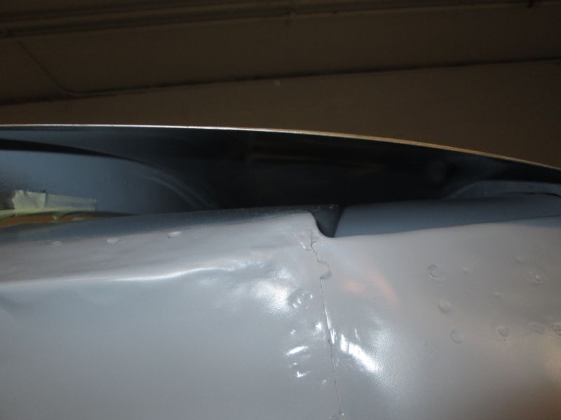

            But, it falls away from the lid as it continues down. Need to determine wheather the fender has to swing in more or the line needs cutting and moving.
            Won't have that answer until I get the ass end off the hoist and begin fitting the tail skin.

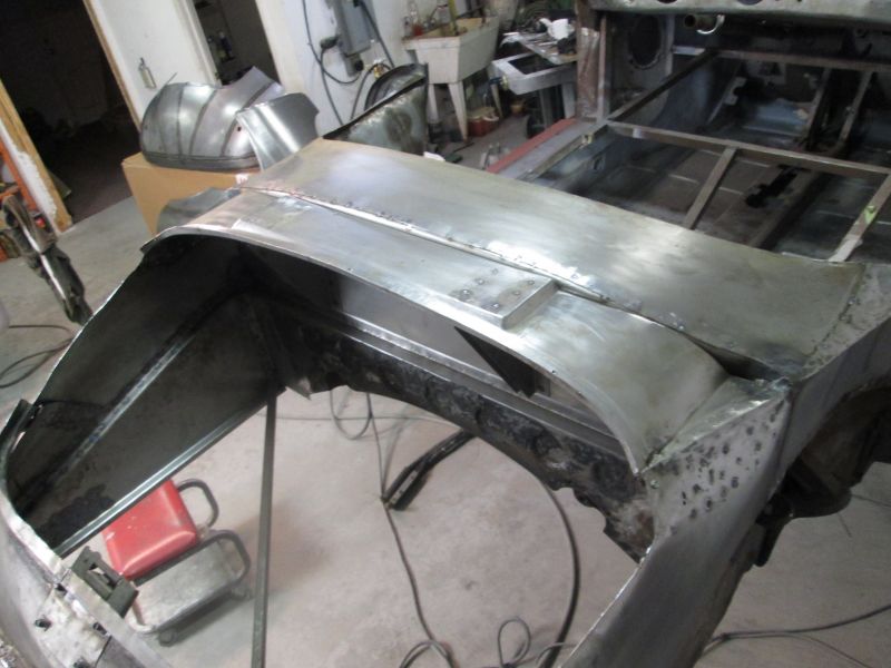

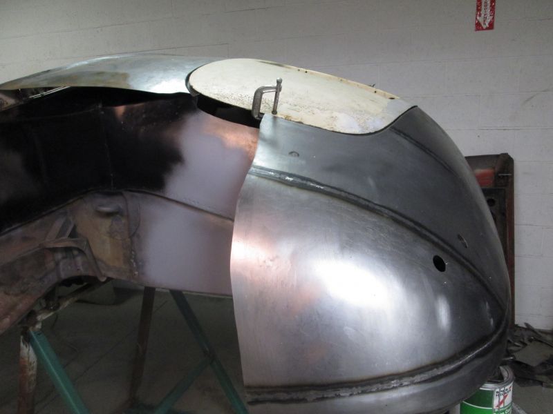

            Through this test fitment I was able to determine that it is now time to go ahead and mount the rear cowl on for good.

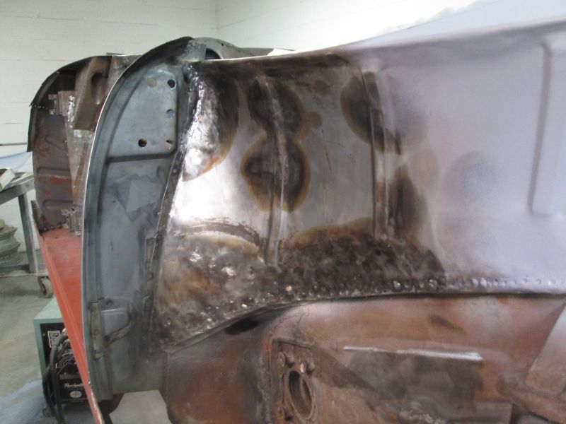

            I broke it all back down....AGAIN to prep both the substructure and the underside of the cowl for primer and paint.

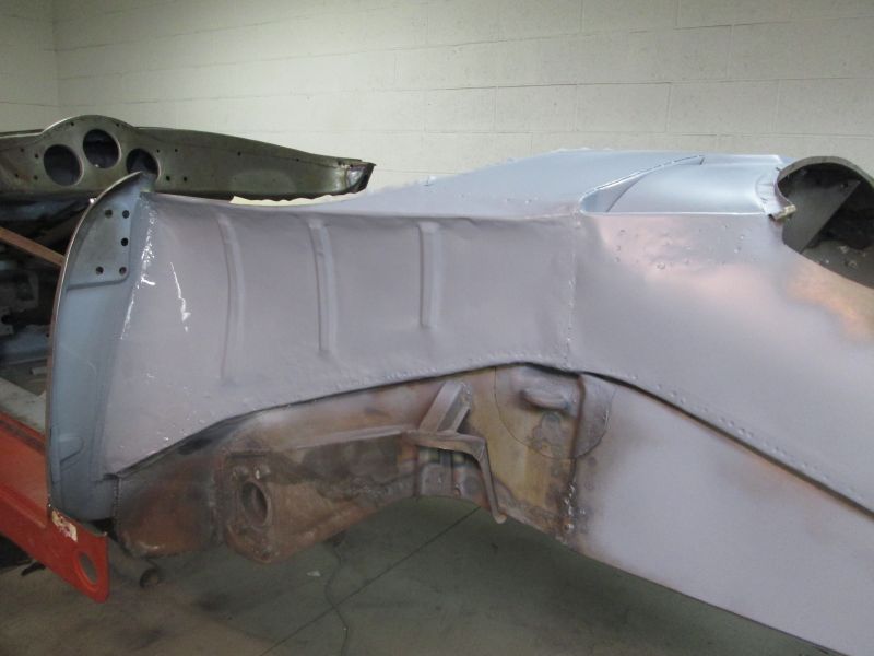

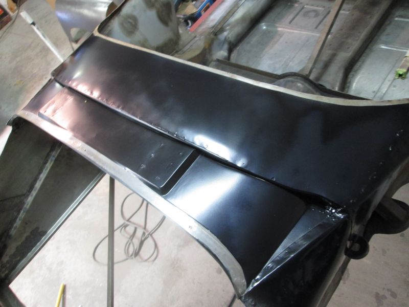

            Much to my great surprise this area remains an open cavity up in the wheel well. I was shocked to be able to run my hand up under the rear cowl of my original reference speedster.
            All sealed in heavy coat of epoxy primer.
            The time to seal and paint this area is now because once the skin is on there'll be no way to get any real paint coverage on it.

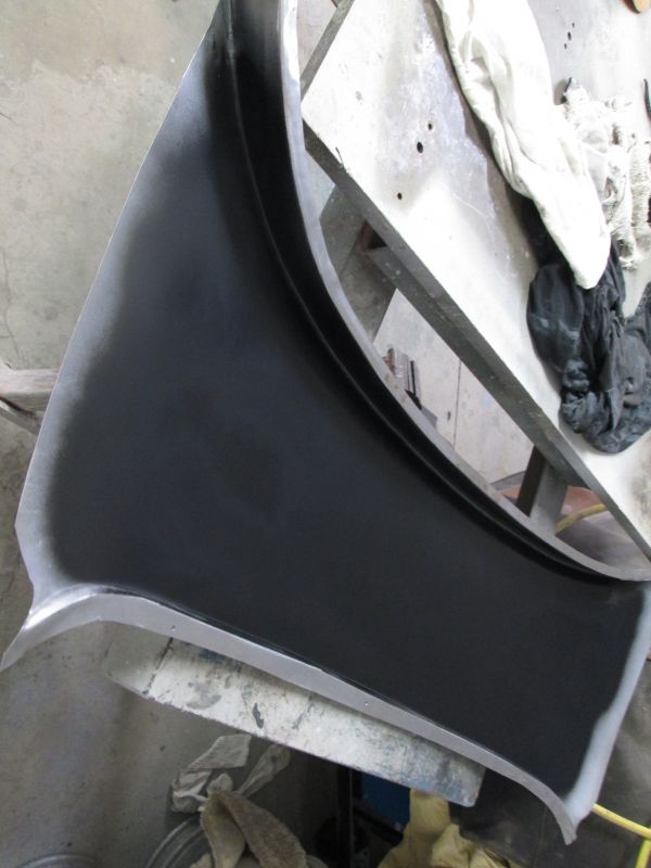

            Had some extra primer which I did not want to waste so I cleaned the forward section up for a fresh coat.
            Primered an officially done with welding on those specific areas.
            Underside of cowl primered now as well. Again this is the cavity that remains open and exposed so a good thorough coat of sealer is a must. I'll shoot a coat of black on tomorrow and will begin welding this panel on next. Thanks for stopping by!

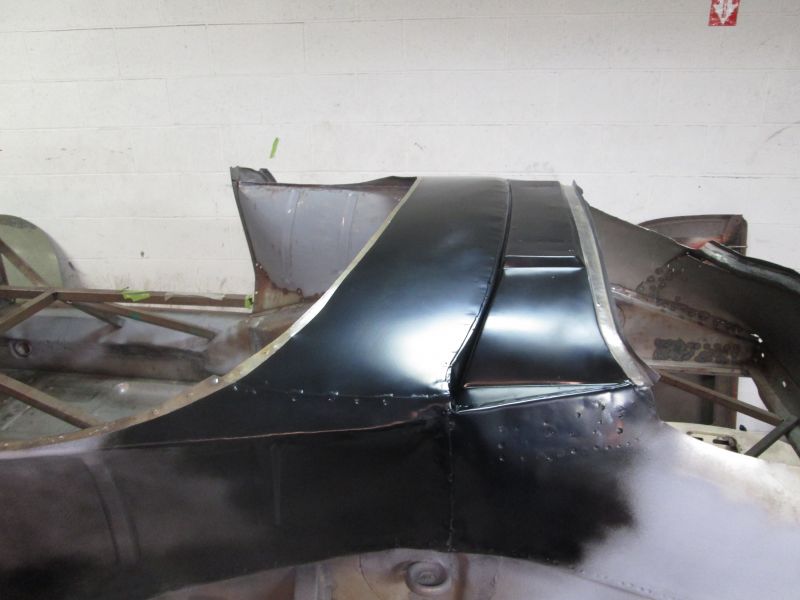

              Substructure in final coat of black today.

              Underside of cowl finished out too which leaves me free to button it up for good.

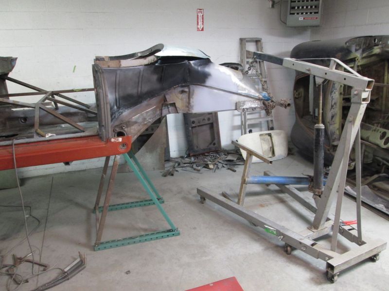

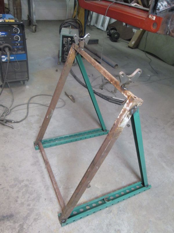

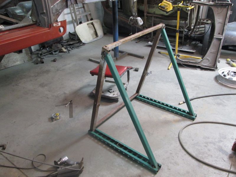

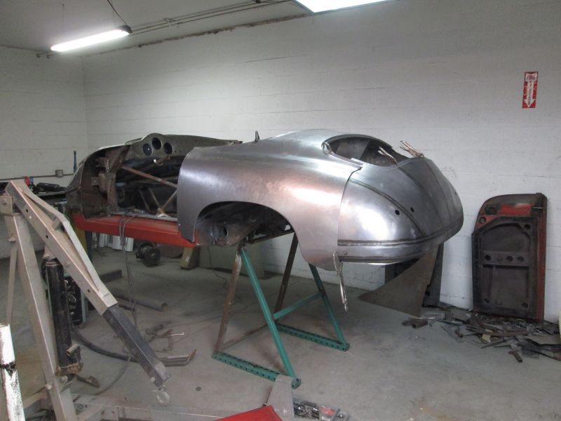

              Began building a stand from some scrap metal I had lying around to cradle the car at the rear torsion housing so I can continue fitting the rear skin. Should have it ready to go by tomorrow.
              Thanks for looking! Justin

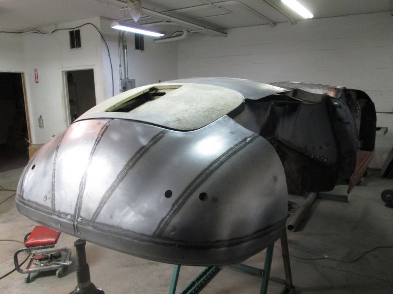

              • 1/9/16

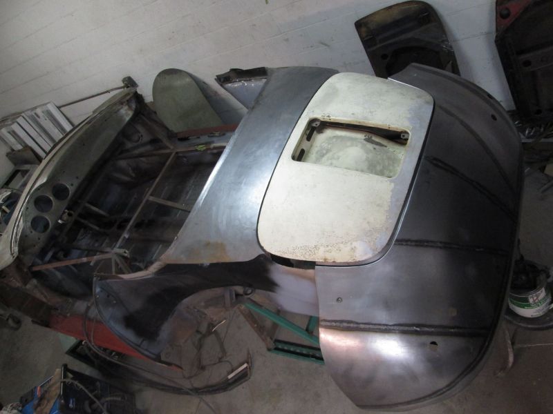

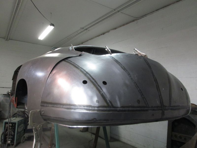

                Body on stand and testing out the new tail skin.
                Stand completed. A pair of caliper flanges I had machined years ago made for nice saddles for the torsion housing to rest in.
                Time to get it in position.

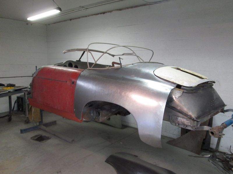

                In and it didn't collapse. Now the fun part... trying on that new tail skin.

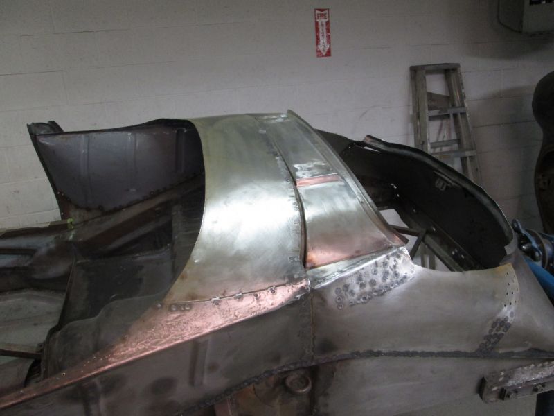

                Very rough initial mock up of course but it was fun to see the body slowly forming.

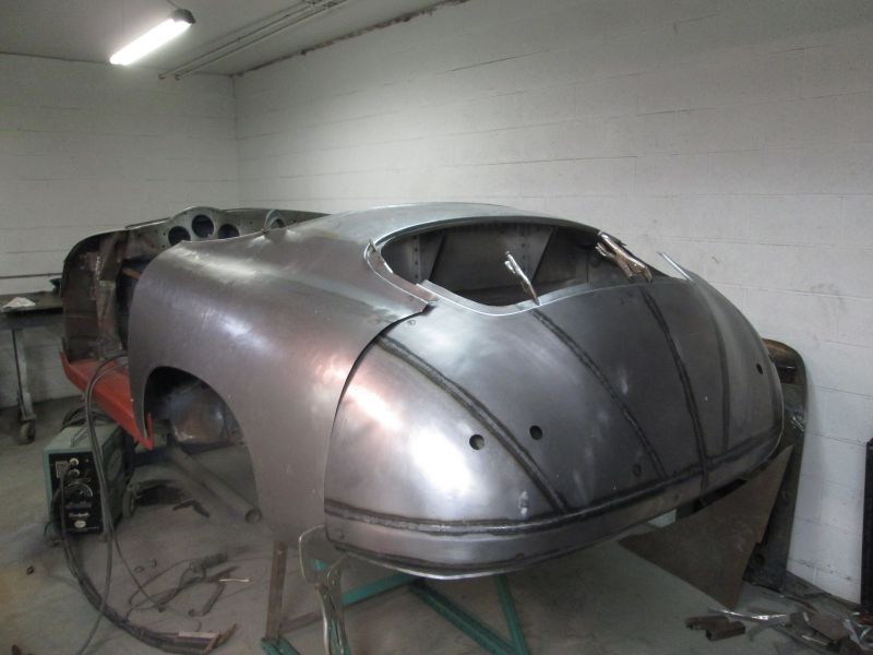

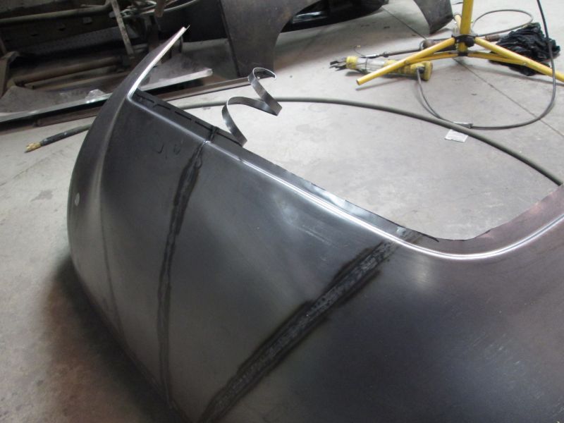

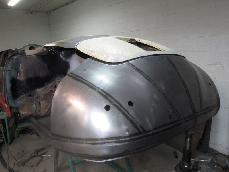

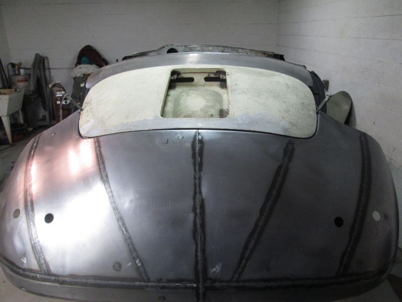

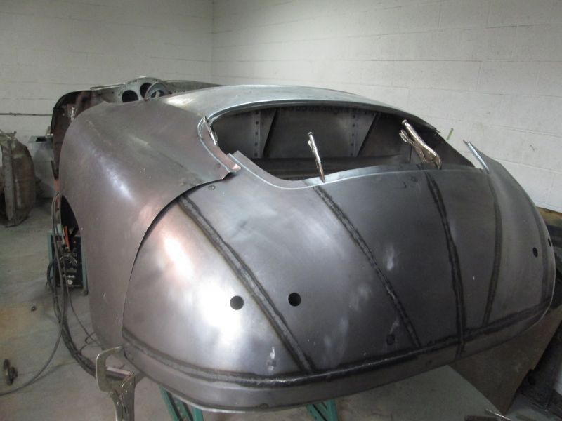

                BTW: I count 10 separate pieces comprising this tail. I took a rough measurement and between it and the length seam across both rear fenders there is almost 30 feet of seam welding here!!

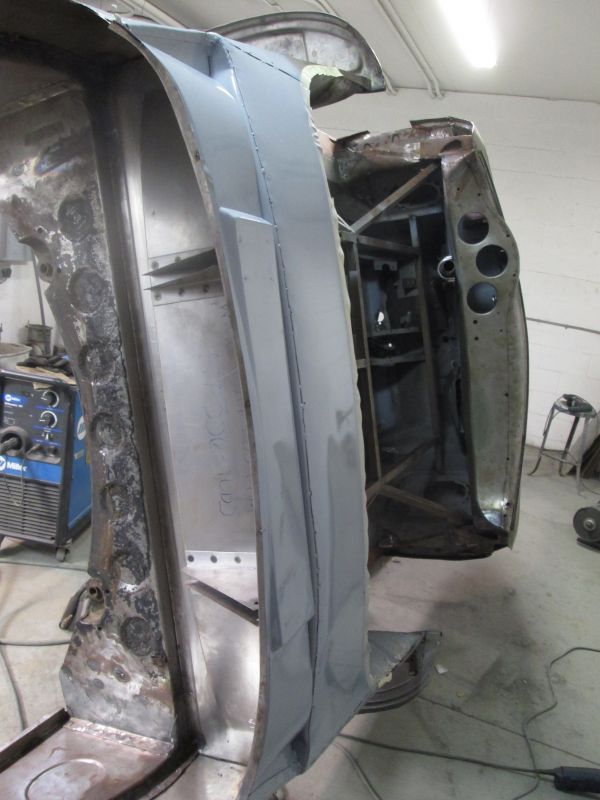

                A lot of bugs to work out, rear apron looks "stuffed" and too rolled under. Notice too the misalignment at the decklid opening. The tail skin's flange takes the more correct approach and the fender hangs too wide. (as I mentioned earlier against the closed lid) I may very well have to cut it. Have to get the decklid back on and keep playing with it.
                Anyway more fit and adjustment tomorrow.

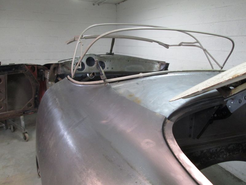

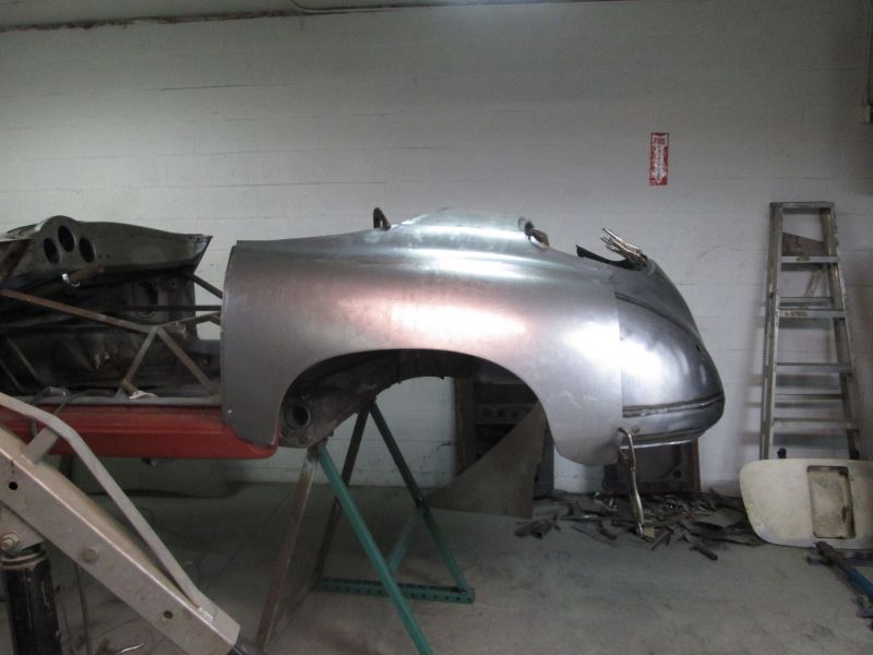

                        1/11/16

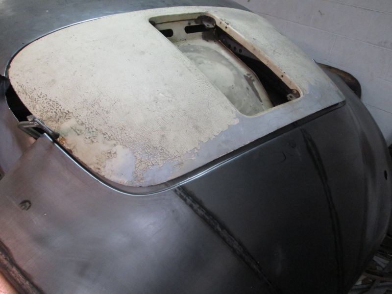

                        Fitting and locating tail skin first.
                        Since this is my very first rebody I initially thought that I'd mount the rear fenders then work my way back to the tail end but as today's session went on I found it a bit more natural to begin fitting and locating the tail against the decklid first. I feel like I'll have better locating feedback for the rear fenders with the tail most of the way set. Just theory so far.

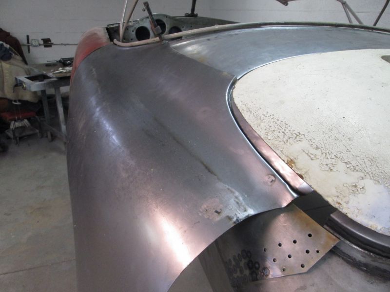

                        First was sight marking it for the best continuation profile off the back edge of the lid. Also too was rigging up a makeshift stand tall enough to hold it in place for these trial fitments.

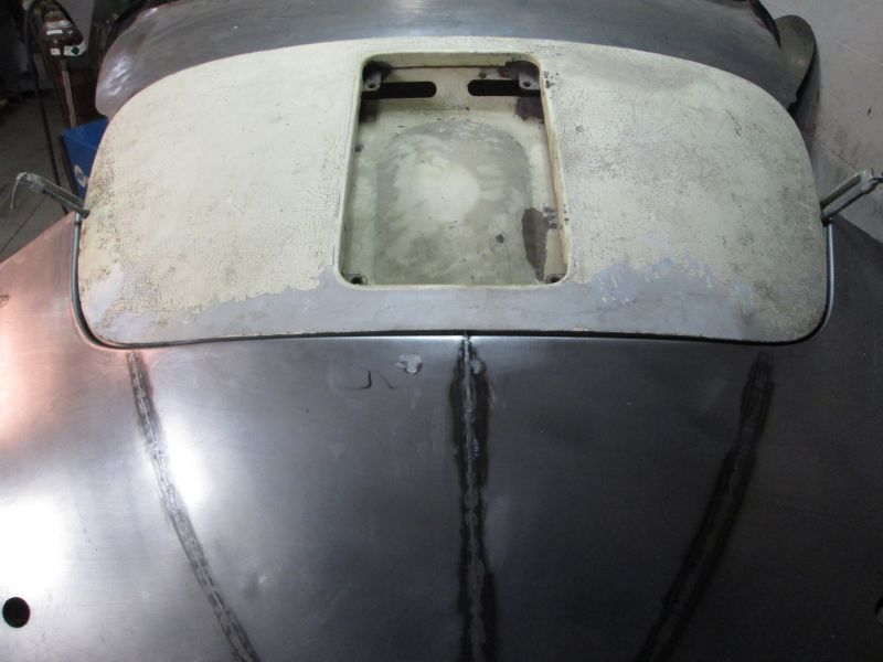

                        next was centering the opening with the lid.
                        Very promising as the skin nicely continues the lines off the lid even at this very rough initial stage.
                        Contour and center line mostly established

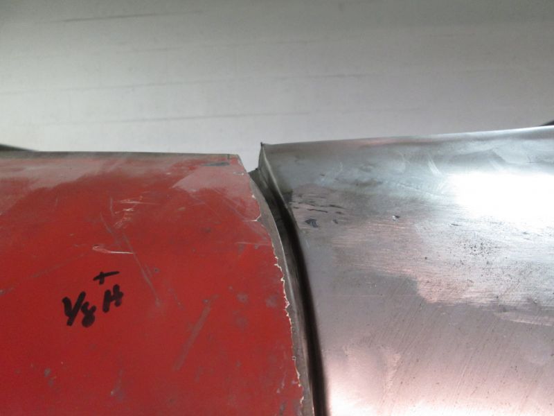

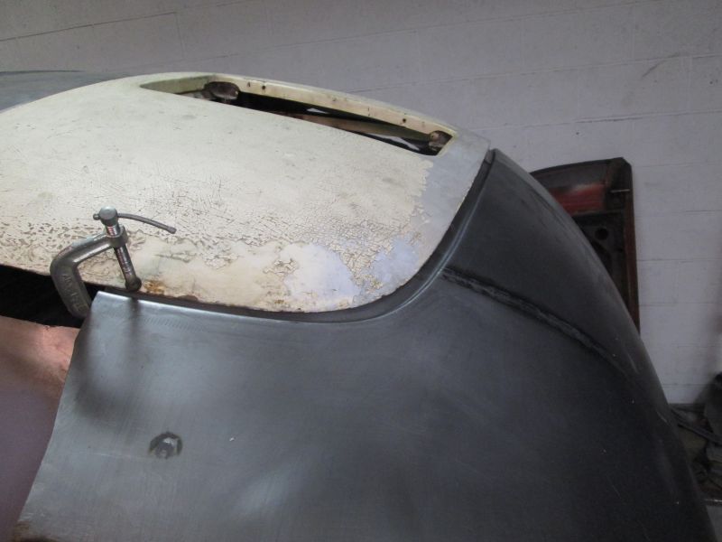

                        Next step to tighten things up more was to narrow this gap.
                        Excess metal on the flange would not allow it to slide up any closer.
                        Dismounted to trim a little off.. but not too much
                        Remounted with improvement.
                        The profile got smoother too.
                        Reminding me of an old "bathtub" more and more.
                        Tail fitment continued with further gap refining and elevation with deck lid next.

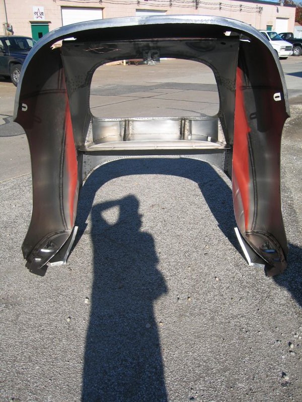

                            • No John, the difference has been night and day so far.
                              That is absolutely gorgeous!! Thanks for posting up those shots Per, I had not seen them before. The final presentation of the finished metal is amazing and is something I'd wish to aspire to one day for sure.
                              Trevor's ribbed rear inner wheel houses show that correct "bulbous" shape that my buddies original car has. Its stunning!
                              • Fantastic photo's of Trevor's panels. I also had never seen these before. Thanks for posting these.
