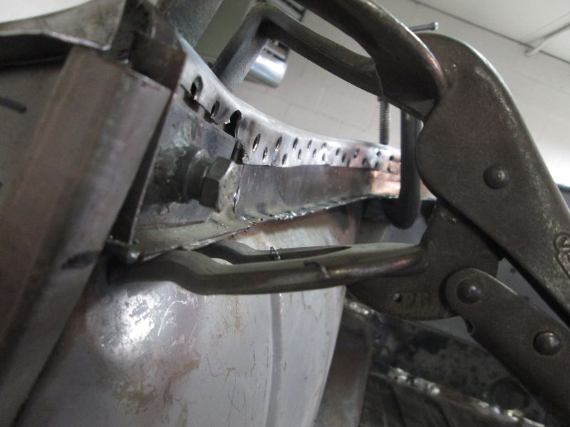

      Seam welded the lap joint where the quarter panel begins as my friends OG Speedster showed.

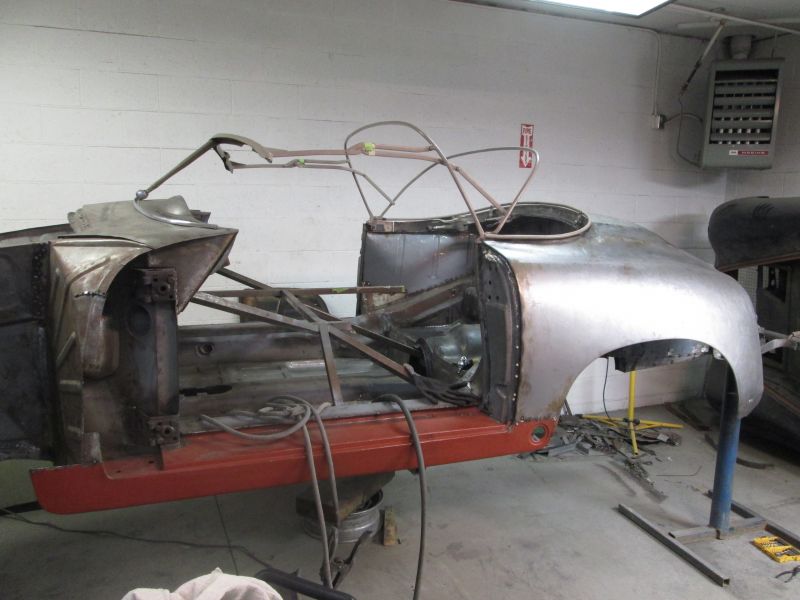

      Car looks deceptively at the same stage as a few weeks ago but with all the loose ends tied up with the cross-member, engine compartment, and now the left quarter closing metal it has changed a lot in my eyes. A lot of tedious detail shit now in the done column.
      As you can see I'm trying to finish out small areas of the car completely so to wrap up this left inner quarter I need to fabricate and install the top frame rests/hooks. I'll see if my buddy is available tomorrow so I can profile these and get them welded on before the weekend is out.

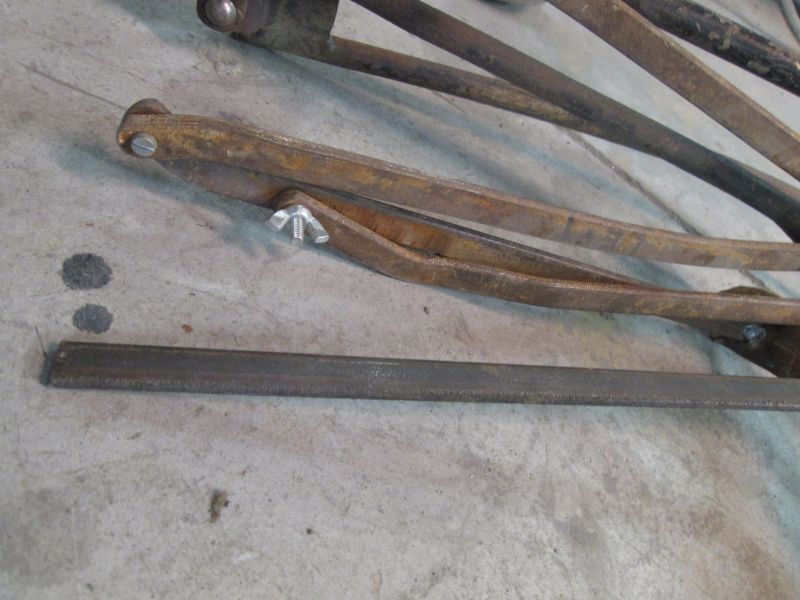

              Top frame resting hooks

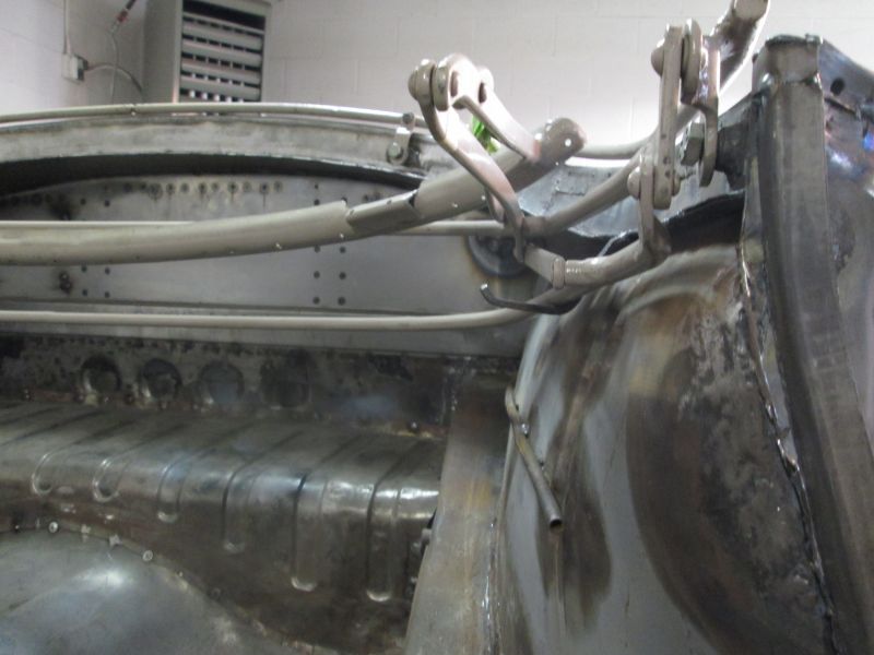

              Made it over to my buddies last Friday to have another look at his Speedster to get position measurements and a profile shape so I could get these knocked out this last weekend.
              Also made sure to take a few close detailed shots like this one to keep all the details fresh in my mind.

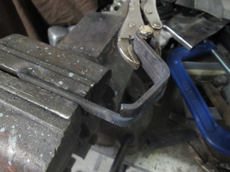

              As for material, same strap stock used for the top frame linkage. Had plenty on hand from fabricating my own several years ago.

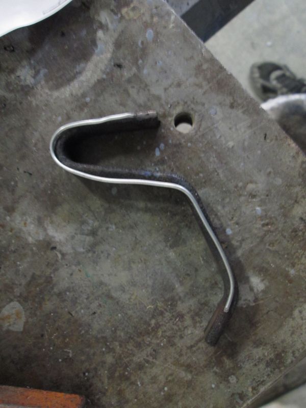

              I was a bit out of practice in timing the bends but it eventually got there.
              Close enough to my crude profile shape off the original. Now it just had to be tweaked and trimmed to fit in the car properly.

              Once I had a usable profile this part was pretty rough with tool marks so I decided to keep this one as my future template. Pigtail end still needs trimming and relaxing here.
              Sample part trimmed and finished. After all that it still closely contours with the my wire sample I profiled off of the original hook.

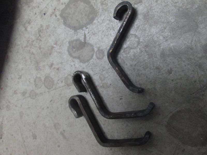

              So with that test run under my belt my final two attempts went a lot smoother and quicker.

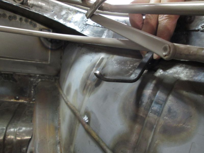

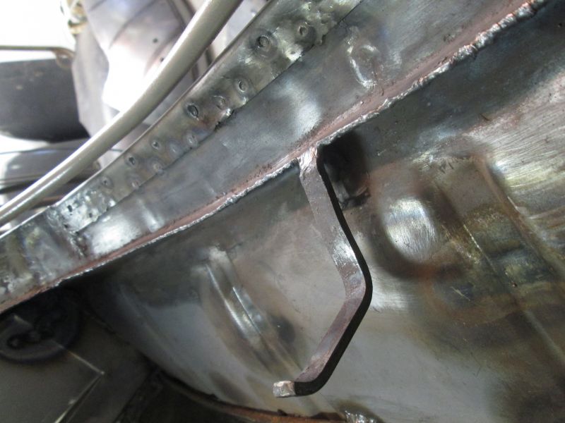

              Tacked into final position and double checking the a folded top frame.

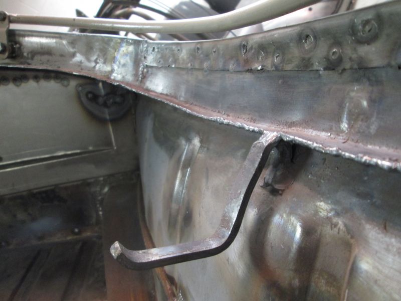

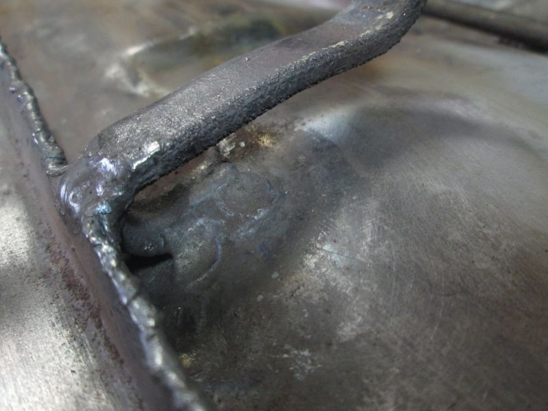

              Fully welded in. I noted on the OG speedster that the leading edge of the flange was fused together up to about where the quarter panel overlap ends. It was then left raw as it continued to the cowl.
              Replicated most of that here.
              It works.

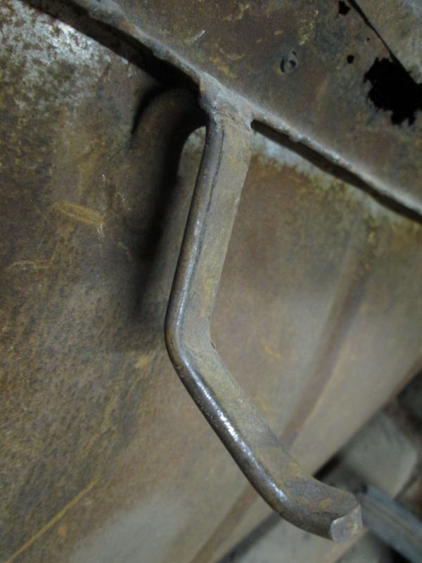

              • Justin, thx 4 sharing a untouched and molested hook......
                I guess most hooks get cut off and by so is misses some of its tail part when getting welded back!
                As the one in my photo.... I didnt see it before it was cut off
                Gressel HB20 is a very good tool when needed to do precision part with various bends and angles.
                I have one but borrowed some photos to show you how it looks like.
                /JOP
                Look about 2:40 min into video clip

                • That is a nice piece of equipment to have around and sure beats the hell out of making small brackets by hand. What does that unit run?

                  I can understand an original hook being cut short if removed from a car. The meld was so hot and thorough that you'd either have to cut the wall or cut it short as your OG hook shows. I tried to replicate that attachment detail as well.

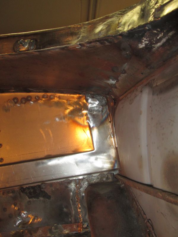

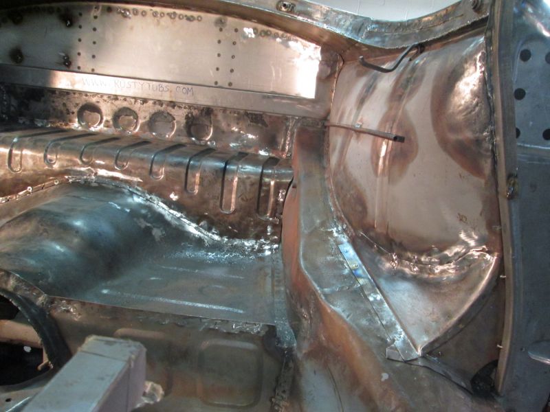

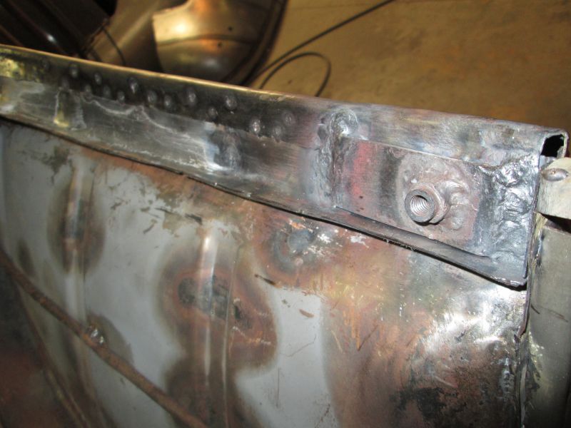

                  Spent this afternoon finishing out rosette weld heads and attaching the parcel shelf in this corner. Been putting this chore off for over a year so you get and idea of how resistant I was to work on it.
                  By sessions end all welding and dress details finished completely in this corner; all the way up to the body skin. Felt good to just type that BTW. As you can see I didn't finish welding the right side of the shelf. That's what a PIA it is as its super thin gauge (21 or 22) and blows out very easily. I'll finish that when I do the entire right side.
                  Lap joints and corner details mimic the OG speedster well enough as I know they all must differ slightly.

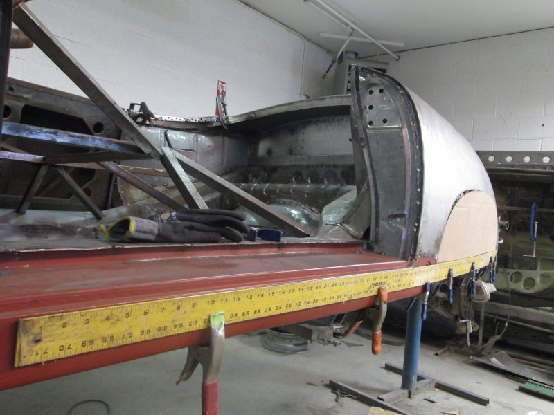

                      Right rear quarter panel installation.
                      Tying up all those loose ends in the engine compartment and rear seat area now frees my mind up to get back on body panels.
                      I'll be putting the ass end back on the stand to install the quarter panel but while I was still free to turn the car on its side I finished attaching the cowl.

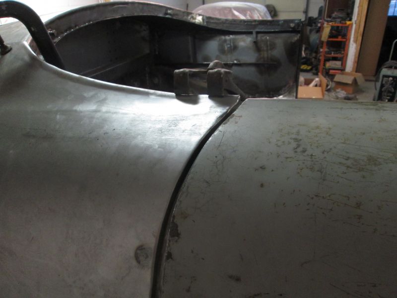

                      My initial assessment of this panel when I first mounted it a few weeks back was that it would need a lot more work than the other side to fit correctly but as I've worked with it more this afternoon I'm realizing that I misjudged it and that its only off badly in one aspect in particular. What can I say, just have to chalk it up to my inexperience.

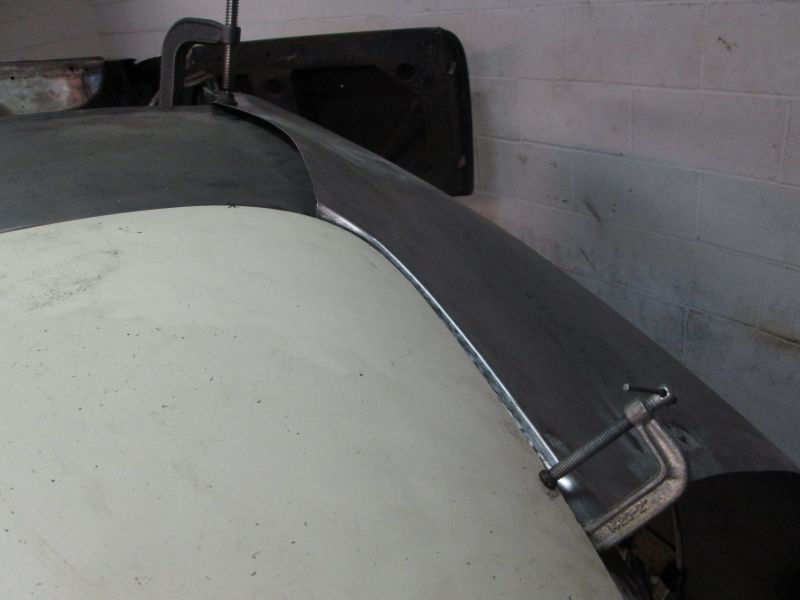

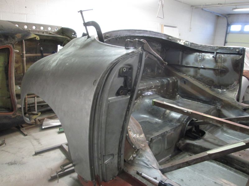

                      Fast forward to this afternoon with the panel remounted for final fitment.

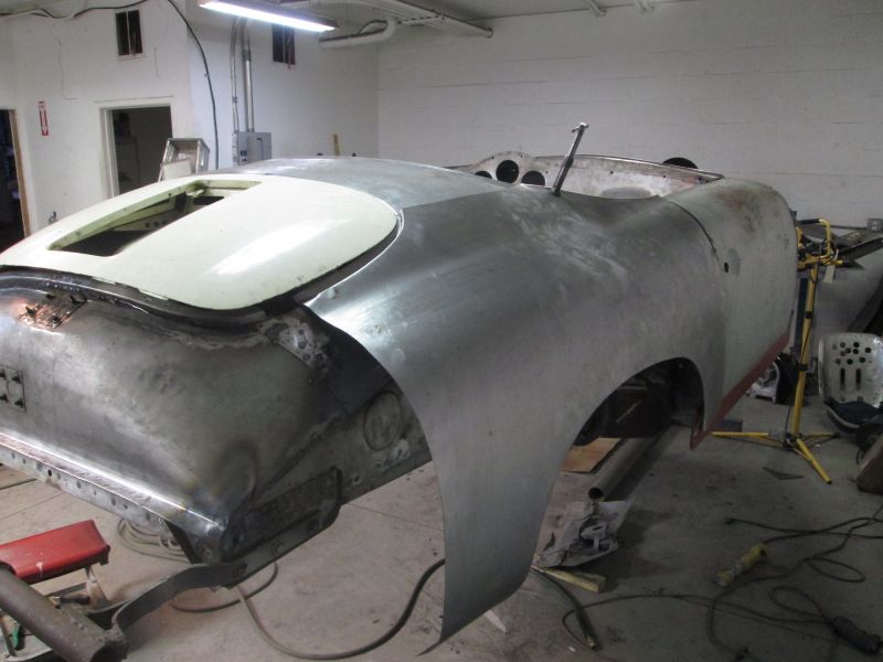

                      By sessions end this was my best average initial fit.
                      Top of panel with top of door a little tall but close.

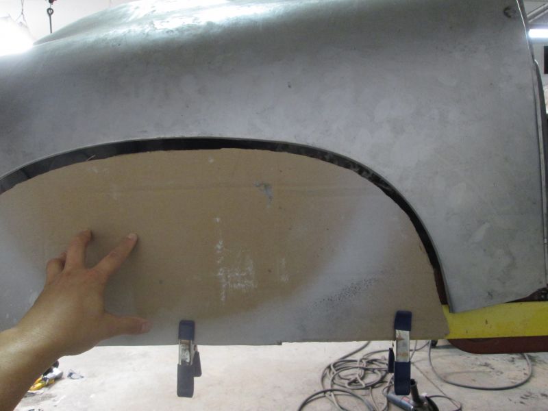

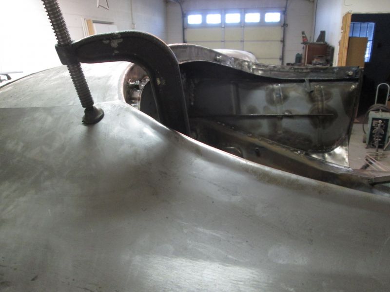

                      Deck lid opening a bit out and swings wide but I'm thinking I might be able to manipulate that in better.
                      Wheel arch also very close with the rocker on the long side this time around.
                      Just like with fitting the other fender a lot all going on at once. So with all those other "planets" slowly aligning my leading edge is tapering back as it makes its way down. Its not even close.
                      At first I was thinking maybe it was out elsewhere but once I brought the leading edge up into alignment with the door with the flange interlocked into the striker like it should the rolled wired edge of the fender well was encroaching into the body plug hole. It was confirmed, the leading edge was rolled in just a few degrees off kilter. I'll have to cut it and add in a sliver filler strip here.

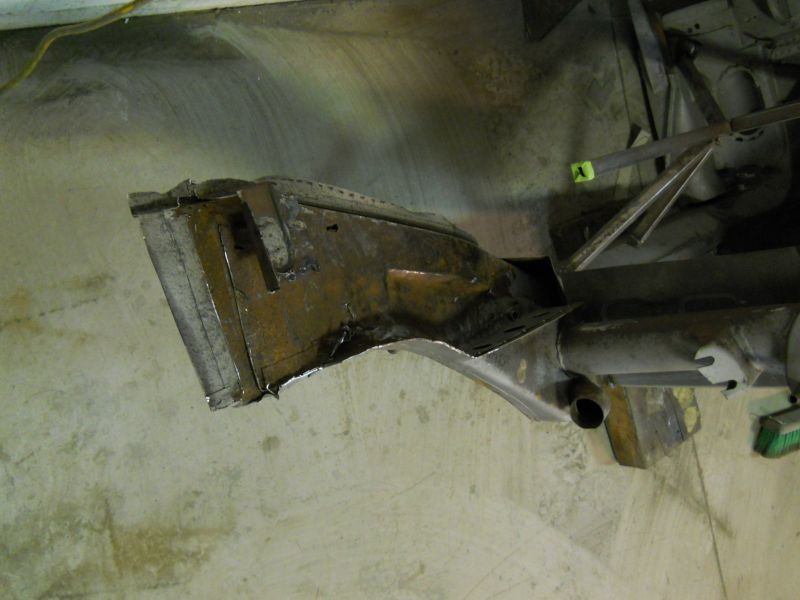

                        Rear fender braces.

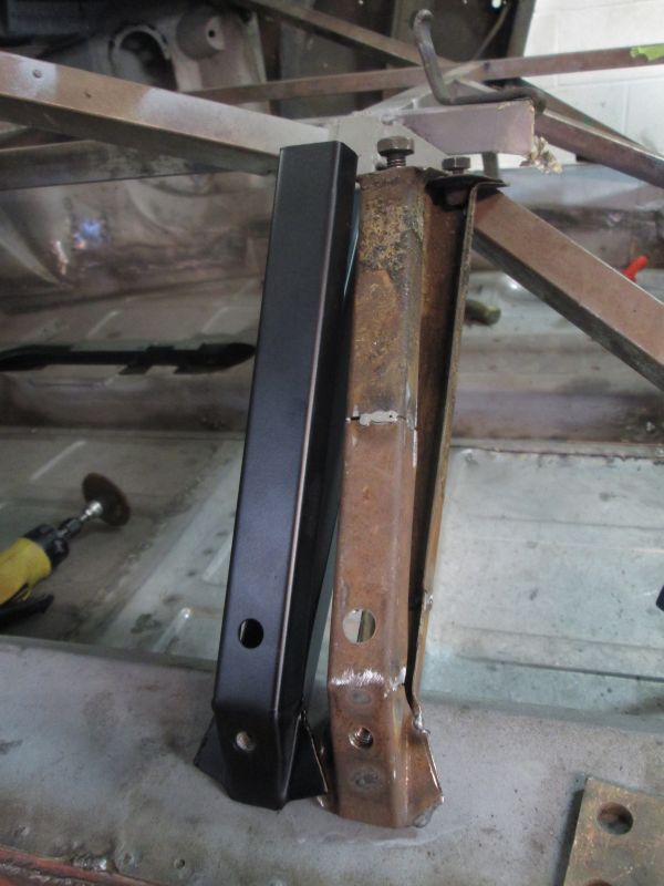

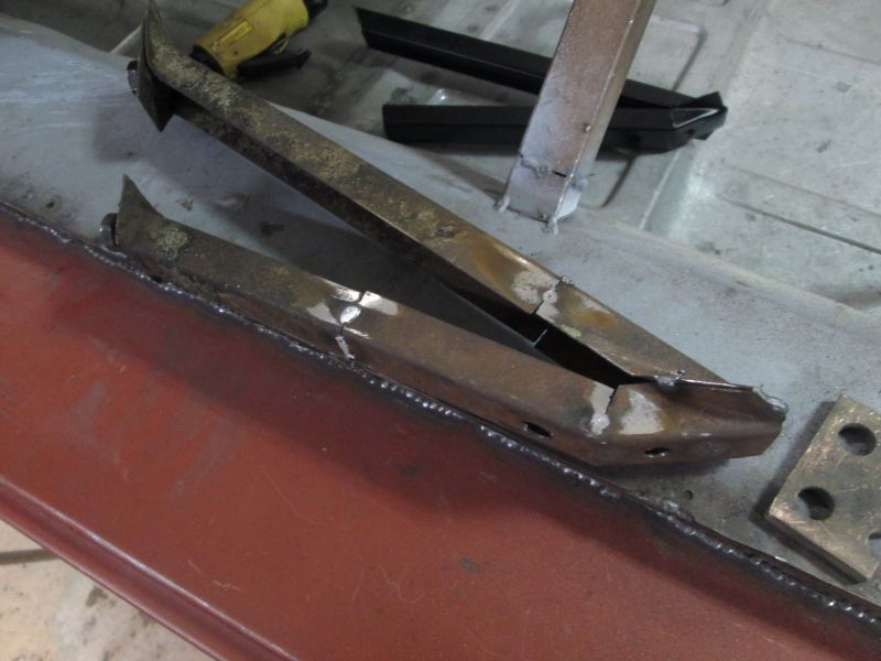

                        In prep for mounting the right rear fender now was as good a time as any to finish and mount the rear braces.
                        Matching new and original as closely as possible for length and angle.
                        close enough...
                        The brace is now set but I'm holding off committing on the tang until the tail skin is set.
                        trimming for length and mount angle with the OG brace.

                        Brace positioned according the left side and a cross check with the OG right brace on my coupe.
                        Ready to weld.
                        It will be nice to have the brace in first to help with fender fitment but its also a lot easier to weld it on without that panel in the way.

                        • 5/16/16
                          Continue fitting the right rear fender. Checking for wheel well opening consistency from left to right.
                          Wasn't sure how I was going to approach cross checking them at first. Measure off the floor? Finally settled on clamping my straight edge to the car with a cardboard template. Straight edge was mounted level and even with the rockers door edge opening creating my baseline.
                          Template was traced, cut to shape then clamped back into place. It was now time to mount this over on the other side to see how off they are at the moment.
                          Straight edge was flipped over and mounted in the same location on the right rocker. Much to my great relief and surprise they are pretty damned close!
                          This side is higher and at its widest its better than a half-inch.
                          ...or about 15mm for JOP. Another confirmation too was that openings are very even in relation to one another.
                          I'm thinking once I get more of this excess removed and trimmed out the this fender should settle down a bit more tightening up this variance between these two sides. Thinking back to the inconsistencies Jack described finding on OG B&C cars from left to right I have to believe these openings also varied a bit from side to side originally. I hope this is within tolerance other more nip and tucking required.
                          • Morgen Builder-Justin,
                            That was a nice metod and accurate way of checking the openings
                            It is also very cheap and I guess all guys have acces to cardboard and a looooong ruler.
                            To many 356 are done with diffrent shapes on left and right sides.....
                            I also have done templets and taken alot of photos with measuring tape in them to get some info where to get the right settings. Ofcourse taken on a good original 356.
                            Thx 4 sharing a new way
                            /JOP
