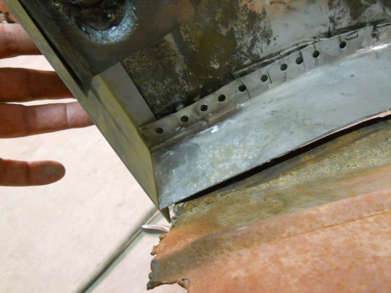

    Hey Phil, I must have missed that question on your thread; glad you got an answer just the same. Without access to the inner face of the wall its going to be tough to detect any severe rot short of just removing the stop plate for an inspection. I suppose you could ream the channel see what comes loose and what if anything is packed in there. This frame is a perfect example of how nice a frame can look from the outside but what lies beneath is another matter. I know what you mean about explaining to family and friends as to why a restoration is taking so damn long. I am 25 years behind schedule on that old coupe of mine.

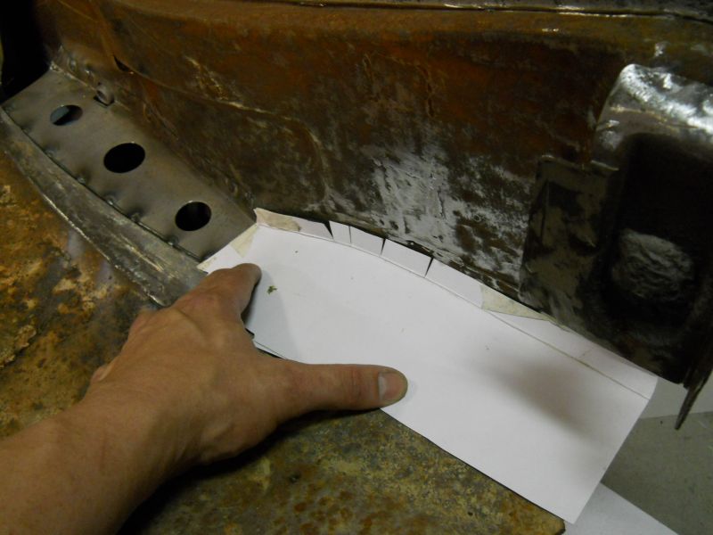

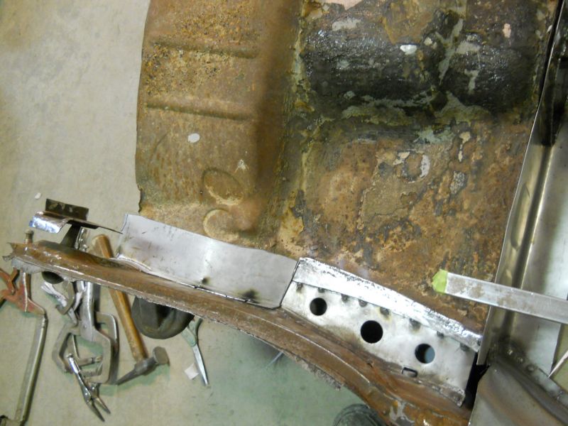

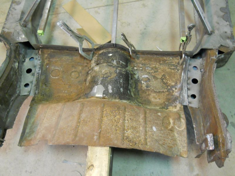

            • 3/18/14
              Seat pan prep continued.

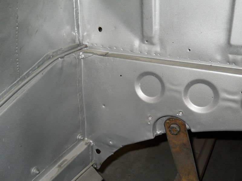

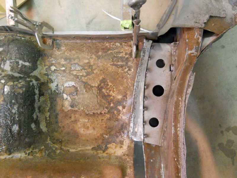

              Last of the forward filler strips welded and dressed

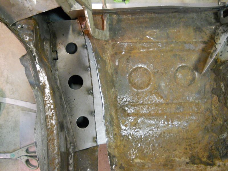

              test fit. All ready for the final seam weld when the time comes to put this pan in for good.
              Ready for the rear portions of this repair/ install
              templating begins. Thanks for looking! Justin

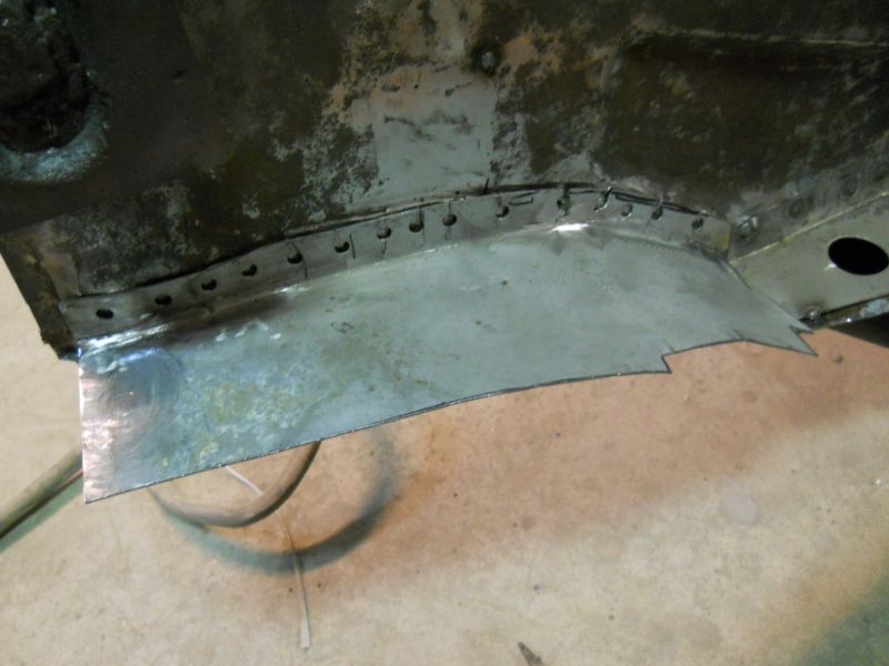

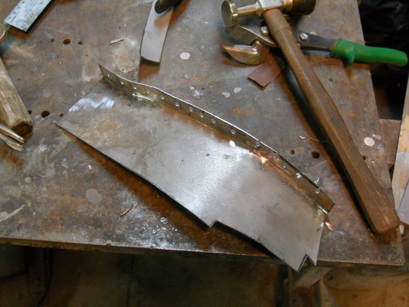

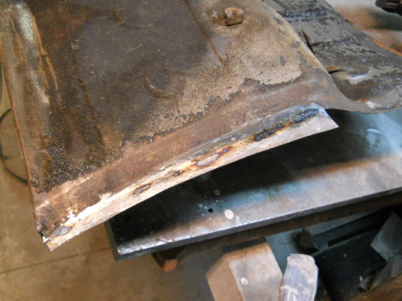

              • 3/20/14
                left rearward seat pan repair section formed.
                Template now fills all the holes and is in final form. Ready to go onto metal.

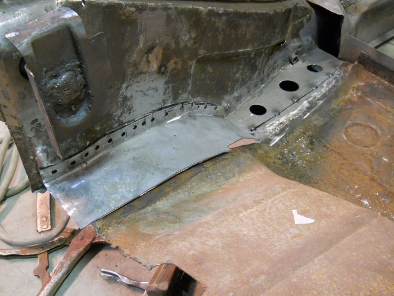

                new metal replacement section complete. A few relief cuts in the flange to achieve the right profile and two slices required to "jog" the flange so it hugs the profile of the wall embossments.
                Test fit. went on almost as well as the paper template.

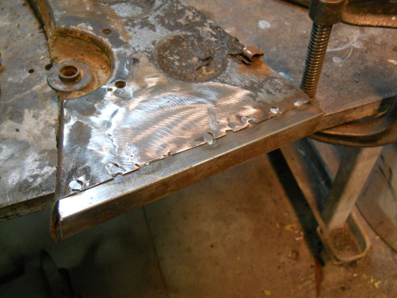

                • 3/21/14
                  donor seat pan repair panels complete.
                  right side now in metal
                  Same contouring required on this flange for a flush fit against the wall.

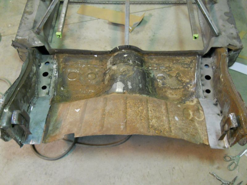

                  All ready to begin welding BUT it cannot go in just yet. New X-member prep and repair up next. Thanks for looking! Justin
                  • 2/24/14
                    Cross-member prep and repair.

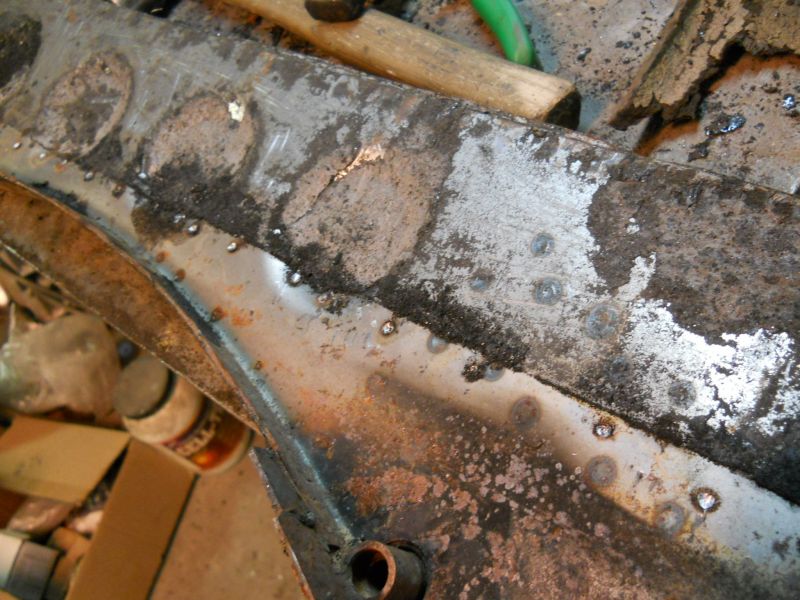

                    Cross-member prep began by removing the mount flange strip of the old parcel shelf.
                    Now gone with lots of factory fresh metal. So much nicer than the original one.

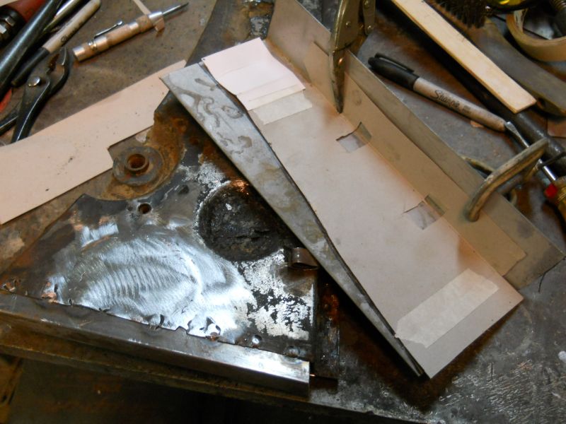

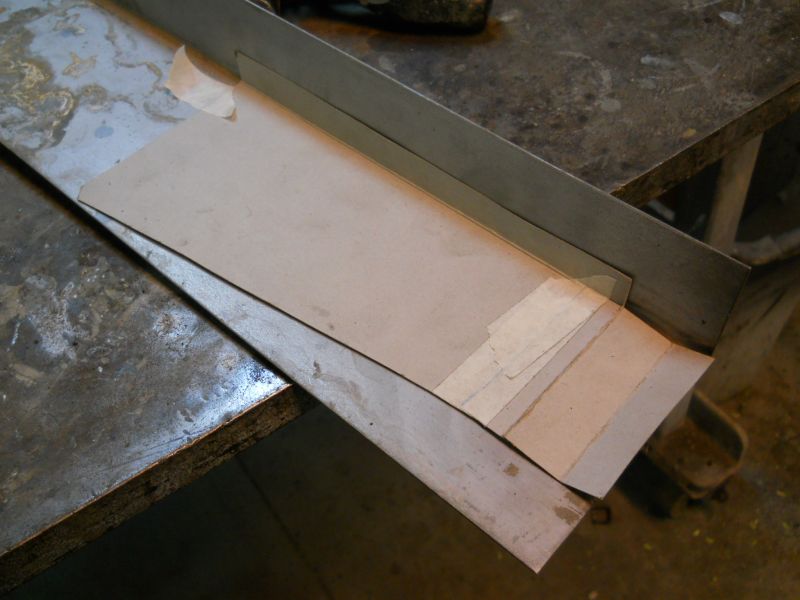

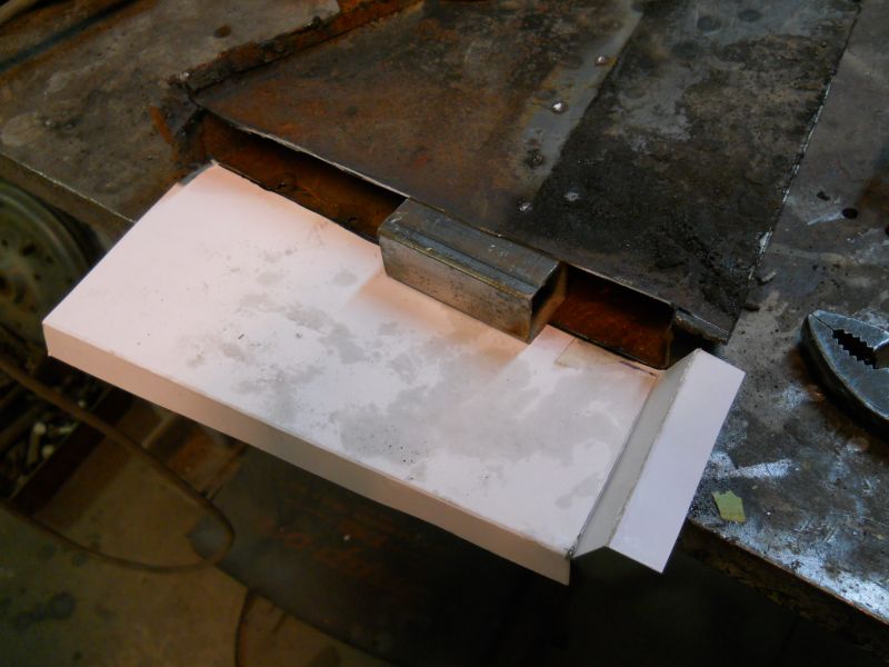

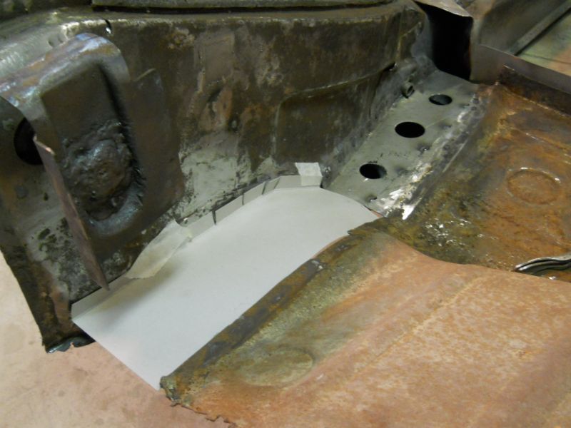

                    The new donor was cut well short of its original length at its flanges so I'll be templating the new sections from my coupe.
                    Template just about complete but I'm a touch short at the bottom. I would be at a loss for correct detail without a reference car!
                    Just about ready to cut it out of metal. This extra length perimeter section was the perfect width for this particular repair. What I also like about this piece is that its made from heavier 18 gauge sheet.

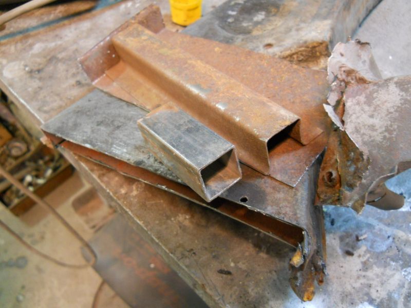

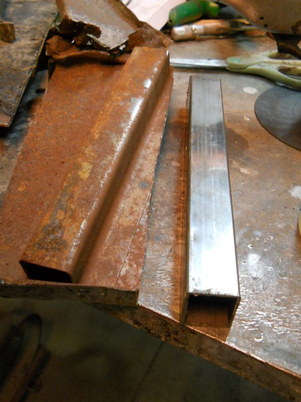

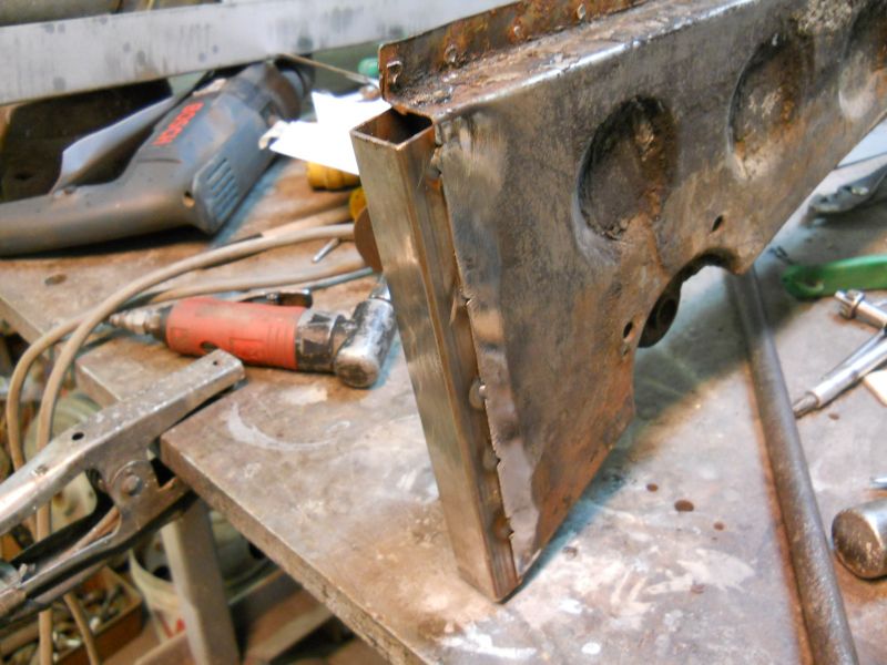

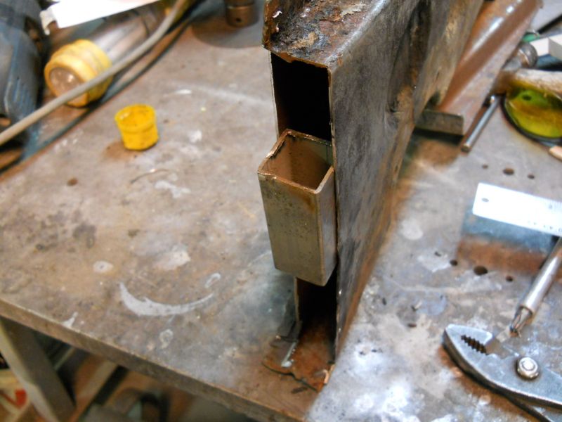

                    While experimenting I found that this 1X1 inch square stock fit beautifully between the two pieces that comprise this member.
                    This square stock will make for the perfect structural stand-in for the factory reinforcement which was found angle mounted on both sides. Being an actual tube made from heavier gauge metal will provide far more integrity over that original sheetmetal version.

                    • Justin,
                      Great sequence of photo's and method of doing it. Cardboard templates and being able reverse them like you did on the carrera makes life easier and that square stock tubing must have made you really happy.
                      Its great when you can see a lot of time saving like that.
                      • Thanks Roy! Yes, every little bit helps in the way to save a little time and effort. That square stock was a natural fit in deed! Like I said every once in a while I get lucky. Thanks again Roy!

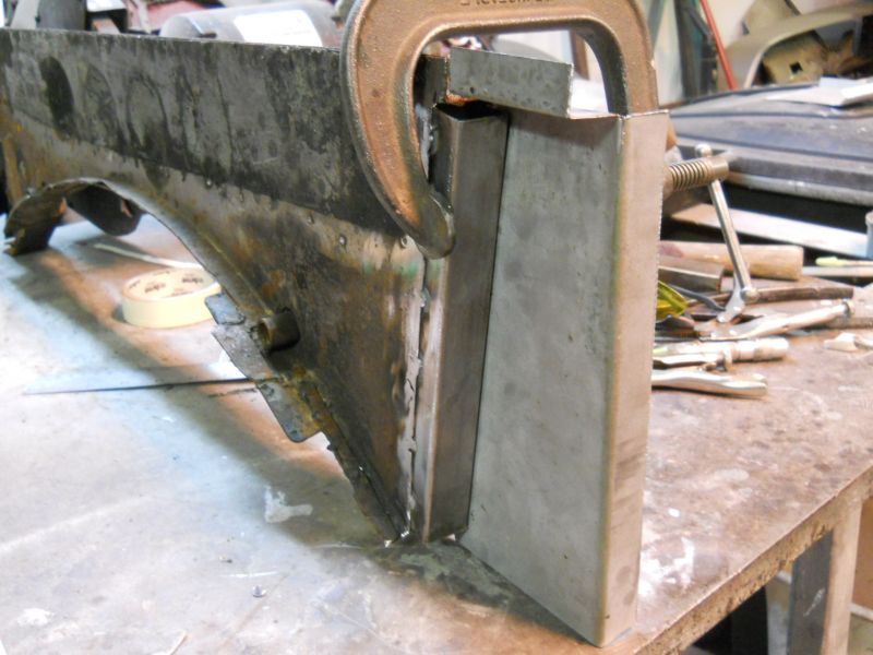

                        2/26/14

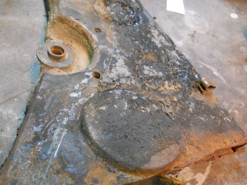

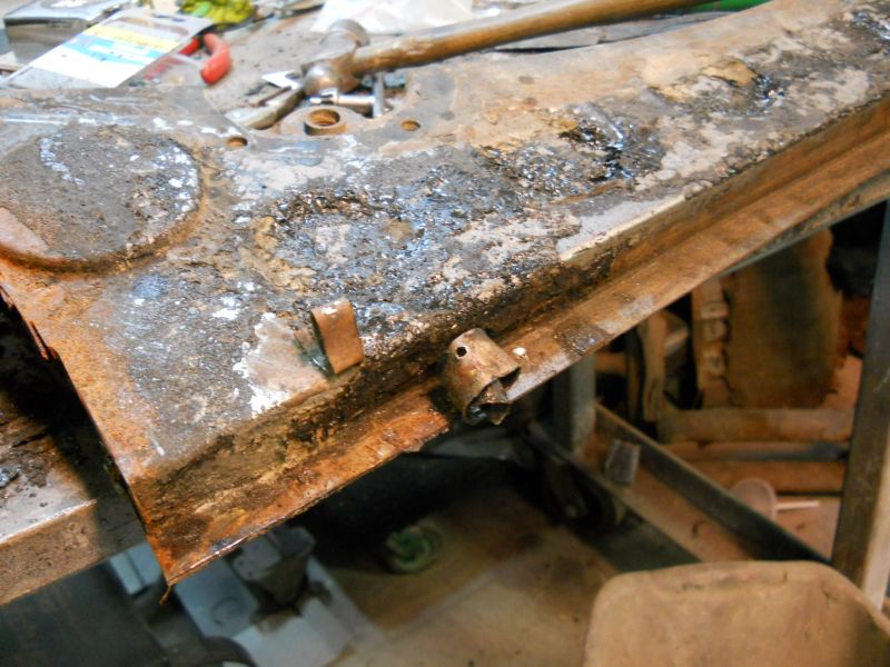

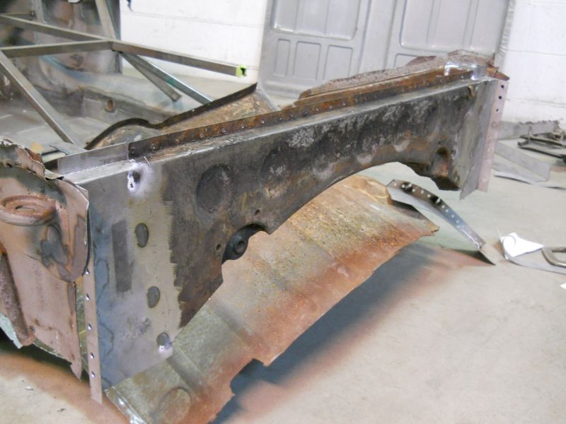

                        Right side of cross-member:

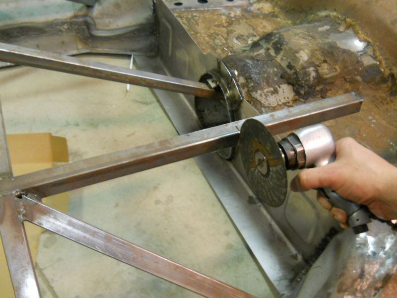

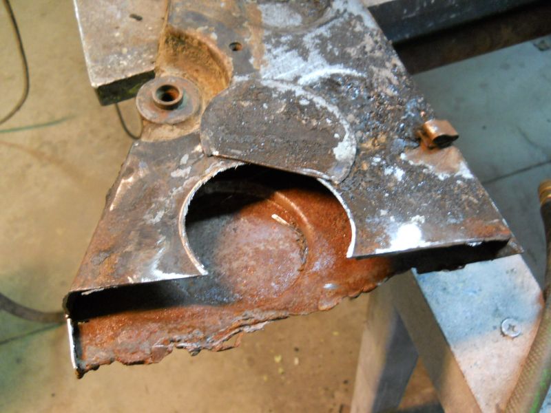

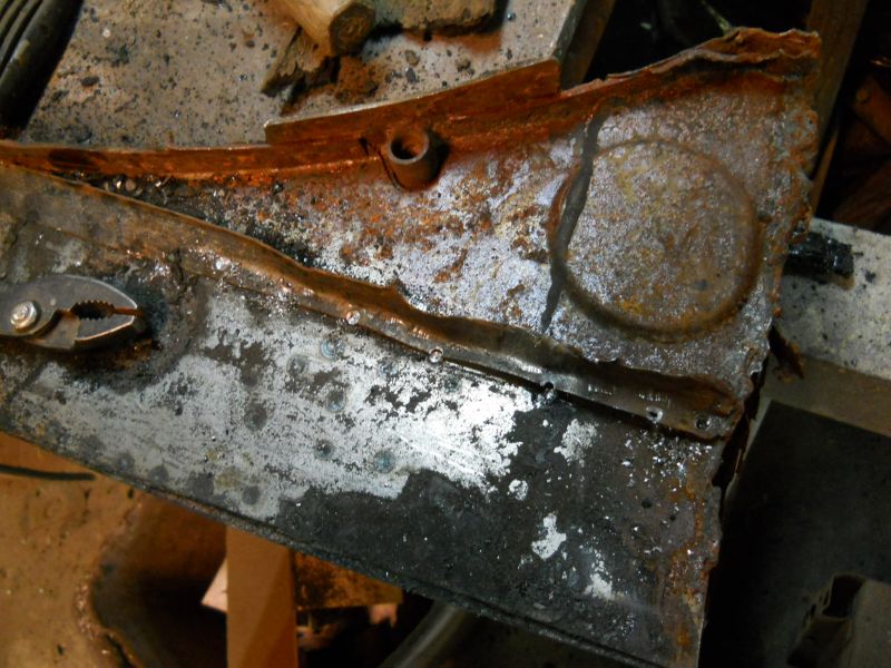

                        Embossment knock-out for the optional Gas heater and its ducting had to be leveled for both a snug fit against the square stock and for a accurate T1 structural detail.
                        Zipped it off right across the step flange.
                        Stepped shoulder was ground off and the original piece was welded back in. Reinforcement now welded into position here.

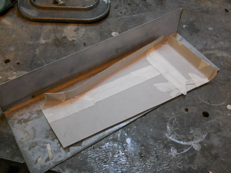

                        Replacement flange template with "locating" tabs in position here. Ready to trim to final size.
                        Template complete and ready once again to go onto metal.

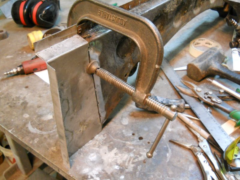

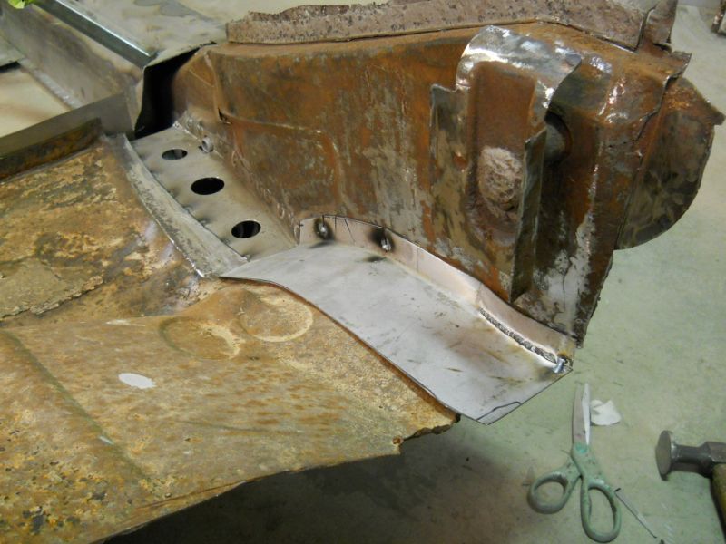

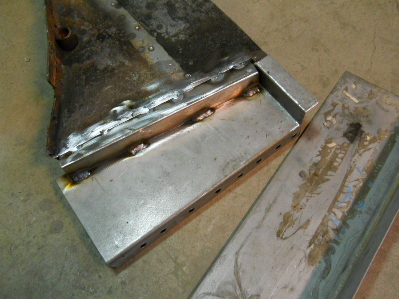

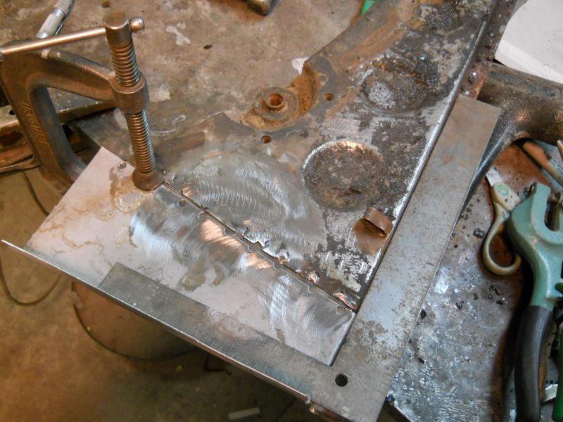

                        • 3/27/14
                          Front repair flanges for new Cross member complete.
                          new section trimmed and now ready to tack on here. I put my square on it first to make sure the new flange is at 90 degrees with the rest of the part.
                          Both sides now finished and dressed smooth.
                          Starting the inner flange sections tomorrow. Thanks for looking! Justin

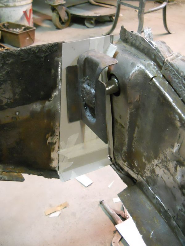

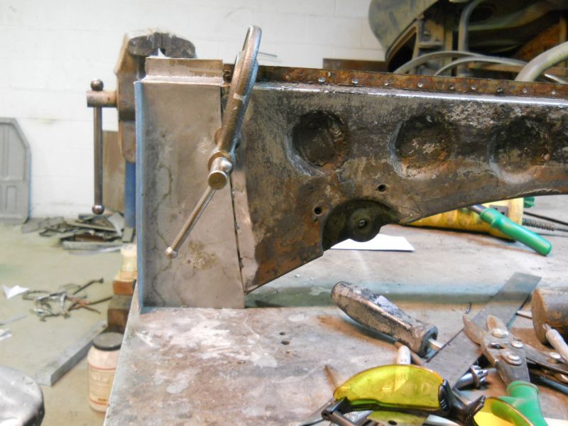

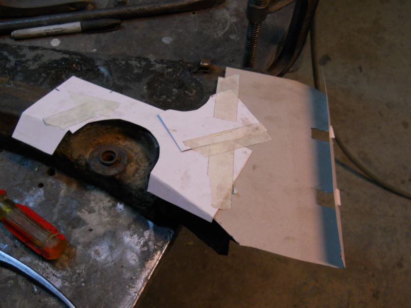

                          • 3/28/14

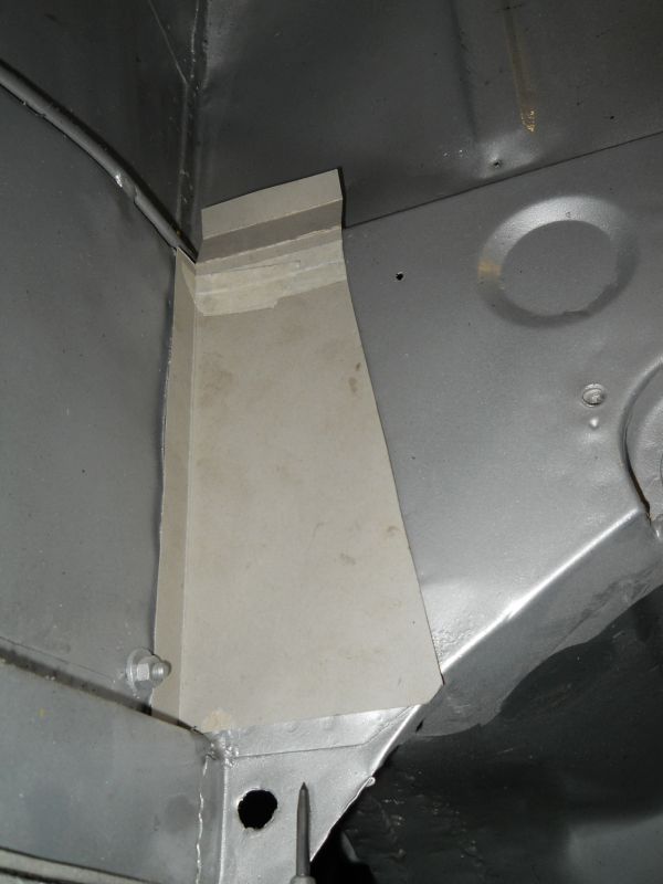

                            template for left side inner cross member panel.

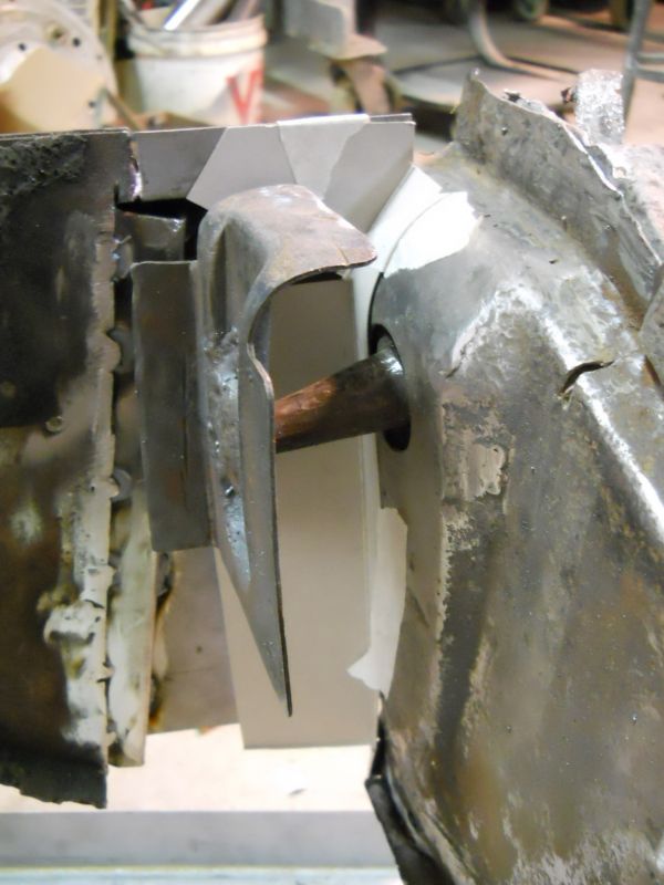

                            New cross member was clamped into position so paper modeling could begin

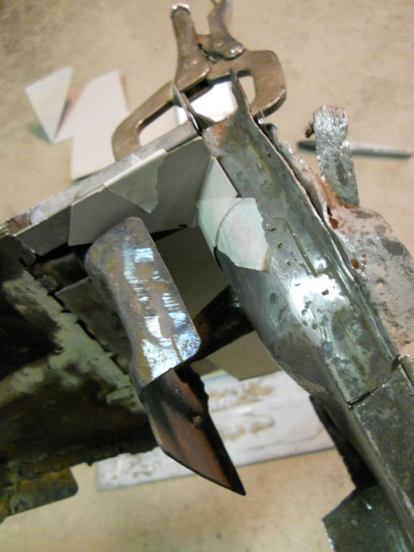

                            The outer flanged half of this template just about complete here. Due to the shock mount embossment this flange is not set at 90 degrees in relation to the cross member like the outers and it also has a kick at the top. Needless to say the only way of getting an accurate copy was to build it stages right on the frame.
                            After several generations of cut, tape and splice I finally had representation of the part I now need to make.
                            Moving onto steel tomorrow. Thanks for looking! Justin
