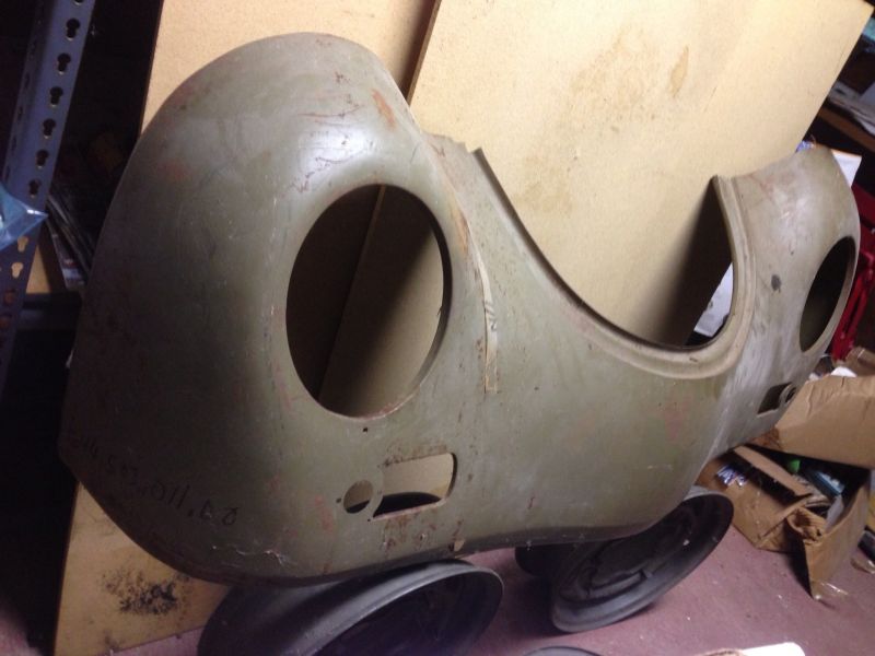

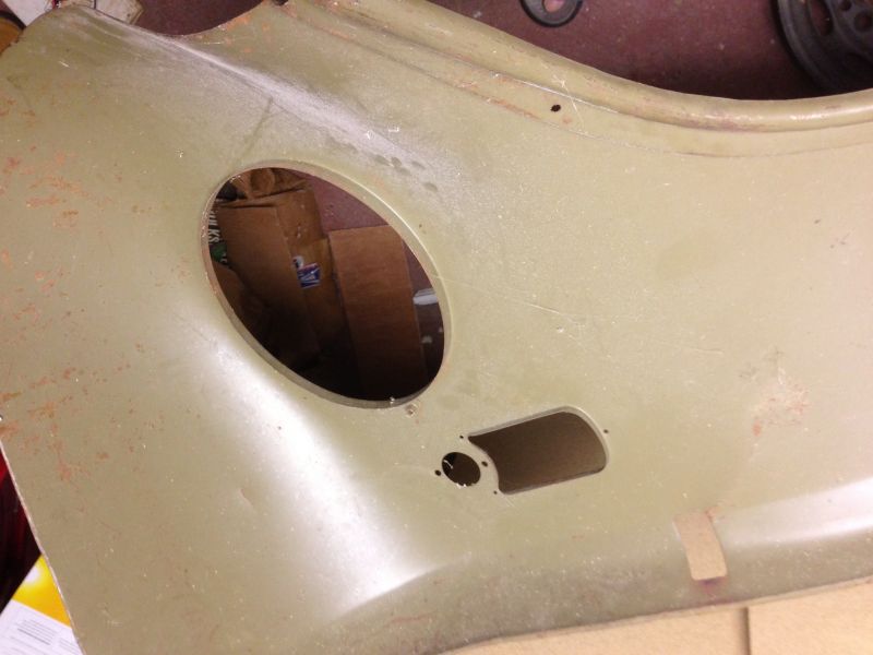

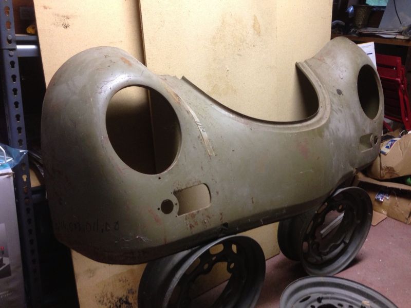

      The pics of the NOS noses is great. I see ours, third one from the top of the stack.
      NOS wheels do a nice job supporting the nose.

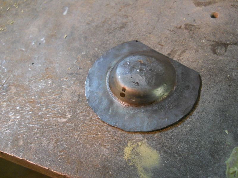

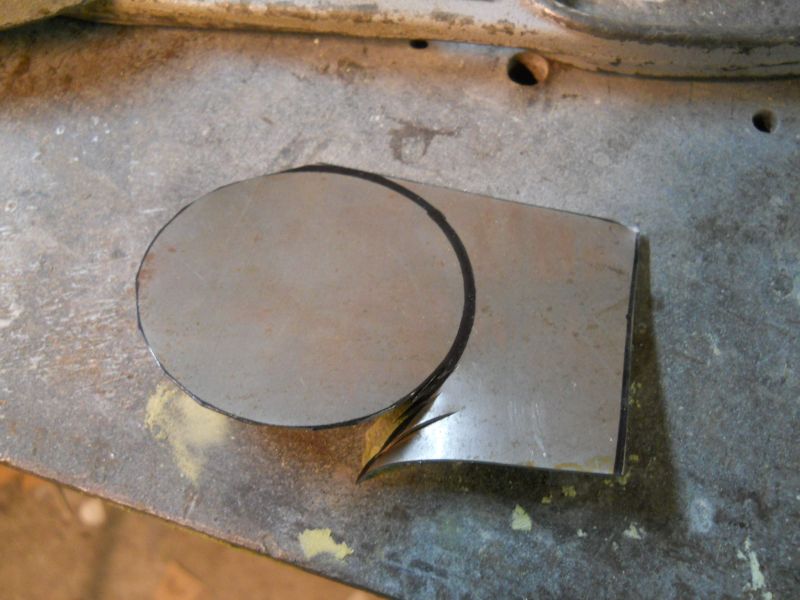

        Like my coupe project before I'm adding the drain hole cover detail to this car. Cutting out my blank here. This is about my 8th one so it comes to life alot quicker than my earlier attempts.
        Basic part now complete; just have to add the hole.

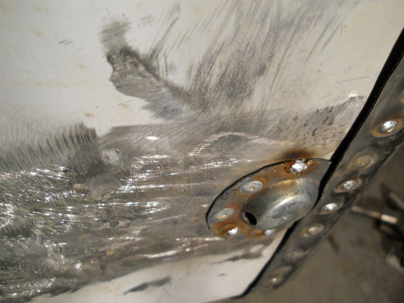

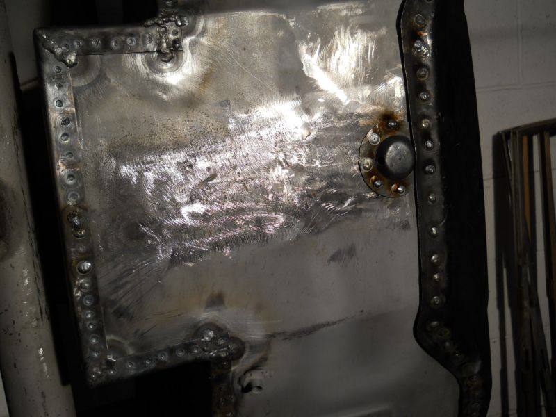

        Hole was drilled both in the floor and this new cap. Plug-welded and in position tight against the flange as was done originally.
        Grinding down plug-weld heads now Thanks for stopping by! Justin

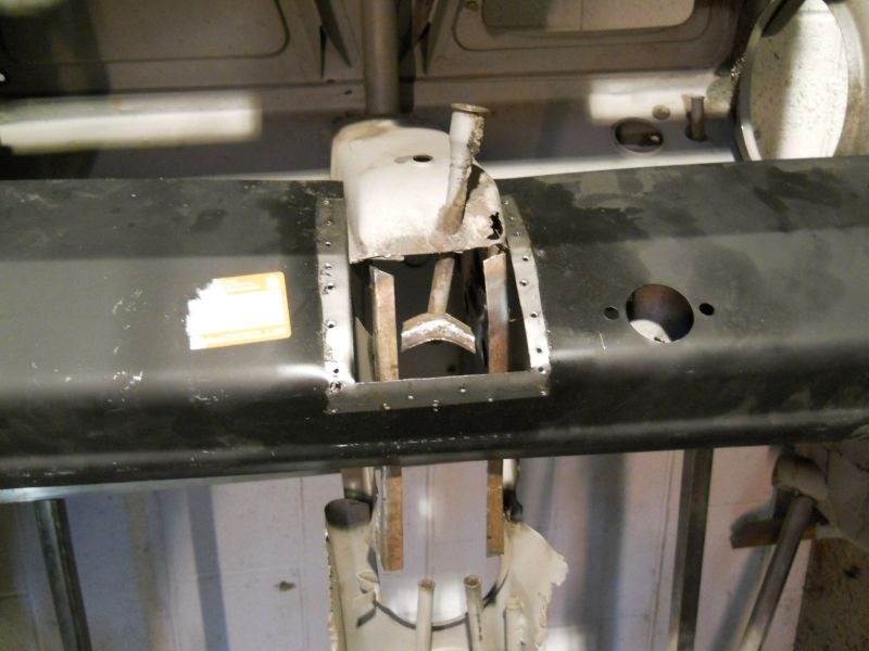

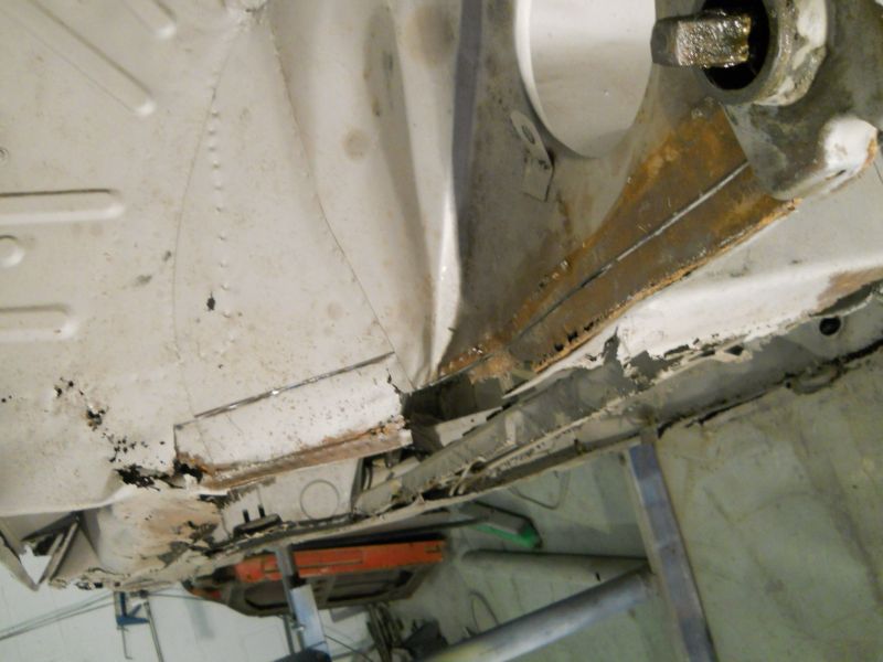

          Other than some minor cosmetic welding, the battery box is finally a set unit. With that I began to address the lower perimeter of the chassis.

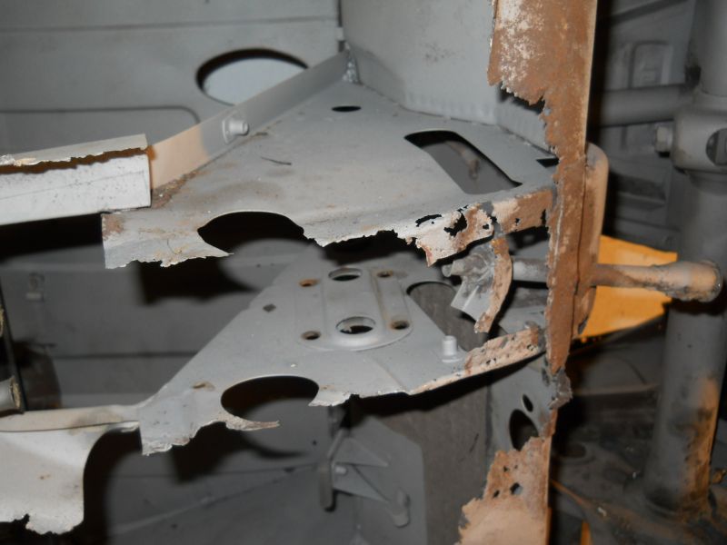

          Began with the most foward section of the frame right where I had removed the reinforcement strut earlier. The final cut line was a balance to get past the rotted and pitted areas while still remaining under any embossment detials.

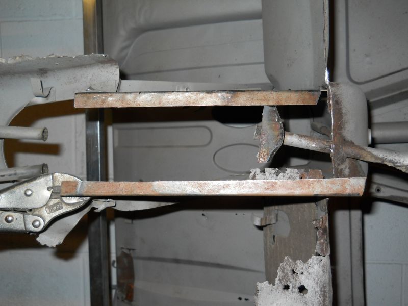

          Most of it cut free here. I also established an initial cut on the splash pan to get it up and out of my way.
          Inital cuts complete. Amazing how instantaniously the outlook improves once the cancered out sections are removed.

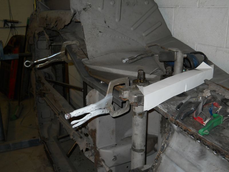

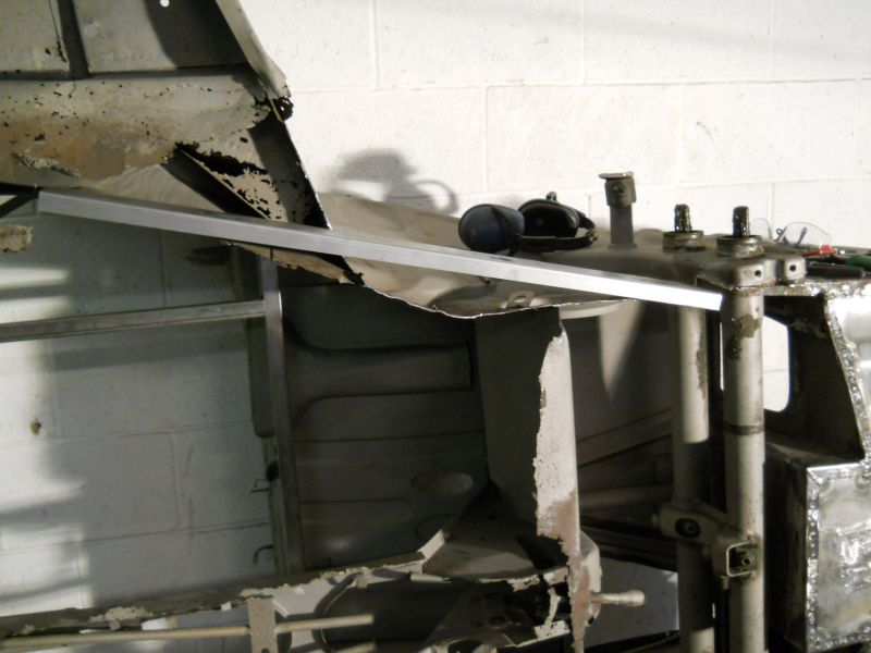

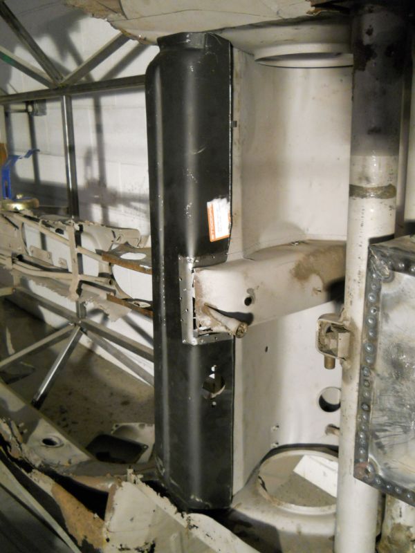

                    Began shaping the new lower frontal flange for the frame runner. As it progressed I soon realized that now would be the best time to repair the lower toe-board bulk-head wall since it is sort of layered under or inside the frame flanges.
                    With that in mind I started planning on where to make the cut.

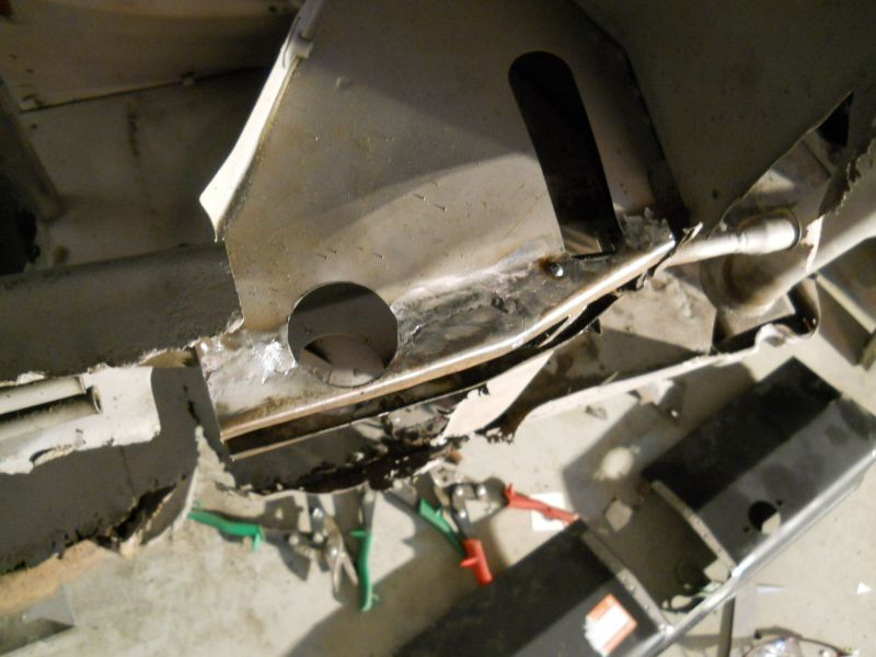

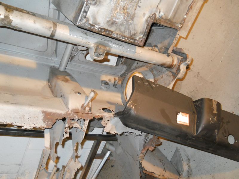

                    As I was planning this repair it became appearent that the lower flange mounts for the diagonal forward tunnel braces should be repaired before any of the other two repairs I was working on. The parking brake tube mount flange will also need to be fix first. This is the tricky thing about these cars. Do one repair slightly out of order and you make the other repairs harder and more painful than they need to be.

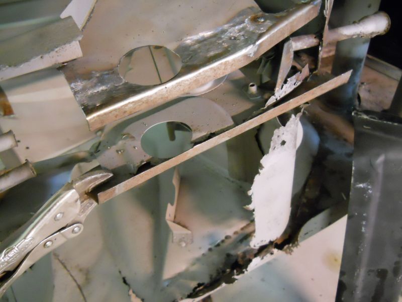

                    Started with a paper template then flanged a piece of 20 guage and got a rough basic part pictured here.
                    Getting the punched hole details in now and deciding on where I'll make the break to join them. Continuing on tomorrow. Thanks for stopping by! Justin

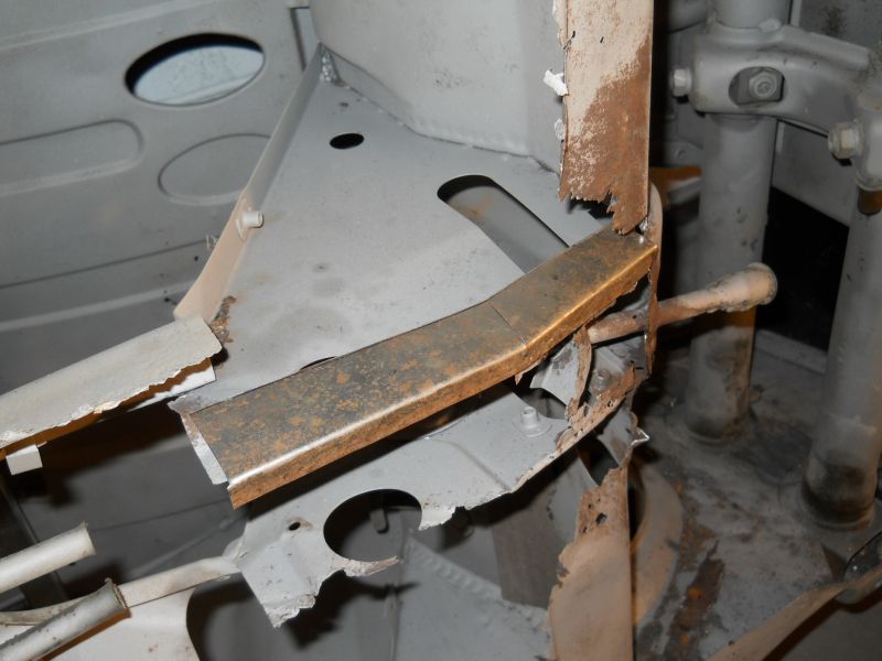

                                forward Tunnel flange repairs completed.

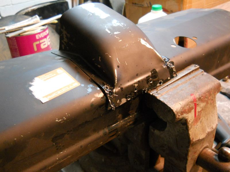

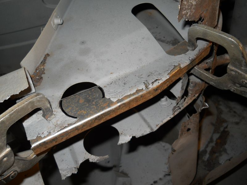

                                Right side mount flange repair along with the parking brake mount flange completed. Addressing the left side here. Slightly more involved than the right due to that embossment around the knock-out hole. Just have to peck that relief in my repair part. It is these tiny hidden repairs that can really grind on your patience. Its much more fun to install the big stuff.
                                Fresh metal does change the outlook quickly.

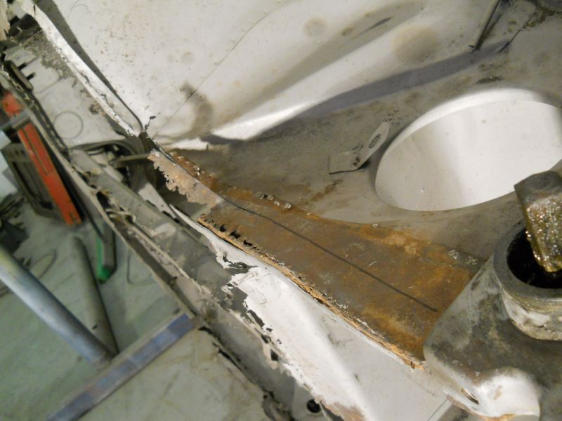

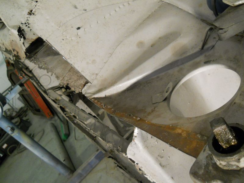

                                With that complete I was now ready for the front Bulk head wall repair panel. Decided to save the entire pocket on the frame so I am drilling spot-welds here to remove this one.
                                Very rough inital trial fitments now.
                                Slow and fine trimming to both frame and this new panel are creating the fitment needed. Maybe I can actually get it tacked in there tomorrow; Would be nice.
