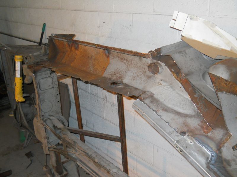

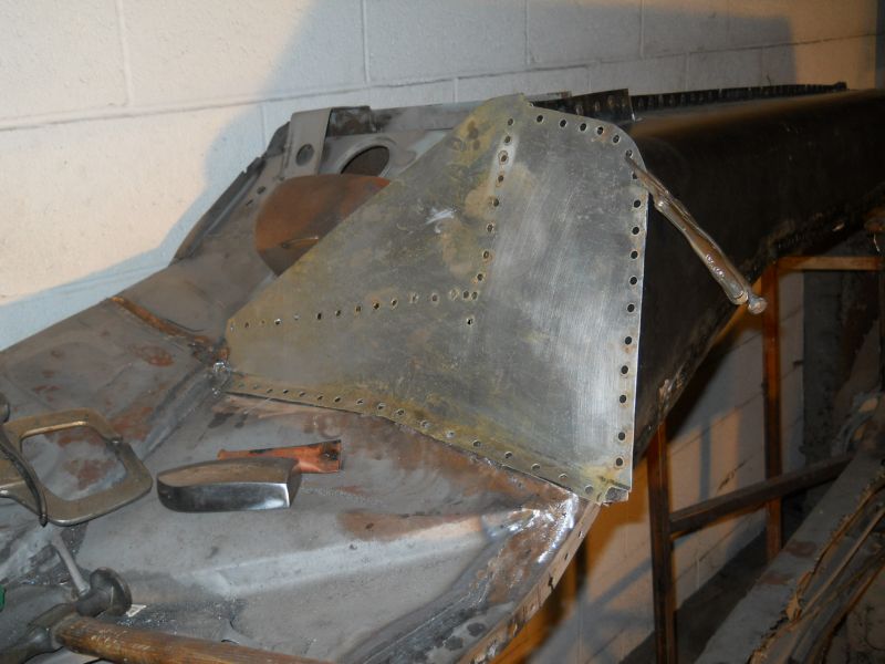

    Left longitudinal ready to be recovered.

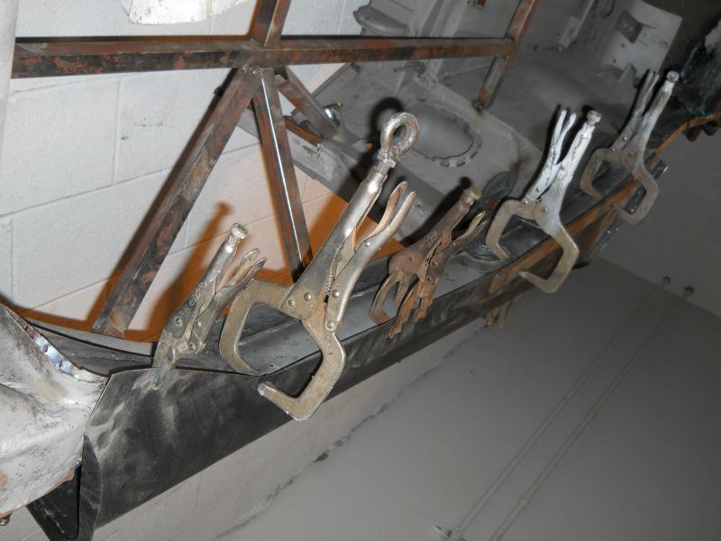

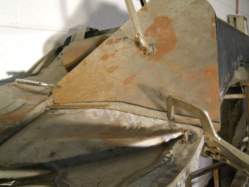

    With that bit of welding done new closing panel trial fitments began.
    A few refits, fine trimming and re-clamping were of course required.

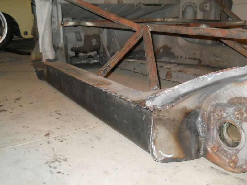

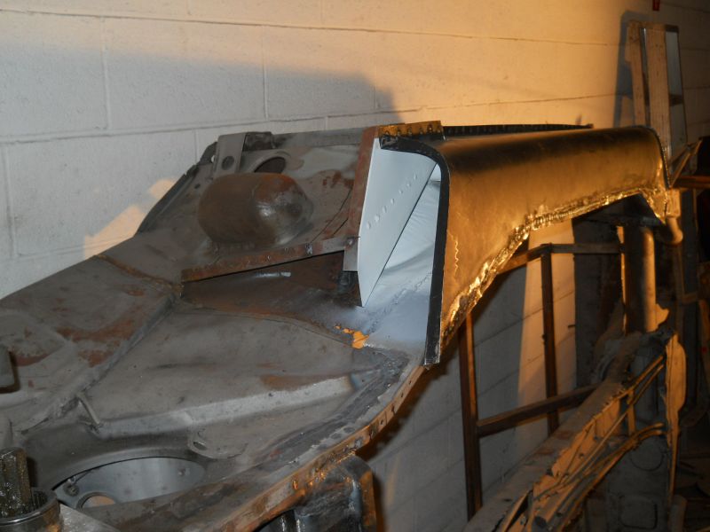

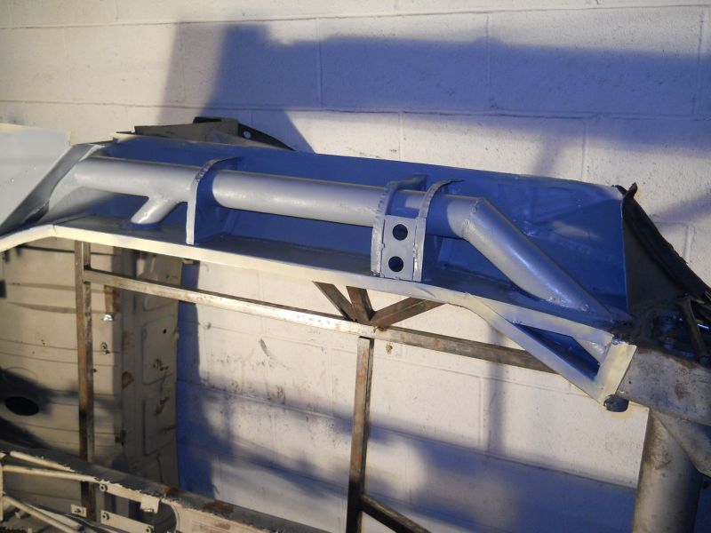

    Part of the adjustment phase was making sure all three of these mount flanges were aligned close enough to allow for a good fit of the eventual face panel.

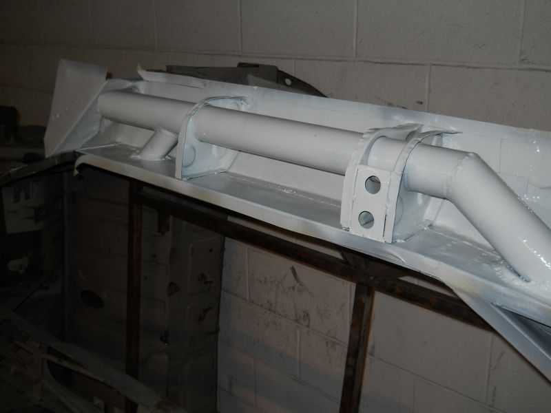

    Once that was established I spent the rest of the session prepping the cavity for a sealer coat. The surface rust I had to leave behind was treated with rust converter/stabilizer then a nice coat of epoxy 2k primer was applied.

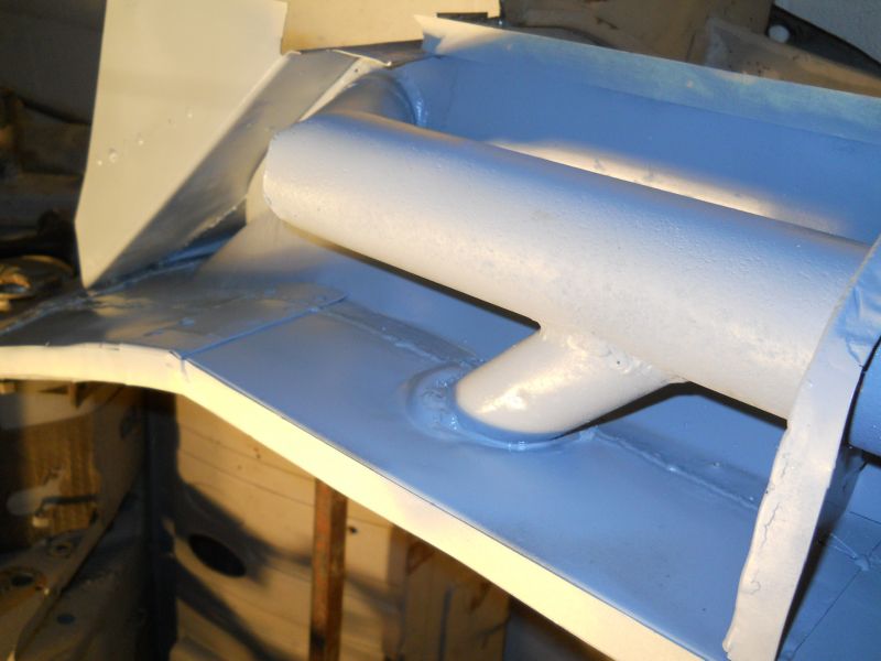

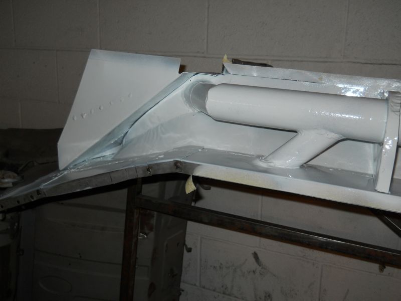

    While epoxy is good, primer always tends to be porous. For added protection I shot on a coat of paint. (spare stuff I needed to use up anyway)

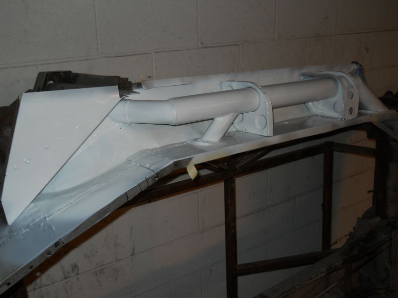

    Both paint and primer were thinned a bit more toward the end and spray concentrated up into the tight cervices.

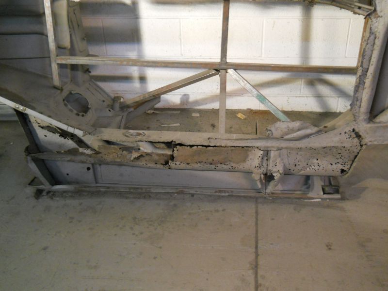

    Come along way from what it was...

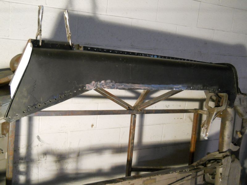

      New left longitudinal outer cover welding begins.

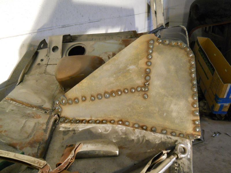

      After a few more minor tweaks and a ton of hole punching along the edges for the plug-welds this new section was clamped into position for the final time.

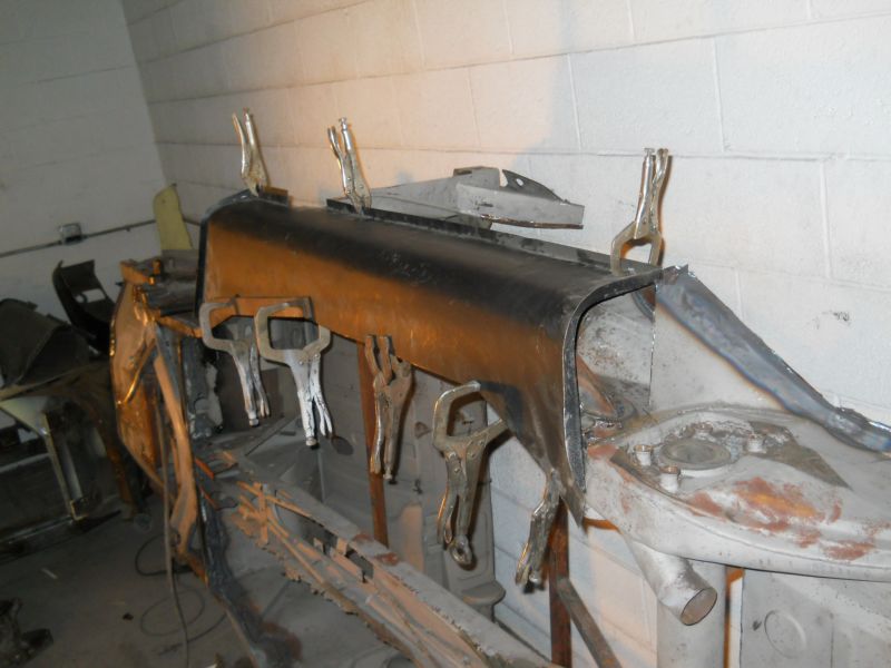

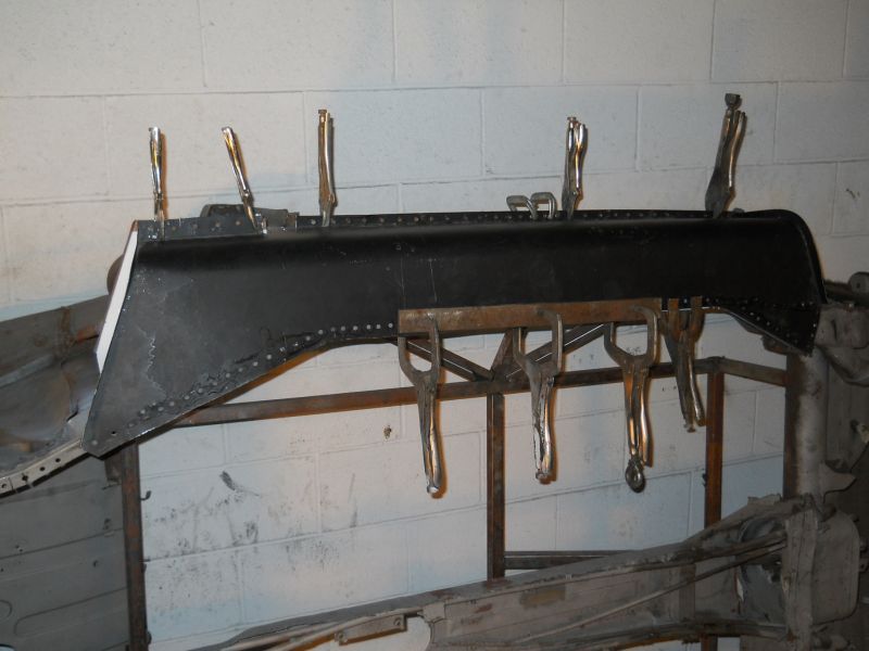

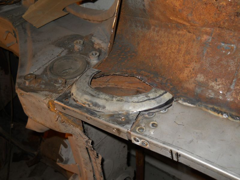

      Cover fitted in its best adjusted position here. I have found it best to begin the welding on the upper threshold flange first. Great care is taken to ensure the new panel is snug-tight against all three of the inner bulk-heads as welding progresses.

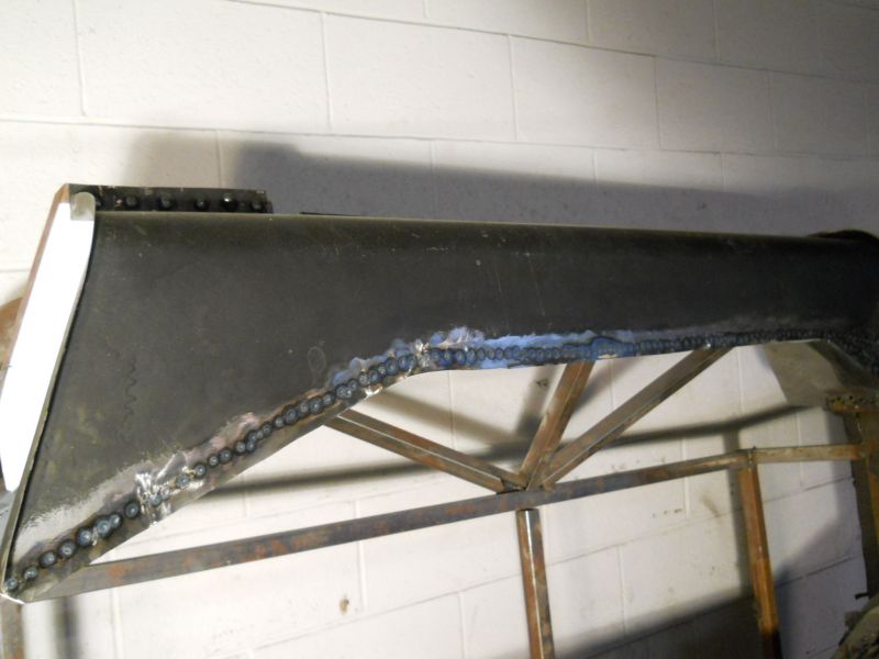

      I have also found it best to weld from the center outward to keep the panel from "bunching-up". First plug-weld laid down here between the center vise-grip and the little C-clamp.

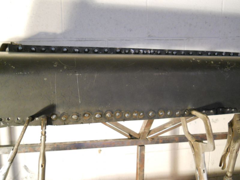

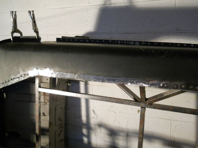

      With the threshold flange welded and set I moved down to the lower flange; again starting from the center outward. Doesn't look like there's a lot to it but the process is a bit time consuming. I am after the tightest fit for each weld as possible so clamps are set on both sides of each hole before welding. Sometimes a little hammer work is also required to get the two panels flush. Process is repeated for each hole so after 40-50 holes you can see how time can get away. Has to be right though.
      To break up the monotony I began dressing some of the plug-welds down smooth.

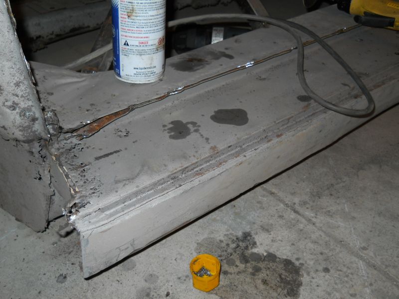

      • 9/28/13
        New longitudinal panel plug welding complete.

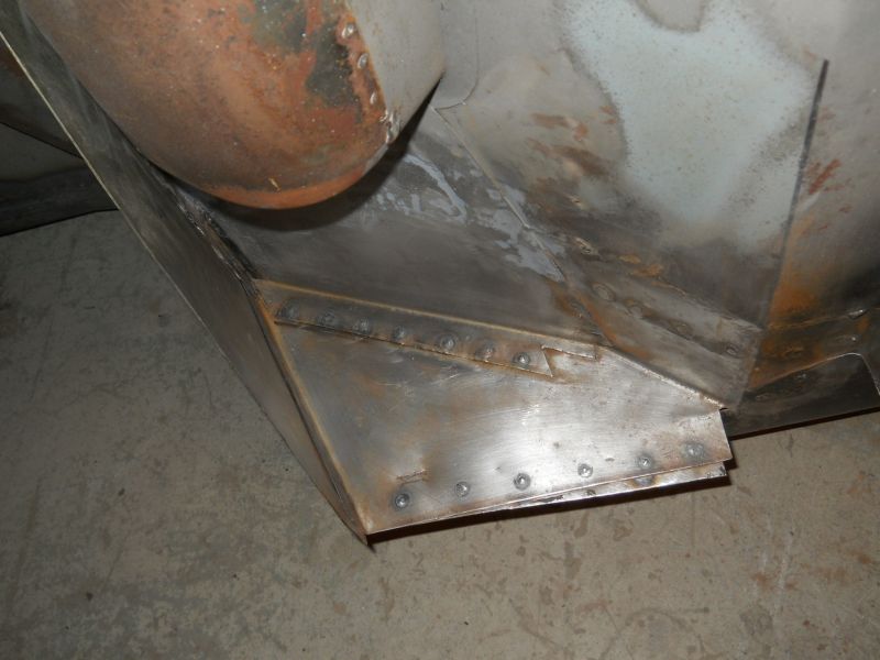

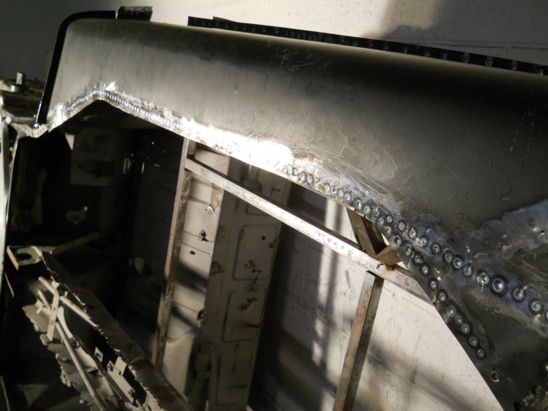

        Plug-welds ground smooth and flange gone over with my spot-welder for a more original looking finish

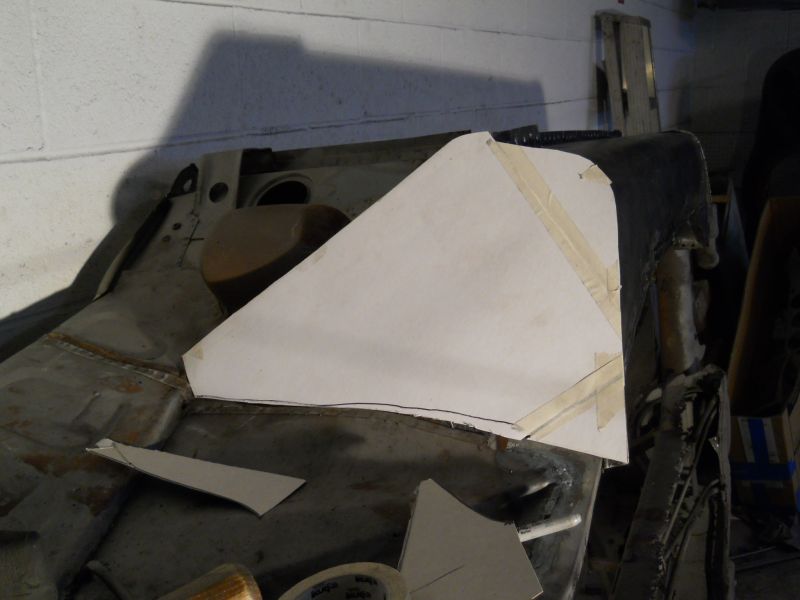

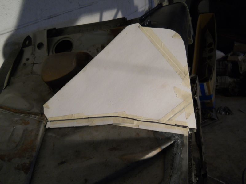

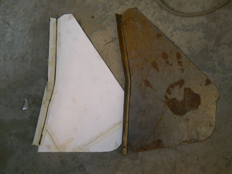

        Onto paper templates for the rear end cap now.
        Pretty straight forward and was in steel in no time. Basic shape cut here. Will get this stitched in tomorrow.

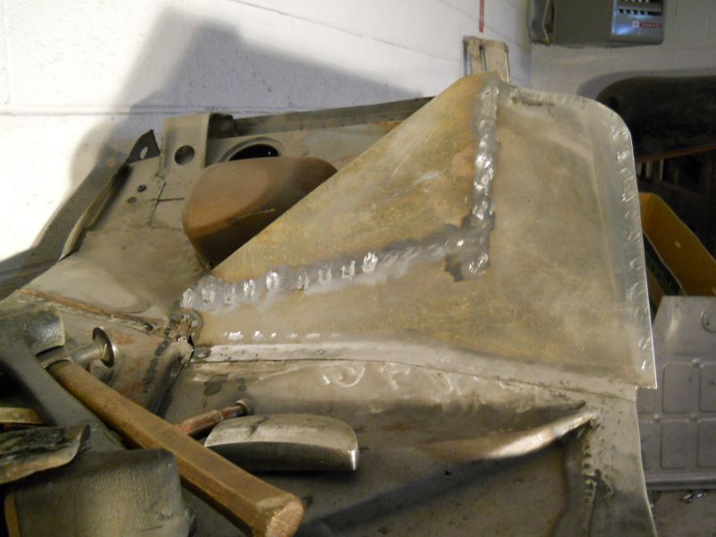

              9/29/13
              Rear longitudinal end cap installed.

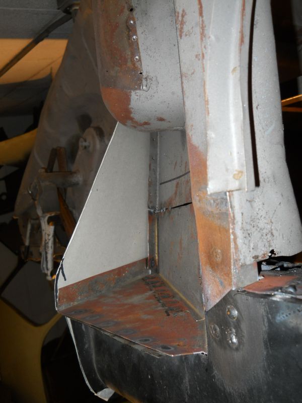

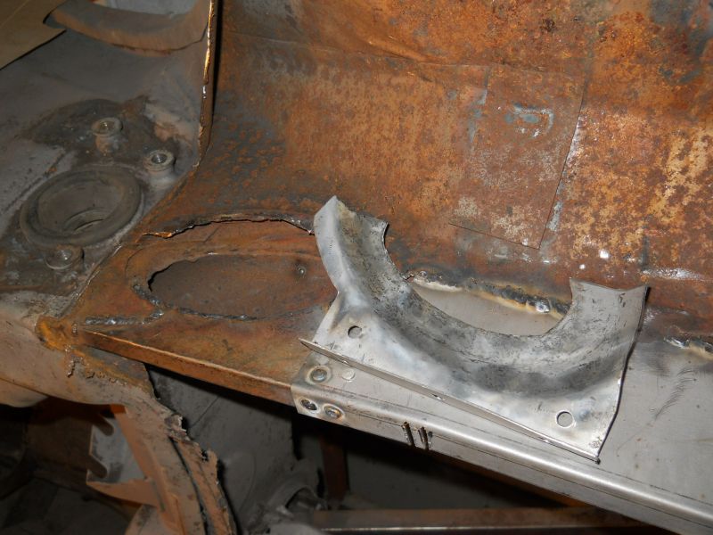

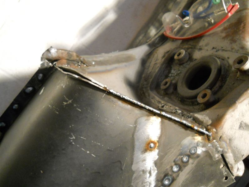

              before closing this end up I had to address those rust holes that were exposed after I removed the old cap section.

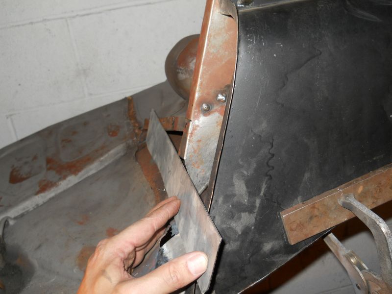

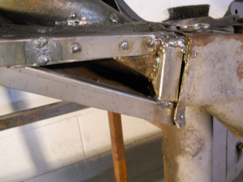

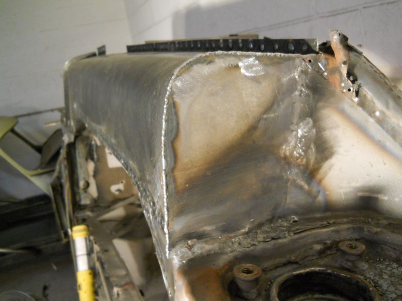

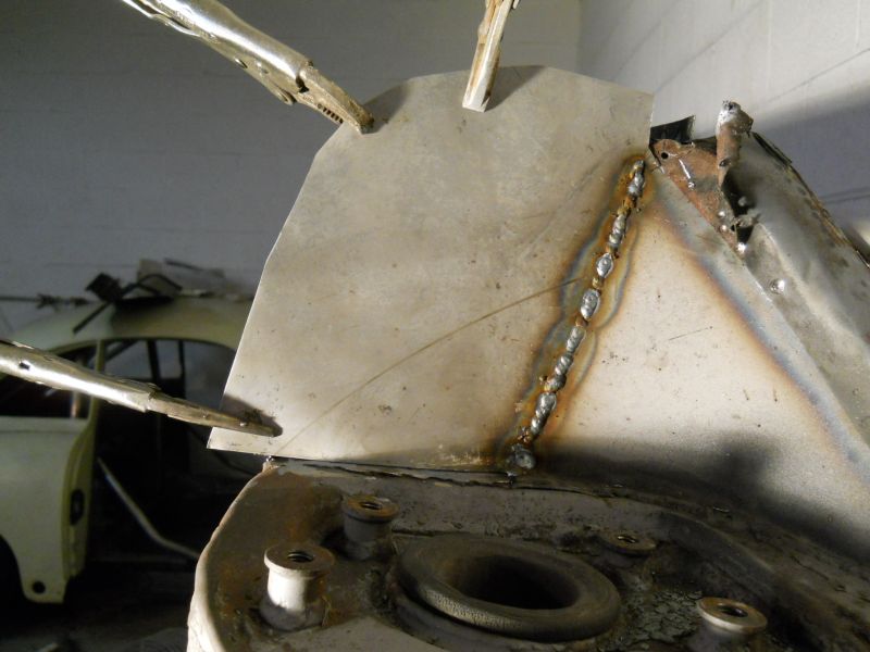

              With that done it was time to start mounting the new closing section. The most critical alignment was this upper butt-welded seam. I set and stitched it first which freed me up to hammer form the rest of it for a good fit.
              T2 style flanges were wide and spot welded but we are doing this chassis T1 style so I substantially shortened the flange and seam welded it all along the outer edge as done originally for 356T1.

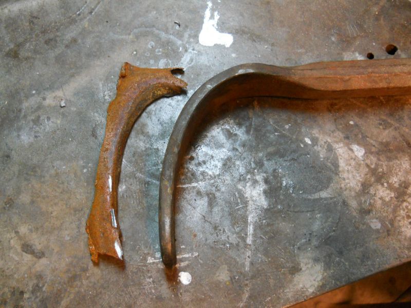

              • 10/1/13
                Front left Longitudinal end cap fabrication.

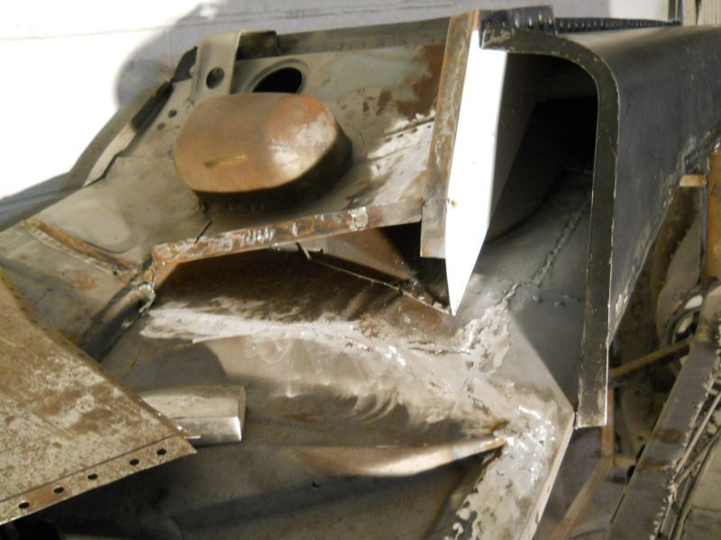

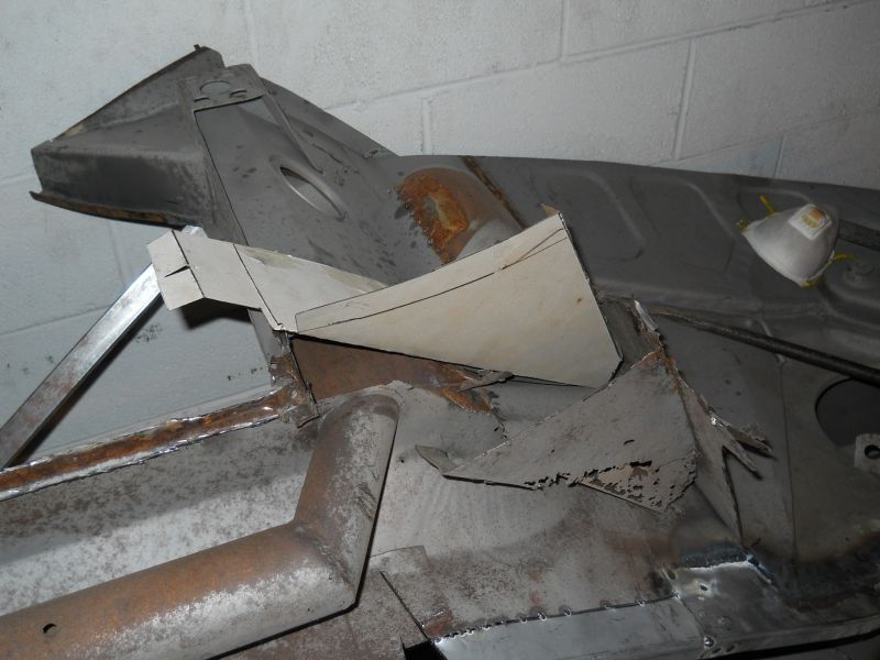

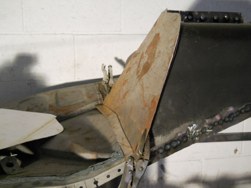

                Began plotting my template based on what was left of the original piece still attached to the old splash-pan.
                Basic shape coming..
                This is the panel that will eventually be welded to these inner flanges.

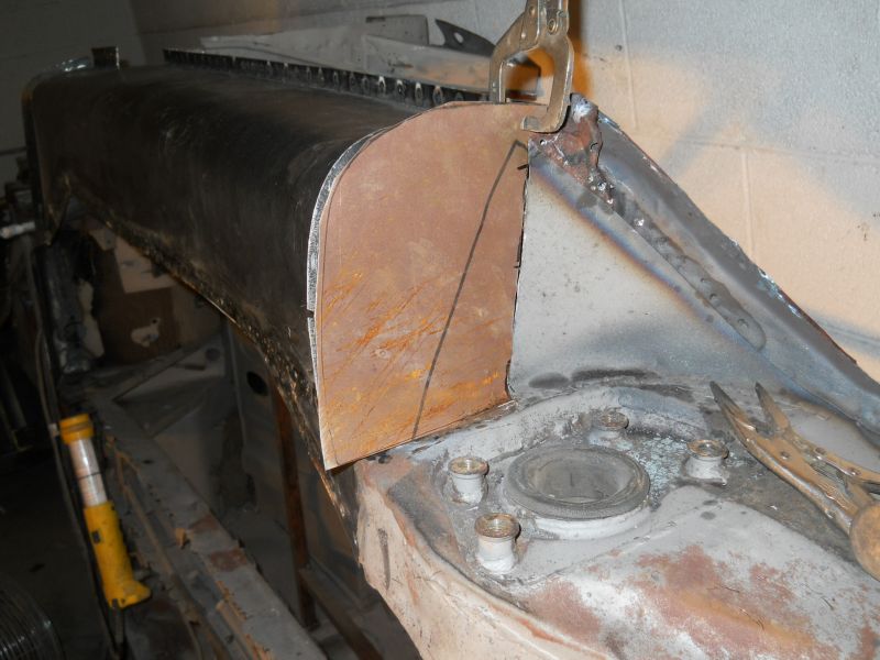

                The magic marker is pointing to what will remain exposed of this new panel once the splash-pan is installed over it.
                Template now complete with perimeter mount flange and turn represented.

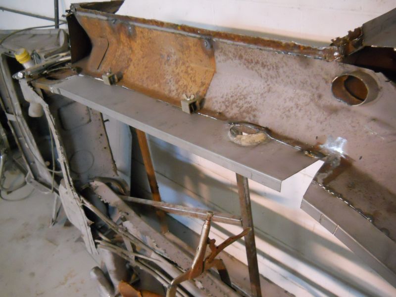

                New copy now cut out of metal. Trimmed and flanged to near finished shape here. (please excuse my old oily handprint now immortalized in oxidation.)
                Fine trimming and repeated test fitments begin

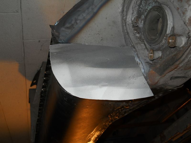

                Just about ready. Once I finish prepping the compartment and punching the holes for the plug-welds I should be tacking this in. Maybe by tomorrow... Thanks for reading this! Justin

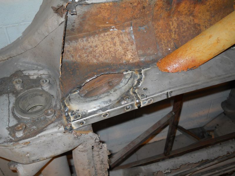

                • 10/2/13
                  prep complete
                  All the loose ends now tied up in here. Lots of grinding and weld finishing. Also added that little upper patch that was needed just above the new perimeter kits reach.

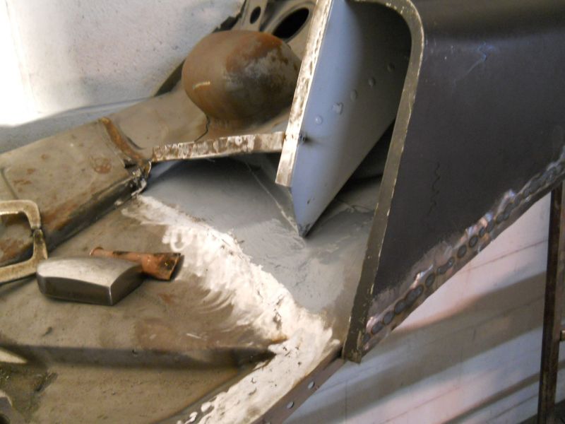

                  • 10/3/13
                    Left longitudinal rebuild complete.

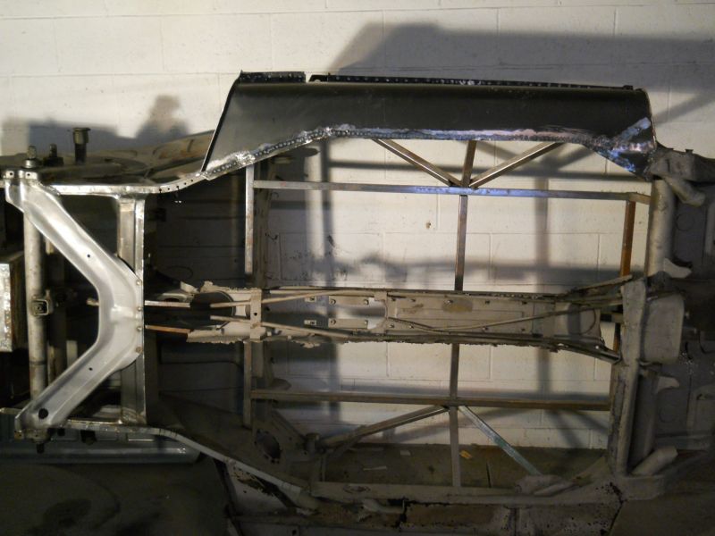

                    At long last this left side frame "tube" repair is complete!
                    Front end cap now fully welded on completing this critical structural component.
                    Welds fully dressed and pretty much ready for the outer splash-pan which we have to order.
                    Chassis is looking healthier little by little..

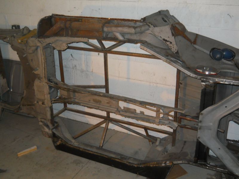

                    Its now ready to come back down so I can begin work on the right side.
                    A few more shots of it down on the ground.

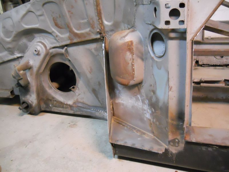

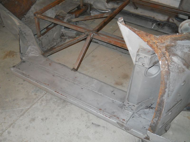

                    New door well area..

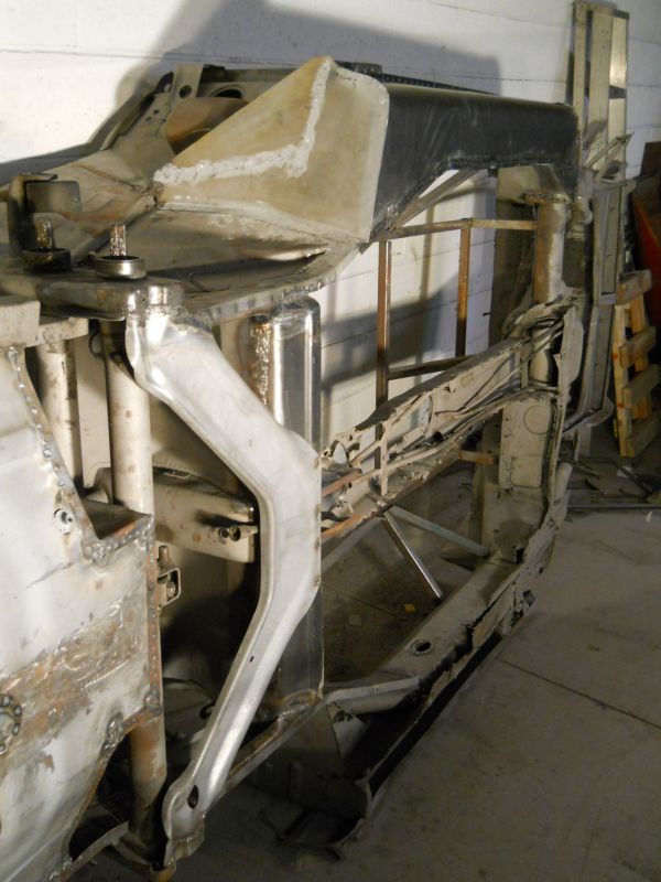

                    A lot of time and paper templates to get here!
                    Just in case you forgot what canker sore it started as..

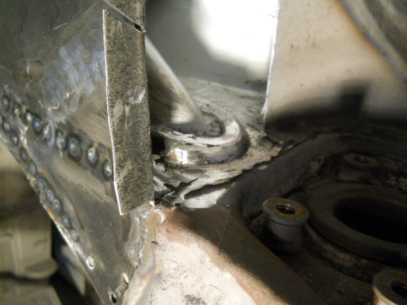

                        Of course removal of the lower hinge mount on this side is necessary as well. The wall looked okay but once I began prying on the mount I broke through.
                        Grinding and splitting the gas welds here. Since this is not on my hoist yet I had to do this work while lying on my side; not fun. Will have it all exposed by tomorrow. Thanks for reading this! Justin

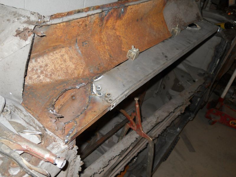

                        • 10/9/13

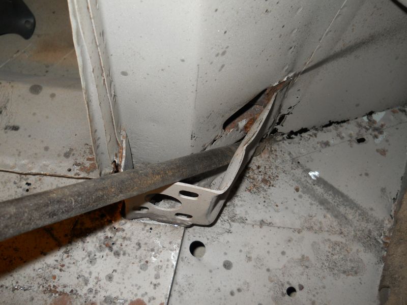

                          Right longitudinal opened

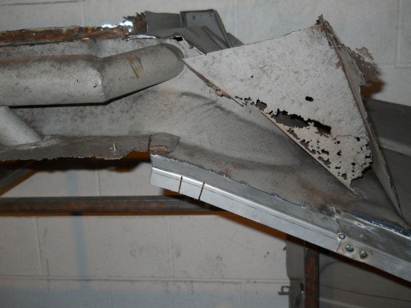

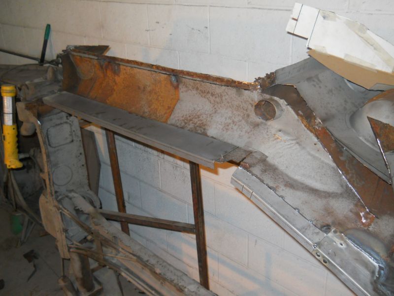

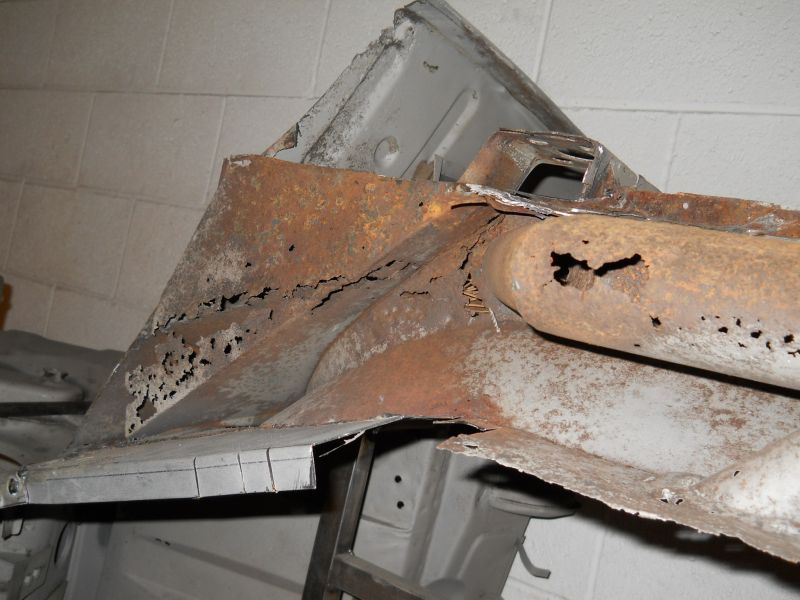

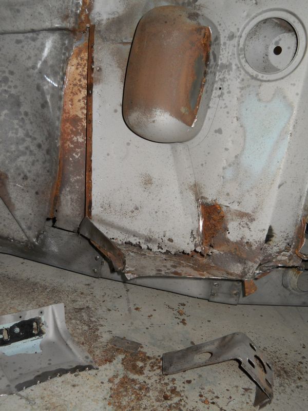

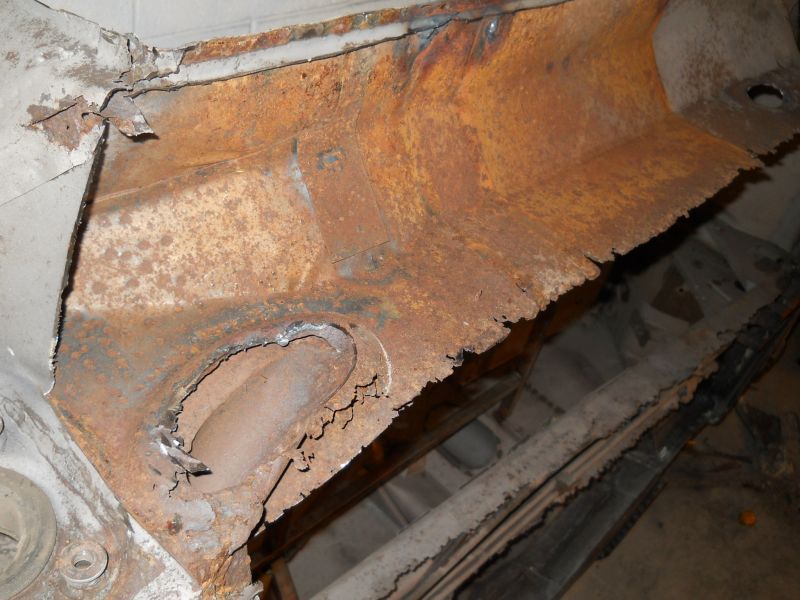

                          Rocker and what was left of the long. closing panel removed. This was not quite as rusty so the hardest side was done first which is always nice.
                          The front area including the tube is not as severe as the left side was.

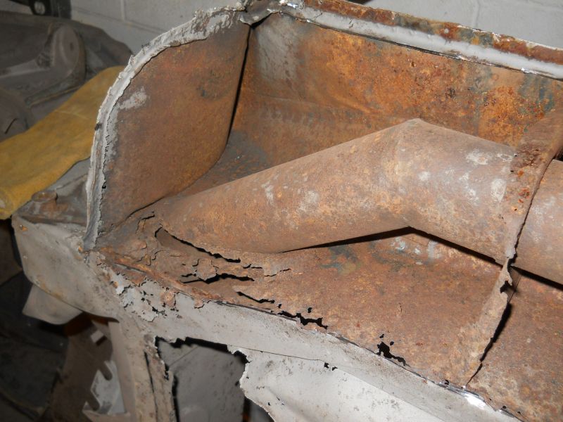

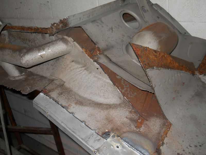

                          The rear area however is a bit more cancered out.

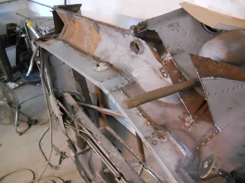

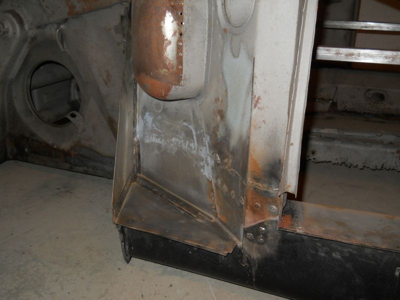

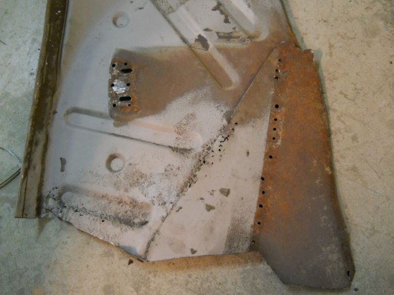

                          Progress on this side should go faster as the templates from the other side can be re-used by simply folding them the other way.

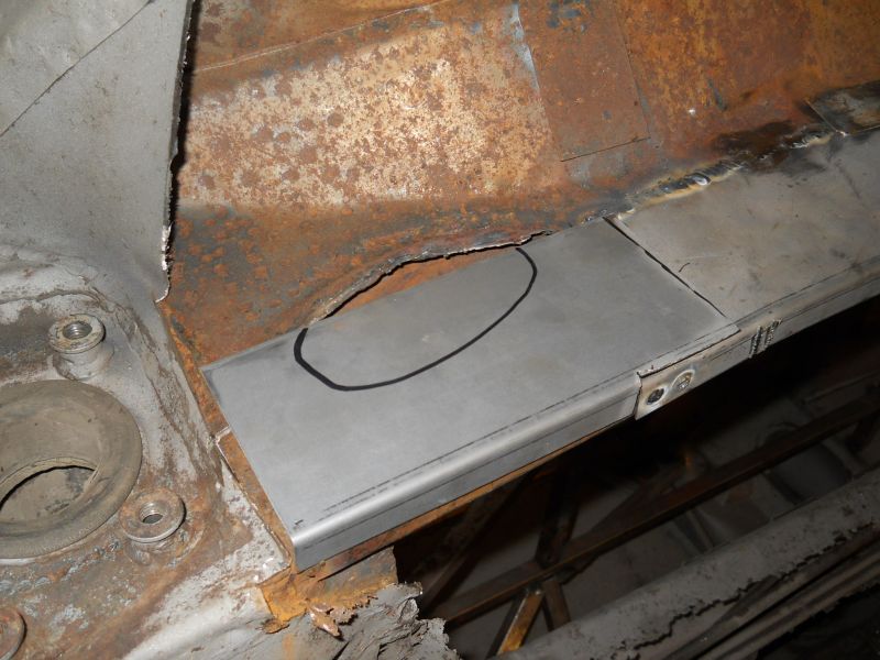

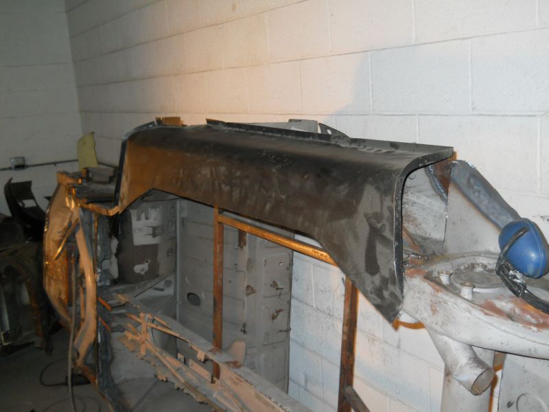

                          Rusted out door well area now removed. Again tube and upper opening bulkhead area in much better condition. Thanks for stopping by! Justin

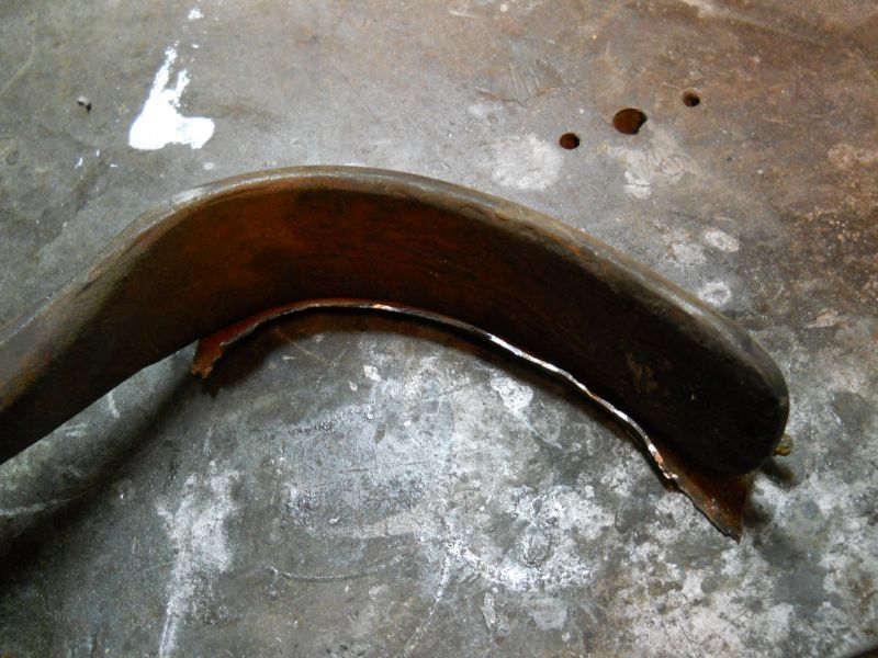

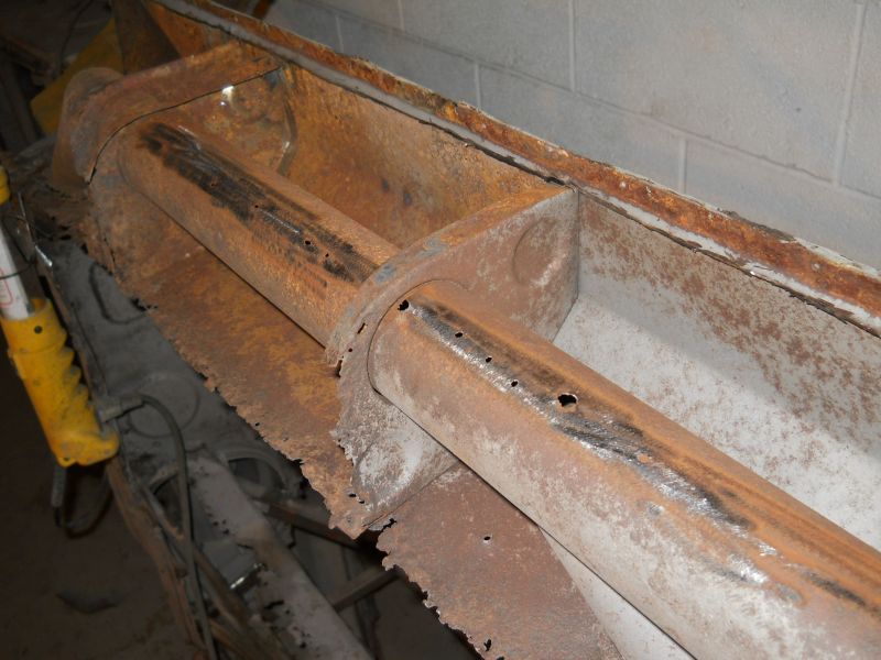

                            This right side tube appeared to be more solid than it actually was. I thought I might get away without replacing or removing it but as I ran my roloc pad along to knock down the surface rust all these holes broke through. Its shot...
                            What is really strange is that holes are all mainly along both sides but the bottom is more solid.

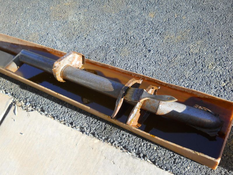

                                Been a little bit lazy about updating this so I thought it was more than overdue.
                                Right longitudinal repair continued:
                                With the lower heat exit opening embossed like the other side it was now time to trim and tack this new piece in.

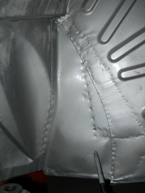

                                rear inner wall/flange had to be fully installed first so this new section could be attached to it. The new runner was a full piece but came up just a bit shy of the end. It was just as well since an opening embossment must hammered in first.

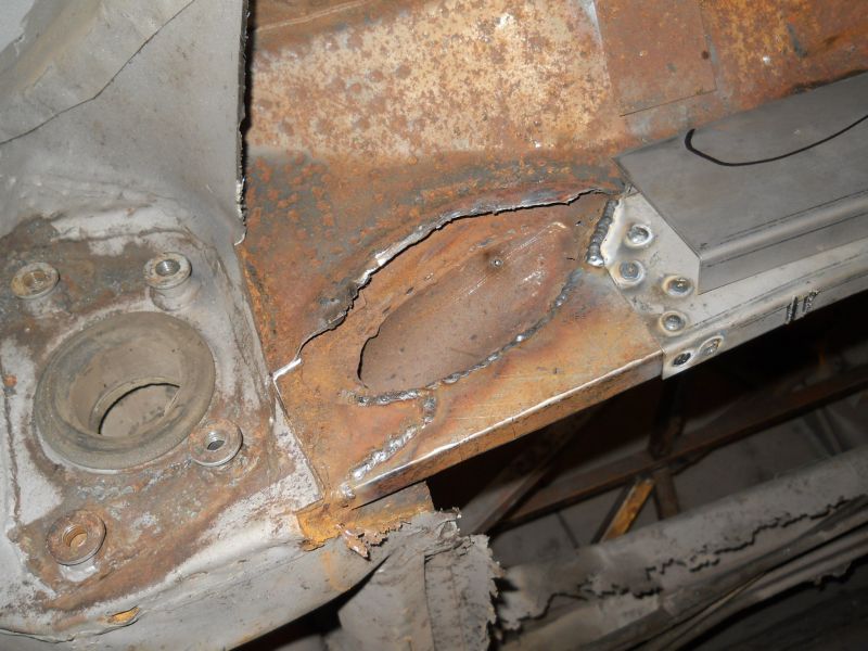

                                New section now fully stitched in.

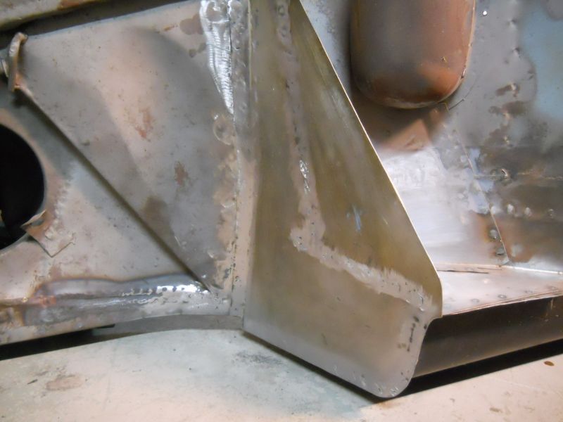

                                Forward corner overlap joint plate now installed as was done by the factory.

                                Time to begin the embossed outer opening replacement section
                                This area was a little rustier than the other side so this repair section is a bit more involved to fabricate.
                                Even I get lucky sometimes; I needed a better hammer-form to recreate that embossment detail. After some searching I found that this slapper was almost the perfect contour and would do the job just fine.
                                Follows the contour almost exactly!
                                My new piece hammered out to basic shape here. Some fine trimming and adjustments but I at least had the basic part I needed.
                                Just about ready to install...
                                New section now fully stitched in. A lot of trimming and adjustments at the opening still to come but its getting there...
