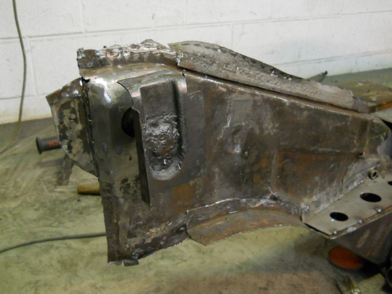

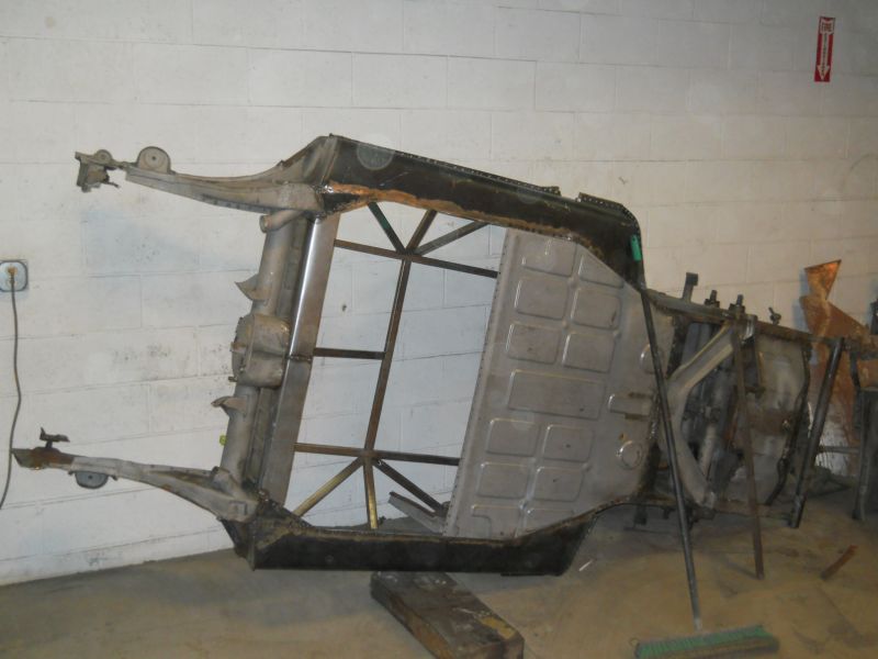

        At last...just about ready to "touch bottom" on these chassis repairs.

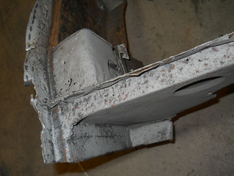

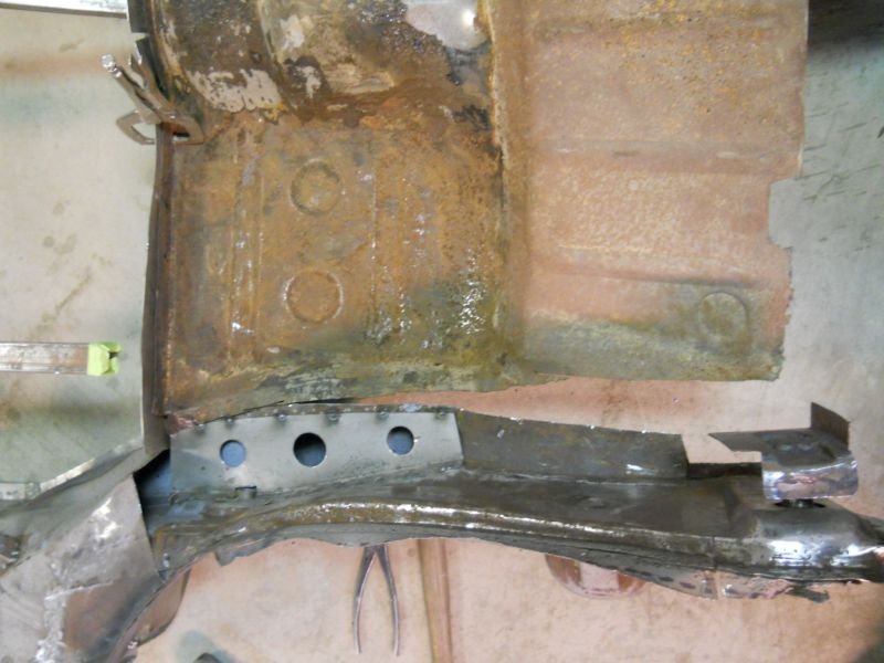

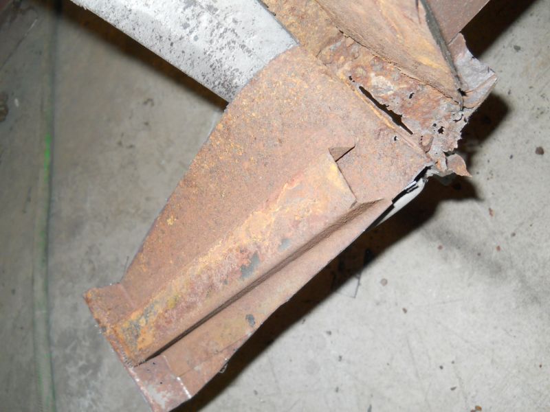

        Taking into account the main rear cross-member (trans-mount)replacement and the amount of rust and pitting to the engine compartment frame runners I decided to would be far easier, cleaner and faster to cut the frame off at the cross-member and order fresh sides from Steve Hogue.
        These sections look okay from the outside however the inside is a different story. Severely pitted and weak.
        Same story on the left side. New pieces will not only look better but I am saving a TON of grinding and cleaning prep time. If I where to save these I'd have to cut and clean this lower engine tray shroud, what's left of the side upper closing wall flanges and this rear closing bulk-head wall and its flange would have to be cleaned and prepped.

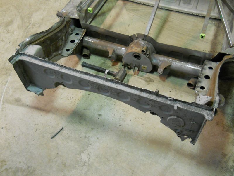

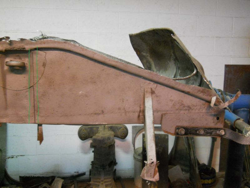

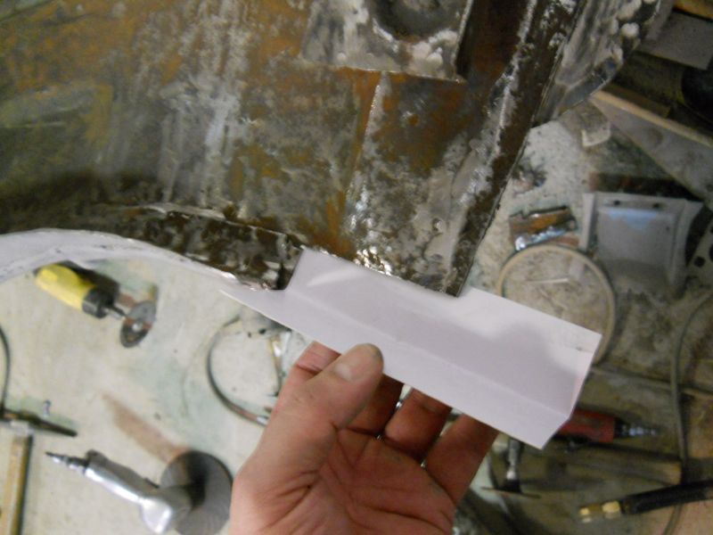

        The weld seam will be here between the green lines so it can be supported (and partially hidden) under the shock mount reinforcement plate and bridge supported by the eventual new cross-member to the inside. Dismounting the frame from the rotisserie was of course next.

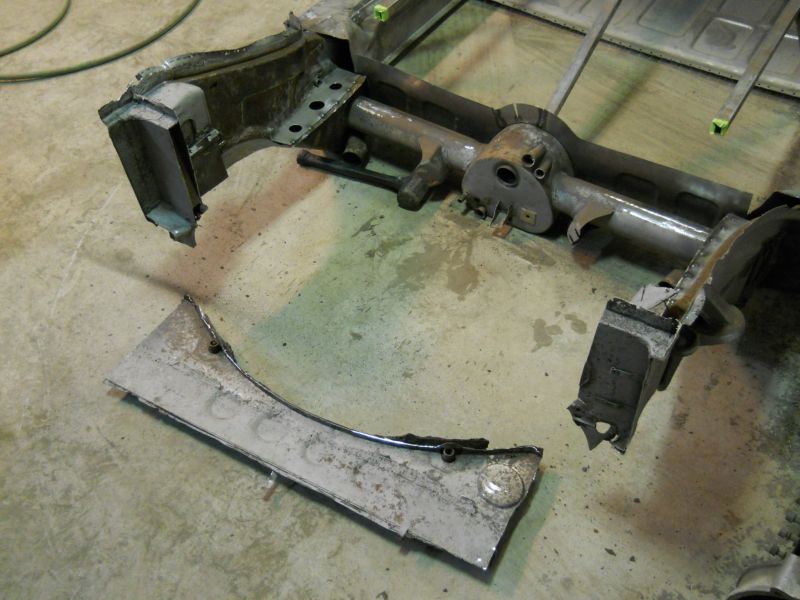

        Two straight initial cuts down both sides instantaneously eliminated a lot of sin.

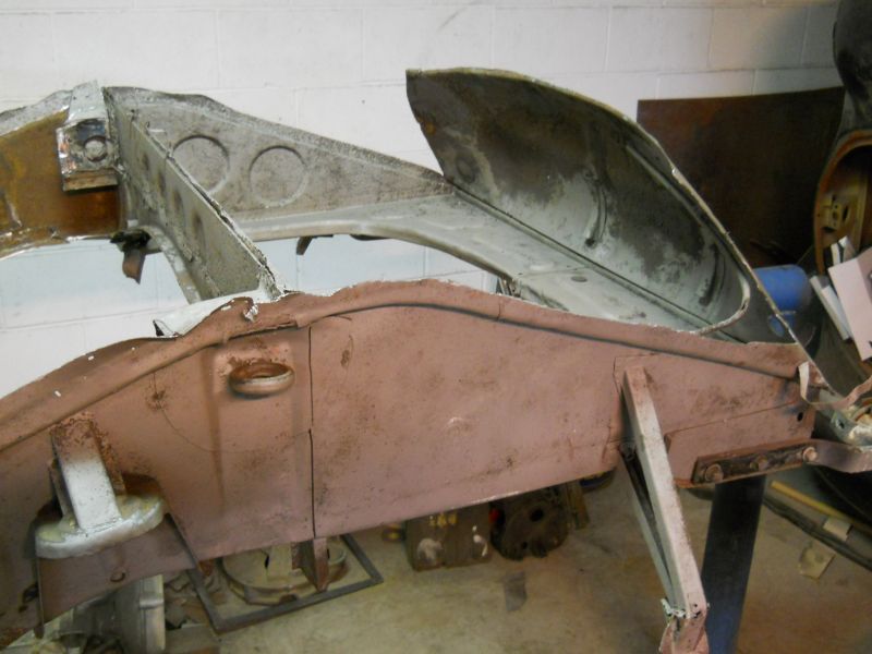

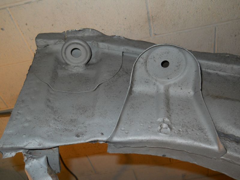

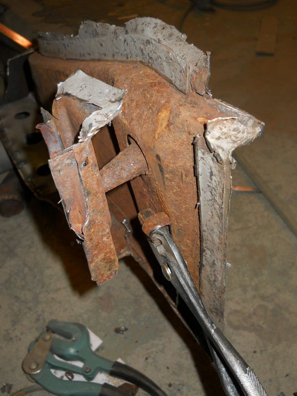

        With the engine compartment now out of my way I have clear unobstructed access the that rotted old cross-member.

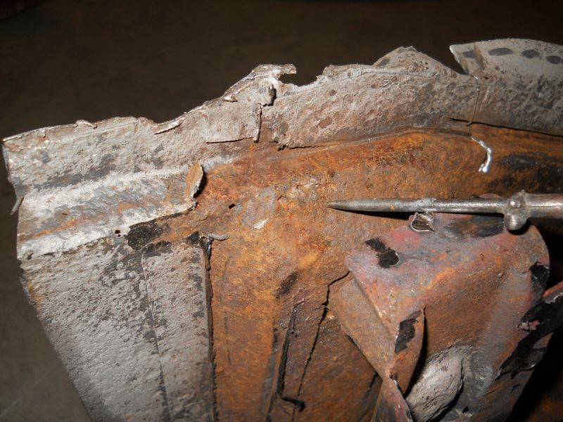

        A very busy, heavily corroded junction I have to remove in layers.
        Initial cut to give me additional access to these corners.

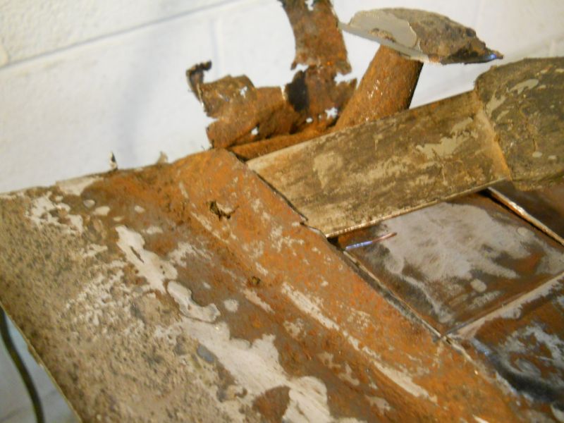

        Note the reinforcement plate in there. Just a piece of flat stock with its mount flanges going in opposite directions (A "Z" profile) I may put a section of square stock in here just to give it a little more strength. Cross that bridge much later. Working on these corners tomorrow. Thanks for stopping by! Justin

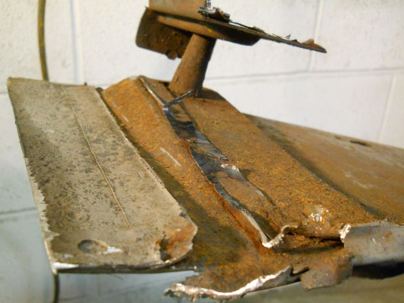

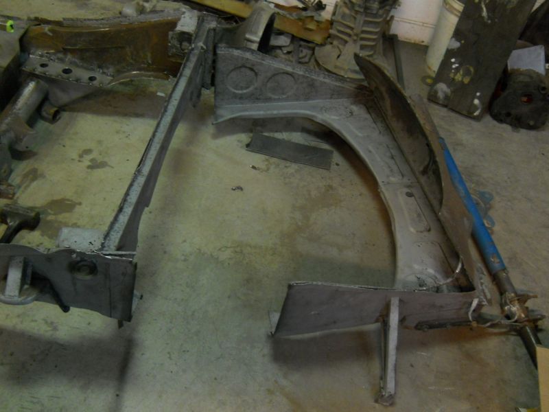

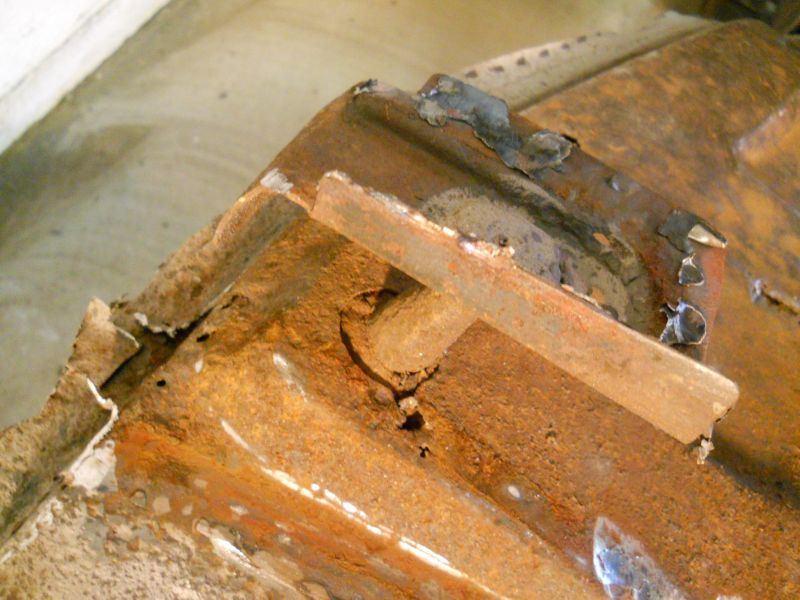

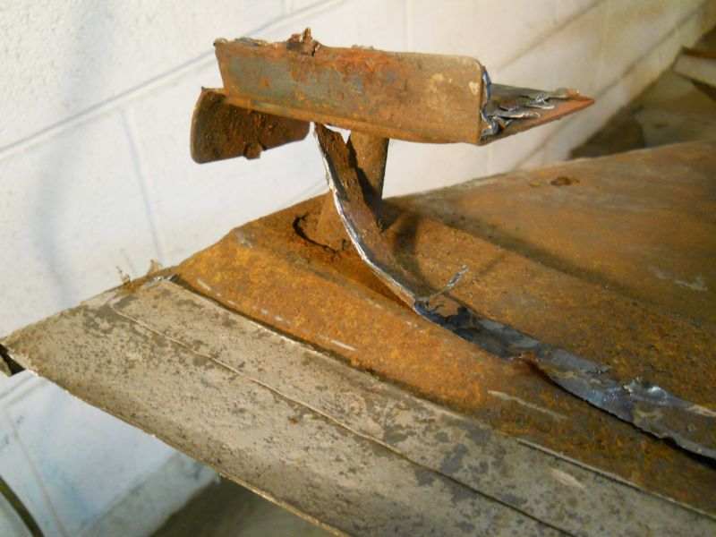

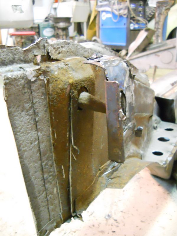

            I was mistaken this re-inforcement is not a "Z" section but rather channel stock that is spot-welded only the outer wall.

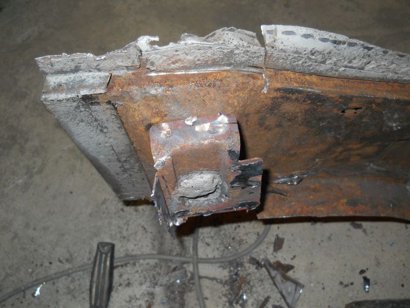

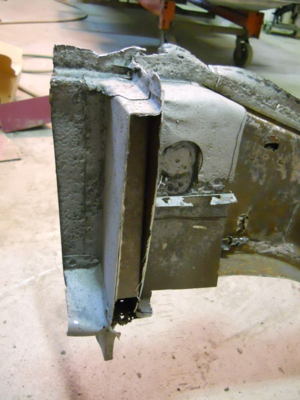

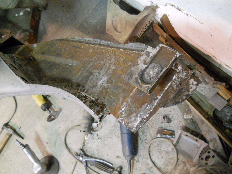

            Inside remains of cross-member now cut free exposing the shock mount shank and anchor plate.
            Cleaned and ground away most of the frame skin that was spot welded to this plate. More prep tomorrow. Thanks for looking! Justin
            • Justin,

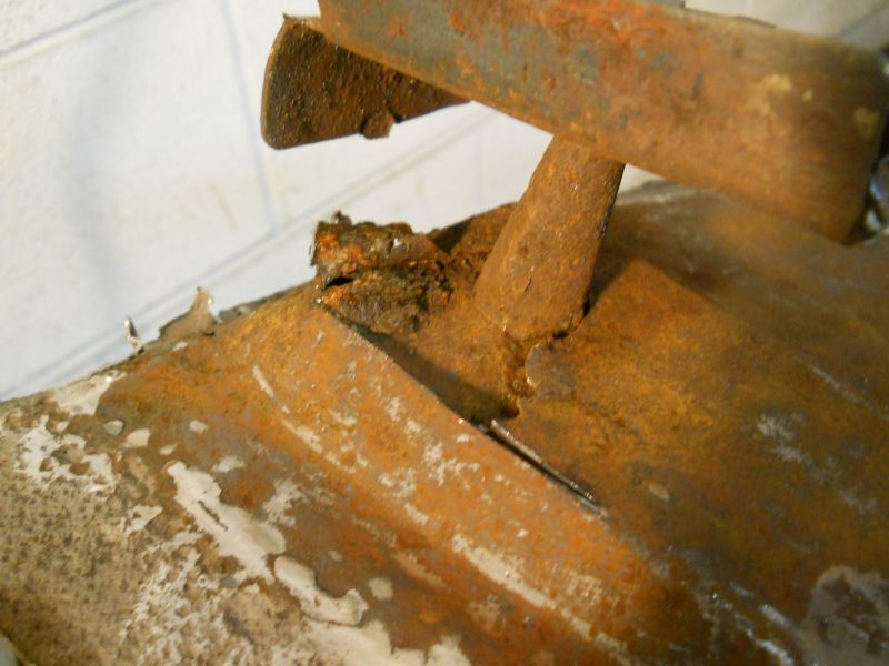

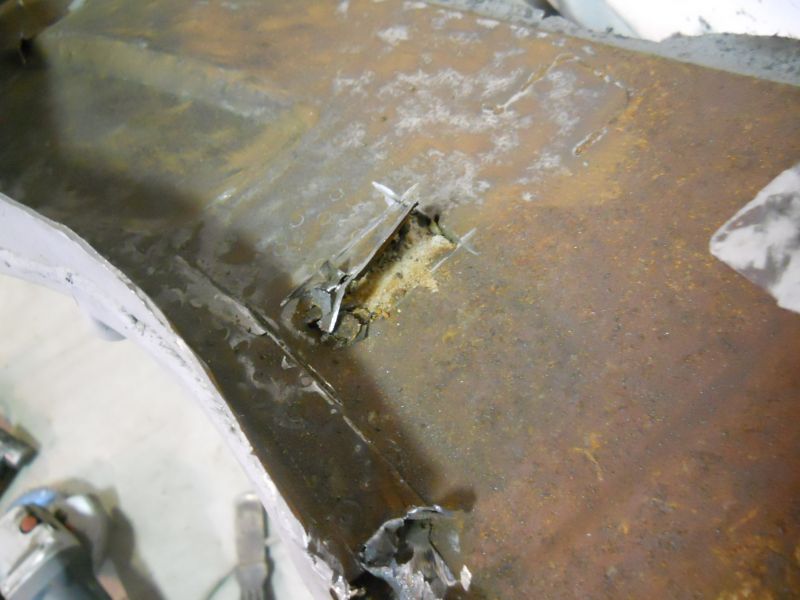

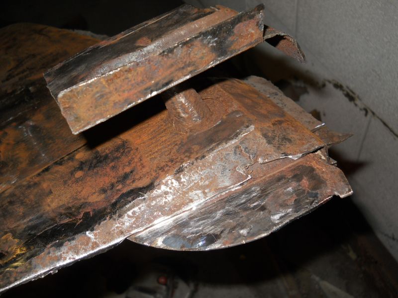

                Not a good sign here; I was able to pry the upper portion off with zero resistance. The old spot-welds gave up along ago from the rust. This is a prime example of why it was so important to come down in here. This is one of the main anchors for the cross-member. while there are many others that sandwich this unit together this is not a "real frame" like a truck frame but is instead flimsy sheet metal that relies on other sheet metal to triangulate and create strength. Not a comforting thought with a 300lbs drivetrain hanging and working off of this area.
                Of course my screwdriver poked right through the wall. Damn it! Just when I thought I was done with surprise rust.
                Lots of thick advanced corrosion lurking under there.

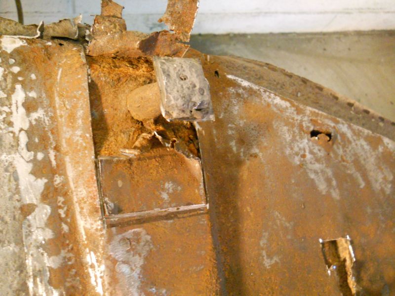

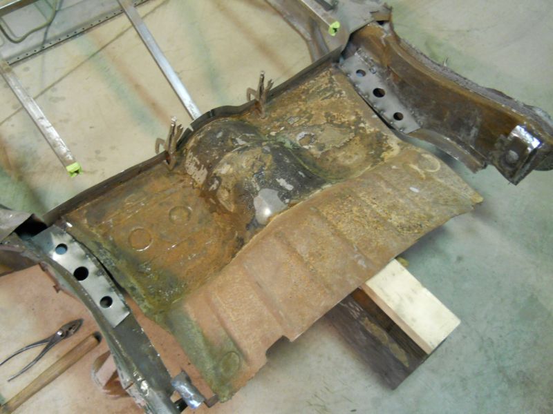

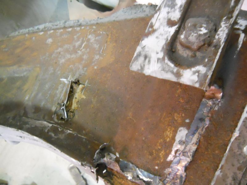

                      Cut the area back to solid metal and wire wheel the area as best as I could to get it clean. Cavity was then coated in rust converter in preparation for the new patch.
                      New patch welded and dressed. I made a mistake and followed the contour the outer reinforcement which gave the to a more swoopy profile should have looked at the other side as it had more defined bends. Oh well, its solid again and will be buried deep in the chassis once it goes back together.
                      The tiny blow-out holes to the upper left is on the eventual cut line so I left them for the moment.

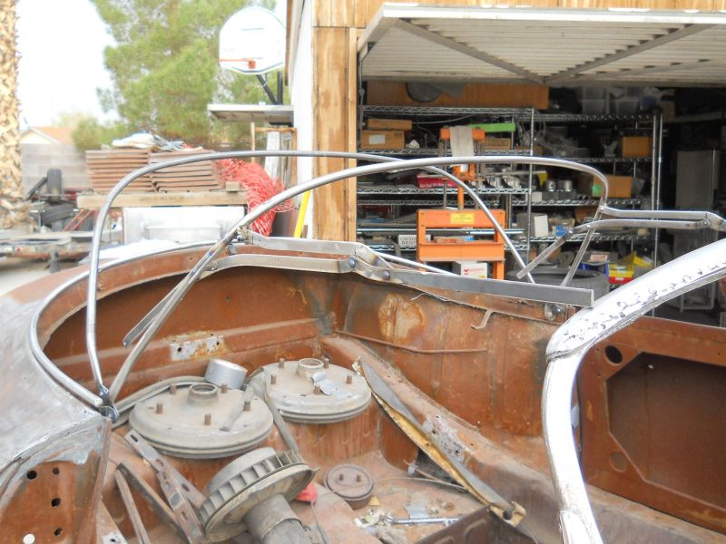

                      Got out of the shop on Friday to help knock rivets into this newly fabricated low bow speedster top frame. Thanks for looking! Justin

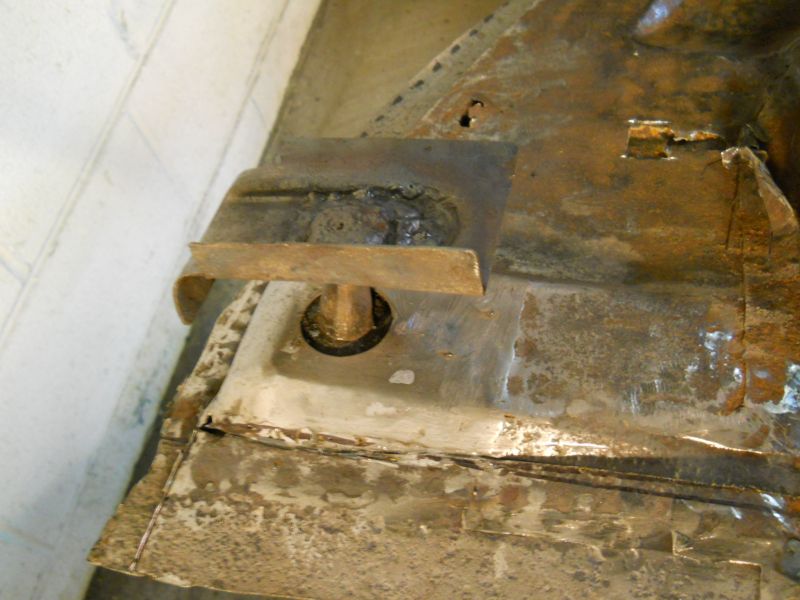

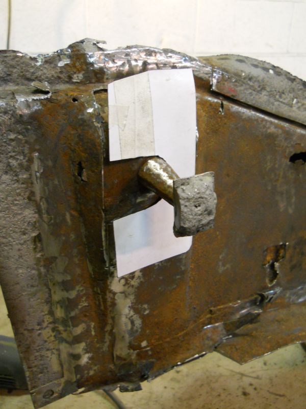

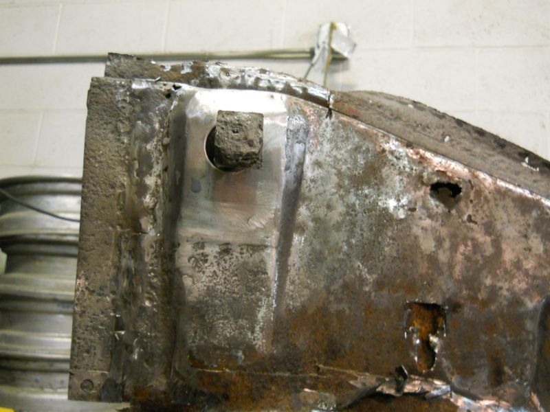

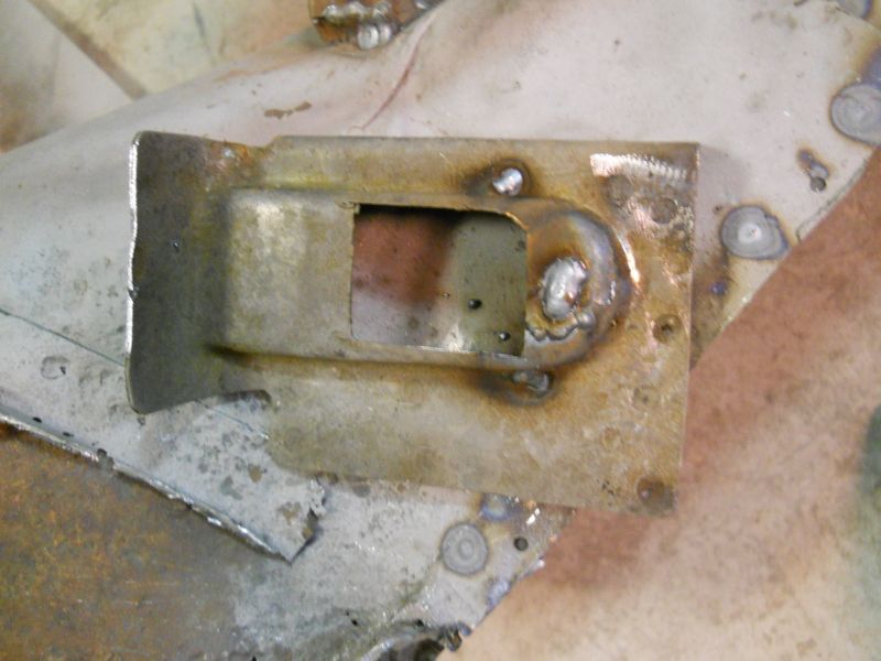

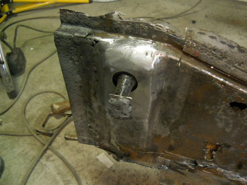

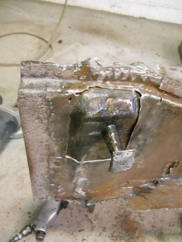

                        Old shock mount anchor acid dipped and cleaned of all rust with remnant flanges also ground smooth. Had a few rust holes to back fill before remounting. A very bad sign when thicker plate brackets even begin to rust through.
                        Rewelded back into position.

                            Right side corner cleaned and prepped for new panel.

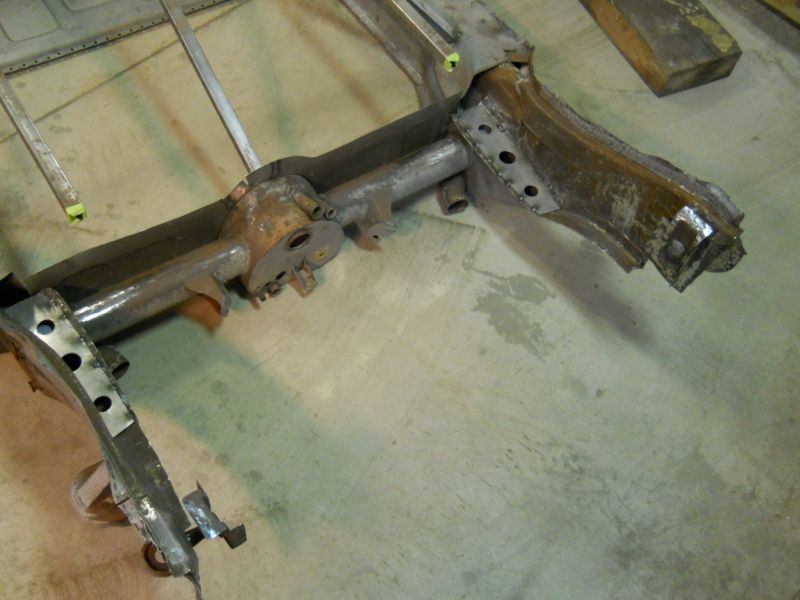

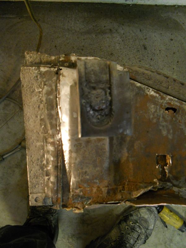

                            Okay, now I believe I have officially eliminated the last of the surprise chassis cancer. All clean here and ready for new side panels, cross member and seat pan. A lot of ceremony and a lot of mount flanges to grind off especially on those shock mount anchor plates but here it is at last all clean.
                            Though this side was not a rotted as the left the upper inner mount flange of the cross member again peeled right-off without a fight. I'm beginning to think that this portion on both sides may not have been spot-welded at all when new???

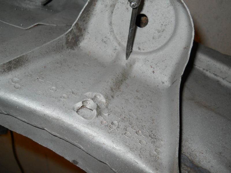

                            The culprit is this fine blow-sand like sediment that accumulated in that center drain embossment on the bump-stop plate. Any moisture that came into contact with it was immediately absorbed and held here rotting out the inner panel. That sand has probably been in here since the early 60's.

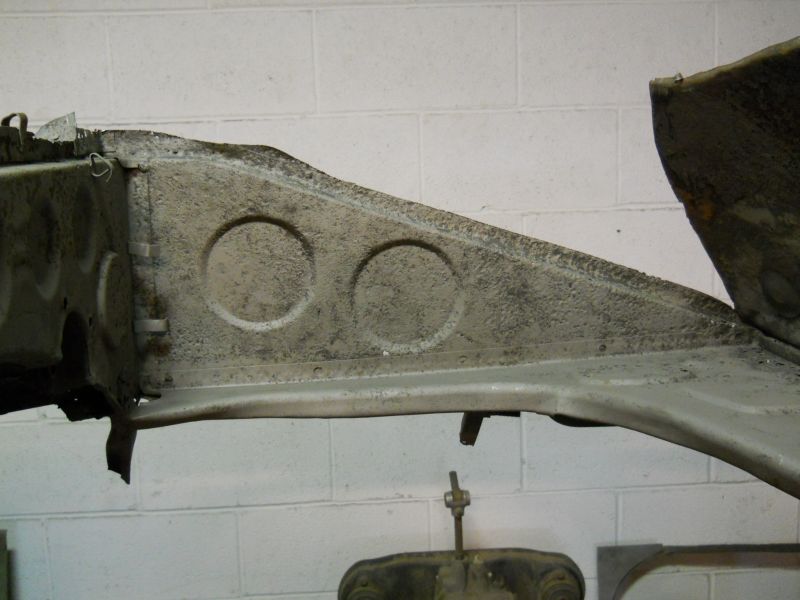

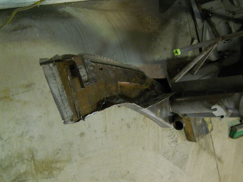

                            Here is the drain embossment that held that sediment. note that the bottom of this drain tube was bent closed just above the outlet.

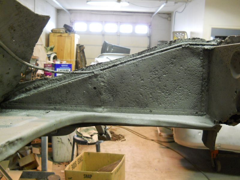

                            Top-side opening. as you can see easy access for dirt and moisture. remnants down in the seam missed by the media blaster.

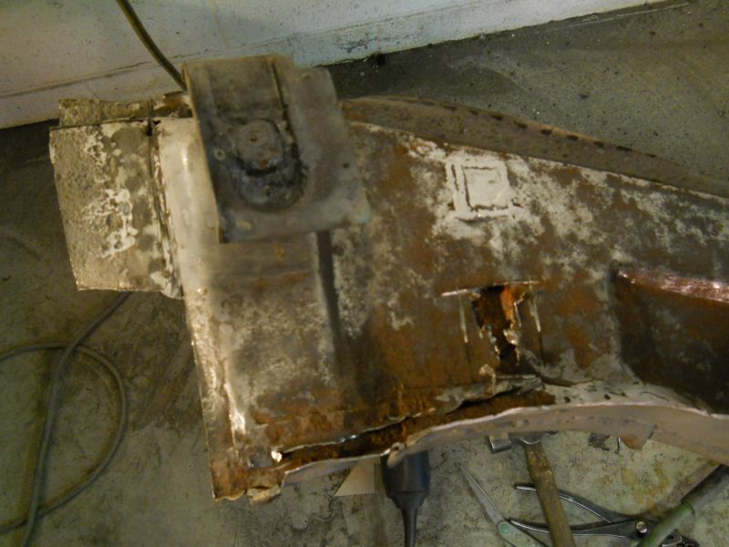

                            Anchor plate and side area cleaned of excess metal. Some rust here but not as severe requiring removal of the anchor plate to patch around the base like on the left side. Every once in a while a catch a tiny break.

                            The lower flange section on this side however needs a small filler section. Templating it here.

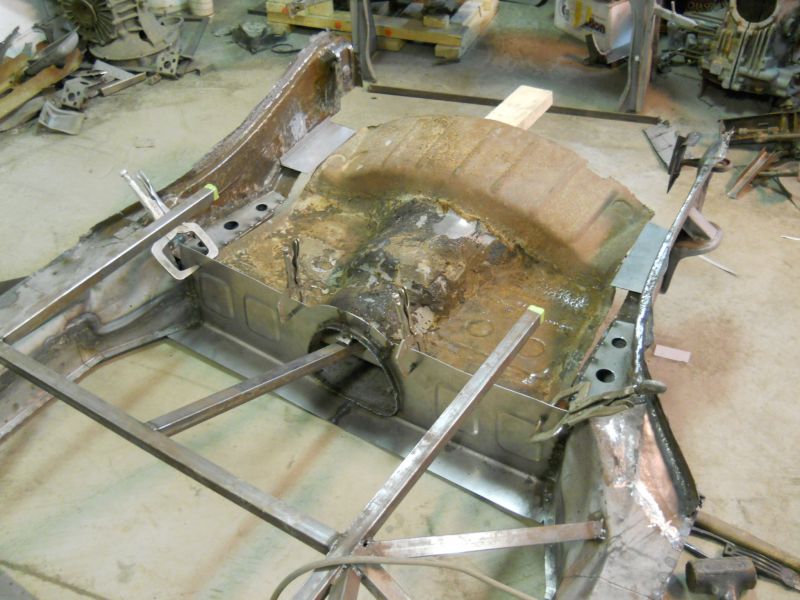

                            While I wait for new sides from Steve I can begin fitment and filler panels for the new seat pan.
                            Templating the new flanged sides next.
