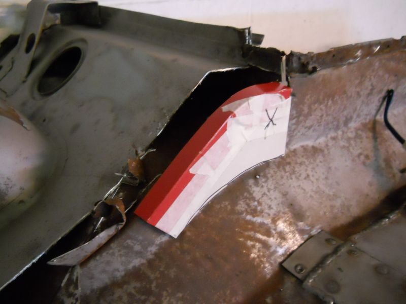

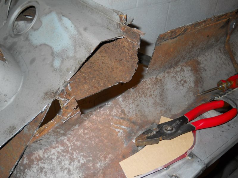

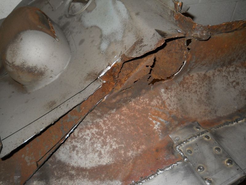

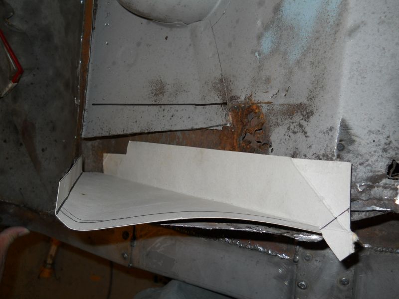

      With the first outer wall template done I cut a section of it out give me a clear shot at the second layer. This next one comprises most of the vertical wall and all of that triangular shaped floor that is so rusted. Template just about set. I'll of course add more to vertical
      wall to address that hole where the hinge mount was.

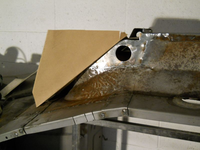

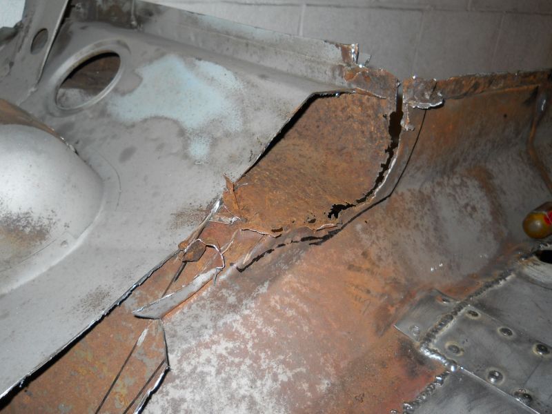

      Just about ready to cut this eye-sore out to get to the third layer.

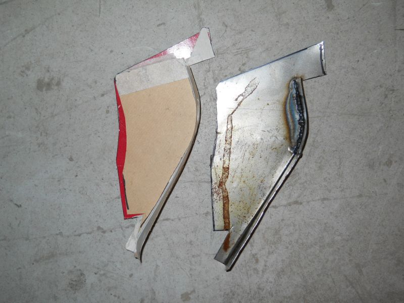

      Now that the first two layers have been copied I am onto this third section. This is the flange/closing panel that end of the heater tube was welded to. Template for this one next. Slowly getting past all the rot! Thanks for stopping by! Justin

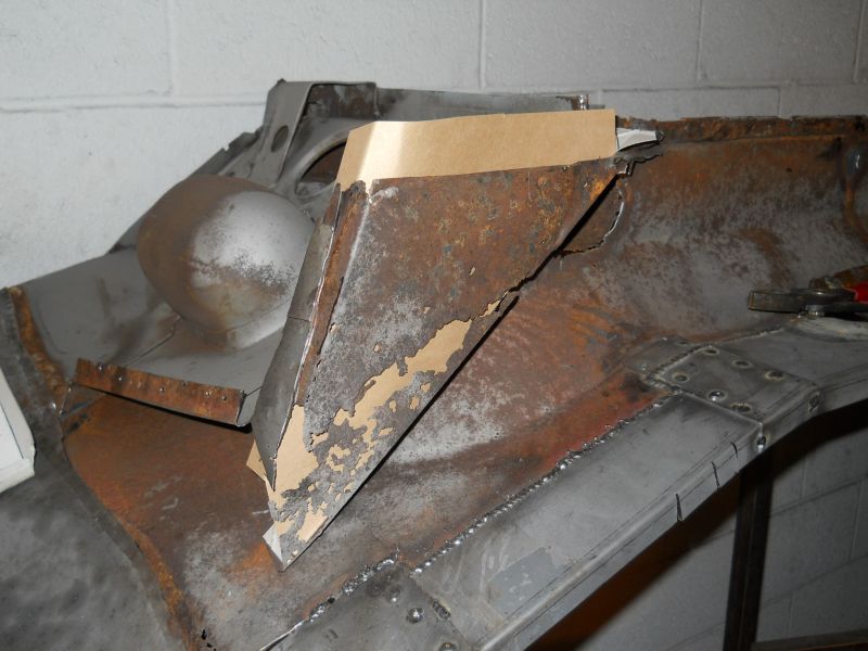

          7/24/13
          One more template.

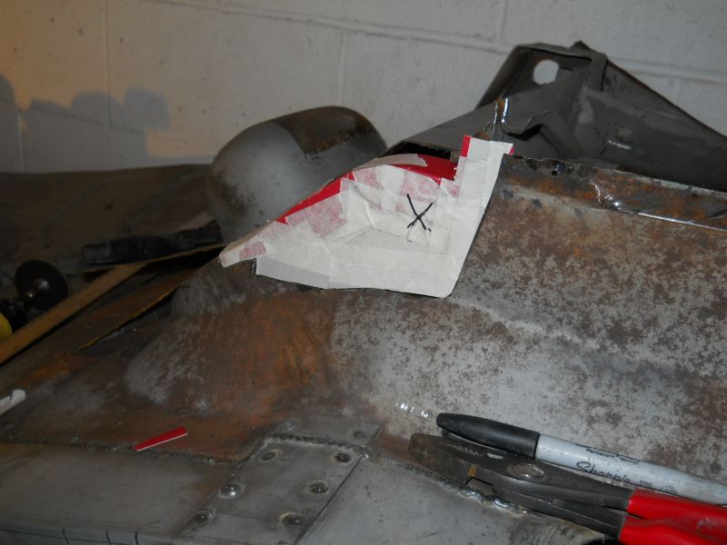

          Template making now begins for this final layer of rotted metal

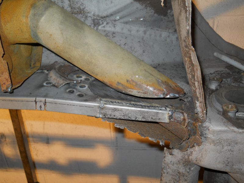

          This final layer is actually the top closing portion of the frame/longitudinal runner. The last bit of rusted out metal is the defroster conduit at the kick panel.
          Interior view of that conduit.

          Adding and subtracting to that basic template. Its in final form here and am now ready for metal.

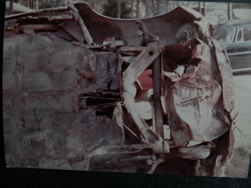

            • My Dad always said "rust free" meant they weren't going to charge any extra for it. Here's one we threw away after we stripped it. 1974

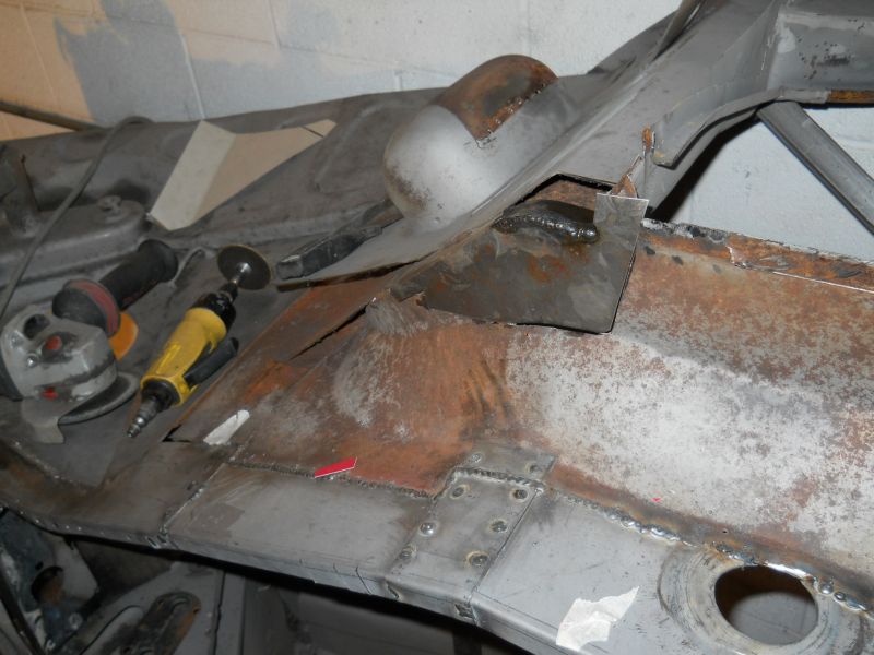

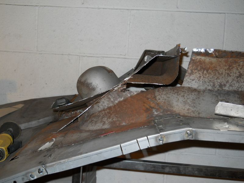

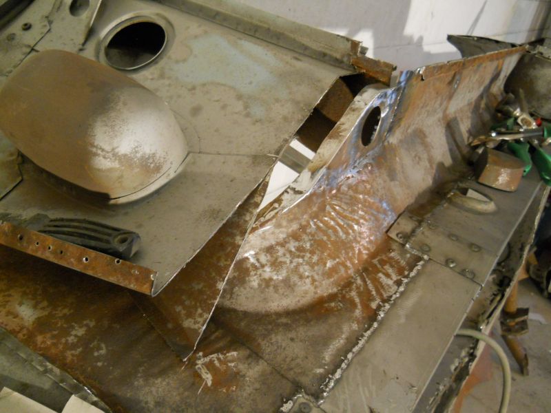

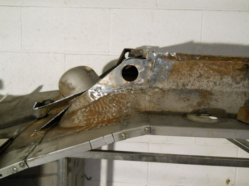

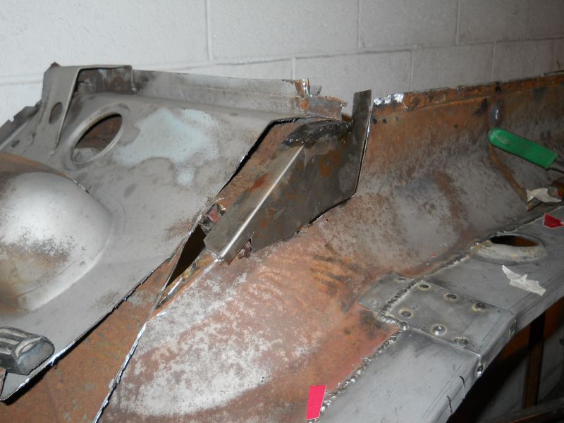

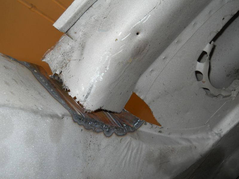

                  7/25/13
                  Officially touched bottom on this side and am now on the way back.
                  New patch now fully installed.
                  New piece follows the contoured edge of the closing panel it will be joined to.

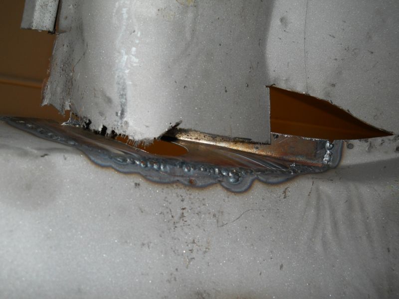

                  New flange will be plug welded onto the new closing wall section. That will have to until the new heat tube is in. I need access to the top side to weld the tube to this new patches opening as originally. So I've gone as far as I can until the new tube is in.

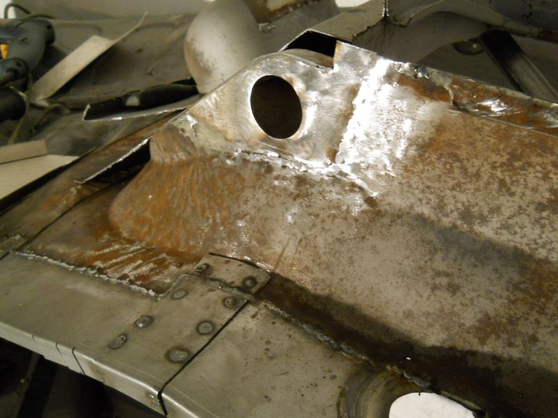

                  Inner top side view

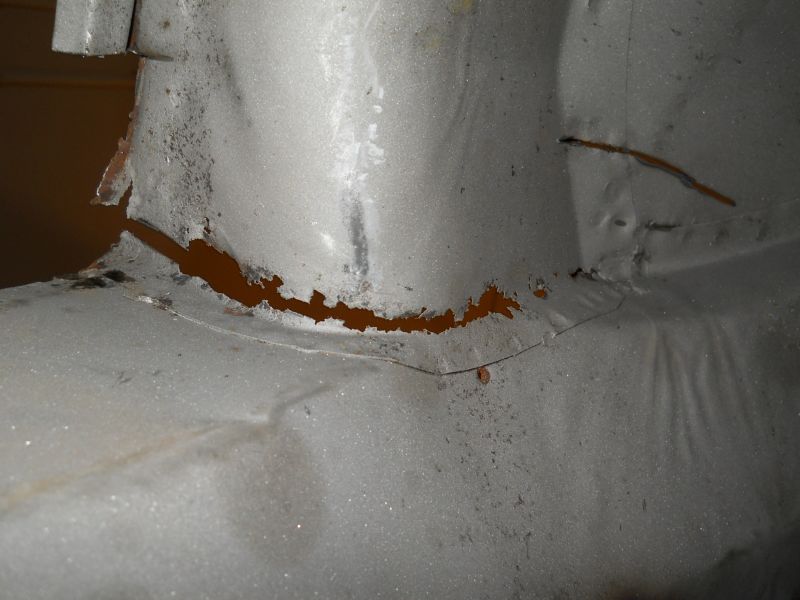

                  Will cut a little more of the conduit away so I can get in there to weld up the tube opening.

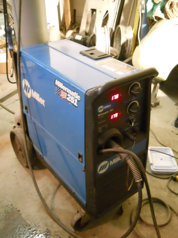

                  • Justin, Out of curiosity, What make and model welding rig do you use? Settings? wire size, speed, heat range, etc. I have used them before but only as a novice. I know experience is the best teacher but what model would you recommend? What about the rest of you guys? Thanks, Erik
                    • Hey Erik, I'll take a photo of my welder tomorrow with wire, speed and heat details.

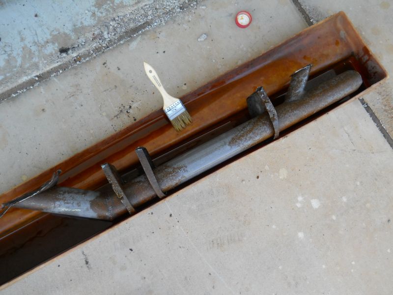

                      7/26/13

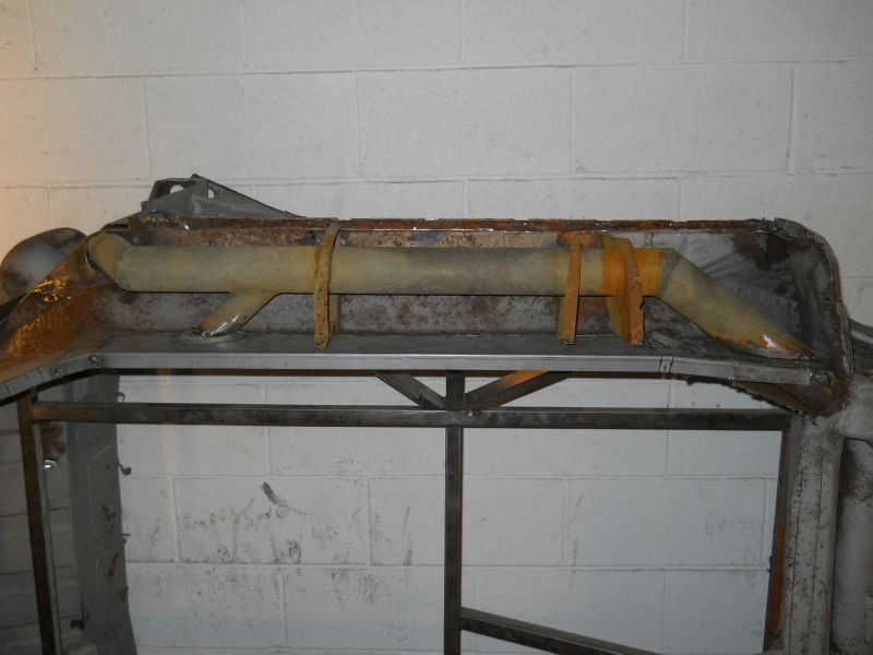

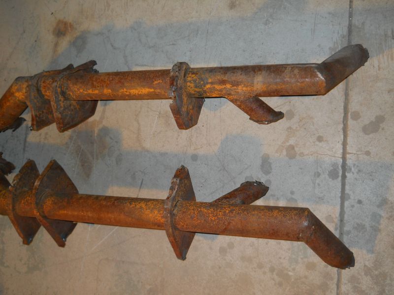

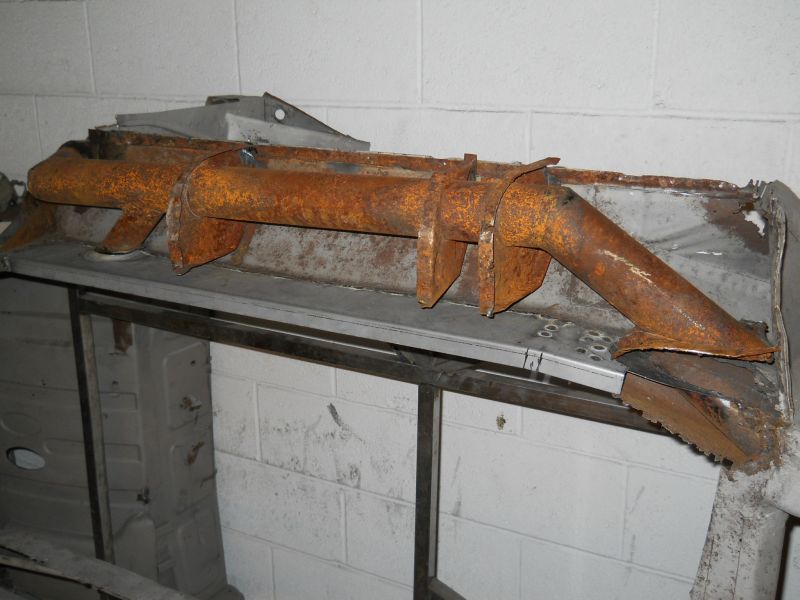

                      New(old) heater tubes here.

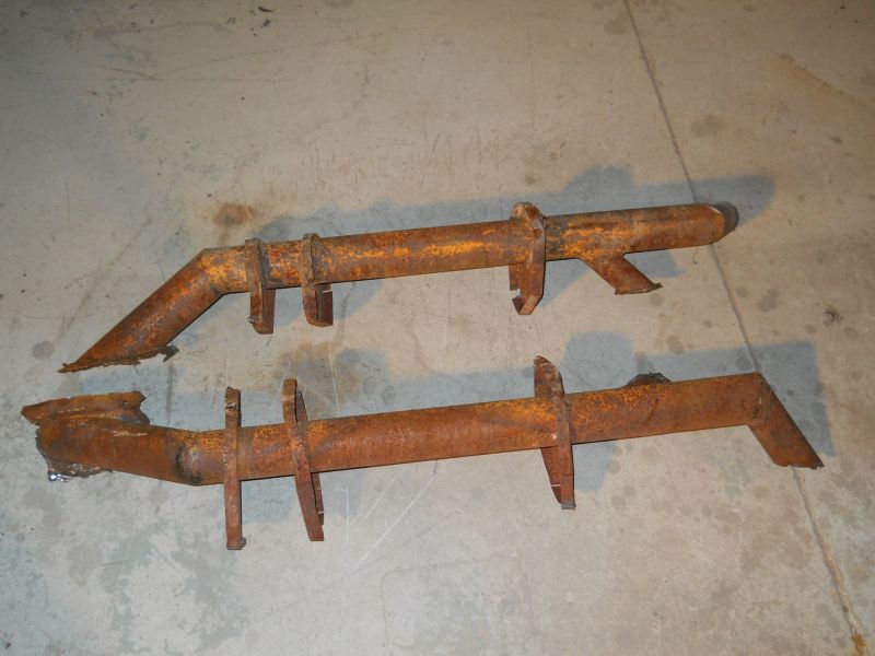

                      Replacement tubes got here on Tuesday. Guaranteed to be solid.

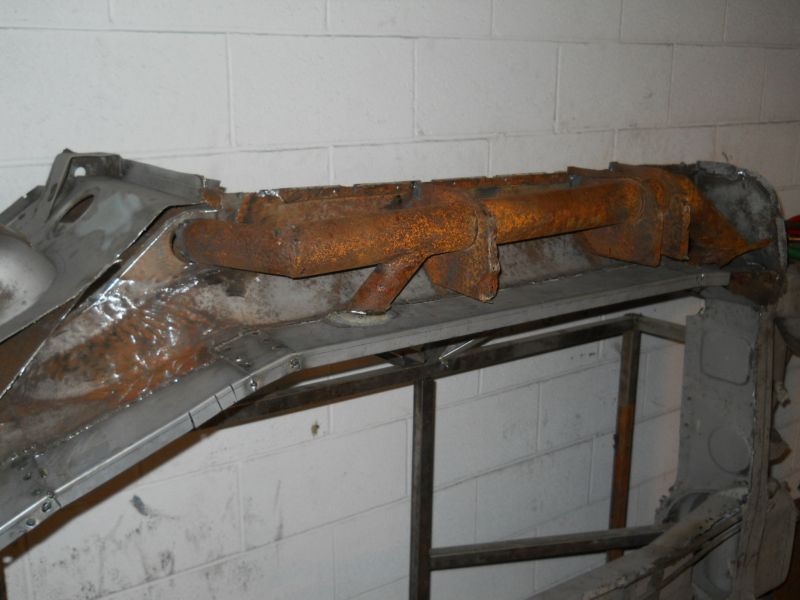

                      Actually they are pretty good. I think I can even salvage the original bulkhead supports.

                      But first an acid bath to get them all clean.

                              Here is my MIG welder:
                              Its a Millermatic 251 I bought used-almost new about six years ago for 1,250.00 I settled on this one for two reasons; its has tons of fine adjustment settings for heat and wire speed for welding thin gauge or just "thin/rusty" sheet metal which is par for the course on any 356. Secondly its big enough for welding heavy gauge frame and tubing as I sometimes do. I at first bought the smallest gauge wire which was I believe 020? It was too thin, If I put any volts to it for penetration it burn and "ball-up" at the tip. I had to drop the heat but the welds were just not hot enough. I went back up to 023 and it gives me exactly what I need for joining 19-20 gauge metal. Yes, through the years I have developed a feel or acquired technique for welding pitted thin metal. At first I'd just blow through and get really pissed and frustrated; now I've got it down where if it attempts to blow out I quickly pull back as I do there is a yellow/orange blob on the end of the wire and before it cools I finesse the trigger and re-introduce it into the forming hole and plug it. That's one little trick I just learned by doing. Hope that made sense. Anyway this machine gets me by but I do want a TIG at some point as well.

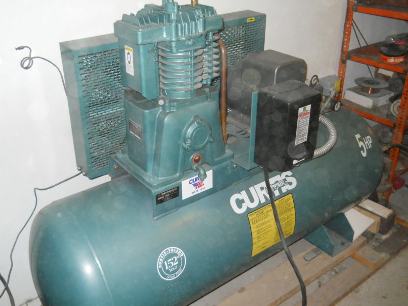

                              While we are on the subject of equipment here is my "other arm" Its a 5HP (rated@5HP) Curtis I bought new right around the same time I bought the welder as I was setting up shop. Growing up my dad always had the cheapie 2 or 3HP compressors that could not keep up with any of the tools or spray guns. It was always very irritating and I promised myself when I had my own place I'd have a good compressor. I Did my research and spoke with a dealer and found that a quality 5HP was all that I needed for a hobby shop. I bought this one for 1,500 from an Ole'boy down south who was a Curtis dealer. I spoke with him on three occasions and it was always very funny and entertaining. Right after I made the deal I later read that when you buy a compressor just because it says "X" Horsepower doesn't mean your getting "X" Horsepower. Example when you buy a 5HP compressor you have to make sure its "rated at 5HP" Its a slick deception on the part of some manufactures. Needless to say I got right on the phone to ask him if this was a legitimate 5HP unit I was getting. His response still brings a smile to my face (you have to imagine it with a heavy southern drawl)" oh no, its a full 5HP rated at 5HP, You're getting a man, not a boy".
                              Anyway, it too has been a great asset; not a hiccup or a problem in 6 years and it easily keeps up with all my grinders. Justin

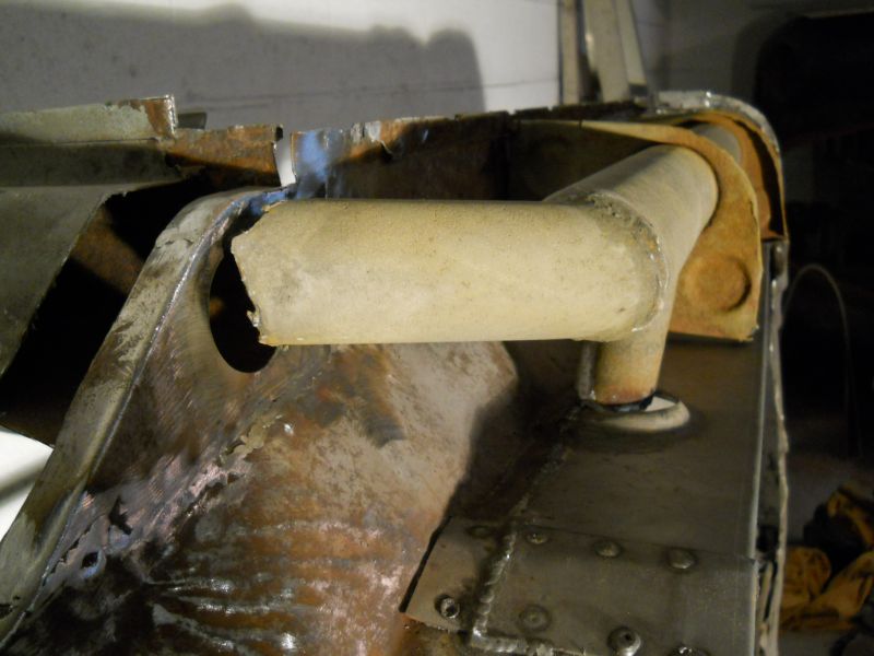

                              • 7/28/13

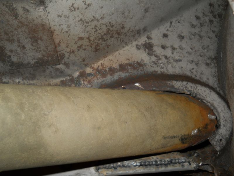

                                New tube 90% clean of old rust. Tube ends cleaned of old weld and flange metal. Trial fitments begin.
                                As expected this end is shy and will have to fabricate an extension.
                                Both tube end and frame opening have been cleaned and prepped of scrap pieces.

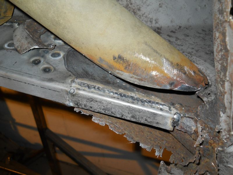

                                This new tube had enough of the old section still with it to show me that the inner repair flange I did was turned 90 degrees at the bottom. An oversight on my part. New flange added here. This will be double thickness once complete.
