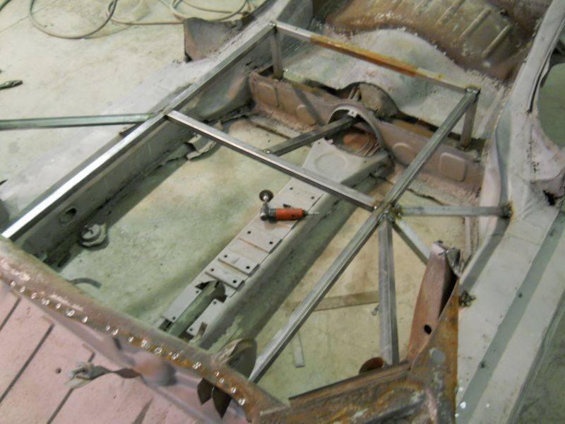

        Finished up my sub-frame jig and am now addressing the battery box. Todays progress...

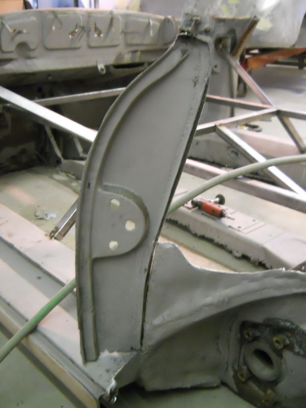

        Went ahead and finished removing the old coupe striker plates. This conversion will utilize early T1 speedster high striker doors so off they came.

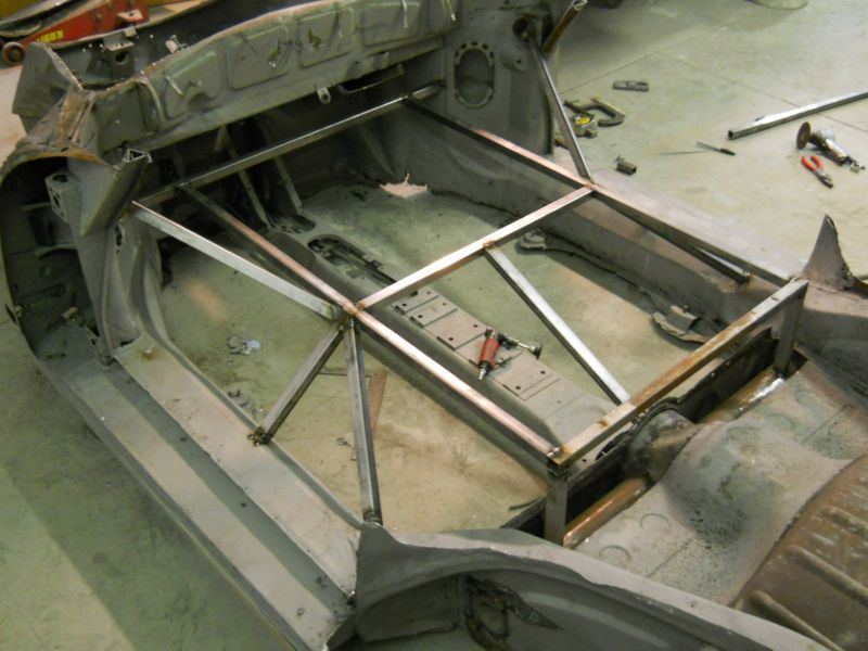

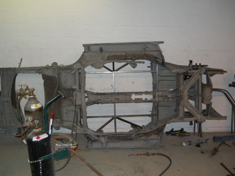

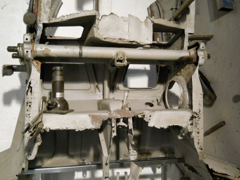

        Jig is now finished. Though I could have gone further it stabilizes the chassis sufficiently and most importantly it will be clear and out of my way while I work.

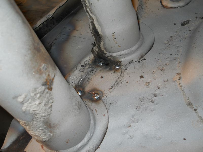

        The tunnel is just hanging on by a thread so I'll go ahead and remove it too. Having this thing out of the way makes new floor installation so much easier! A possible clearance problem in the future might be the center out rigger blocking the new floor from sliding in but I'll cut one if I have to. By then both longitudinals will be fully rebuilt so it won't be an issue to cut one.
        One more tie-in was added to the rear torsion tube housing. Its out of my way so it can't hurt; only help.

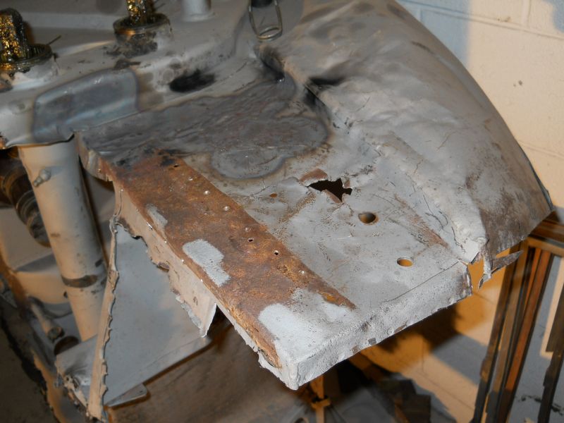

          The right side did not fair quite as well and was crunched pretty good on this corner.

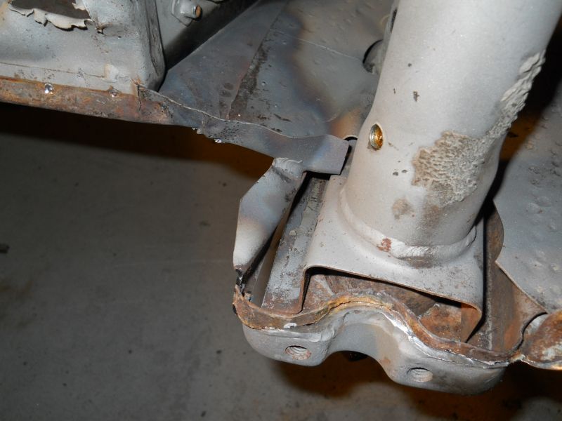

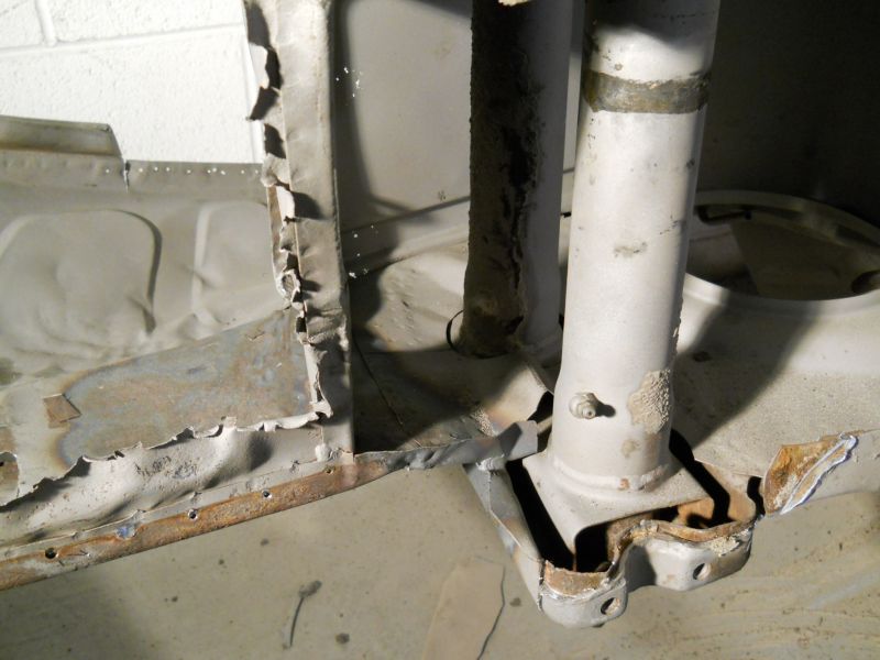

          Fortunately there is no sign of damage or deformation behind the suspension. Thank God!
          Have to make a decision weather to save this closing wall or replace it. The bumper bracket mount I can definitely straighten and save.

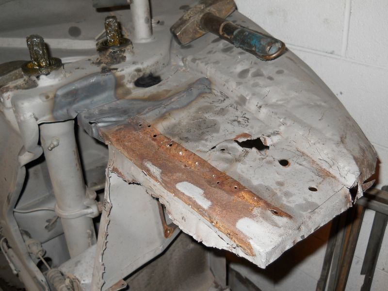

          Both upper and low front bulkhead closing walls will be replaced. Someone got locked out of the trunk it seems and shot thier way back in through the hood.

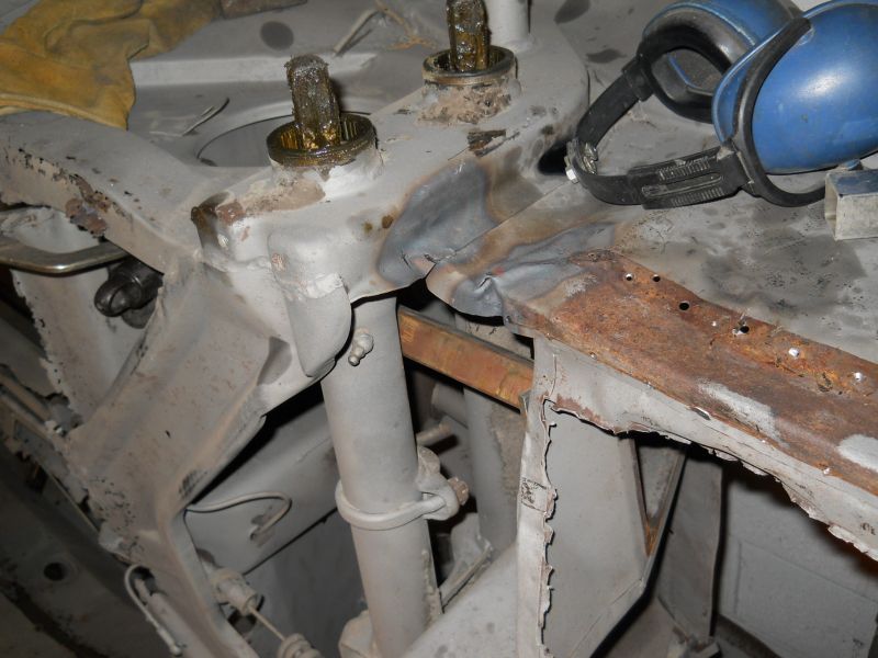

          Removed what was left of the front wall today along the lap joints. Too rusty, crunched and shot full of holes to mess with.

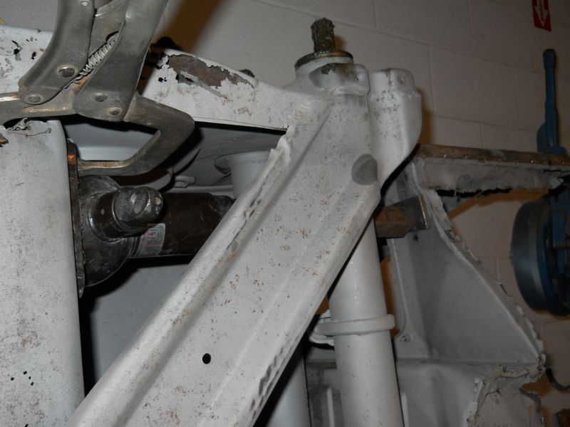

          I think straightening this will amount to the same amount of effort as replacement but will access it further tomorrow. Note the curled metal between the torsion housing. Thanks for stopping by! Justin

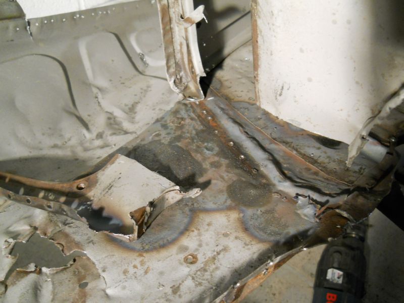

              Addressing old collision damage on the right side battery wall.
              To better asses if I'd save or replace this wall I had to get the old bumper bracket mount out of the way first. Drilled the spot welds and splitting it back apart here. The bracket is not rusty or weak so I'll definitely straighten it back out and remount.
              Bracket removal gave a clean look at the damage. Again the wall is not rusted or weak so I'm going to try and save it. Replacing it would be just as much work by the time all the spot welds were drilled to get it free again. I'd rather spend the time and fix this one.

              Along with some torch heat and a heavy hammer I also needed to apply forward pressure while I beat on it. I don't have a frame dozer though I could not use a frame puller anyway considering how delicate this frame is at the moment. So you just come up with solutions with the tools you have on hand like this bottle jack. Once clamped into position it does the job beautifully.

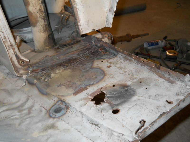

              repeated heat and hammer blows are beginning to iron this piece back out. I could not do this cold, not only is this a tight space on the inside but its double walled and also lap jointed in this area. The jack ever so slowly crept outward so it is submitting.
              Another solid session to put in here but its headed in the right direction.

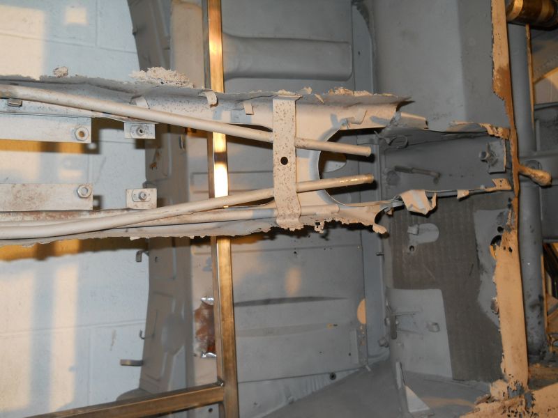

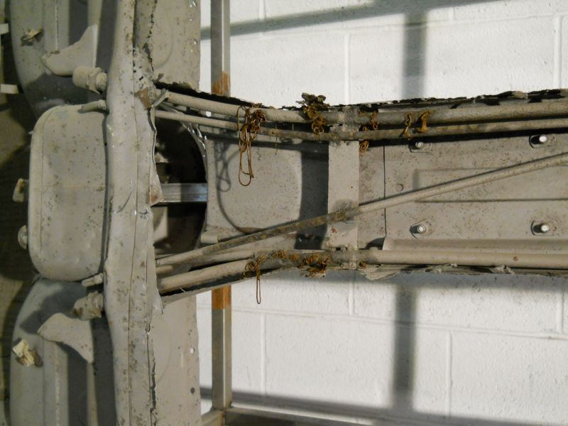

                  Only had an hour to work on it today so I removed the remaning brake/tunnel components and the diagonal brace.
                  Brace is completely gone at the toeboard bulkhead and offers zero stability. Its only in my way as I try to iron this right side wall out so I cut it free today.

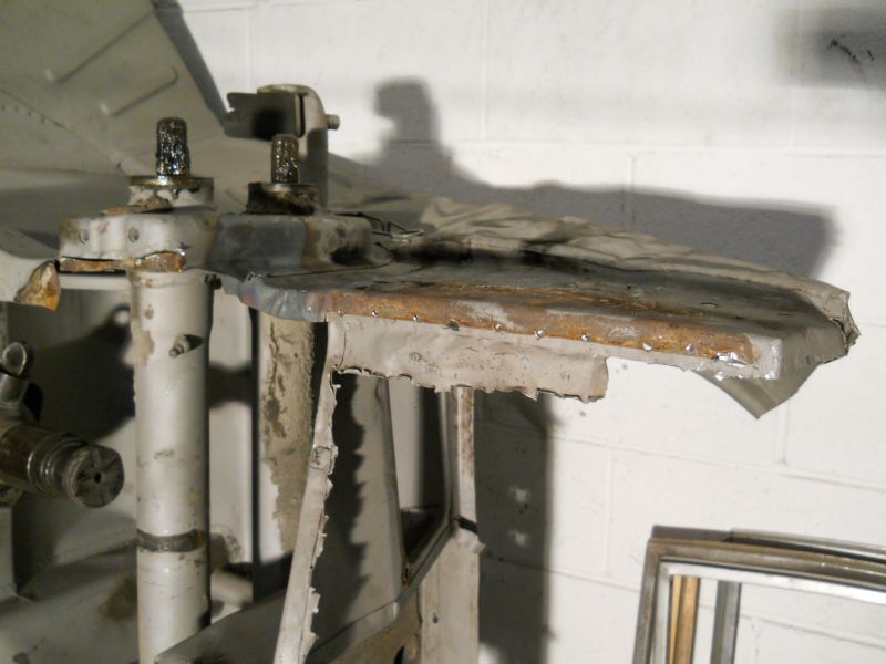

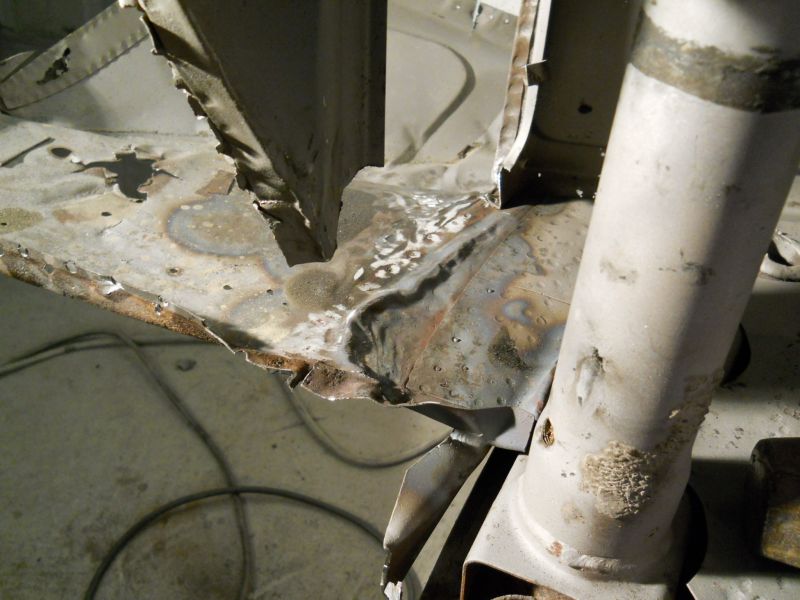

                    Had just a little over an hour to play with this today. Applied more heat and hammering to get the kinks and stretched areas closer.
                    Mainly worked this area ahead of the rear inner bulkhead wall. It was kinked hard in front of it so it took several passes

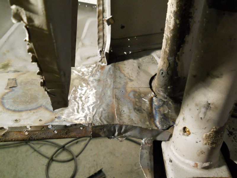

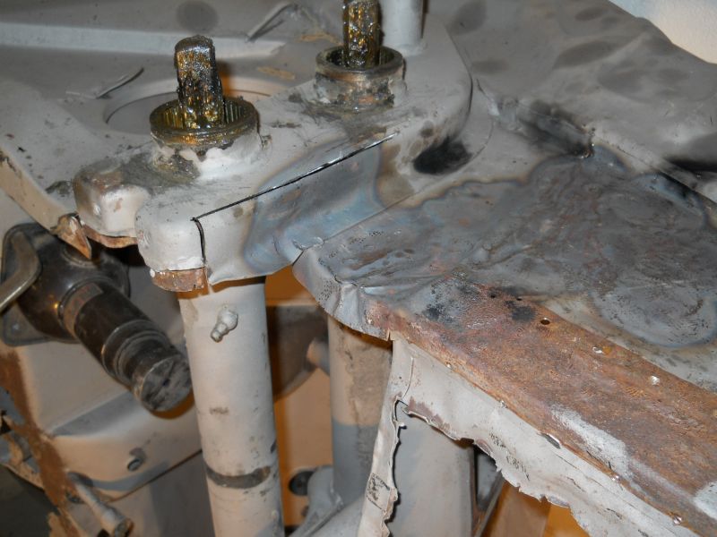

                        Right box wall repair Continued.
                        The rest of my hammer blows will be downward so I thought it best to flip the chassis over and get a clear inside shot at it.

                        The progress soon ended. The horn's leading edge is now rolled back and sharper. To relax it and get the wall messaged flat I need two torches and an extra pair of hands to heat both areas simultaniously. Only have one of each so this relief cut was my answer to keep things moving and allow the wall to now flatten out.
                        With the relief cut I could now return to that buckle.
                        With the buckle now out you can see how much forward movement I got out of it by the new width of the relief cut. Once the wall is finished and stabilized I'll go back reheat the horn flange and stitch it back together.

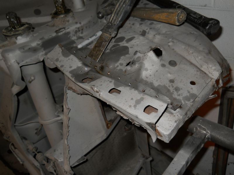

                          1/10/13 Part 2
                          The buckle was now level between the tubes and I began to beat the wall out level between the horn and the bulkhead wall. A stubborn ridge remained right behind the bulkhead run. I could only get light glancing blows on it and was going nowhere fast. My only option was to remove the outer portion of the bulkhead to expose this area and give me a clear shot at it.

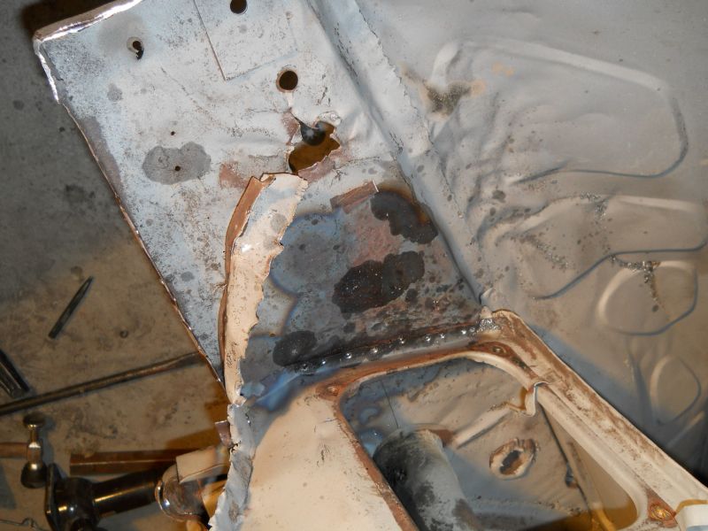

                          Didn't want to do this but again left with no choice.

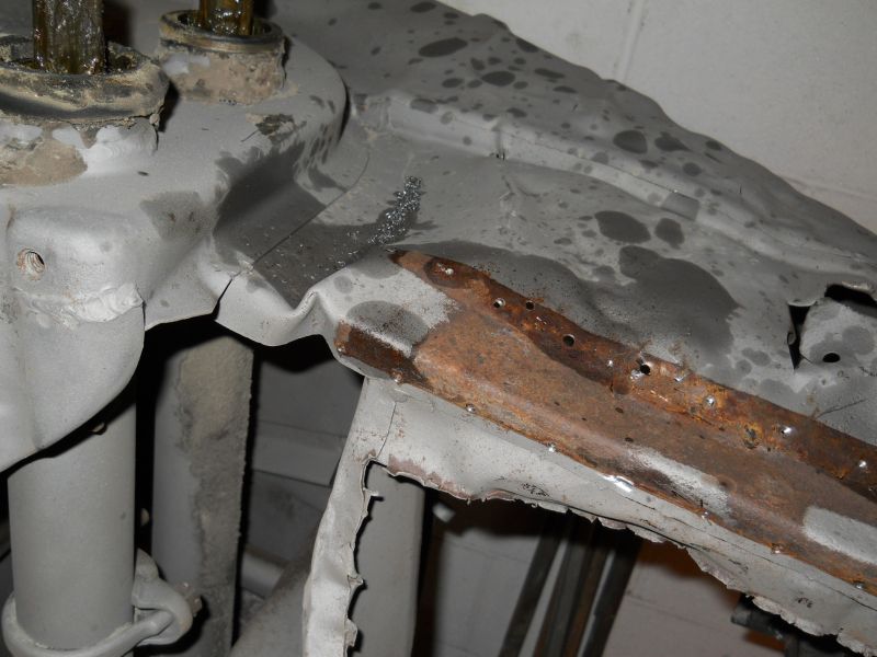

                          Now I can finish this off.

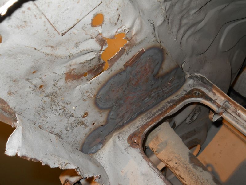

                          Finally got it all leveled out.
                          Still have a little tidying up to do on the lower flange area but the heavy lifting is done. With my clear hindsight now a replacement panel would be about the same work considering all that I had to cut and remove to get at it but it was good exercise on saving the old crap. Thanks for reading this! Justin

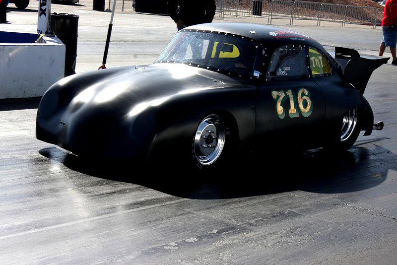

                              Its a T6 coupe with a fiberglass "A" front end. Amazing how quickly it can morph into the A of your liking with just a nose job. Now If you wanted to go just a step further to complete this picture I know you can buy either an A or BT5 Coupe roof clip with the smaller front and back windows. Its just sheet metal don't be afraid to cut it up. Some food for thought...let us know what your up to with it. Thanks again for reading this build post! Justin
