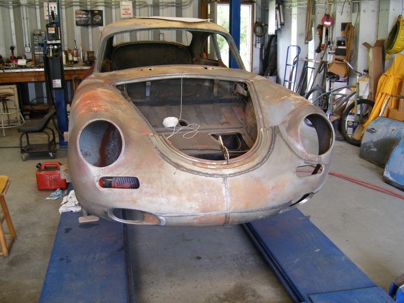

    Glad I didnt cut off the original gutter at the front of the hood opening as the new one is not even close.
    Looks like I will have to do some extra work fitting it around the old one.

      Looking good Brock! Smart saving the trough; you know very well that the repro stuff never fits like its supposed to.
      • #78
        Very sensible Brock keeping the gutter. All these ' tricks ' by guys like you and Justin etc, are very valuable to guys that don't know them. I guess the motto is: think about it, think about it and then start cutting!

          Thanks guys but I cant take credit for being smart. It was pure accidental, my plan was to grind the spot welds off after the rest was out of the way. When I put the new one up I saw it was way off.

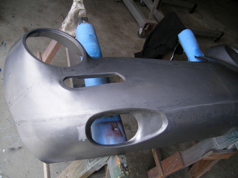

                            Here is the nose after a light spray of Ospho
                            (no telling how many gallons of this stuff I used!) It will not re-flash unless it gets washed completely off. I have not tried the CRC but I have used Gibbs brand, it will also wipe clean when ready for paint. Several high end metal guys from over on the HAMB use it and thats where I found it.
