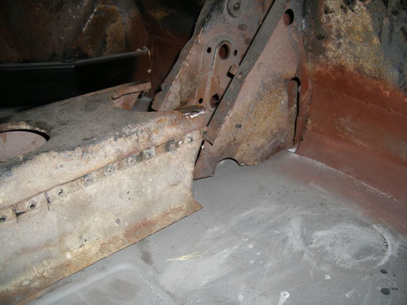

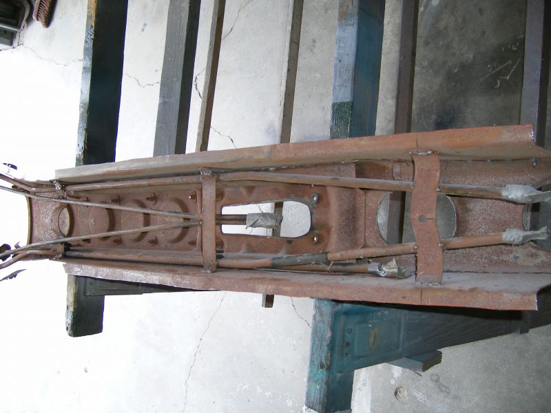

        • Started working on the tunnel, the PO had welded home made sides on it. He overlapped them some but its ok. Two things, does anyone know what the two smaller tubes inside are for? Throttle?
          The bigger ones with threads are for the parking brake cables,then there is one other for clutch?

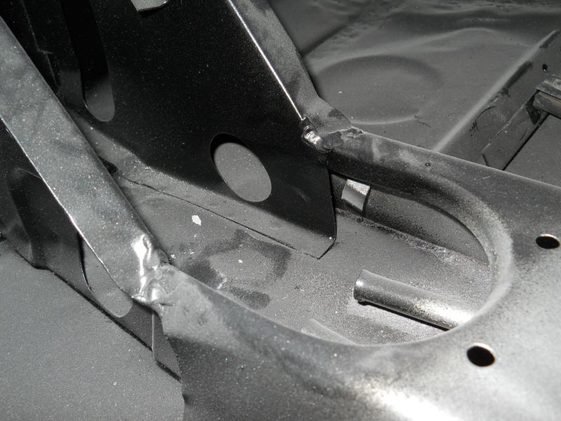

          Also how was the front attatched to the angled fire wall brackets?

          • Not that familiar with 60 model but my guess would be heater pull cables.
            • I think you are right Erik Thanks!!
              60 Coupe Outlaw Project

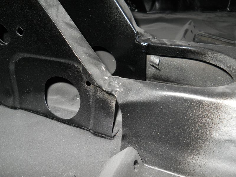

              • Hey Brock,
                Yes, Erik is right those are the heater cable runners. The tunnel and the incline bases are only joined up top and are not really connected completely. The tie-in with the floor is where the strength comes in. here is a detailed shot of mine. This part didn't change much in the B series.

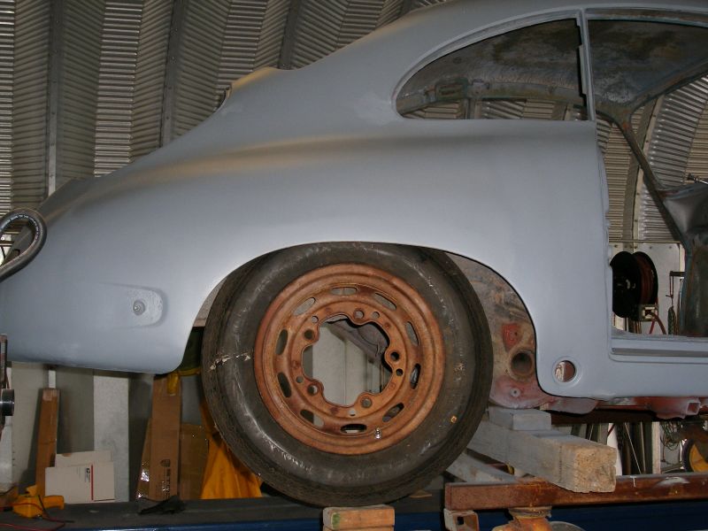

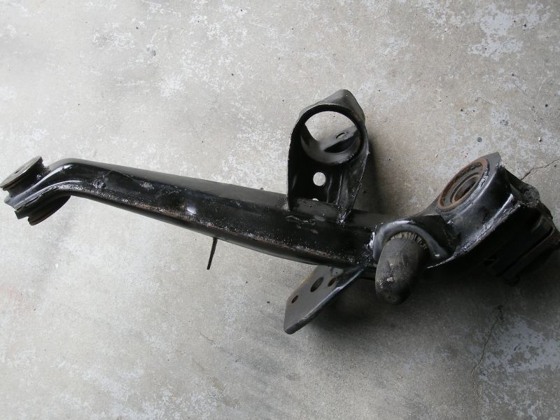

                  • Started messing with the rear trailing arms yesterday. Did this mockup and quikly saw that the straight arms would hit the frame rails way before the axle centered with the wheel.

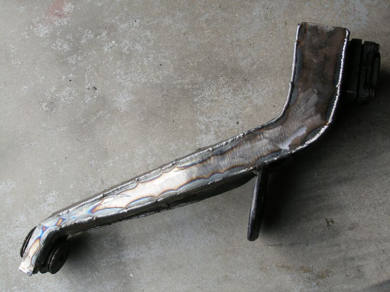

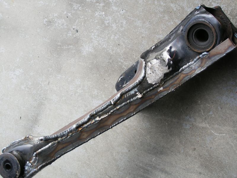

                    So instead of cutting the rail I started to mod the arms. I gained 2.5" of extra clearance with this notch.
                    Arms went from this
                    To this
                    Still a little ugly and have to box the end and later place a lower shock mount but I lost 1.5 lbs doing this.

                    • Making progress Brock! Just an FYI: whenever you weld long expanses on arms or axle housings like you're doing its almost required that the part be mounted in a holding jig or fixture. The heating and cooling no matter how slow will more often than not tweak the part out of shape. I remember a guy gussetting a ford 9 inch housing in the 90's without a jig. He took his time but it still warped and after it was done the axles shafts were all bound up and would no longer spin freely. So if you get your mount tabs in the right position on the torsion housing and then run into alignment problems with the arms this maybe be your cause.
                      Again just some advice I've learned from over the years.Keep at it! Justin
                      • Thanks Justin, it was welded to the steel table.

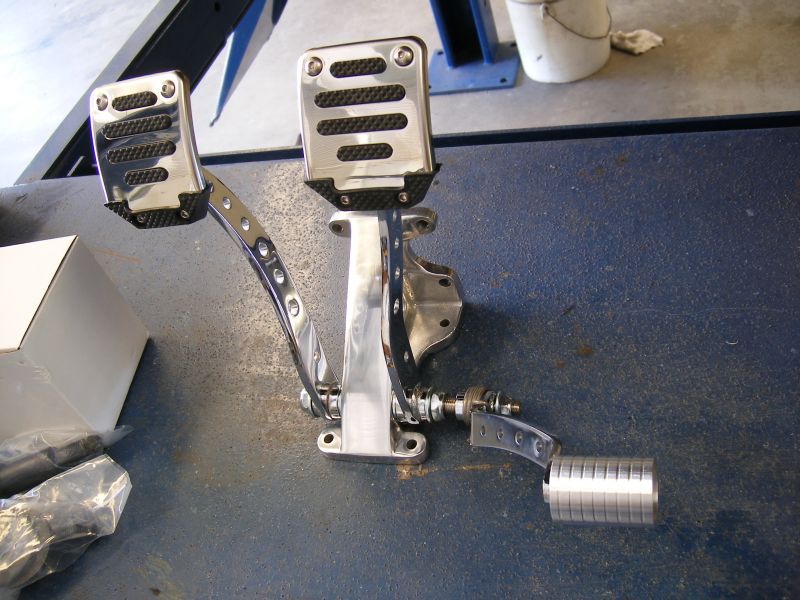

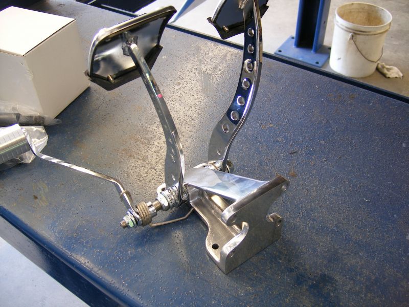

                        • Been waiting on parts, the pedals showed but not real fond of the pads on them but they can be changed.

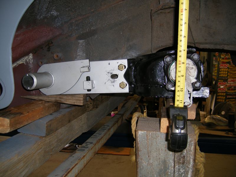

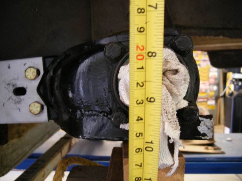

                          The adjustable spring plates came so I could re-test the trailing arms.
                          With the arms in this position a 15" wheel would be about 1/2" below the top of the fender opening.
                          BUT the suspension would ALMOST bottomed out so this would not be ride height but I gotta start somewhere.........
