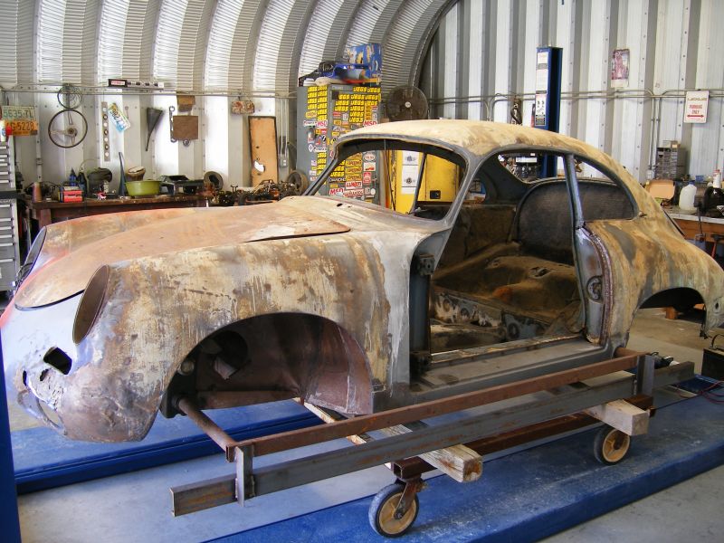

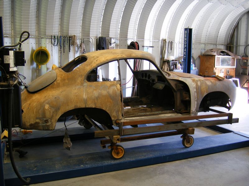

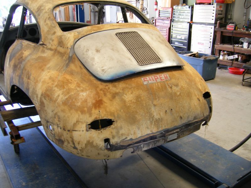

    Well after some time away I am back with a new project. I sold the rusty 65 and just got a 60 in that has had most of the lower metal work done. Looks to be originally Aetna Blue not sure of the interior color. It may need the new nose that came with it , not sure if I can save the original or not.

    Hey Brock, Welcome back and thanks for sharing your build! I'm glad to see that you got into a more sound chassis. Other than the normal rust, the body looks like its never been hit hard. What's the matter with the front end, just more rust or collision damage as well? Looks like your applying an acid to clean the surface rust on the body? Tells us about your custom plans for the car. Looking foward to watching you progress.
    Thanks again for posting! Justin
      Hey Justin, the nose has been hit on the left side and now also rusty and badly repaired long ago. Someone scabbed a headlight bucket in it and its all screwed up. The body was bare metal when it left MN but lots of bad weather between there and here left it rusty again.
      Pretty much still going Subaru 2.0 N/A but with a VW style Pro Street/Freeway flyer transmissions. Stiffin up the frame and a formed to the roof line cage. Disc brakes but the wheels and bolt pat. are up in the air. Oringinal Aeta blue with Brick color int.

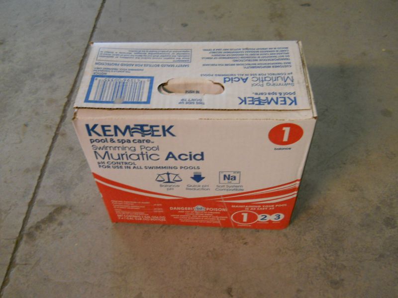

          Just a quick tip: for the flash rust on the body head down to your local home improvement center and pick up a couple gallons of muratic acid pictured above. Just brush it on and should almost instantly clean the metal. Once done make sure you wash it all off ( prefer soapy water then a final rinse)and that it is 100% neutralized otherwise it will create more rust itself. Towl dry the area then blow it dry with an air chuck. The metal may "flash rust" yellow/gold in places afterward but a scotch brite pad quickly cleans that up before primer. I love this stuff and have used since the beginning. I bathe small crusty parts, hardware, brackets, bolts you name it and all done passively while I work on other things. Hope this helps. Justin
            Curious about the Subaru motor also. I haven't found anything on one being used in a 356 either. Brocks will be the test vehicle for us all to see, can't wait.
              Thanks for tip Justin, that stuff is kinda hard to work with but I will check it out. I have used Ospho before but not the straight acid.

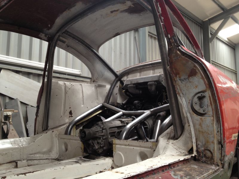

                      Real 356 body, full tube chassis with Subaru motor. Ric says he has more photos and detials of this car; maybe he'll post a few up if he has a moment. Thanks! Great thread! Justin
                        Now looking at the powder blue car those must be the coolant tubes for the radiator in the fenderwell...?
                          I was thinking they were oil lines at first but after finding out what is powering this car I agree they must be water lines. No openings for the radiator(s) to get a direct flow of air?? If it was mine I'd have some mean looking openings for them. Justin
                            Thanks for the pic Rey, real cool cage work! The blue car I have seen before but I had been under the impression that it was a late model VW inline 4.
