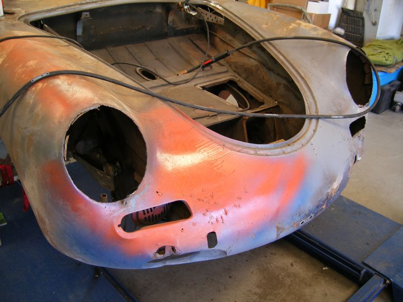

        Knocked her eyes out, no way in hell Im paying $180 each for the buckets .

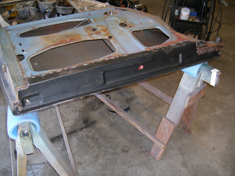

        Started putting the bottom in the driver door. Going to get the outside patch in tomorrow I hope.

            Fresh door bottom looks good! Ready to cut the nose free it seems...
            Stay on brock!

              Thanks Justin, as soon as the doors are done the nose comes off.

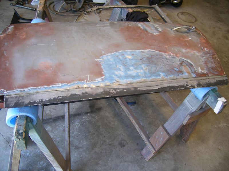

                Got the outter on the door starting the other door today.

                  Now for the slow process of stitching it together and keeping as much heat distortion out of it as possible. This can sure try your patience! Best of luck with it Brock! Thanks for the update! Justin

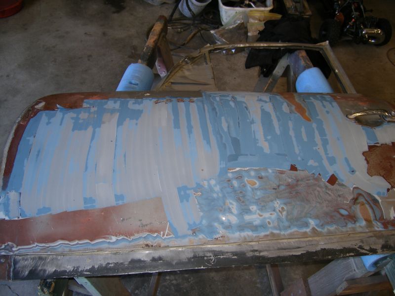

                    Not welding the outter, I used SEM Weld Bond on that long seam. Came out flat and even. If these doors didnt have the last 3 of the vin on em I think I may have found new ones.

                      Oh, you're gluing the new panel in? Is there a step flange in there for your glued mating surface? Well that takes care of any heat deformation...
                      • #71
                        Yeah when I made the outter I flanged the top edge about 1/2". Got in place and just lifted the skin a little and sqirted the SEM in and weighted it till it set.

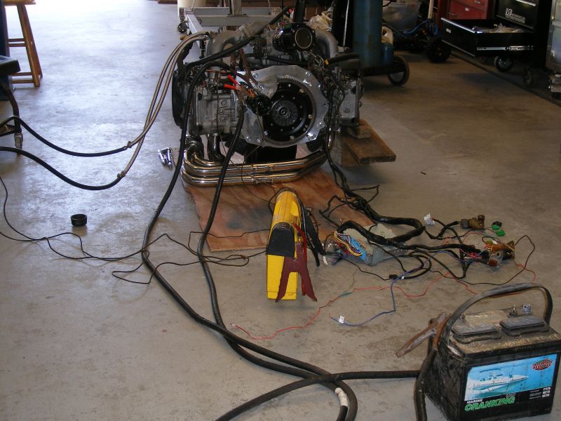

                            This mess of wires and cables all mean....ITS ALIVE!!!! Started the scooby today. Sounds great with just the header.

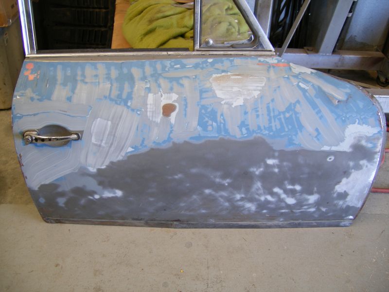

                            Got the paint stripped off the doors with the heat gun yesterday

                            Its changed alot since 67 but its home eventhough stainless will rust here. Going wide 5 disc, Empi 5 spokes,stock front arms and some type of IRS in the rear.

                              Oh man! I'll bet firing that thing up was exciting! Keep after it! Justin
                              • #75
                                Yeah it was a blast and a load off my mind to know it worked. Vid coming asap.....
