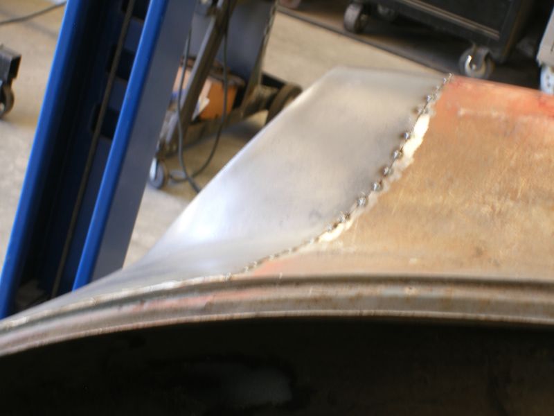

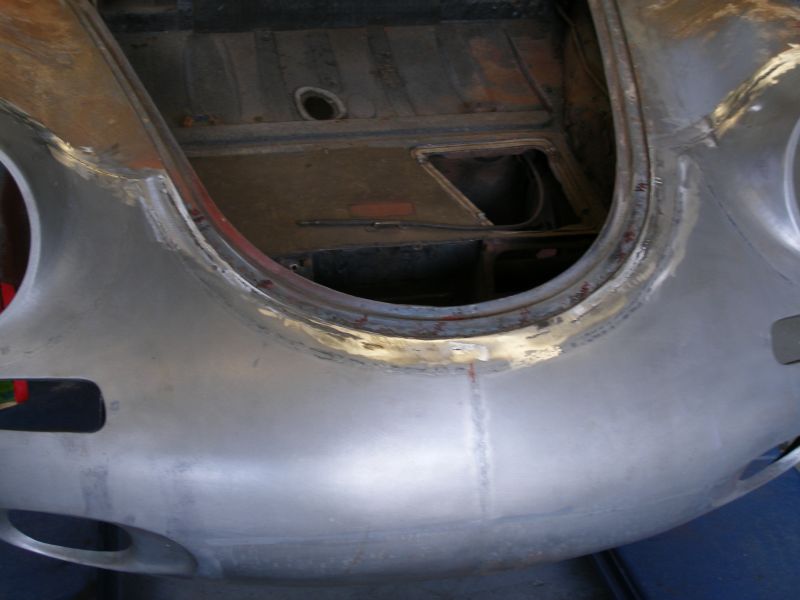

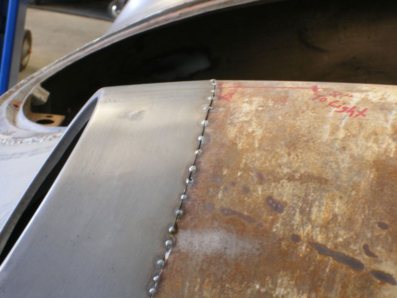

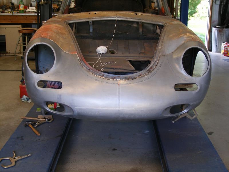

    All tacked in,all butt welded.......

              Got it fully welded and mostly ground off today.

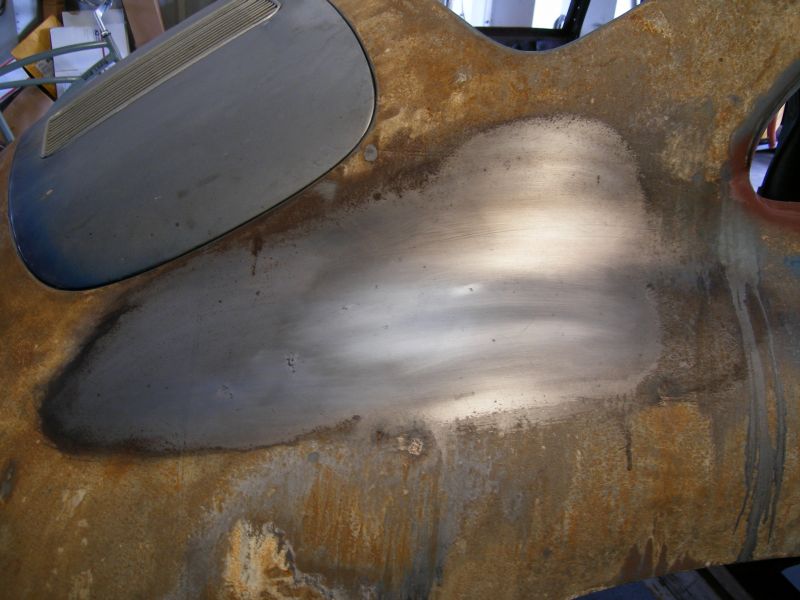

              I wanted to see how well Ospho and some scotchbrite would work on the body,came out good.

                  Looking good Brock! You're really making some headway on it. The Opsho does a nice job on that flash rust...

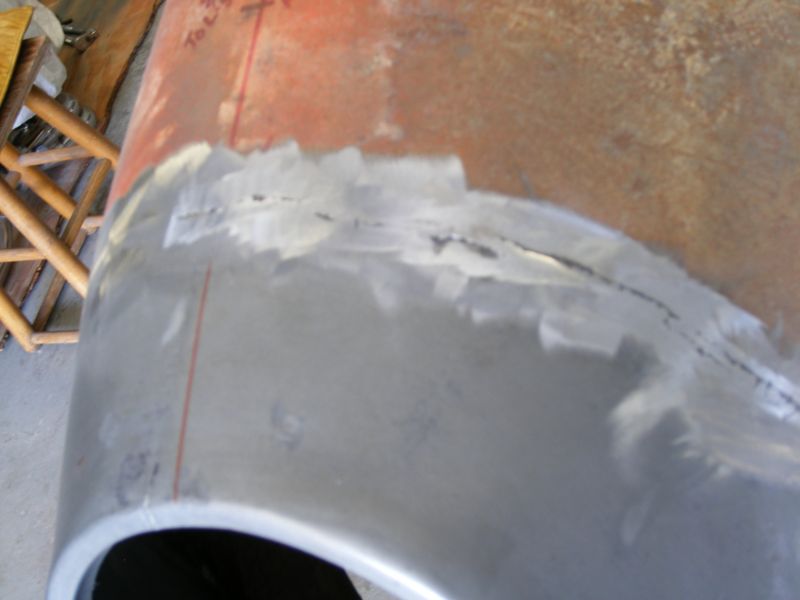

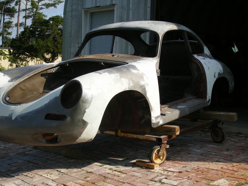

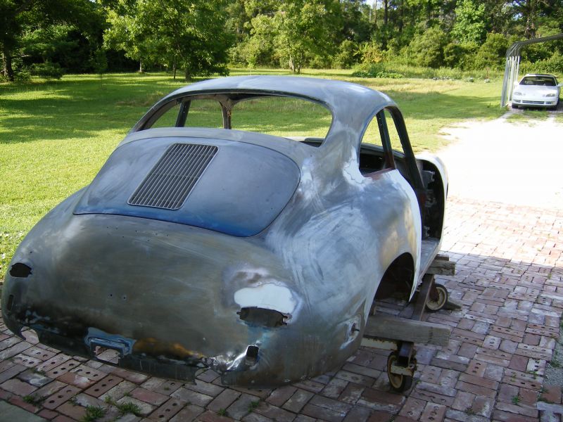

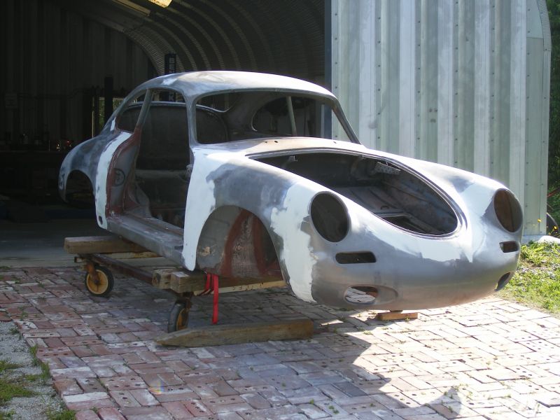

                          • Well the second most dredfull/hatefull non mechanical job you can do on a car in the summertime heat has started......SANDING FILLER!!
                            Been starting at 7am to beat the heat and sun and the Rage has been flowing freely . Been a while since I had to do this and my arms are KILLIN me! My air file took a dump so its all by hand.

                            • Thanks for the update Brock. Amazing transformation already with the new nose and the flash rust cleaned up. The body is actually in pretty nice condition. Yes, blocking the body by hand is a very good workout. Keep up the great work! Nice spread you have out there BTW.
                              • Thanks!! Its one of those the more you do the more you find kind of things. I sand and feel around and find a ding or a wrinkle,fix it find another ect ect.
