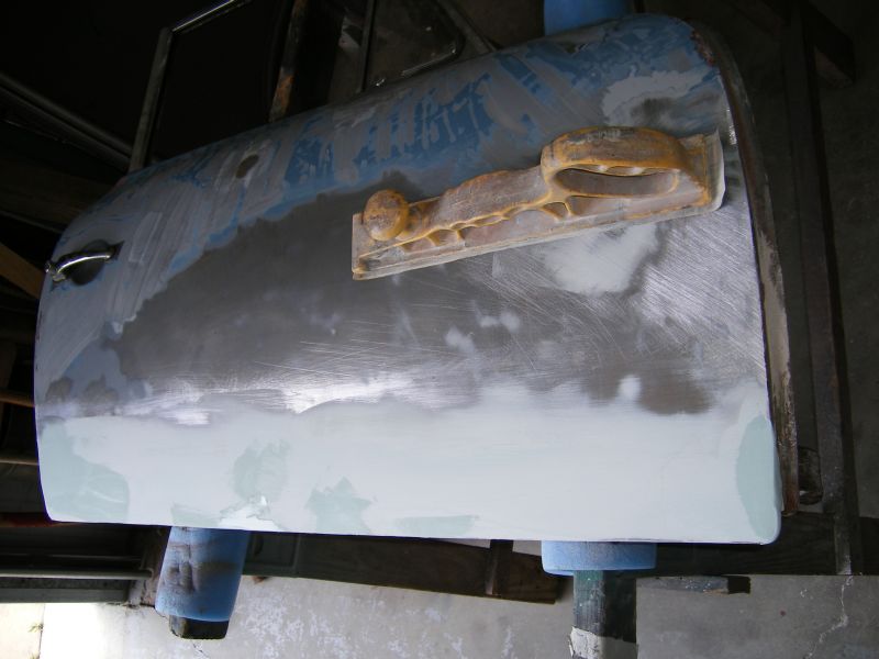

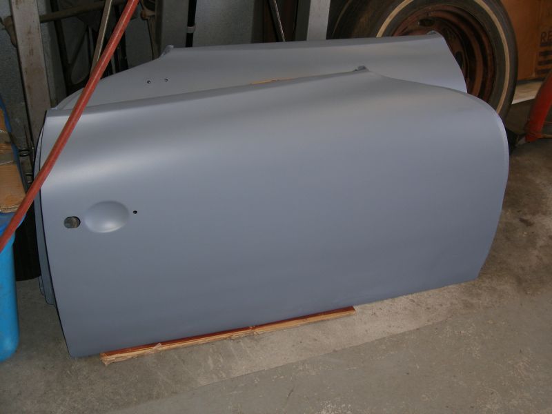

  • Been working on the doors, they are shaping up...

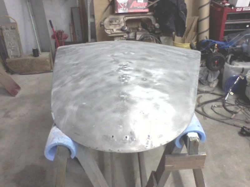

    The hood MUST have been used by Rick as a sled...I stopped counting at 50!!! dents/low spots
    Going to have to skim the whole thing
    Did I mention I am OVER sanding filler !!

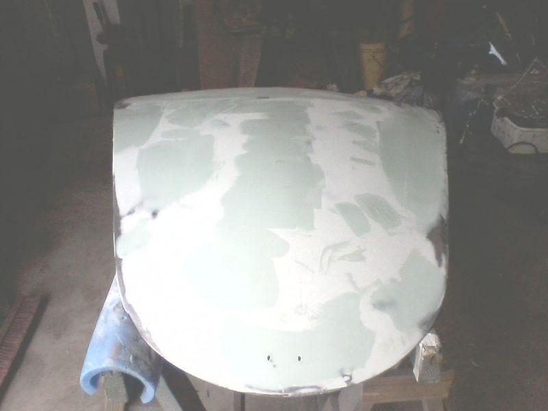

        Here is the hood after one skim and some DA work and some light re-skim.

          • Nice work Brock! I commend you for being honest in your bodywork phase. Nothing to be ashamed of as long as its thin. They ALL need to be skim coated with something to be dead-nuts perfect and straight. Stay on it!
            • Mark, The best as I understand these epoxy base bonders are water proof so they should seal up nicely as the tend to sqeeze out some.
              Justin, the hood skim after sanding is pretty thin so it didnt add much weight to the hood. I dont think the paint will be perfect so to speak but it should be nice.

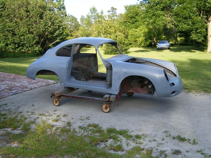

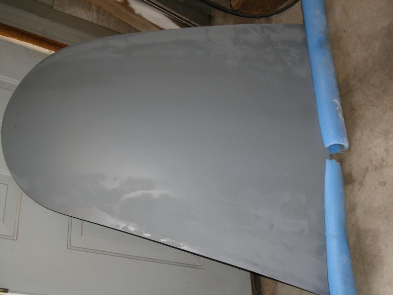

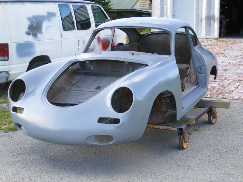

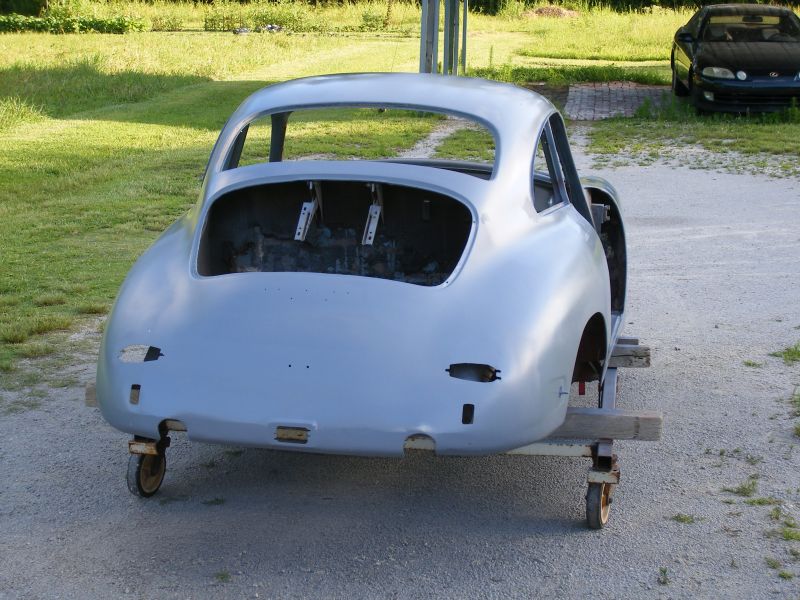

              • In primer Still a lot of sanding to do but I wont have to keep chasing the flash rust thats been getting worse with the hunidity lately.
                Taking a brake on the body work after I prime the doors and hood tomorrow so I can get going on the engine mounts.

                • Big hurdle w that primer. Need to do the same for mine to stop flash rust. That stuff is evil.
                  • Nice! Amazing how a uniform coat of color can change the outlook...

                          • Doors and hood in primer on the 4th, cut the stock trans mounts off yeaterday. Didnt do much today.....to FN hot!

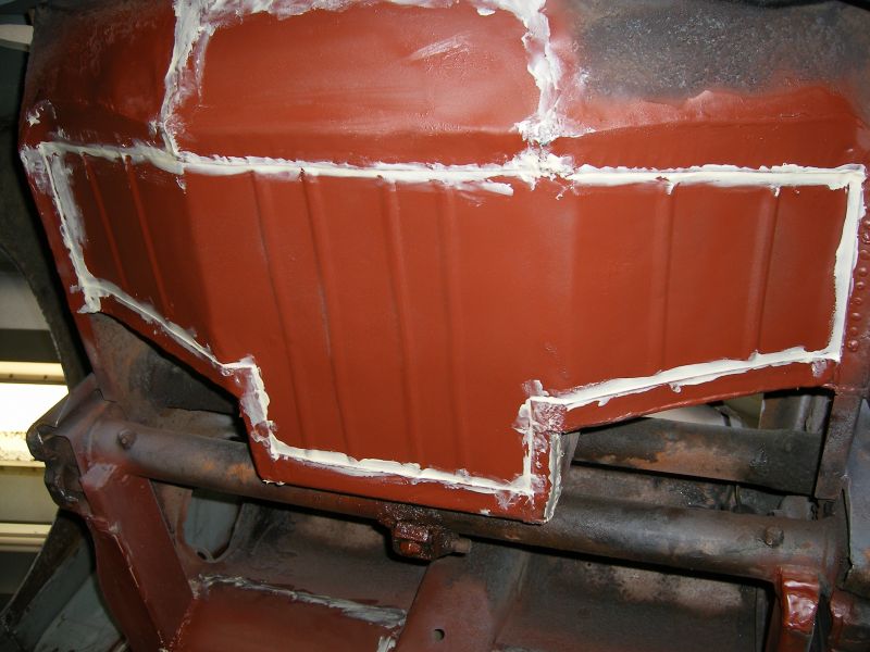

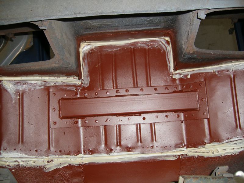

                                Got the battery box area welds ground. Osphoed and primed it, then seam sealed. Didnt do a very pretty job on the sealer but it will be covered anyway.

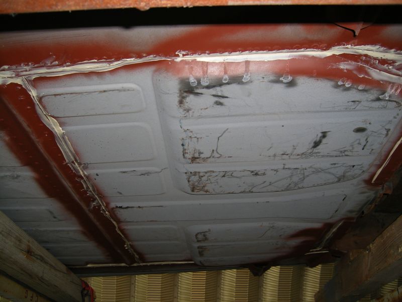

                                Also sealed the pan edges.
