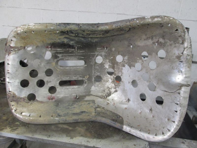

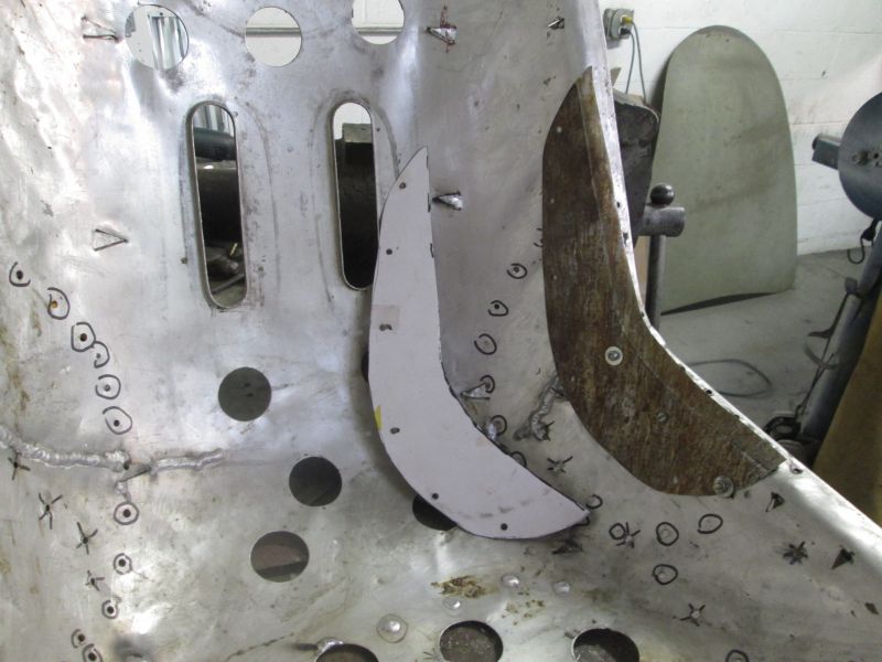

                  Getting back on seat shell repairs.
                  I'd like to have my shells redone before the years out so began the repairs again to get them ready to send off to the upholsterer.

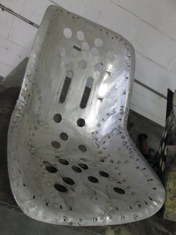

                  Though I have a lot of holes yet to weld shut from the previous owners repair attempt I thought I'd start making the steel reinforcement panels now. After some close study I believe this shell was never fitted with them originally which is probably the reason it was so cracked to shit as compared to my other shell which was outfitted with them. Someone pop-riveted their own versions out of alloy hence all those holes but I'll be copying what was originally done.

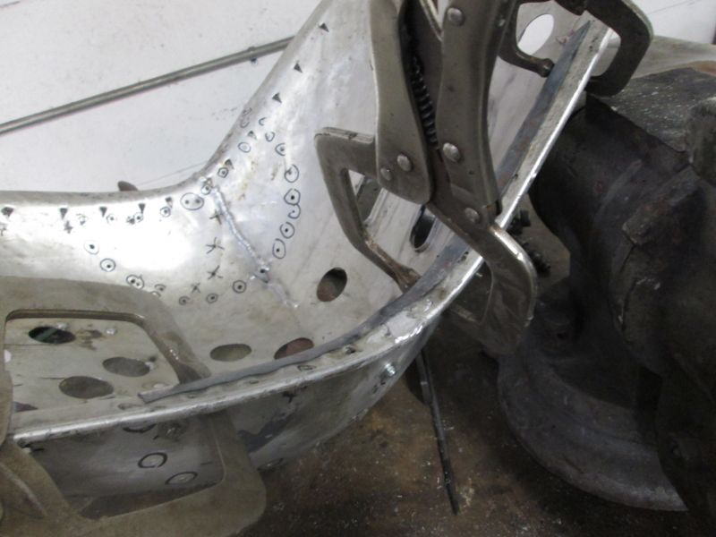

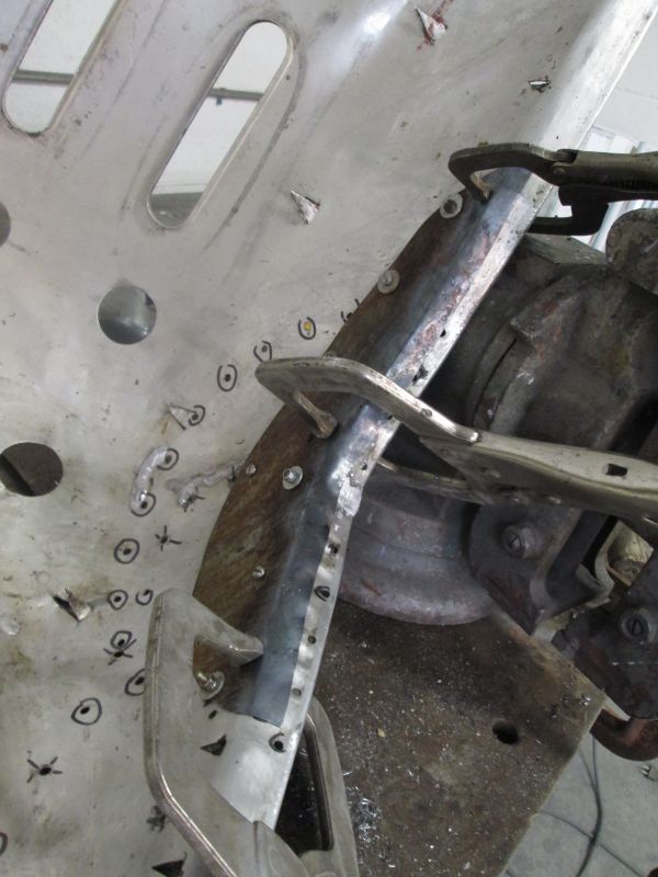

                  I'll be copying the original plates from this shell. This one is by far in better shape with cracking found only at the centers of the top and bottom edge. BTW: I'll be adding small steel reinforcement to these areas as well before I'm done.
                  paper template and basic section in steel being mounted up.
                  Synched down with screws where the eventual copper rivets will go. A little torch heat and the shell itself became the perfect hammer form.
                  To make the wrap around the edge cleanly and accurately meant I'd have to do it in sections. Besides no way could I hammer on that poor old alloy hard enough to do it as one piece.
                  Finishing out the edge sections next.

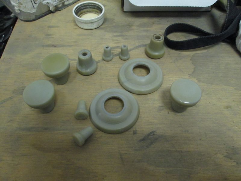

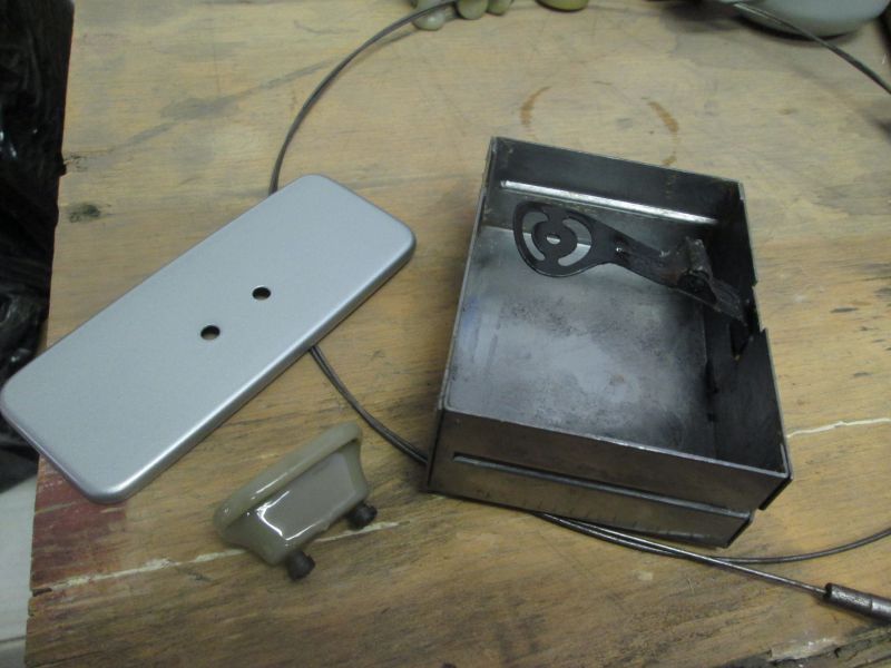

                        I'd prefer just to polish these but a few are so rotted from many years of severe UV exposure and desert heat that I had to get them encased in a protective coating to preserve them.

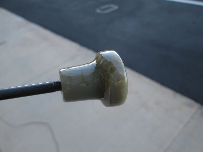

                        Like this deck lid pull. It survived 3 decades of direct sunlight through the back window but the "sunny side" was so scaly and deep that there was no way of sanding and polishing past the damage. About 7 coats of clear fixed it right up.

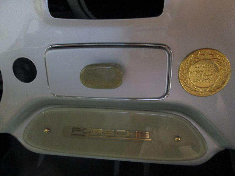

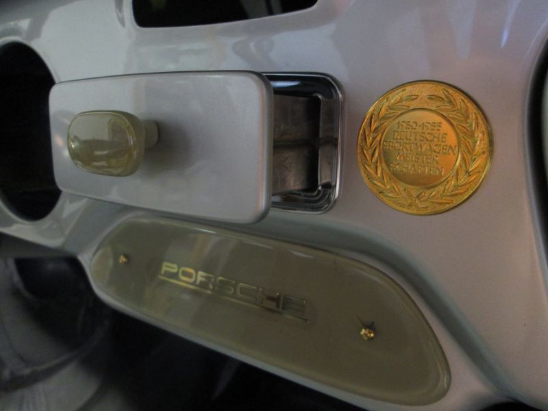

                        Ash tray knob finish allowed for final assembly.
                        Not much but it was nice to get another vacant hole in that dash filled.
                        So lucky to have found that original delete plate. Perfect color match with the car's original knobs.

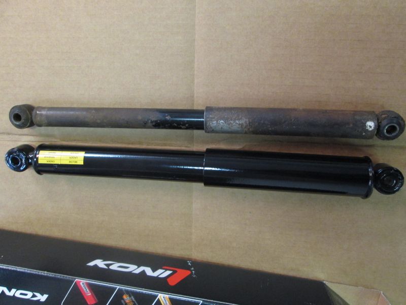

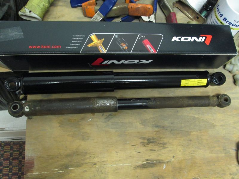

                            Stepped up and ordered the "classic koni"

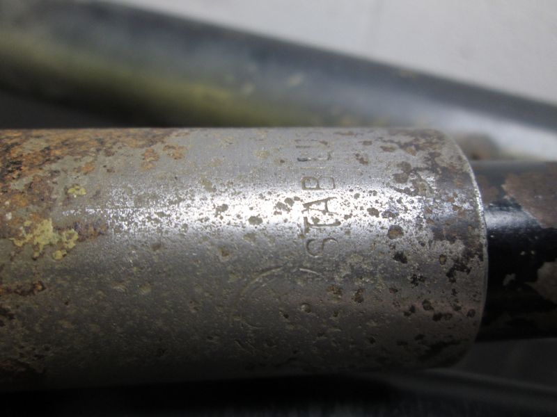

                            Its pictured with the Original (or what I believe to be the original) dampener from this car. Though the lengths are correct (as I know the BOGE's are too short) I was surprised to find the body a little bigger in diameter.
                            After removing some rust I realized its not a Koni at all. It stamped "stablus" with a few part numbers and that large circle. Maybe this skinny unit is correct for early T1 cars equipped with a VW type 1 steering box like this car? This "new Koni" is probably right for T2 on up equipped with a ZF box? It would make sense as I've found most new catalog items for 356A are geared toward the T2. Maybe Jack, Bruce or someone "in the Know" might shed some light here? Anyway, since I've upgraded to a ZF I'll mount the new koni.

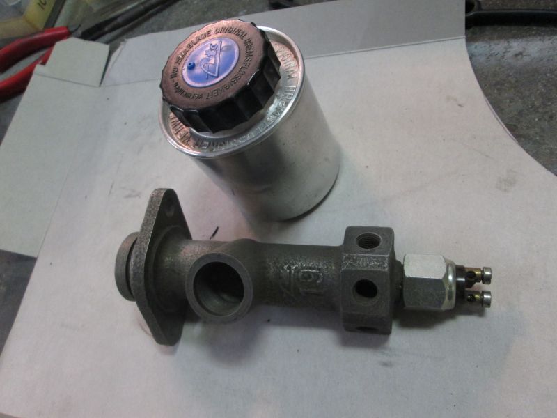

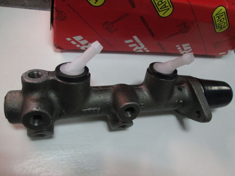

                            • 8/9/16

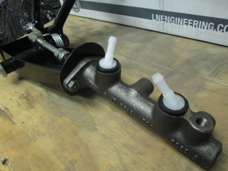

                              Dual circuit Master cylinder
                              I'm opting for the redundant safety of these units so I took delivery of brand new one today.
                              The original and correct ATE unit will go into the box with all the rest of the stock correct parts I have for this car.

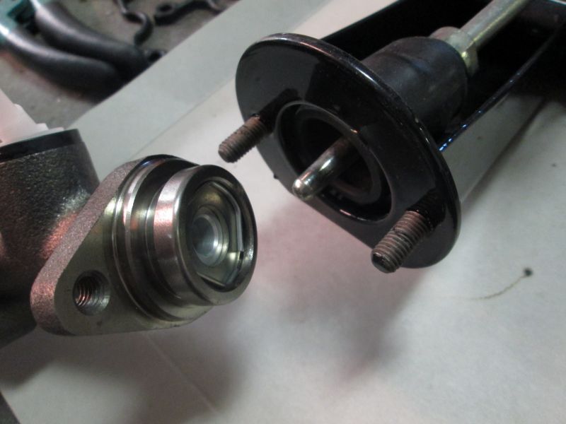

                              Arrived from Rusty Tubs this afternoon. Drum brake version for type 1 VW. They do offer this unit with a mounted tank but life will be so much nicer with it easily accessible in the trunk.

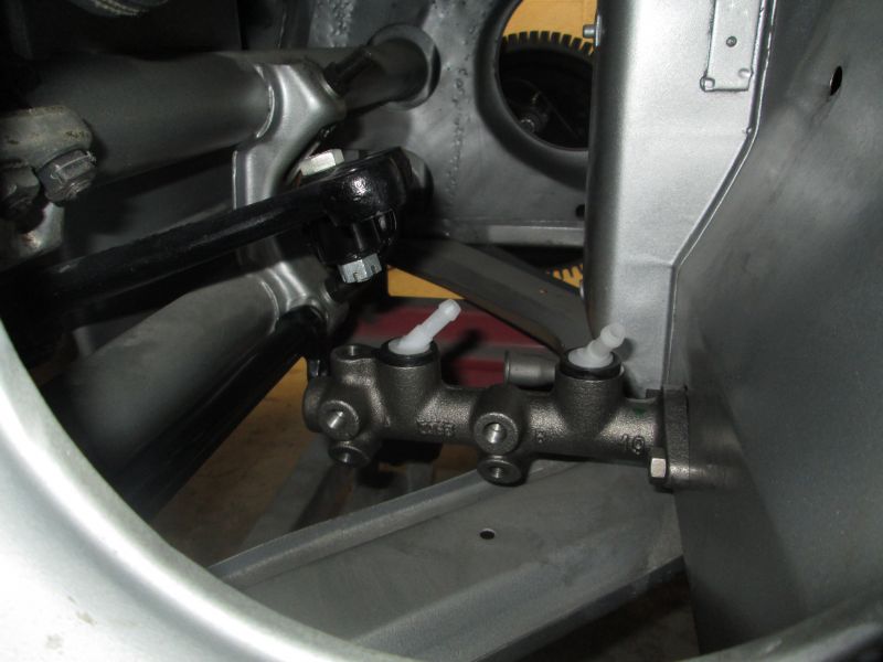

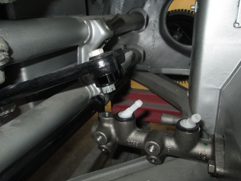

                              Pretty much a direct bolt-on but the flange holes had to be drilled out to accept the studs on a 356 unit versus bolts for the VW it was intended for. Bruce Baker recommended that I stick with a stock 19mm bore as the larger units require additional pressure to get the pedal down.
                              Once drilled it fit perfectly.

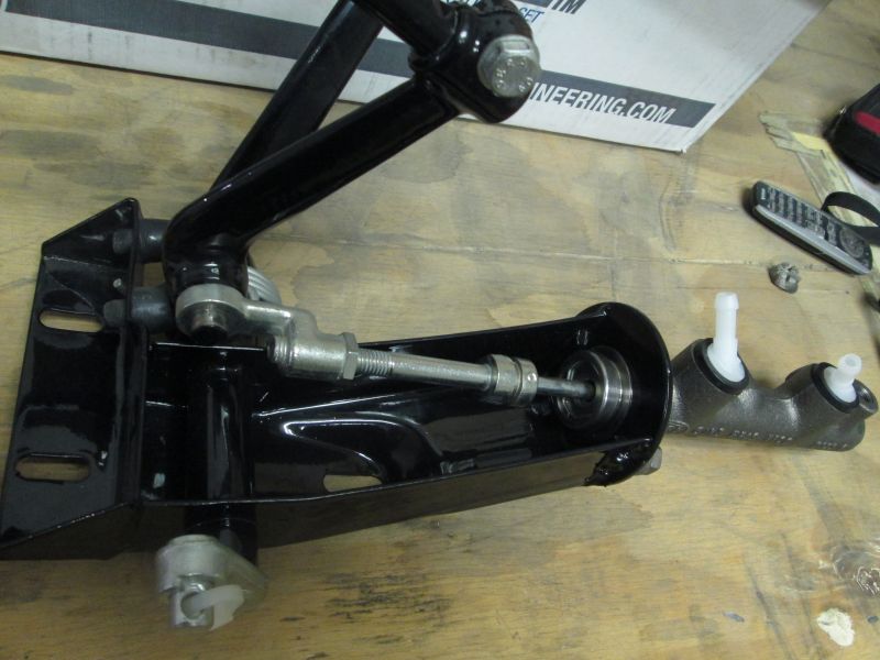

                              Time to test fit it in the car.
                              Sticks out quite a bit farther than the old one but no clearance issues so far.
                              The real work of plumbing the hard lines and mounting the remote reservoir in the trunk will be next. I'll begin dedicated thread on this conversion shortly.
