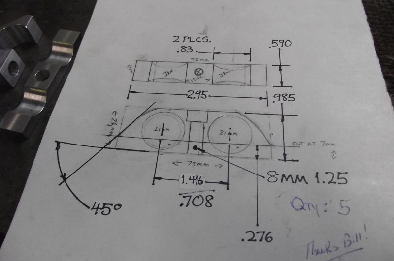

          • Hi Pete,
            Thanks again for the really nice words, I appreaciate it!
            The Setrab oil cooler I bought is thier "Proline STD" series cooler. They come in a wide range of configurations so Take a look at thier website and see which one would fit best for your B-car application.
            As for the oil clamps, again you're going to need to build them to suit. If your running the 911 oil lines they are slightly bigger at 19mm than mine.
            Here are the basic dimensions that Bill added which any competent machinest could replicate and change slightly to suit your larger oil lines. At this point I'd strongly recommend that you find a machine shop in your area that you trust. Bill is getting up there and has had a few serious health issues as of late. It took 6 months for him to complete my last job and he only knocked it out for me beacuse we're friends and I told him not to worry, just get better and that I'd settle up with him and have another machine shop finish it out. My intention was to let him off the hook but he insisted on finishing the job. Anyway, he is a great guy but he is slowing down through no falt of his own.
            Hope this helped.
            Thanks again!

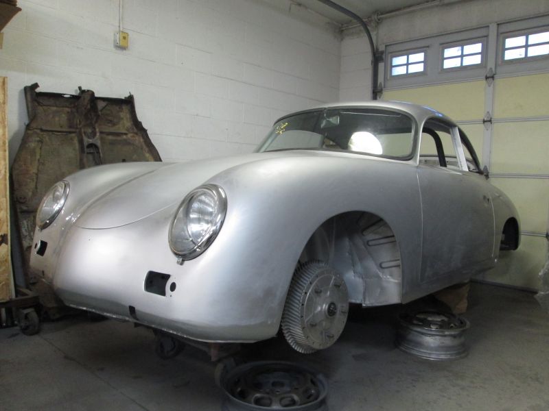

            • 12/3/17
              My cousin wanted me to send him photos of my coupe so I sent him these I took a few days ago. Then it hit me
              This paint job is officially 2 years old as of last month. The only bright side is that I haven't seen any bubbling or lifting so its stable so far.

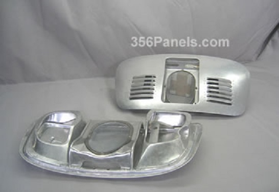

              I did recently place an order with Trevor for one of his All Alloy GT decklids and will post some shots of it when I take delivery.

              • it looks so close
                Maybe focus on getting something you can drive then add in the interior later? Unfortunately your desire to have everything perfect, which is what has ensured the quality of car, probably means you will not do this
                • Justin,
                  I think most of us the same with projects. I should have finished my utility room a year ago. Still got to tile the floor. Once you stop on a project its hard to find time to start again.
                  Once you do and it goes well, then it comes together! That's what I keep on telling myself.
                  Nothing is hurting on your car. Paint is now nice and hard.
                  • Justin I can't believe it has been two years since you painted your car.
                    Time gets away from us. Hang in there its a great project. Gordon T1
                    • Paint shrinks. Place it in the sun, get it hot and then in the shade to sand and polish. But you likely know that.
                      You likely also know that today's urethanes have a typical "window" for sanding. When I was painting, it was three days max of sitting after baking in the booth, post-paint, for a few hours (at 120*). After that, the "skin" was very hard and fine sanding was very difficult and when sanded, it was difficult to polish due to exposing the micro-bubbles under that skin if sanded too far, so be very careful...now that your window has closed.
                      I just did a silver C-2. It was painted by a good shop that ignored/forgot my condition that I inspect the details after a "cut-in" before their overall painting. Their overall painting became a very expensive primer coat. It was repainted by a 42 year old local guy to whom I was recommended by my detailer/polisher/overall really good guy. This second painter, from Romania, worked as a painter for Alpha, then Porsche, then came to the US..fluent in 4 languages, 5 if auto paint is added. He used a finer metal flake and got the silver to look just as I remember new(er) 356s to have appeared 40+ years ago...when it was in single stage baked enamel.
                      I let the car sit while doing other assembly and finding/restoring the special 4-cam parts missing when the car arrived. The shrinkage happened because it wasn't baked and the one 'paintjob' followed closely on the other, which wasn't baked.
                      When almost finished in assembly, my detailer friend made all the paint issues just disappear. There is the fine "baked enamel" look to the surface but it's shiny-like-new.
                      I wish you good luck with yours. Here is something else you already know: it takes patience and you seem to have plenty of that!
                      • Thanks Neil! I could just throw a 356 trans, a push rod motor and a drivers seat in it and tool around but you do have me figured out...I just won't do it. Probably stems from my upbringing as my Father was and still is "Mr Temporary" (bless his heart)and never fixed things to a high standard, as it was always just to get things by. It drove me crazy as I got older and its probably why obsess and take things too far in some cases but in the end I have to like it otherwise my mind gets very resistant.
                        Roy, your utility room is a perfect analogy. It is hard to get the wheels rolling again once you've stepped away for a while.
                        Thanks Gordon! Time sure does get away. I believe your T1 has been completed for at least as long as my car has been painted.
                        Very True Bruce, I did miss my window and I was warned about it by my friend who shot the car. Aside from motivation my other problem completing this task was a clean enough area to sand in. My shop is small and I have a lot of grinding dust and other particulates everywhere. I'm sanding with a hard block and my biggest fear is wet sanding and hearing that "ZZZZZZZZIP" as something small and nasty got between the block and surface. Then you dry the area off revealing a knarly scratch and you just pray enough material remains to sand past it and polish. All things you know as well. When I'm comfortable enough to begin again I will watch for that bubbling but in the worst case I suppose I'll just have to reclear it again and level it before it gets too late. Keeping my fingers crossed that it will all work out though.
                        Thanks again for listening you guys!
